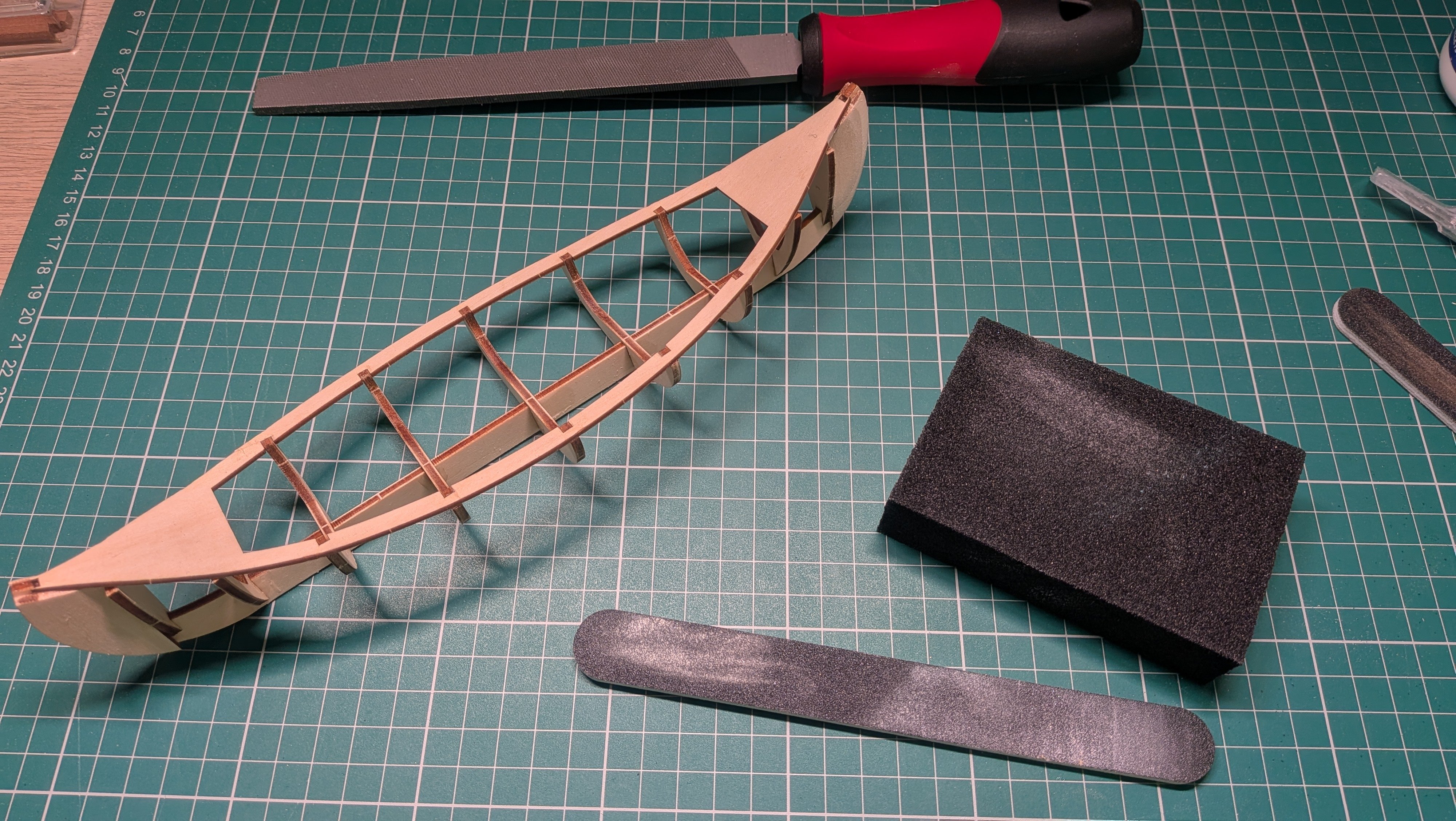

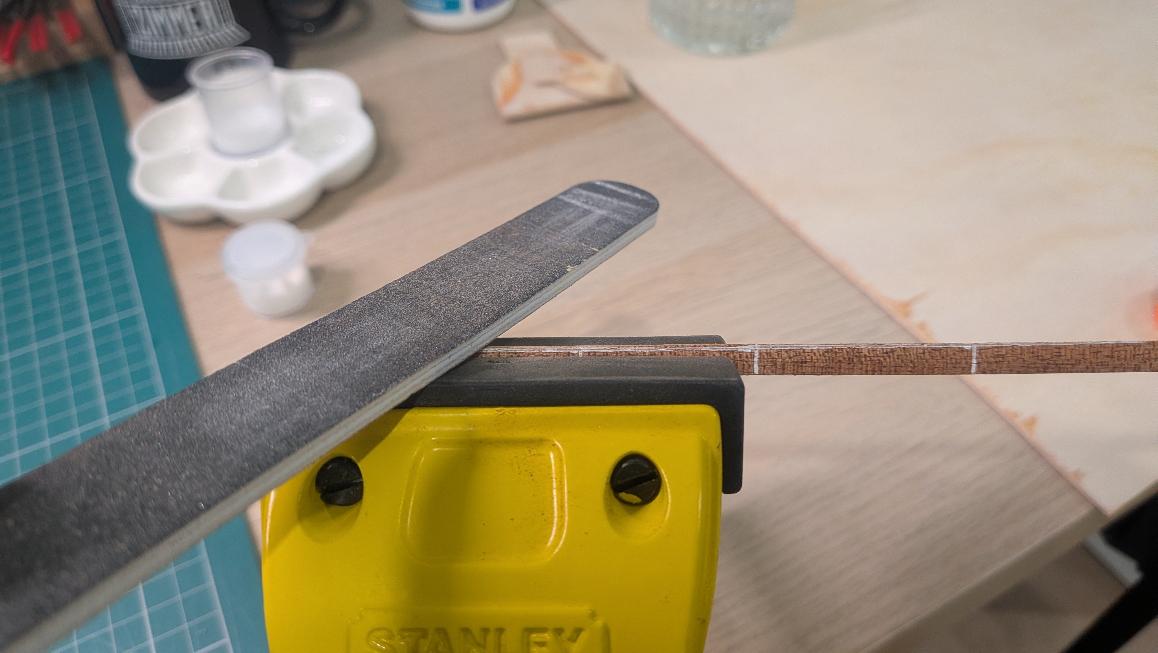

I began by counting and labelling all the parts before cutting them out, then used sandpaper to clean up and level the cut edges.

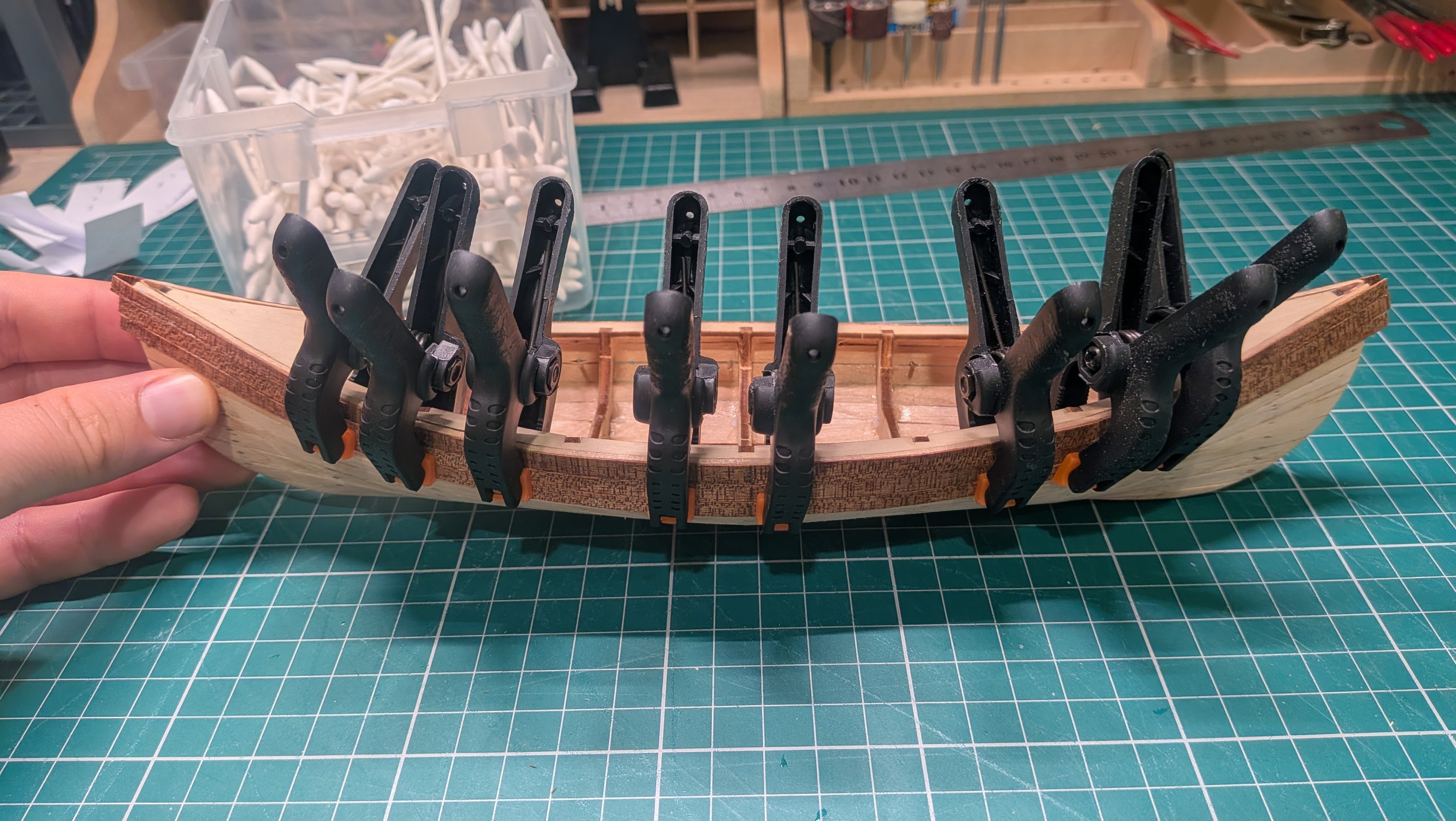

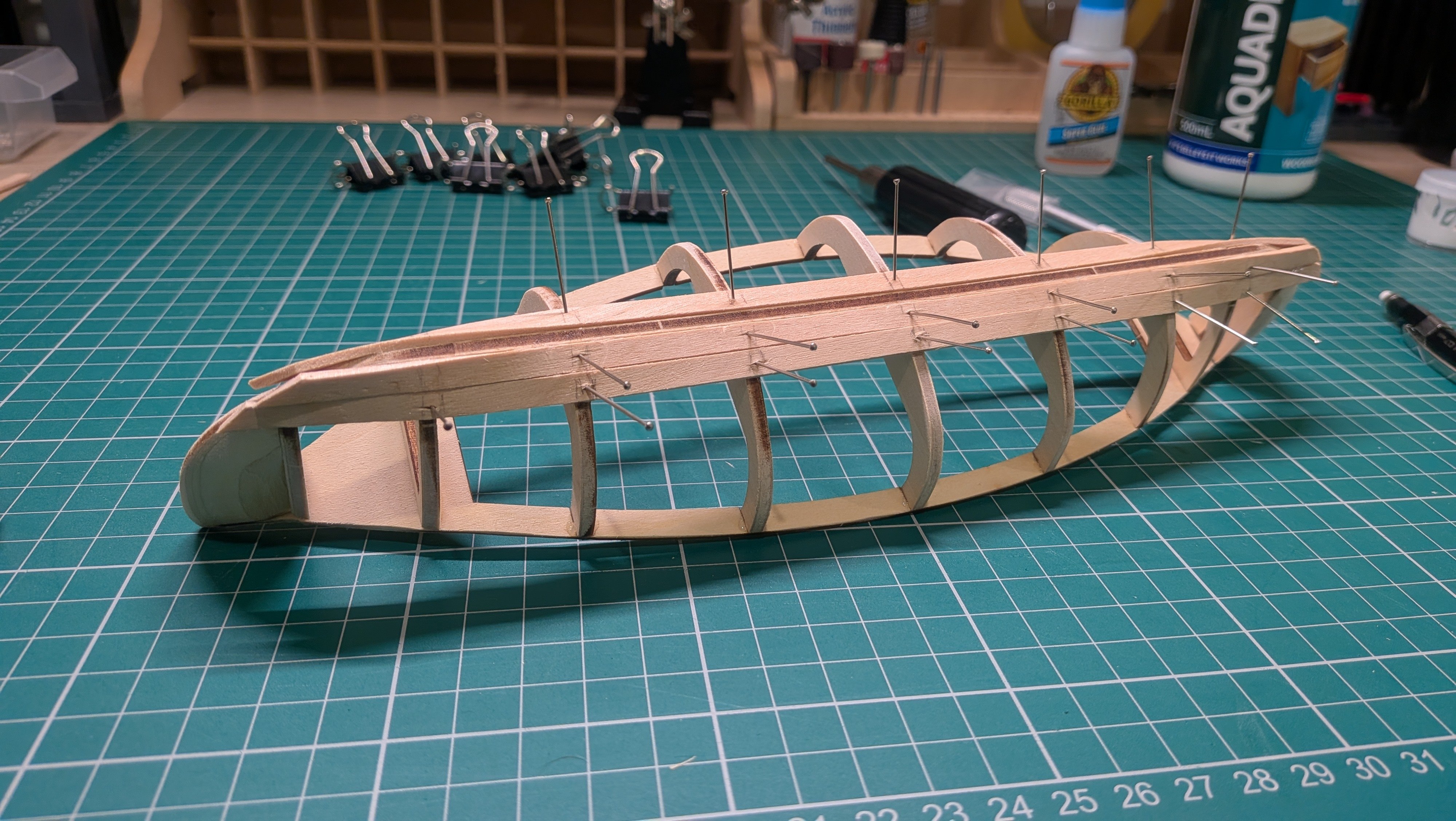

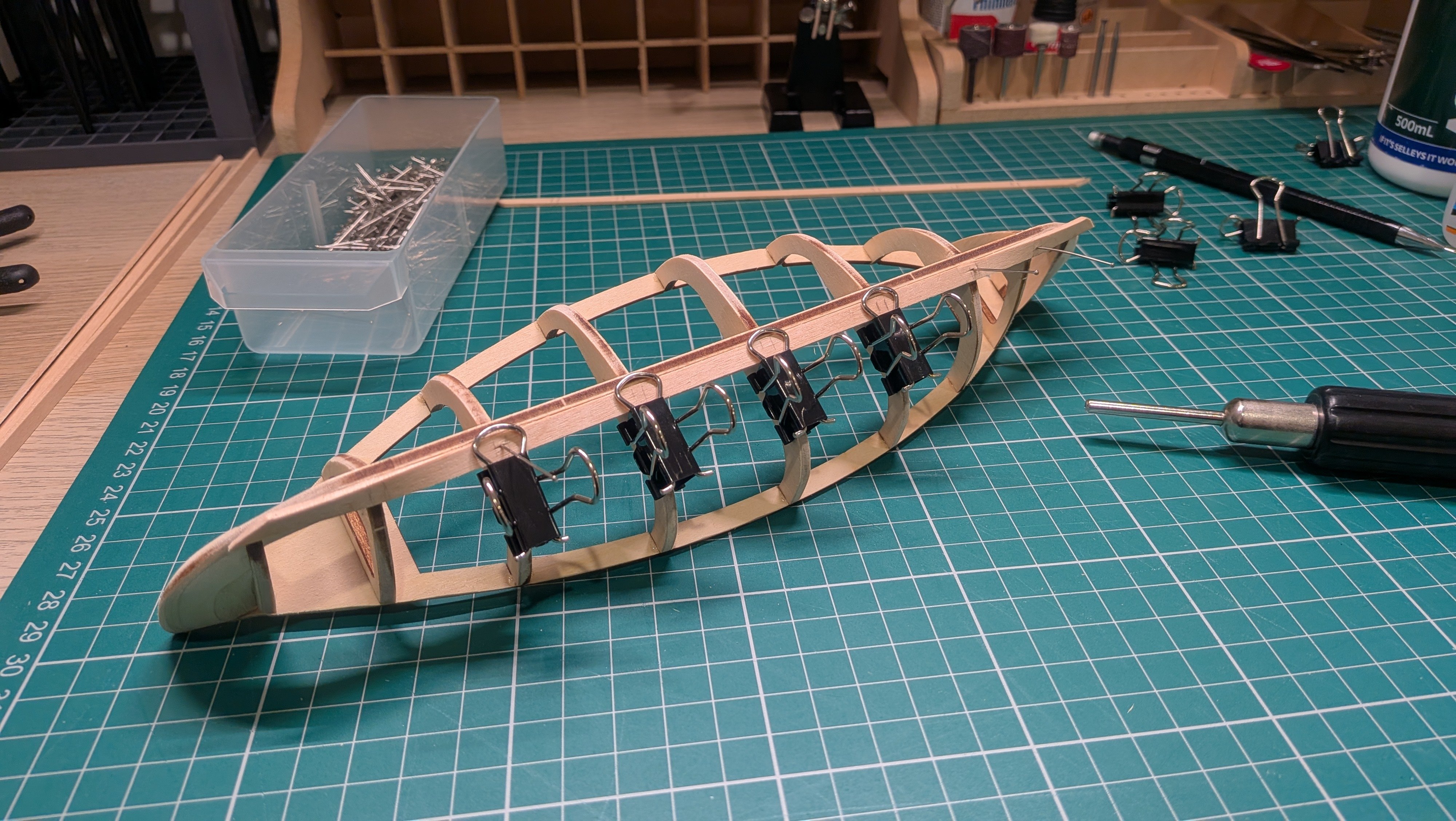

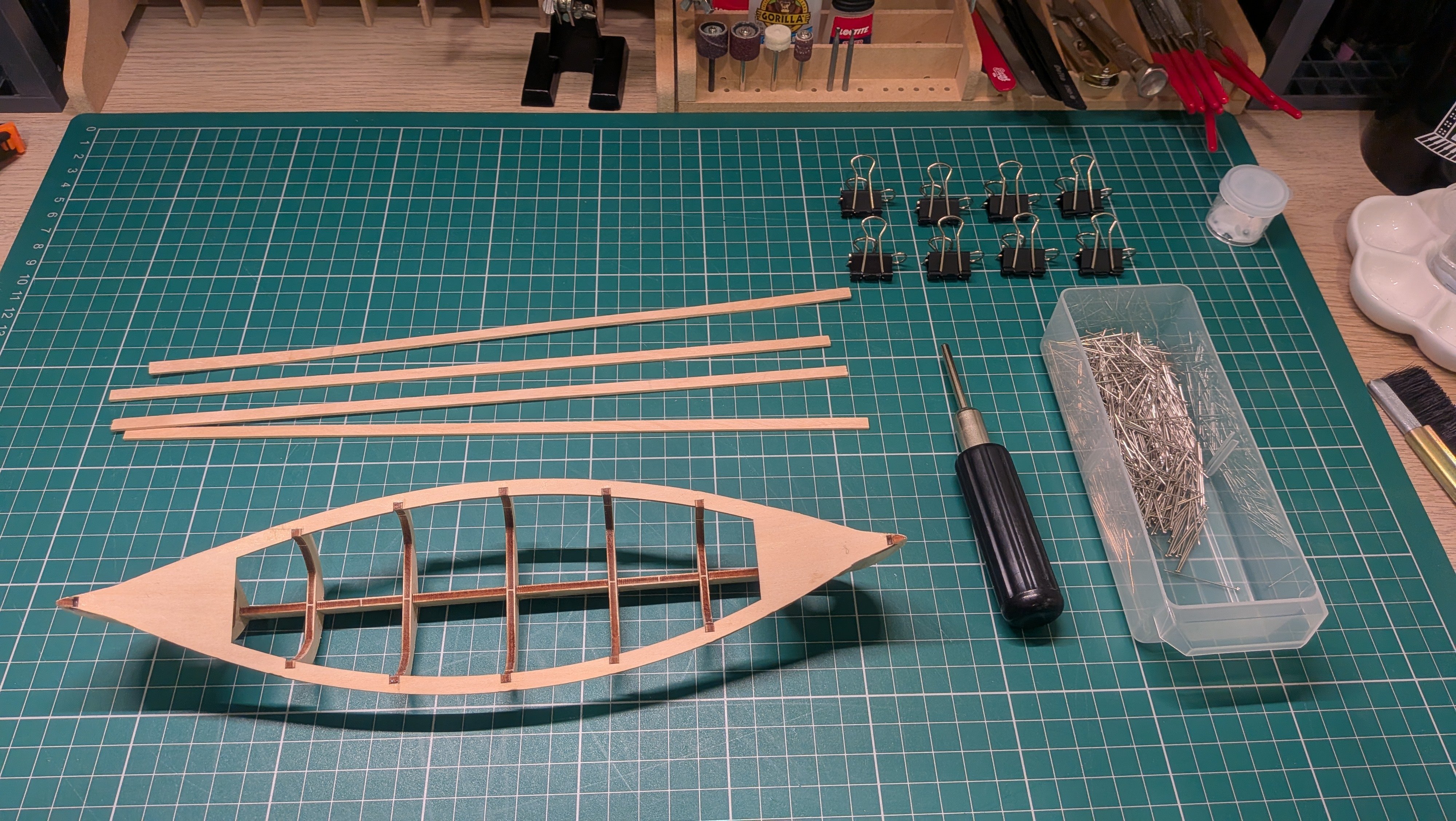

From what I’ve gathered on the forums, most builders prefer using wood glue over CA glue, reserving CA for specific parts, so I followed that approach. After a dry fit to check alignment, I glued the first frame into place, using LEGO bricks as makeshift squares while it dried. (By the way, is this technically called a frame or a bulkhead? From what I understand, bulkheads are solid, disc-like sections rather than open struts, so “frame” seems to fit better here… but I could be wrong!)
4.thumb.jpg.ac1fd903c7a5a63543d58dafb69b049f.jpg5.thumb.jpg.b71b21d452a53fca08656b9088afa934.jpg6.thumb.jpg.36101a93413406bc91e4e2d9034b2187.jpg
That’s as far as I’ve gotten for now. Only a small step. Once I’m confident with the clamping and gluing process, I’ll move on to attaching the remaining frames. I’m taking things slowly, experimenting with techniques, and trying not to rush any step. I’m definitely nervous about making mistakes, but I know that’s part of the learning process - or a rite of passage, really - and I don’t want that fear to get in the way of enjoying the build.

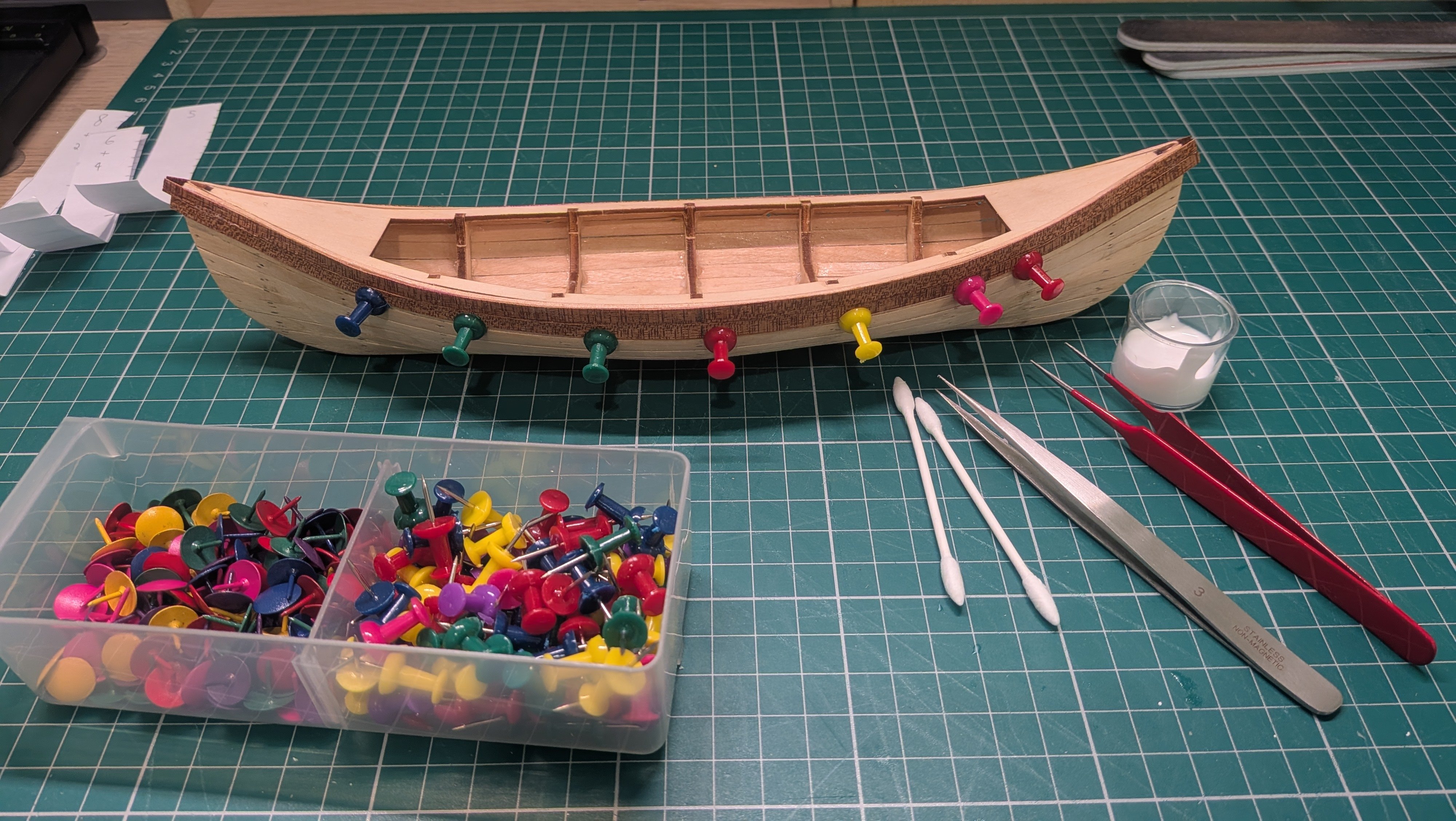

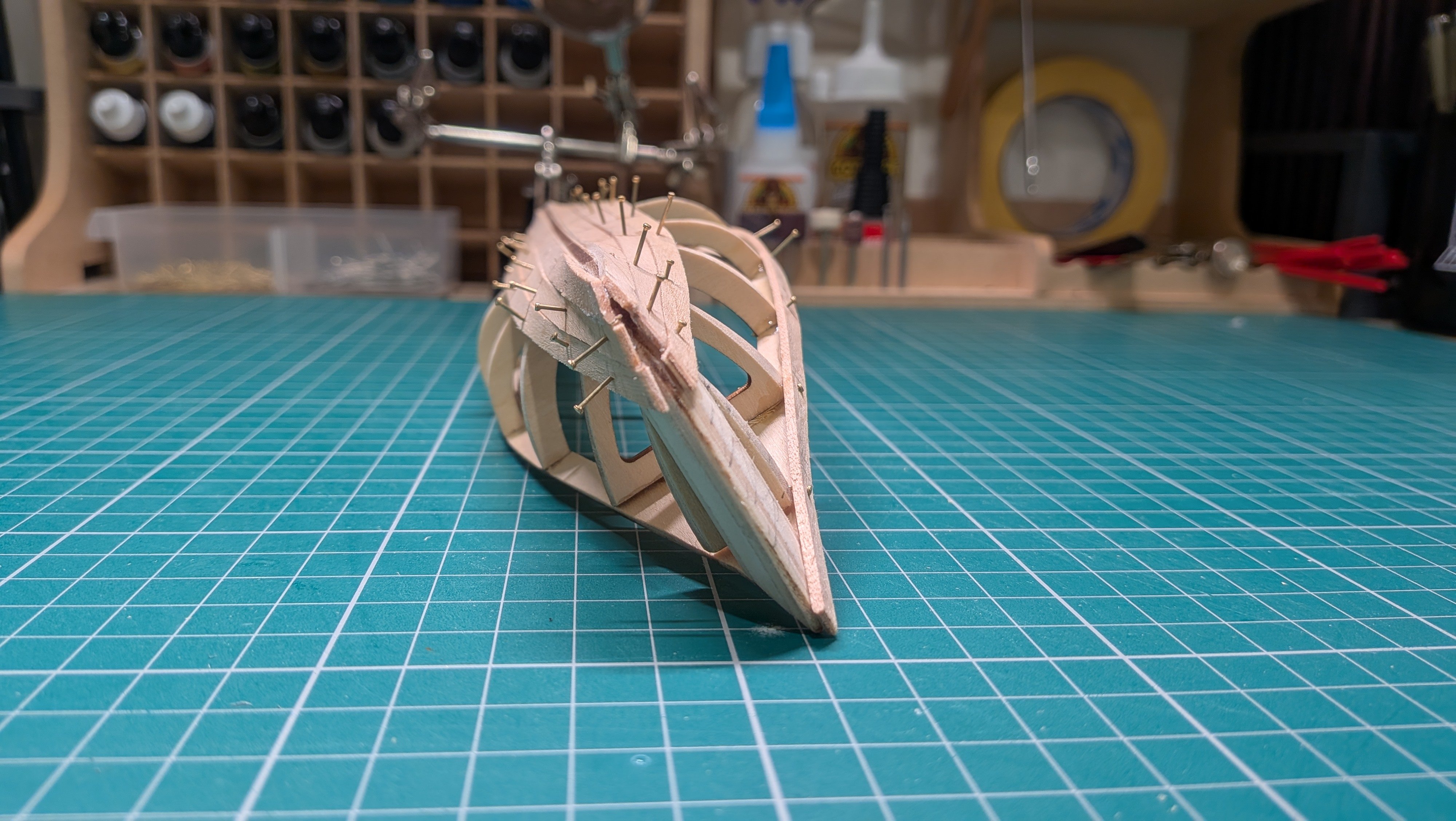

[UPDATE 1]
Thanks for the welcome, Nearshore and Ronald-V!

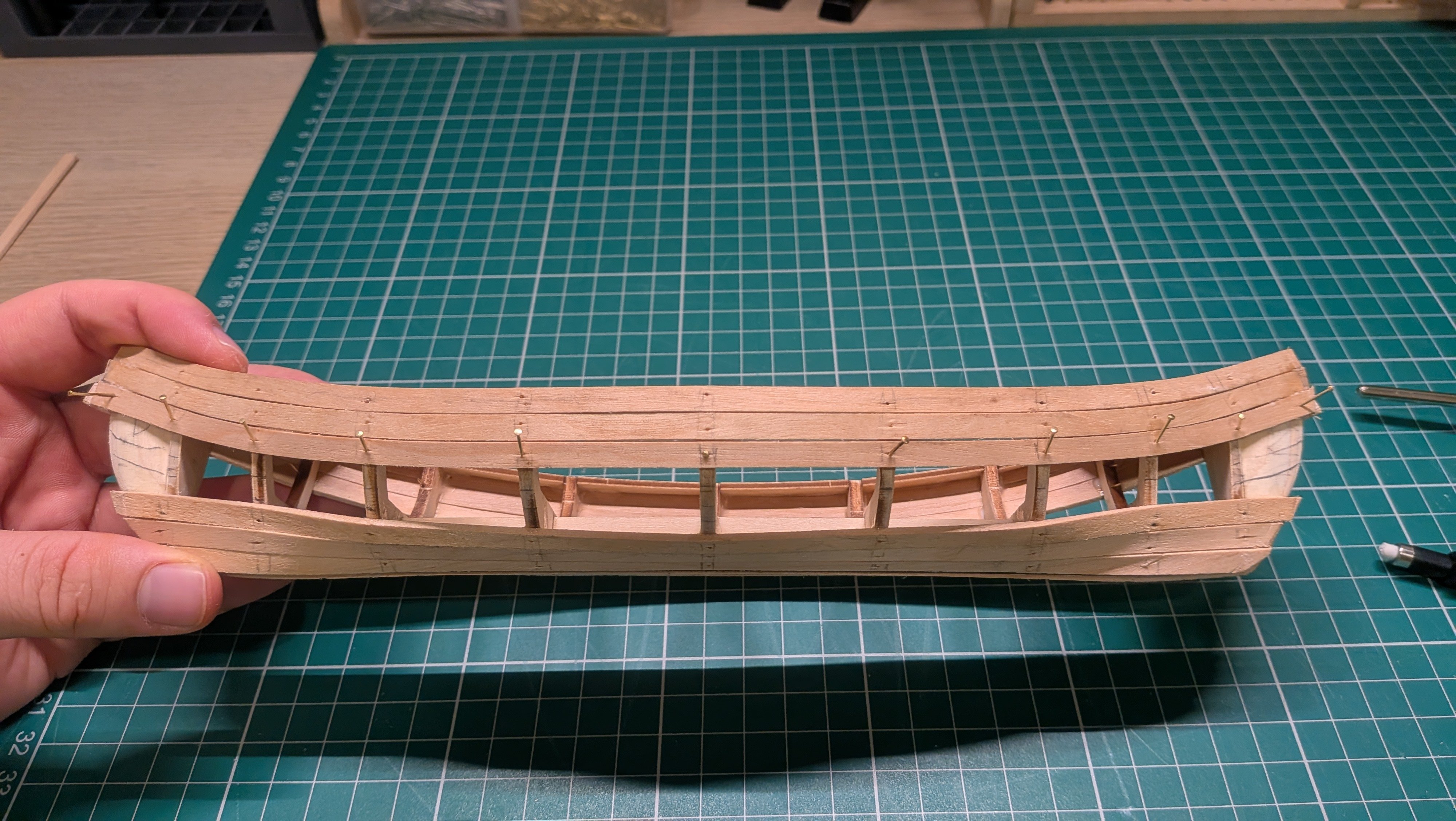

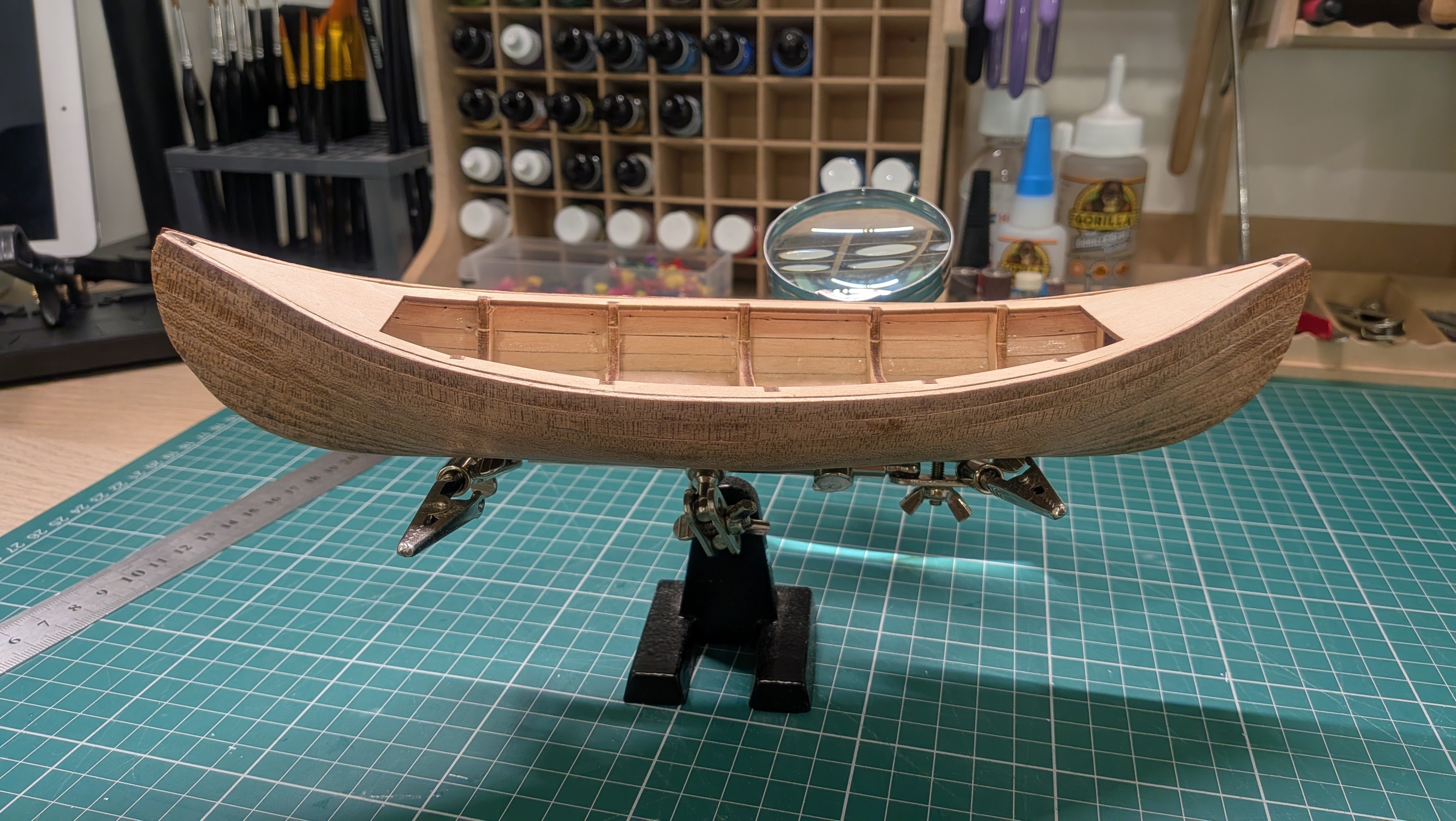

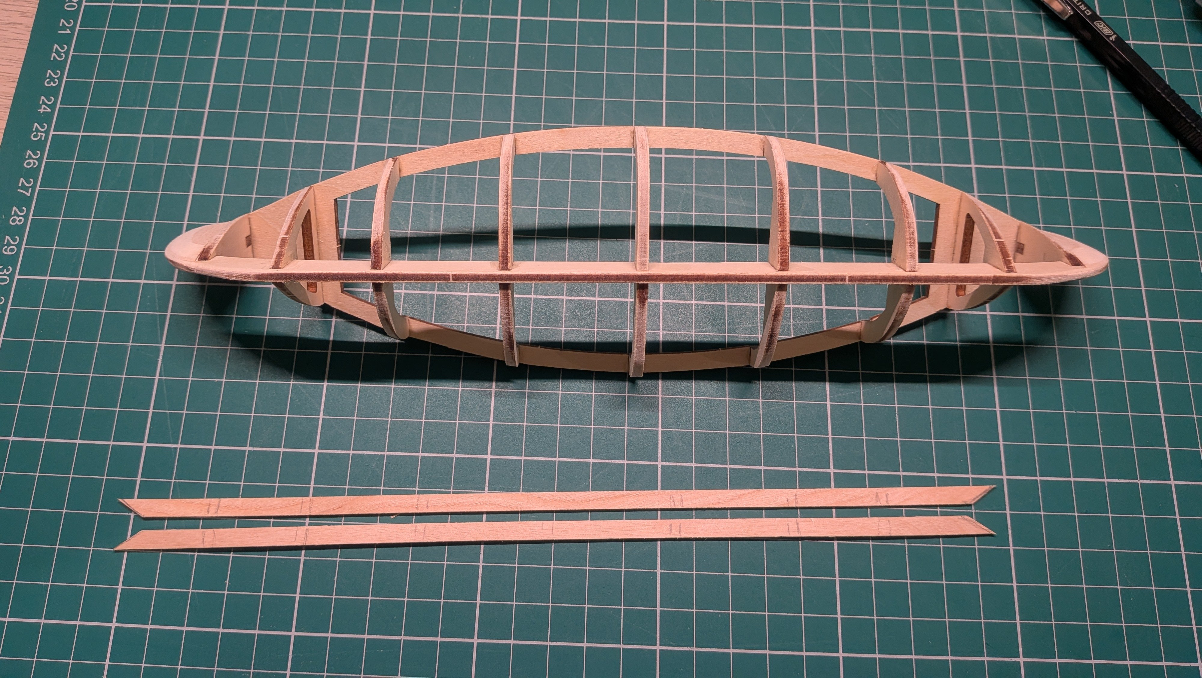

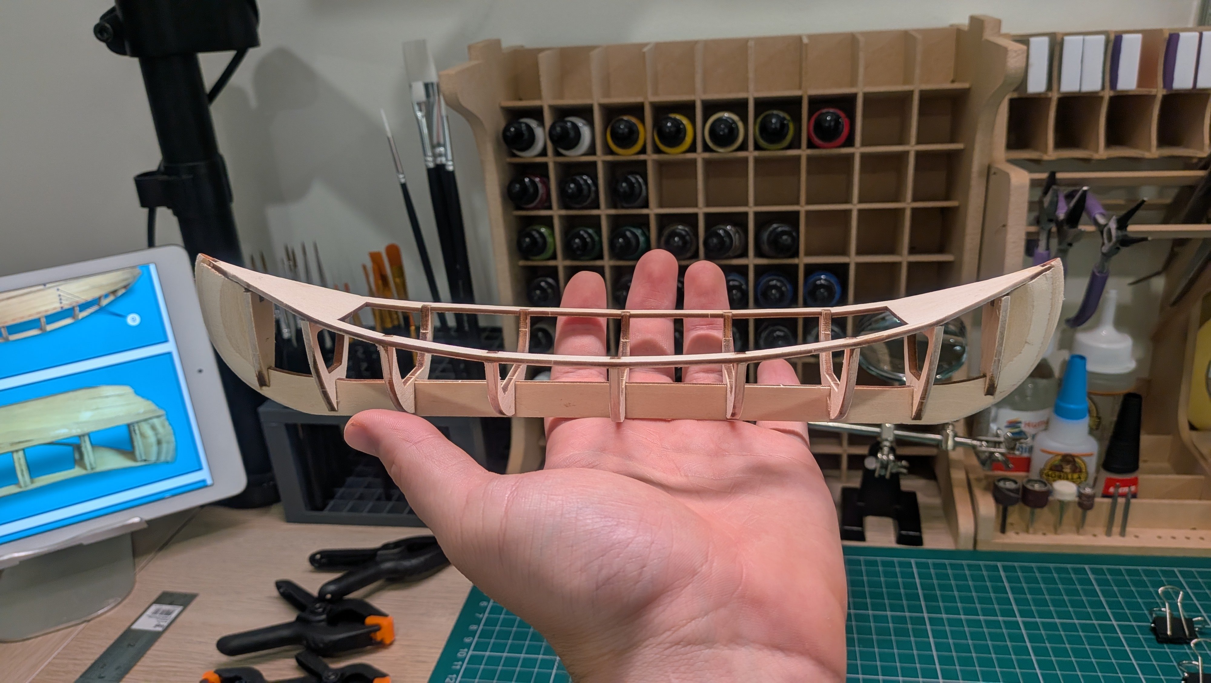

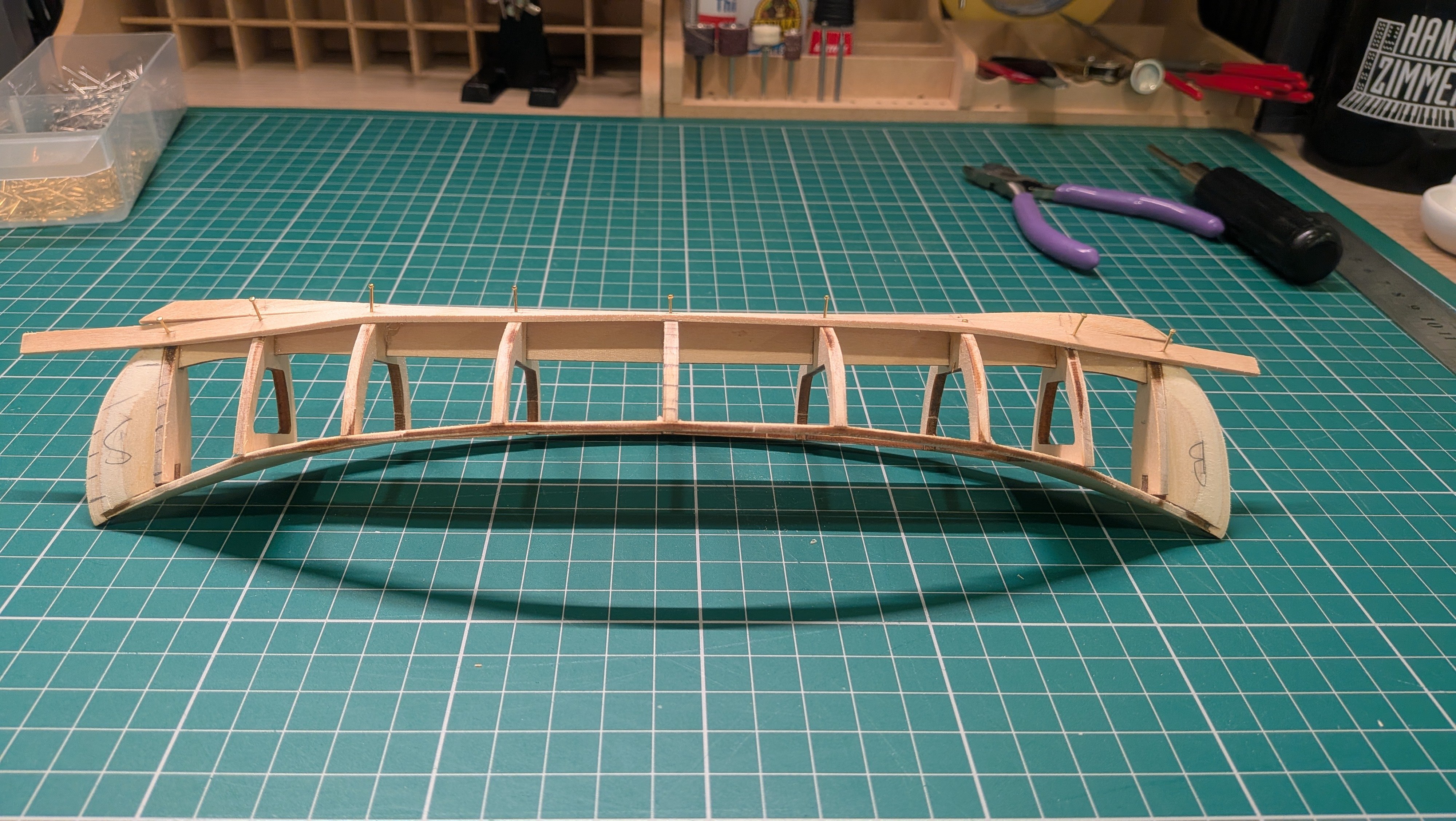

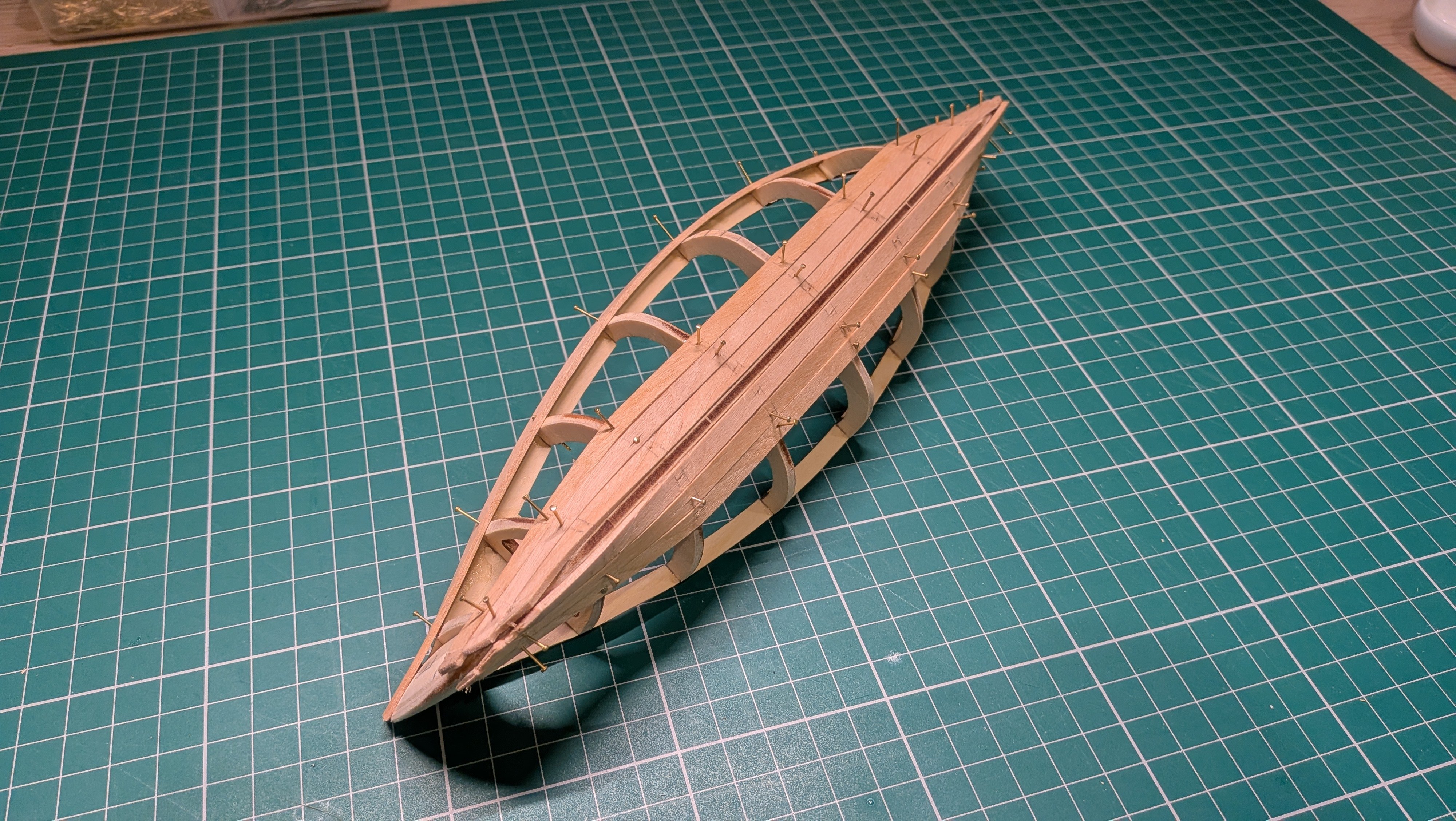

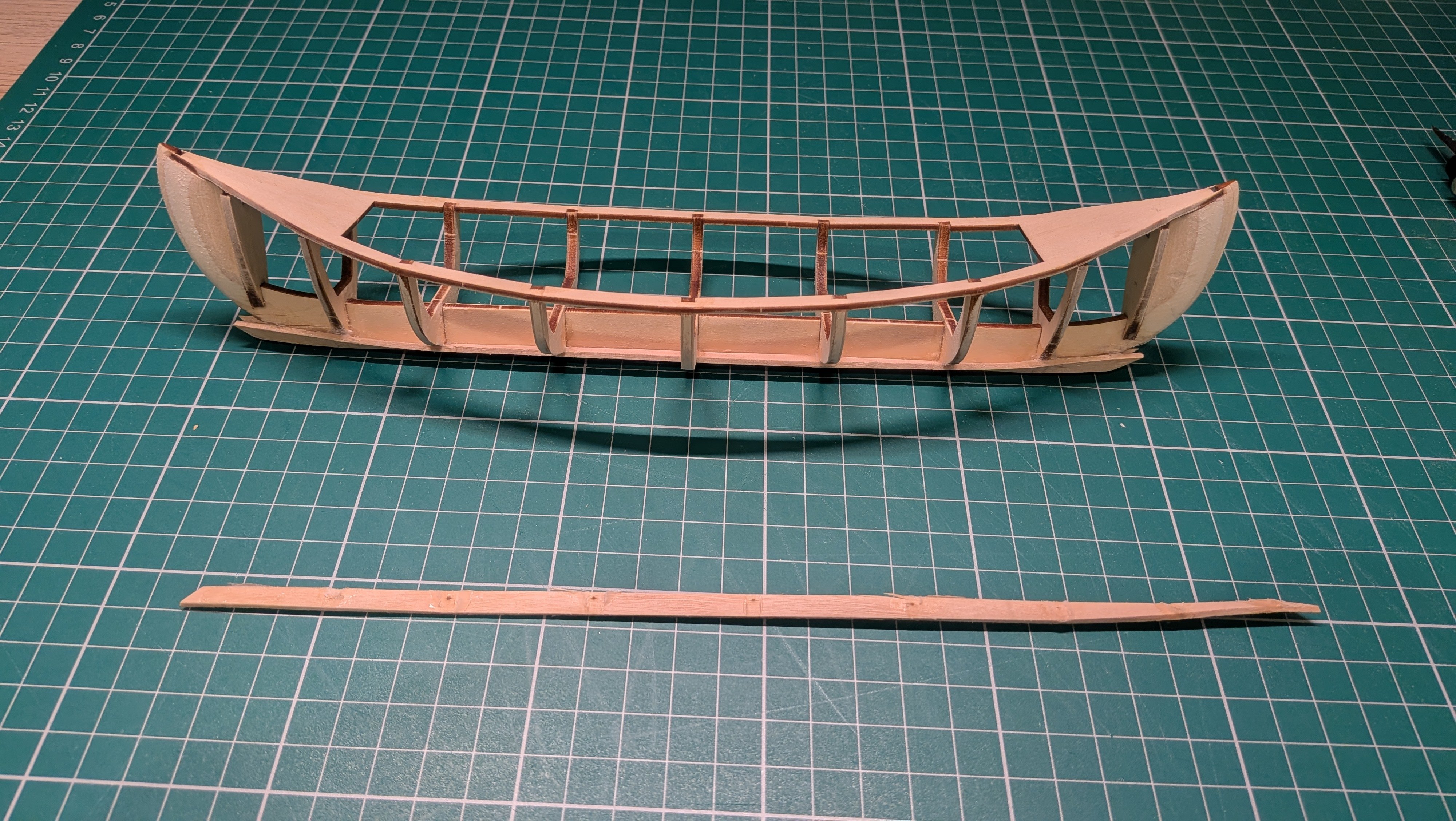

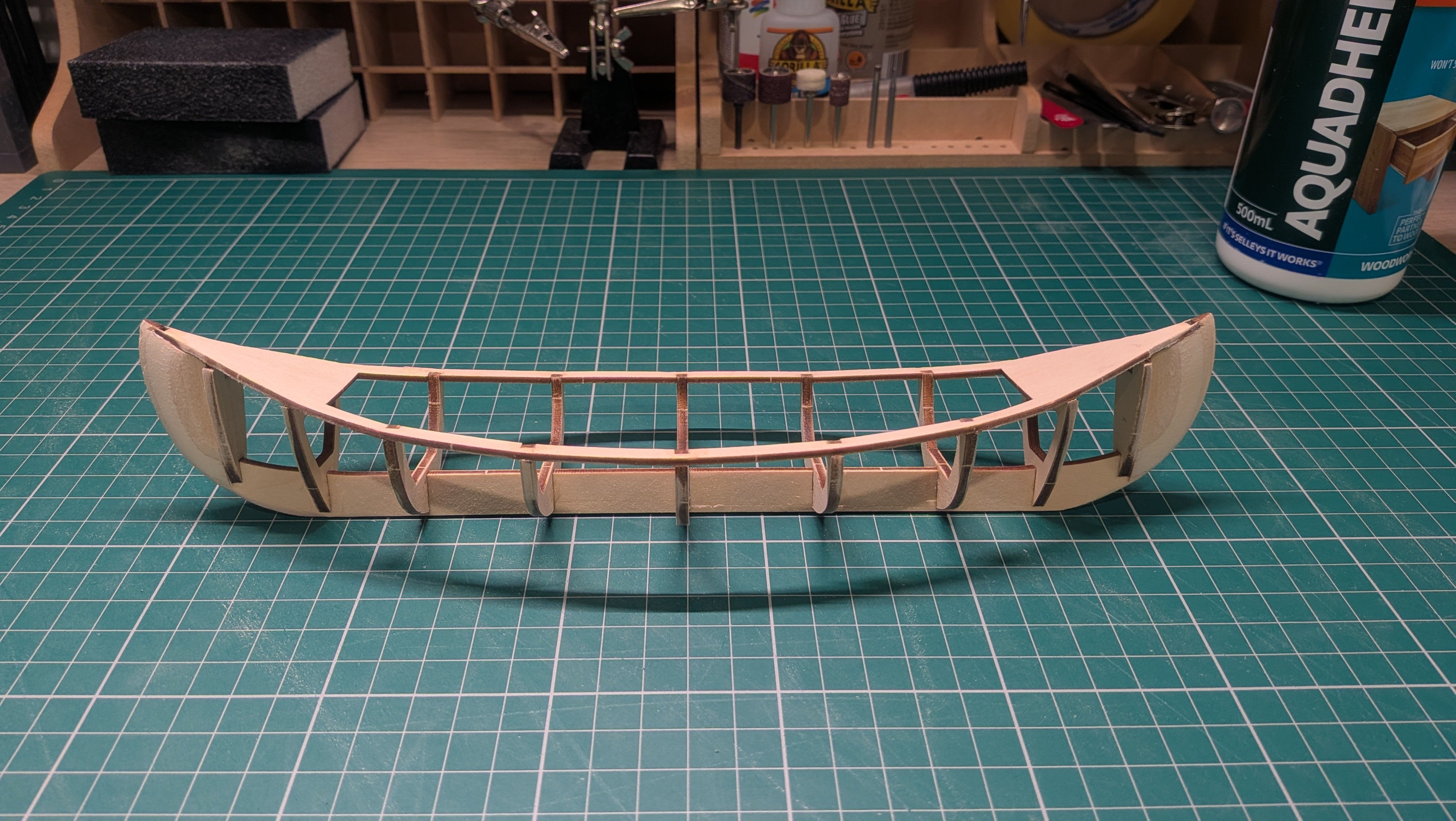

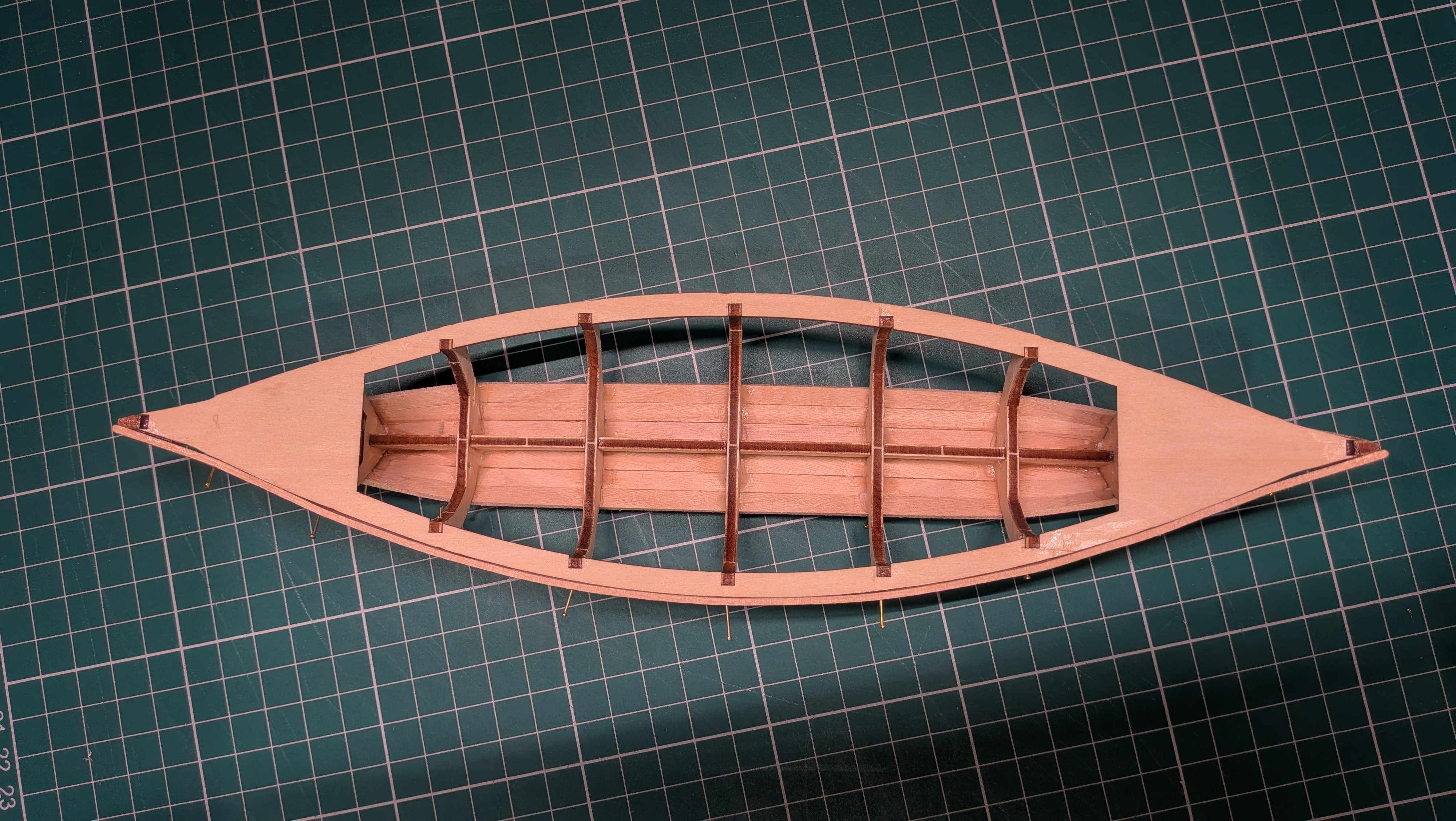

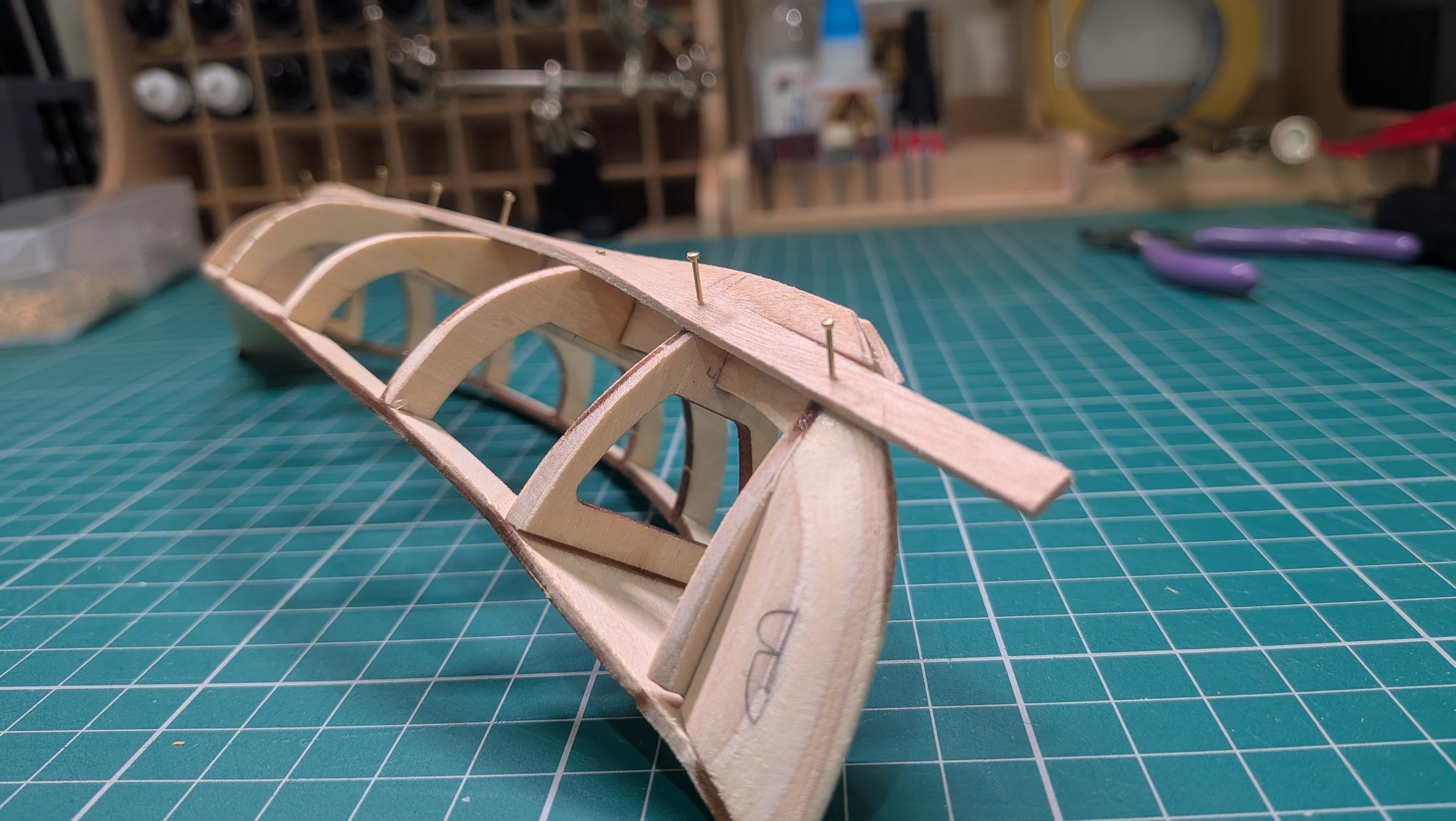

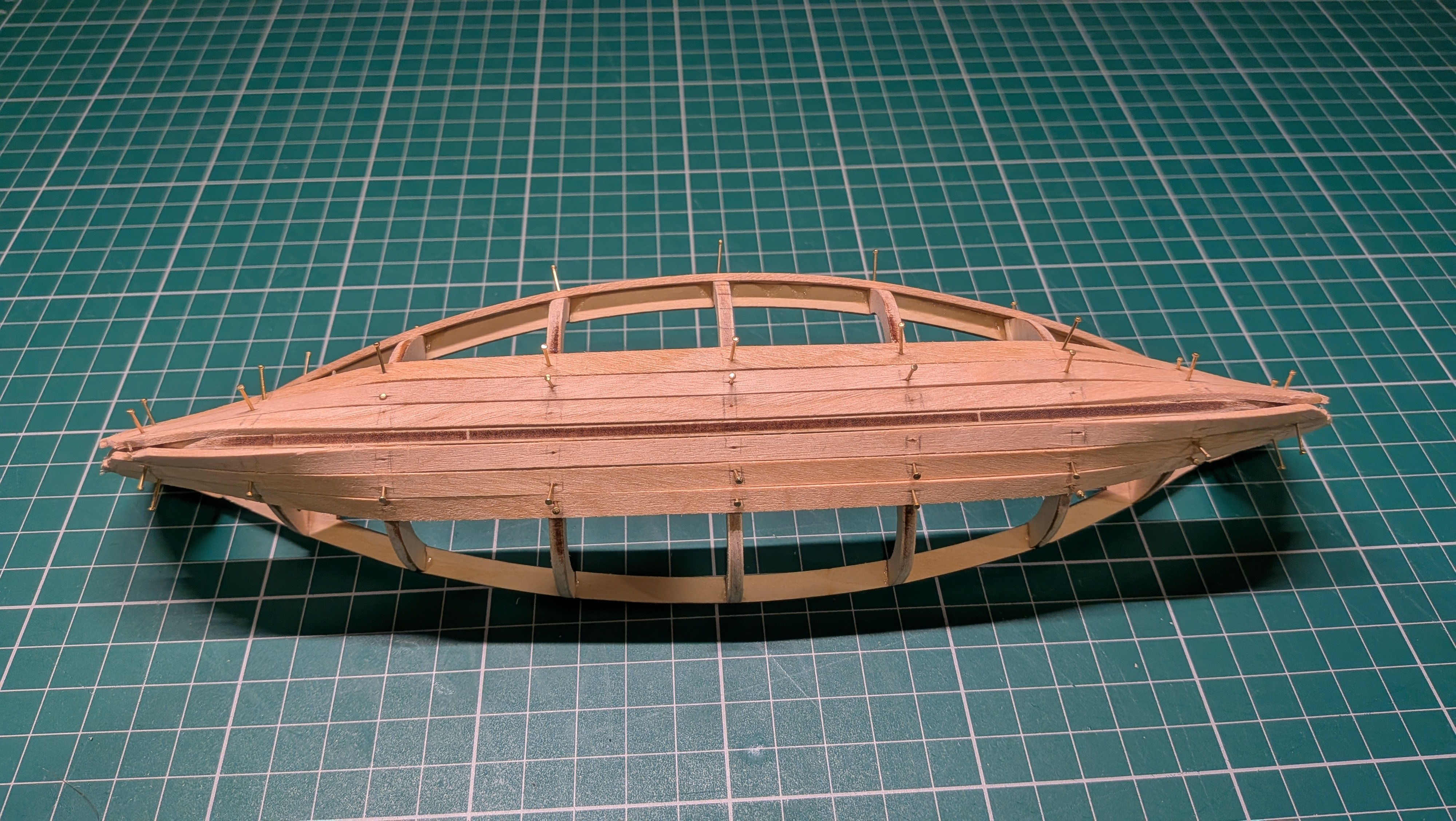

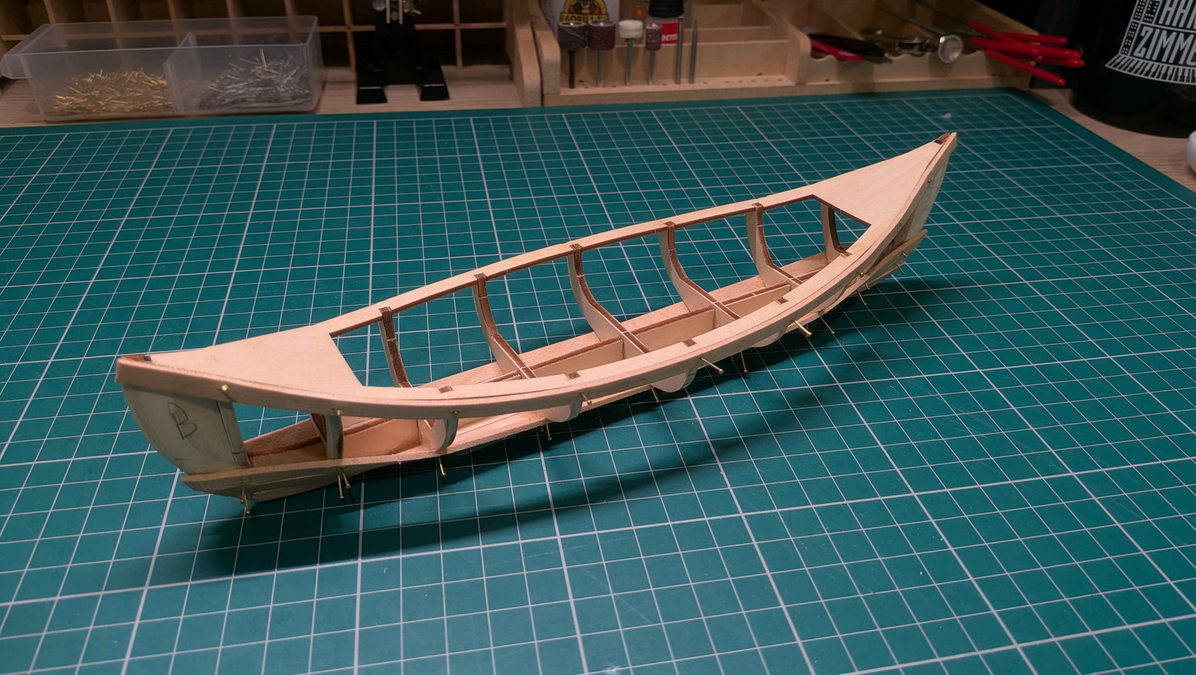

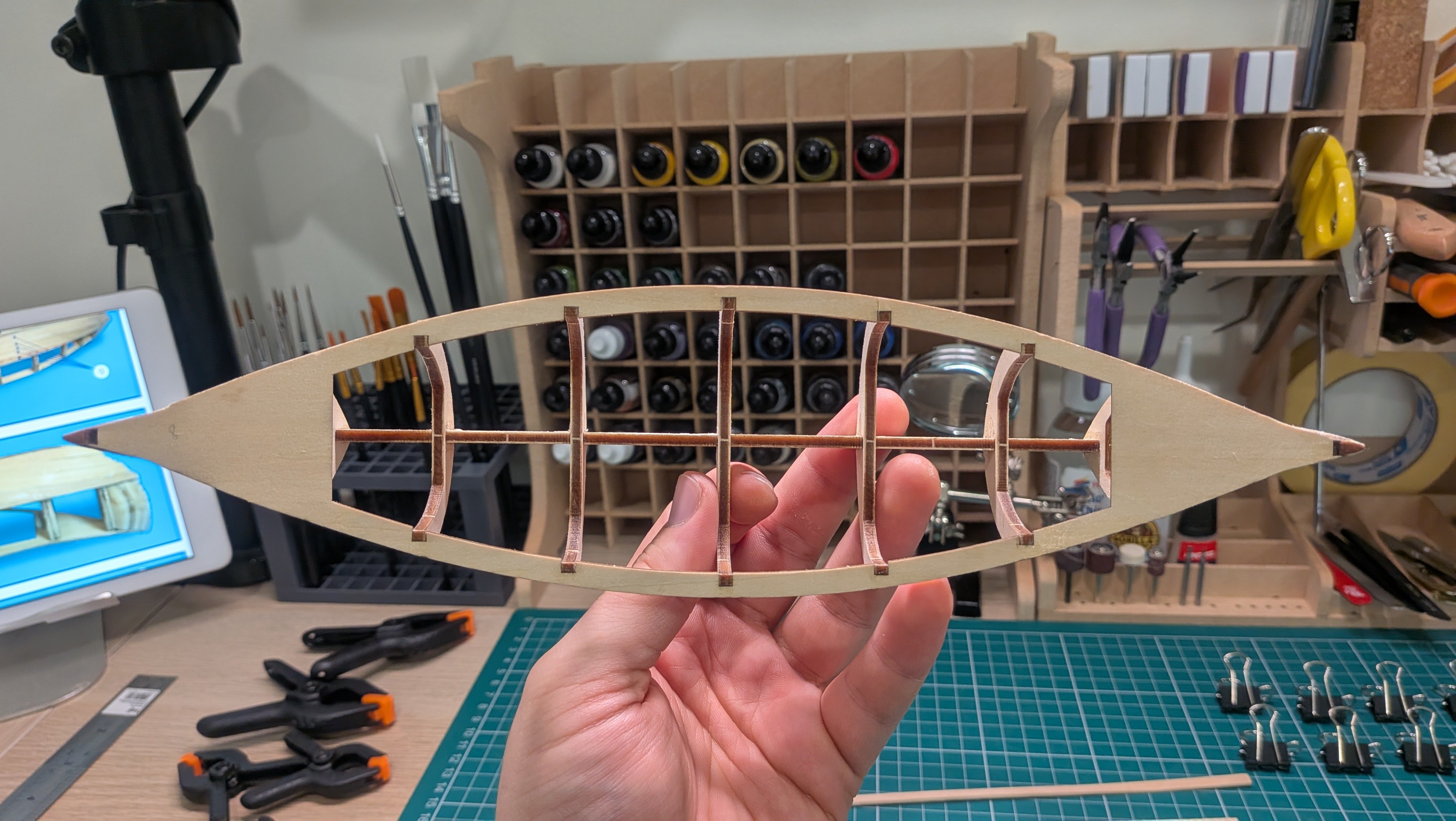

I’ve completed the rest of the frames. I found it a bit tricky to get them perfectly level (foreshadowing of an issue I’ll have), but squaring them was pretty straightforward.

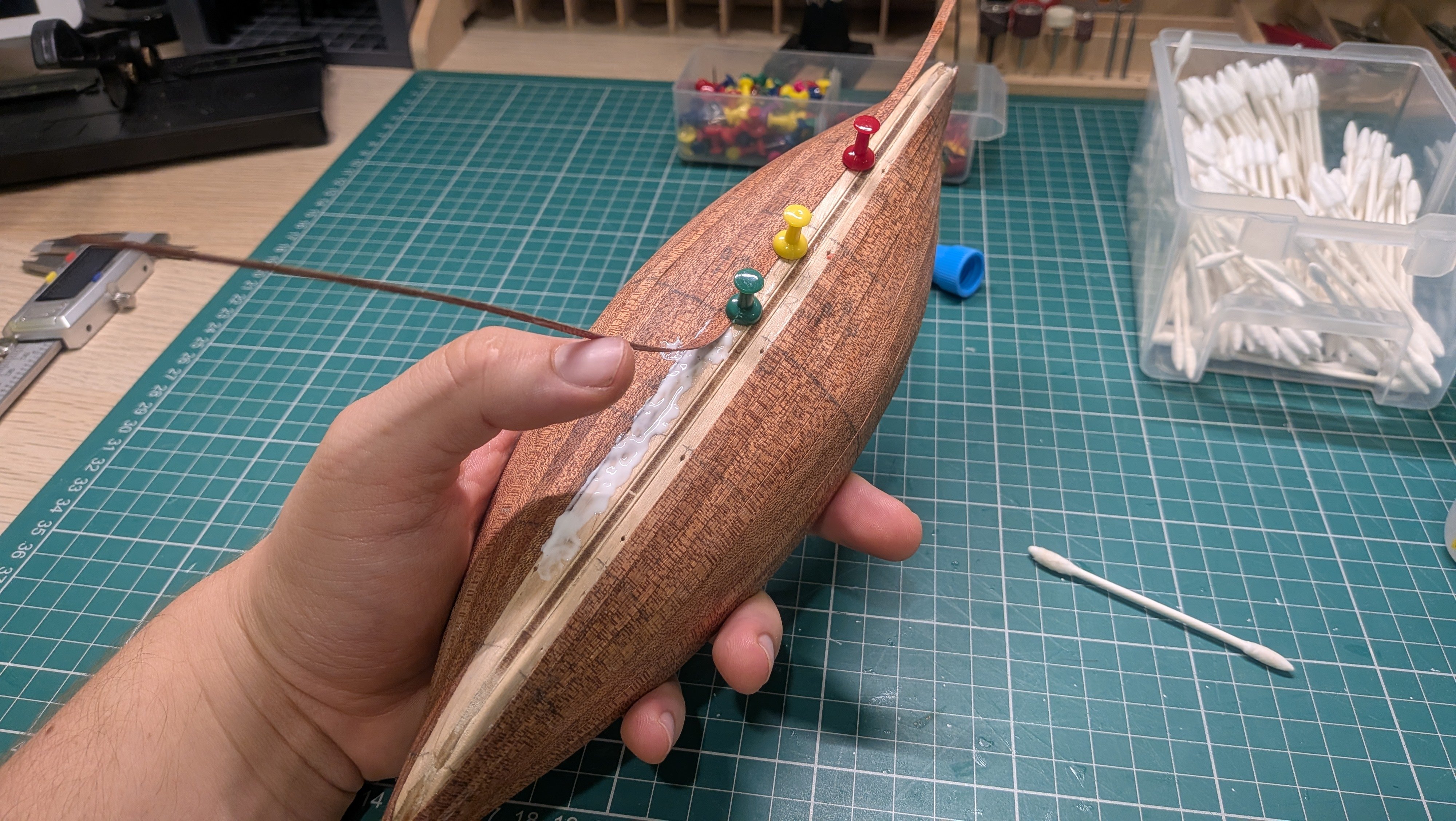

When the time came to glue this next flat piece onto the frames, I assumed it would handle the bend without any help. Probably a rookie mistake because I was definitely wrong, and the wood split right at the point that takes the most stress.
I decided to fill the split with some Loctite super glue and let it set for a few hours.

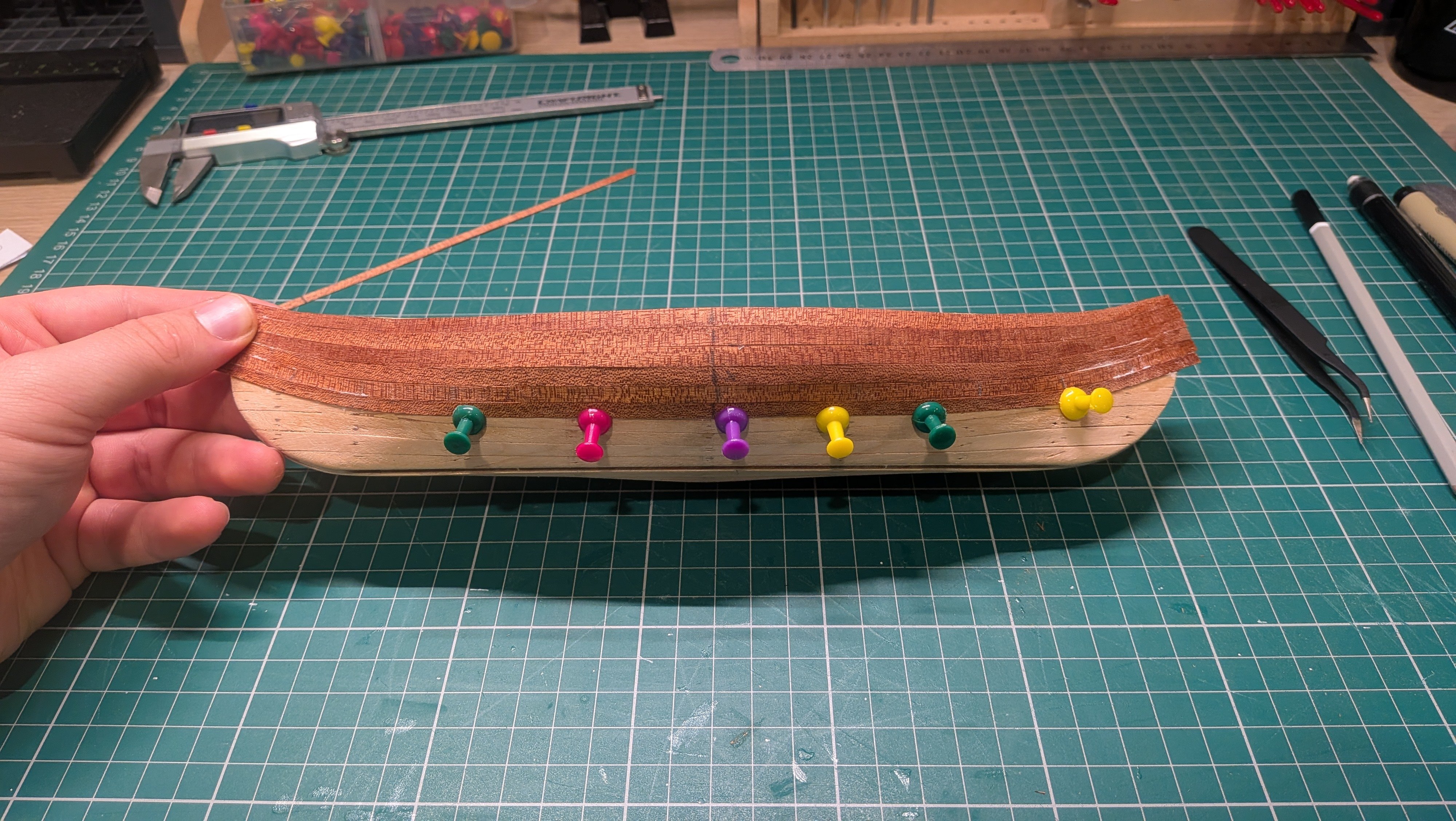

This time, I boiled some water and poured it into a plate, soaking the wood for about 30 seconds. After a quick wipe with a cloth, I carefully shaped it into position on top of the frames, and it worked perfectly.
Three things I noticed while it was drying:

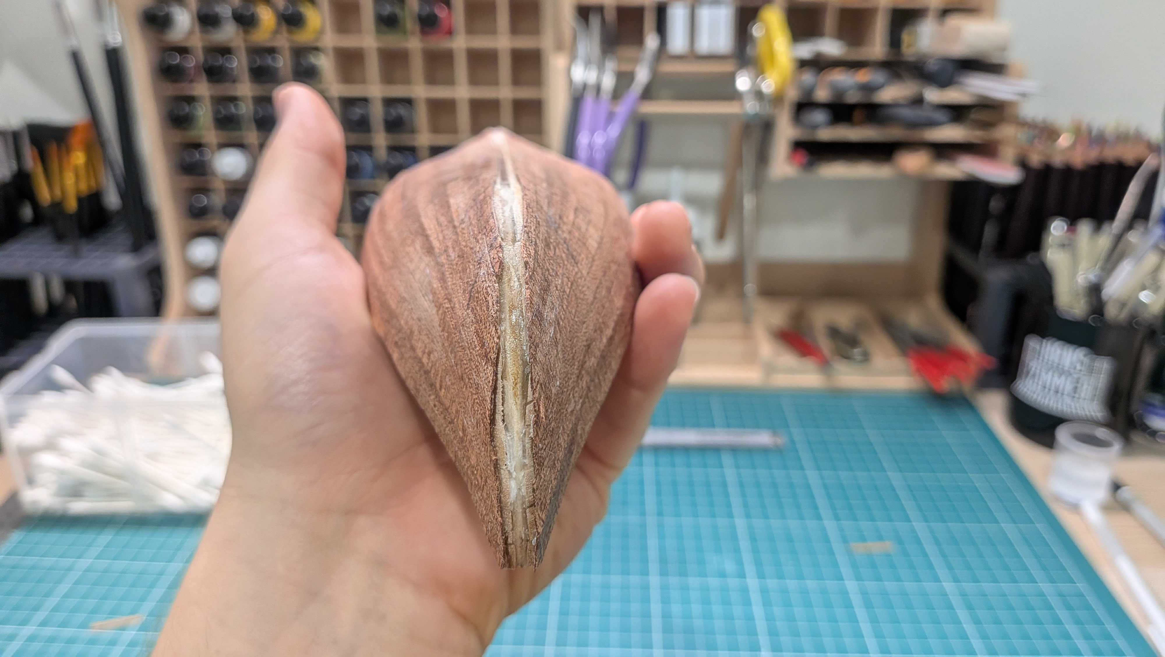

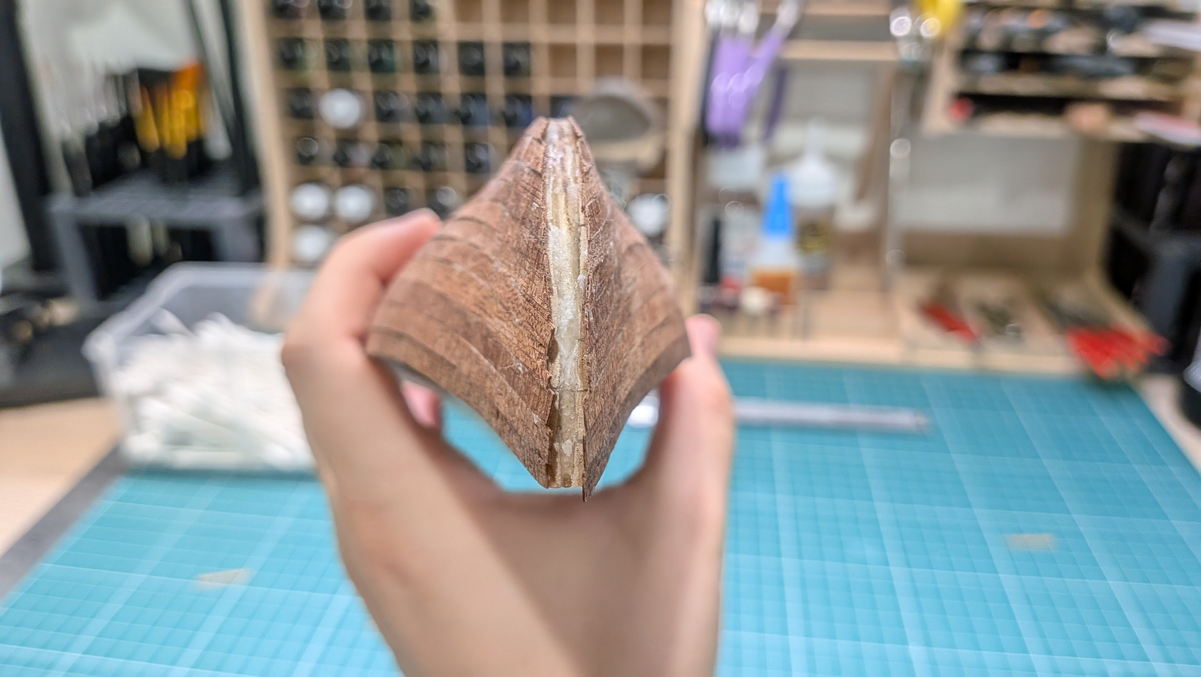

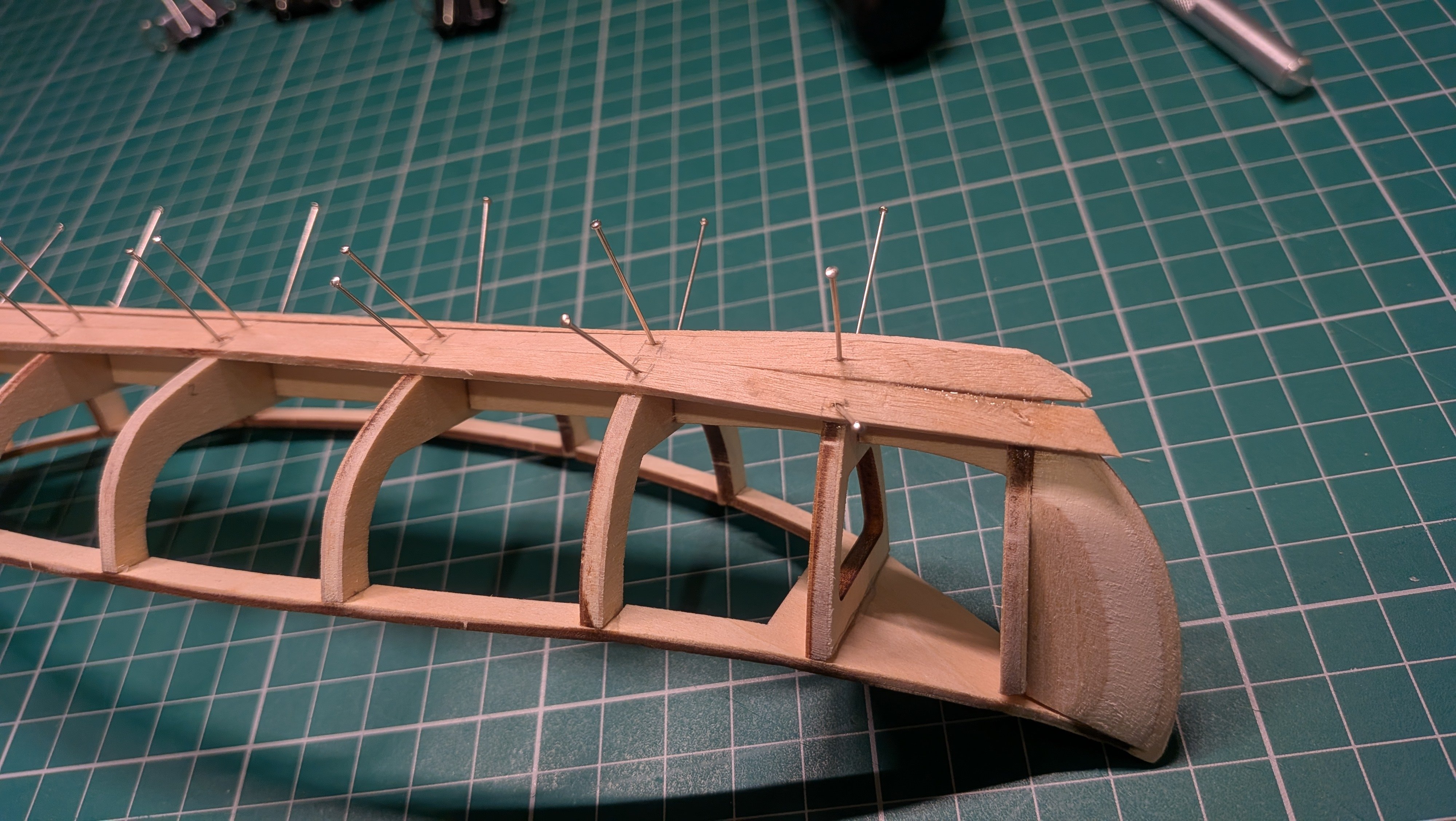

1) The flat piece doesn’t line up flush with the ends of the ship. A gap can be seen where it's meant to connect (see below). I decided that aligning the flat piece with the frames was more important than having the ends flush (I tried to get both but couldn't figure it out). I'm hoping that this won't be a problem for me later!
2) Something I realised was that I probably should have sanded a slight bevel on the two closest frames at each end. If those frames had been beveled, the connection might have been a bit stronger.

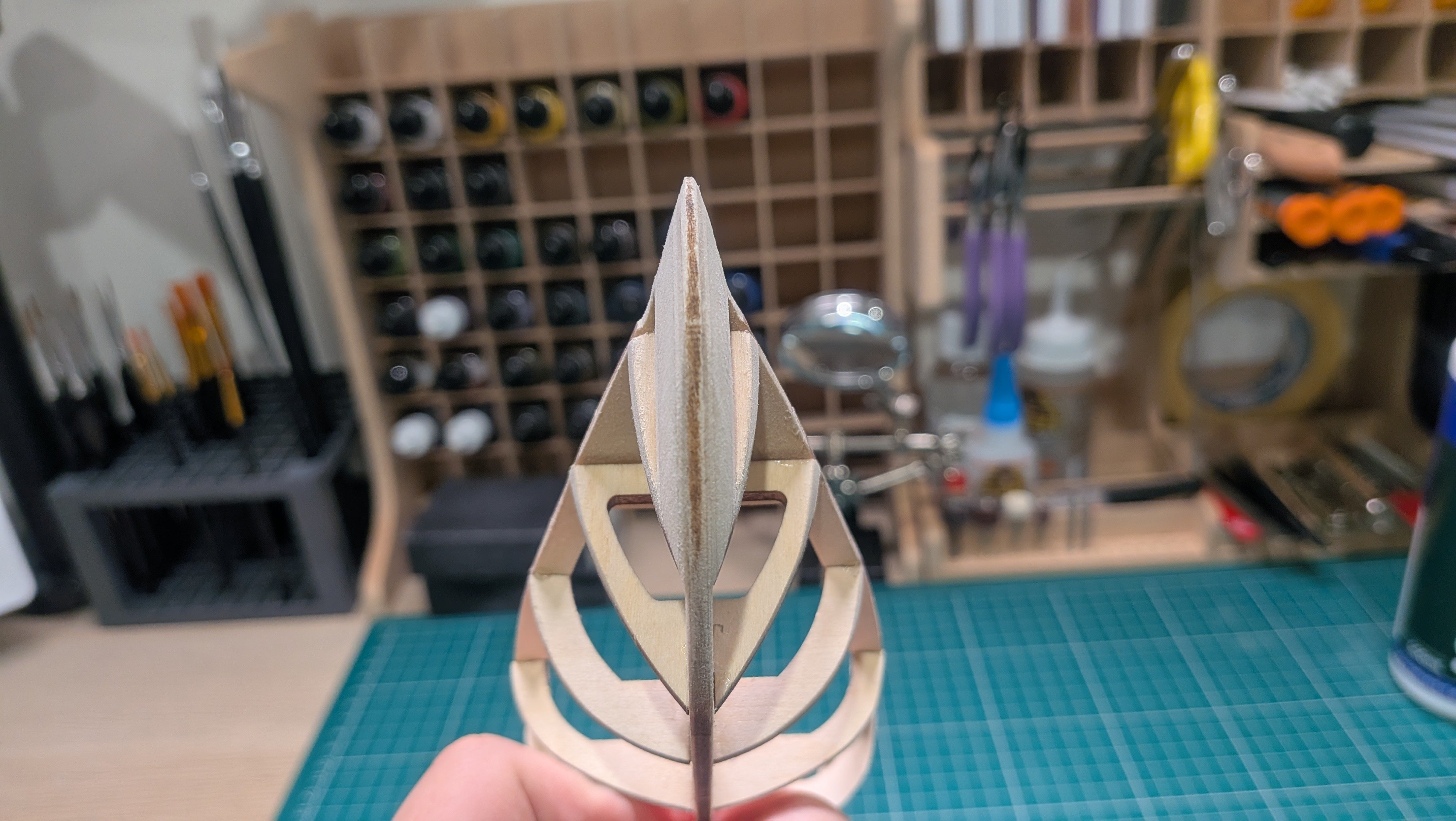

3) Finally, remember when I said I had trouble getting the frames perfectly level? Well I’m pretty sure this frame (see below) is slightly leaning more to one side which makes everything the tiniest bit wonky. It's not the end of the world, but worth noting for next time. If anyone has tips for getting your frames or bulkheads perfectly level, I’m all ears!
