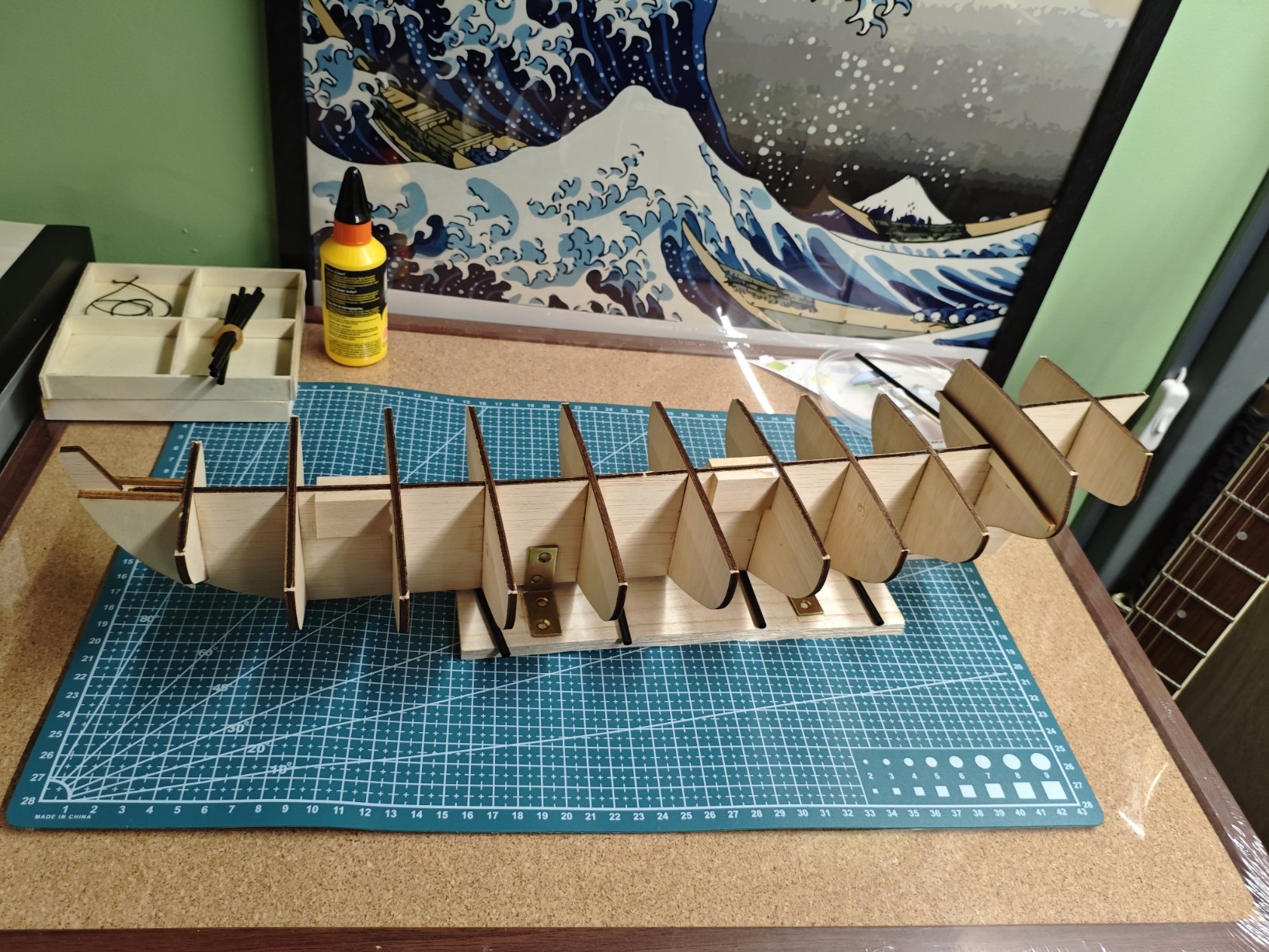

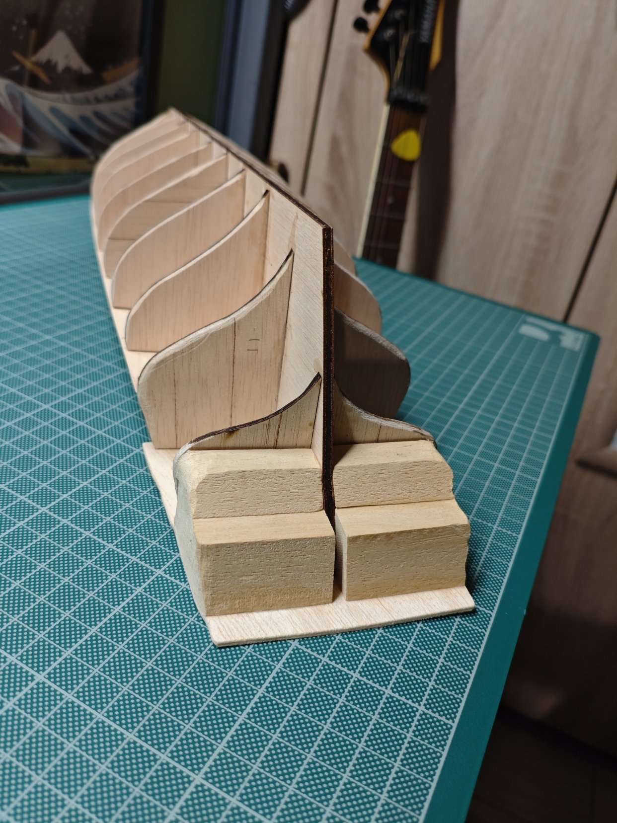

The very beginning...

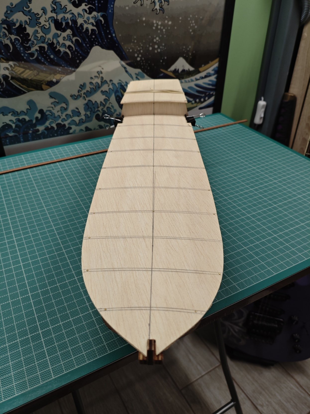

Next the false deck
IMG_20251127_171918.thumb.jpg.96ef91f9f23f677dbb6d2b808ff708b9.jpgIMG_20251127_003347.thumb.jpg.d9360f0f40c91ebd6bb9859a4d6686f6.jpg

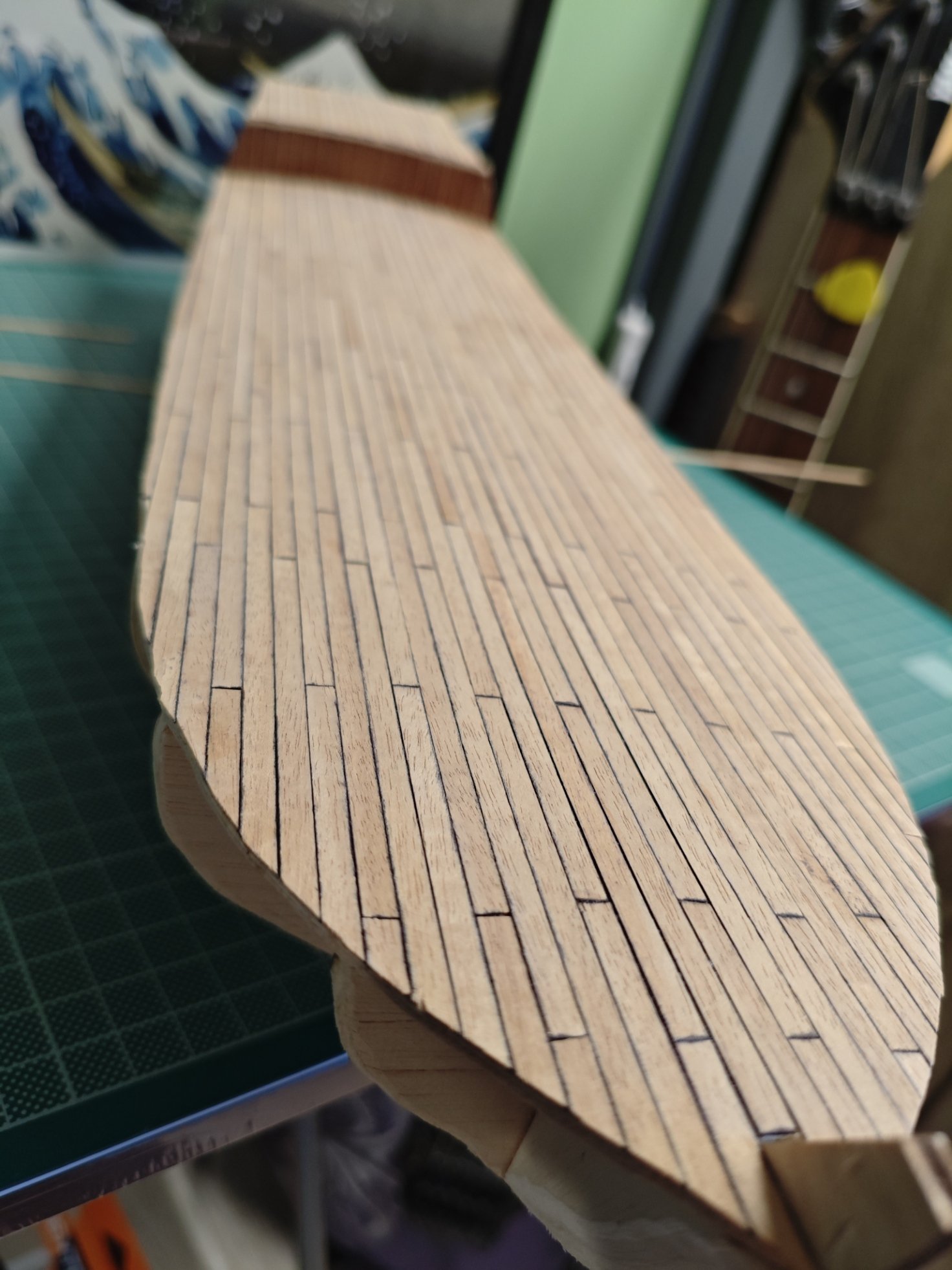

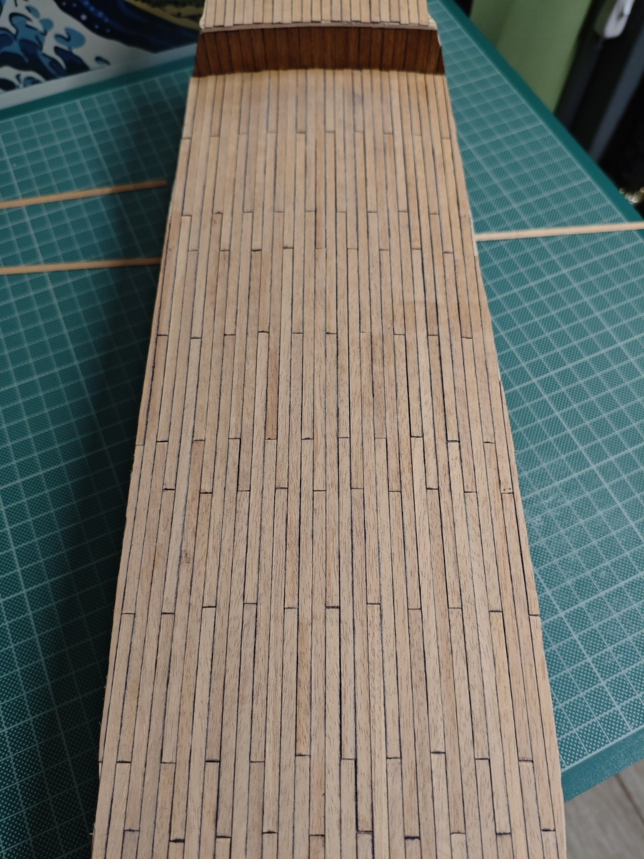

Bit of smoothing
Next i planked the deck

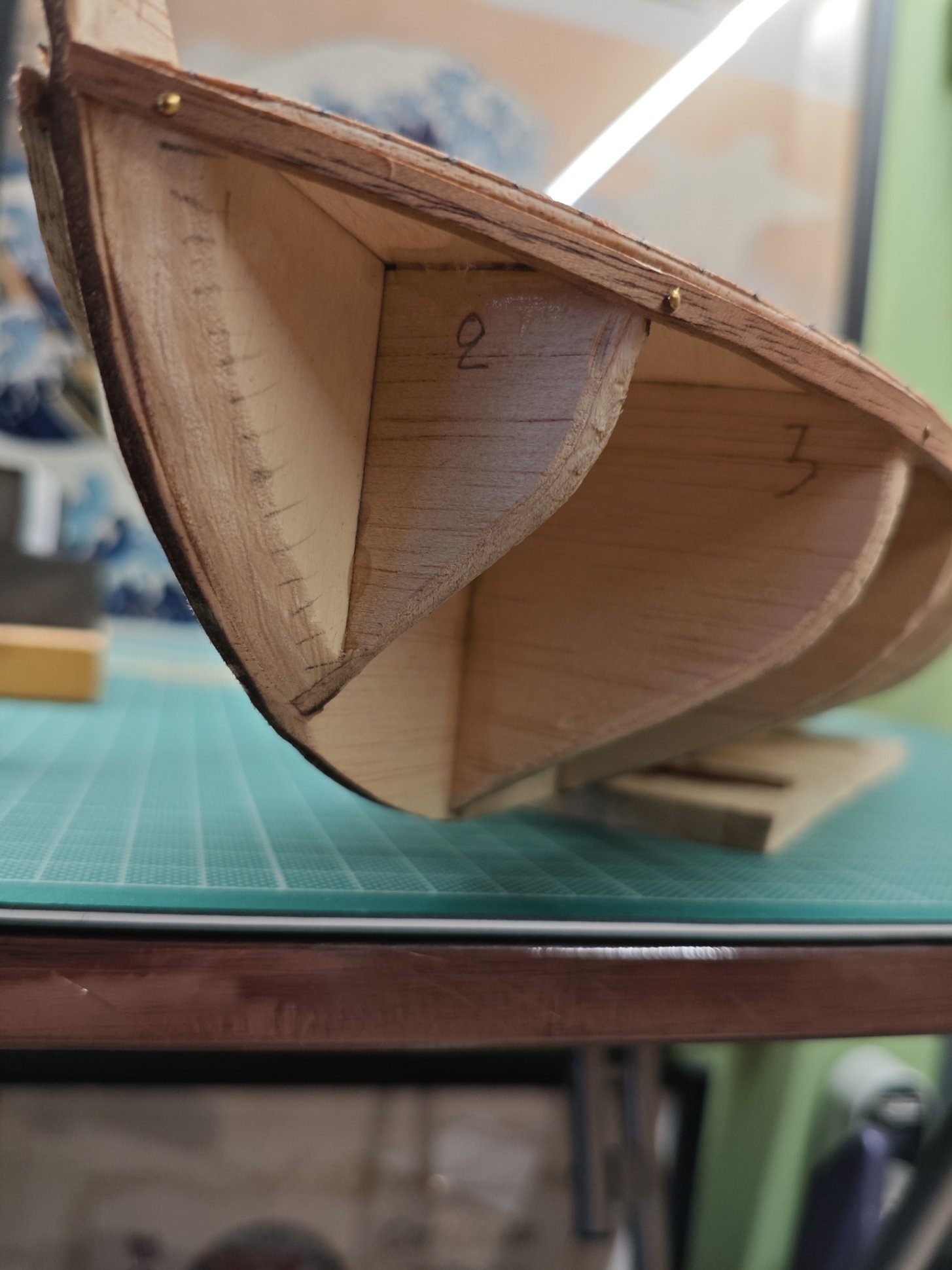

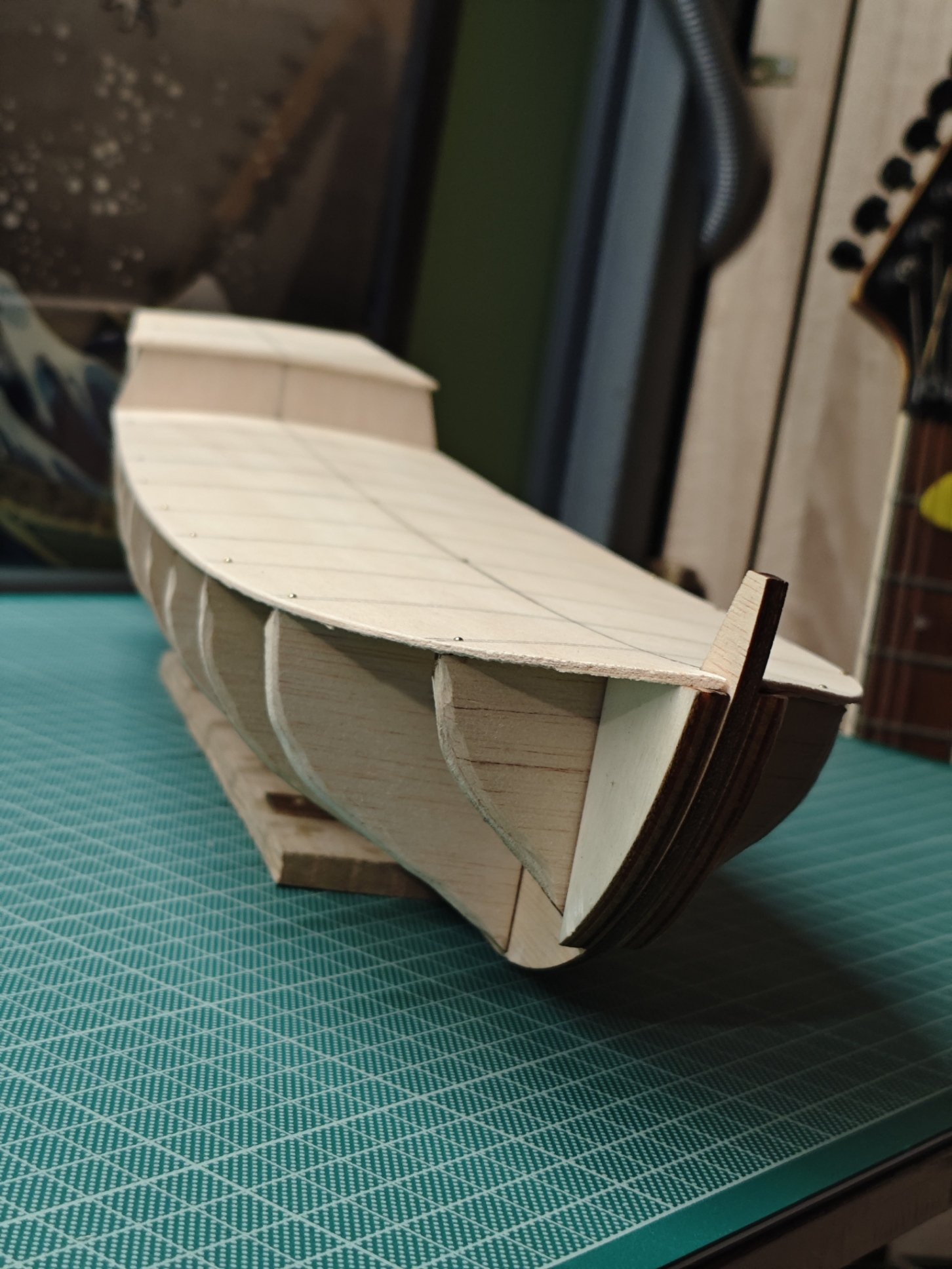

So.. right now i m in the part that scares me a bit. Planking the hull.
Today i put my very first planks
IMG_20251204_014325.thumb.jpg.799f127805f0b05376f212c43146da0b.jpgIMG_20251204_014453.thumb.jpg.e4bac0a69103db06e26f4dfae0e7e365.jpgIMG_20251204_181204.thumb.jpg.82bd85e14ad820c5f86ed401dc3ed778.jpg
I m now trying to figure out what i shall do with the planks on the stern.
I still dont understand where they should stop and and if i have to trim and smooth a bit more.
So back to searching...

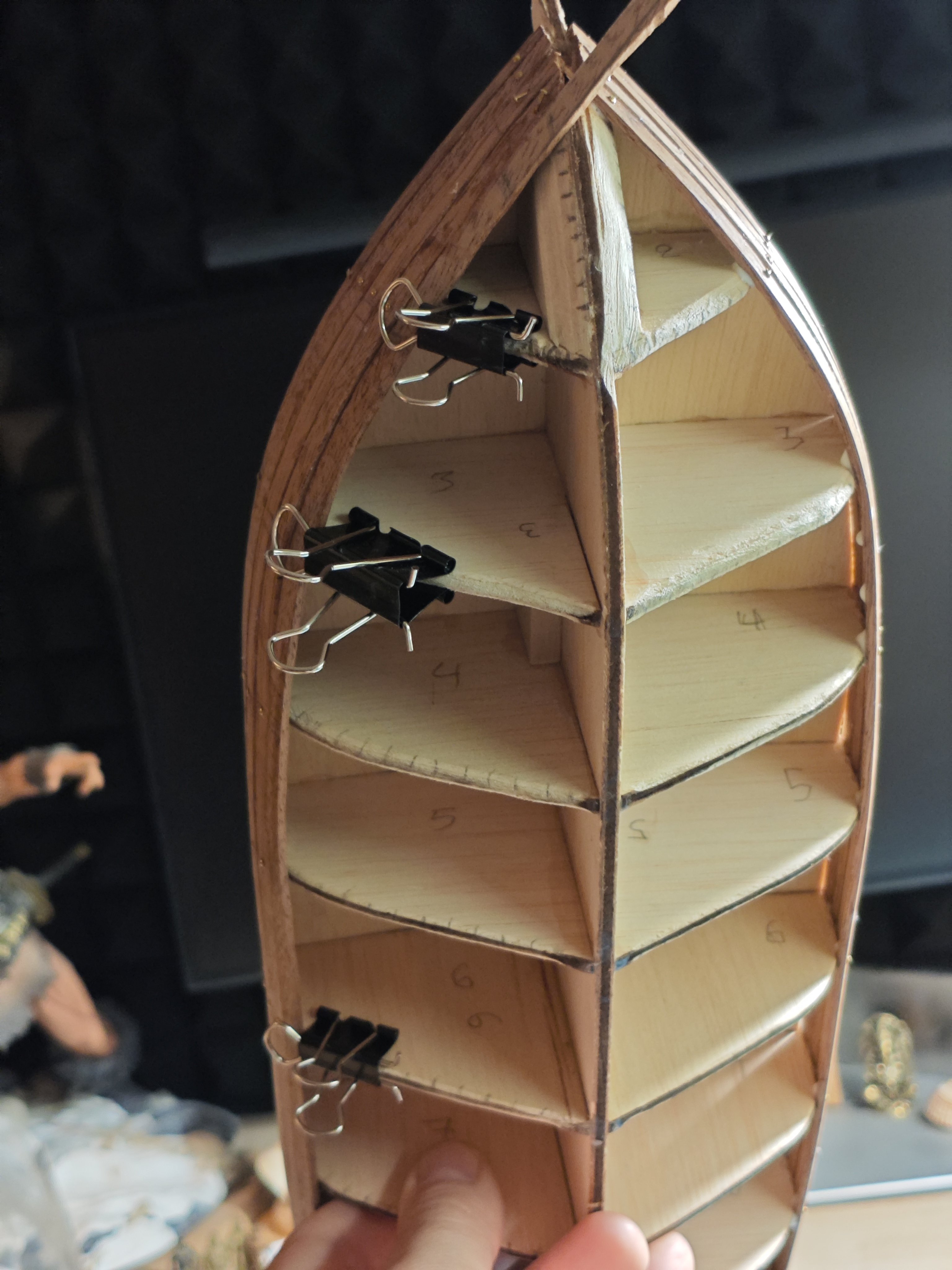

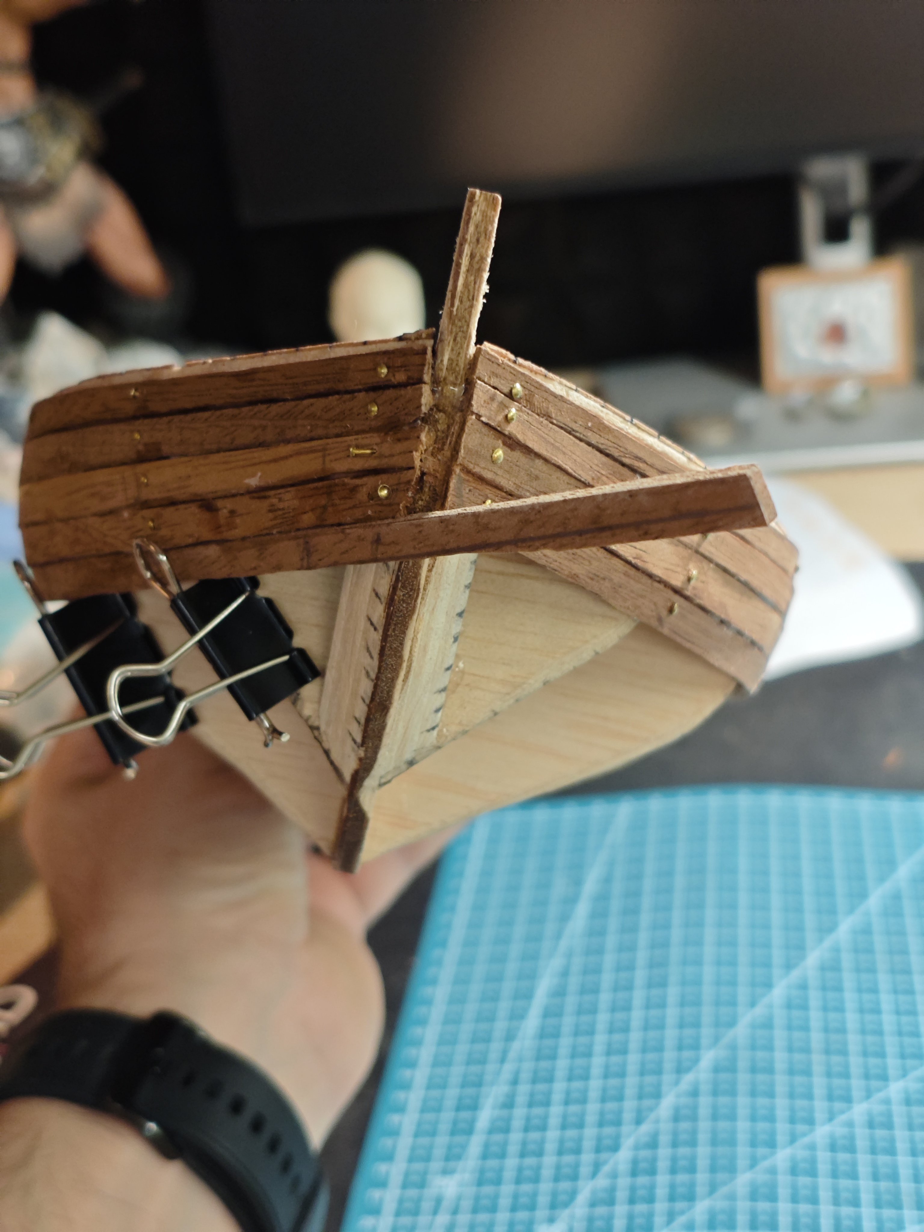

First planking is almost done

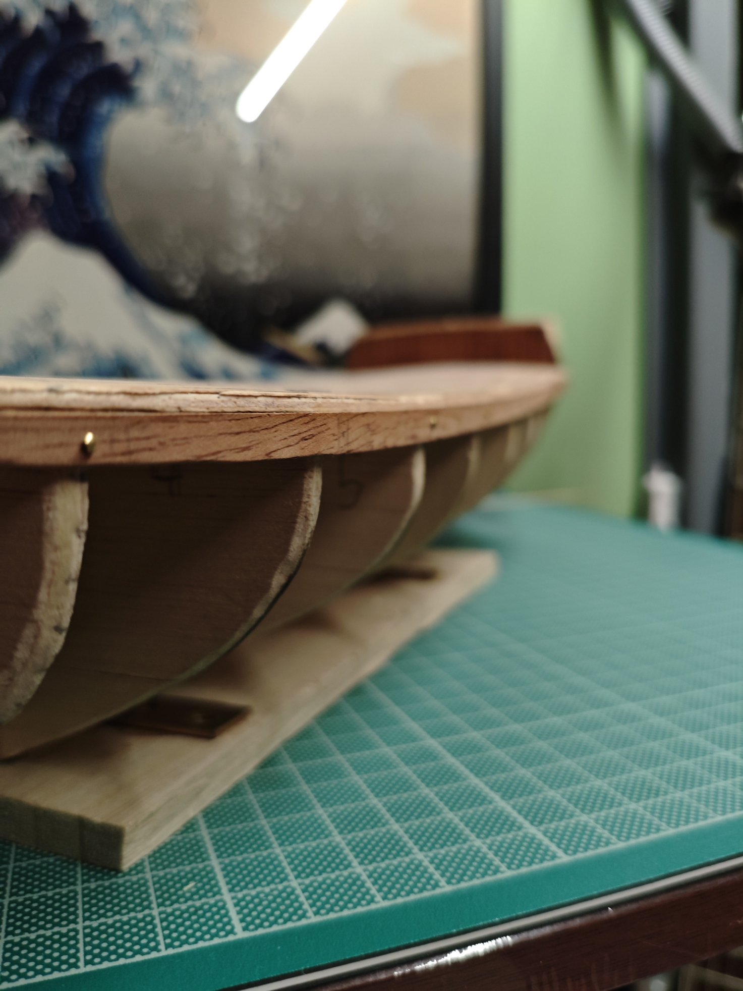

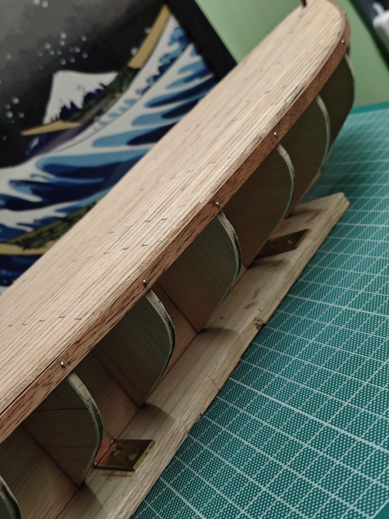

Then it was time, according to the instructions booklet, to add the waterways.
I ve used the board provided where the false deck was, to bend it exactly to the curve.
Making the plank wet, bending it on the board and letting it dry while secured, worked really well.
When it was totally dry, it was easy to glue
I ve marked and cut out the holes for the scuppers
 and continued adding the planks
This is where i am now

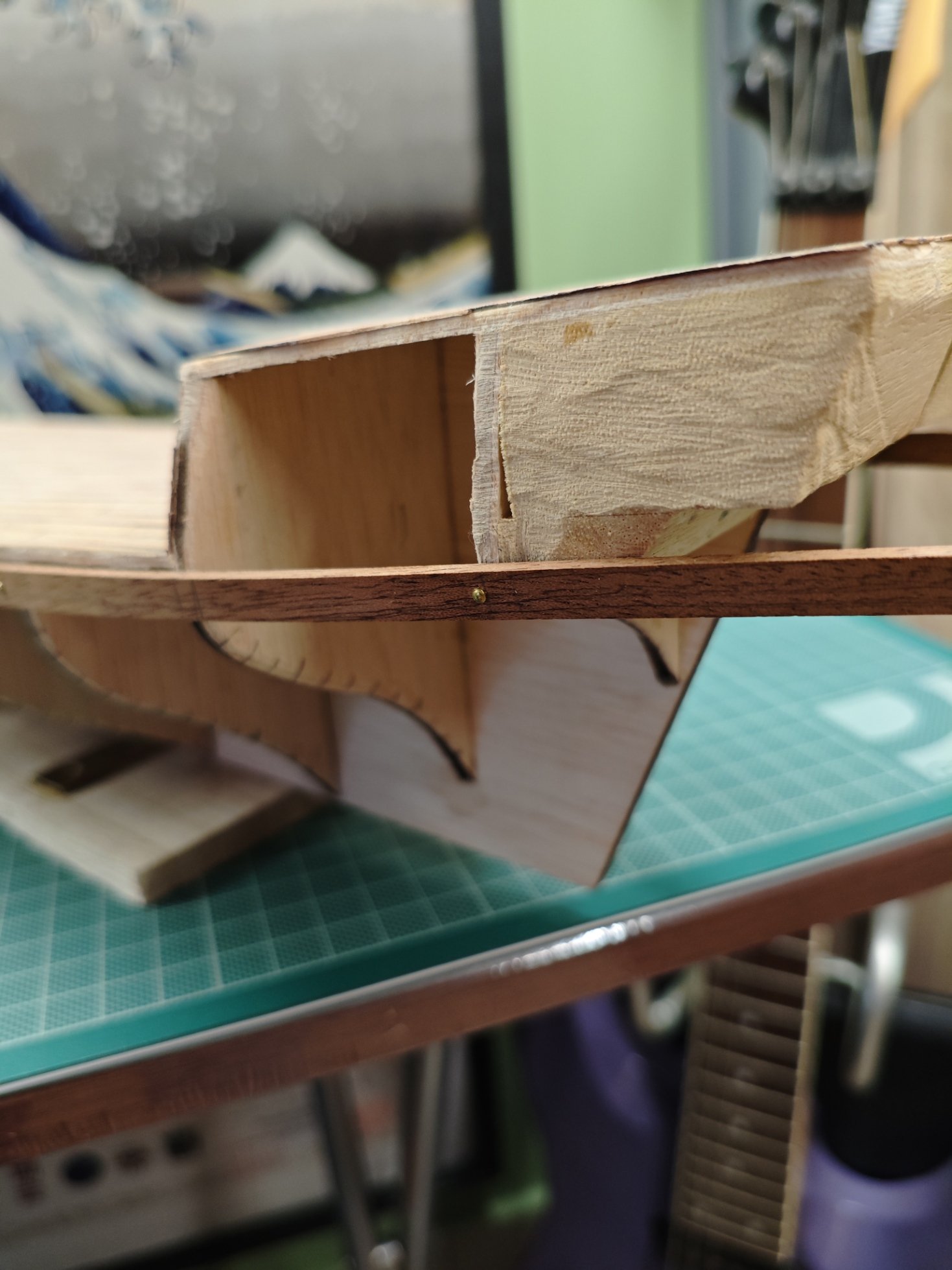

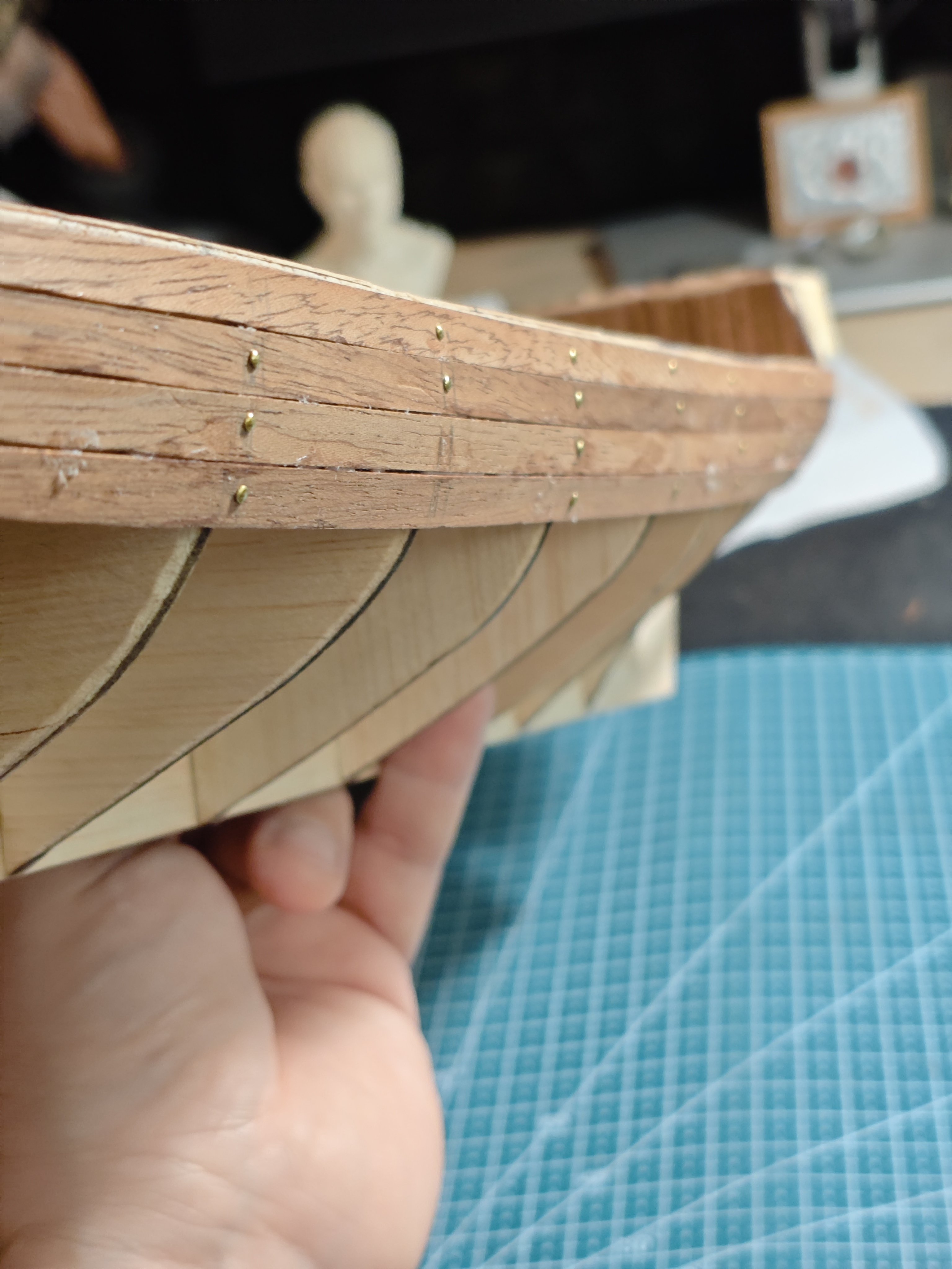

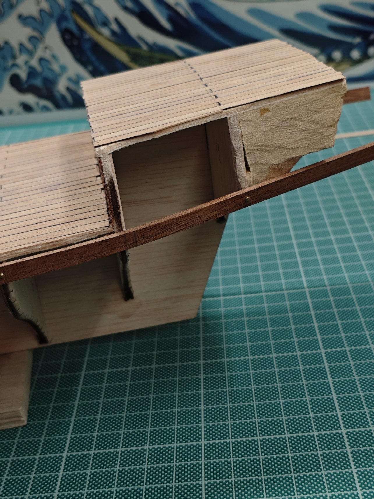

Hello again !
While i was planking, i knew i ll have a problem on the stern. So i cut the planks like this
All this time i was thinking to make a flat surface and plank it with the second layer palnks which are thinner.
and then add the sternpost
Is this a good idea or will make the hull look weird?
I m afraid that using a file wont round it enough to look descent.
Are there any other solutions which my inexperience make me not think?
So i decided to go for it and i think it will do the job if i plank and file it correctly
I added wood filler and started sanding it down
Wood filler is an amazing thing.
Couldn't believe how smooth the hull gets!
A bit more sanding and hopefully will be good for second planking.
I m not sure if i shall add the stem and sternpost before i start the second palnking.
Will it be better to add them after the planking, so that i can maybe hide some mistakes?
