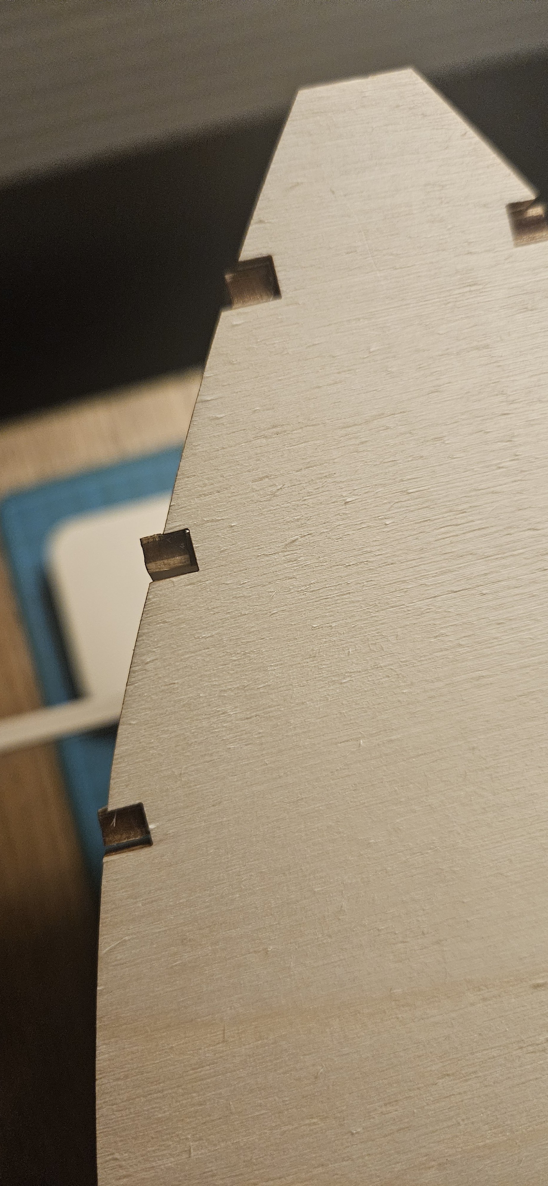

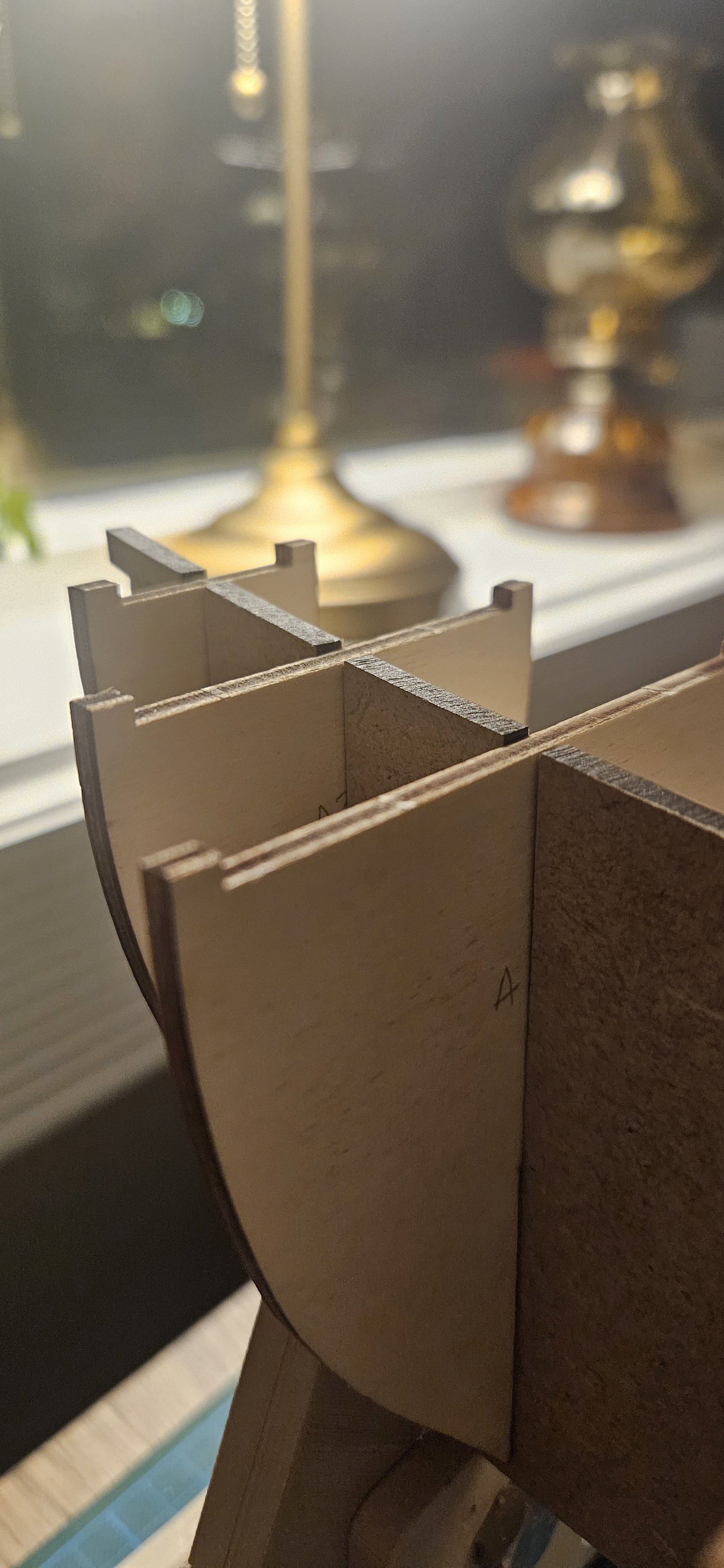

The second part of the false deck fits perfectly. The main part has two or three big misfits, and I cannot figure out what the issue was. It seems to be at a completely wrong angle and is not flush. It seems to be the same on both sides! The deck is flush on the keel, so the bulkheads seem too low? When I glued them, they looked to be at a right angle. I checked a few times, but I might not have been exact enough.

My question is: how bad is this? Can I still fix it? Worth it to (try) unglue? Or just sand it down?
Any feedback appreciated.20260128_204649.thumb.jpg.94c37e1906dc017bcf476e857dbf0951.jpg

If the bulkheads are square, I wouldn't worry about it.  The backbone being higher in front of the bulkheads  is because of the slope of the deck.  I would sand them down to  accommodate the slope.
Yes, I could not figure if i was meant to do more for the slope or not.
Will fit with the deck again and sand down where there is bad overlap only on the bulkheads.
