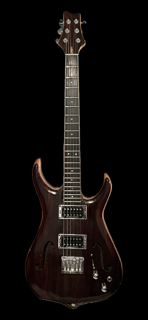

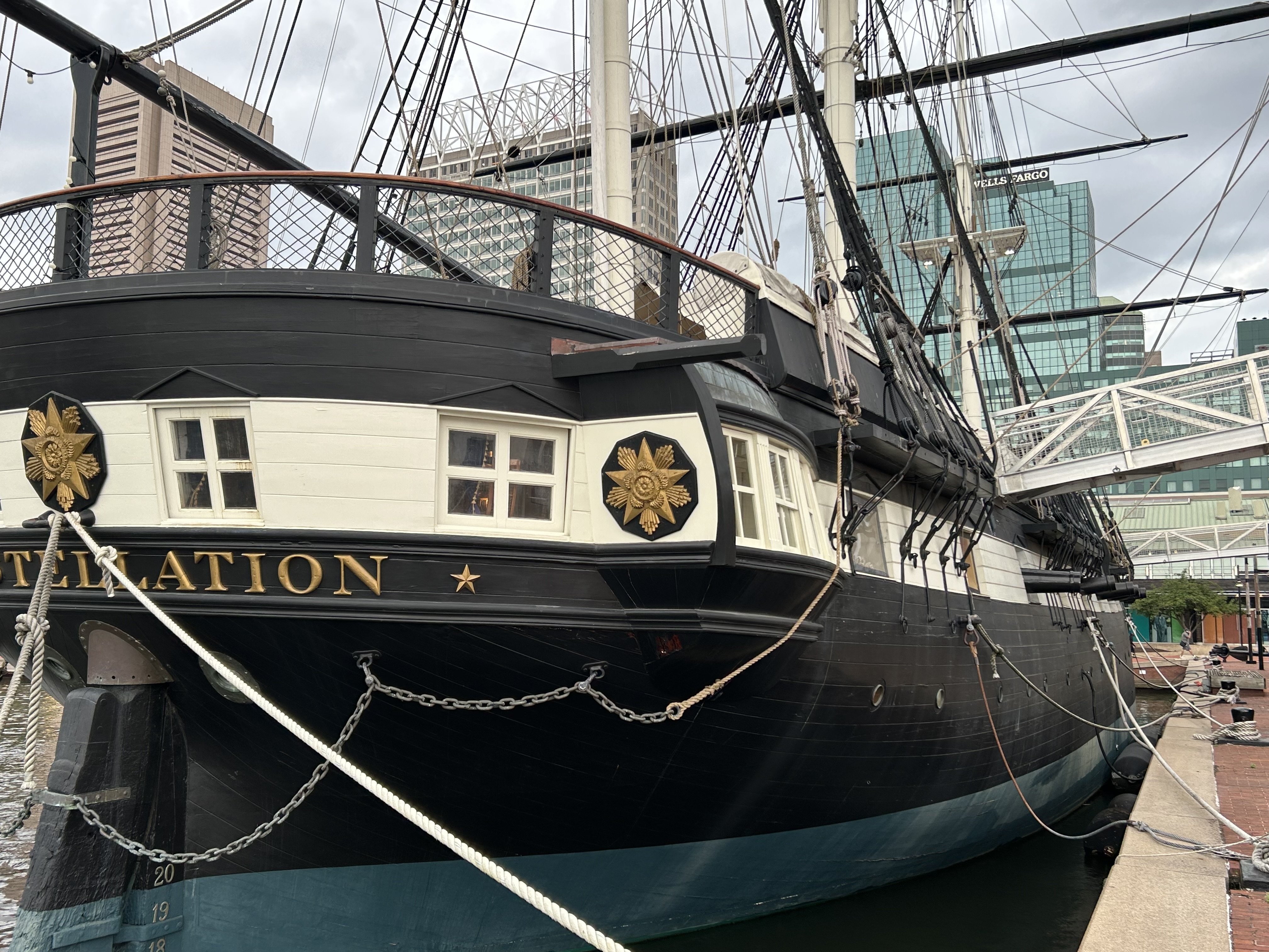

  1. Well, finished my guitar!! From scratch!! I was able to get downtown and get some pics of the “Constellation” Here you go!!

  3. So, I’ve been gone a while. Between Covid and my schedule- my ship has been docked for a while.. I completed a lot of the deck furniture.(nothing to hard) I’ve begun the mast. Pics / details soon to come. I did a side project during Covid quarantine building the body of a electric guitar from scratch. a sandwich of: coco bola hard maple Purple Heart maple hard maple w Schaller hardware.

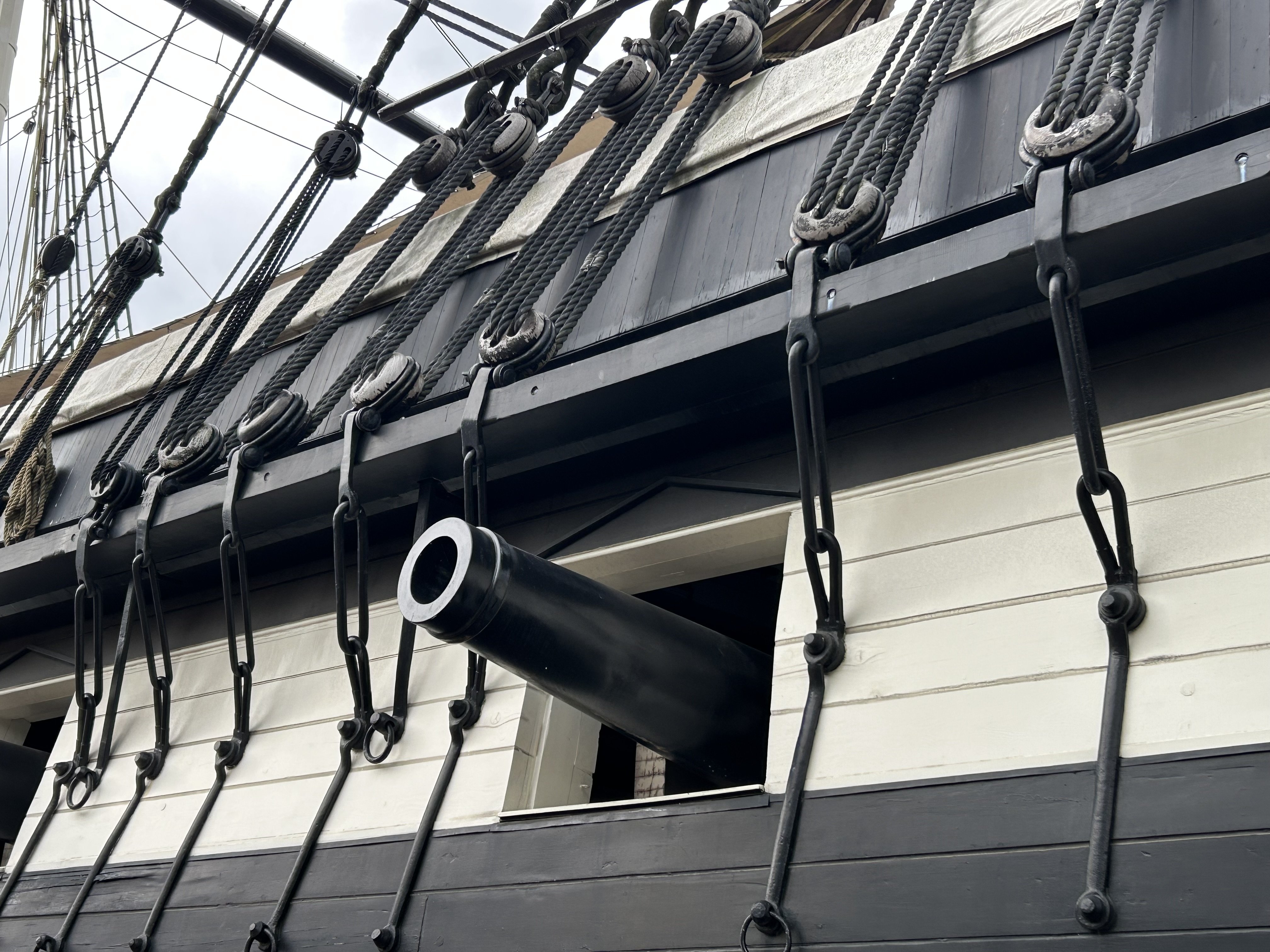

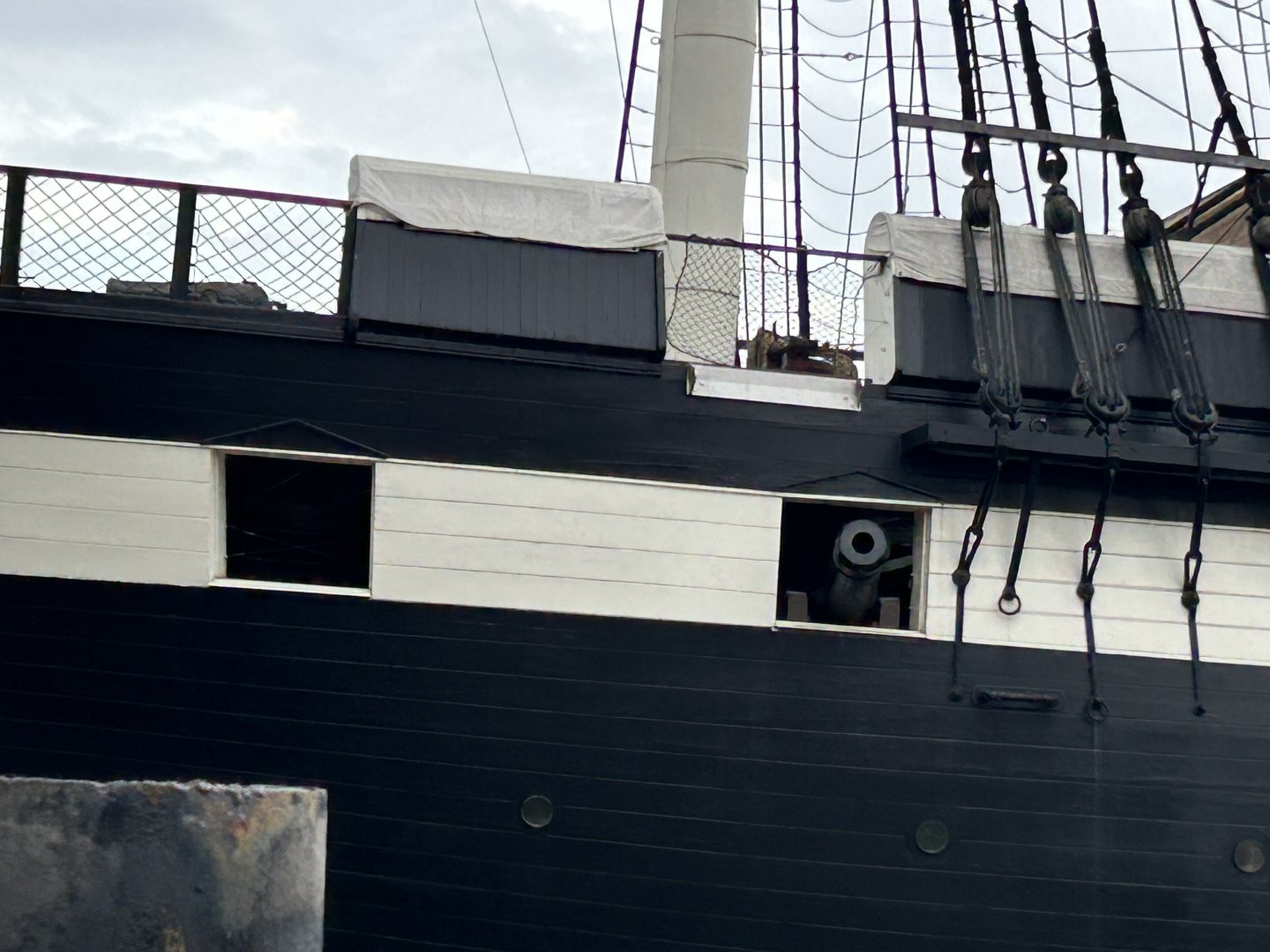

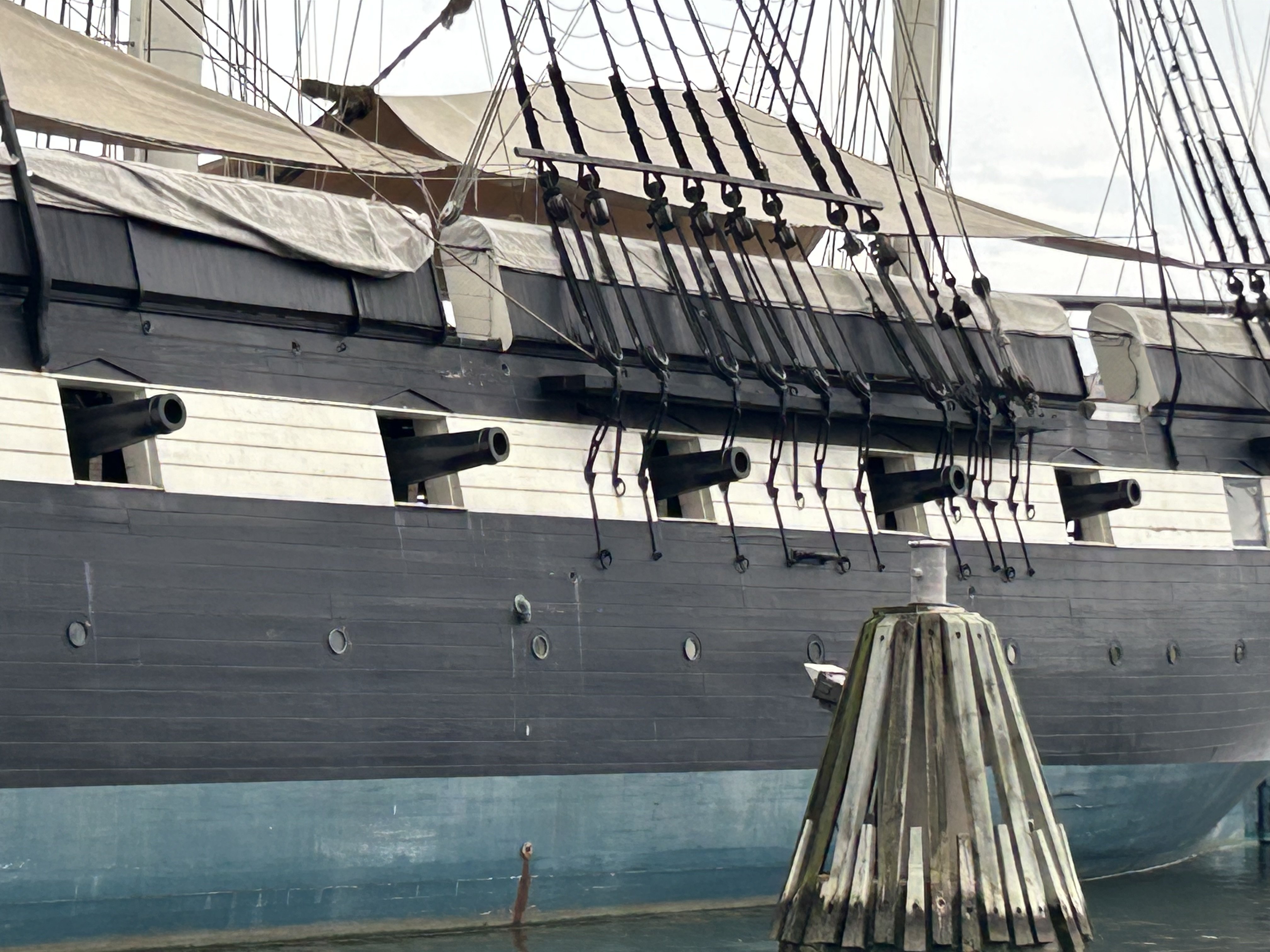

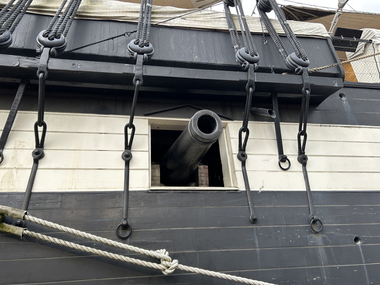

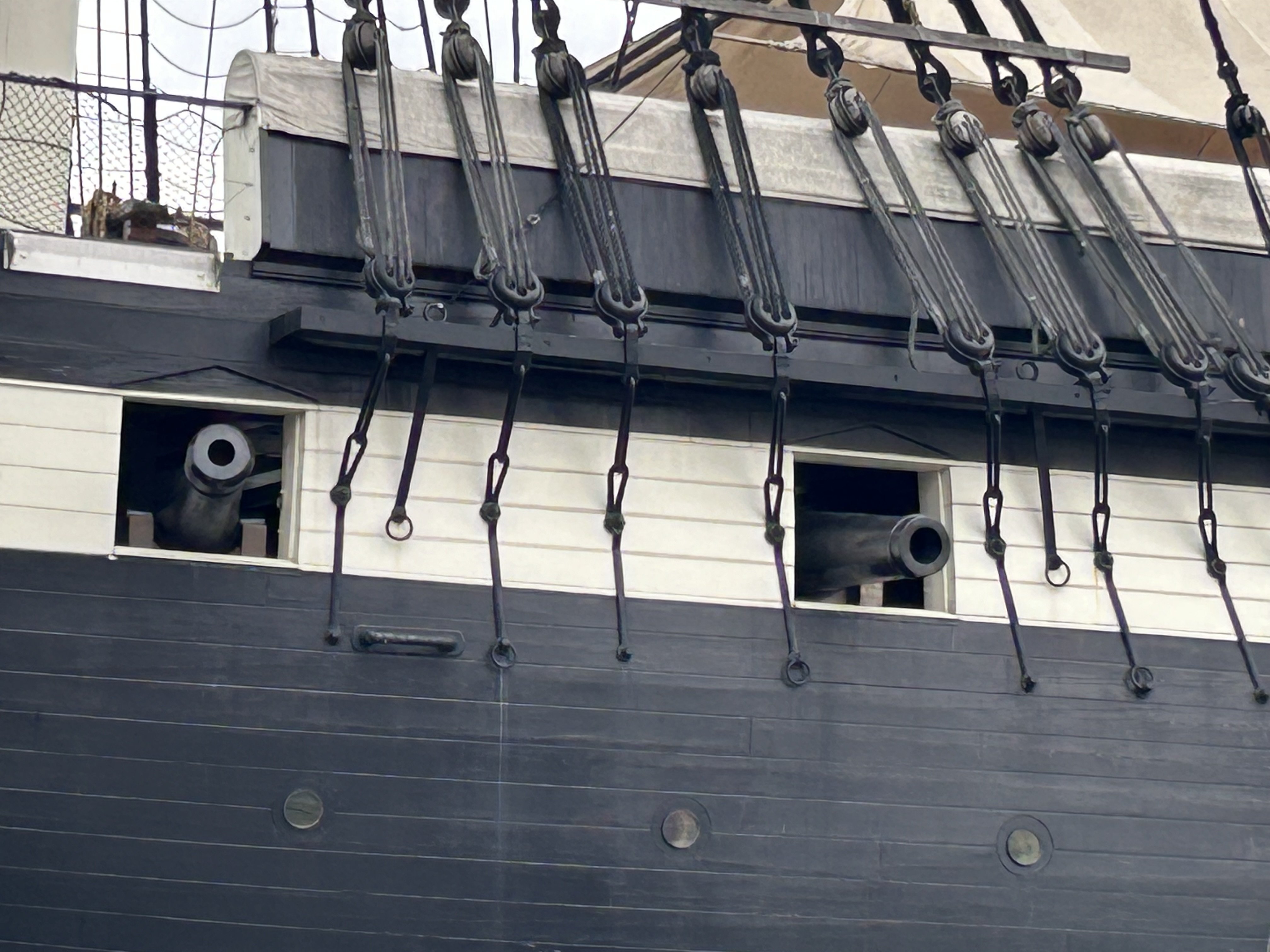

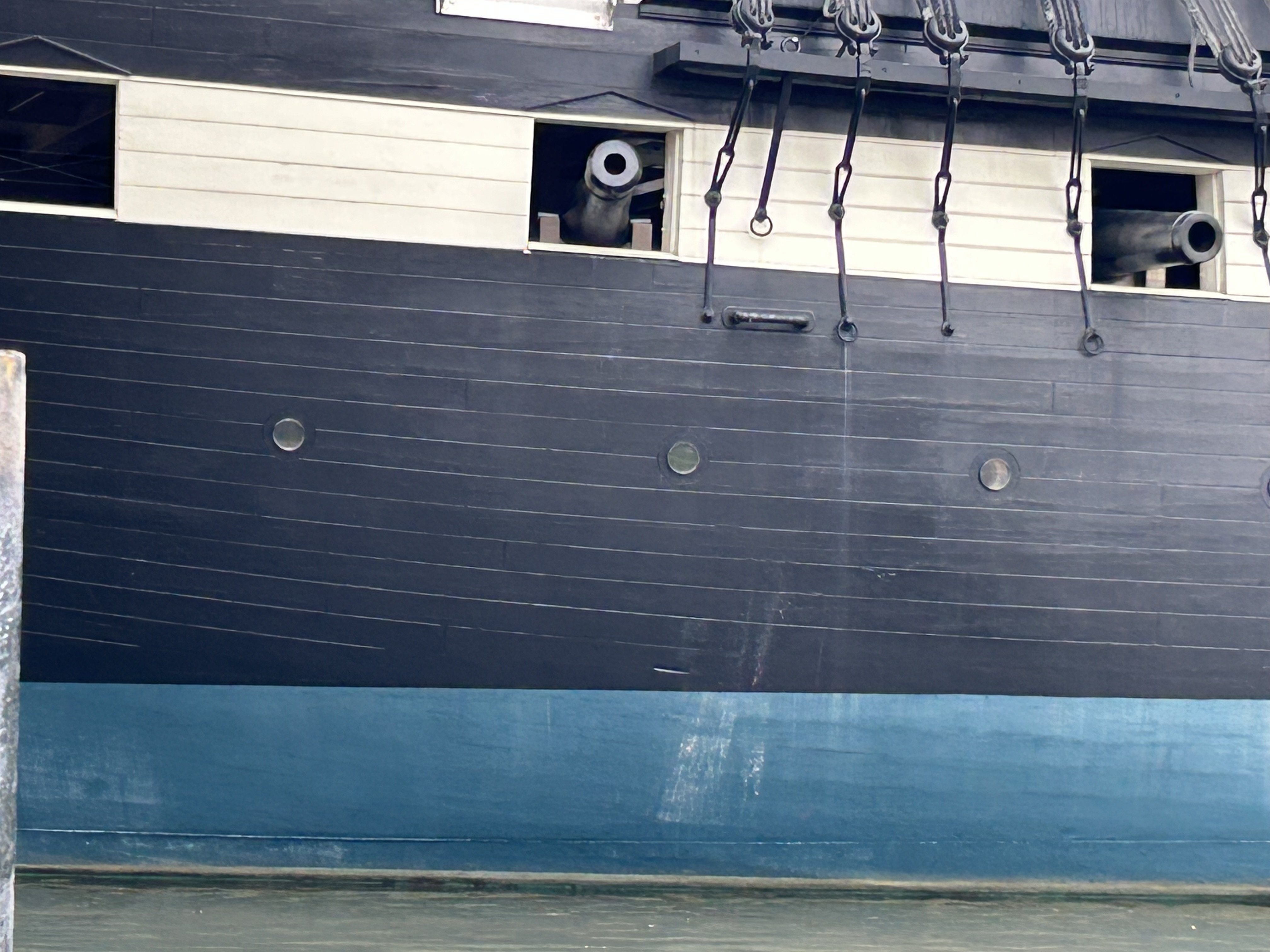

  4. Rigging the cannons I decided to loop the rope around the inner rigging. Most of the pictures I’ve seen of the ship use this method.. I’ve deviantex from blocks w 2 holes to blocks w one, on the inner rigging. Most of the pictures I’ve seen, the blocks are covered w rope anyway.
  5. I decided to use 34 awg copper wire that’s coated black- and make the cannon rigging hooks.
  6. The third pic above (white styrene) attach between the cannons- and rigging hooks are attached- I used styrene- drilled tiny holes- files edges- and squeezed the center w a small “rounded” pair of needle nose pliers to simulate the roundness of the actual rigging.

  8. Hello, I’m building a Conny and Hunt’s practicum calls for “floquil rust” paint for the steering wheel. Does anyone know a good replacement since this paint has been “discontinued?”( I think- from my online shopping research) Thx

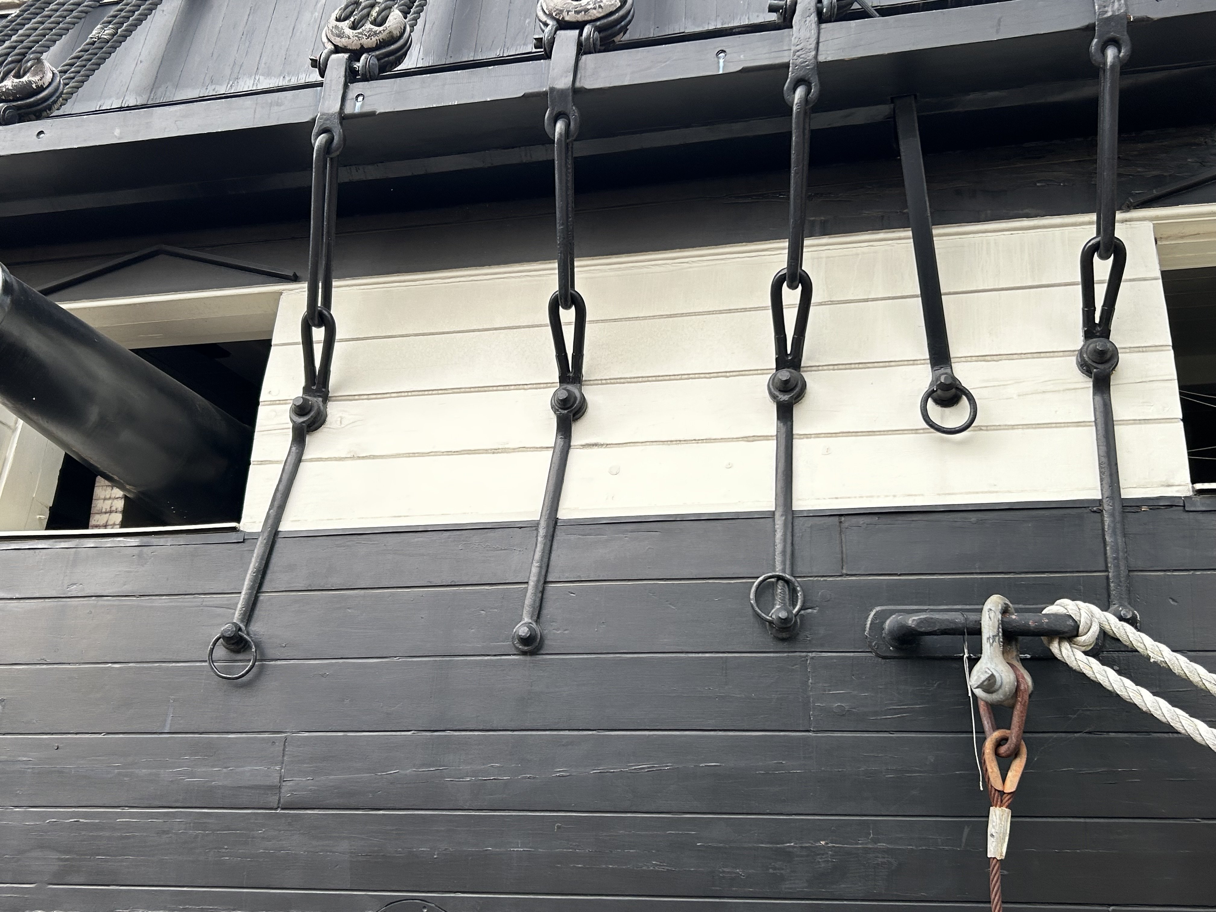

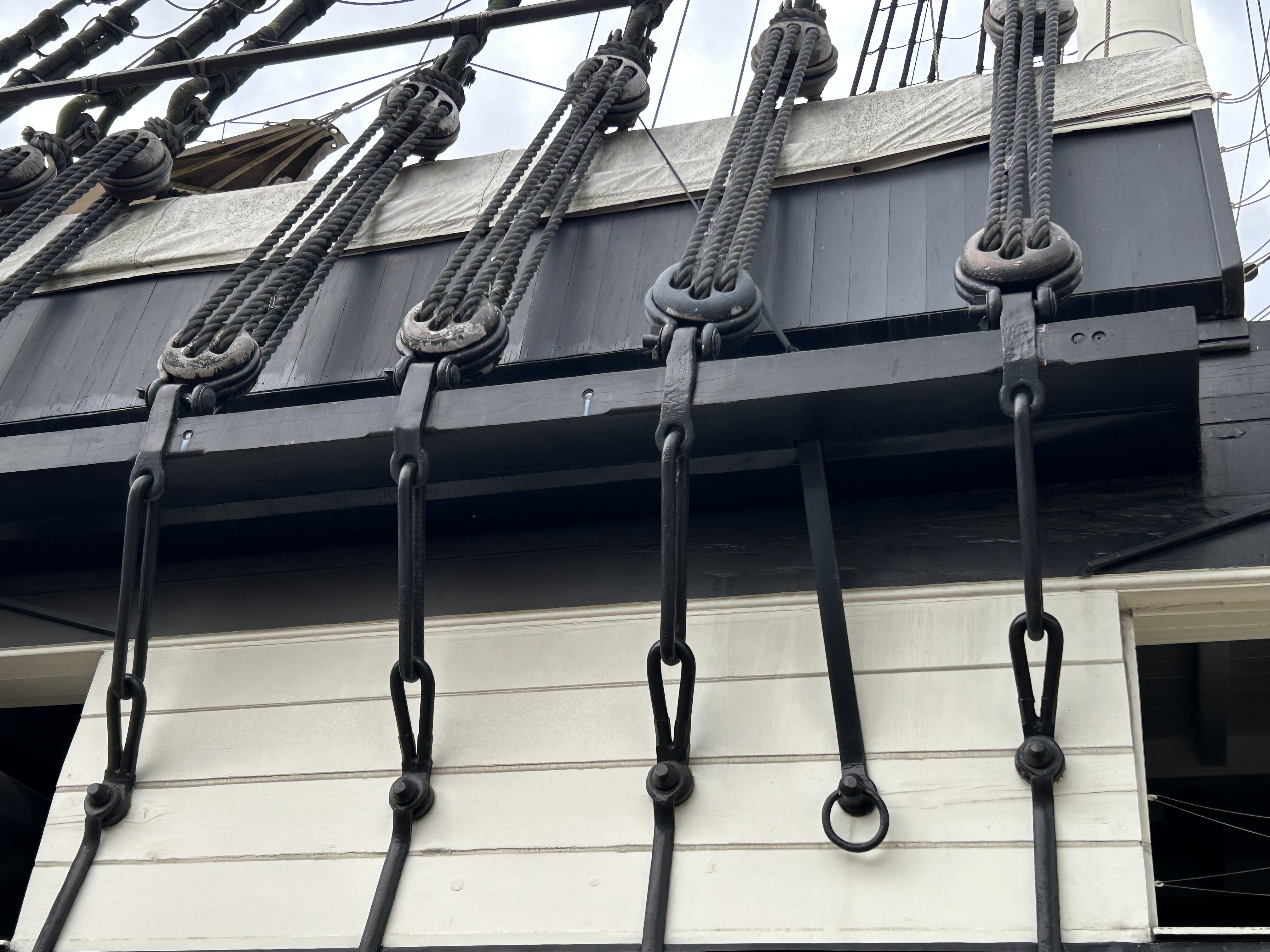

  9. Ok, so I built deck cannons- not much to them, just glue and paint. I painted the wheels before attaching to the base- and touched up the cannons after they were glued up. The little handles required a pin vice bit. Then started on the dead eyes/chain plates. A little tricky- I used a 3-way alligator clip holder for the soldering of the wire twisted around the dead eye to the chain plate. I had to paint them twice because the paint didn't bond to the brass right away. I haven't decided how I'm going to go about attaching the bottom of the chain plate to the ship. I'm going to look at some other build logs before deciding if I'm sticking to Hunt's plans or deviating a bit. Any suggestions are welcome. Thx
