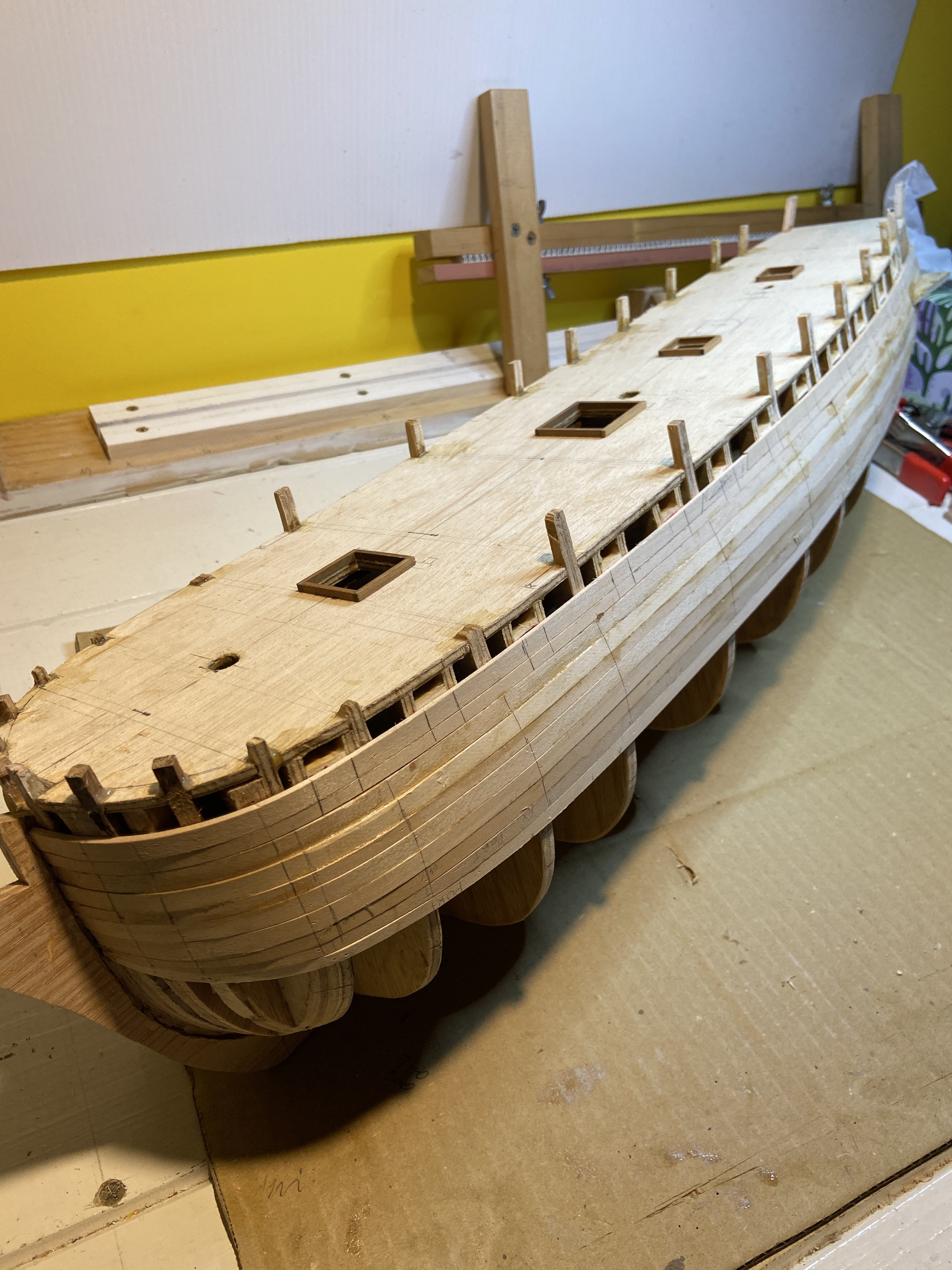

  2. Back in the Shipyard 06 October 2025. I cannot believe nearly a month has gone since the last post. Been a few things going on, slow progress. Bit of a catchup post below. The Sirius has been flipped/mounted on a new base for the 2nd layer of planking. There are 25 - 5mm wide planks from the Wales to Keel. So some need to disappear, "dropped" 8 Planks have been run into the Bluff Bow of the Sirius. 3 to the Stern to date. I'm using a Cada 4 - 3 planks between joints, staggered planking pattern, planks join every 4th frame(max. ~ 9.7 feet long). Some join over 8 frames for convenience of the build. I groove every 4th joint though. The shaping of each plank takes time to get them to lay as flat as possible. Especially around the Bluff Bow. The planks ending at bow are "hooked" to allow the plank behind to end at a half width. Well that's what I'm aiming for. Where talking in mm at the plank ends. At the moment I'm getting away with pre-bending the plank ends and pinning the open plank edge to hold the planks whilst the glue dries. A light sand and will/should result in a smooth finish. The Garboard plank is glued in place. If you look closely a Half Stealer was added in to the keel rabbit for the Garboard to lay naturally. Just to the left of the Red Pins, you'll see the first 2 dropped planks. They'll be another 2 planks dropped in the next set of 4 planks. A keen eye may see the gap above the Wales on the left. I need to cut a filler plank in "one day". A few of the first planks have been pulled around to the Transom. The 1mm Beech planks bent very well in this area. A timber strip to be added at the intersection when all planks on. Wales need to be finished off. Wel, the planking is not being rushed. A few o/s holidays coming up before Xmas.

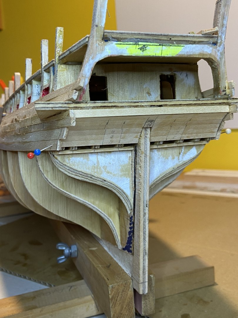

  3. Back in the Shipyard 10 September 2025. Since the last update, the Bow Gun Whales have appeared. With the aid of 3mm balsa as a filler, this provided plenty of support for the run of the inner planks. The Gun Wale was cut from 6 pieces of Rosewood, and used what I call a "scarf joint"(is that correct) on the side joins. The picture shows the finished product.

  8. More progress from the Shipyard - Thursday 7th August 2025. A bit of a push over last week to get all the 1st layer planks onto the hull has been reached. I spent a few hours fairing(sanding) the planks today. I did carry the upper planks too far down the side. However, for the first layer it's been a good refresher on planking before the 2nd layer of planks. I'm pretty happy with the outcome so far. Port Bow Port Stern_Side Port Stern Starboard Bow Starboard Stern_Side Starboard side I'll be marking out the Wales & thickstuff's, Sheer Strake, and the Channels next

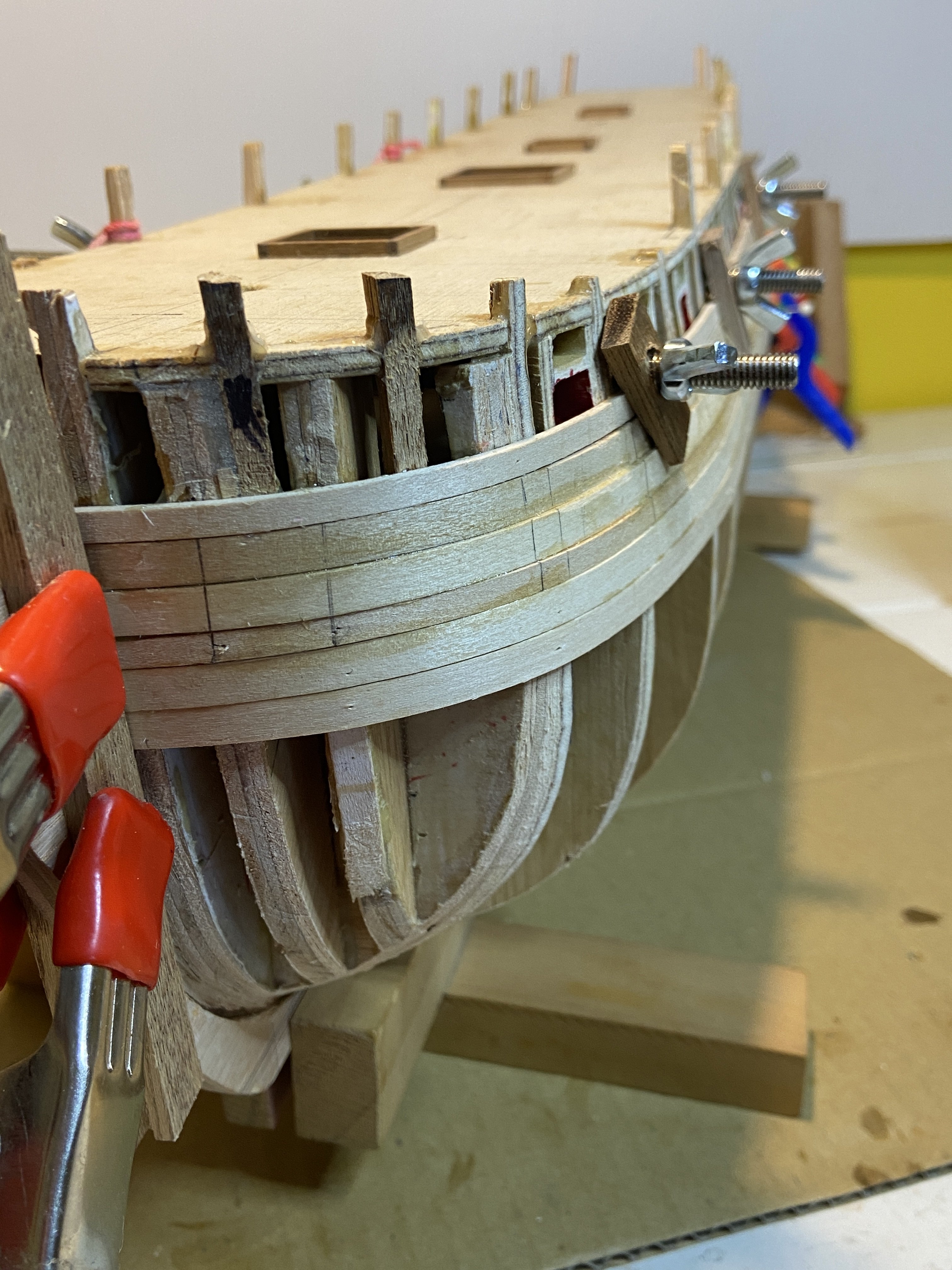

  11. More progress from the Shipyard. Slow progress on the 1st layer planking. Another 3 planks added from the keel. All 6mm wide. The first 4mm wide plank of 12 has been added, where they go over the curve section of the frame. As I had not kept the garboard plank shorter, the rest have swung further down. But being 1st planks, I have learn't.

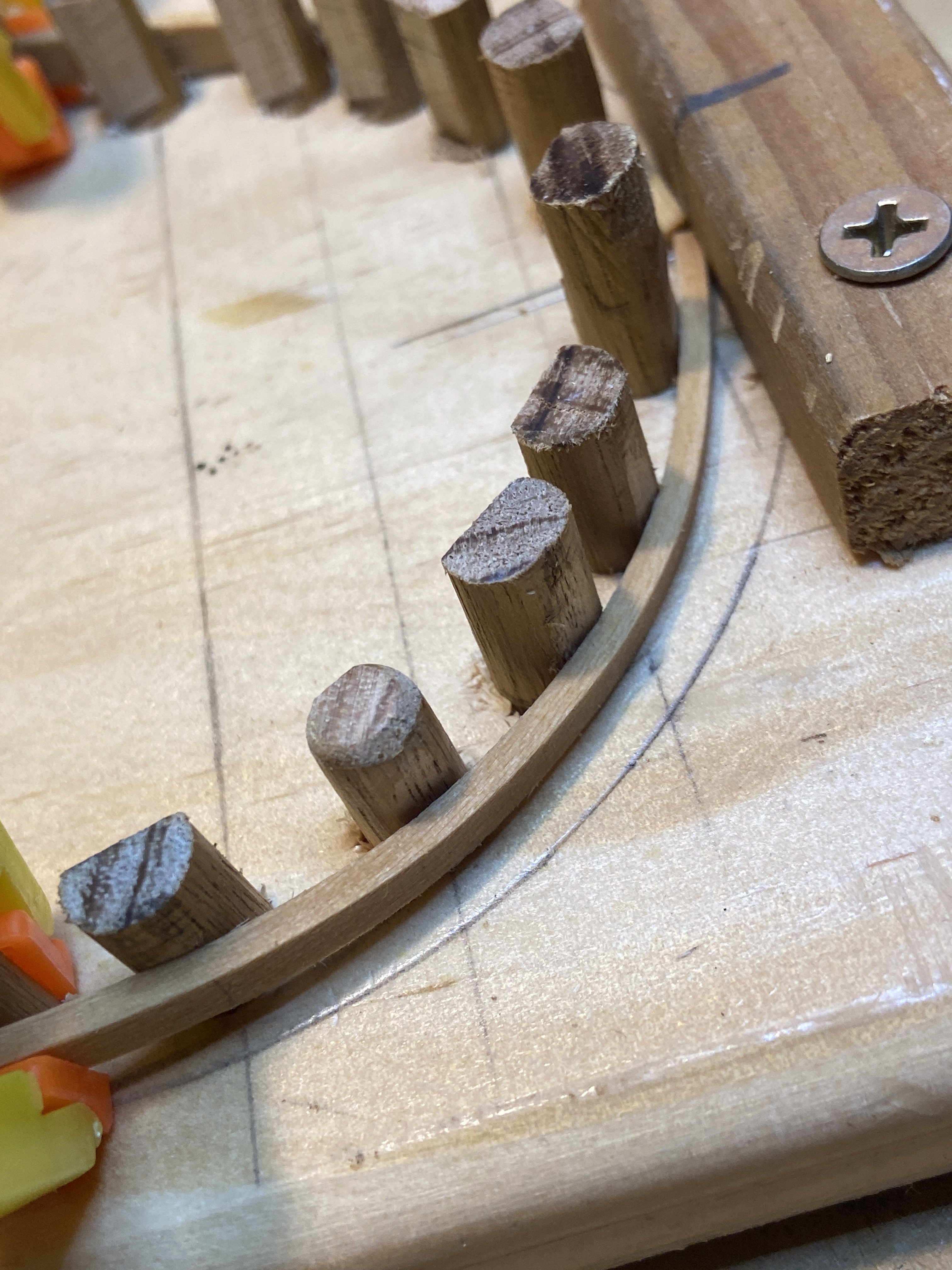

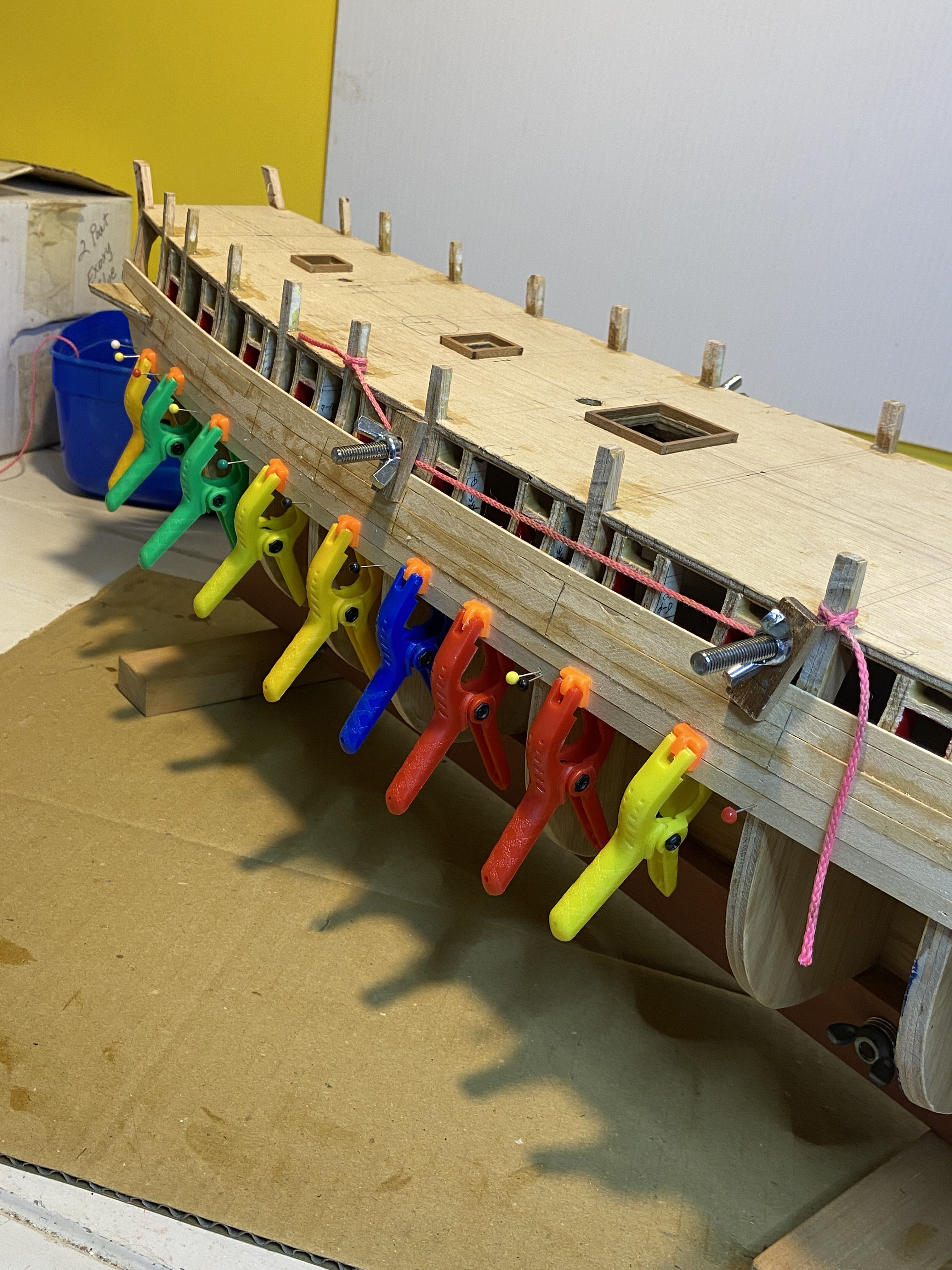

  13. More progress from the Shipyard. Since last post, more first layer planks have been added to the hull. And some 3D items in the pipeline. I've made a start on a few planks against the keel. Also marked out the lines for the tapering of the planks(in groups of 6) I'm using 6mm and 4mm wide planks. 4mm where the hull curves most, 6mm on the straighter sections. I usually pin each plank onto a frame and use plastic clamps, in hope to get the planks butted up neatly. This doesn't always work, especially where planks are curving a lot. Sandpaper time then... Here we are transitioning from a run of 6mm to start of 4mm planks - stern port side. Here we are transitioning from 4mm into 6mm planks - stern starboard side. The next few pictures are some works in progress on creating 3D Models and Resin Printing. I'm hopeful that with the right details and finishes, they will look presentable installed on the ship. Also been testing some paint on the 18 pound Carronade Cannon Base. Come up pretty good I reckon. Bit more touch up to do underneath(for the beady eyed) Same for the 18 pound Carronade Barrels. And the 6 pound Cannon barrels. Have also developed a 3D Model for a Capstan to print & paint. And before someone asks, it does not turn - yet !! See how it turns out. Well, always more planking to get on with. Dabble with 3D development whilst glue dries.

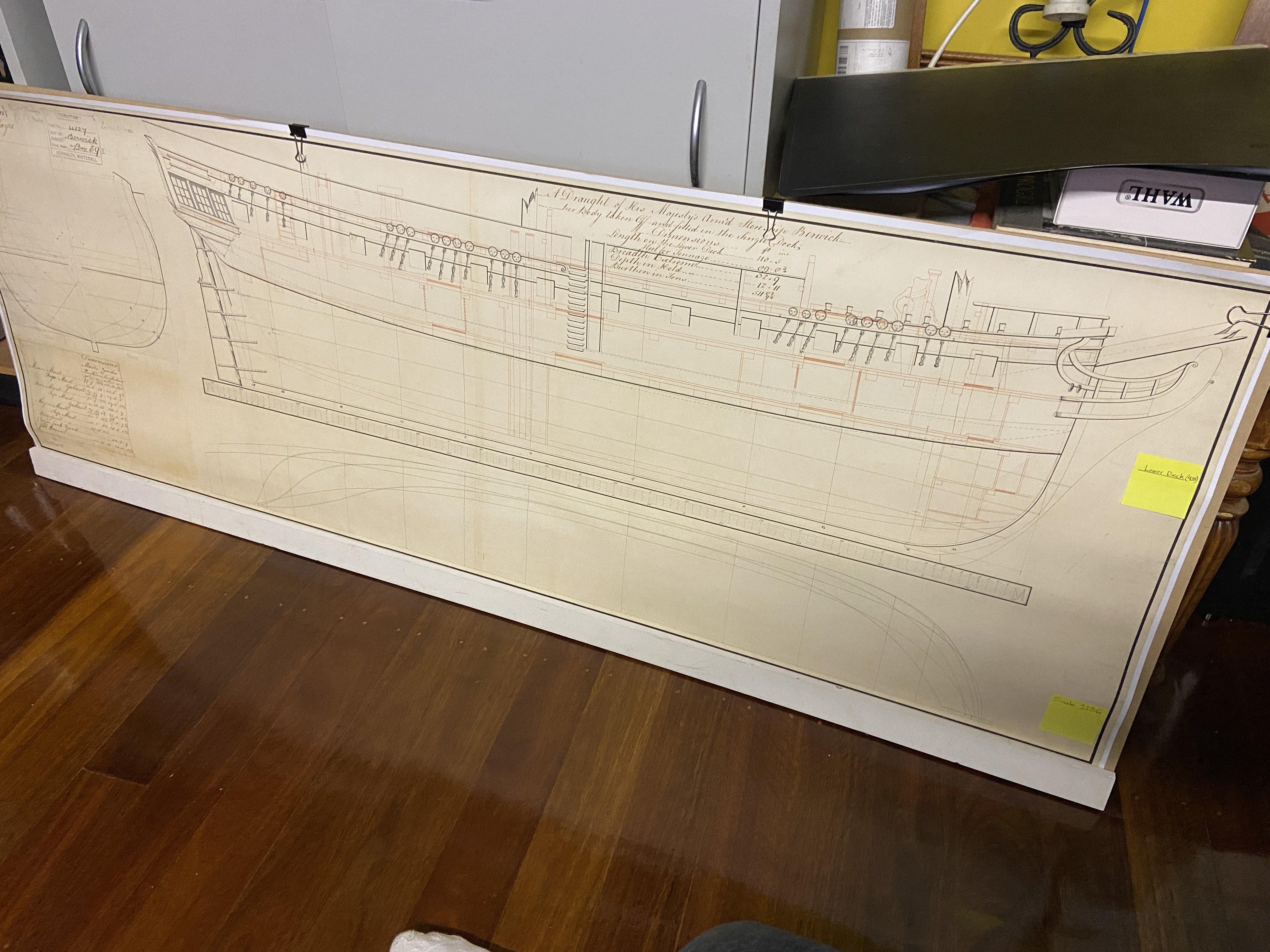

  17. A quick Photo. I do believe I have neglected to show the plan I purchased of the "Berwick (1781) - Technical Drawing" ZAZ5405 held at the Royal Museums Greenwich. The plan does show good detail of the hull's starboard side, the upper & mid decks, along with the half frames(to the left), and hull lines at the bottom. No detail of the Taffrail, gun openings, though just the top edge. More than adequate to get the hull into shape.
  18. Back in the Shipyard after a cold snap has started in Brisbane. I have continued to add on more of the first plank layer. Progress slow, having to pre-bend the "bluff" bow planks, and run then down to side to the stern. I'm adding 4mm wide planks where the frames curve, wider 6mm planks on the flat'ish areas. The Bluff Bow. Brings back memories of when I did the same on the Endeavour many moons ago. Cannot have enough of these little clamps. I use them to hopefully pinch the planks together, ending up with a smooth joint. If not, some sanding work to do later. The Transon planked. I made this little Jig to shape/bend the planks after soaking in hot water, gently bending each around the posts. Fast forward after a few more planks have been added. Not all the planks worked out(bend well) on the bow. Not enough fairing on the frame edges. I'll try better on the next run moving towards the keel. I/m not going to hide and errors on this build. Nothing a bit of sanding will fix. May cut the gun/port holes that have been covered over next. Bit of a break from planking

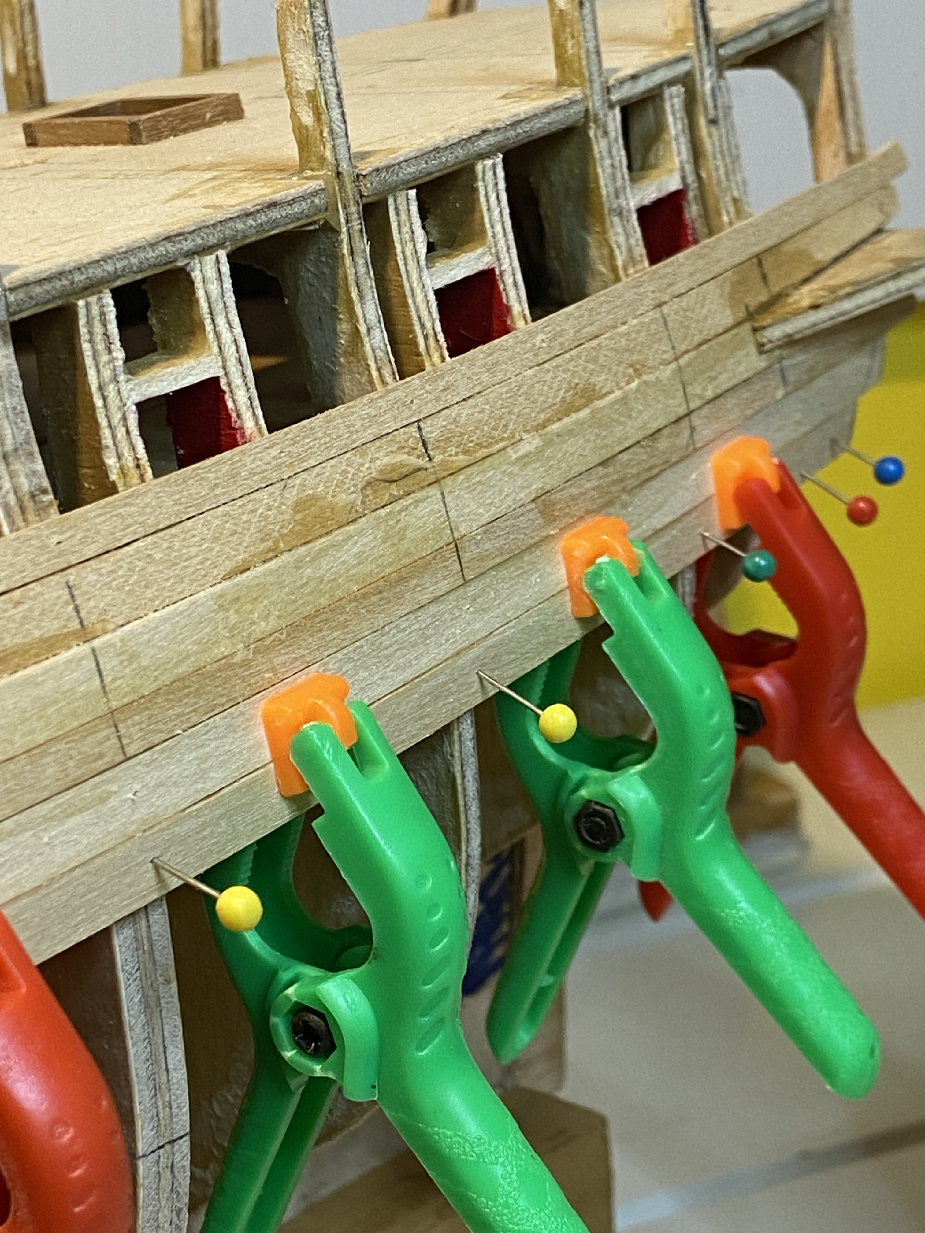

  20. My shipyard had been shut down for a few weeks, whilst I was on holidays. Not a lot of progress, just a few 1st layer planks to either side of the hull. The first plank I added was just below the gun ports, aligning the top of the plank level with the bottom of the gun port. I made up some rods & wingnuts, with a tapered wedge to pull the plank in to get full contact to shape of the frame. Well that was/is the aim. Close up of the rod/nuts & wedges, packers, whatever I could lay my hands on to pull the plank flush to the frame/s. 2 planks per side now on. This is going to take some time..................
