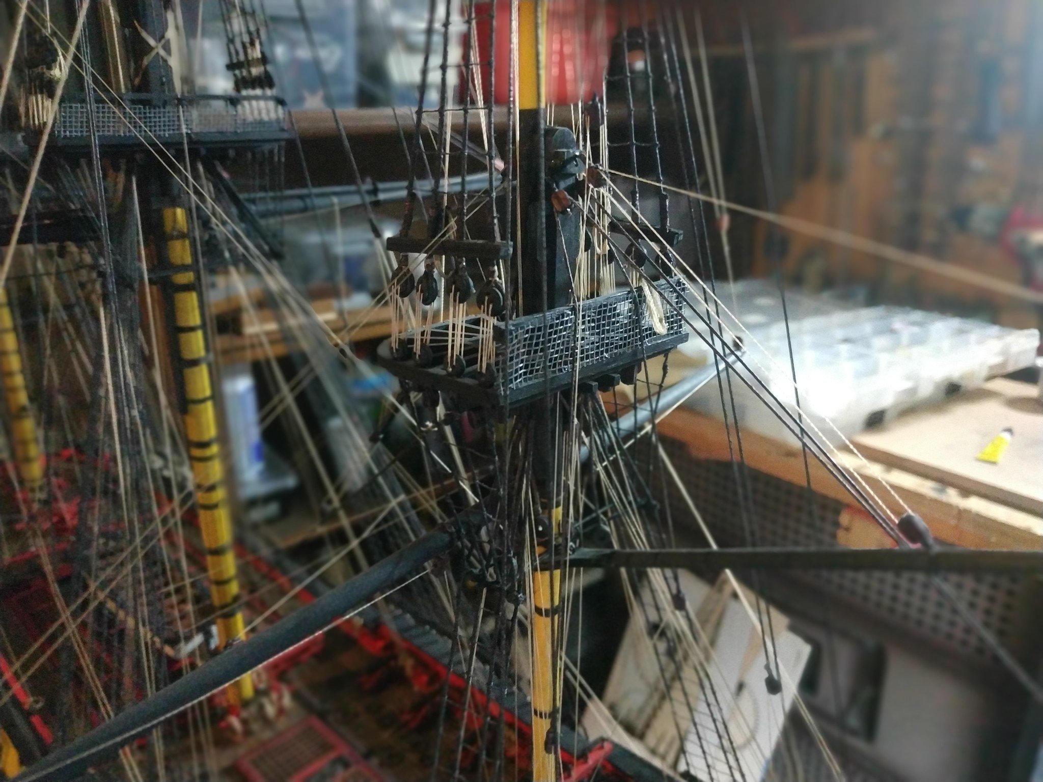

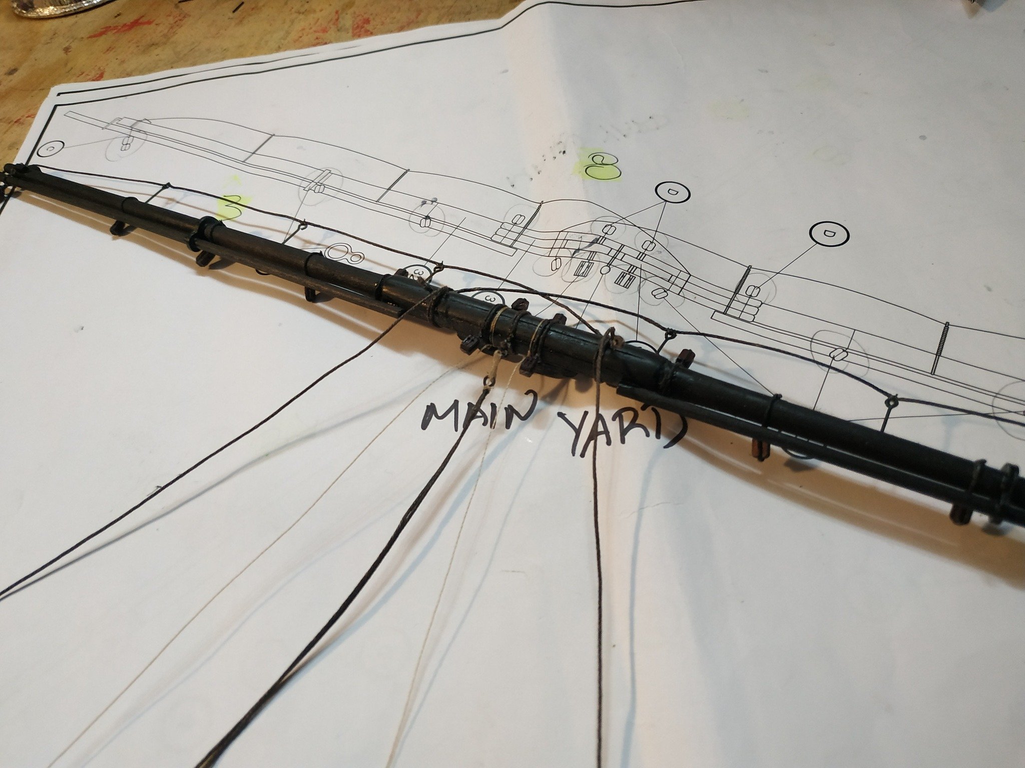

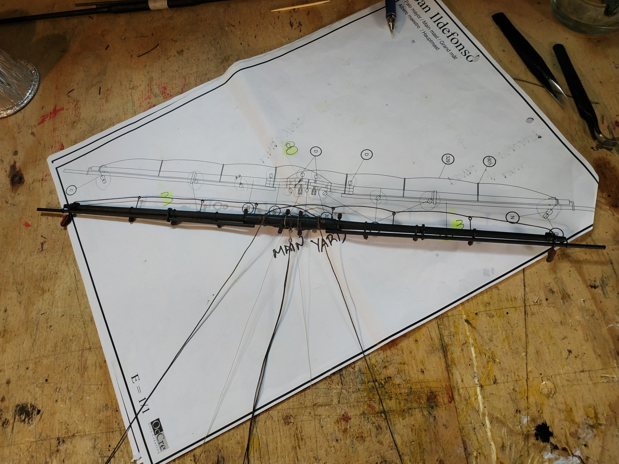

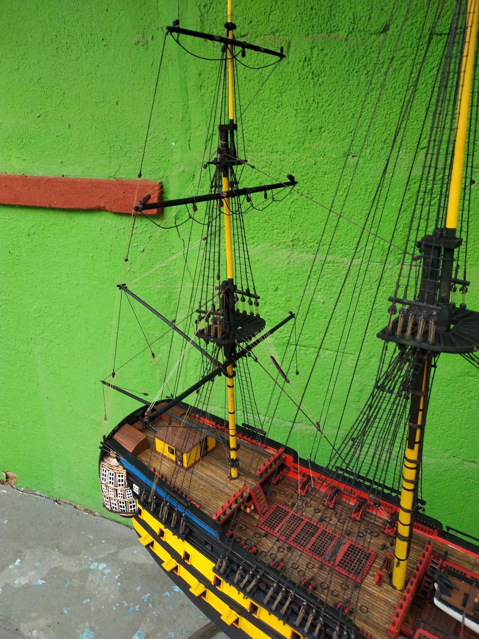

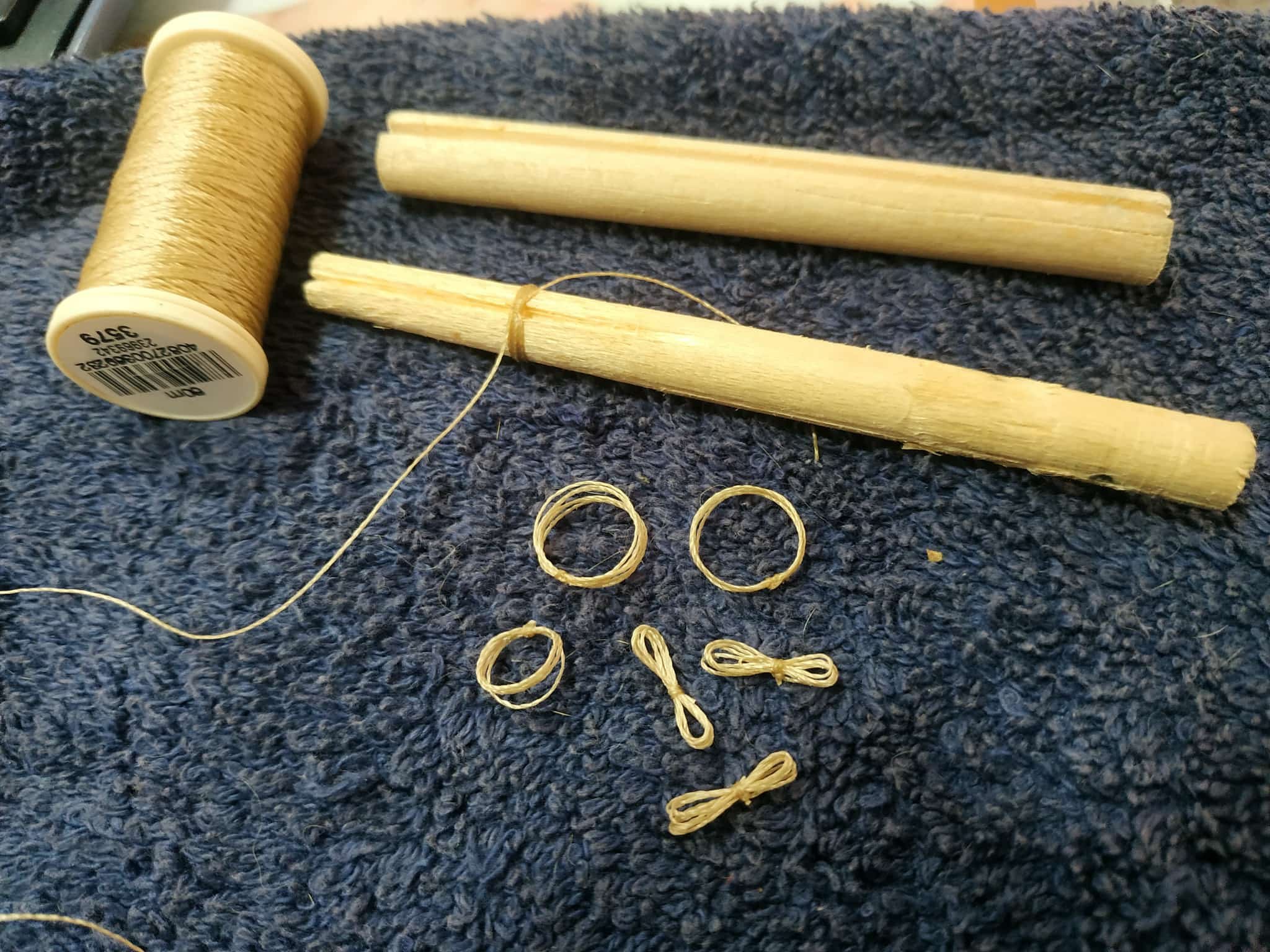

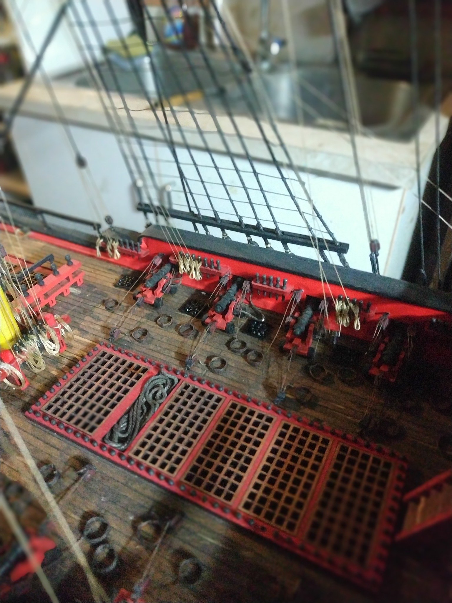

  1. well guys. Here we are again after some years i decided to finish the model. Lots of parts are missing cause i had to move two times to new house. i had to organize to order some new lumber and rigging parts, i also laser cutted some parts my self. I modified the model according to Lenarth Peterson book ''Rigging Period ship models'' i'm in the phase of completion of the standing rigging so i am working on building the yards. Good times, the repetitive work of cannons and ratlines is finished. Here are some photos.

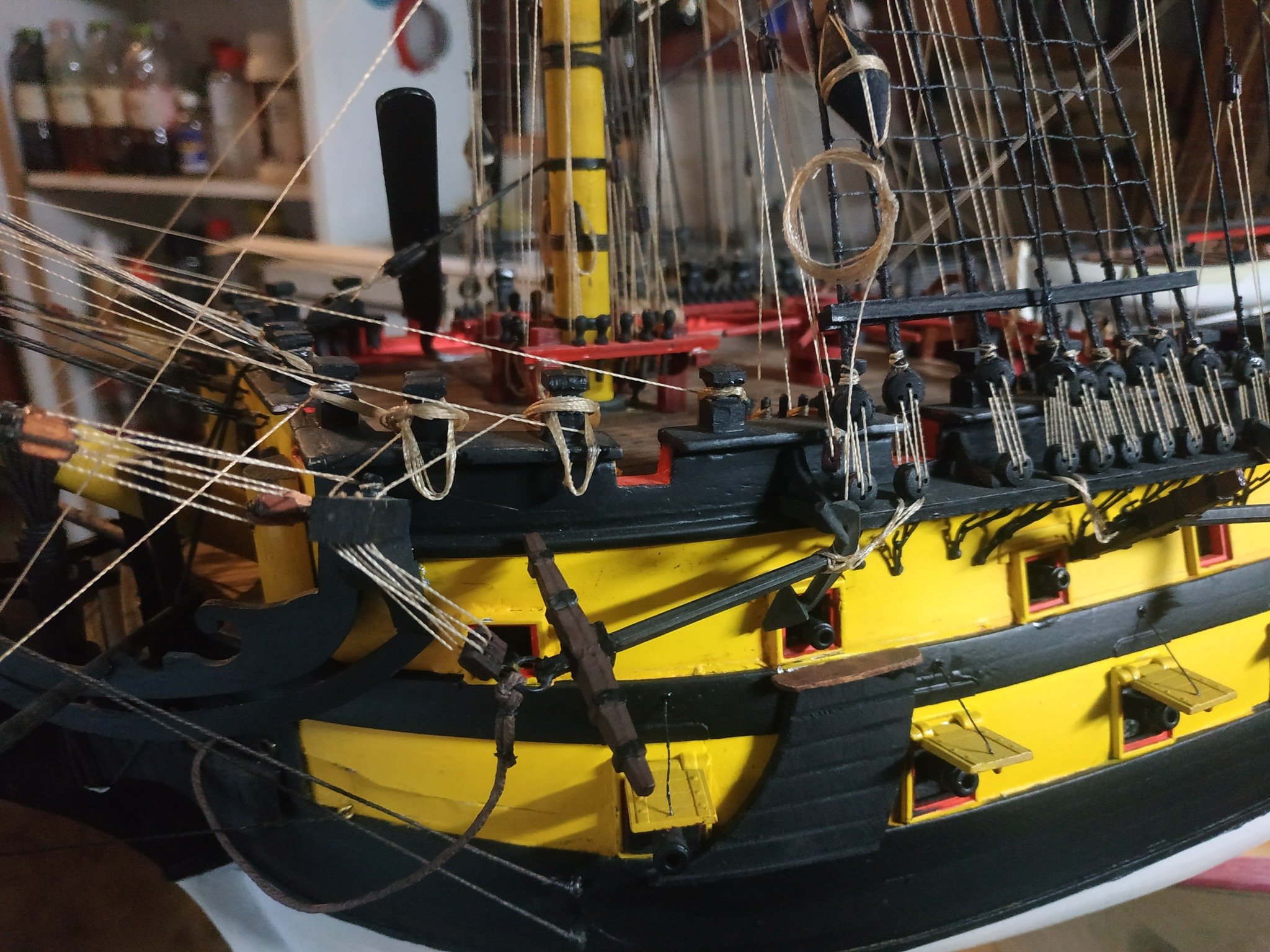

  3. well...today I finished copper plating the hull and the rudder, and I applied a first coat of blue patina, the result after one hour was this

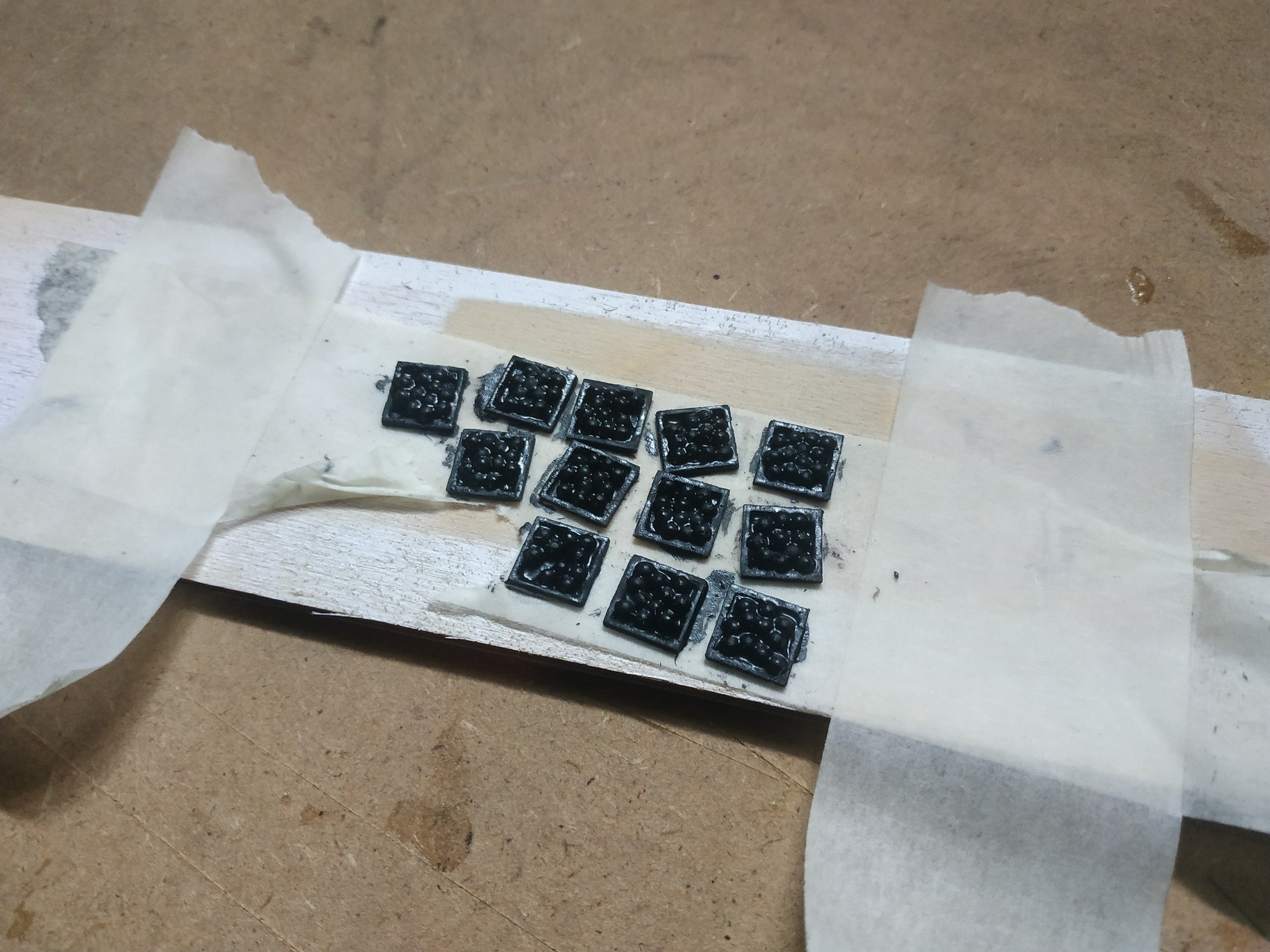

  4. and some photos of the copper plating, i used copper tape and a riveting tool to simulate the copper plates, this weekend i finished one side

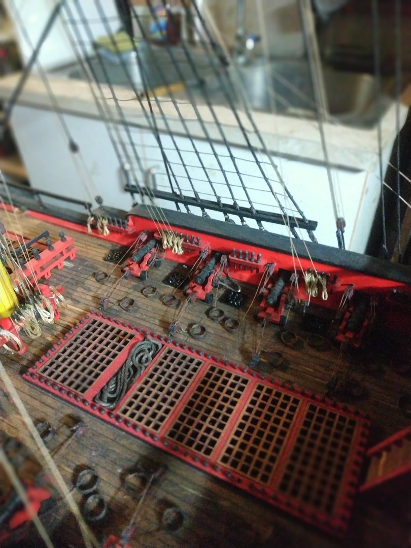

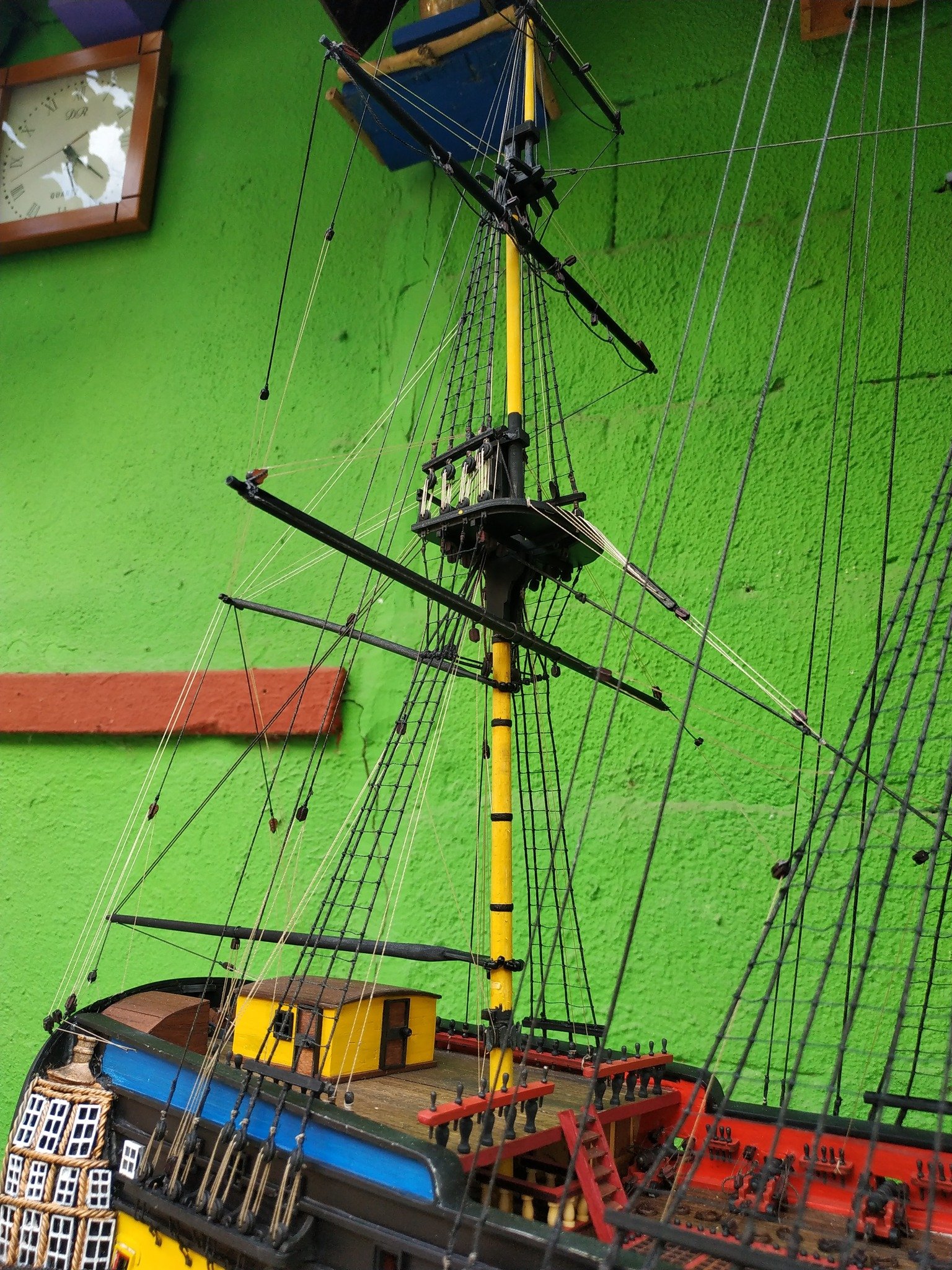

  5. and some photos of the paint job, as you noticed i decided to add aftermarket cannoports cause i had a majot problem to build the frames perfectly square

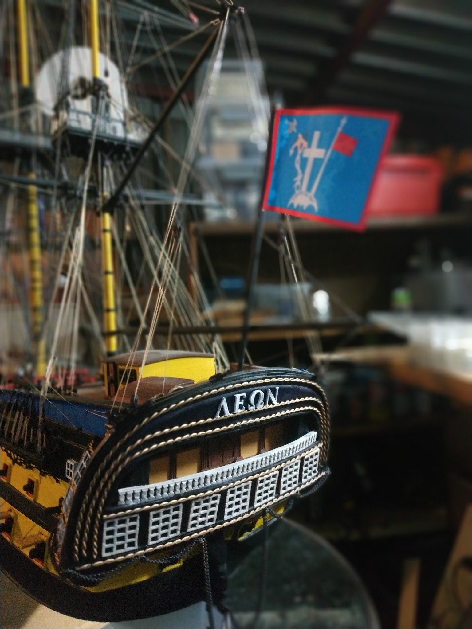

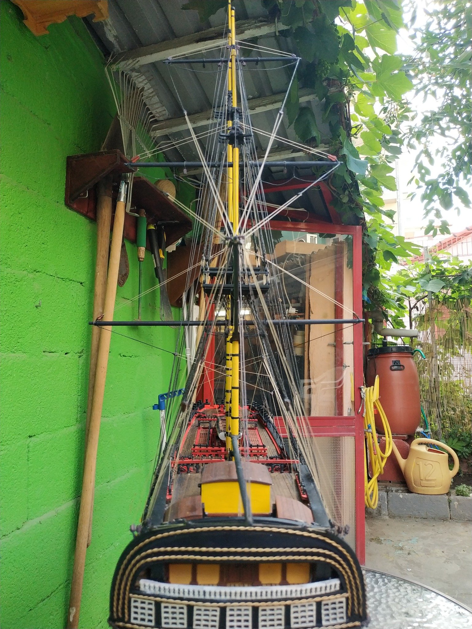

  6. Hello guys, i started this ship at January 2016 and after a long brake period i decided to finish it here are some photos of the progress so far
