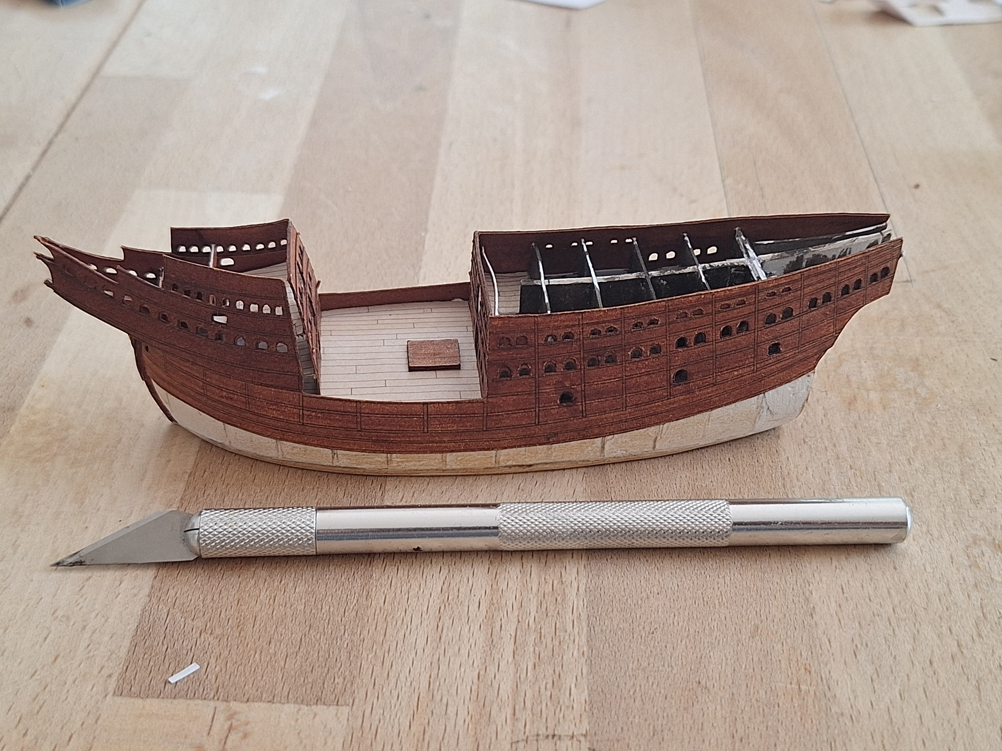

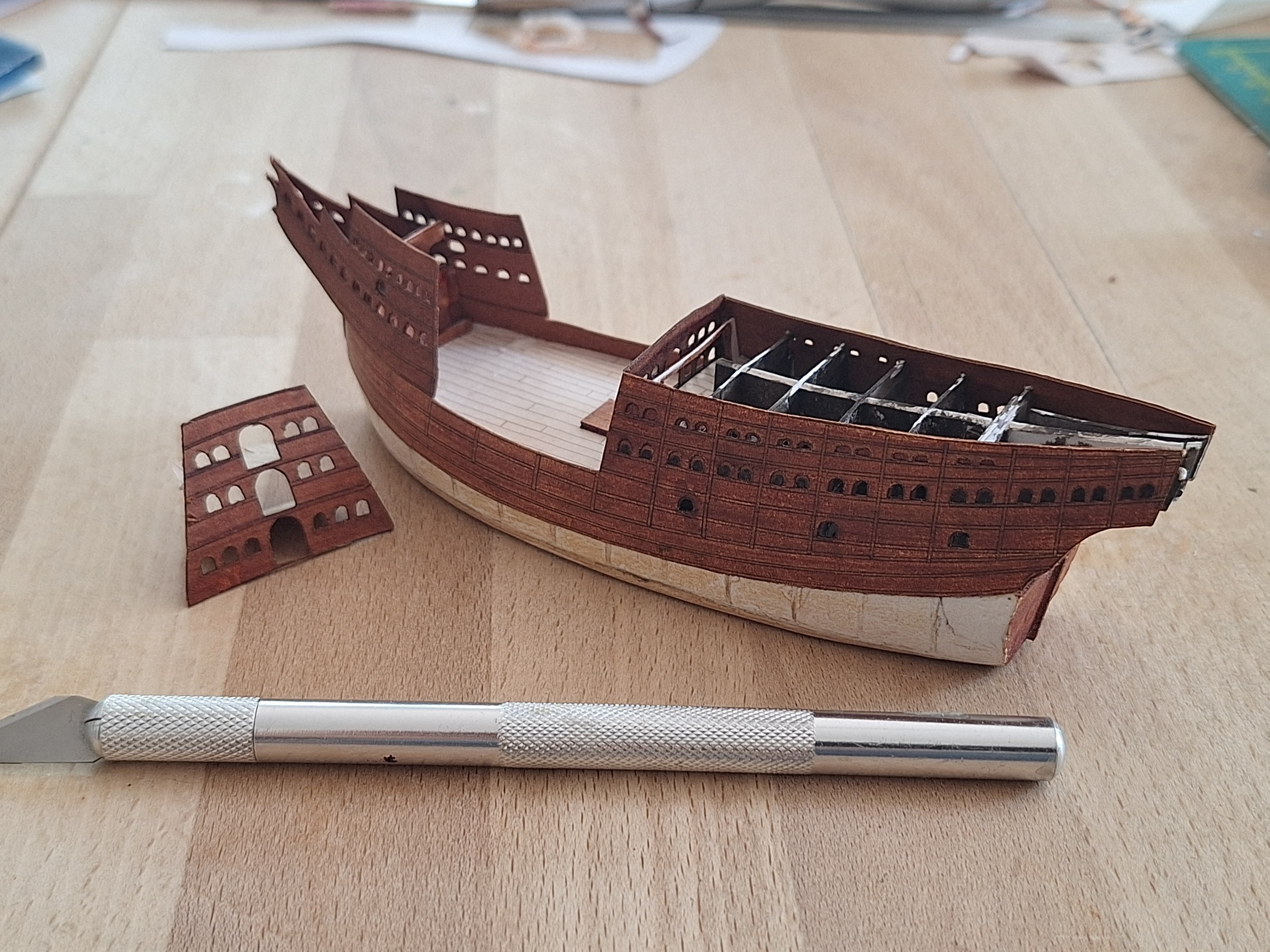

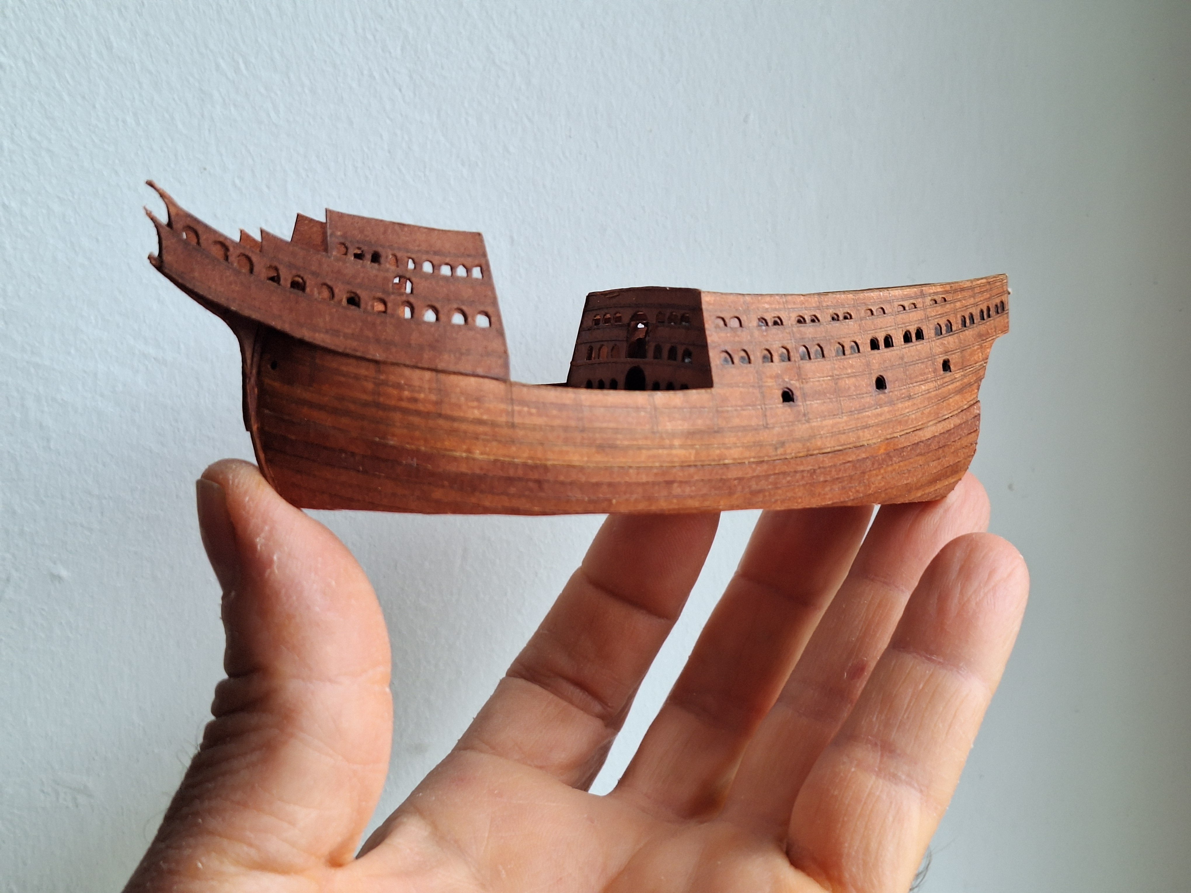

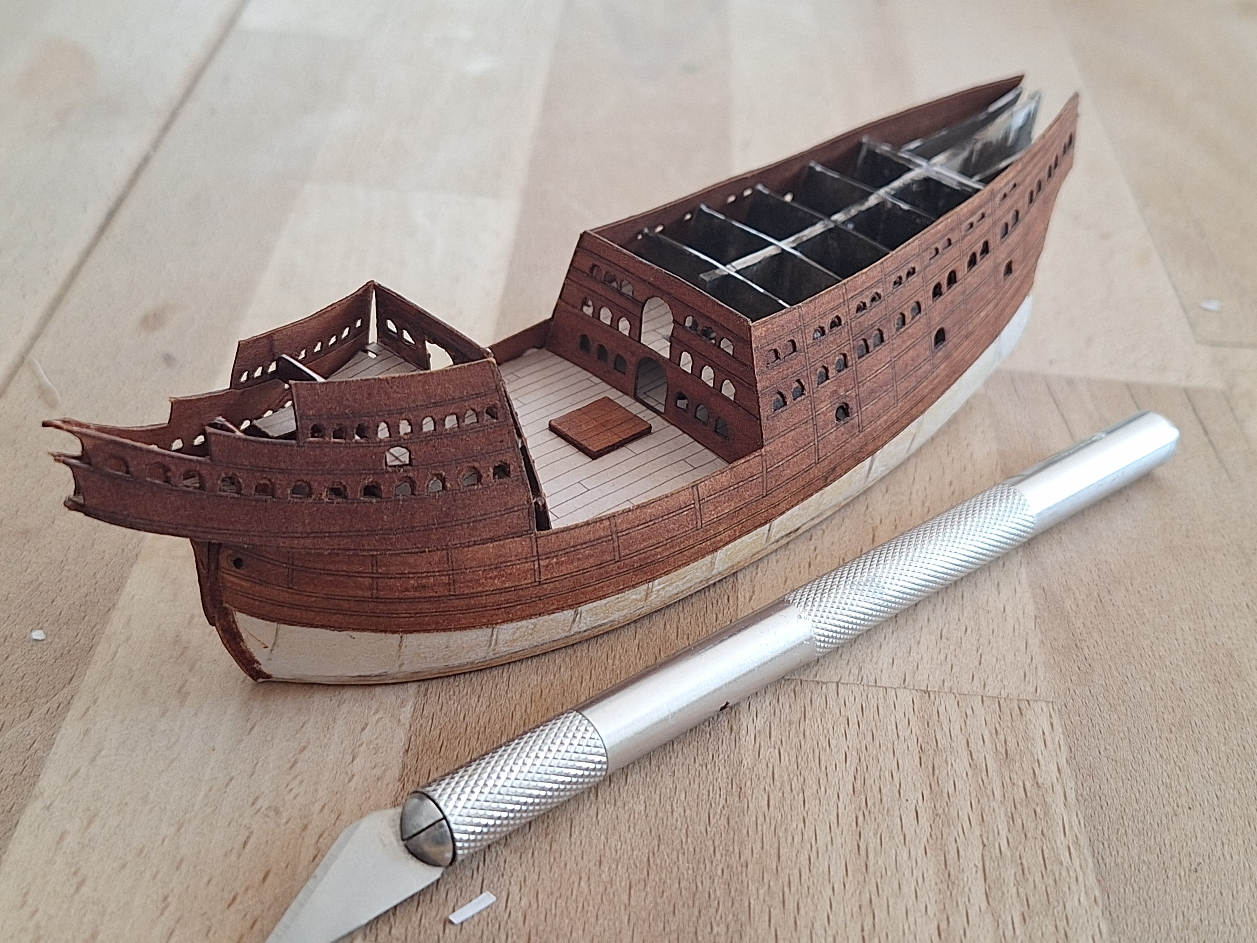

  16. I meant the texts you and others have linked from time to time, not the posts in this forum.
