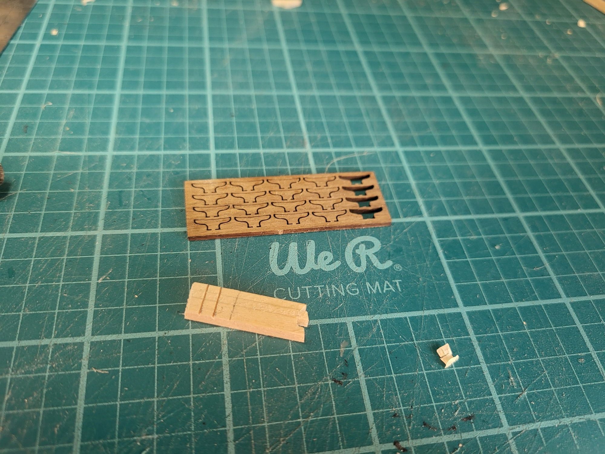

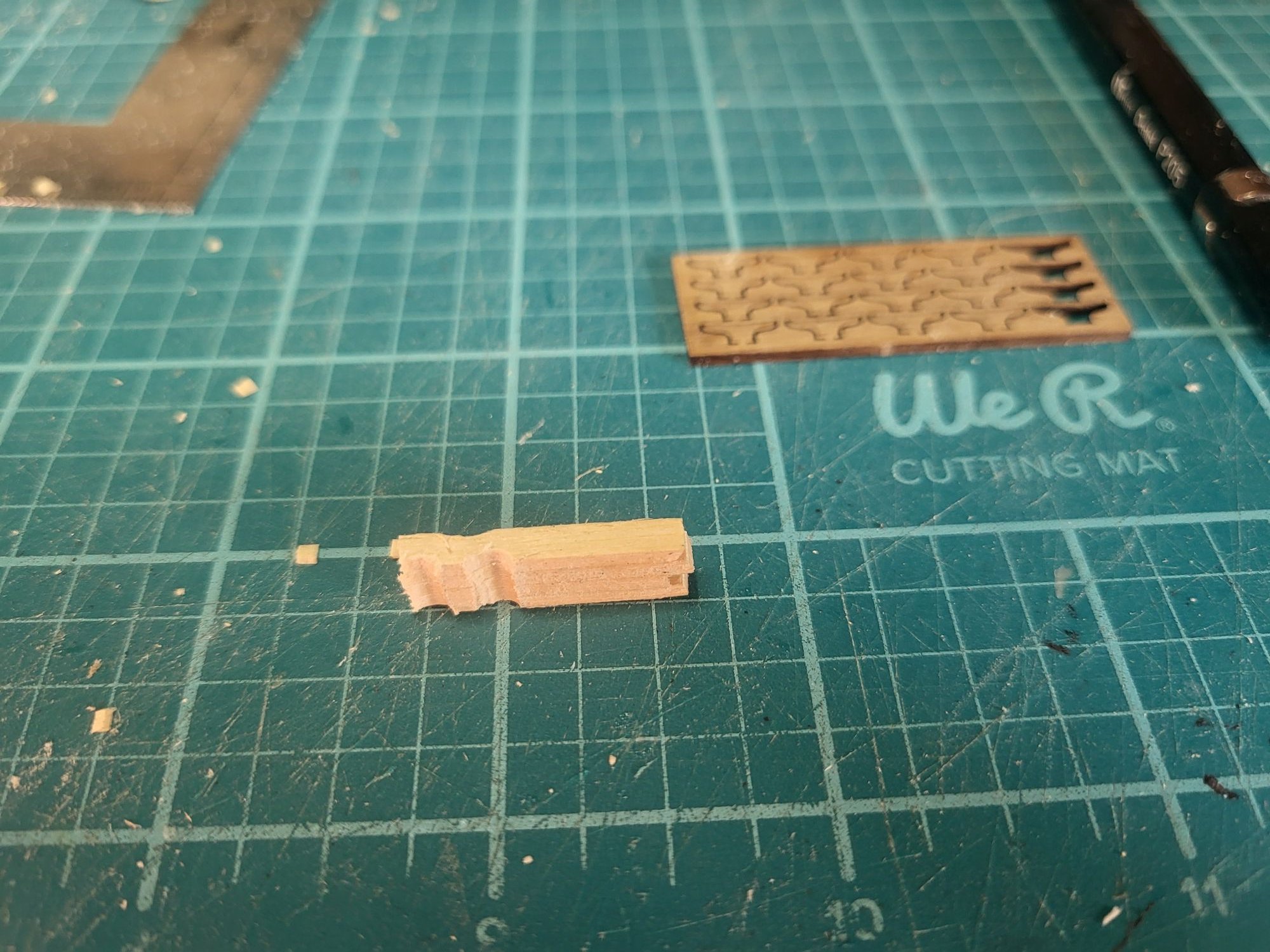

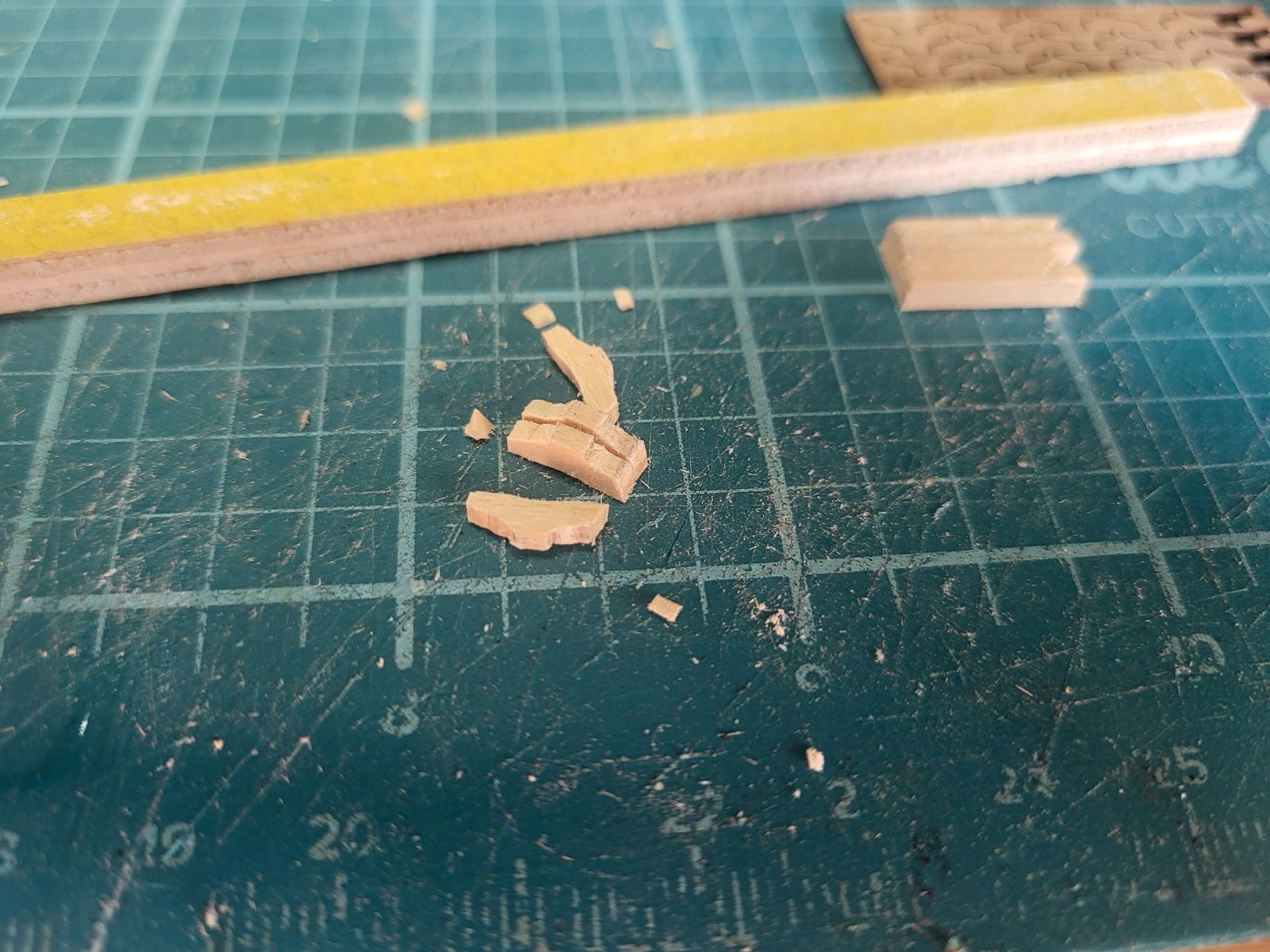

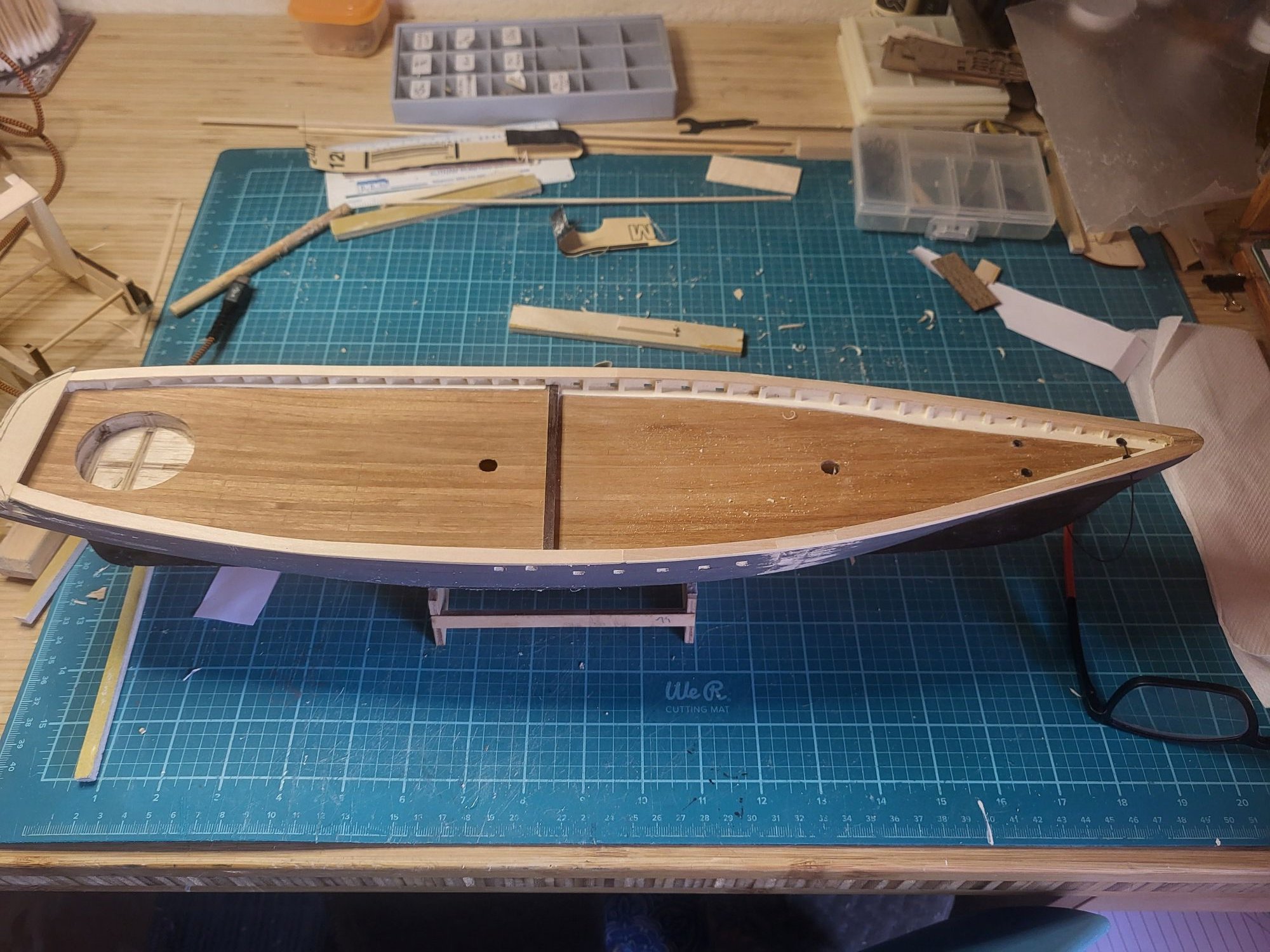

  7. I did proceed with replacing the loops, elongated the dead eye holes as well. I have a couple of "masts" in place to hold them in place while I secure the pins and such.
  8. Thanks @Gregory I was thinking about how I could replace the loops holding the dead eyes, I've made chainstays from scratch, that's not a problem. So, yes, I think I will replace them.

  10. Finished the top rail, I do these now, by gluing a large plank to the timbers, then carving/sanding to get the overhang on the hull right, then using a compass, I create the parallel overhang over the deck. I need to make a few "adjustments to the timbers, they sure looked fine before, but I obviously want them to meet the top rail nicely. I'm also carving some cleats, I glued the tail end of 4 pieces of stock together, then I can carve the profile on all four, before cutting them loose and finishing. I'll used the supplied ones for the booms and bowsprit, I just don't believe every cleat would be the same size.
