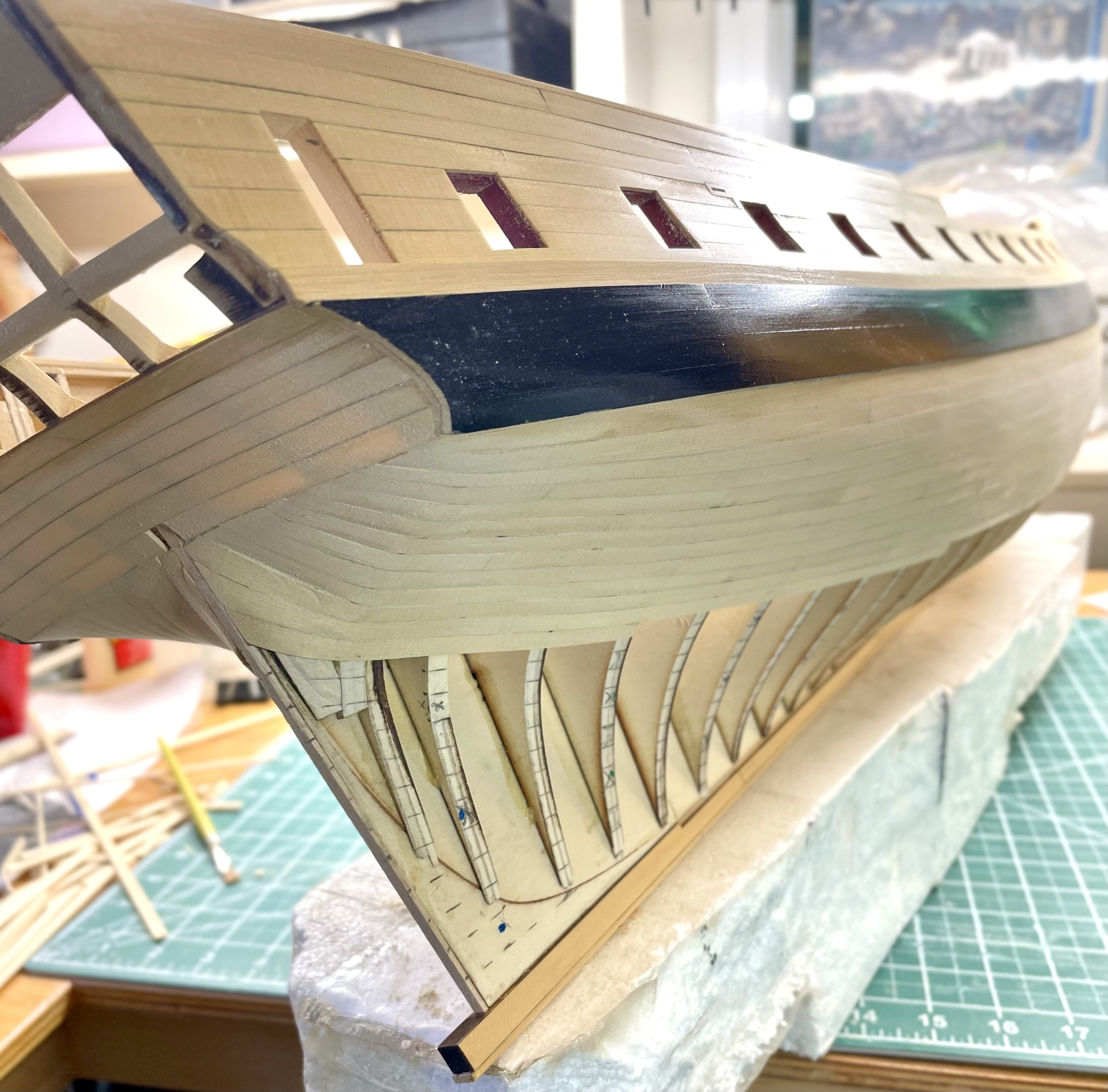

Another update. I'm almost half way done with the planking of the lower hull. Finished the tuck at the stern. This was the most technically challenging area. It came out okay, not perfect but about as close as I'm going to get it after re-doing about half of my first attempt. The edge set on some of the planks is pretty extreme and I ended up shaping as much of the curve into the plank as I could prior to applying heat and water. This yielded a more consistent result for me. I do some rough fairing as I go along. Only enough right now to blend the edges of the planks. I won't attempt to ease any high or low spots until the entire hull is planked. I also take care to leave the leading edge of my work untouched with the rough fairing as I work along. Steve
Finally got back to work. Was able to spend a couple of solid days over the weekend and completed a little over 8 strakes of planking. I decided to plank both sides at the same time, working in pairs of strakes to help me keep things symmetrical. Using Chuck's planking method and it's going really well. For planking, I'm using gel CA glue that I can apply with a toothpick to each bulkhead. Progress pictures with just some light fairing to even up the edges of the strakes. Steve

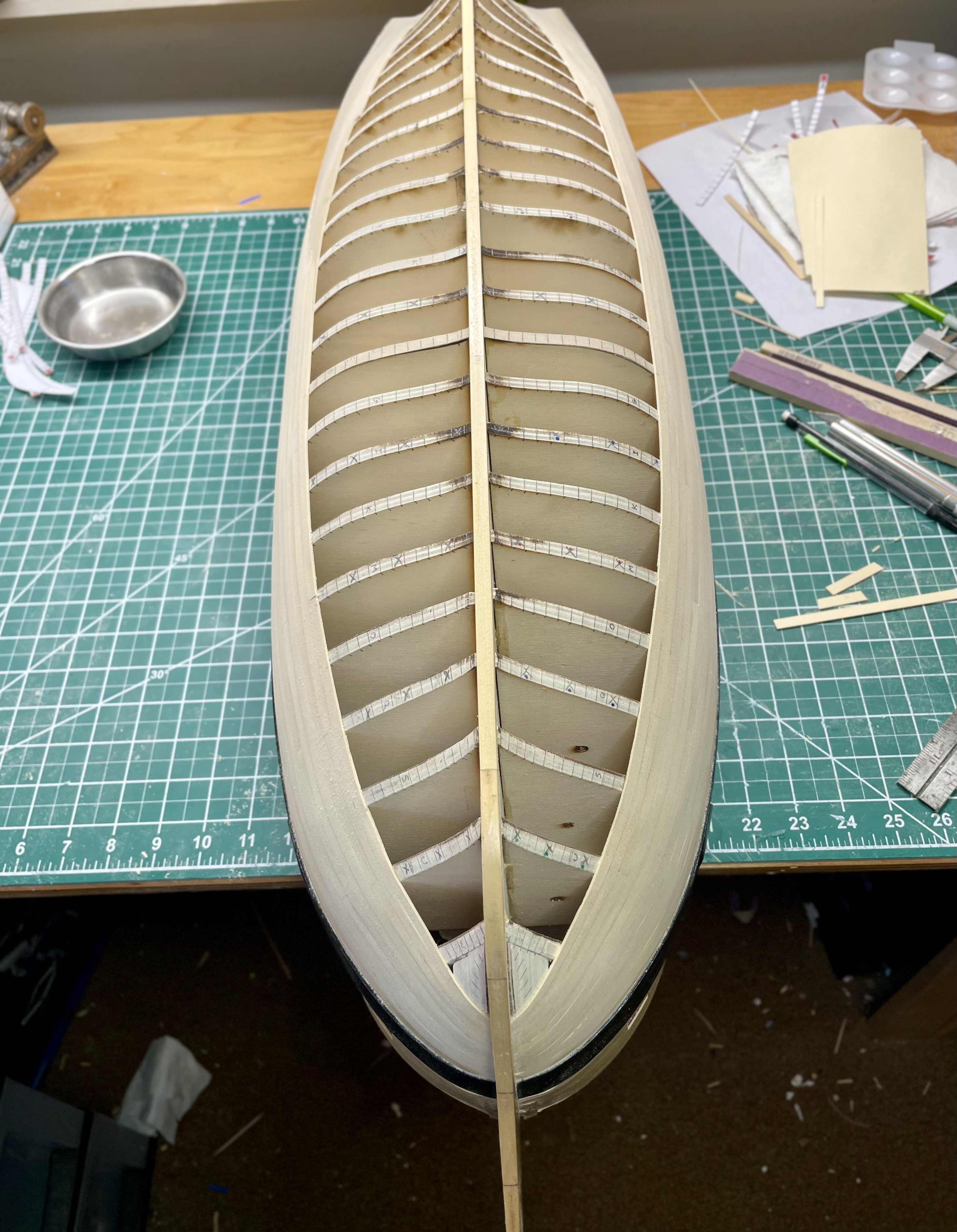

After going through this 2 1/2 times I'm pretty happy with the lining off and run of the planking. The spacing is not 100% perfect in all areas but I'll adjust that as I add the actual planks. I found and corrected at least a half dozen areas of the hull that were either high or low, worth the time it took. Progress will continue to be slow but steady. I get an hour or two a few times a week and sometimes an afternoon during the weekend. This should improve heading into the fall. Steve
Spent a couple mornings over the weekend working on adjusting the run of the planking and fixing some low and high spots. Chuck, I did flip it over I was surprised at what each perspective on the hull was able to show. I found several spots that needed some touch-up on the fairing that were only visible from one angle, and also some areas that were an optical illusion as you stated. I had thought that simply inverting a photo would be sufficient, that was very wrong. The other hulls I have done were smaller vessels and 1:64 scale so I'm learning how to spot more subtle issues across a much larger hull area. Starting what is hopefully a final taping this evening. Frank, thanks for the comments on the corrections I made to the stern. I'm really happy with it now. Good suggestion on checking the frieze, I'll check that tonight. Steve

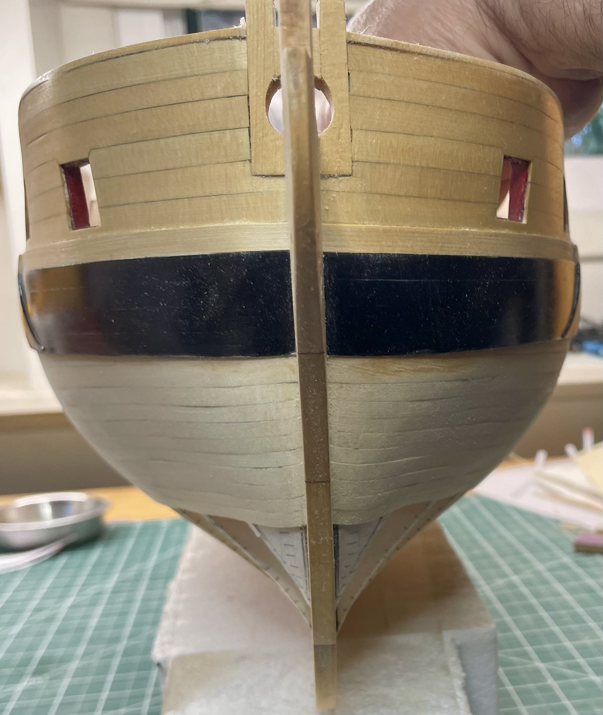

Working on lining off the hull. Pretty happy with how the lines are running for the most part, except for the lower bow area. Looking for some opinions on what needs to be adjusted. Looks like I need to remove some more material from the bow blocking, especially in the lower portion of the bow. Any other opinions? And several other angles. I ran tape for every other strake. Hoping to finally get to planking this weekend.

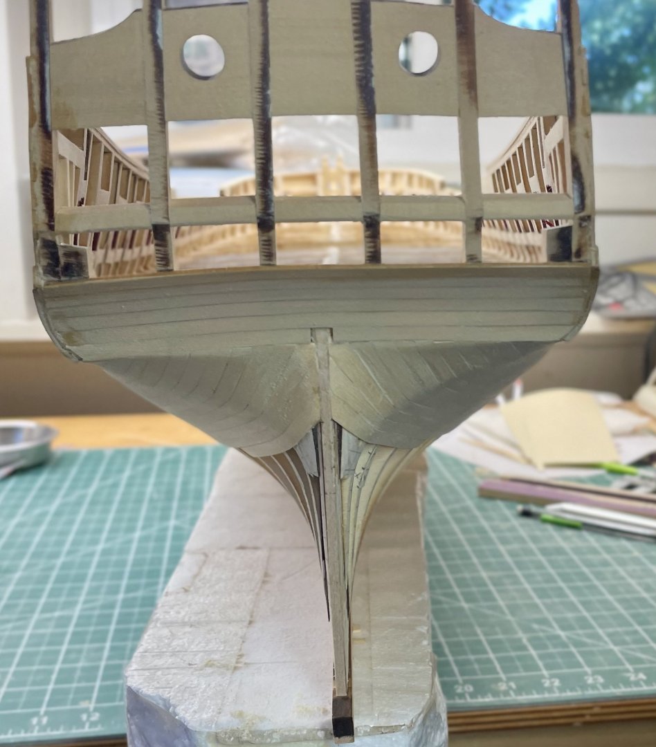

Finally got back to work after about 3 weeks. Spent about 4 evenings getting my lower counter to bottom planking sorted out. As a reminder, here was the issue. I had made a mistake in the placement of the lower counter planking, aligning the bottom edge flush with the edge of the stern frames, instead of having the planking extend below this edge to accommodate the bottom plank thickness. I compounded this mistake by not stopping when the first bottom planks didn't align correctly and instead trying to force it to work. You can see where the lower counter planking is even with the framing, leaving no space for the bottom planks. The blocking behind the counter is also way too high and not close enough to the counter to support the ends of the bottom planks. I received a lot of thoughtful recommendations on correcting this. The first step was to remove the narrow lower planks on the counter and replace them with with full width planks and see if that would close the gap. Lower planks on the counter removed. The blocking behind the counter was also a mess, I removed it and also cut some notches into the lower stern frames to give me some more room to work with replacing the blocking. Not strictly necessary but made things a little easier to fit. The wide plank alone was not quite enough to fully take up all the gap that I had. I needed to pop the bottom planks off the aft bulkheads to fair things a little more to get the planks a little lower. I also lucked out on the port side that the plank lengths were correct for the new mounting position. Just needed to glue everything back in place. Not so lucky on the starboard side. I cracked the inboard lower plank when I tried to remove it from the aft bulkhead so I needed to replace it. The lower plank adjacent to the wales was a little to short to reach the counter in its new position and I misplaced my plank stretcher so I needed to remove and replace the aft portion of this outer plank as well. Starboard counter plank, blocking, and outboard lower plank all back where they belong. Finished result, I'm much happier with this now. Only 4-5 evenings to perform this rework once I settled on a plan. Hope this helps someone in seeing the steps I needed to take to rework an area like this. As I mentioned, I think the entire run of lower counter planking was about a plank width too high on my model. I extended it downward with the wider plank. I expect I may need to remove some width on the upper plank but will wait and see what happens when I add the upper counter. Now finally onto lining out and starting the remainder of the planking. Steve
