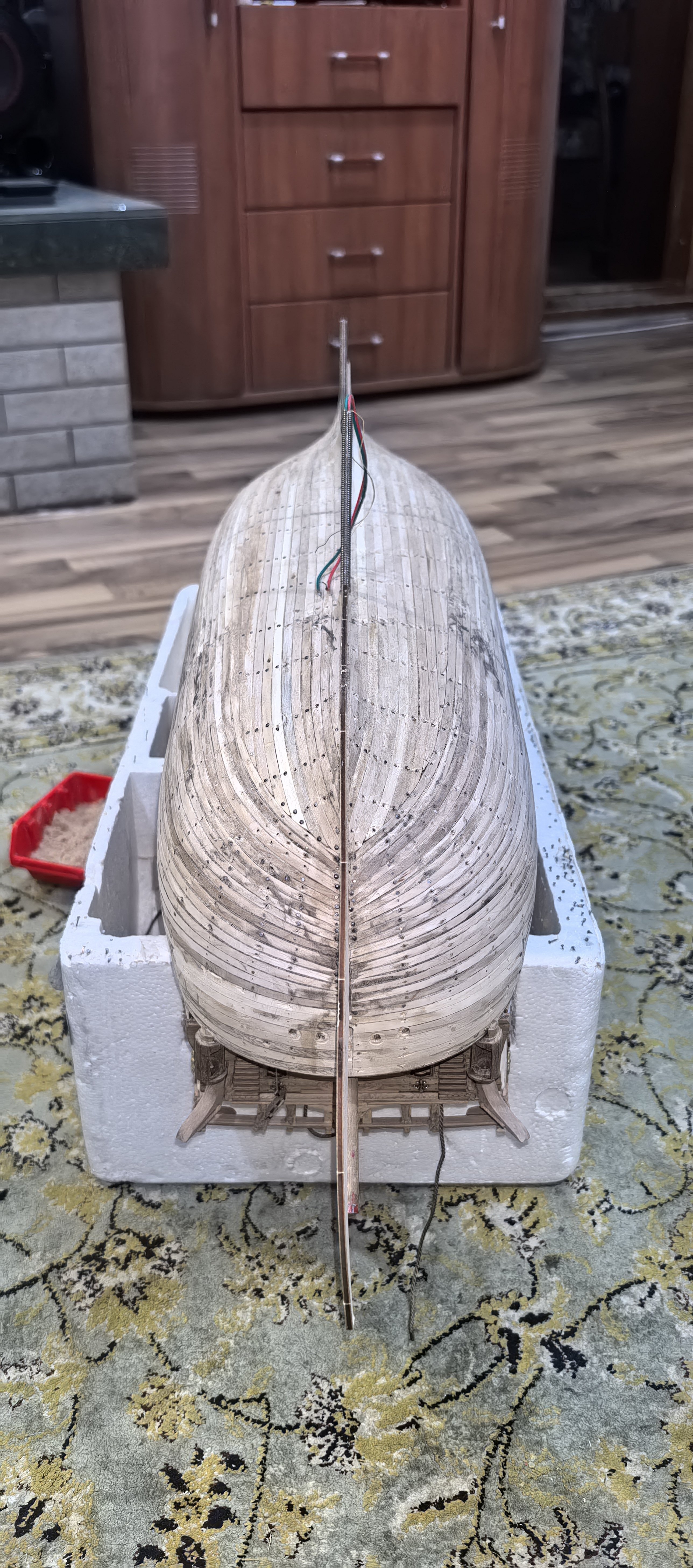

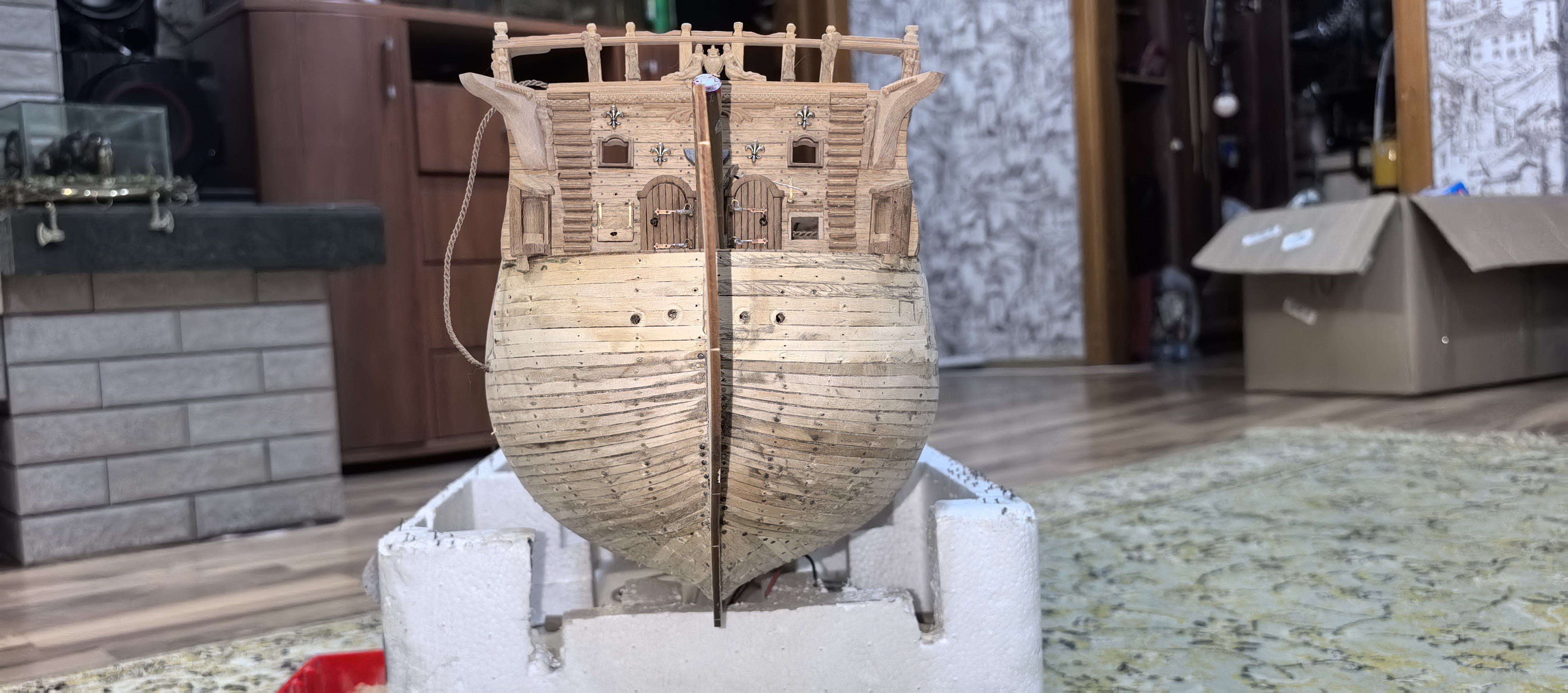

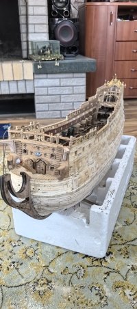

On this quiet and not-yet-late evening, I have decided on the next steps in my shipbuilding project. The next step is the rough sheathing of the ship's hull. Due to the lack of free time, the speed of the ship's assembly has slowed down. Before starting work, I dismantled the ship's hull from the display stand. It has become inconvenient to firmly attach the model, so I suggest building it in a foam box. It's relatively soft so as not to spoil the model.
All the preparatory work is completed, it's time to start. Before starting the cladding, we arm ourselves with…
Wood material linden rail 5x2x50mm.
Wood material birch rail
5x2x30mm. from the magazine set from Diagostini.
Tools and consumables
Nails 10x0.7mm
Nailing tool
Mini drill + 0.7mm drill bit
PVA glue (red)
Wood flour
Iron
Rack soaking bottle
Shlivmashina + renovator
Sandpaper, sponge, bar.
A knife for cutting rails.
The motor for narrowing the slats. I

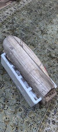

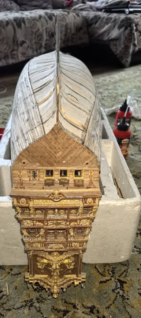

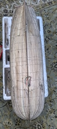

started roughing the hull.

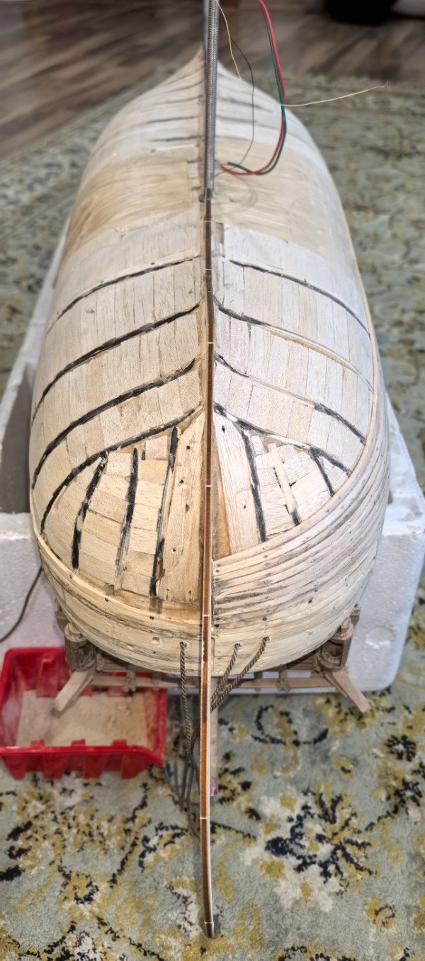

A) Fitting the slats on the model body, marking with a pencil from where the rail needs to be narrowed. Marking with a pencil the location of the nails in the projection of the frames.
B) Next, I made holes with a 0.7 mm drill bit and narrowed the rail on a sandpaper.
C) Soak in hot water for 10' - 15' When soaking the rails, there is a problem that there is no container in which you can place the rail completely, but in my case, it is not necessary to soak the rail completely, in this case, I soak in a glass bottle from under beer.
In order to avoid cracking and breaking of the rail in places of sharp bends. You can also bend over steam.
G) Once again, I try it out how it fits on the body, and if everything is satisfactory, I apply PVA glue to the rail and immediately attach it with nails. Since the nails are very small and it is inconvenient to hammer them in, it is best to use a nailer. I have such a tool in my arsenal. After that, the work went much faster. However, a small hammer should always be on hand, as it may be necessary to finish the nail.

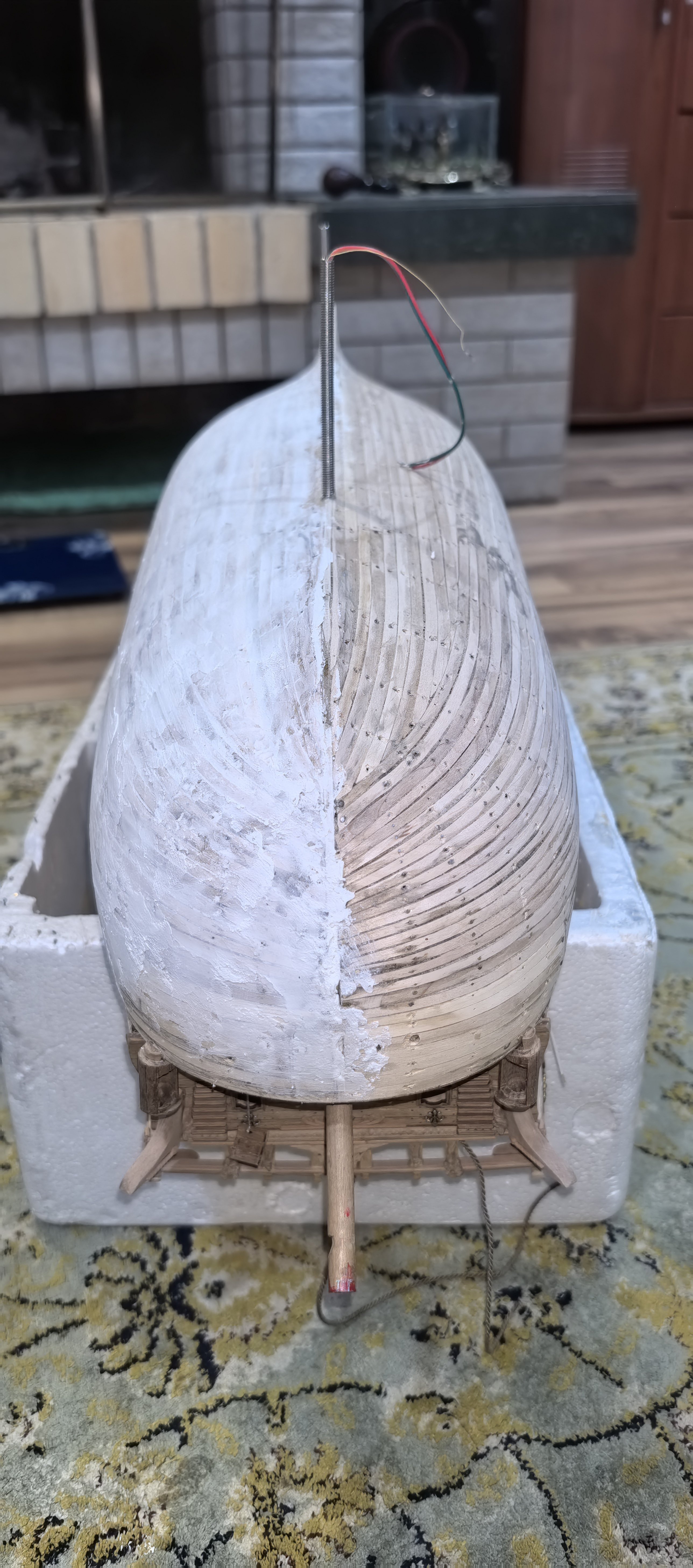

D) I remove the excess glue, especially on the end of the attached rail, using a cloth and then a knife. If there is a gap between the slats, it must be filled with glue and wood flour.
And so 10 rows are made. I cleaned the body a little from the glue, but I haven't polished it properly yet. I used sandpaper, a block, a grinder, and finally an emery sponge. This manipulation allows you to evaluate the work more accurately.
After that, I move to the other side and do the same.
The most difficult part is bending the front slats, as they require careful attention. The middle and rear slats are much easier to bend.
I am confident that our model will last a long time. The model is not cheap. Each modeler invests a lot of time, money, and effort into it. It is primarily a reminder of the present, which is unfortunately fleeting.IMG_20251031_162408_copy_613x1386.thumb.jpg.b46c65bef5d4171b6312cbd56d4444e1.jpgIMG_20251031_162422_copy_582x1316.thumb.jpg.4c540f42f454eb91135095d9ded2994e.jpgIMG_20251031_162504_copy_461x1042.jpg.a586432b195cdc7b8479549b8099b060.jpgIMG_20251019_173432_copy_600x1357.thumb.jpg.7d3f58428406c9f9bc8f3ed035e7728f.jpgIMG_20251019_173336_copy_800x354.jpg.a20691b59838152072922cfbdb67e7da.jpg

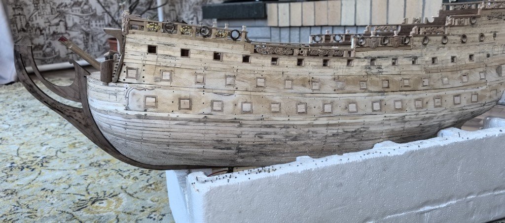

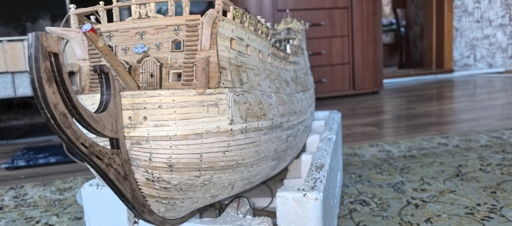

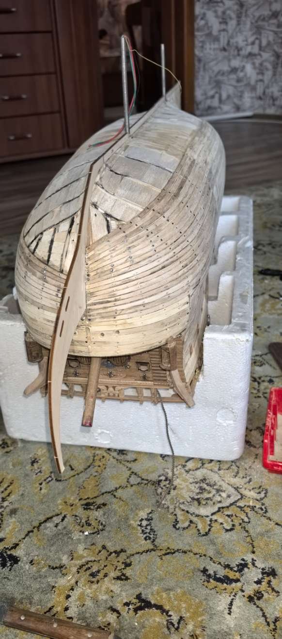

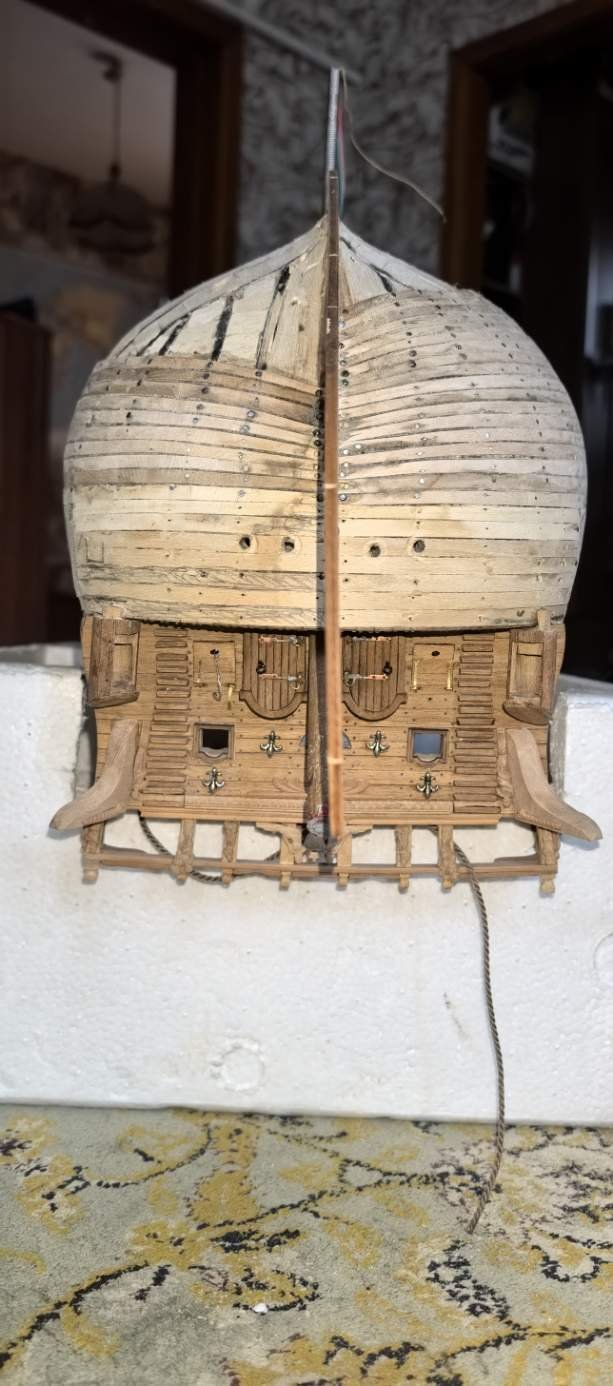

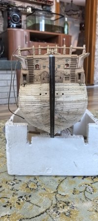

Hello, dear colleagues - model shipbuilders!
My "Shipyard is working. My main concern is the construction of a model of the French sailing ship Soley Royal. I must say that over the years of construction, I have departed from the Soley Royal model developed by Deagostini. I have completed the twentieth row of rough planking. I am starting the thirtieth row of planking from the keel.
-due to the fact that the soaked rail lay on the nails very easily, I just joined the rails one to one without making wedges. In principle, the rails lay normally, not taking into account the pattern on the front. But I decided that it was not important for the rough sheathing.
A rather difficult and lengthy process loomed in front of us - the finishing of the hull. All belts and contours should be smooth. Pits and mounds are unacceptable. Even a small break will spoil the impression, so we must strive for perfection. Now I'm caulking nails, preparing tools for grinding. And at the same time I am correcting log errors. It can be called the backbone of the ship, it is the keel. Insistently, the keel was built up from several massive beams, the reason is obvious - the large size of the ships. And I make it composite, like an adult modeler.

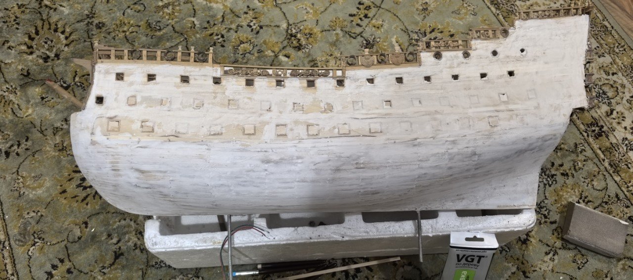

IMG_20251130_151738_copy_200x453.jpg.2bcd41fd82e87aaa7ec9b8529e97b813.jpgIMG_20251130_154222_copy_1024x453.jpg.183f3322bb85358dbfb05eeb13f7b102.jpgIMG_20251130_151814_copy_1024x453.jpg.de5bc19fb7d852e799275e6ab63de5b5.jpgIMG_20251130_151748_copy_200x453.jpg.2873c81b3a2d2a212131105667047cf7.jpg

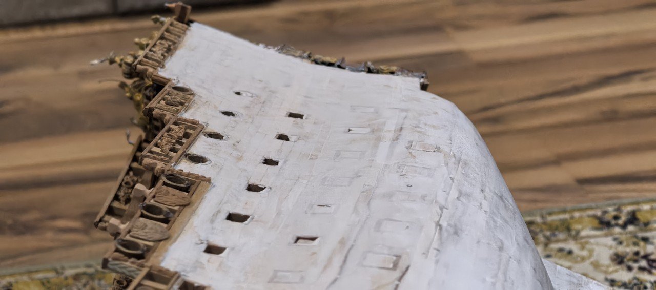

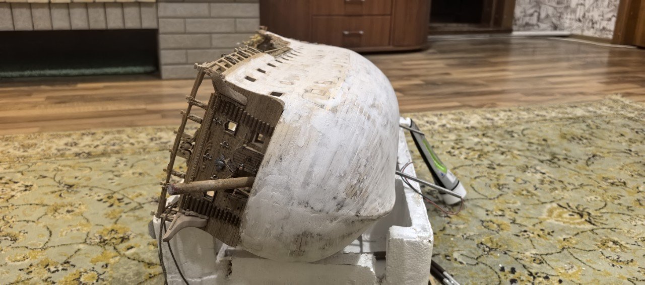

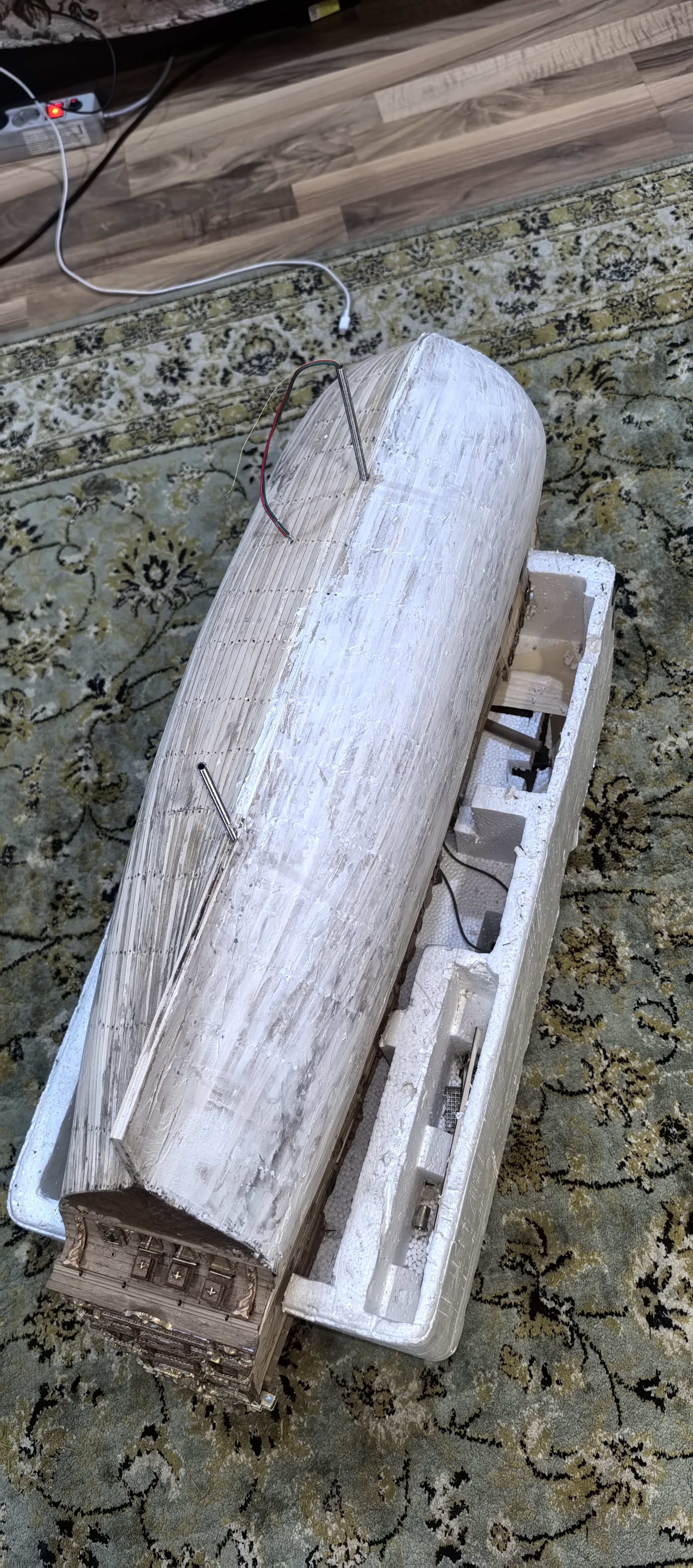

I picked up sandpaper of different grain sizes (from coarse to fine).
I have prepared the grinding machines and will use the manual method using wooden bars.
I have prepared protective glasses and a mask to avoid dust getting into my eyes and respiratory tract.

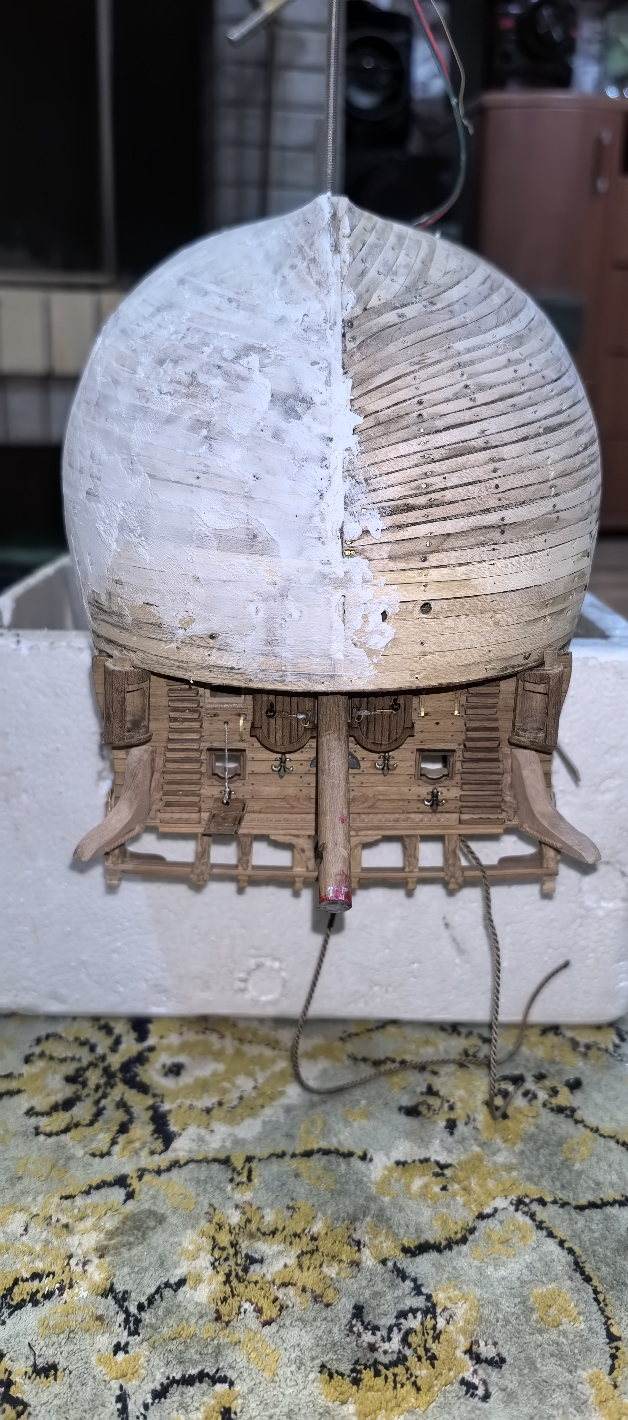

I started sanding with coarse-grained sandpaper.
I removed all the irregularities, burrs and rough defects on the surface of the case.
I worked in one direction to avoid unnecessary scratches.
I picked up an acrylic putty suitable for use on wood. It has good adhesion to wood, is easy to grind and provides a durable coating.
