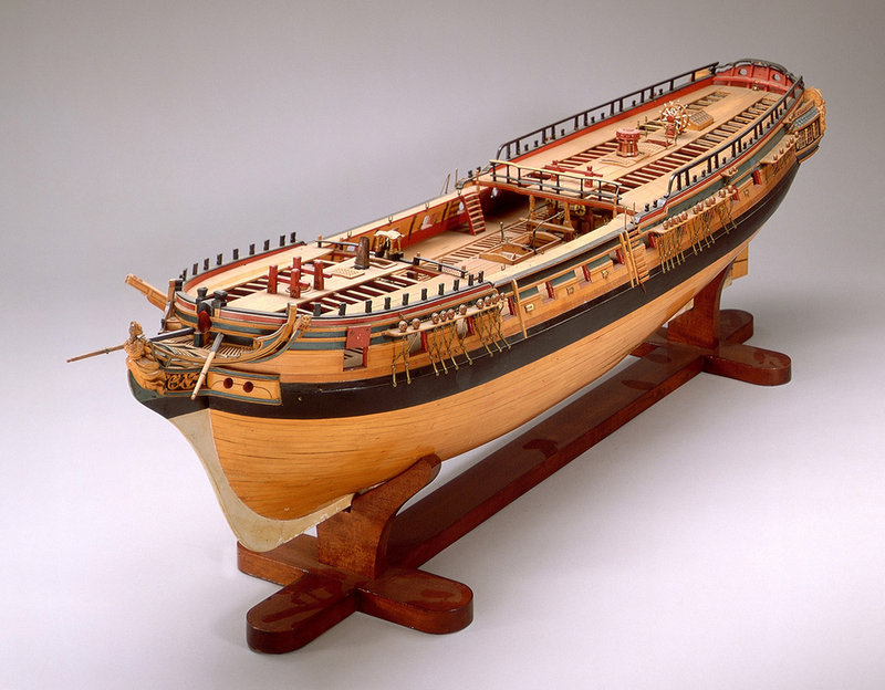

Nearly all of the contemporary models I've seen support the first drawing (red line), but the contemporary model of HMS Minerva in the link below seems to support the second drawing (blue line):
http://s3.amazonaws.com/magnoliasoft.imageweb/nmm/supersize/d4842_2.jpg
As seen in the close up below, Minerva's taffarel capping rail does not seem to extend up to the stern timber:
What do you think guys? Red or Blue?

Looks like your drawing is not typical. The tafferel (aft) is lower than usual, so that there is a bulwark forward of it to make up the height for safety. This being the case, the tafferel is the width of the blue line, as it butts up against the bulwark. The latter has its own rail, the width of which you can measure directly from the plan.
