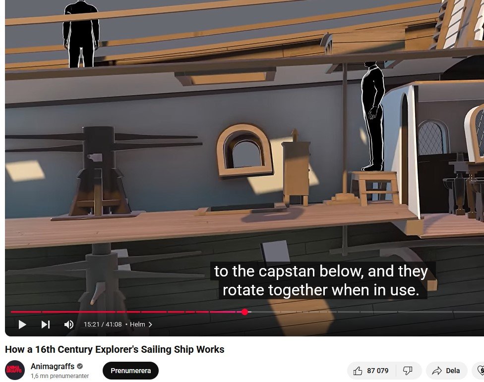

Did see these amazing animations by Animagraffs on YouTube of the ships anatomy. Highly Recommended!

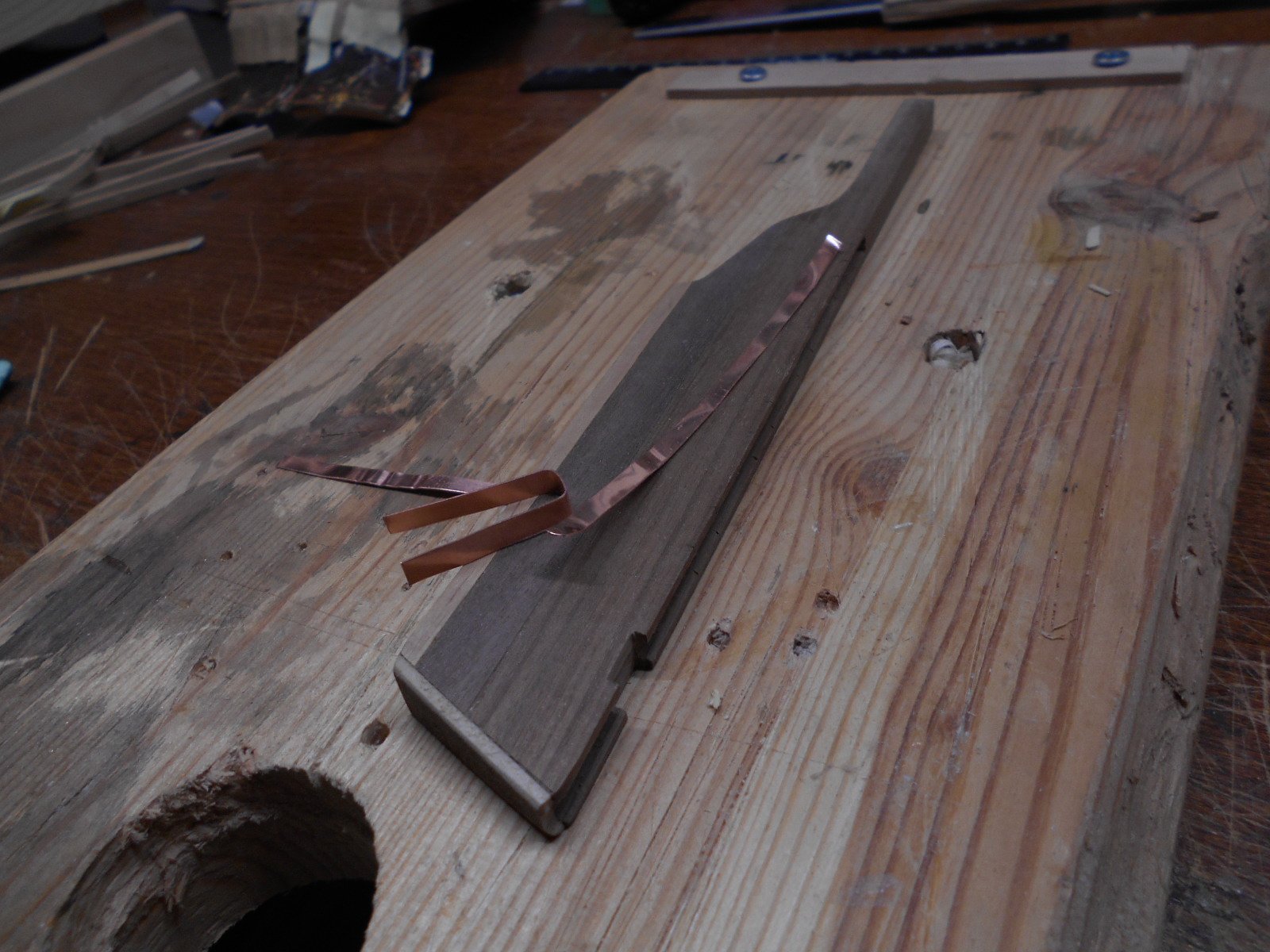

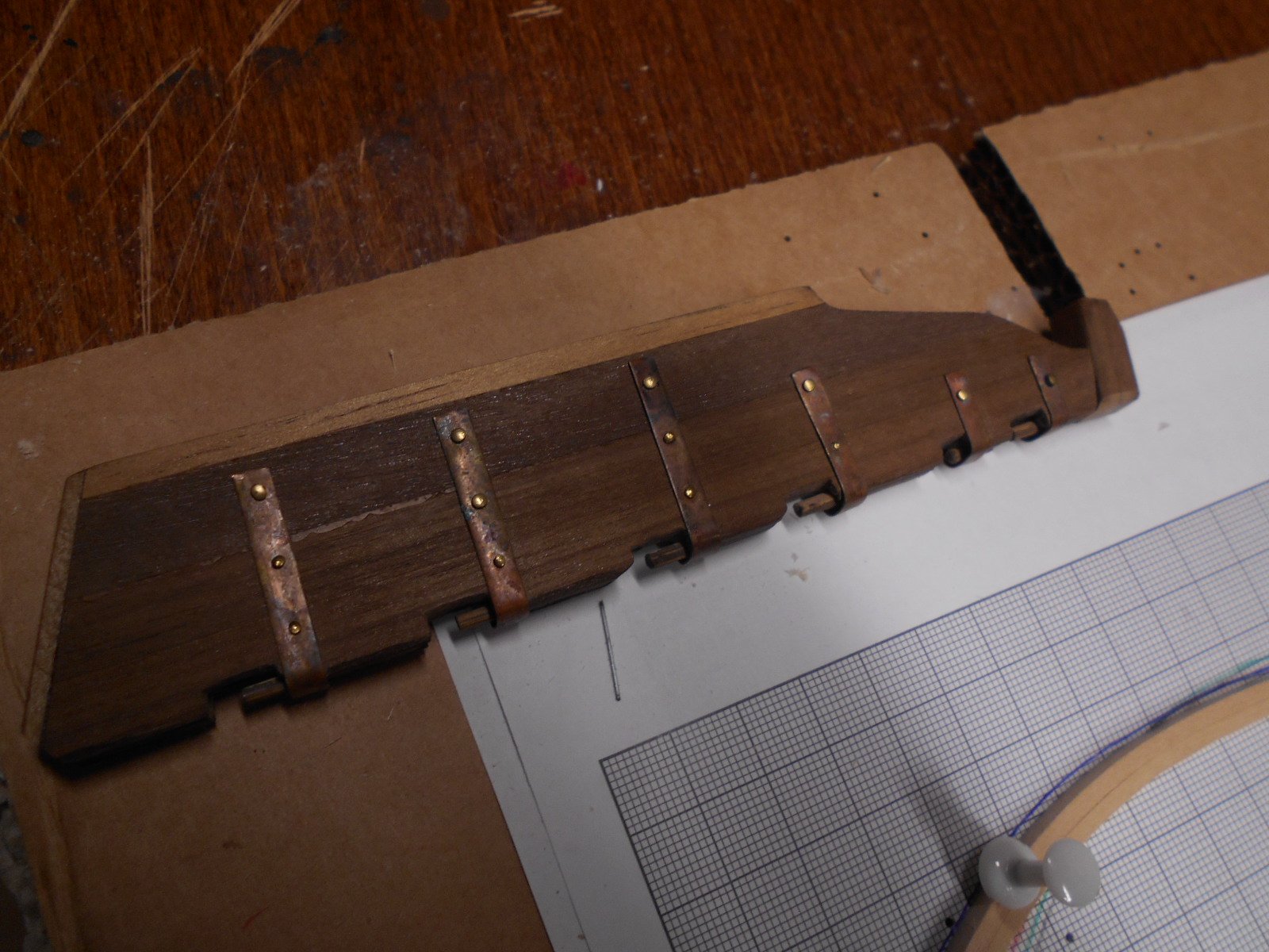

Found the Brian Lavery book (in the library)  Arming and fitting of English war ships 1600-1815DSC_0189.thumb.JPG.5521682a693a2ab7b992cf6a100482e4.JPG and found out my rudder is a bit off for a early 1600 type of rudder. I was planning having the tiller not passing the hull but to be enclosed and have the rudder passing the hull vertically. I have now cut off a bit off the stern post and try making the rudder like the picture in his book.
Made the "hinges" for the rudder of copper sheet. Put them in vinegar bath to age them a bit.

  I have curved the top of the rudder now. I have not decided were to place tiller and length. I read about the use of whip-staff or not on big ships and Wasa as not being used for very long as it sank (maybe it is not such a great representative), I read that Lavery in this latest book I read was open for alternative ways (as McKay). I find it somehow crazy to have a single person without watching the sails only depending on shouts from above during a battle or bad weather. In Wasa the helmsman could see out through the upper part of the deck and Lavery writes about companions as can be seen in the animated video link in previous post.

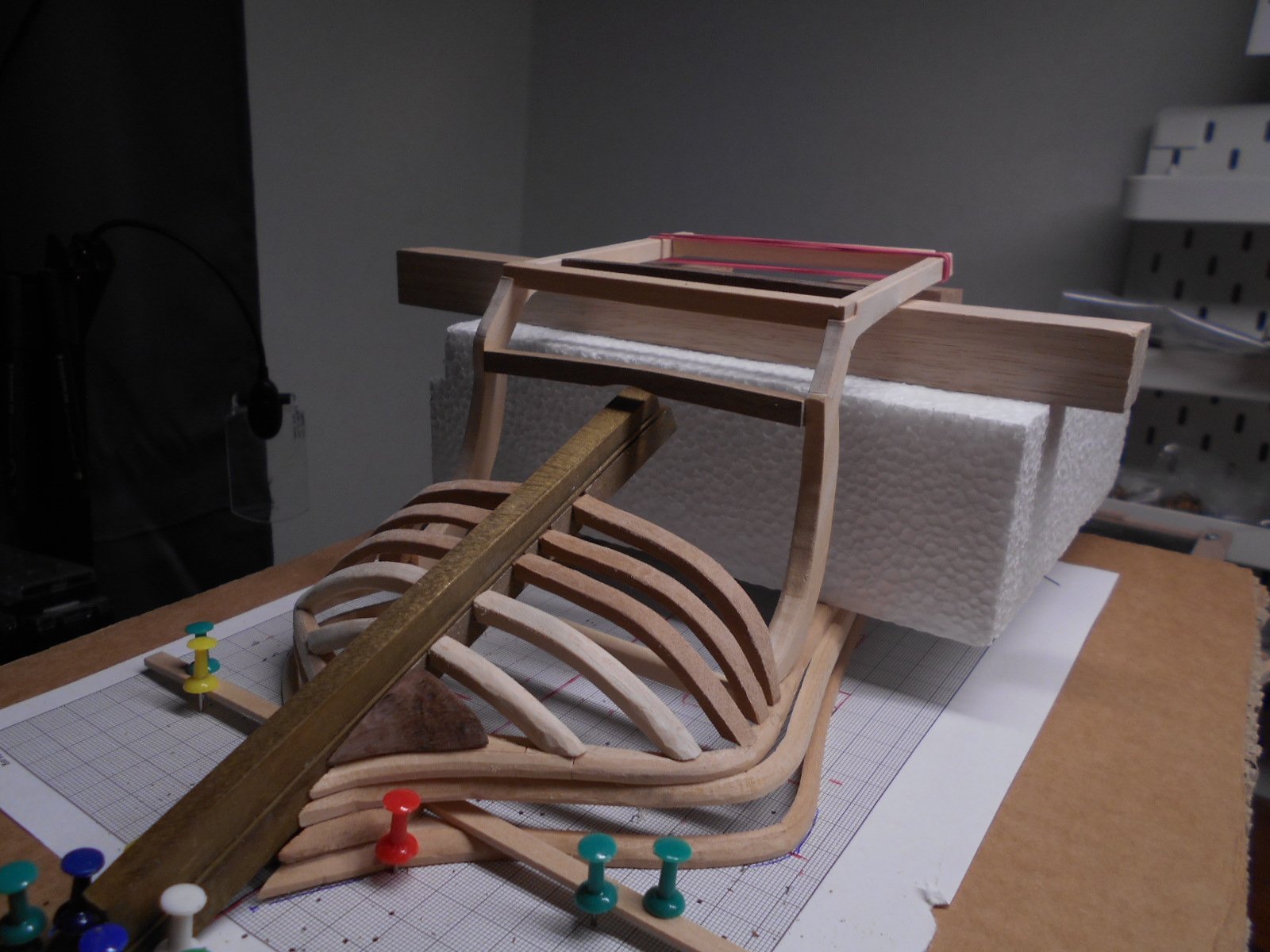

I am sort of done with the structure or the stern and finally working my way forward with making new frames.

I have only two more frames left and trying to fit the keelson with floor pieces between each frame. It is a bit tricky to fill the space on the lower part of each frame and a lot of crating templates and jigsawing. Practice pays off.

Started gluing the frames from each end and figured out I am missing a half a dozen frames in with the max size. All frames were leaning in one direction making it look like I had enough frames for the whole keel. So now I have to pick out my bending kit again and created some more frames.
Dyeing the frames as a I fix them, it will be around 65 frames.

I have done the rudder.

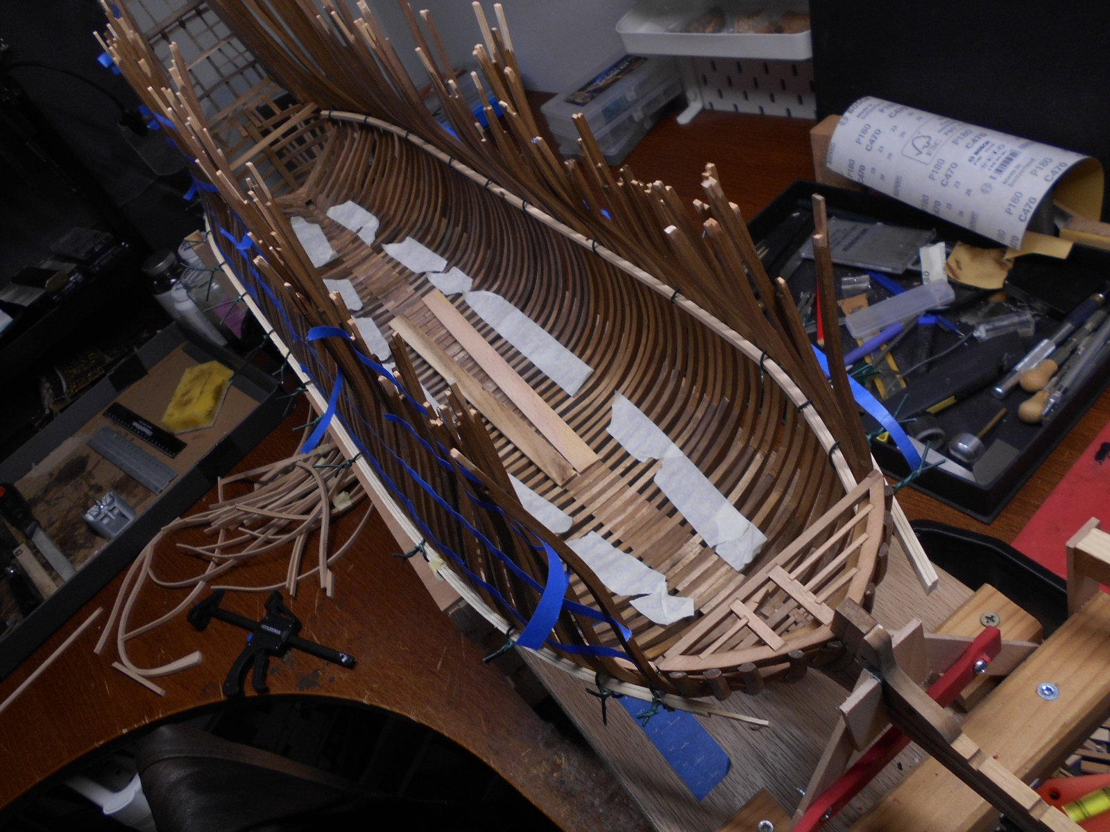

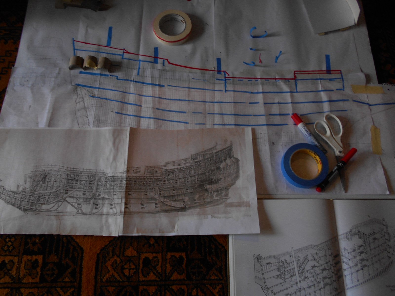

Started fixing the frames with some small wooden pieces along the keel on both sides in a oval bow shape. The whole thing is a bit tricky to work on - i have not cut the top ends of the frames yet. I want to get the deck positions done before i do that.
 DSCN4234.thumb.JPG.83ab141c1e9a51f279372ccaf9bb5249.JPGDSCN4233.thumb.JPG.48326b3186737eda61eb392f38b306f2.JPG
