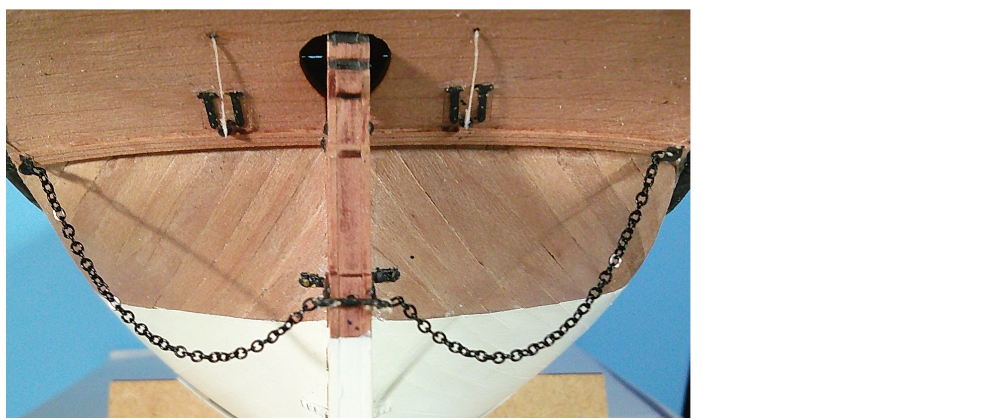

Hinges and ropes installed for the bridle ports and airing and small items loading ports.  The afore mentioned PE letter "P" arrived from across the pond (Thank you Chris!) enabling me to complete the name on the upper counter:

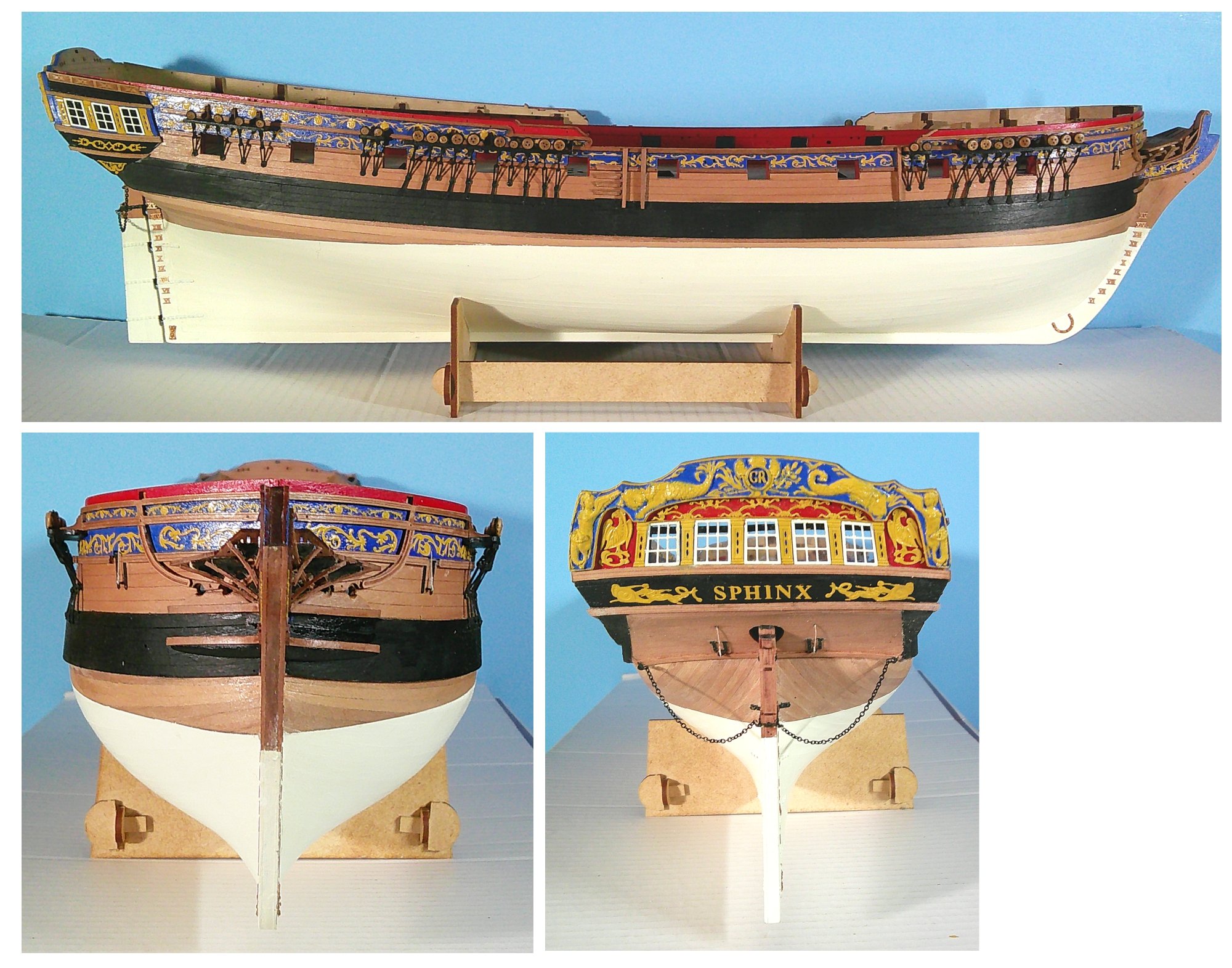

Now on to the chains.
Work on the chains has been completed except for the mizzen backstays.  It looks like these will stick up, begging to be broken off or bent, so I will wait until much later to install them.
The components of the chains are all on the PE sprue, including some extras of each:
1. Strops
2. Mid Links
3. Toe Links
4. Backing Links (AKA Preventer Links)
5. The method I used to determine the angles of the link assemblies.
Here is a photo of the starboard main chains:
And here is a shot of the finished chains:
