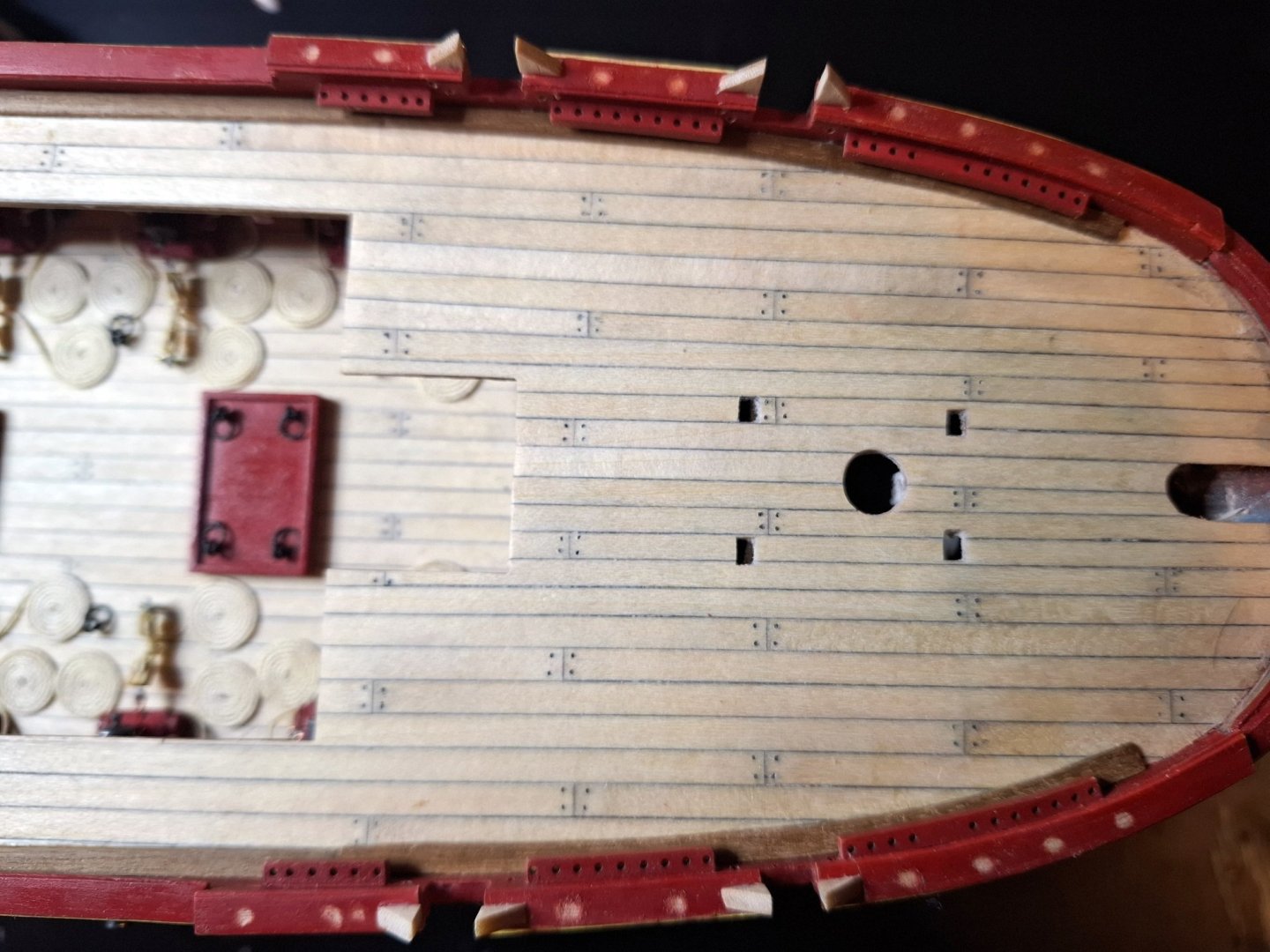

Feeling excited about completing the upper deck planking, I wanted to speed up the process. So, I decided to finish Area A first before continuing with the rest of the deck. After taking numerous measurements, I was confident that all the planks were properly aligned. However, in the end, I realized there was a 2mm gap error. With little I could do to fix it, I had no choice but to remove all the planks from Area A.
By placing an alignment plank, I can get a clearer view of the corrections needed in Area A
A top-down view shows that everything looks fine nowHULL79.thumb.jpg.d2abfc4a1f7ba012caa0c2dea7c266c7.jpg

Some planks in Area A have been trimmed to ensure full alignment with the main deck planking pattern, following the rule ofHULL80.thumb.jpg.42ac583eca159e3e190280565cb45849.jpg
I have made treenails as previously described during the main deck planking process.

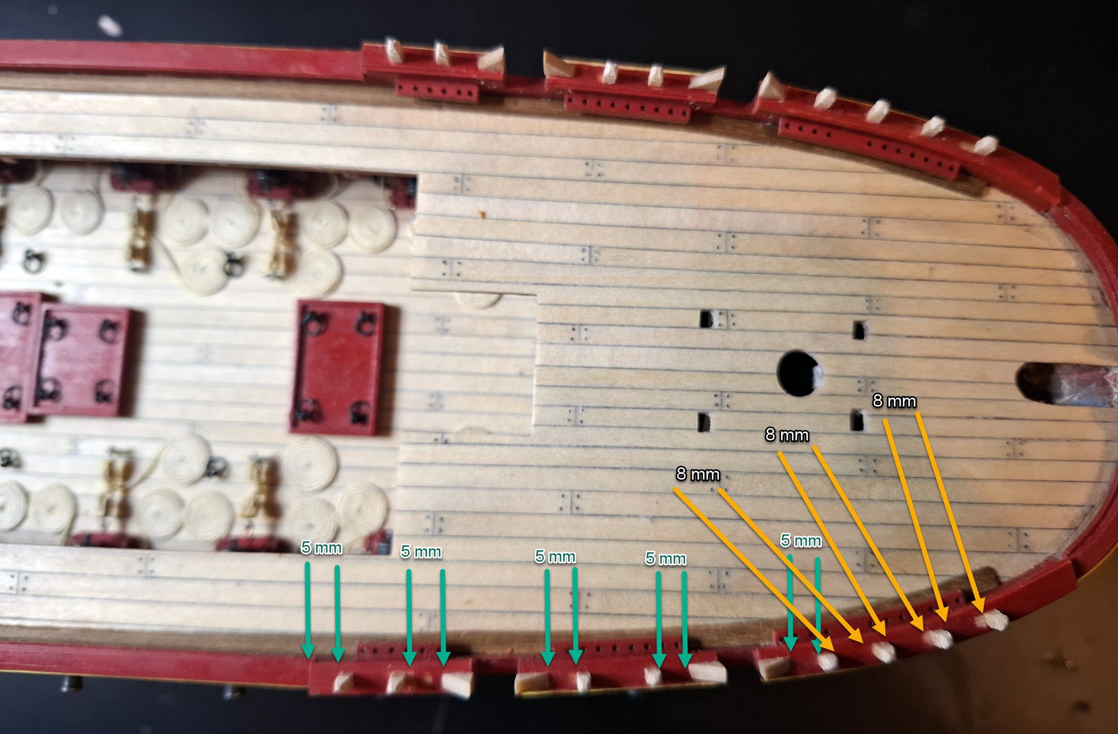

The hull rails and other deck elements have been marked and prepared for painting
Markings are in place for the foremast fife rail installationsrails02.thumb.jpg.38717d4d08261012b7c196374ae8bb5b.jpg

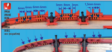

Here are the measurements for Artessania Instructions displayed in the picture below, but I have chosen to use different figures.
The next task is to repaint the deck rails to fix any deterioration
