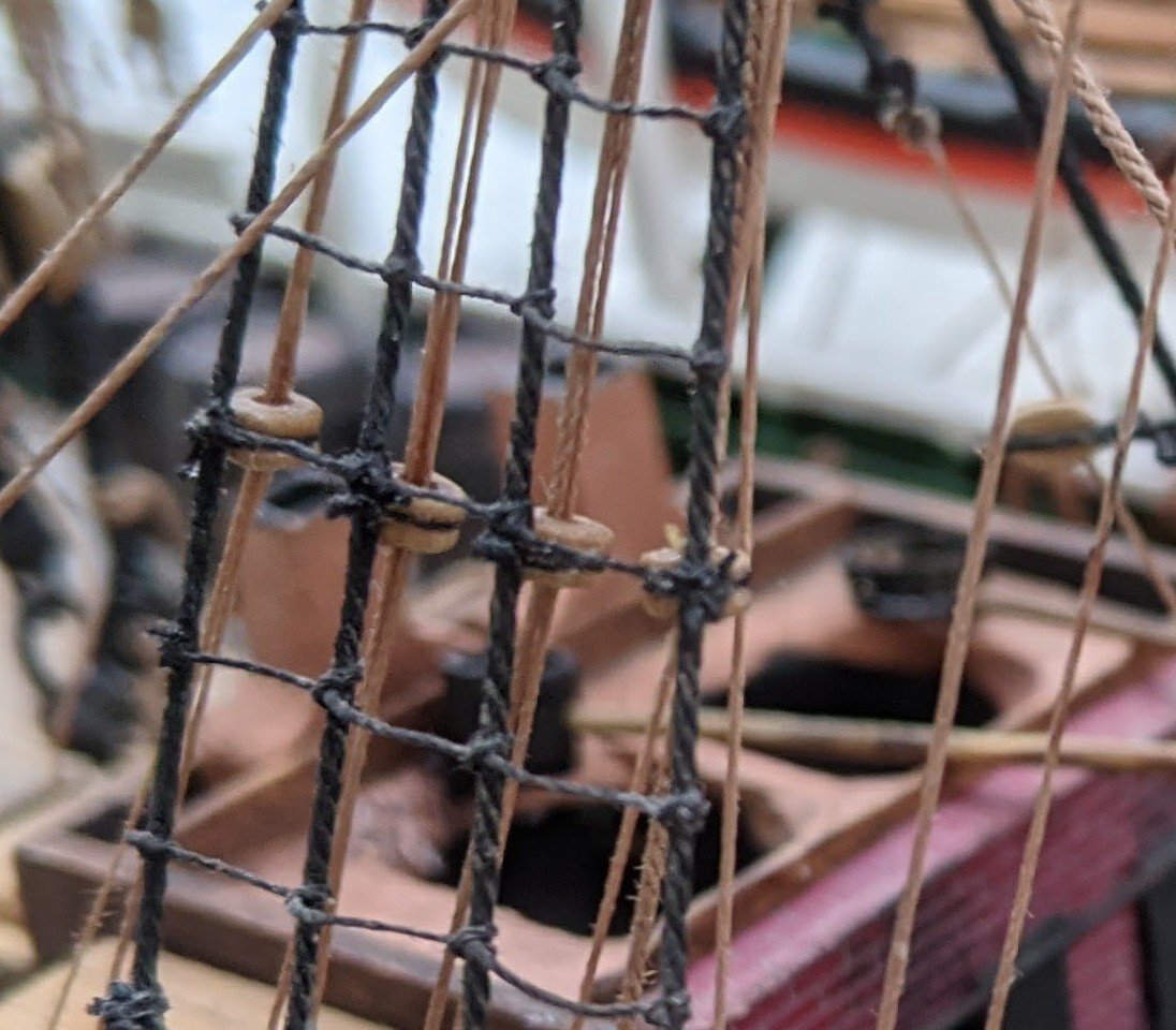

Looks fantastic. Are you planning on rigging the cutting in tackle? If yes, get that in before you get too deep into the braces and running rigging. It's a tough enough rig with nothing in the way. Hope you have fairleads drilled in the fore top if you're going to run bunt and leech lines. It's going to get crowded up there. Don't forget the fairleads on the front shrouds as well. I used bulls eyesKC7bullseyes.jpg.4cf1b67c9e90bb65afe3cb97fcce920e.jpg

Richvee. At this point I plan on doing the cutting tackle. Some of the bunt and leech lines aren't necessary without sails. Aesthetically it looks better with them, not sure how much I'll add at this point. It's starting to become a slow frustrating process interpreting the rigging plans.
Thanks for the tips!
