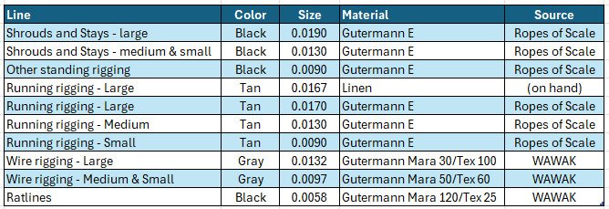

But I have done some work on the model. I finished my research of the sizes of standing and running rigging lines, using several sources, including:
          Horst Wessel (now USCGC Eagle) blueprint that I discussed previously;
          Underhill's Masting and Rigging the Clipper Ship & Ocean Carrier;
          Rigging spreadsheet at Model Ship World for size of blocks and diameter of ropes;
          Lloyd’s standard specification for standing and running rigging; and
          Size of lines used by a few other modelers for model ships of similar scale to mine.
After factoring all the data from the various sources, I have selected the following thread sizes and sources for the various standing and running rigging:
My selection of the black and tan thread sizes was driven in part by the selection of dark gray thread from WAWAK for the wire running rigging. WAWAK has several sizes of Gutermann Mara threads, but not all of them come in dark gray. Once I found two sizes that were acceptable, I selected sizes for the black and tan threads from Ropes of Scale, keeping in mind that the dark gray threads, representing wire running rigging, should be smaller than their corresponding fiber running rigging. And the black threads for the standing rigging (also wire on the real ship) should be similar or a bit larger than the running rigging.

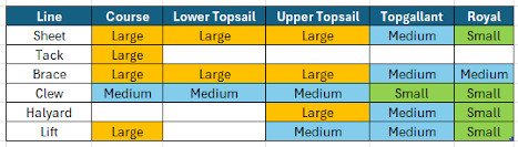

I summarized the relative sizes of running rigging lines for the square sails as follows:
For simplicity, I have decided not to model buntlines or leach lines, and I’m still on the fence regarding whether to model no sails or furled sails (I’m leaning towards the latter).

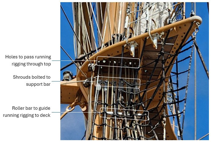

The tops on the Eagle's fore and main masts are made of metal framework with wood planks on the upper surface, as shown in the below picture.
Highlighted in the picture are:
      1. Holes in the planks to pass the running rigging (both wire and fiber rope) from above (similar to lubbers holes on 19th century and earlier ships)
      2. A roller bar (behind the shrouds) to guide the running rigging down to the deck
      3. Shrouds bolted to a support bar
Other items visible in the picture are the four futtock shrouds, and the turnbuckles for the topmast shrouds that are attached to the tops of the futtock shrouds as they pass through the metal framework and planks.
The top on the mizzen mast is similar but smaller.
I'm developing a plan for modeling the key features of the Eagle tops using brass sheet metal for the metal pieces, and wood veneer for the planks. More on that in an upcoming post.

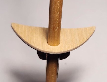

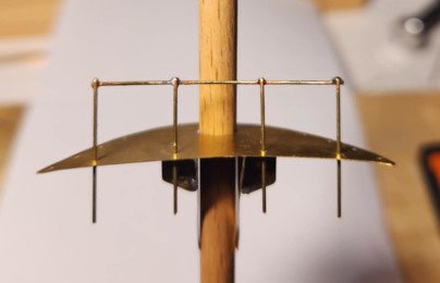

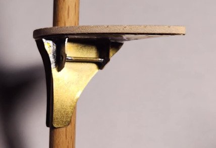

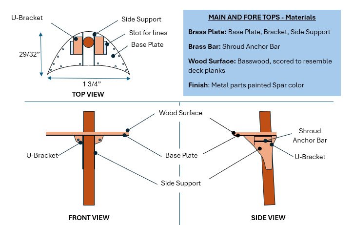

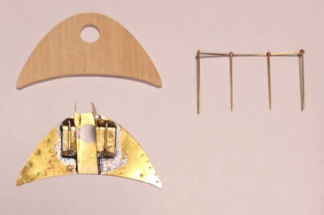

As noted previously, the ship's tops are constructed of metal framework with a wood plank surface. After considering several ways to model the tops, I settled on using brass sheet metal for the base plates and side supports, thicker brass metal for the U-bracket, and basswood on top. My plan is shown below:
I needed a way to anchor the main and fore shrouds underneath the top surface, and it needed to be strong enough to withstand the pull of the shrouds when they are pulled taught. After forming the U-brackets and filing their profiles as shown in the front view, I soldered the U-brackets to the port and starboard sides of the the base plate bottom, then soldered the side supports to the base plate and U-brackets, followed by soldering the anchor bar through holes in the U-bracket. I drilled a small hole for the mast opening, just enough to use a round metal file to enlarge it to just fit the mast. Same with the wood surface. I also drilled holes in the base plate for the upper ends of the futtock shrouds to pass through the top and as anchor points for the topmast shrouds. Holes along the back edge of the top are for a safety railing, on which is fastened rope netting on the ship.
I was originally going to use wood veneer for the wood surface, but I found that it wasn't stiff enough to make a rigid structure (the brass sheet has a lot of flex). So instead, I used 1/16" basswood, and to simulate planks, I scored the top surface using a blunted straight pin along a ruler, following several suggestions and techniques I found online.

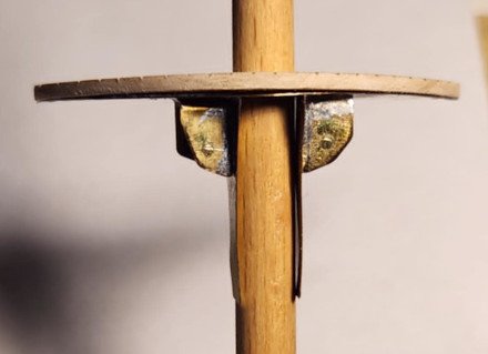

Below are pics various view of the base plate/bracket assembly, wood surface, and railing, test fitted to the mast. I'll clean up the solder resin before painting the various parts (railing is white, all other metal parts are spar color). I'll also stain the wood surface to resemble the wood on the ship, and paint the edge white (as it was in 1972 on Eagle).
I haven't glued the wood surface to the base plate yet. Once that's done, I'll drill through the holes in the baseplate through the wood surface. I'll also drill and file the slots for the running rigging at that time. The railing bottoms will be cut flush with the bottom of the base plate at final assembly.
top_5_adjusted.jpg.1ada8385976935a7f2e426231ded740e.jpg  top_6_adjusted.jpg.51282990b5586637144be39648c26187.jpg
top_9_adjusted.jpg.86df679f2e71c163ec936147339a99b9.jpg   top_8_adjusted.jpg.345c139d25b539d27768512abe4db716.jpg
When I (eventually) get to mounting the masts to the ship's deck, I'll tie the shroud threads to the shroud anchor bar and seal with a touch of CA, and leave the ends long until I'm ready to fasten the lower ends to the turnbuckles attached to the deck. Then I'll add the futtock shrouds, since once they're installed, it will be hard to reach the shroud anchor bar.

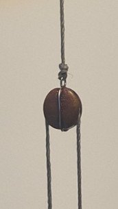

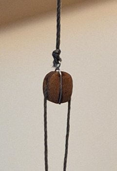

Since the Eagle uses internally stropped blocks, I wanted to replicate that to the extent possible. I looked at the iron stropped blocks from Bluejacket Ship Crafters, but they don't have the wood look that I want. And I didn't find any other sources for stropped blocks in the sizes I need (3mm, 4mm, 5mm) So recently I purchased several sizes of Syren blocks, and quite a long time ago I purchased one size of MS Beautiful Blocks, with the intent of using wire instead of thread/rope to strop the blocks.
Below are photos of several 4mm blocks stropped with 32 gauge stainless steel wire. The top row is MS BB blocks, and the bottom row is a Syren block. The two on the top left are an attempt to make both a top eye and a bottom becket (I used the wrong size wire, 28 gauge, for the becket on the left block, and all wire on the second block).
FourBlocks_cropped.jpg.fe92172b6532358e1e92a3ae157df46e.jpg      FourBlocksSide_cropped.jpg.4653e37b8e999a8adbd03639591657b7.jpg
Below are two 4mm blocks, MS BB on the left, Syren on the right, temporarily rigged with thread (not made into rope, so forgive the frayed ends).
MSBB4mmRigged_cropped.jpg.a5b0c94478614fb5fdd25db3591d4b74.jpg    Syren4mmRigged_cropped.jpg.a9aaf20a59bbe1e6da477709bf7aa06f.jpg
 In general, I found it easier to strop the MS BB blocks because the block face is flatter, and the groove is deeper, than the Syren blocks. I also did some tests with Syren 3mm blocks, and stropping them was quite a bit more difficult than the 4mm blocks. In all cases, I used some CA on the sides and bottom to hold the wire in place. I found that the color on the Syren blocks bled a bit into the CA, and turned it red. I probably used too much CA.
I'm leaning toward the MS BB blocks for several reasons. I think the look of the real wood and flatter face matches better to the Eagle's blocks. Second, the best way I found to make the beckets is to drill into the bottom of the block and insert and CA an eye with a twisted stem, which was more difficult with the Syren blocks. Finally, it was easier overall to strop the MS BB blocks than the Syren blocks.
