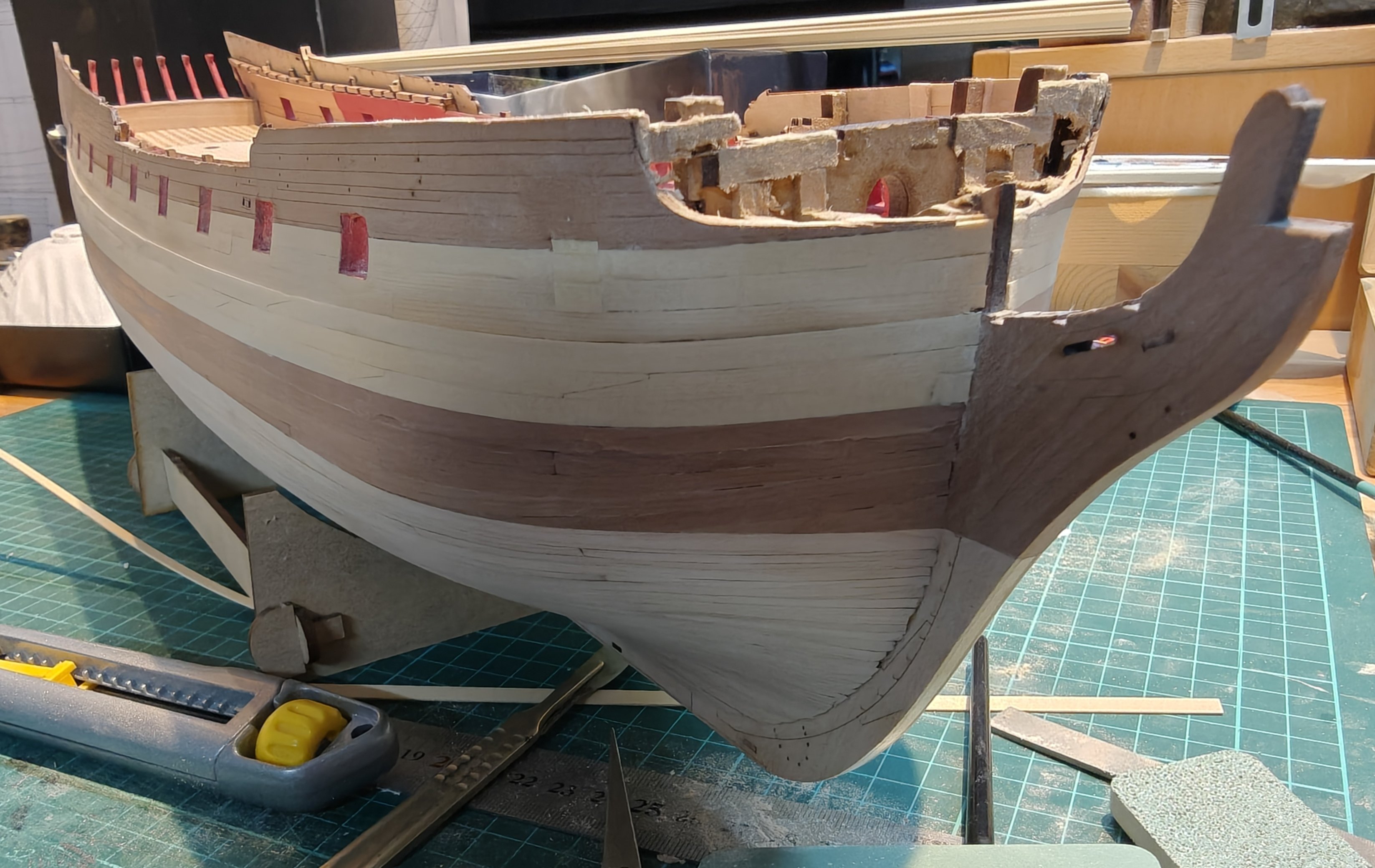

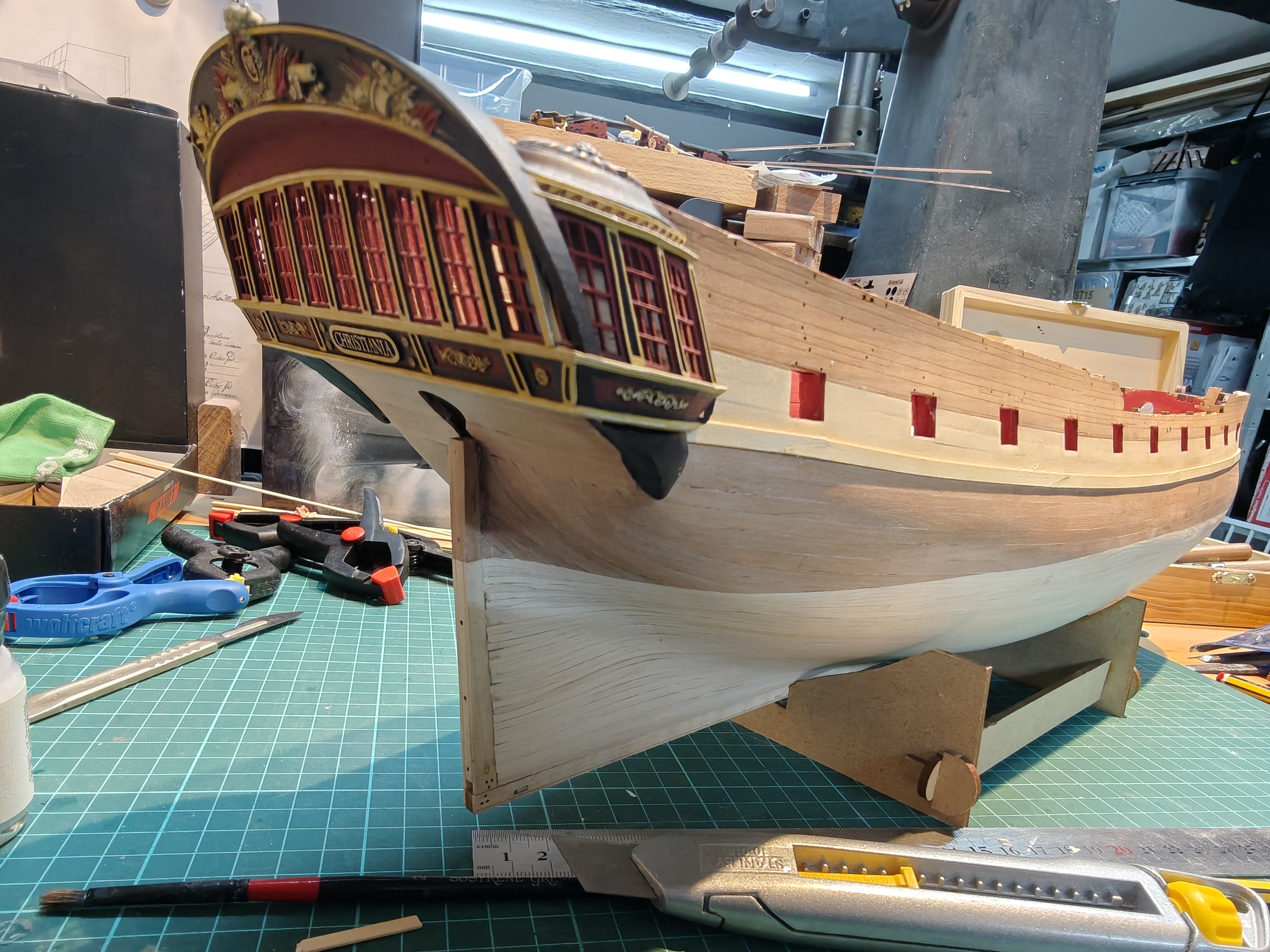

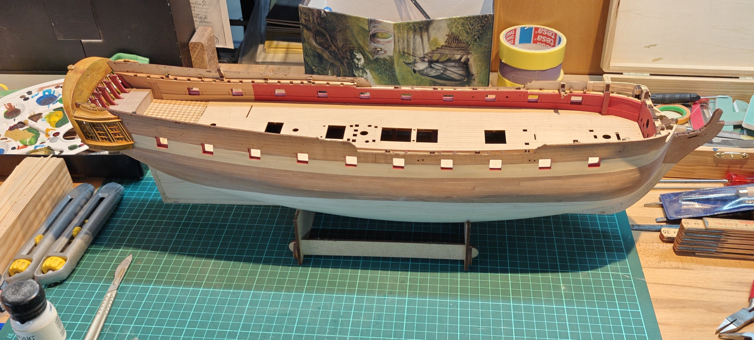

My original plan was to have a colour scheme like this:
Screenshot2024-09-17at19_51_16.png.967c5f5222069369450648219c357858.thumb.png.b88a23ebd845b3afa726cc0cbdcdda17.png
This looks like two thin wales, painted black, which was the norm up until at least the 1720's or 30's. But i have become aware of the way the wales were made later in the 18th century that you point out, and it makes it difficult to decide what to do colour wise.
As mentioned in this post, I am not sure I like the look if I continued the yellow cedar on the wale part. Though that may be the more realistic option!
This is also the way the model of Gerner's Bornholm is depicted:
However, I would like to keep as much of the hull natural wood as possible, so I would like to avoid painting the area between the wale and the waterline black, though this would probably be the most realistic.
Instead I looked towards another model, of the hukkert Amager:

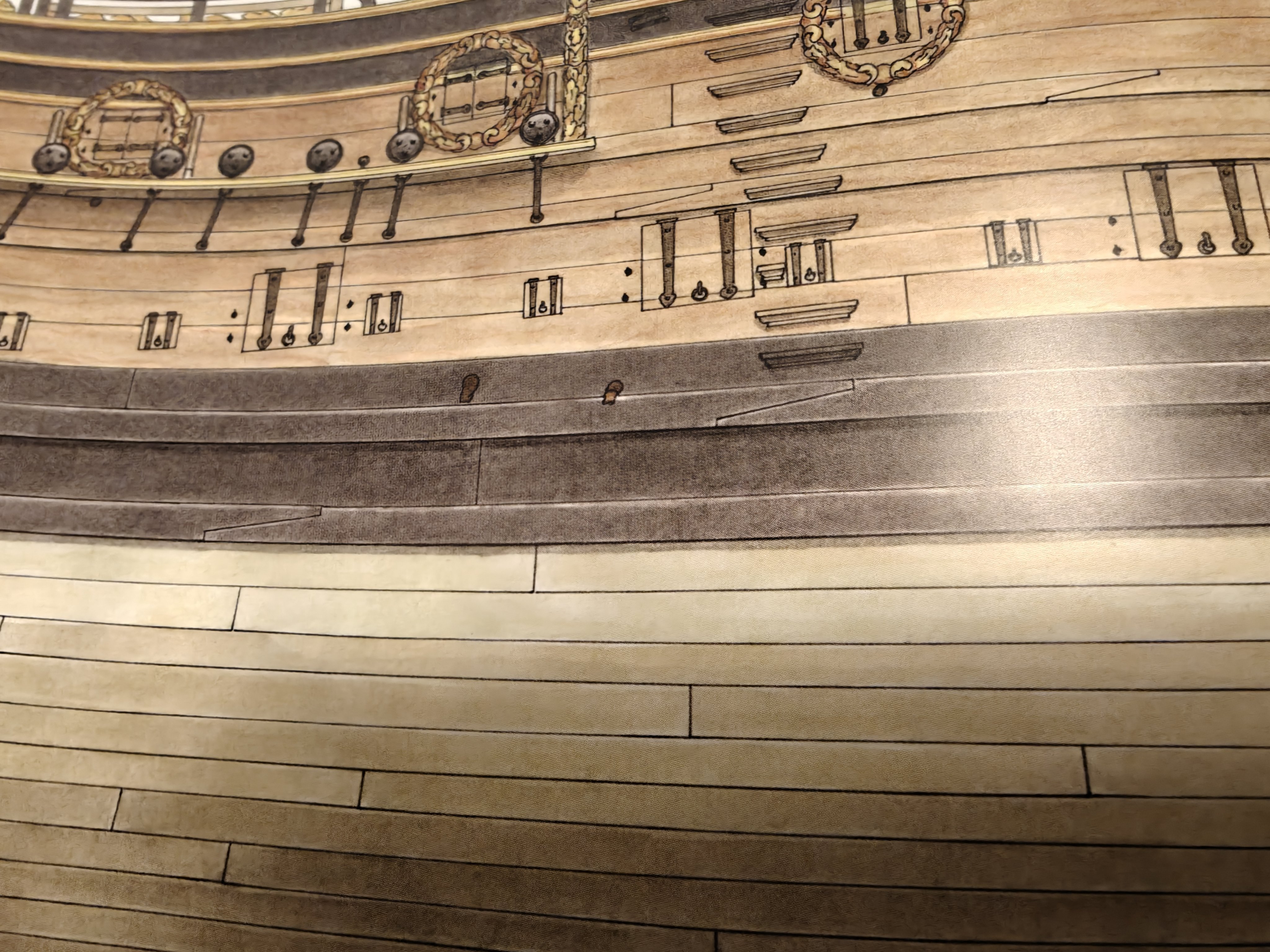

This shows the black double wale, it is a ship by Krabbe like Christiania and the original drawing shows the same wale, blended into the planking:
But I admit that I am not being consistent here, and that balancing the historical accuracy with the wish to show as much wood as possible is getting me into trouble!

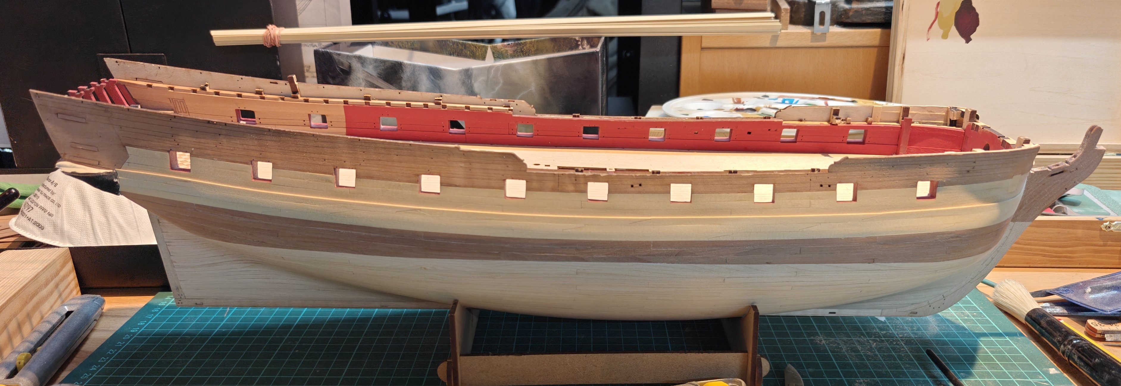

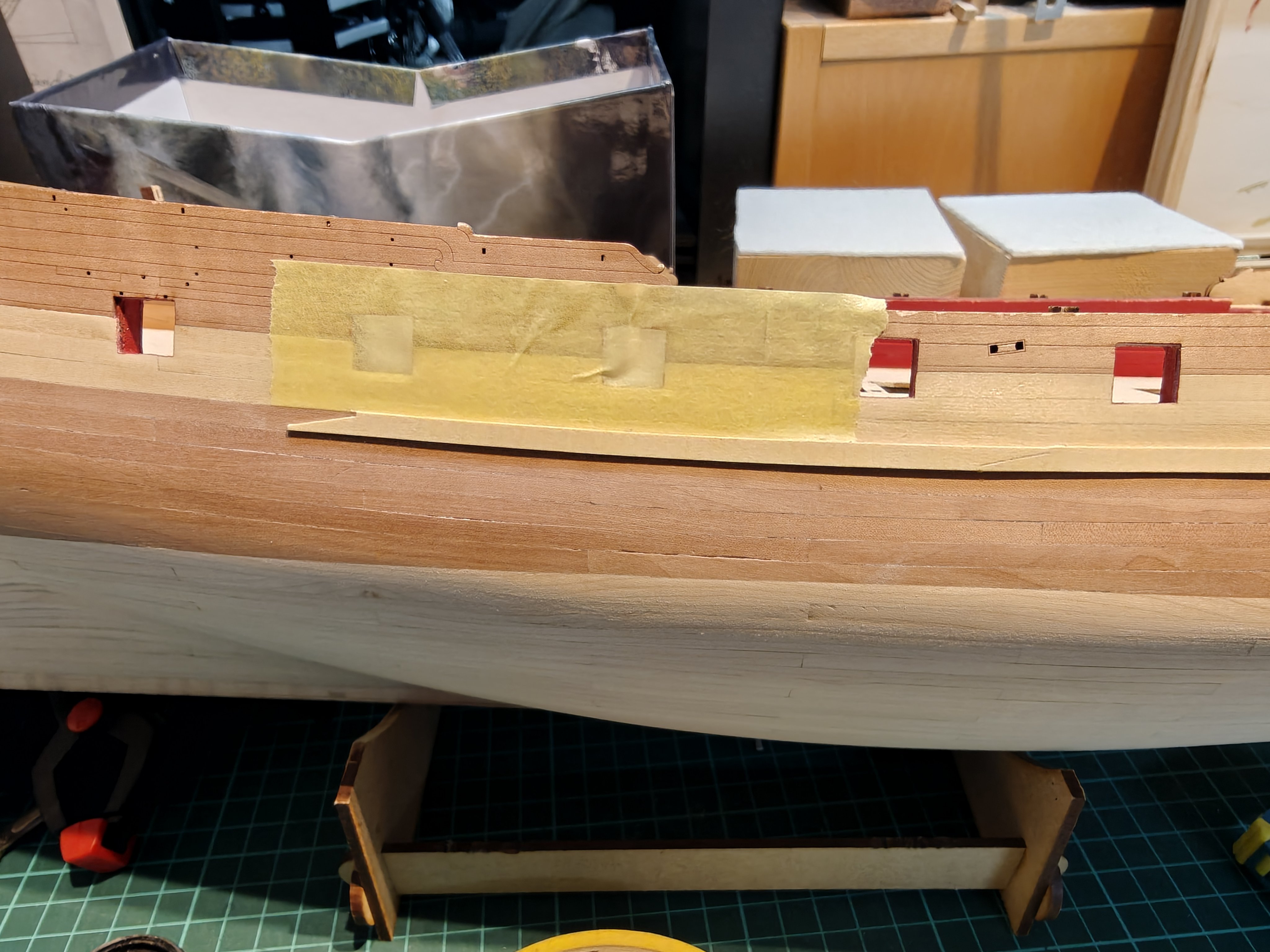

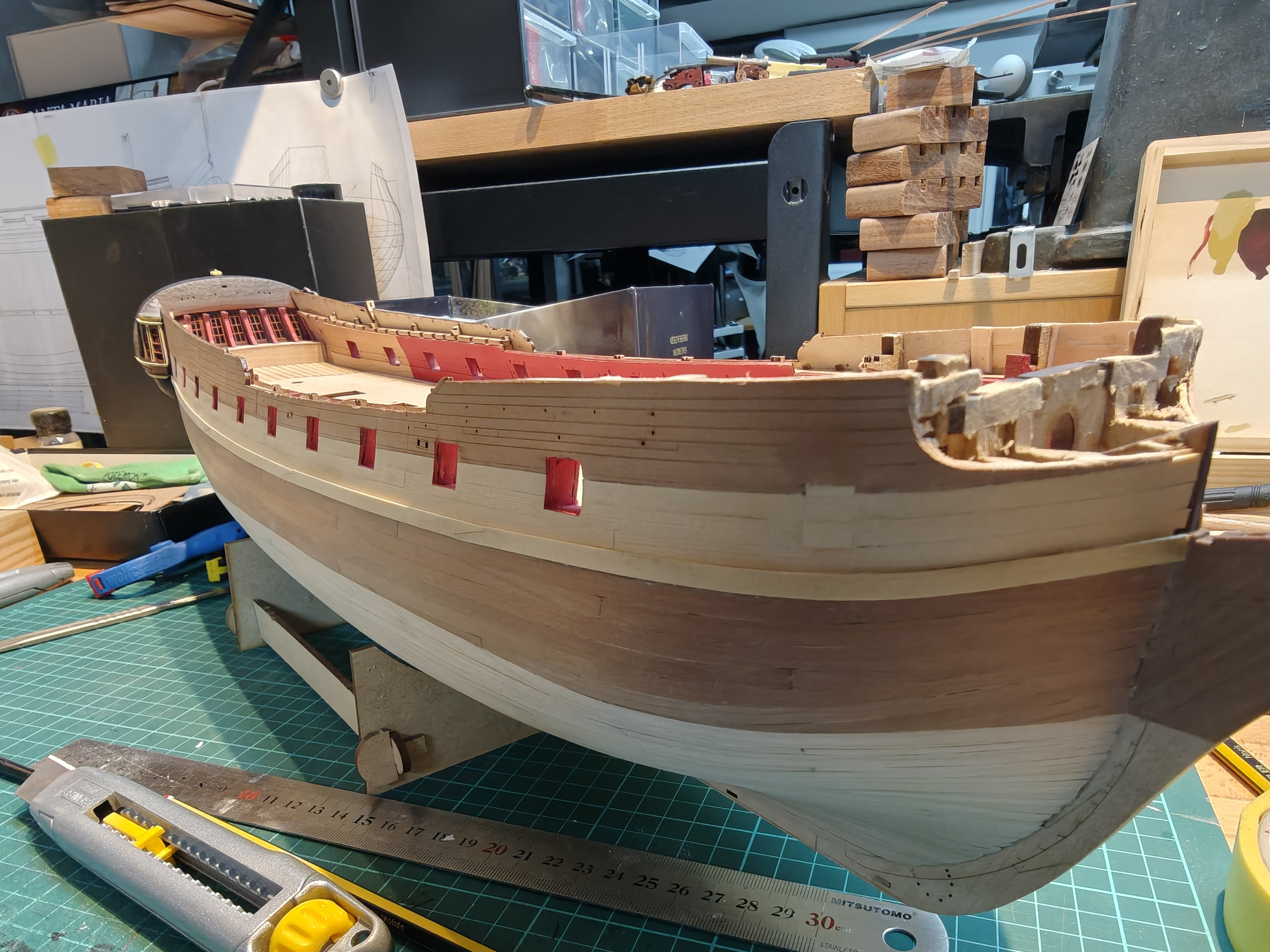

I am seeing a number of options here:
1) continue as planned, two thin wales painted black. It will look good, but will not be accurate for the time period - a bit of a pitty!
2) add three wale stakes in pear and blend it into the hull, no black paint at all. I think this may look a bit unfinished? And it might be difficult to get a nice transition when blending the lower part - I could leave a smaller ridge there as an easier transition.
3) add two or 3 yellow ceder and one pear plank as wale, and blend it into the hull. This would have the pear represent the part that is painted black, between the wale on many several depictions, incl. the Bornholm model.
4) build the whale from yellow cedar, blend it into the hull, and paint the area between the main wale snd waterline black. This is probably the most realistic, but it paints over the nicest part of the pear hull planking 😅! And this is what I wanted to avoid!
It might have been better if I had planked the upper part either entirely in pear or yellow cedar, but I am not ripping it off now! I will have to find a solution based on wale planking and painting.
Any suggestions, both on opinions on the above, or on other suggestions for a solution, would be much appreciated!
