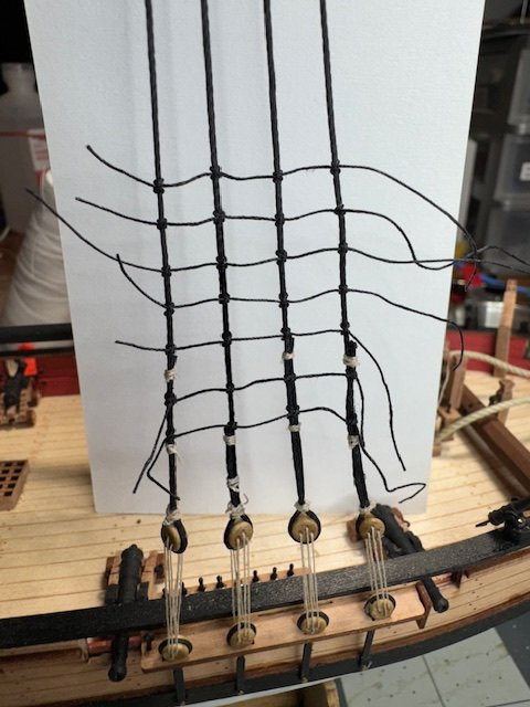

Just a quick update today.
First, my 50-50 glue seems to be working better so far. Maybe my previous attempt was too thick to really soak in or something. I'm keeping my fingers crossed.
Second, I started putting together some blocks for the backstays. My first try was with some wire I had, but it ended up out of scale and looked awful anyway. I'm switching to using some dark "rope" instead.
And now that I see the picture, I realize I got the blocks in the wrong order there! Oh well, I'll try again tomorrow.

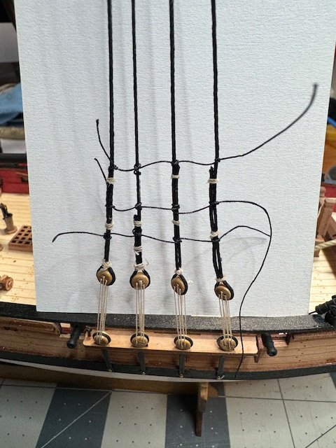

I watched some YouTube videos on how to tie clove hitches, and that was a *big* help! I can tie them a lot faster than I had been doing, too.
The clove hitches don't really want to stay tied if there's not tension from both sides, but I might have found a workaround. I soaked some thread in dilute glue and hung it to dry with a weight on the end, then used that for my ratlines. It stiffens the thread a bit, enough to make it easier to work with and hopefully less likely for the knots to try to spring open.
