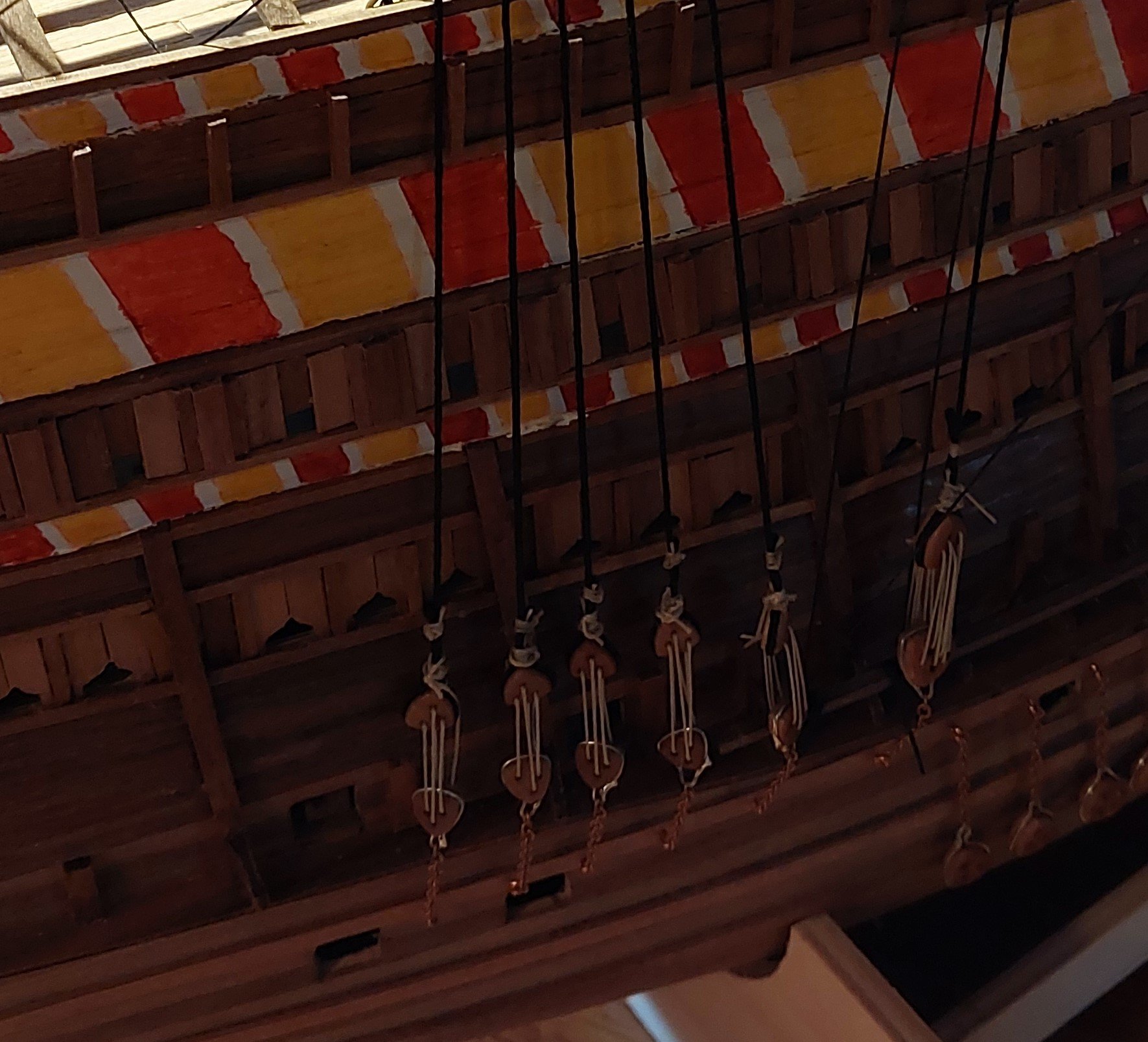

I tied the blocks in place for the tackles - these are on the foremast, but I've also put tackles in place for the main and mizzen mast. None on the bonaventure, as Anderson's book omits any info on that, and it seems like it was quite a small mast even on the Mary Rose.
Here's the tackles set up on the foremast:
It seems like most models (and likely most real ships) attach their tackle hooks to eyebolts on the channels. I've hooked and lashed mine to the belaying rail, at least on the forecastle, as there's really not much space around it for an eyebolt. That said, I've got a whole bunch of spare eyepins, so I could change this if there's a notable outcry. There's still enough room on the belaying rail to belay the yards to, so I don't foresee this being a major issue.

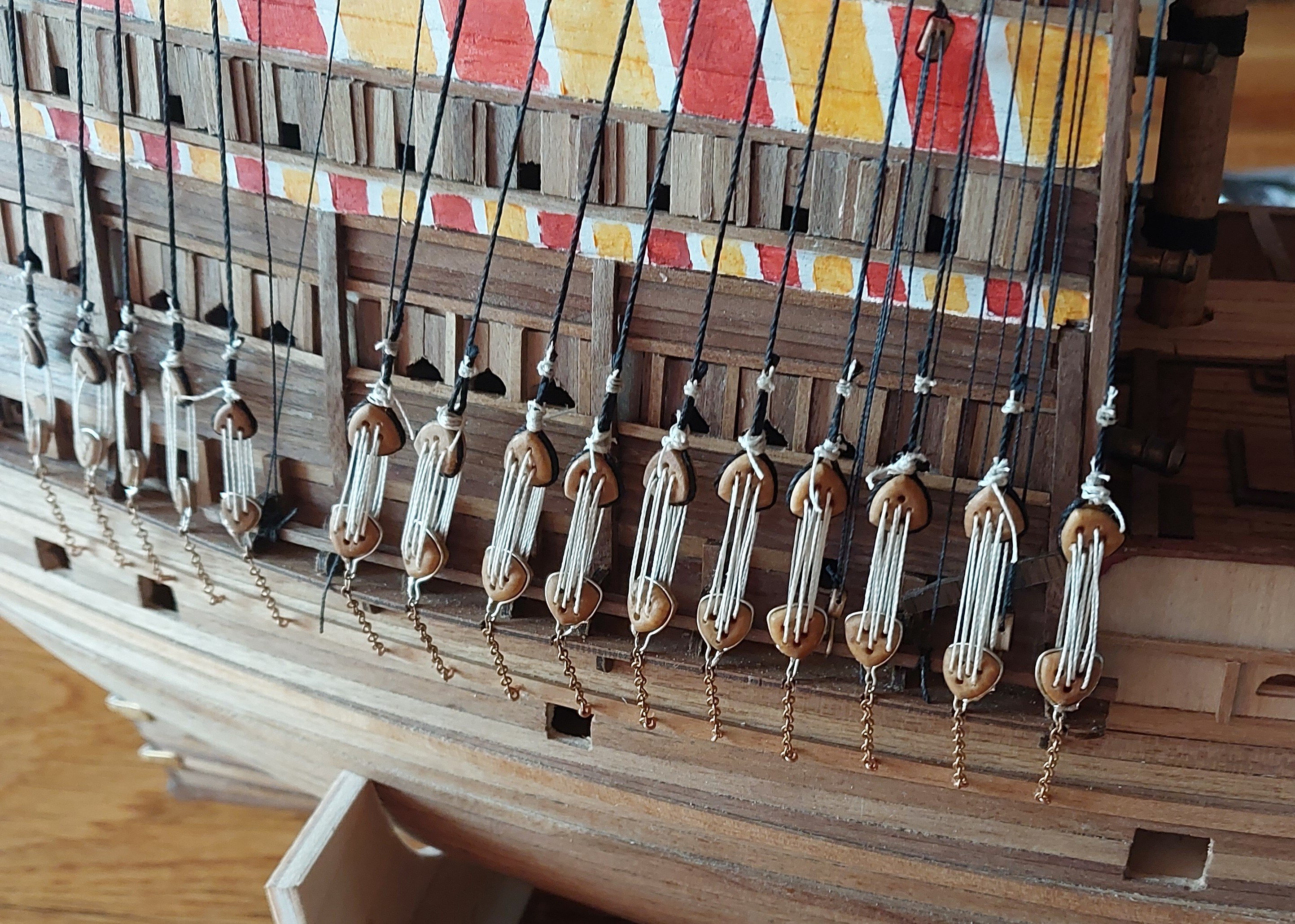

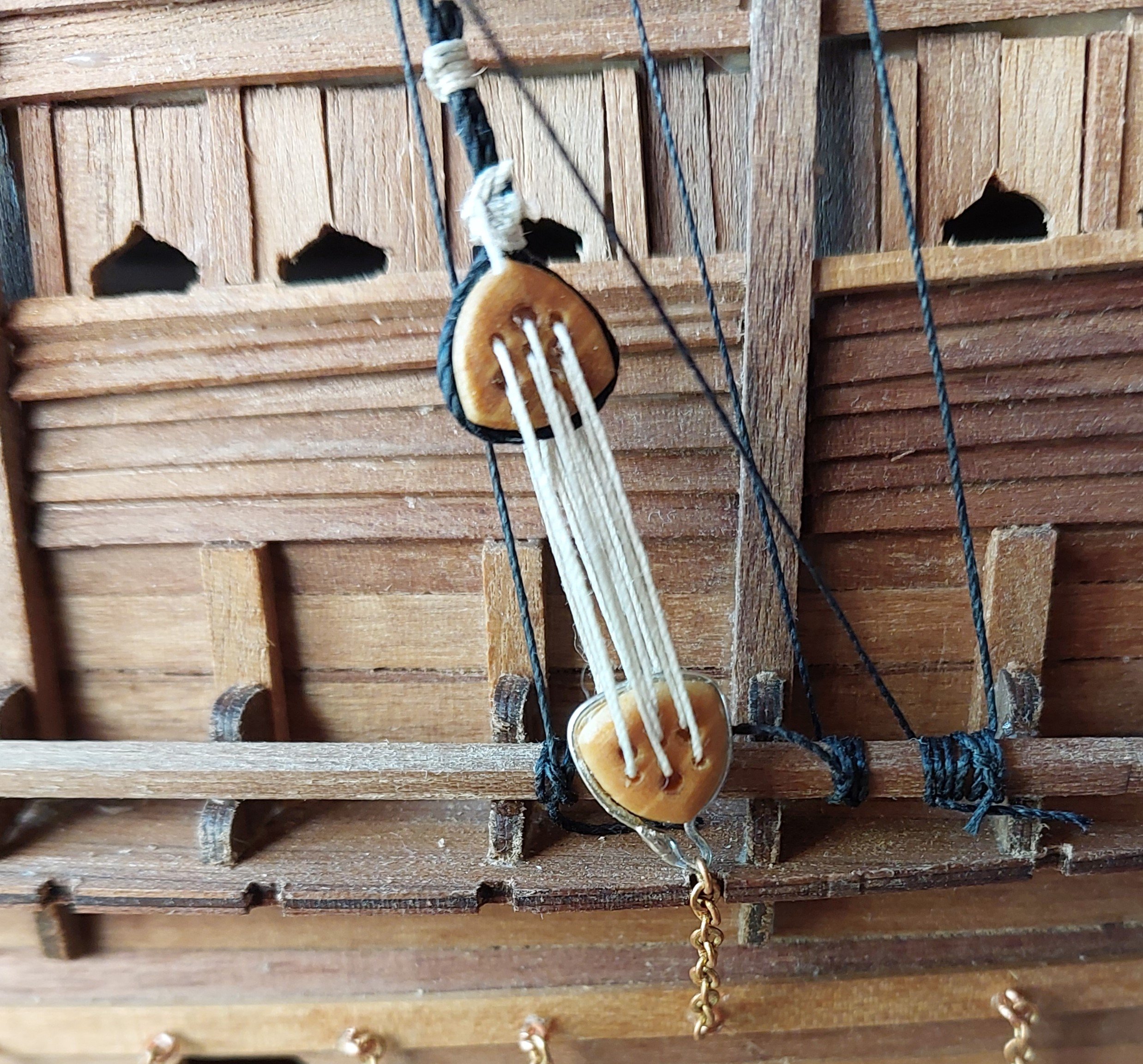

Here's the first deadeye on the shrouds. I've spaced these 2.5x the width of the deadeyes, so here about 14mm apart, using a bit of wire bent to the right distance:
And here's the first one tied off:
And then, because I was on a roll, here's the whole foremast done:
And a view of the full forecastle:
Looking pretty snazzy if I say so myself! Obviously I need to do the ratlines, and I've only done the foremast and not the fore topmast and the shrouds for that, but it's progress.

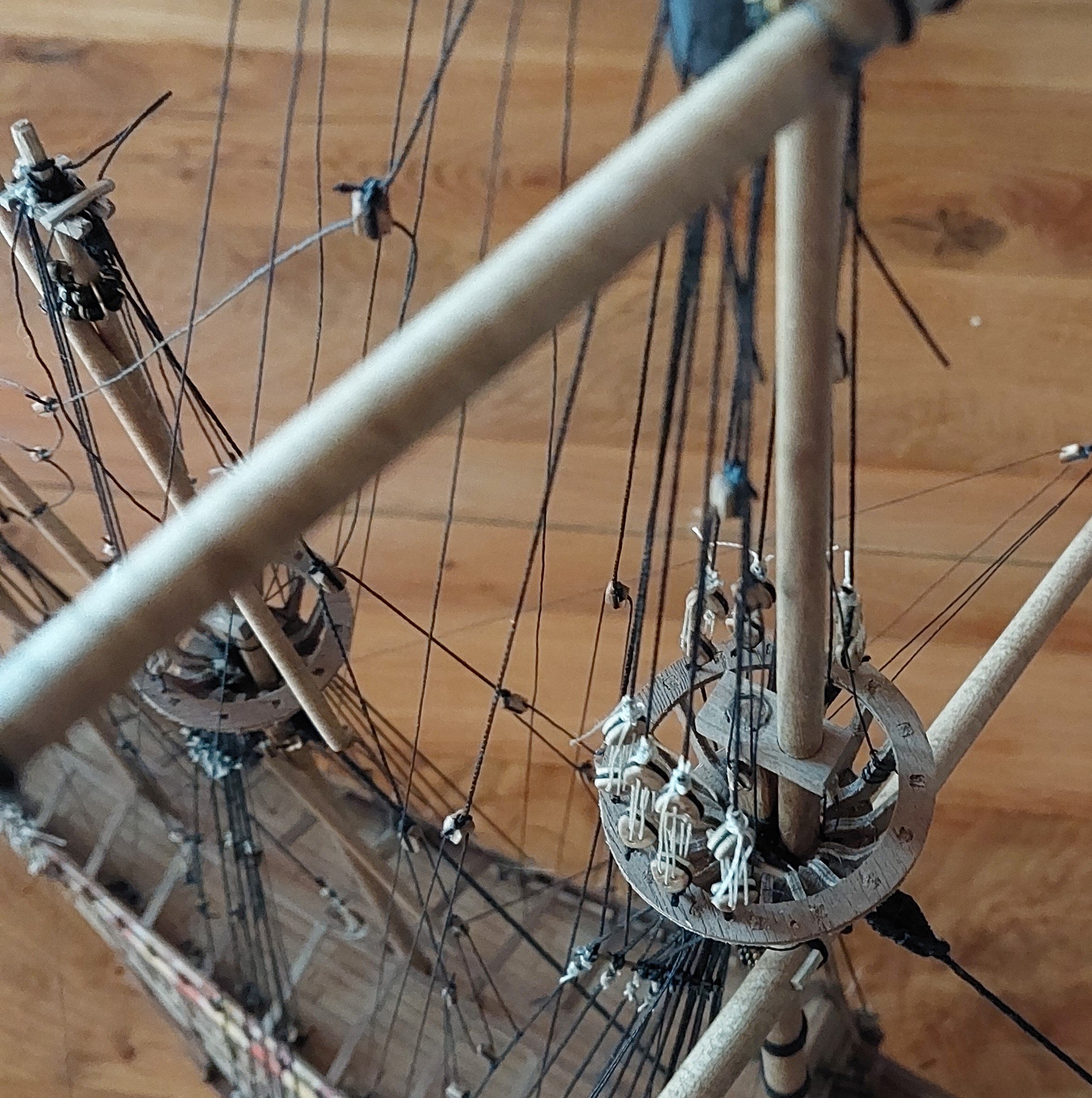

I sped ahead with the rigging after this. Here's the main yard rigged with lifts and braces:
And here's the fore yard:
(the eagle-eyed amongst you will note that I actually put the fore yard on before I completed the braces on the spritsail yard. Enjoy the narrative!!)
And after this I got the tops on:
Now she's really looking shipshape! I had a bit of a mare with these, as they wouldn't sit flat and I actually snapped the cross-trees off the main mast. Nothing a bit of glue couldn't fix...
Here's the mainmast top and main topmast, showing off the toprope underneath:
I'm belaying this off of one of the two knights on the front of the sterncastle. In hindsight, I wish I'd put one centrally and used the other for the mizzen, but they're way too attached to want to rejig at this point, and at least it's another attachment point. The toprope here was actually functional, holding the mast up, but I did end up glueing the topmast in after I popped an eyebolt out applying too much pressure - it's not like I was ever going to remove it!
Here's the main top yard with a very neat parrel if I do say so myself:
The caldercraft kit only provides 5-ribbed parrels for this job, but Anderson specifically says these only had two ribs. I simply cut some of the 5-ribbed sections into pieces, and found it so much easier than the larger parrels down below. Hopefully this will have streamlined my process somewhat for the rest.
As noted in a previous post, I've deigned not to paint my parrels black as suggested - I like the brass.

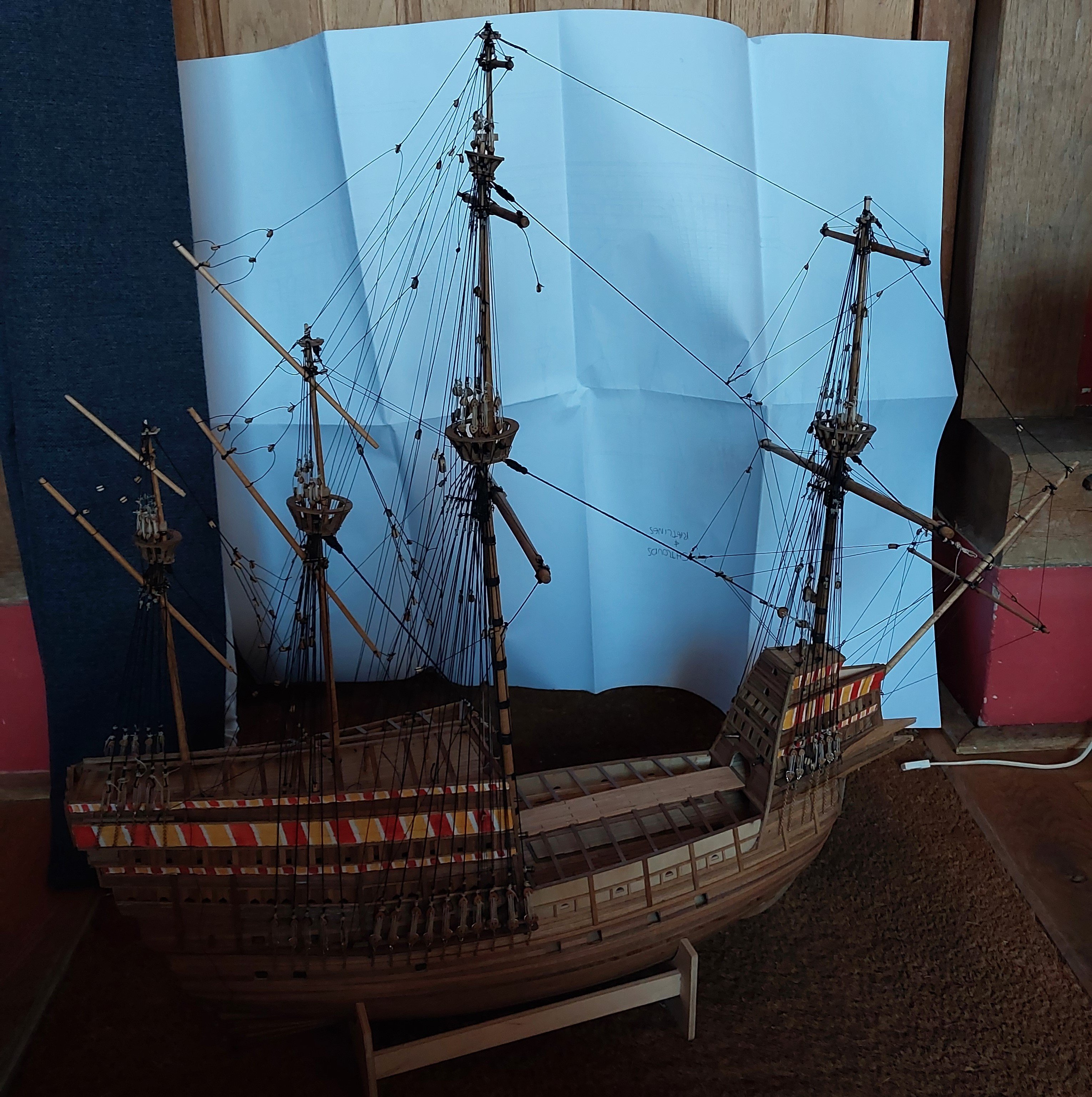

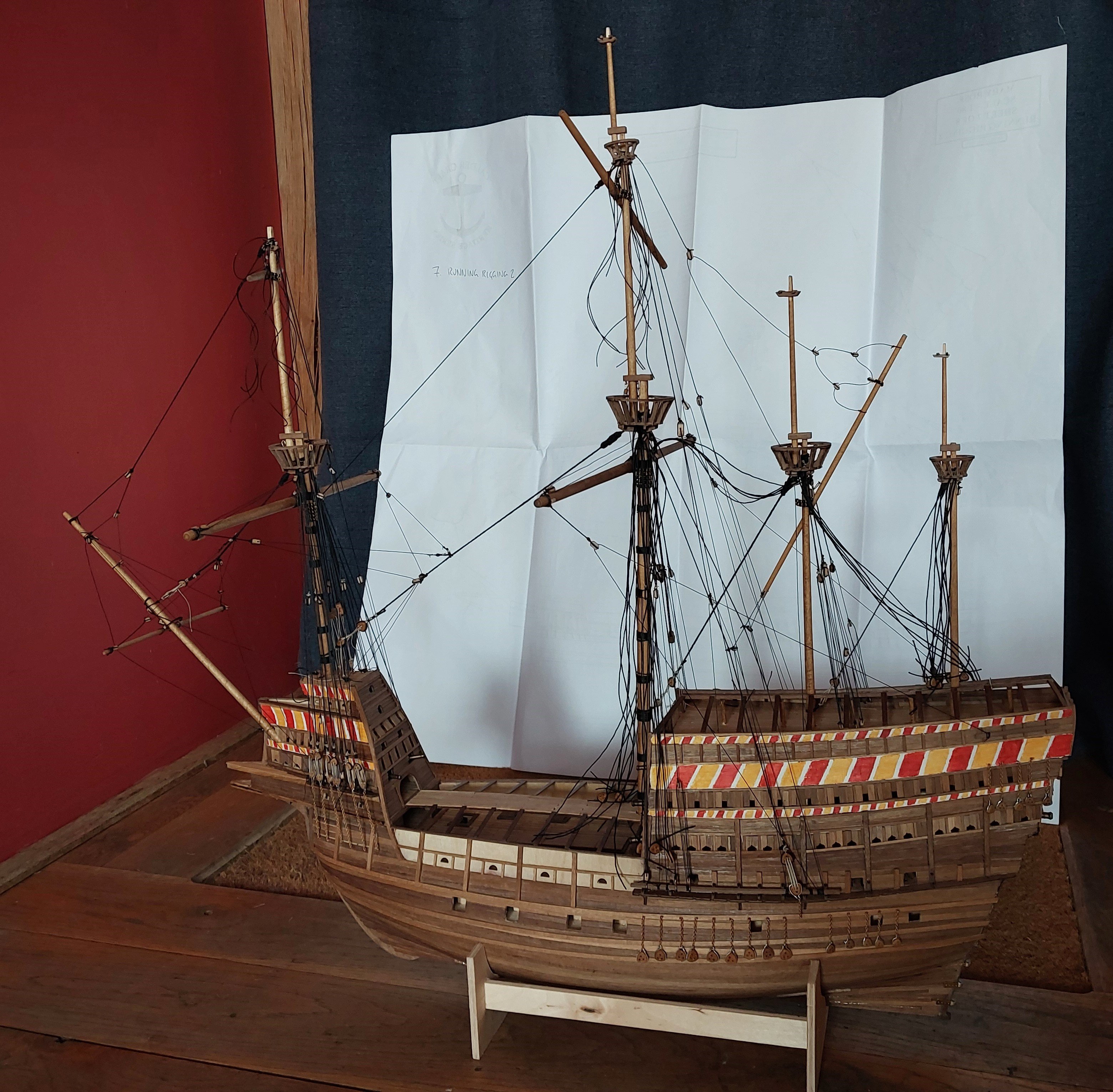

Whoops. That'll be a four month update break! Sorry all, life got in the way and progress has been slow on the Mary Rose. Developments have still been made though, between a few trips away and a new work contract (the boring parts of life). I'm going to condense a lot of the work I've done down into a few short photos as I can't actually remember the exact order some of this went on in, but the following is a summary of the last few months of steady work.
Here we go!
First, here's a full shot of the ship as she was in the first week of March. Excuse the backdrop - that's one of the Caldercraft instruction sheets.

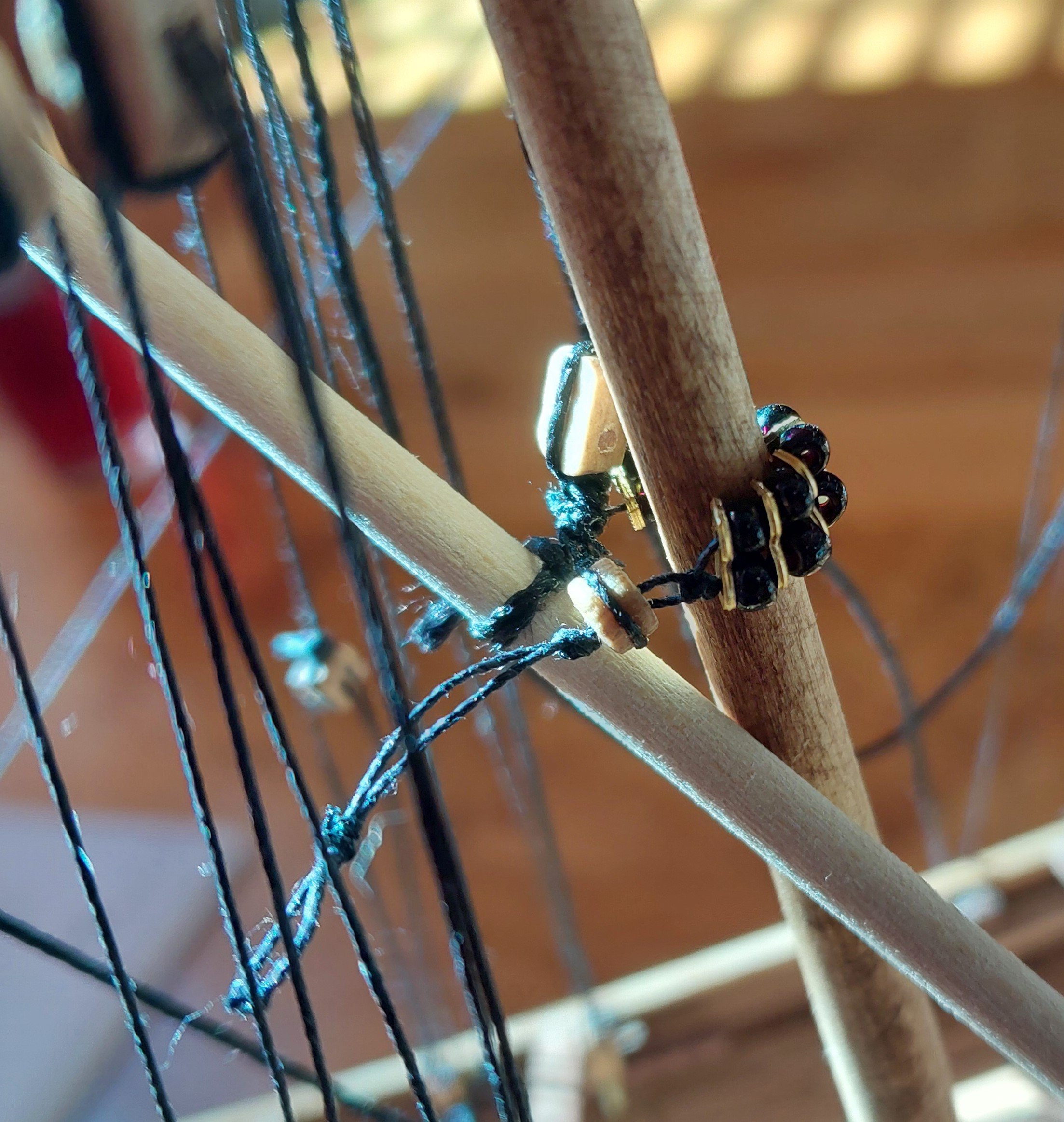

Here's some details; the parrel for the lateen yard on the mizzen, rigged following Anderson's diagrams, and the first of the 7-holed deadeyes set up on the mainmast.
20250304_115919.thumb.jpg.e957bf84f2397cec0a6a977deee9b119.jpg20250303_144533.thumb.jpg.50c634818458e0257a390332db3c8c9d.jpg
Here's the shrouds linked up on the mizzen:
And here's the whole line of mainmast shrouds tied down:
Honestly this was one of the main factors in the slow update - I completely burnt myself out tying these, and whilst the process was satisfying I'll be happy not to have to tie another deadeye in place for some time!
But it's so nice and neat now they're all tied down. So much less spaghetti mess!

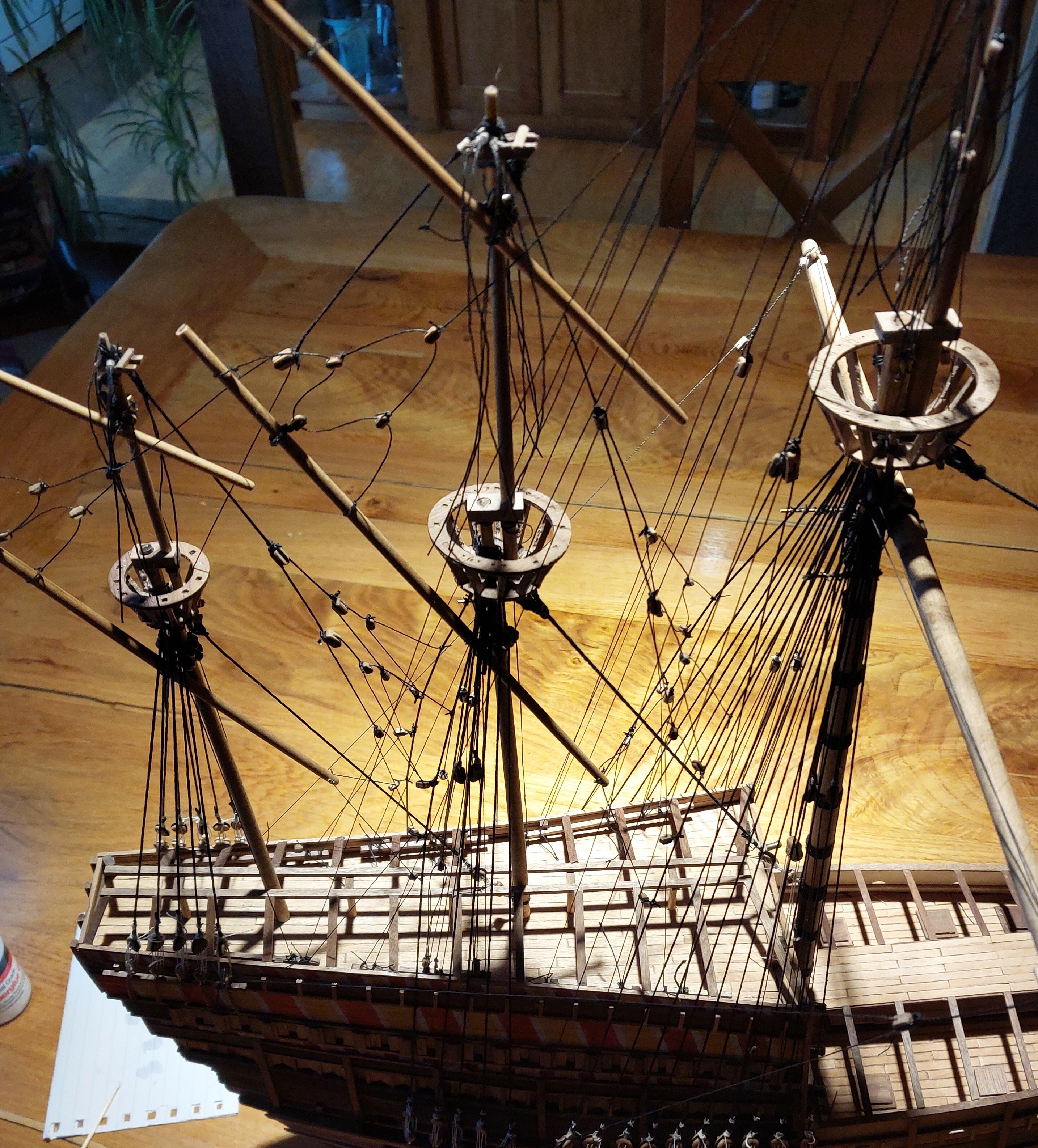

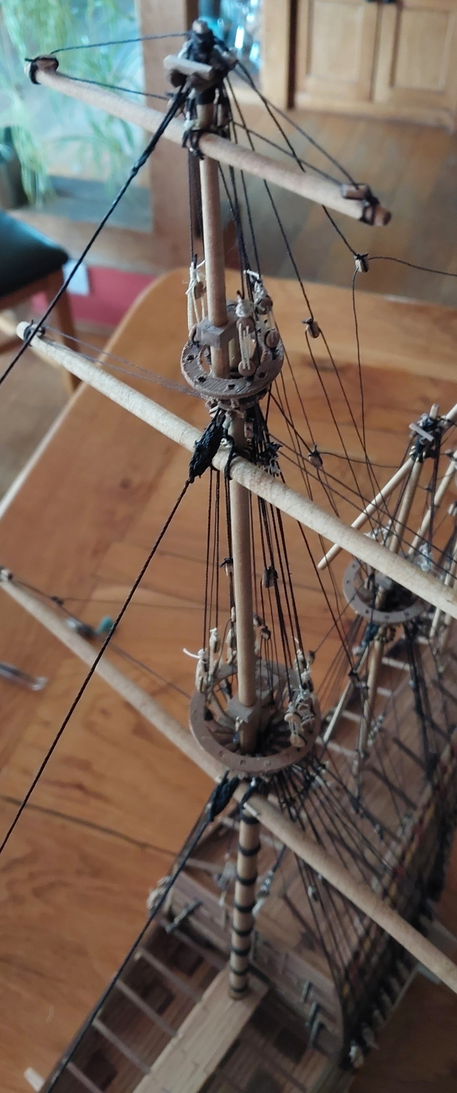

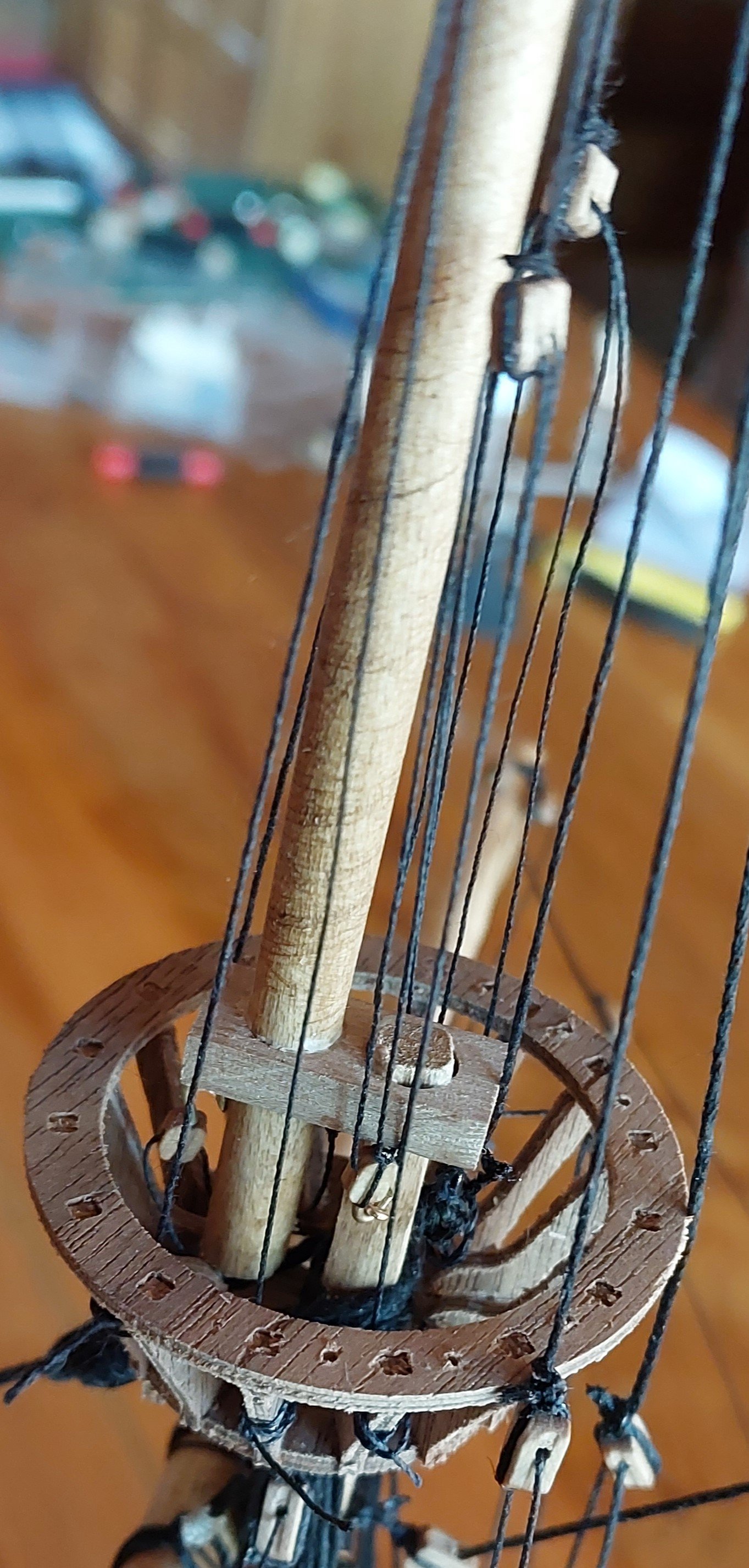

Looking much better. Now on to the topmasts. Take note of the plaque in the background please - more on that later.

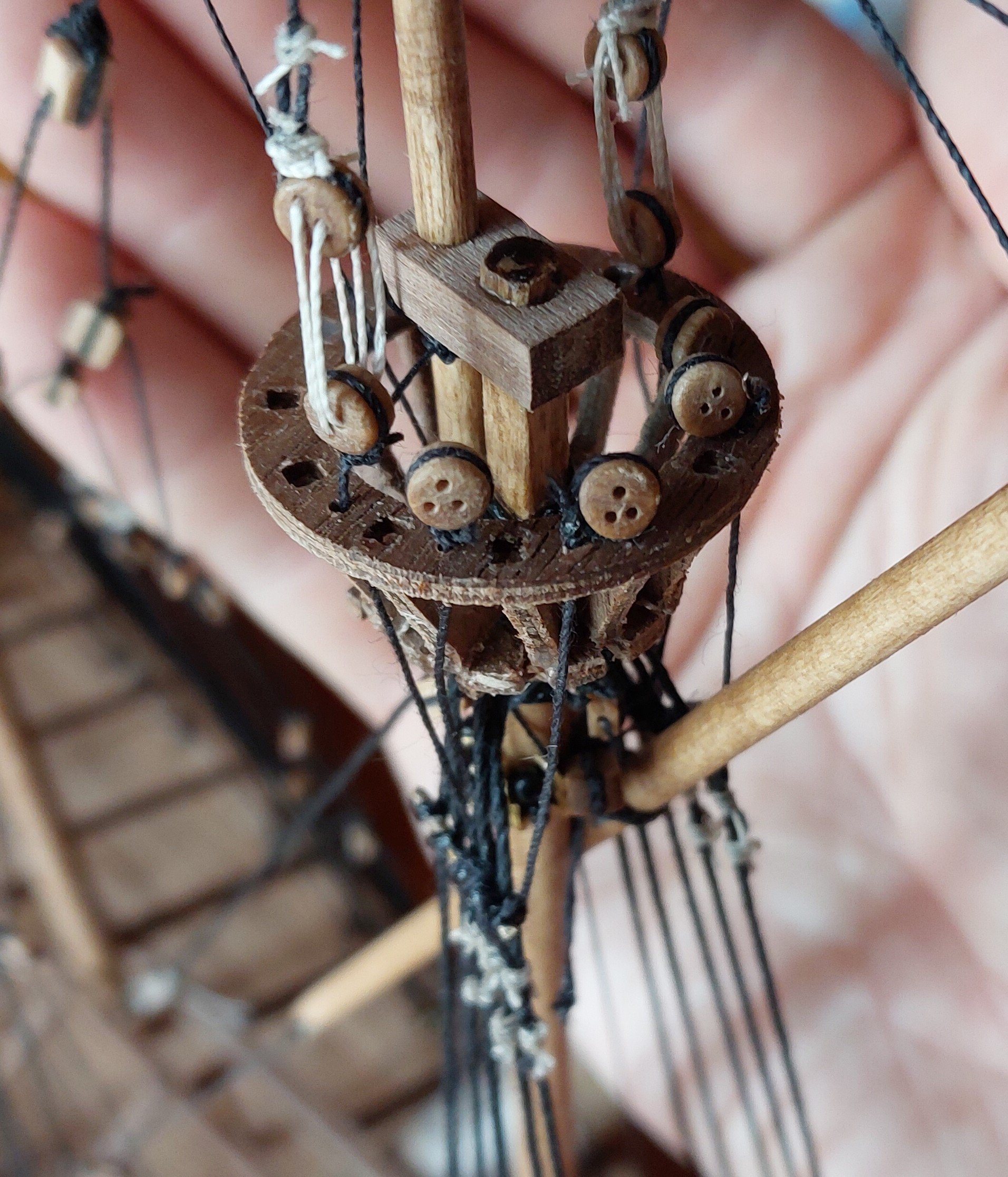

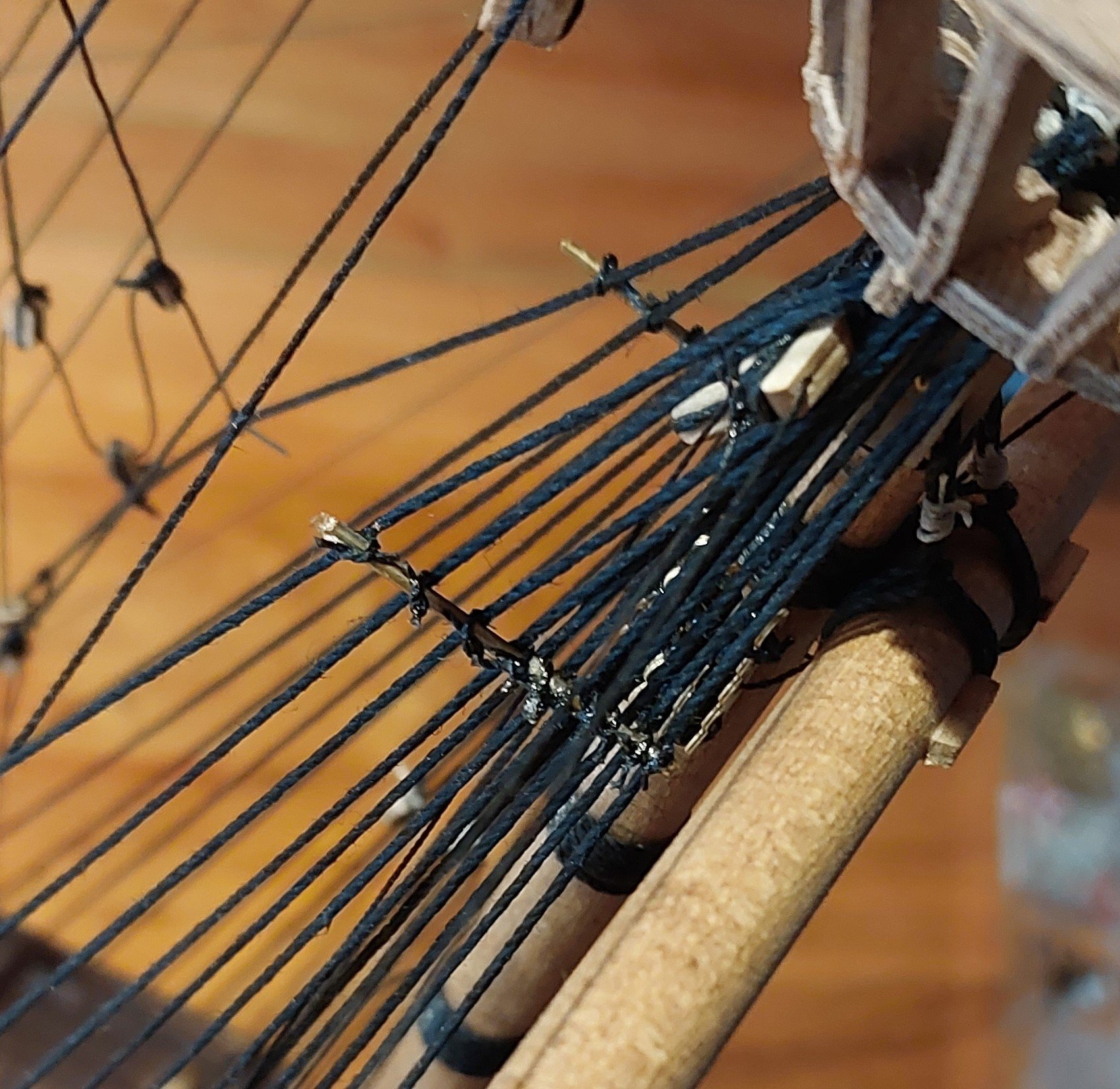

Futtock staves - lengths of brass rod as per the Caldercraft kit. I might have used wooden strips in hindsight, but I don't think these show too badly:

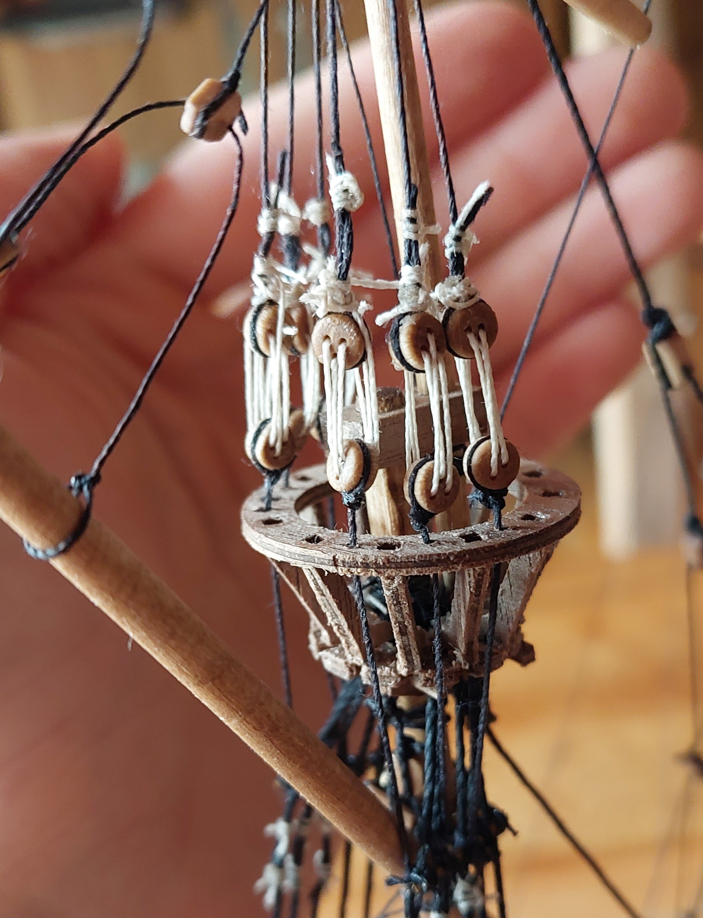

I put a single tackle in the main top and fore top. I'm not sure if there would have been any in the mizzen or bonaventure mizzen, but at this scale I went for simplicity:
All four lateen yards in place - Anderson's book notes that ships prior to the 1600s would likely have been lateen rigged on the mizzen topmast, but doesn't provide a way of actually rigging them. Something to ponder!
Futtock shrouds and deadeyes on the bonaventure mizzen top:
20250524_132431.thumb.jpg.ab37a42c53d24143e31e8224a0d054b4.jpg20250524_150623.thumb.jpg.eb76bd169f051b0c9b82b9f8c3dbfd7b.jpg
Not my neatest knots in some palces, but I'm actually really happy with how these have worked out - and the shrouds all being tied off makes the ship look, well, shipshape!
Again, I felt very burnt out on the project during this period, so photos are few and far between - I think it took me a couple weeks between sessions to get these done in all. Here's the main topmast at a nice artistic angle:

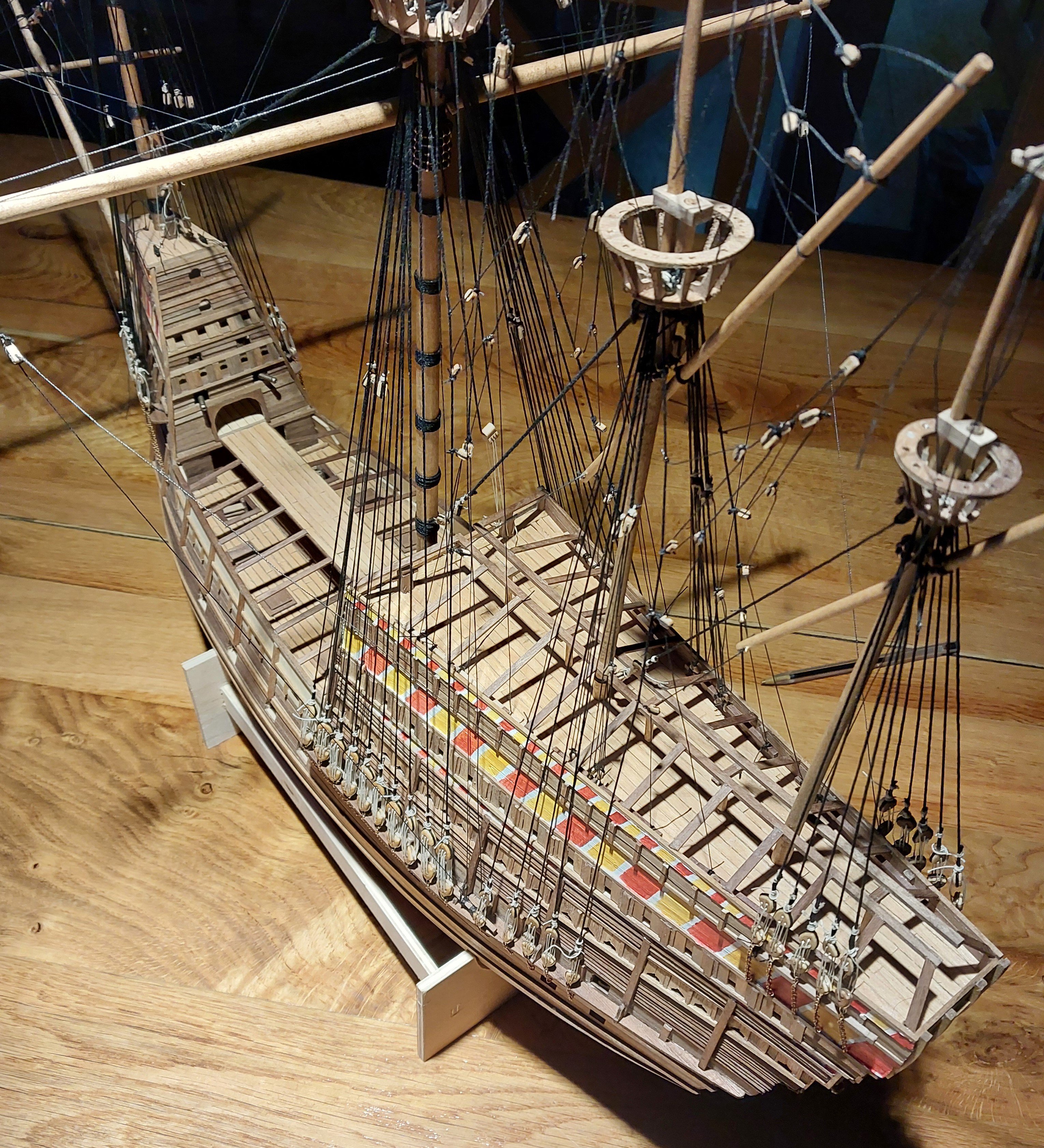

And here's the whole mainmast assembled - the only thing missing are the braces for the top yard and topgallant yard. And all the sail controls. And probably some other things...
Well, that summarises the progress I've made. It doesn't look like a lot in these photos, but man does it feel like it!

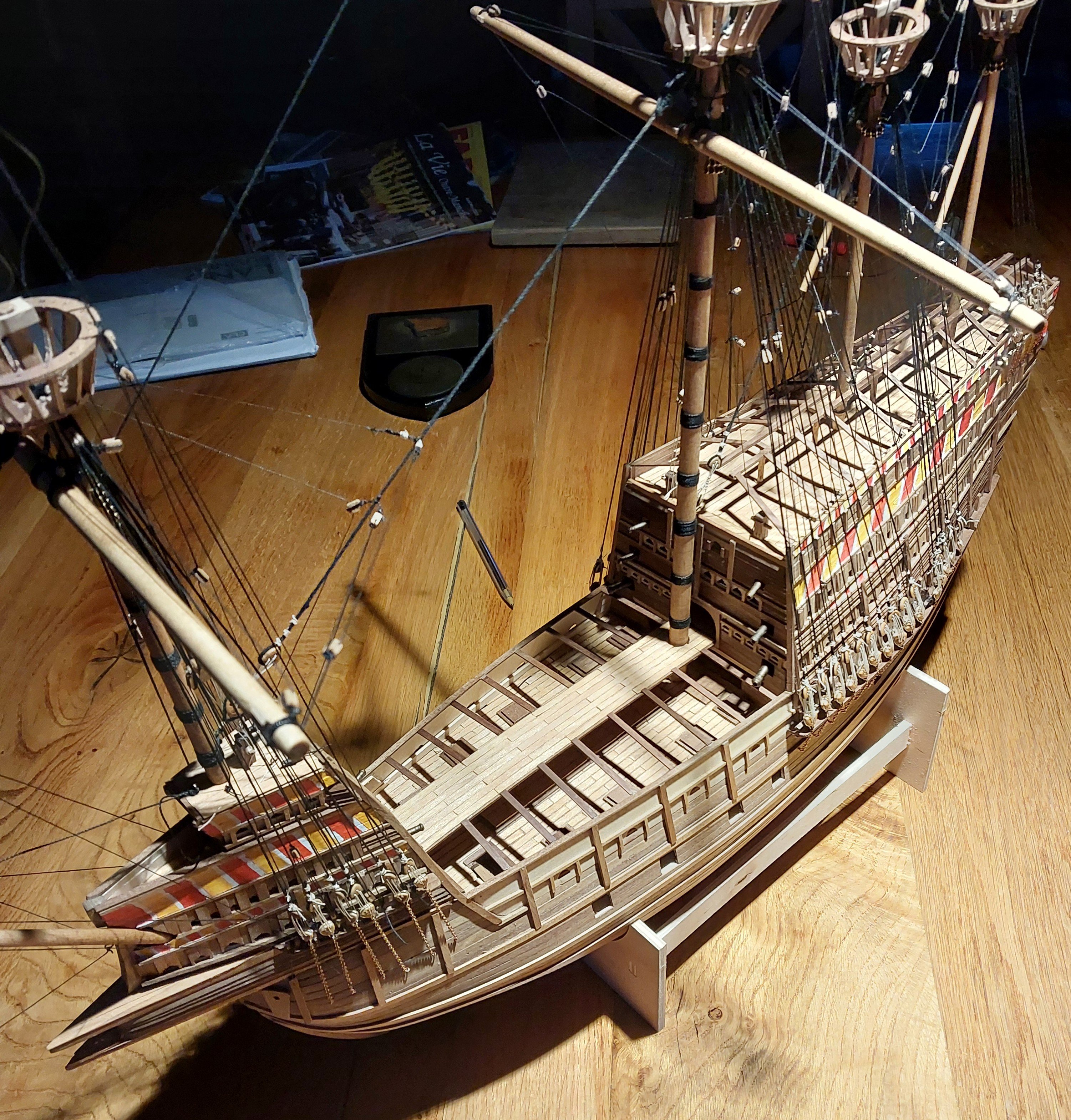

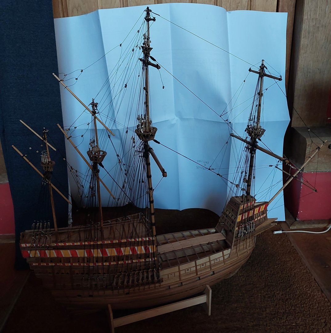

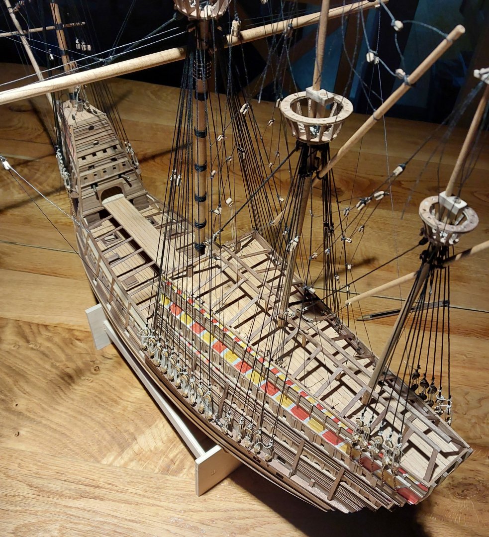

Here's an updated shot:
As you can see, all the yards have their controls in place, with the exception of the main topmast yard and the bonaventure top lateen yard. The former I simply need to complete - running the braces to the shrouds on the mizzen and back to the deck - but the latter is a bit of a puzzle.
As I mentioned above, Anderson is not clear how these would have been rigged, so I've left it til last. The Caldercraft plans have the lead for the lifts going to the mizzen topmast, but that's where I have the lifts for the bonaventure lateen, so it seems unlikely the bonaventure top lateen would also go there. My current thinking is to perhaps run the bonaventure top lateen lifts to the tip of the mizzen top lateen, but that seems a little tenuous - any input would be very appreciated here.
I still need to do the ratlines, but other than these points the main bulk of the rigging work has been done. That is, until sails are considered. The Caldercraft kit has no sails, and I understand most people rig sails before rigging the yards in place, so that ship has (aha) sailed. I have a few square feet of linen that would be suitable, but I'm currently considering putting furled sails in place - this would be easier for sure, and also more closely match the Anthony Roll. Any opinions are welcome here - open to ideas!
My other tasks are to finalise details - cannon, the figurehead (haven't forgotten that!) and gunport covers, amongst other things. There's also the spar that sticks out the stern, which I took off as I kept knocking it. I believe this would have been a tie-point for the bonaventure yards, and in the Anthony Roll it also has a rope ladder hanging from it, so I'll need to investigate that.
And finally, here's a little cool piece of history. I mentioned the plaque in the background earlier, and here it is:
