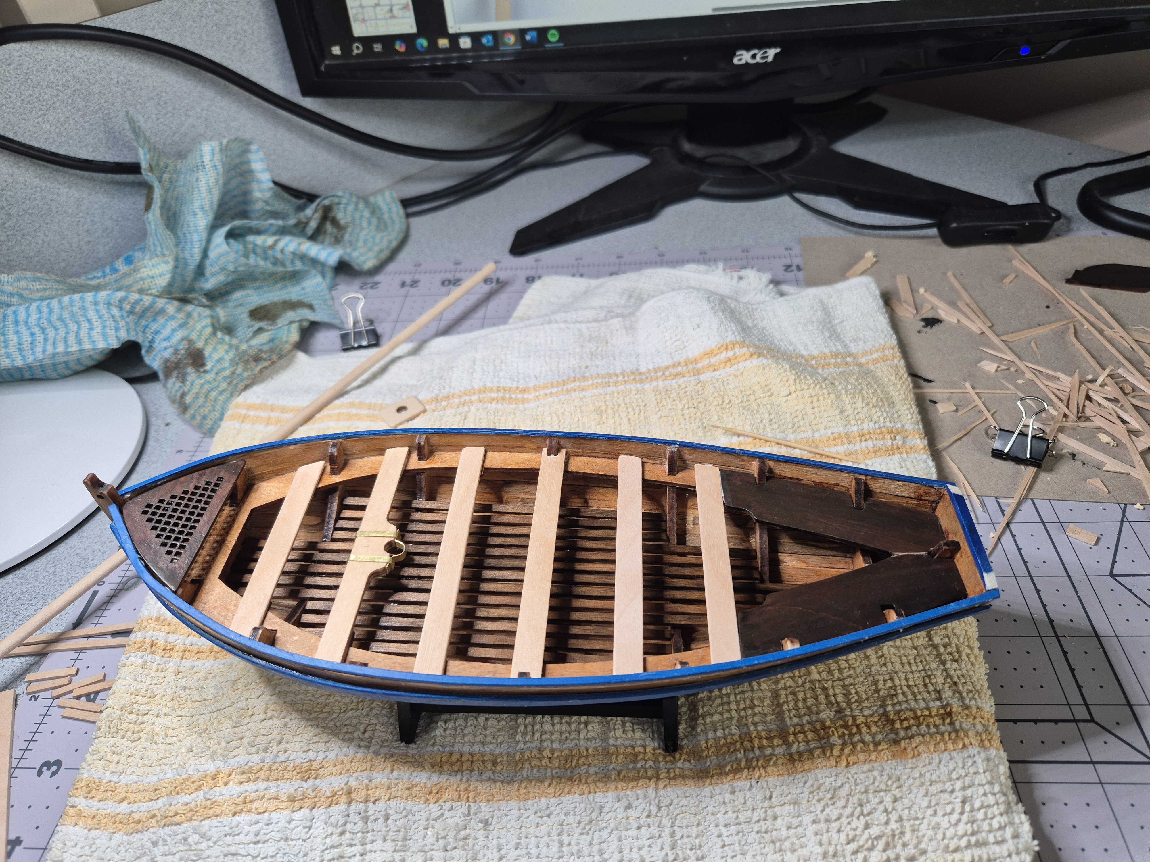

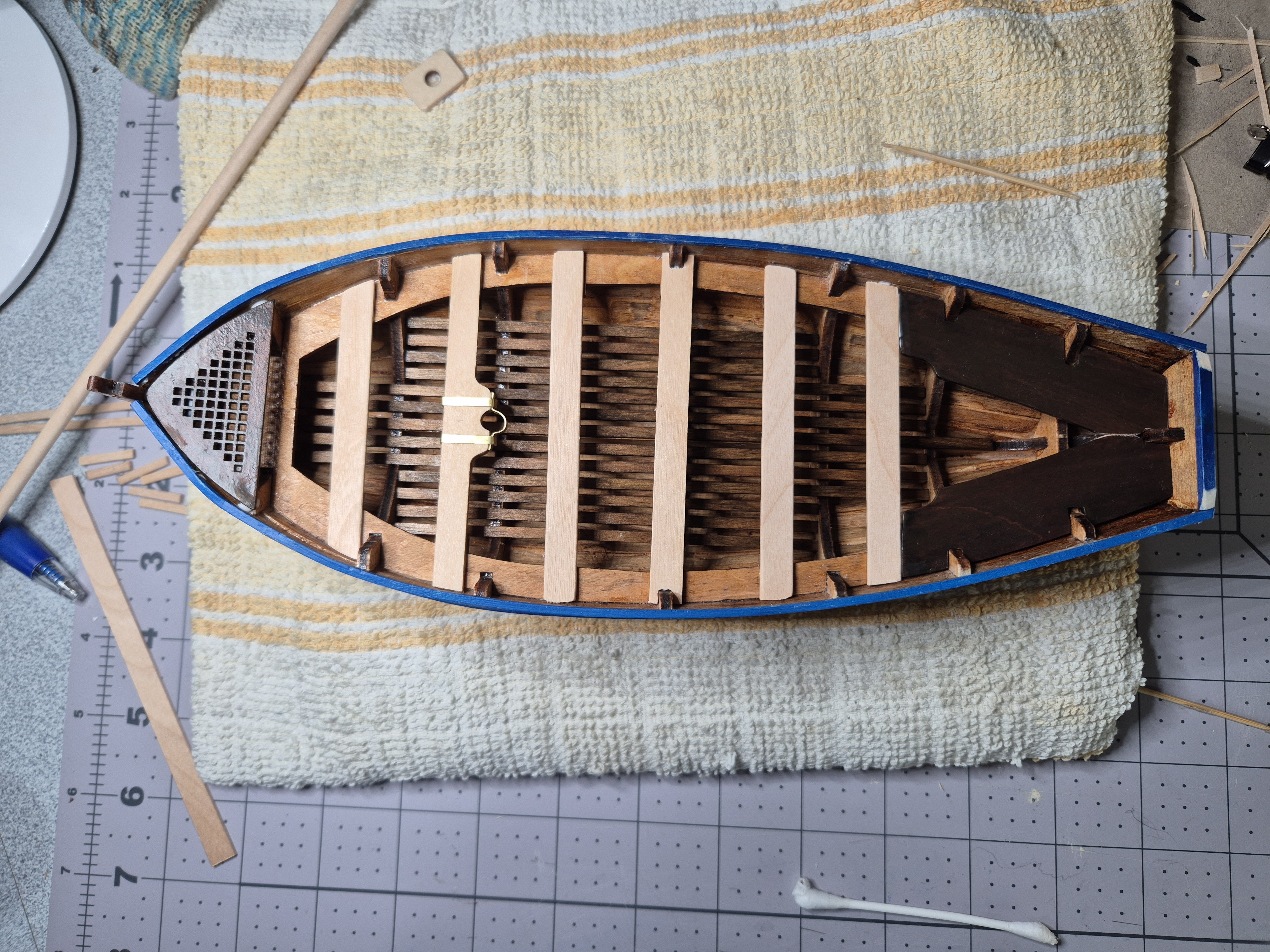

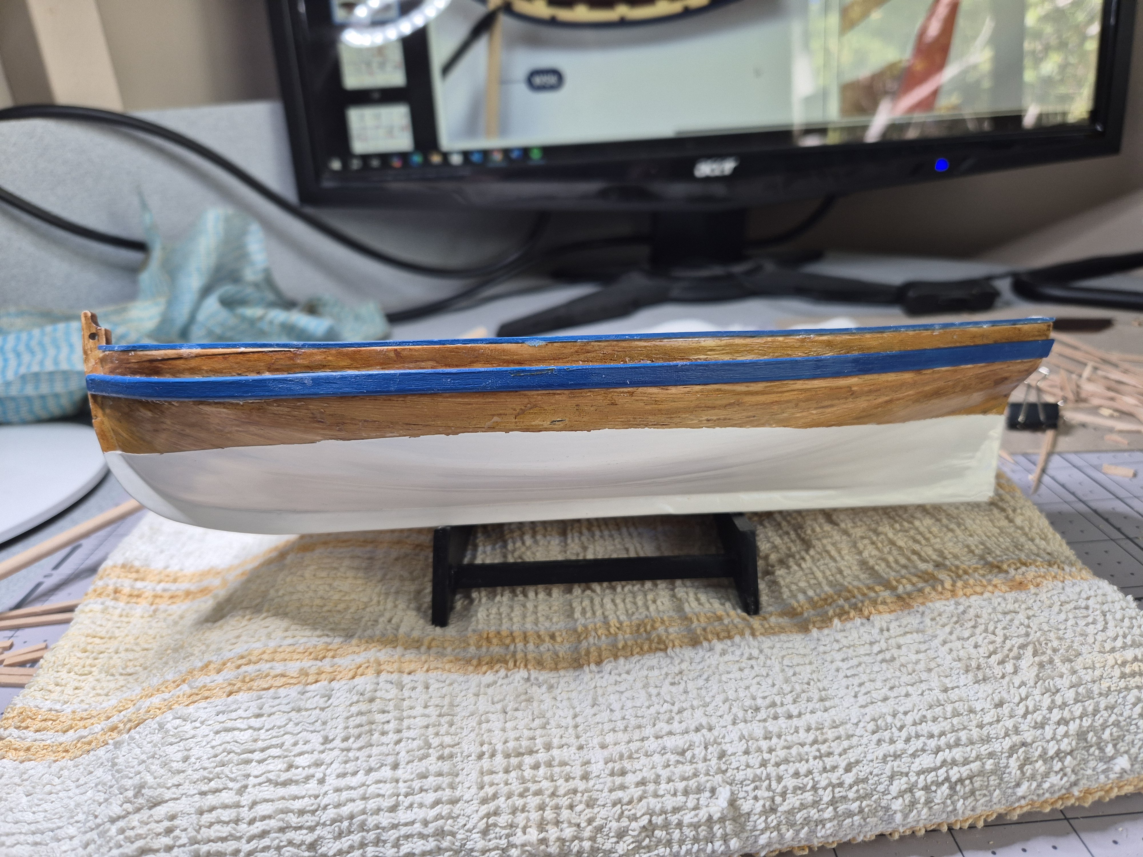

Finally managed to attach the wales, although need to work out how to bend the last few mm's at the bow to attach to the hull. Had a few dramas getting the cap rails attached as well. Took a number of attempts to get the rail bent into the correct shape. Unfortunately I did manage to break one but luckily there was spare piece of timber so had to do it all over again.
Have now positioned the thwarts and glued them in place. Next step is work on the rudder. This is currently undergoing painting in readiness. After that will start on the spars.
Some pictures below - still a bit rough in parts and needs some touch-up on some of the paint work but starting to look like a Jolly Boat!

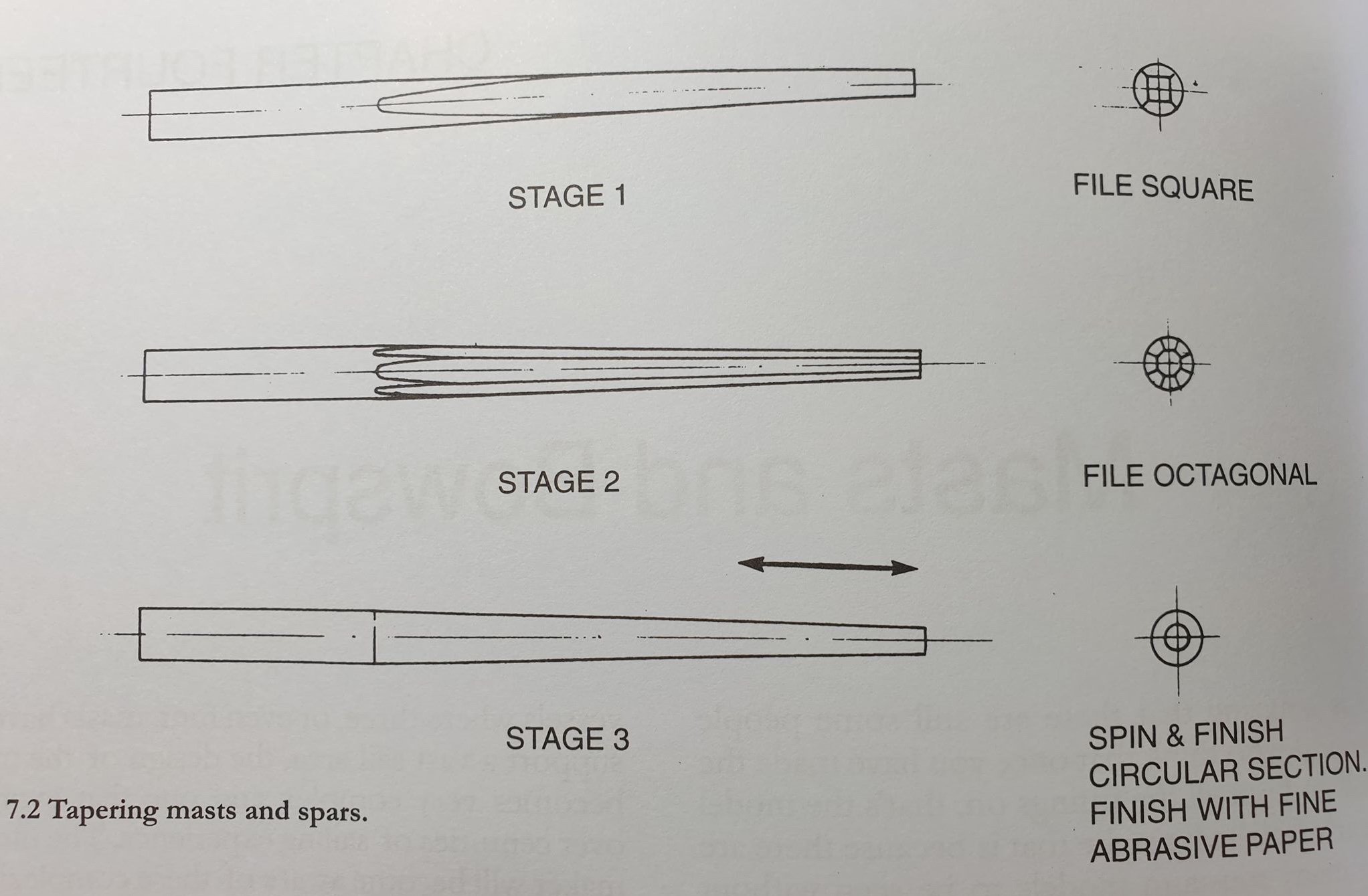

Has anyone got any pointers and/or videos on how best to taper  the spars to ensure that the tape is even and centred? Remember reading somewhere about using a drill but can't find where I read that or if there was any pointers on how it was used. Tks
Thanks for this. Where did you get that information/diagram from? Is there a bigger document with more information. Always looking for documents/books with useful information. Really appreciate the feedback. I did try the drill method with spectacular failure. The drill was way too fast and the spar got the wobbles and snapped at the chuck. Oh well it was a learning exercise and fortunately I had decided to do this test knowing that I had enough for a spare. Phew! Might have to invest in a miniature plane at some point. I did these by hand, continually turning while moving the sandpaper up and down. Seemed to work out pretty well. Managed to to do the 4 spars this afternoon!

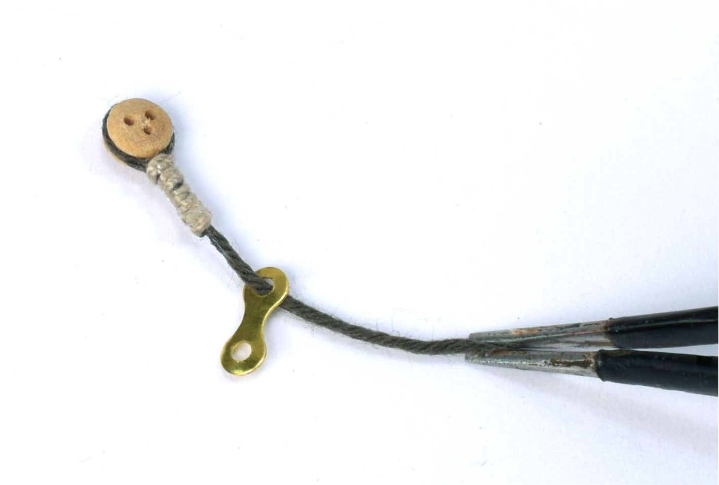

Started building the deadeye assemblies while waiting for some pain to dry. The kit calls for the chain plate to be seized to the deadeye. However trying to pass the thread through the chain plate  is near impossible. Or at least I have not yet been able to manage it. The thread just starts to fray. The hole in the chain plate is 1mm and the thread is 0.5mm. Has anyone got any ideas on how to achieve threading the chain plate.
The pic above is from the instructions.  Hoping there might be a few tricks to try that I am not aware about. I suspect that a big part of the problem is that quality of the thread is not very good.
Cheers Peter
I did manage to get one of chainplates threaded more by luck than anything else. Put a tiny bit of CA onto the end of the thread and then was able to pass it through the eye of the chain plate. Then remembered I had a the HM Sherbourne kit and the thread there is a much better quality so used that thread instead. Big difference! Big learning curve doing the seizing. Not as easy as I thought. Really only one out of the four was reasonable. But learnt a lot which was what this model is all about!

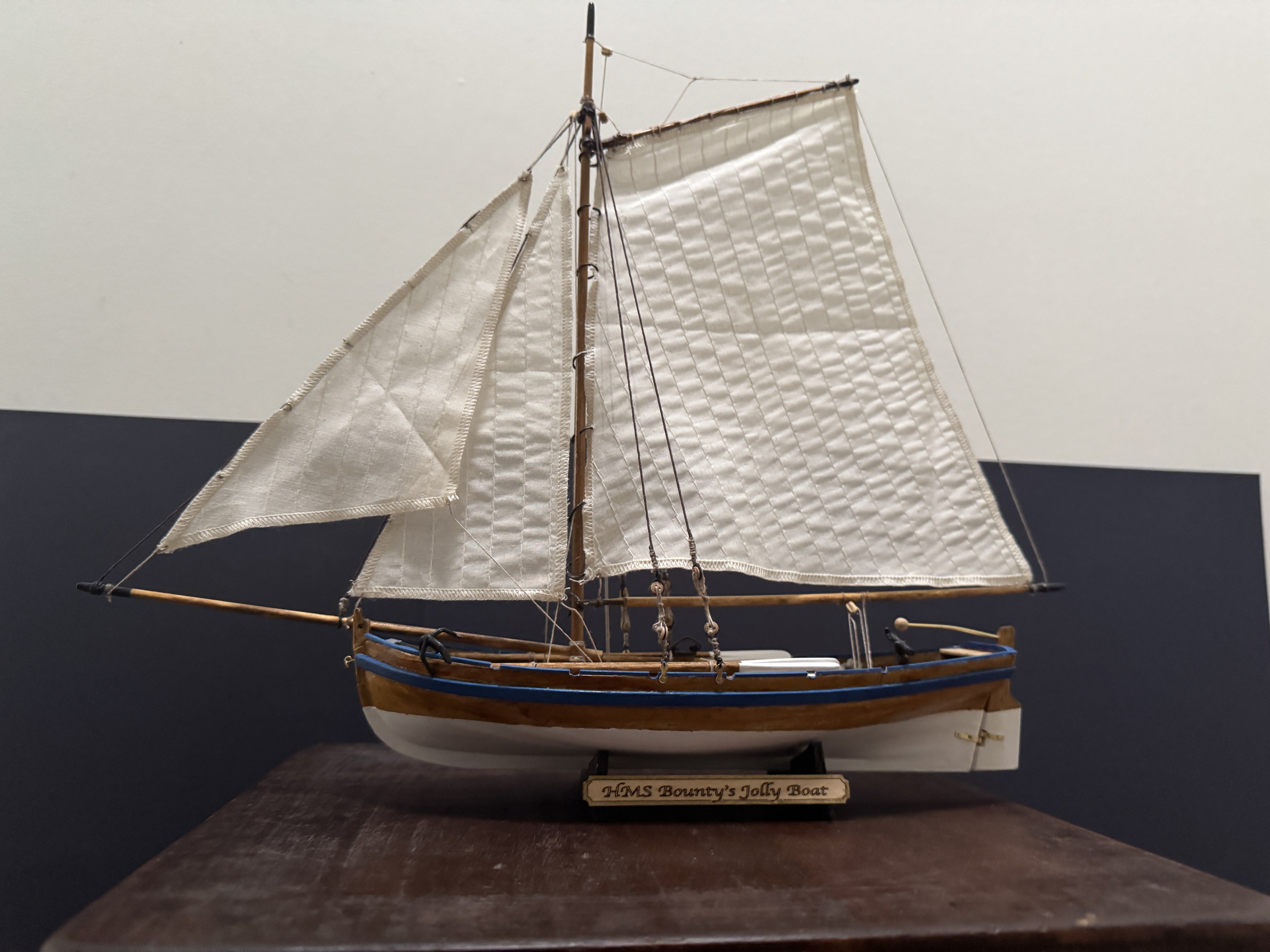

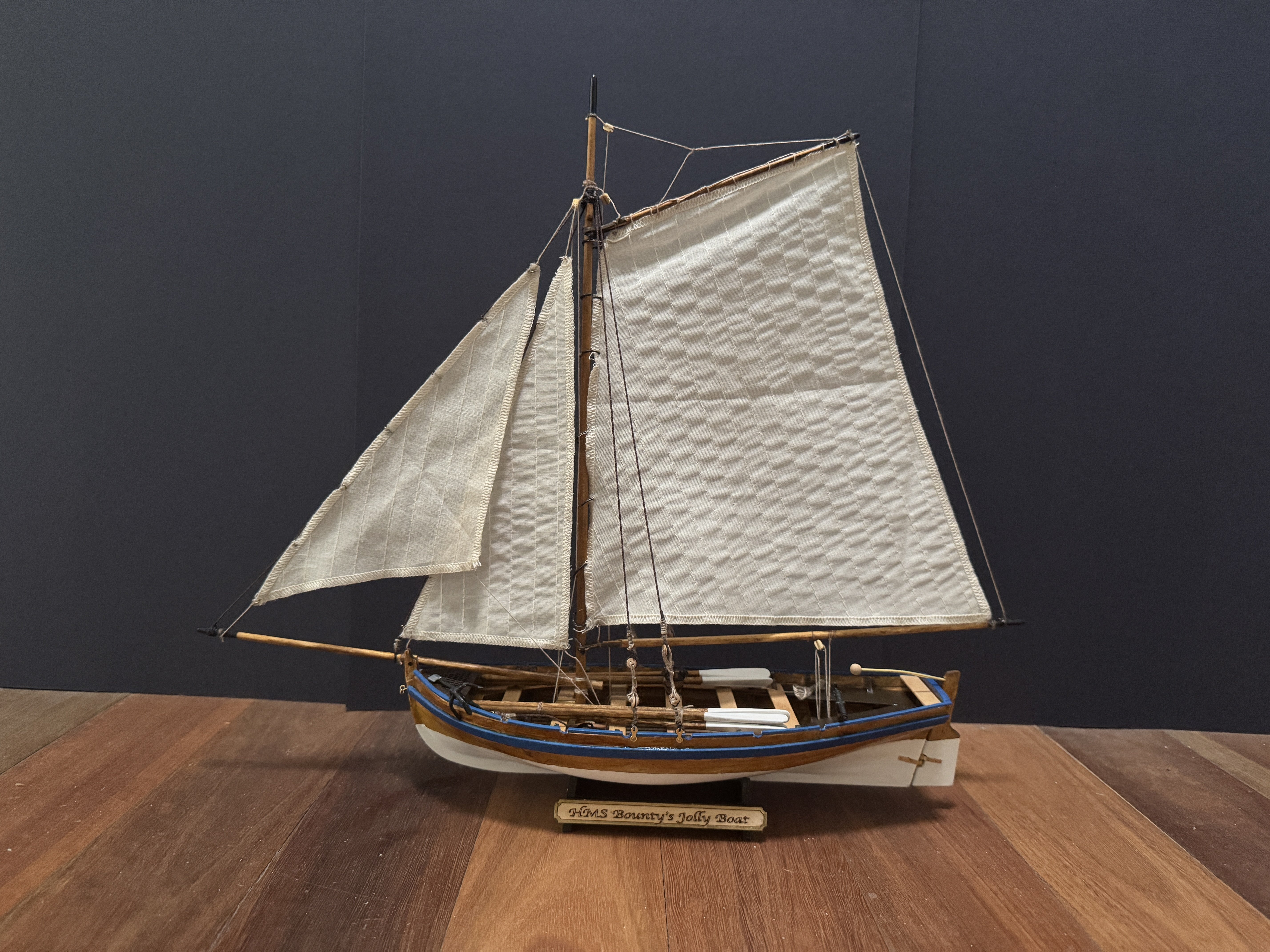

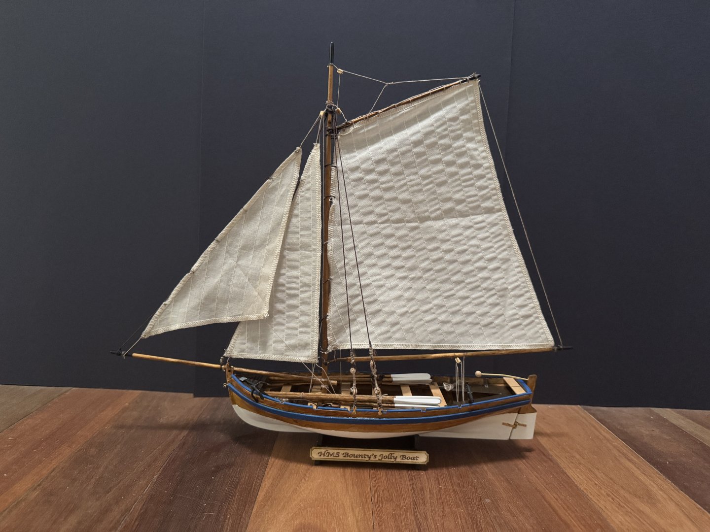

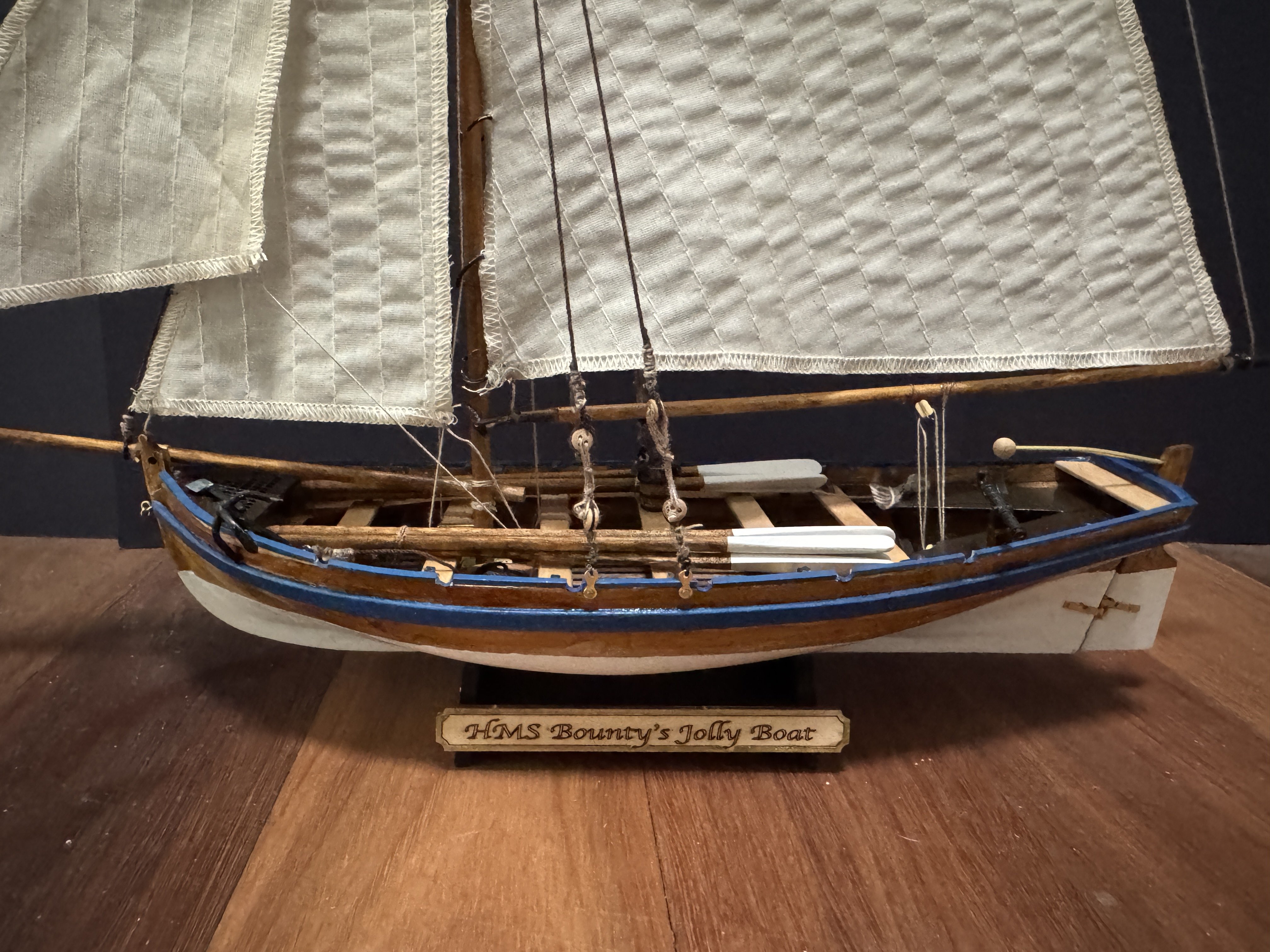

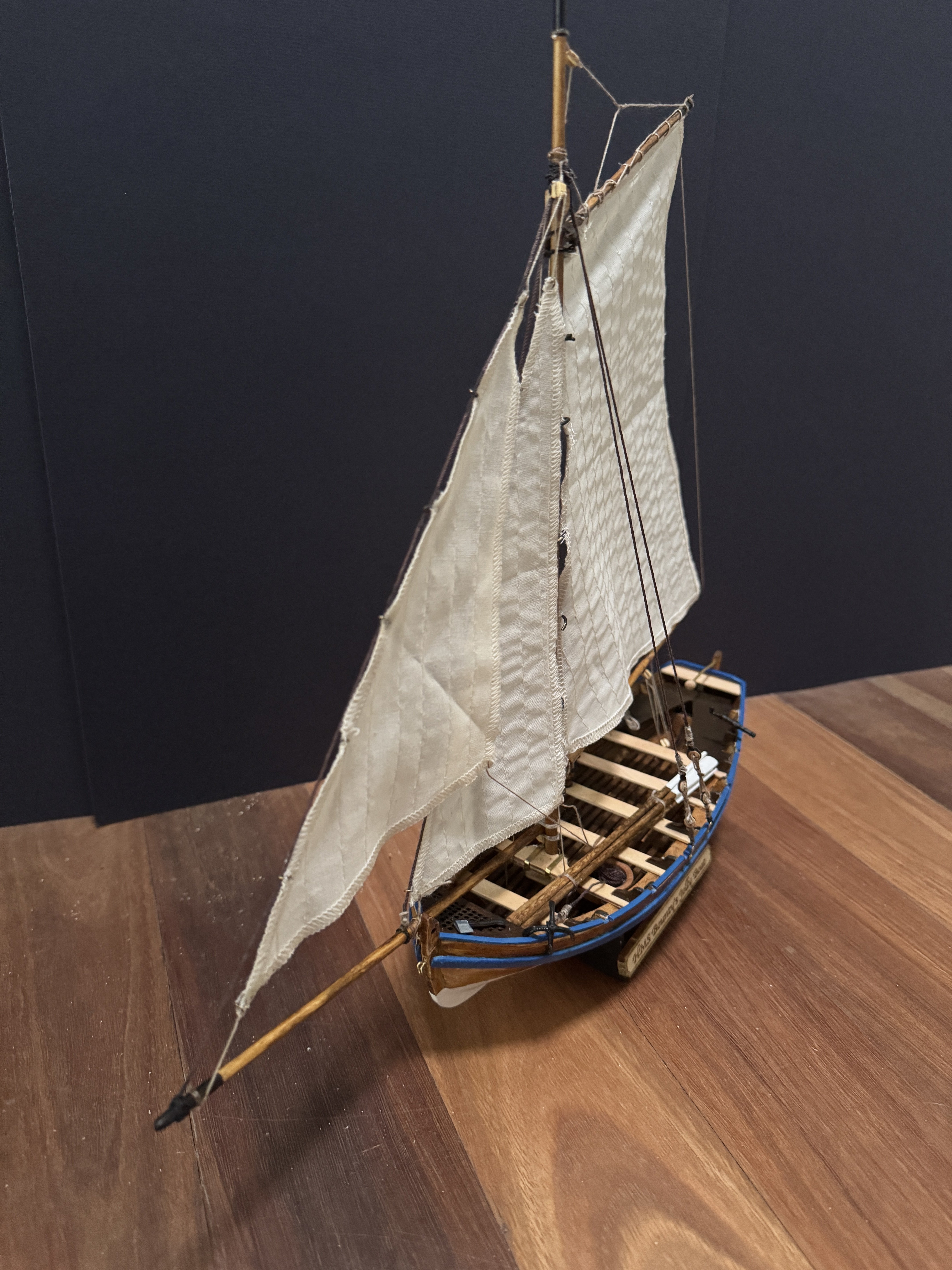

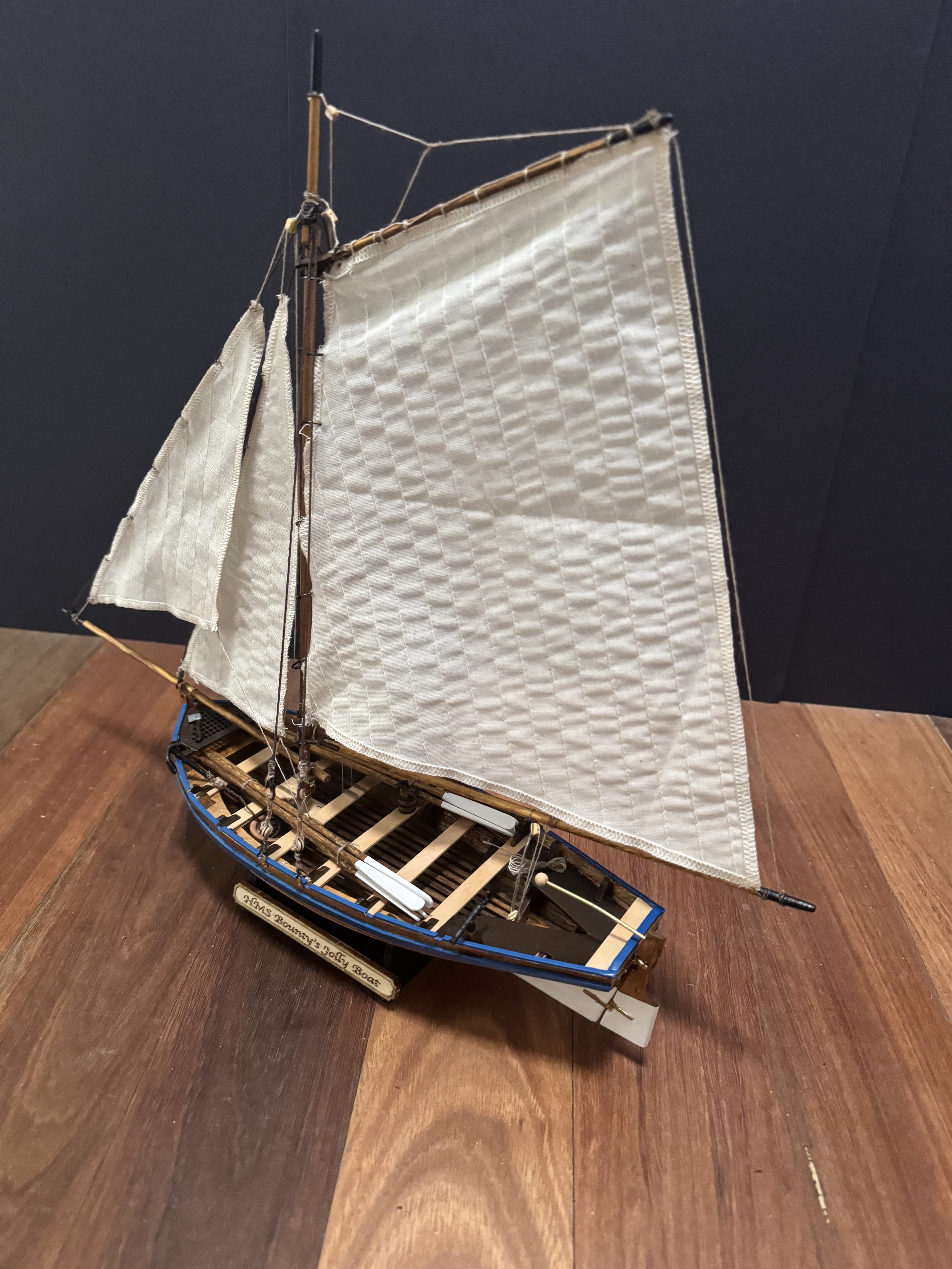

Have been making a little progress. Lots of outdoor projects with the admiral are taking most of the time at the moment. Also about to head overseas for a few weeks so no further progress until I get back. However, the good news is that all the stays and deadeyes are now installed. Found that adding some CA to the end of the thread and then running my fingers along it makes it nice and stiff and much easier to push through the deadeye holes. Finally seeing the light at the end of the tunnel. Next step is installing the sails.
