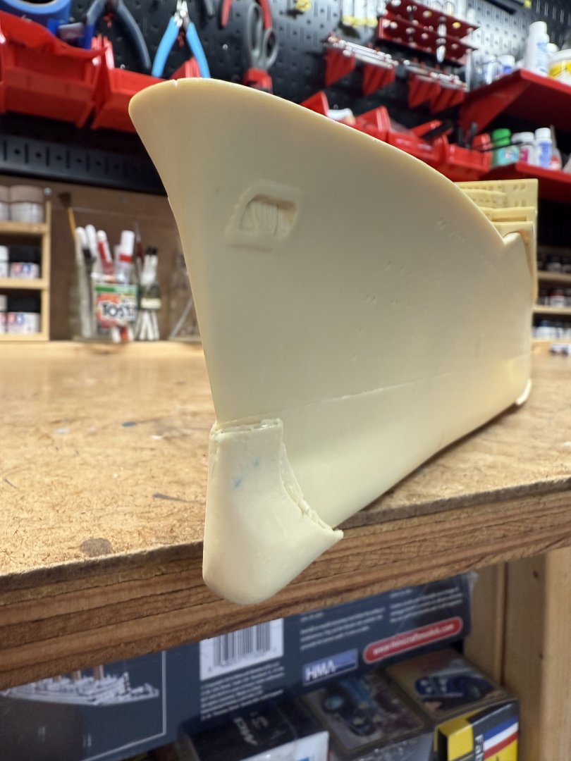

The SS Rex was built in Italy in the 1930's.  Evidently Mussolini wanted a spiffy ship like everyone else had back then.  I am building this model because I love building models, I love big ships, and my dog is named Rex.image.png.9fc8413e29782b29dcb2b5b9150da837.png

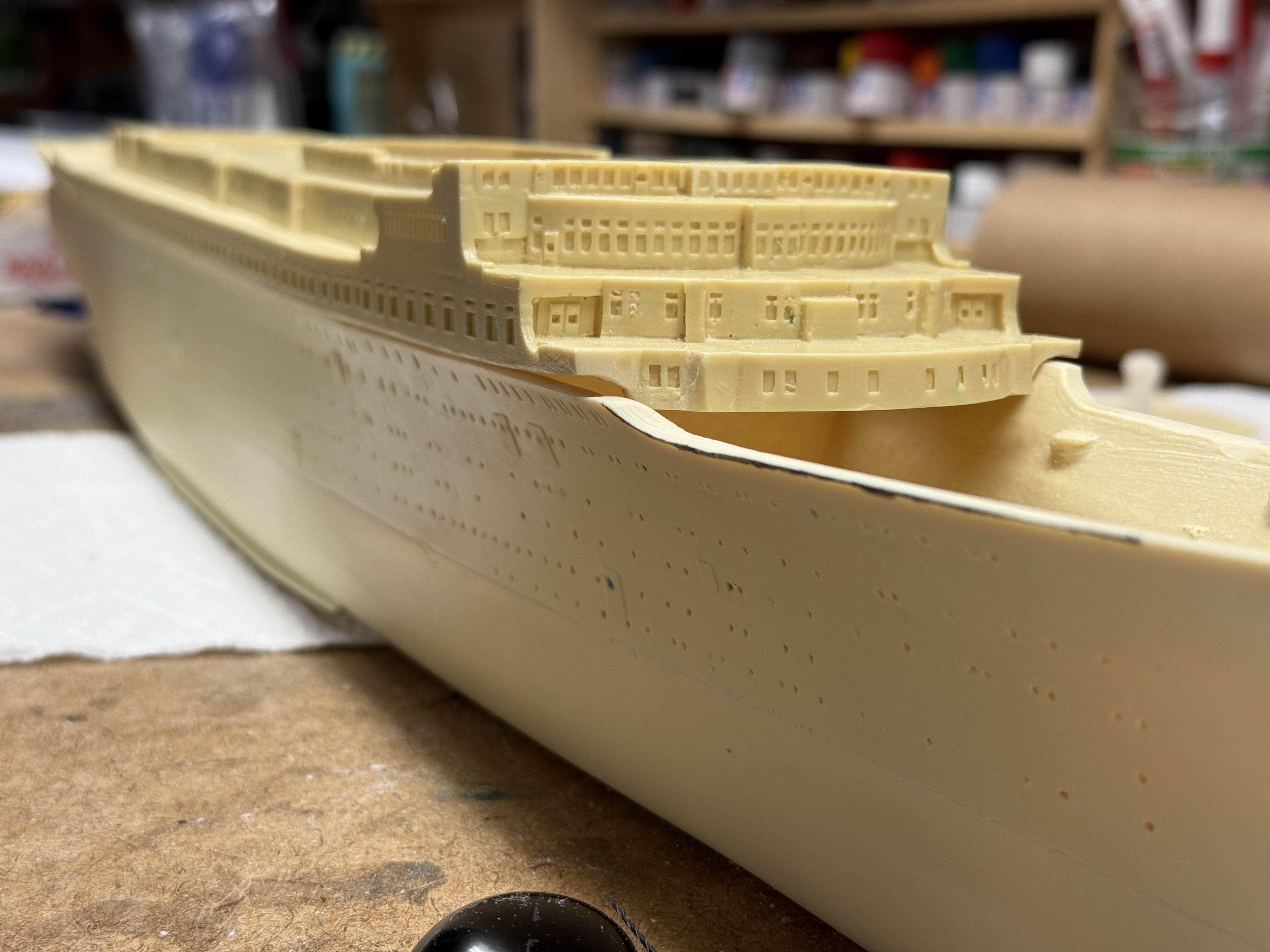

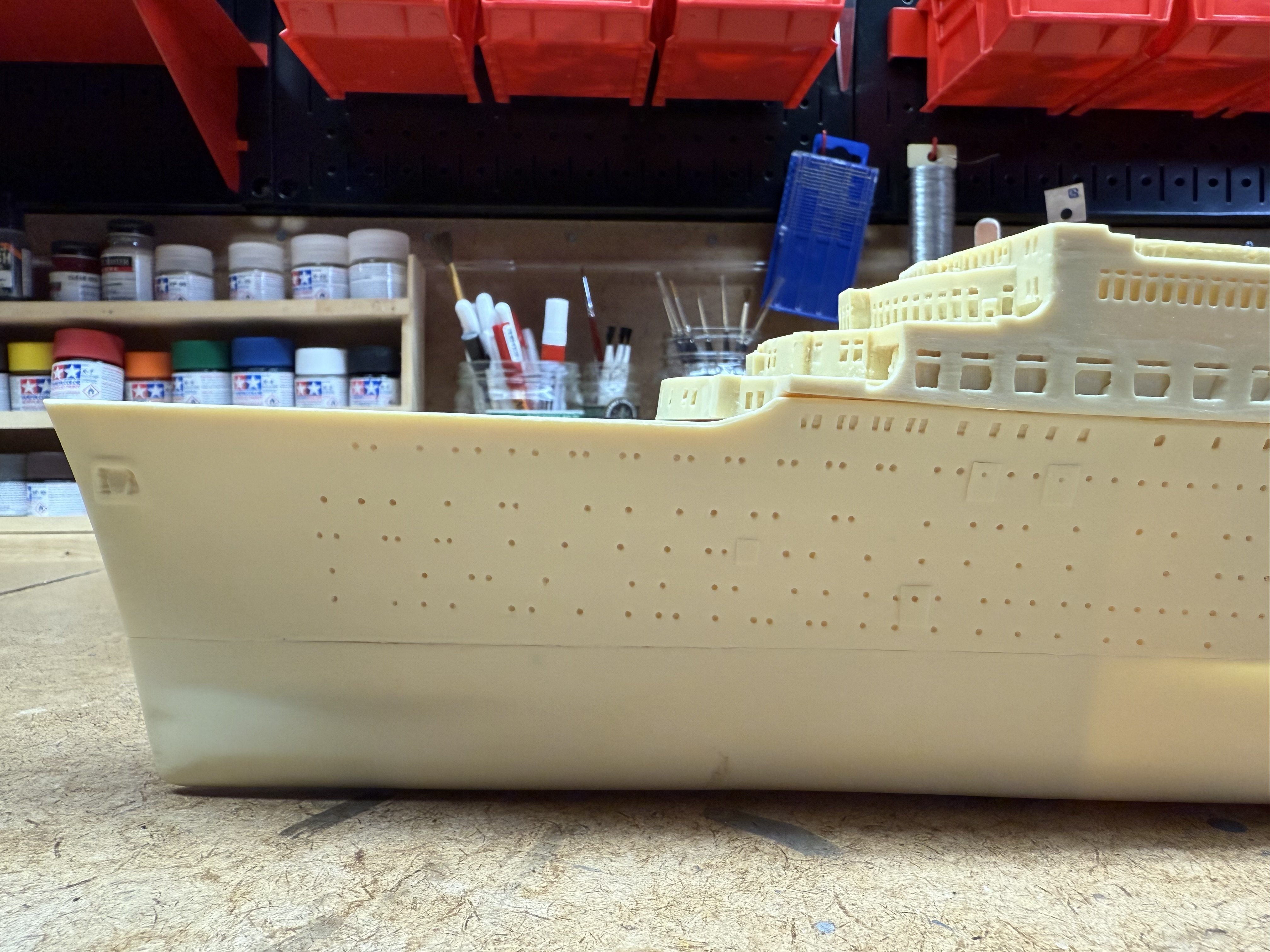

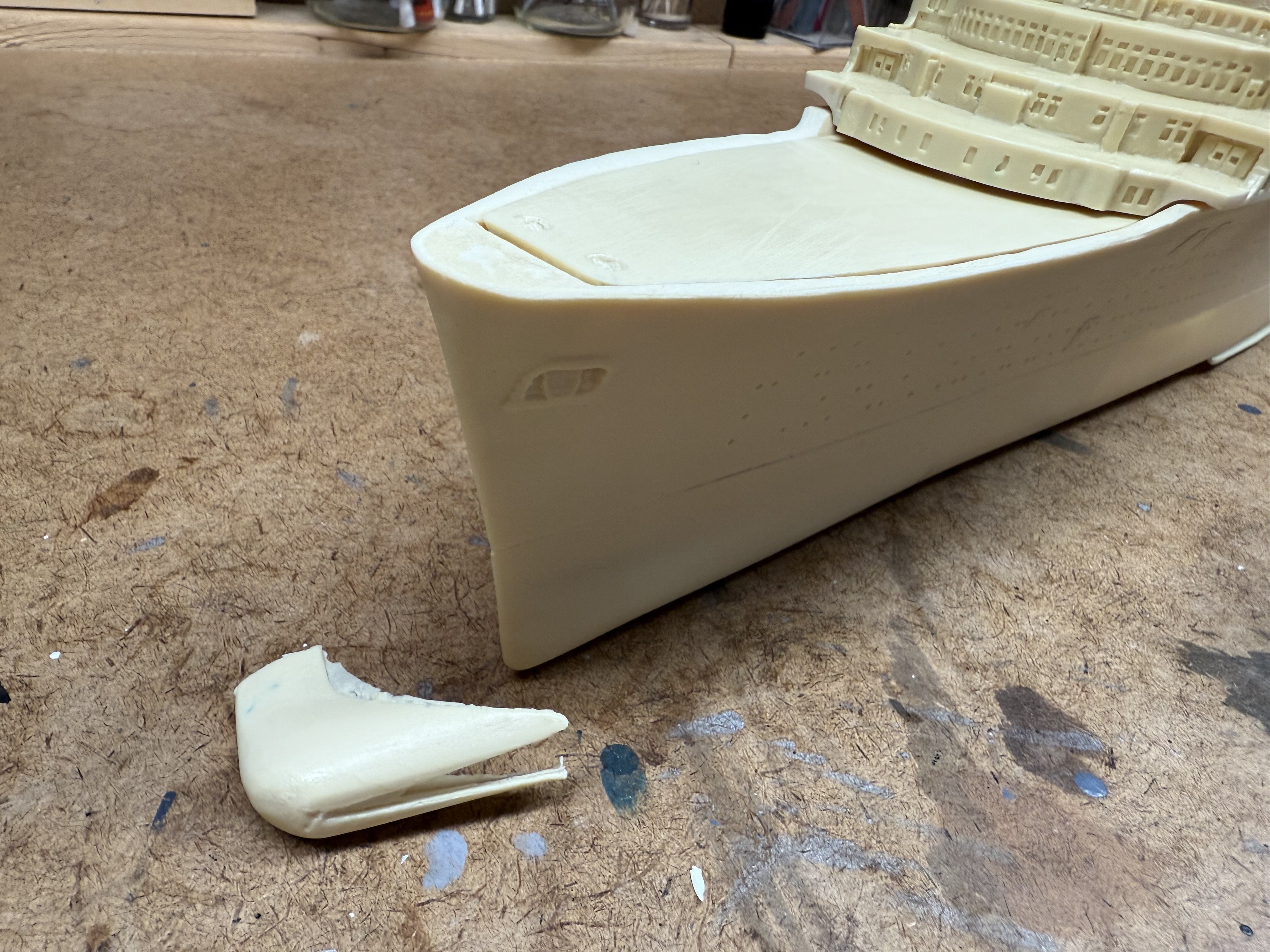

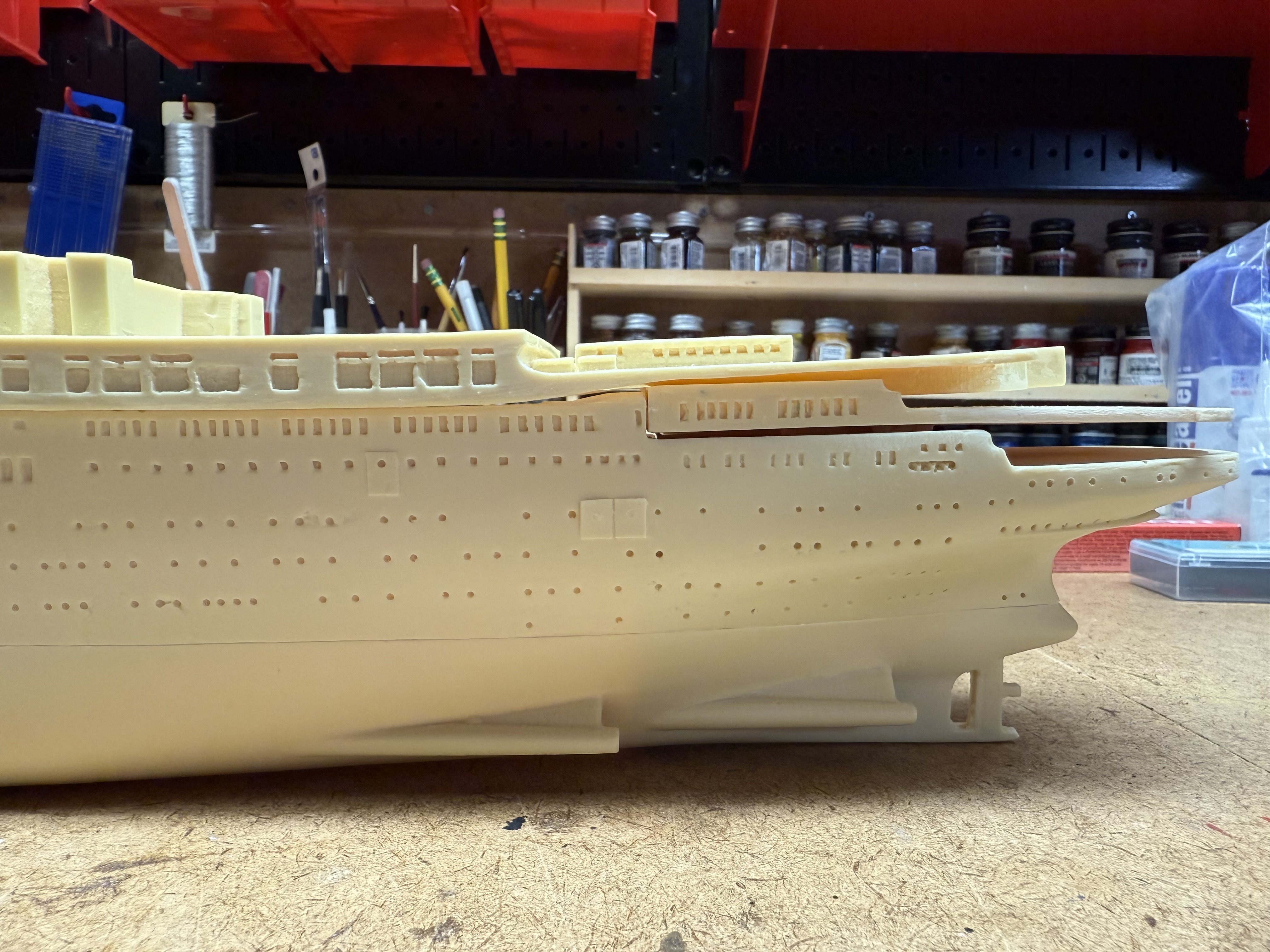

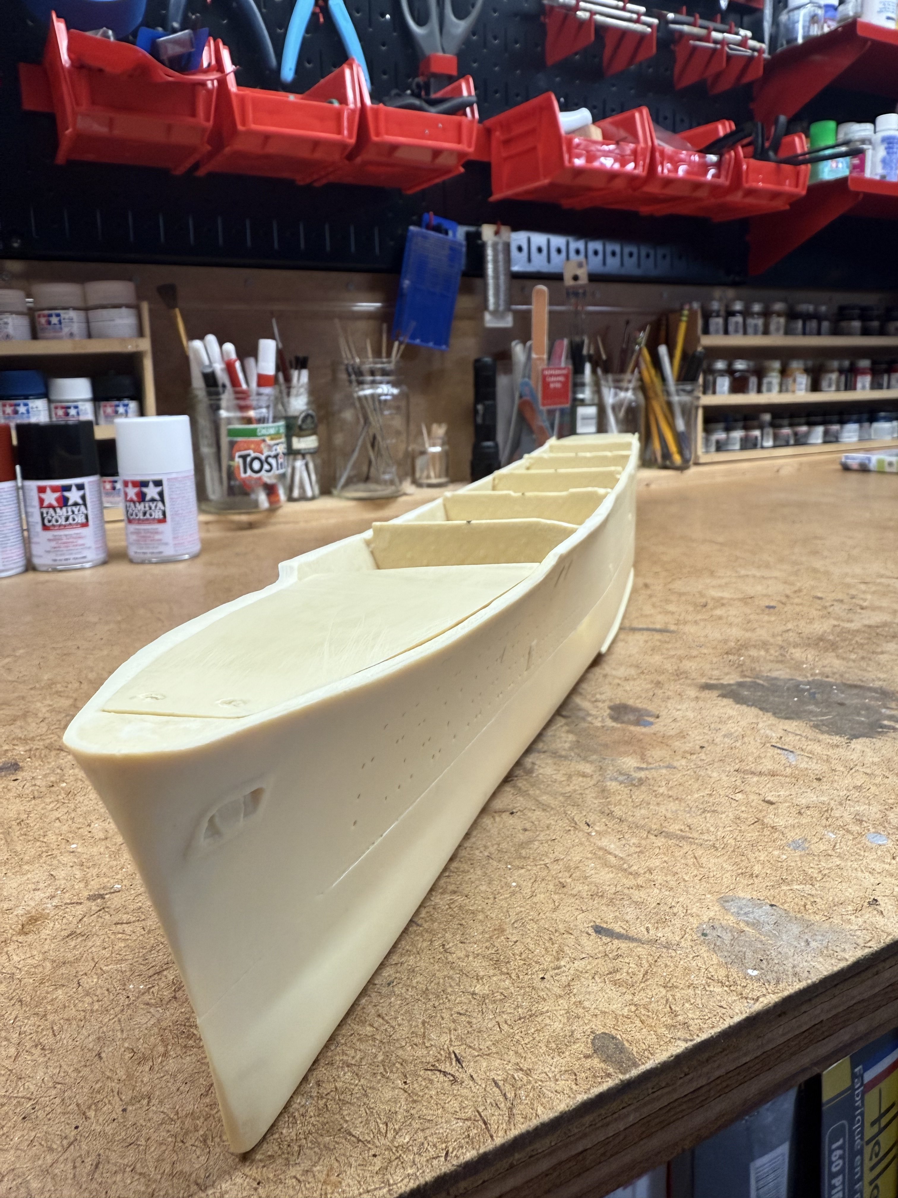

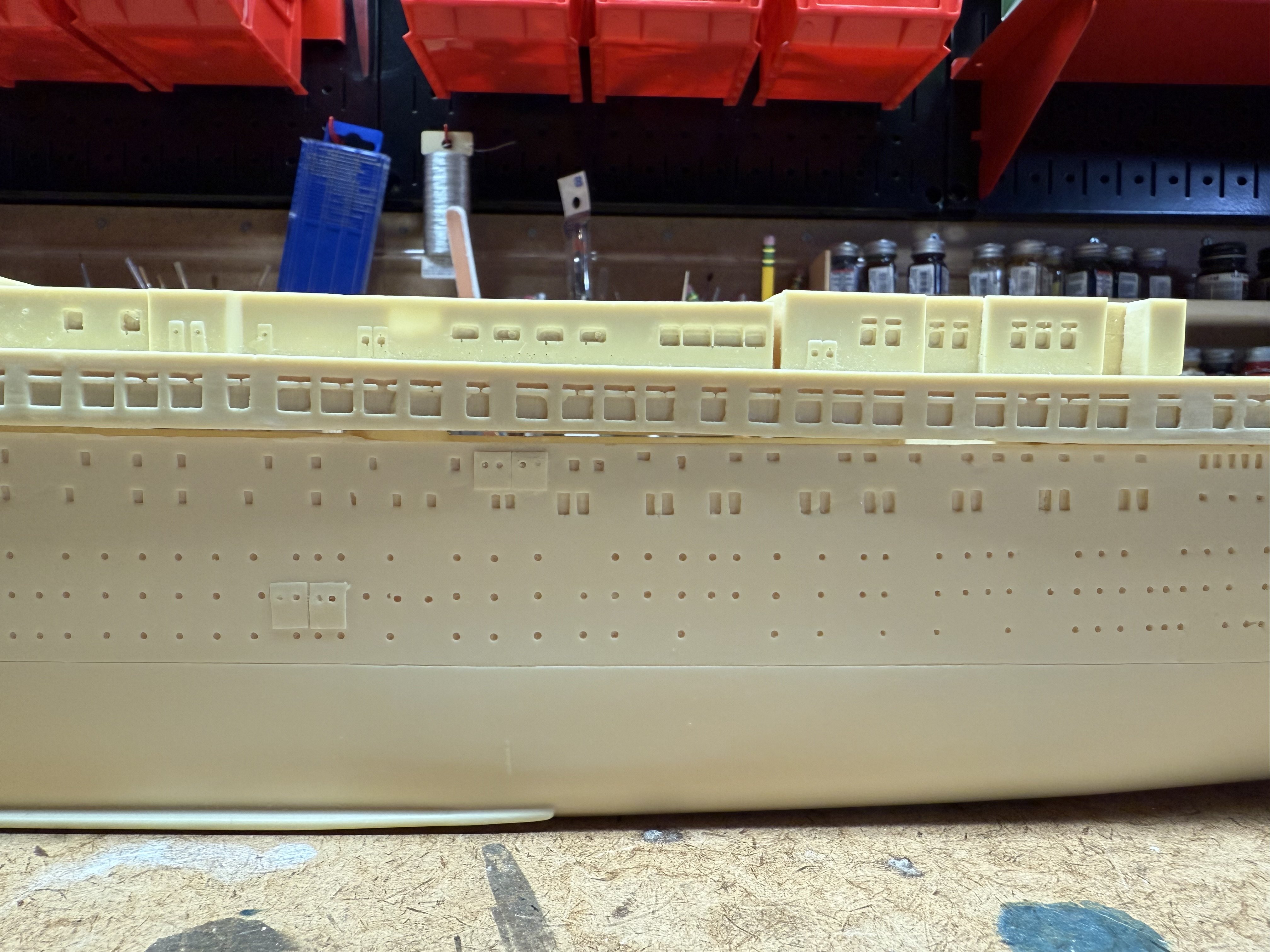

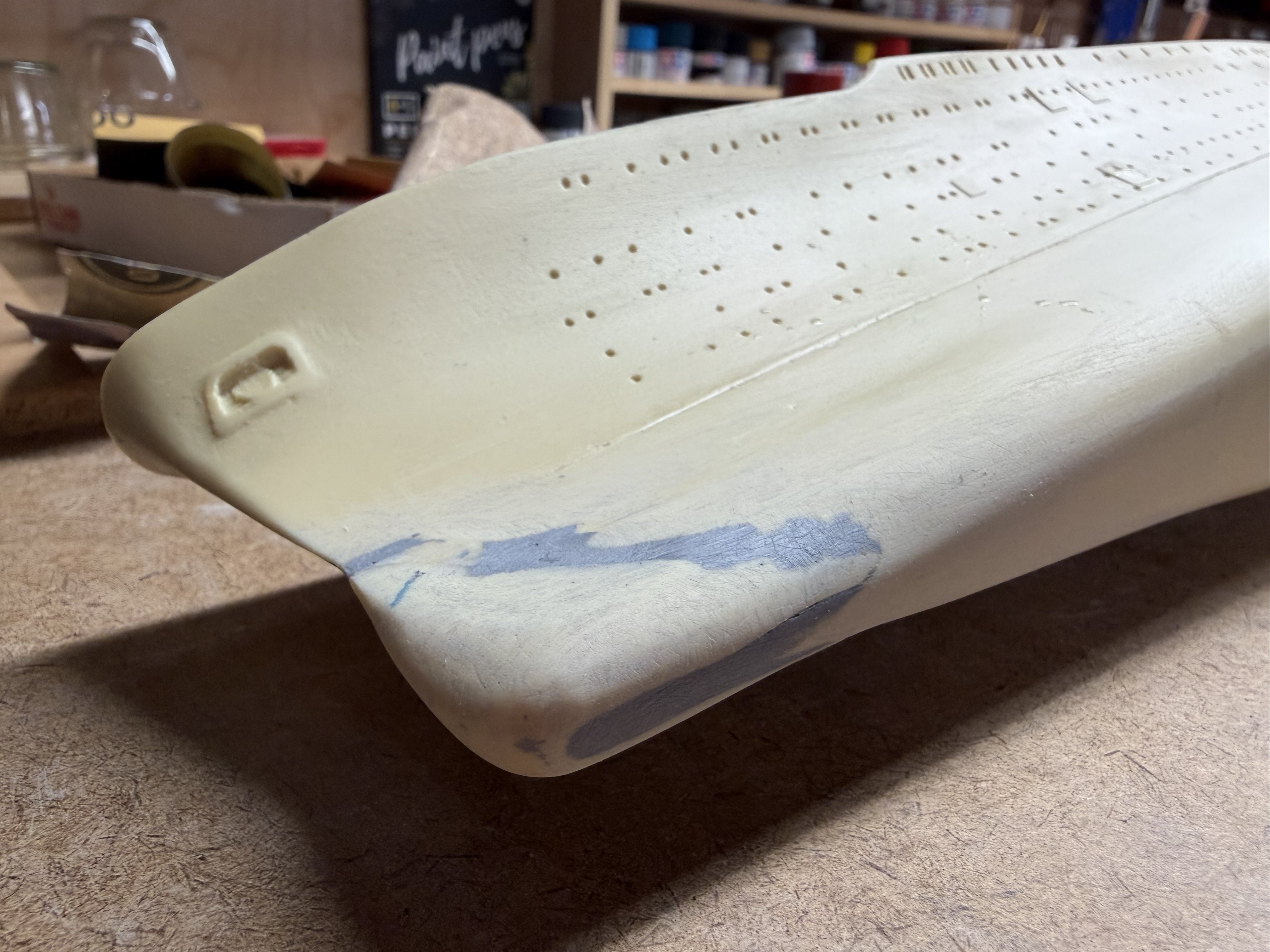

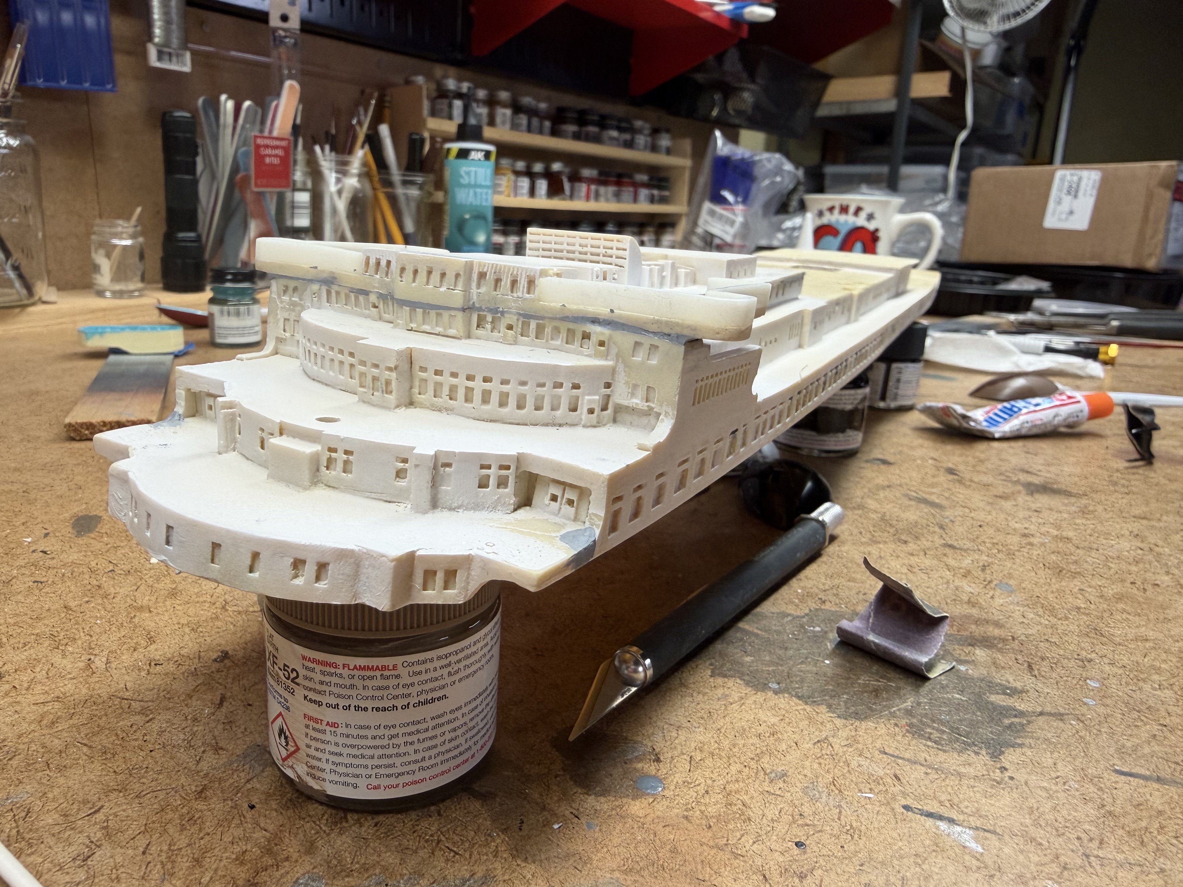

is that hull warped from the swimming pool deck to below the port holes to the right of the clear tape holding the decks to the hull?
DDP - it may be warped a bit.  The kit is good but not as exacting as an injection molded kit. It may also be light shadows from the superstructure piece that's sitting on top of the hull.  Here it is right down the side, it does not look terribly warped.IMG_1007.thumb.jpeg.cf9310f79799a34fb2ea6c28056526fb.jpegIMG_1006.thumb.jpeg.368bc9f4da1d8f55e1a254f4f87f6d2e.jpeg

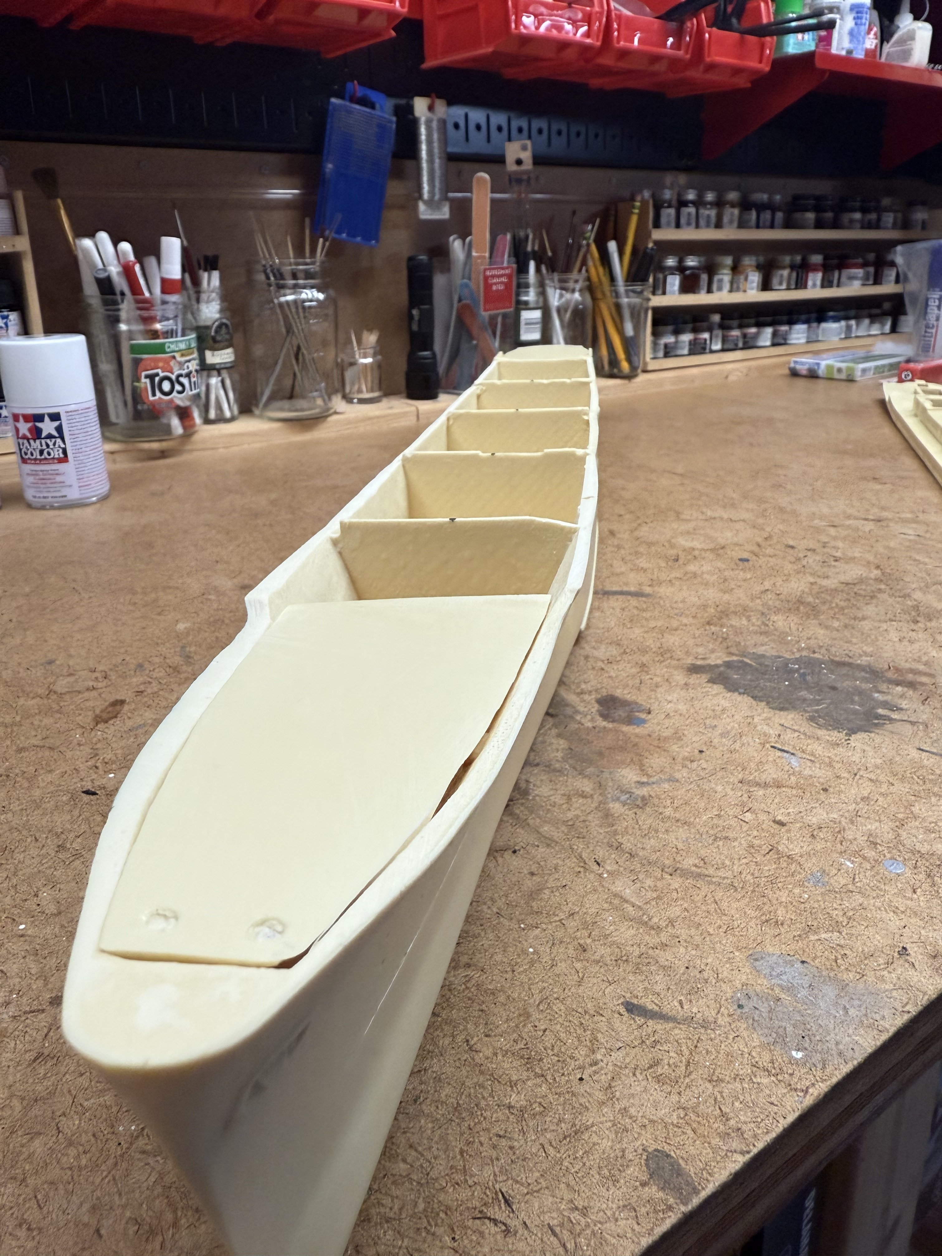

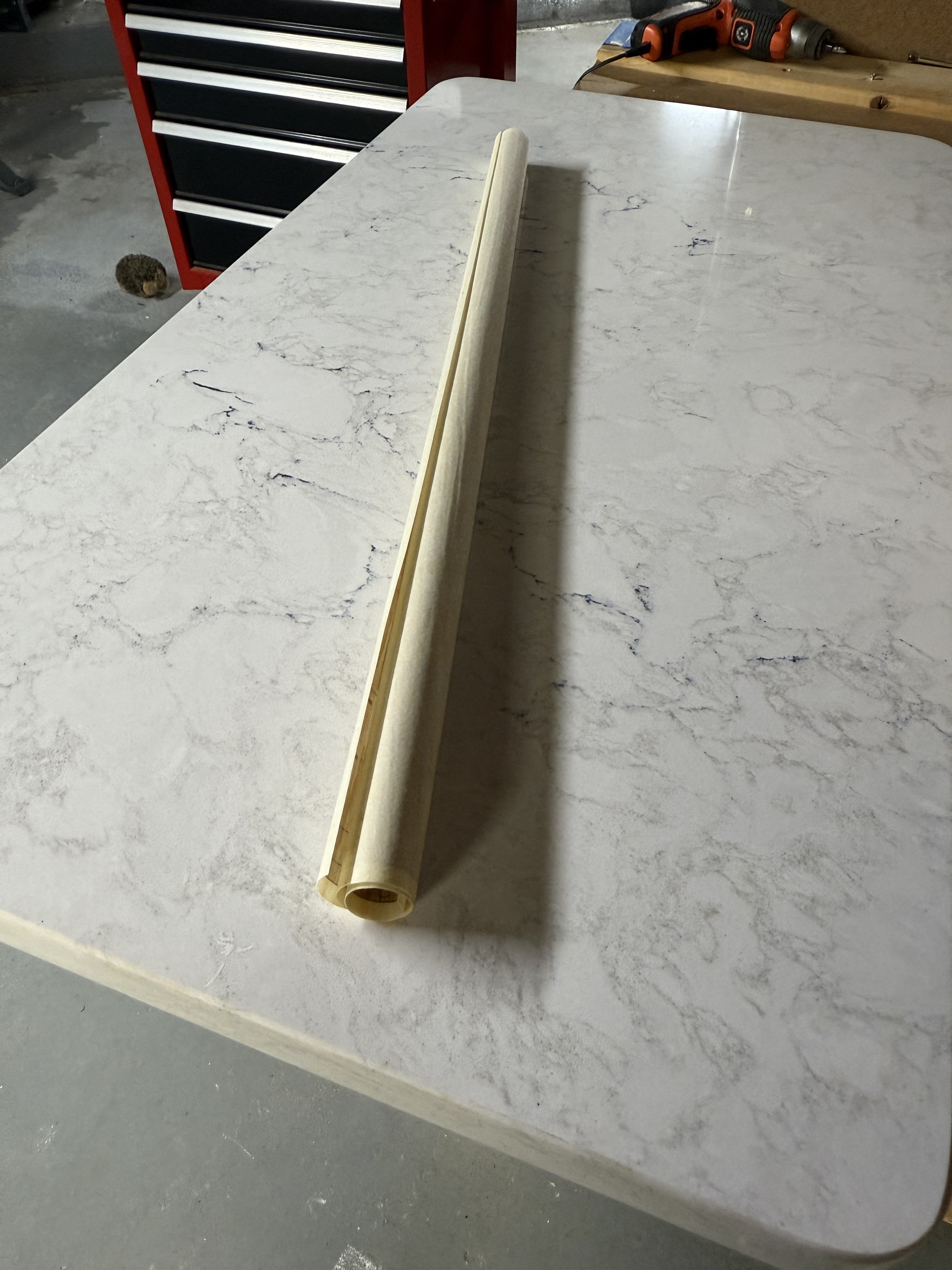

FLATTENING THE DECKS

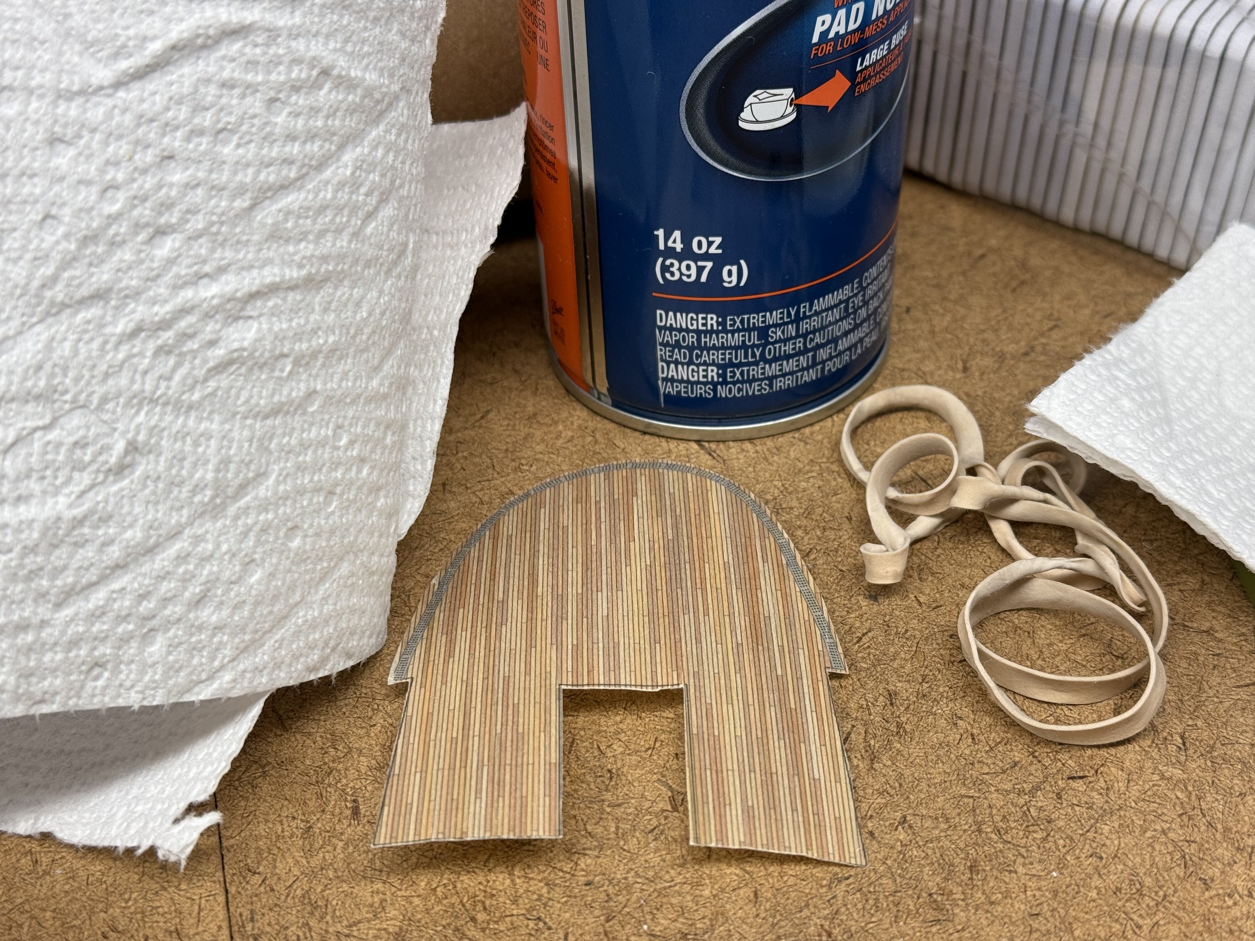

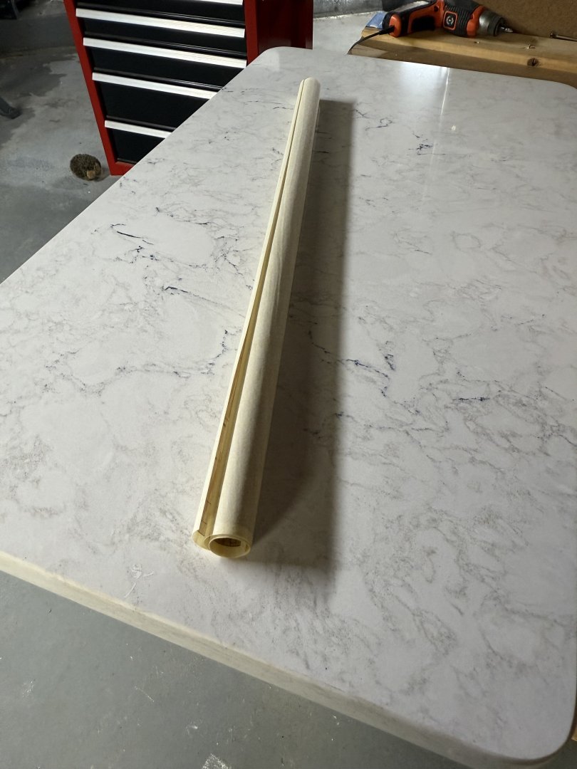

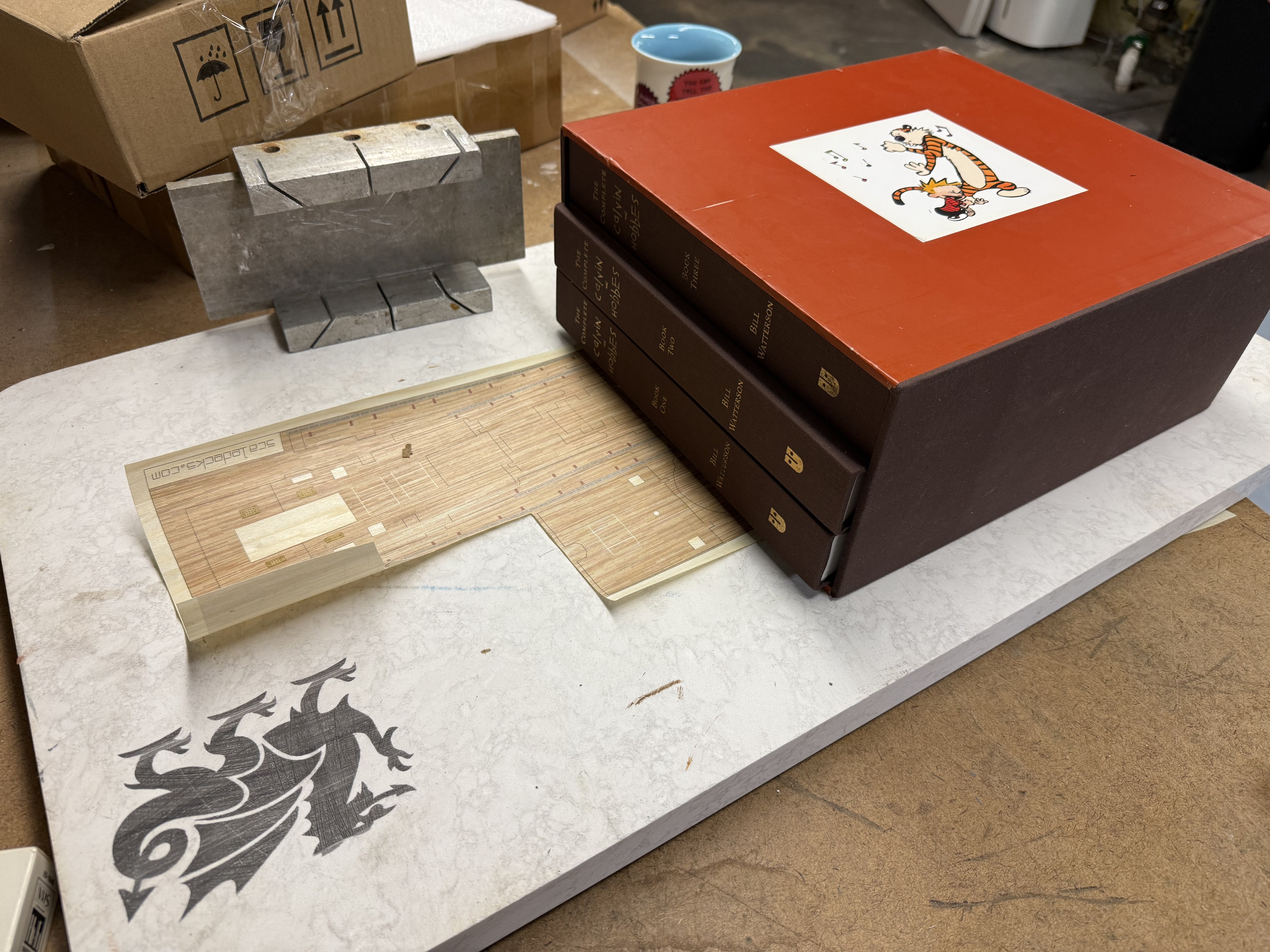

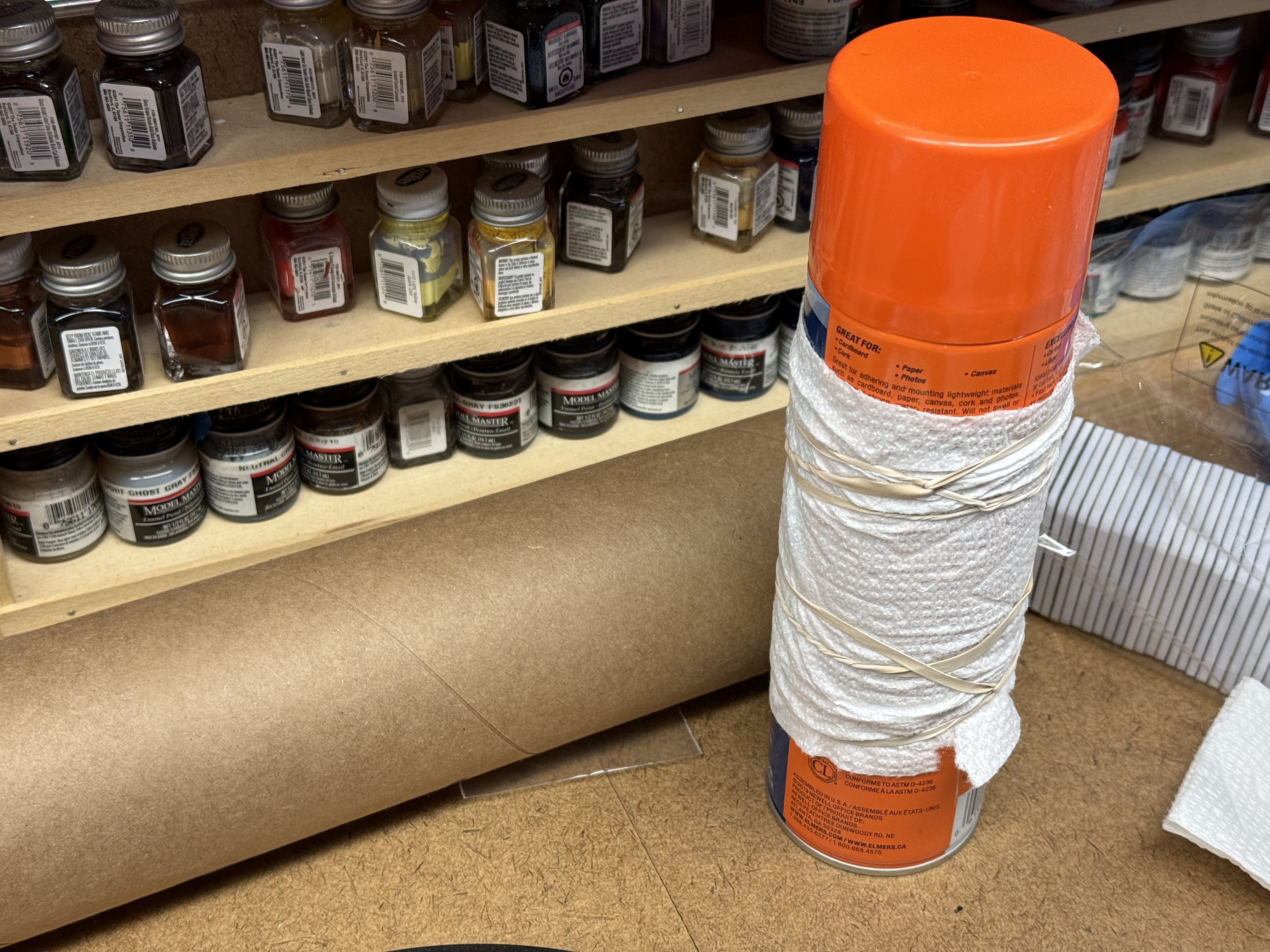

The deck paper came rolled up very tightly.  To flatten it I got the heaviest set of books I have (the complete Calvin and Hobbes) and put it on top.  I also tried cutting out one of the sections and wrapping it reverse-wise around a can, then wrapped paper towels and rubber bands.  Both worked somewhat. Ultimately, after leaving the decking under that book set for several MONTHS, the decks are suitably flat.

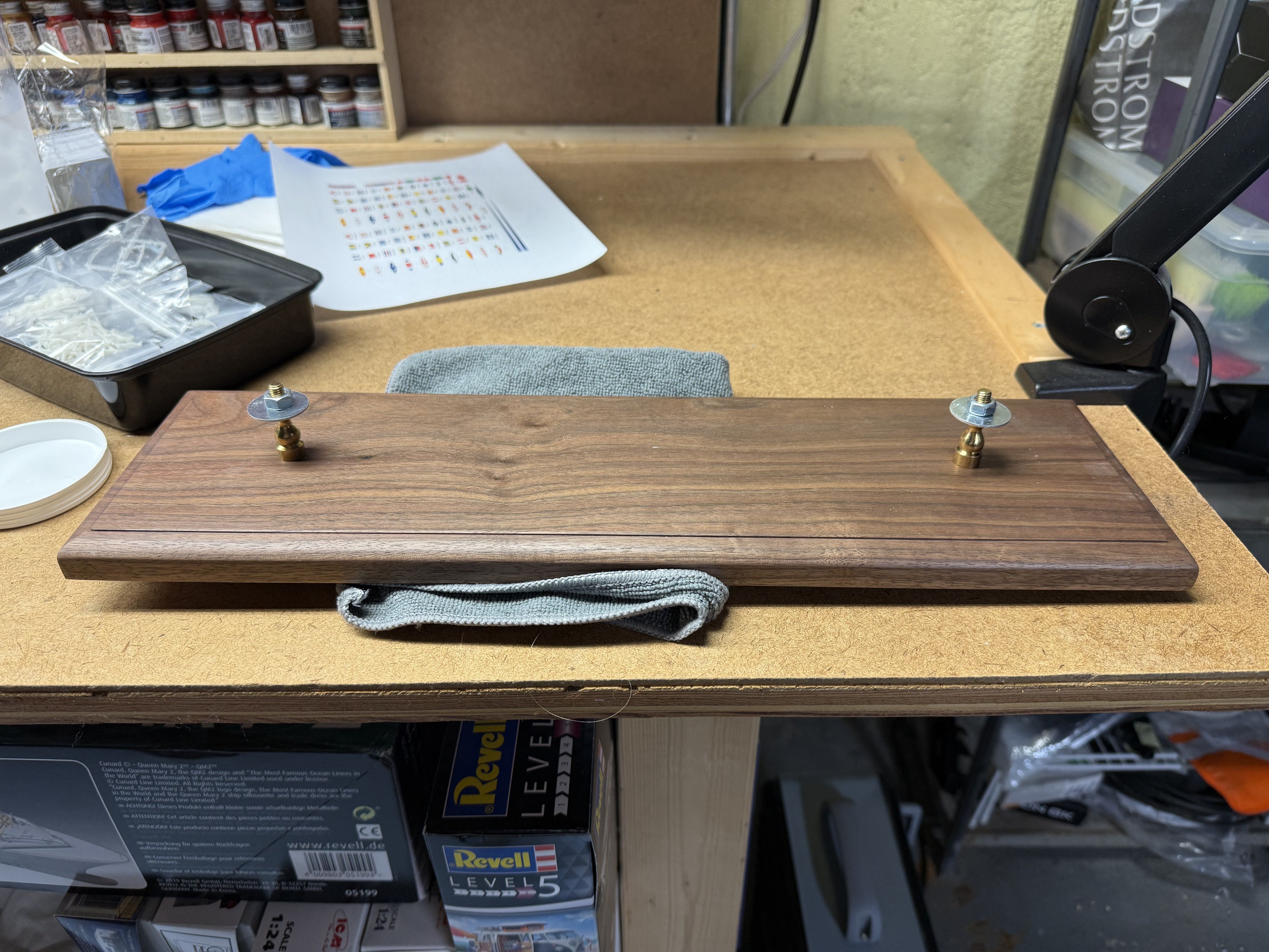

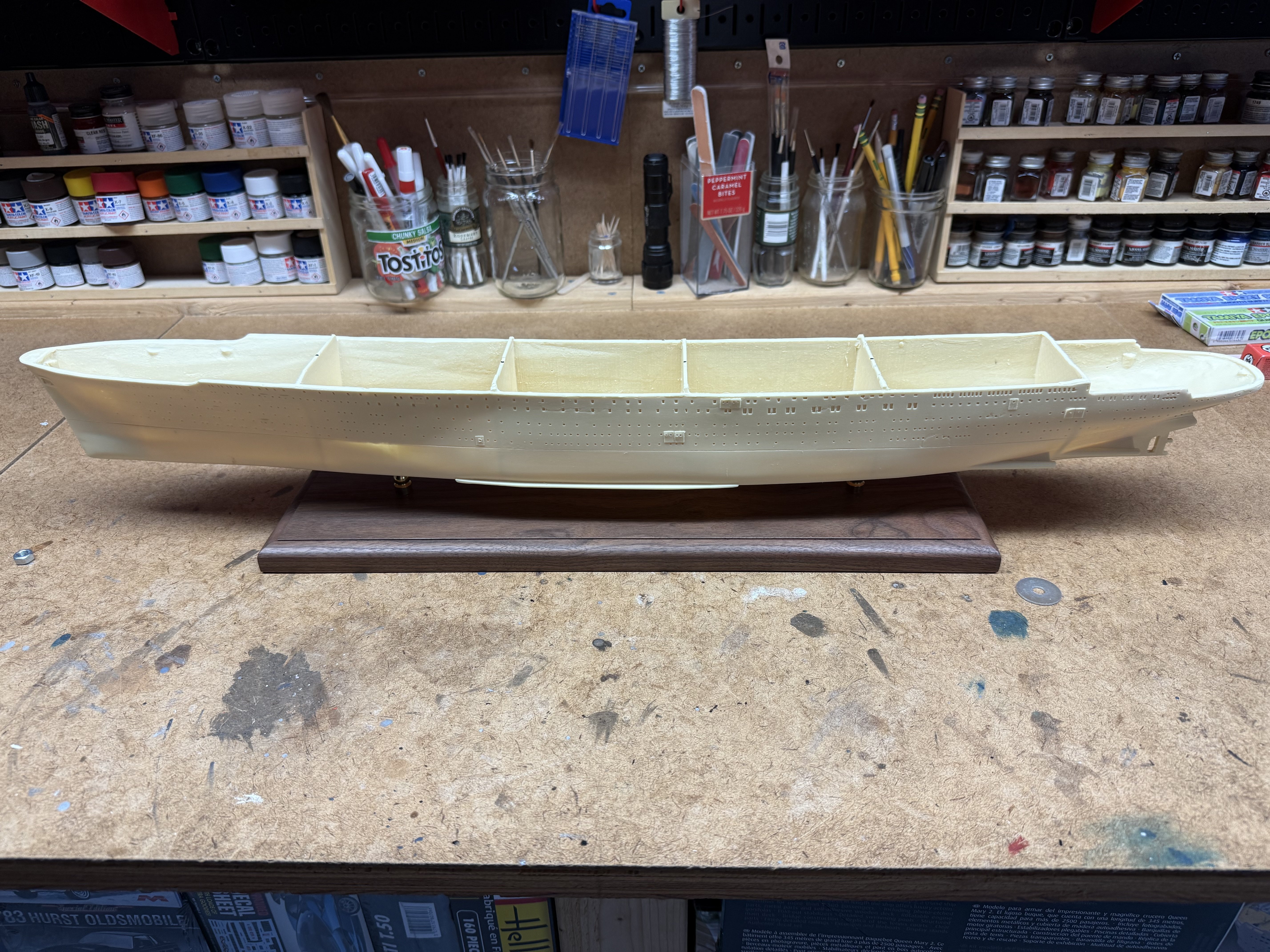

WOODEN STAND

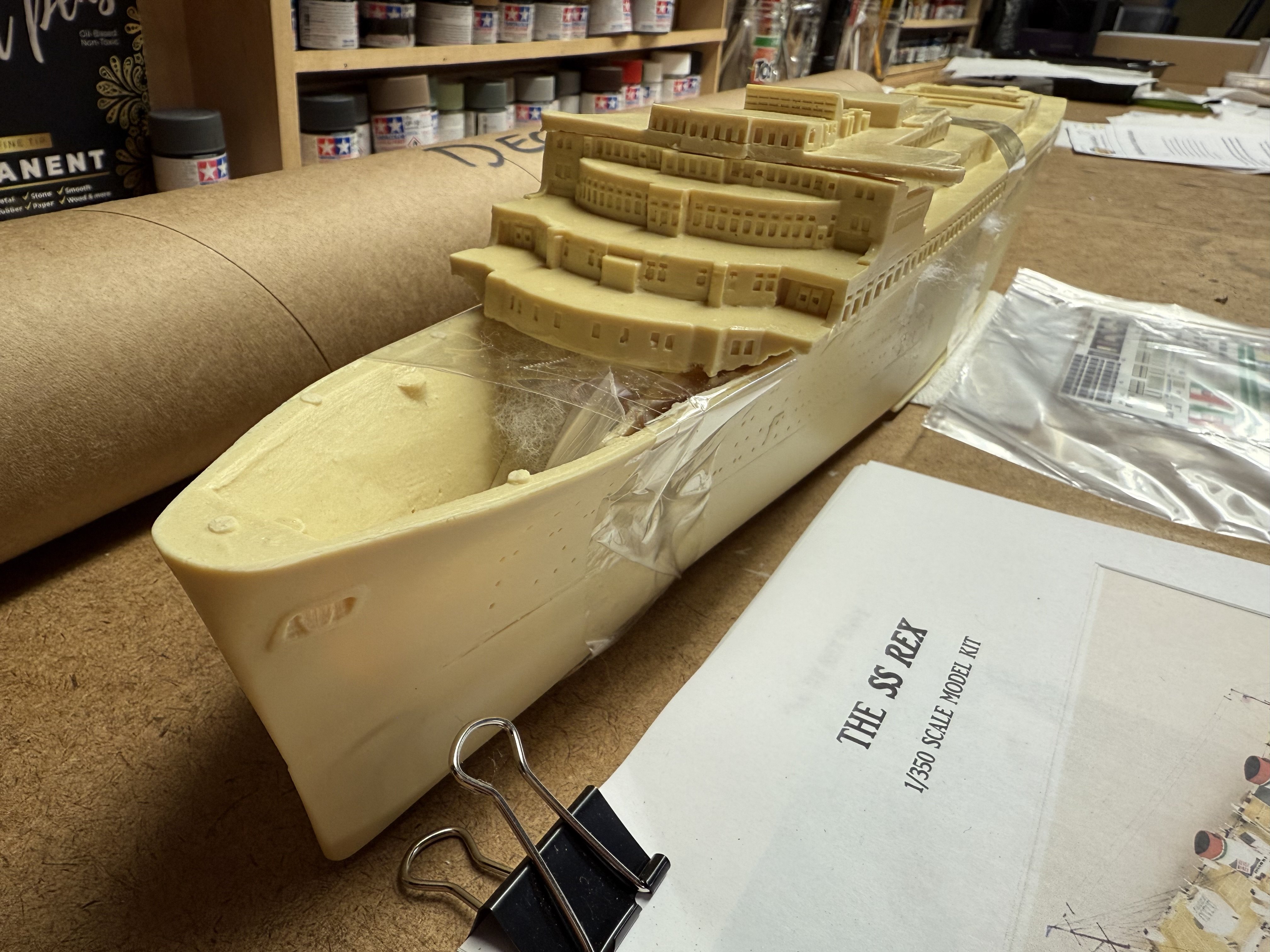

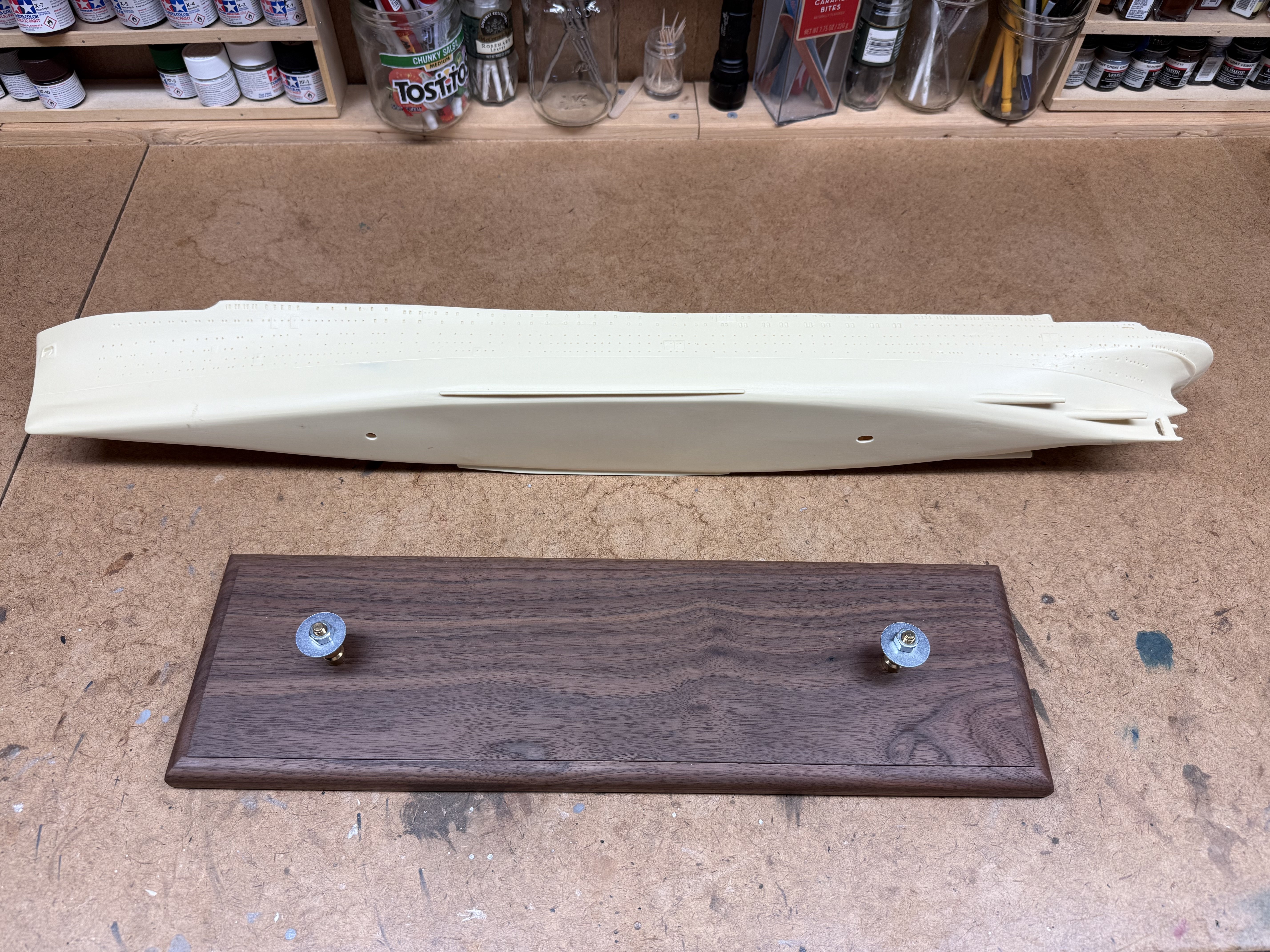

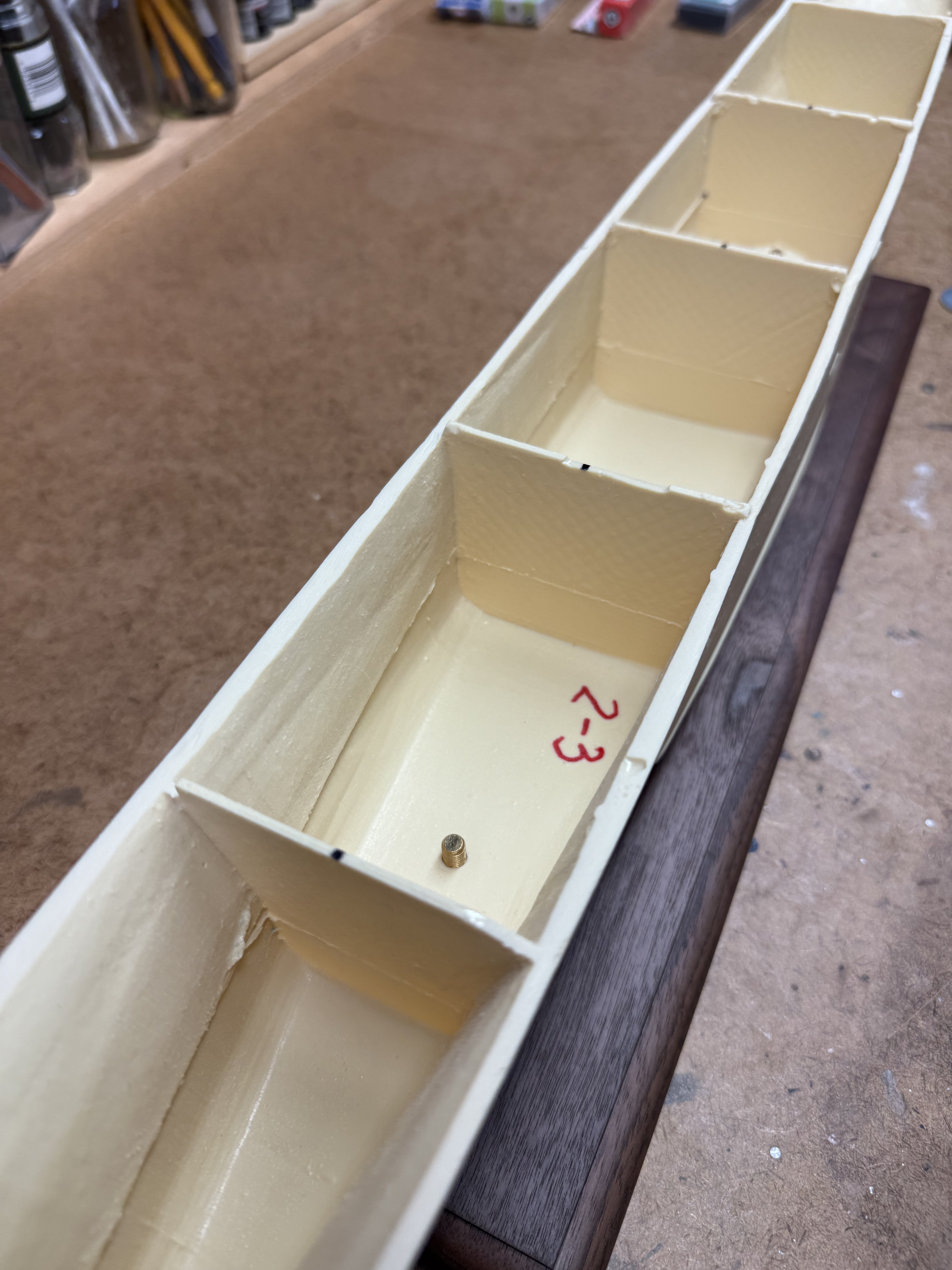

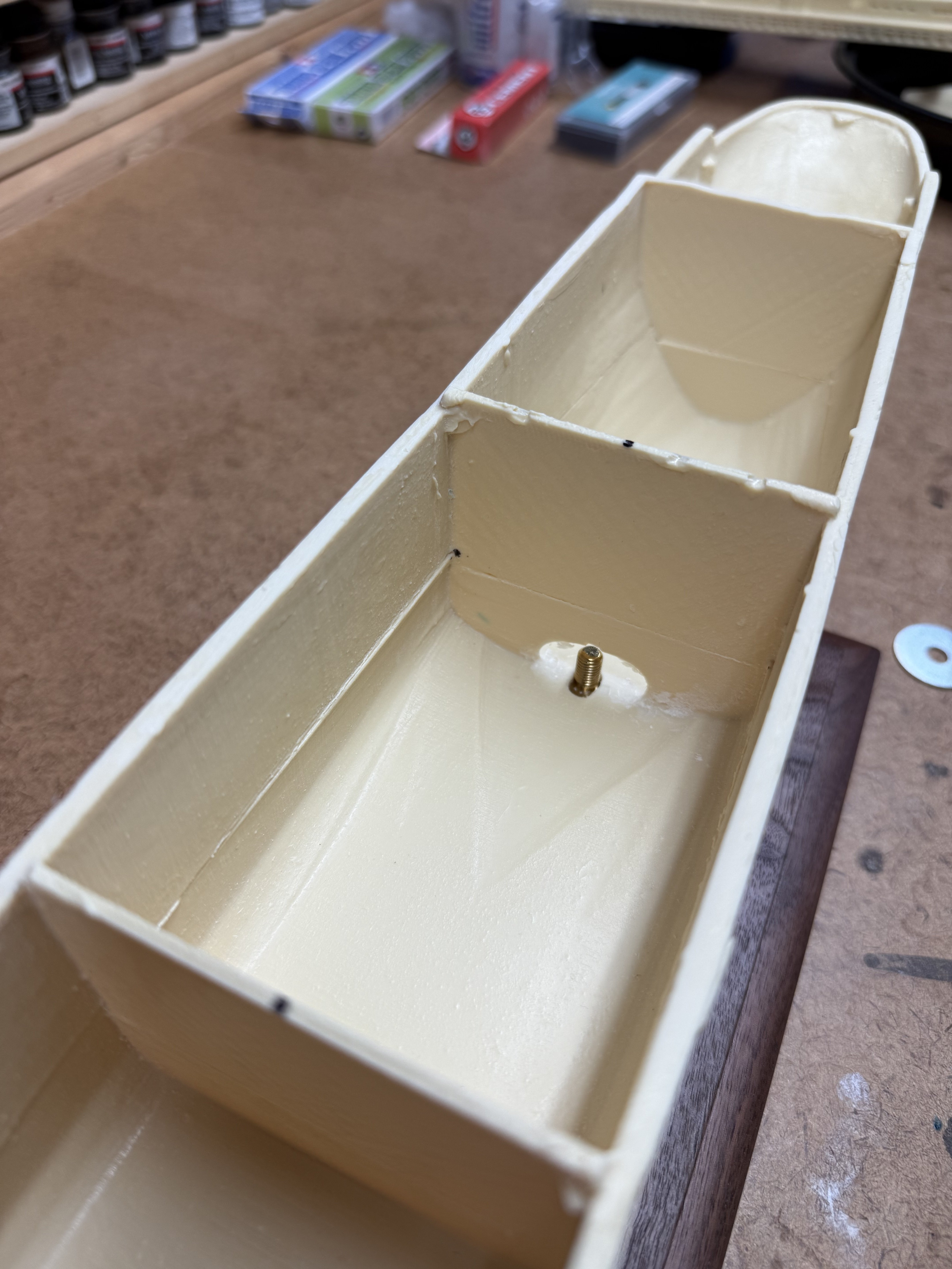

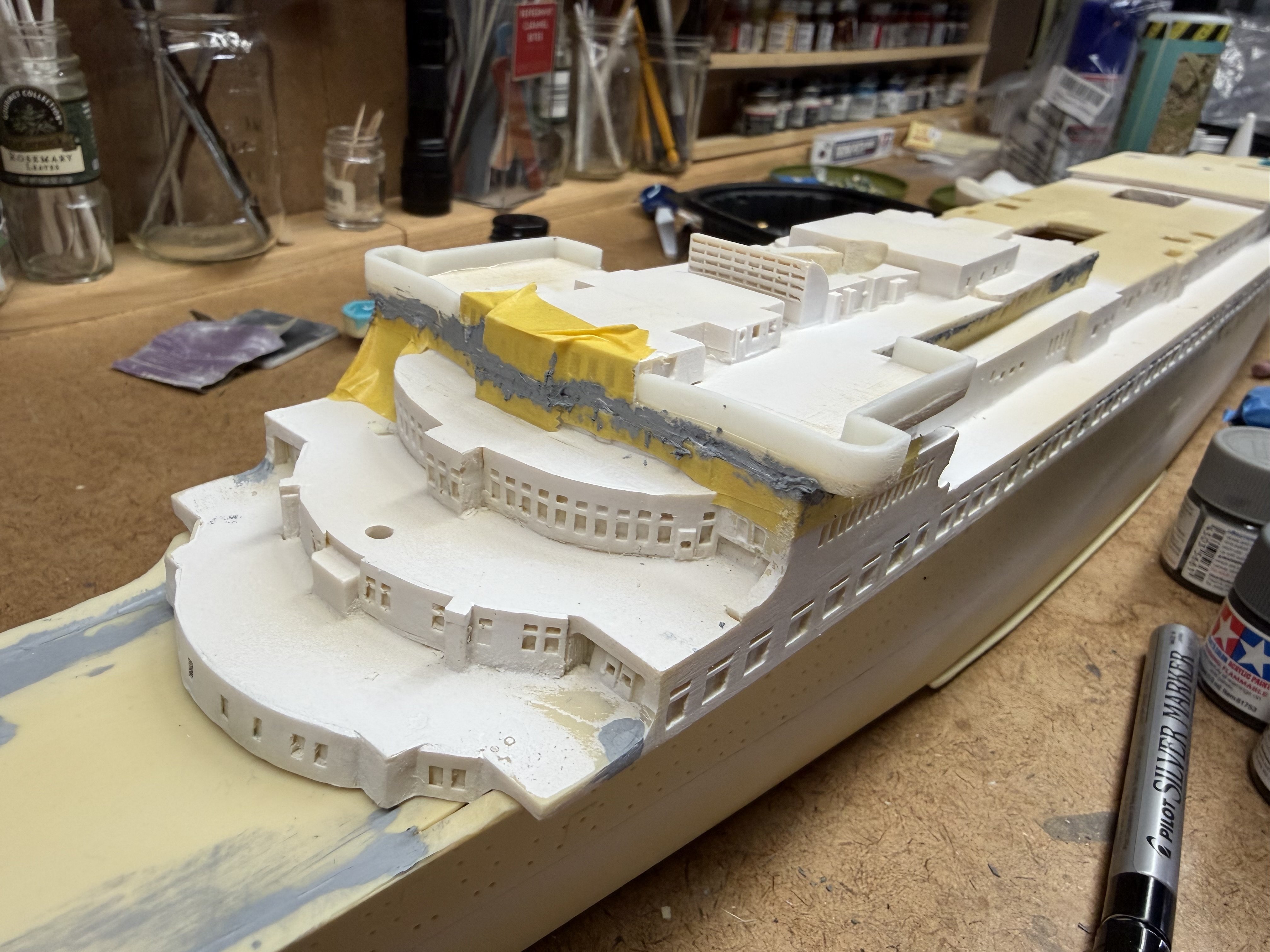

One of the first tasks was to drill the holes for the stand.  It has to be screwed on before I attach the superstructure, other wise I won't be able to get inside to tighten the bolds.  So the plan is to get the hull mostly done and painted, then attach the base.  After that, the rest of the superstructure, details, etc.  The stand will at that point be removable.
A slight annoyance was that the aft position for the stand post is right where there is an internal, support.  I cut it out and I should be able to screw the nut.

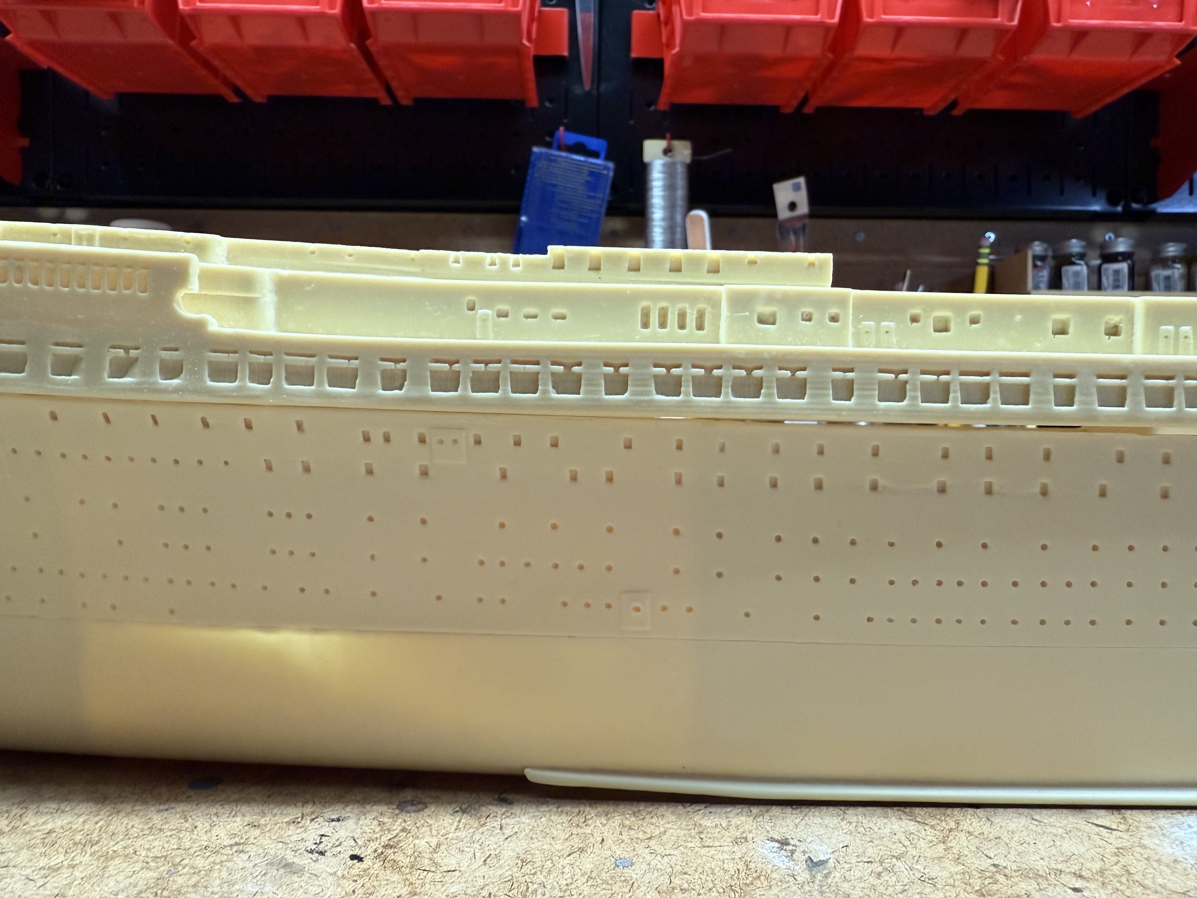

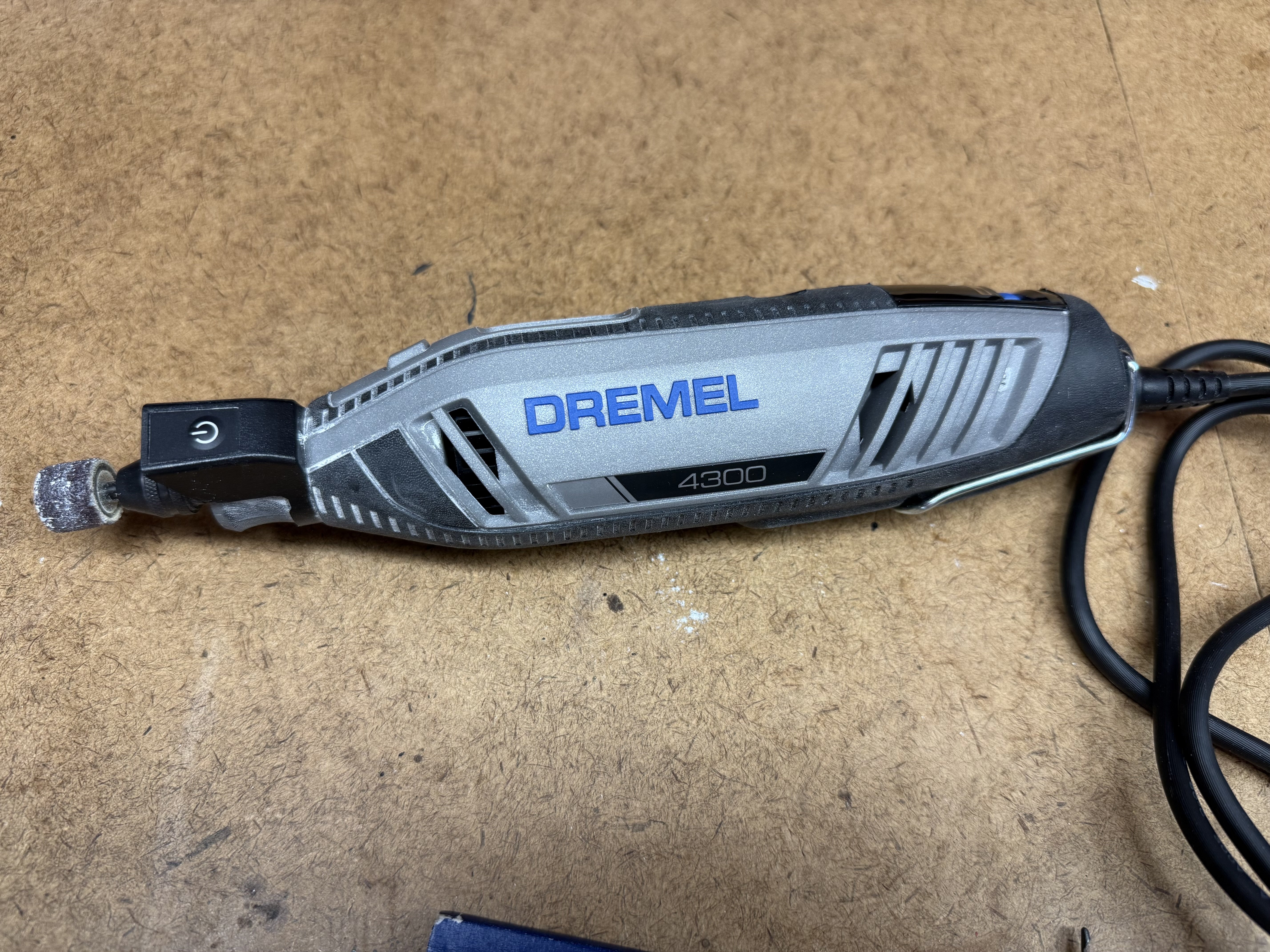

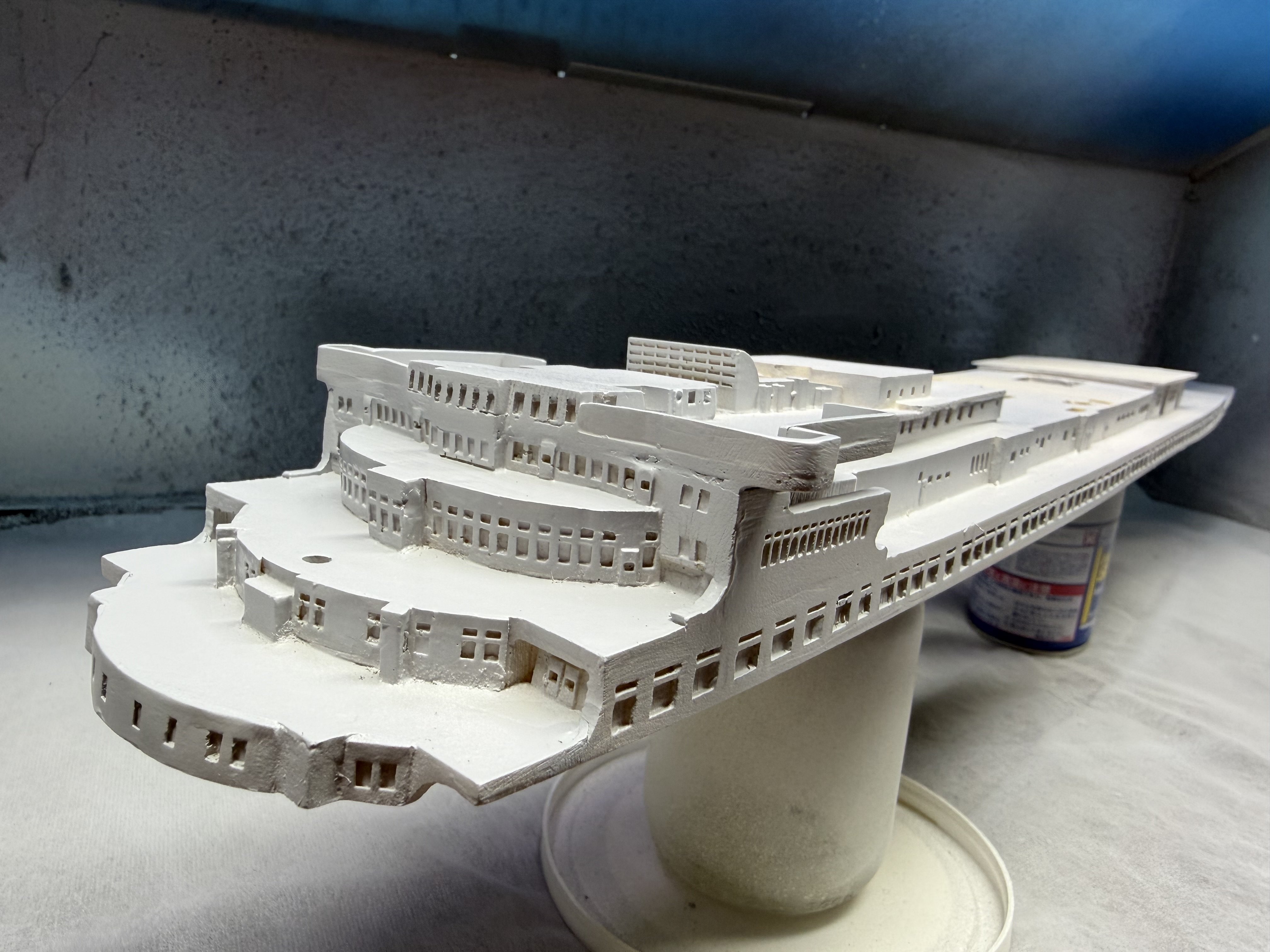

GRINDING AND DRILLING

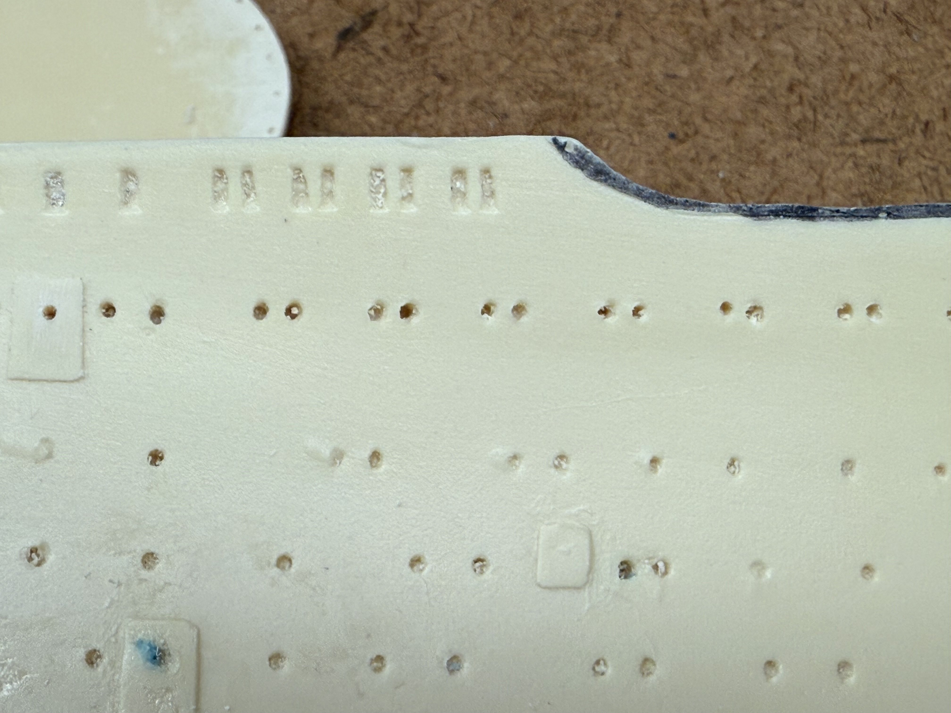

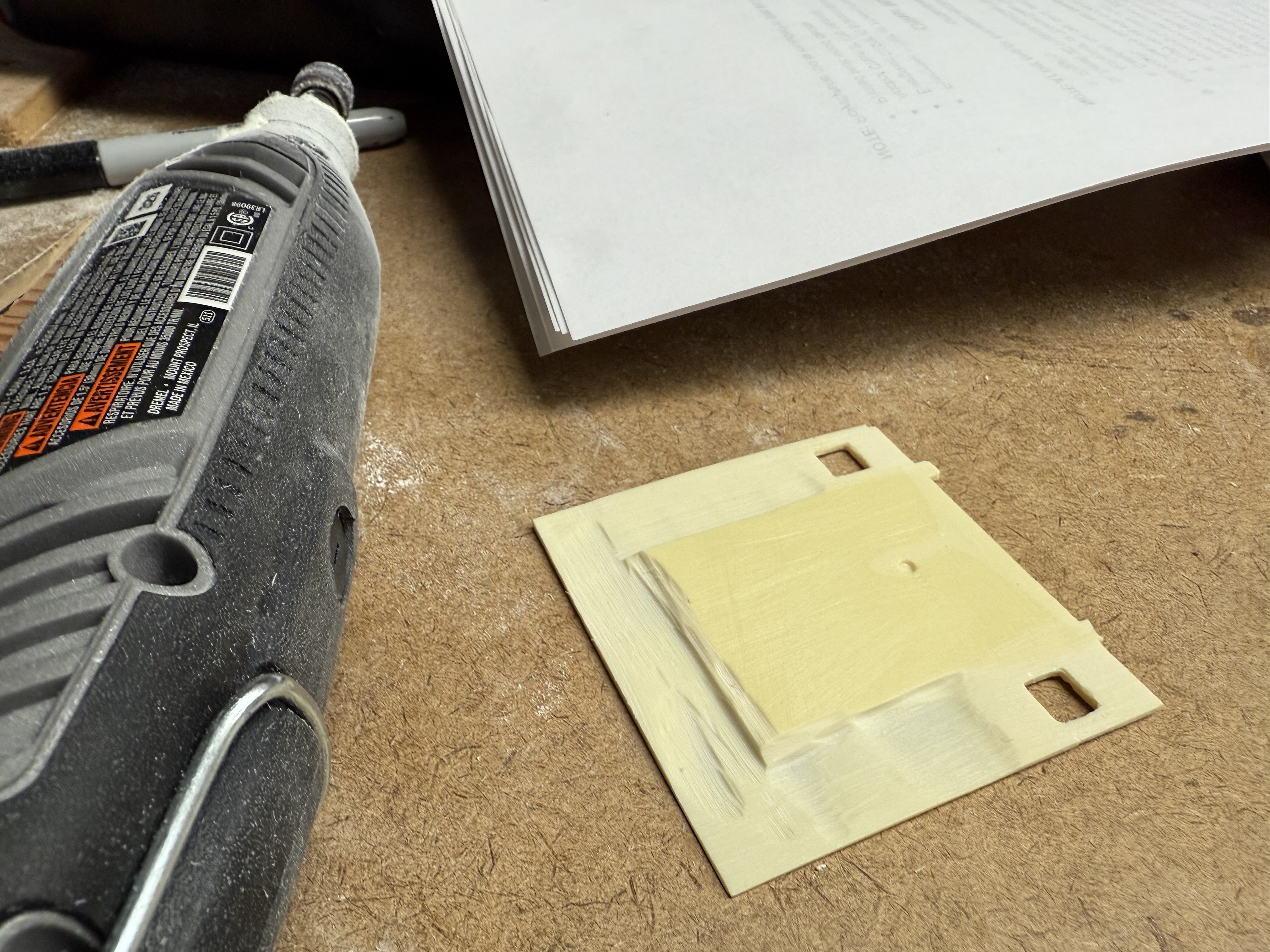

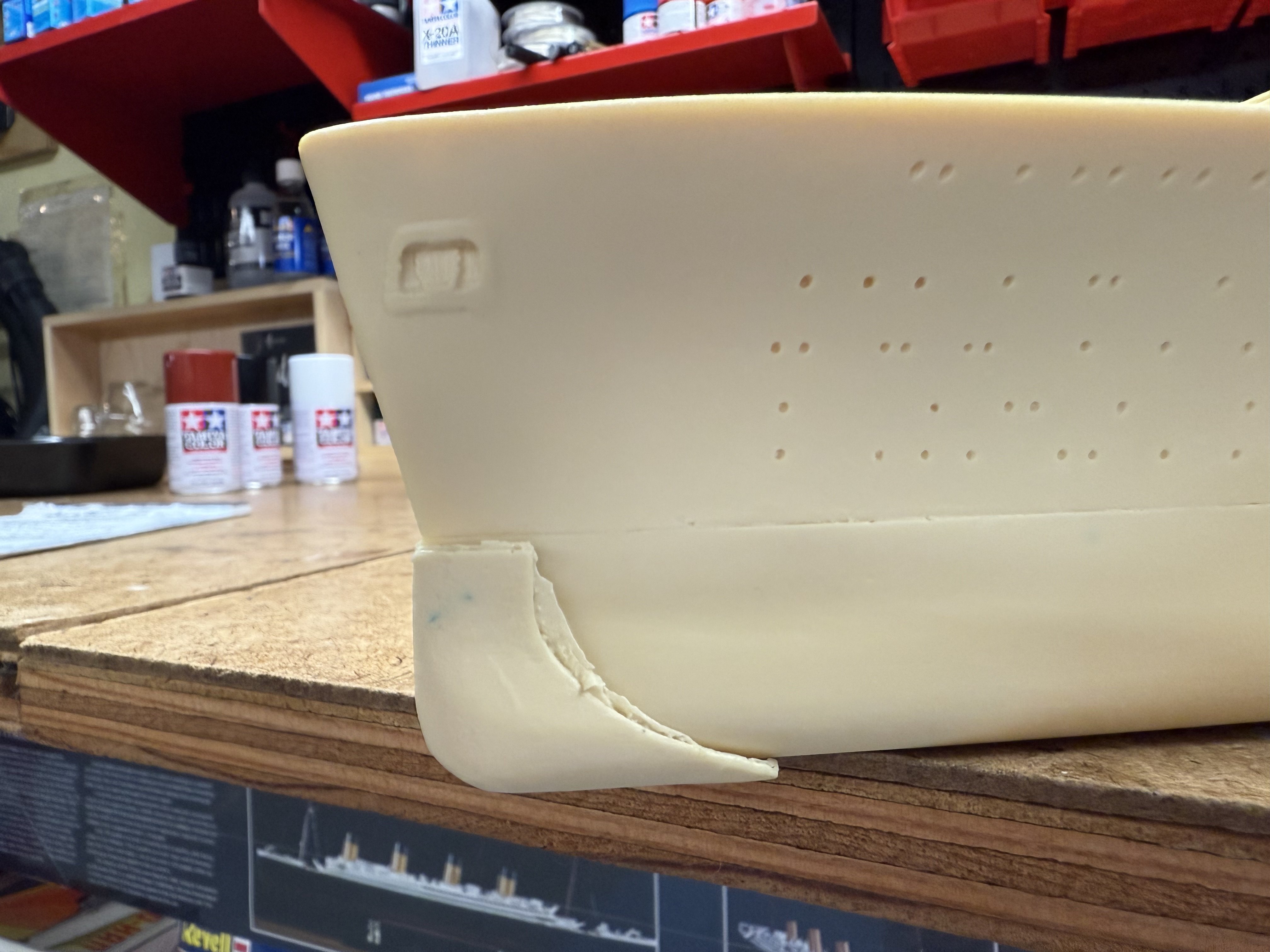

I used a Dremel with a grinding bit and had at the top of the hull, the main superstructure piece, and others.  One superstructure roof section was WAY too thick, and crooked getting thicker on only one side - I ground it way down.  I drilled out many of the portholes as they were not deep enough, or not there at all, or clogged (they are not cleaned out yet in the photo, I'll do that before painting).

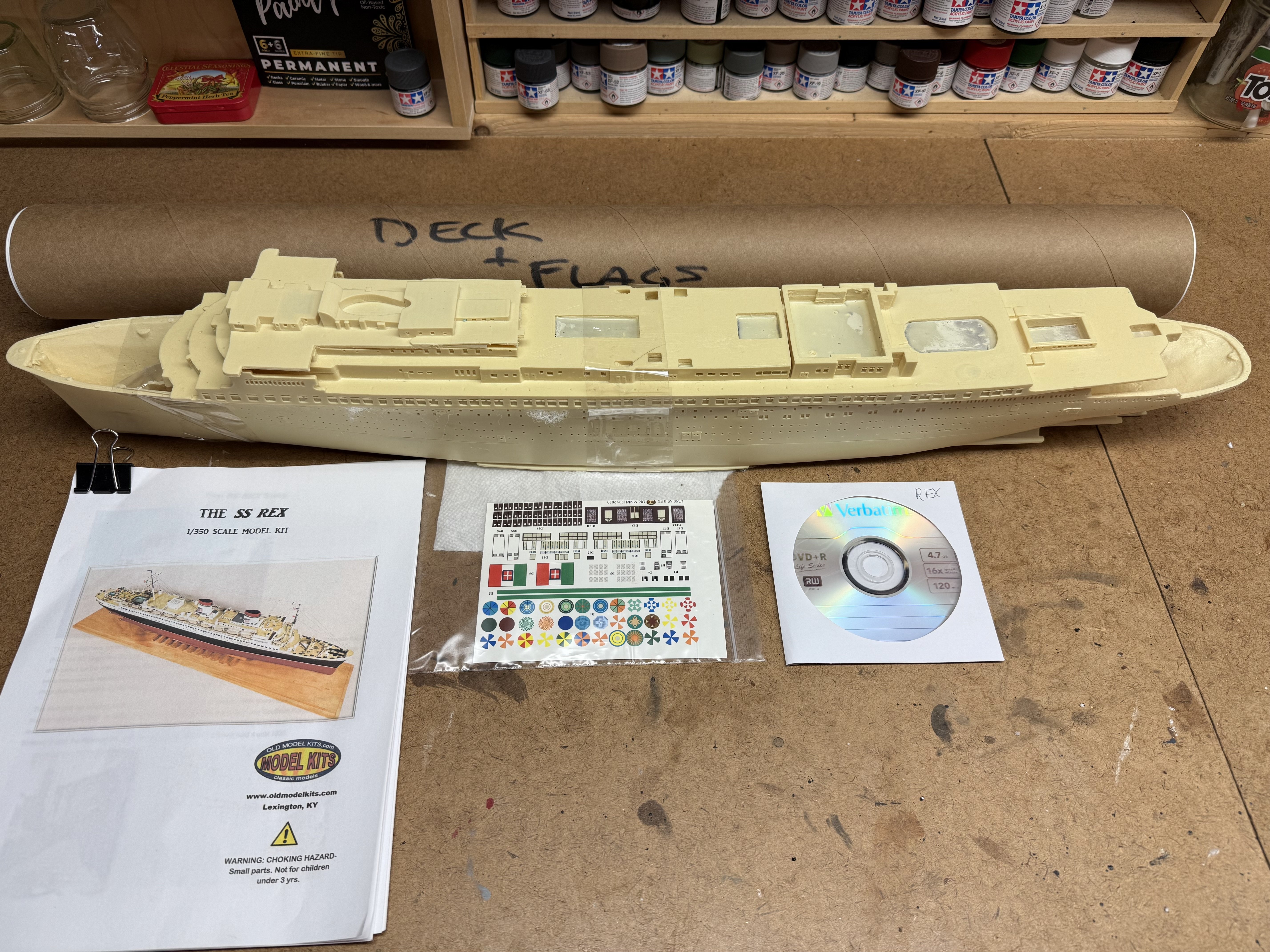

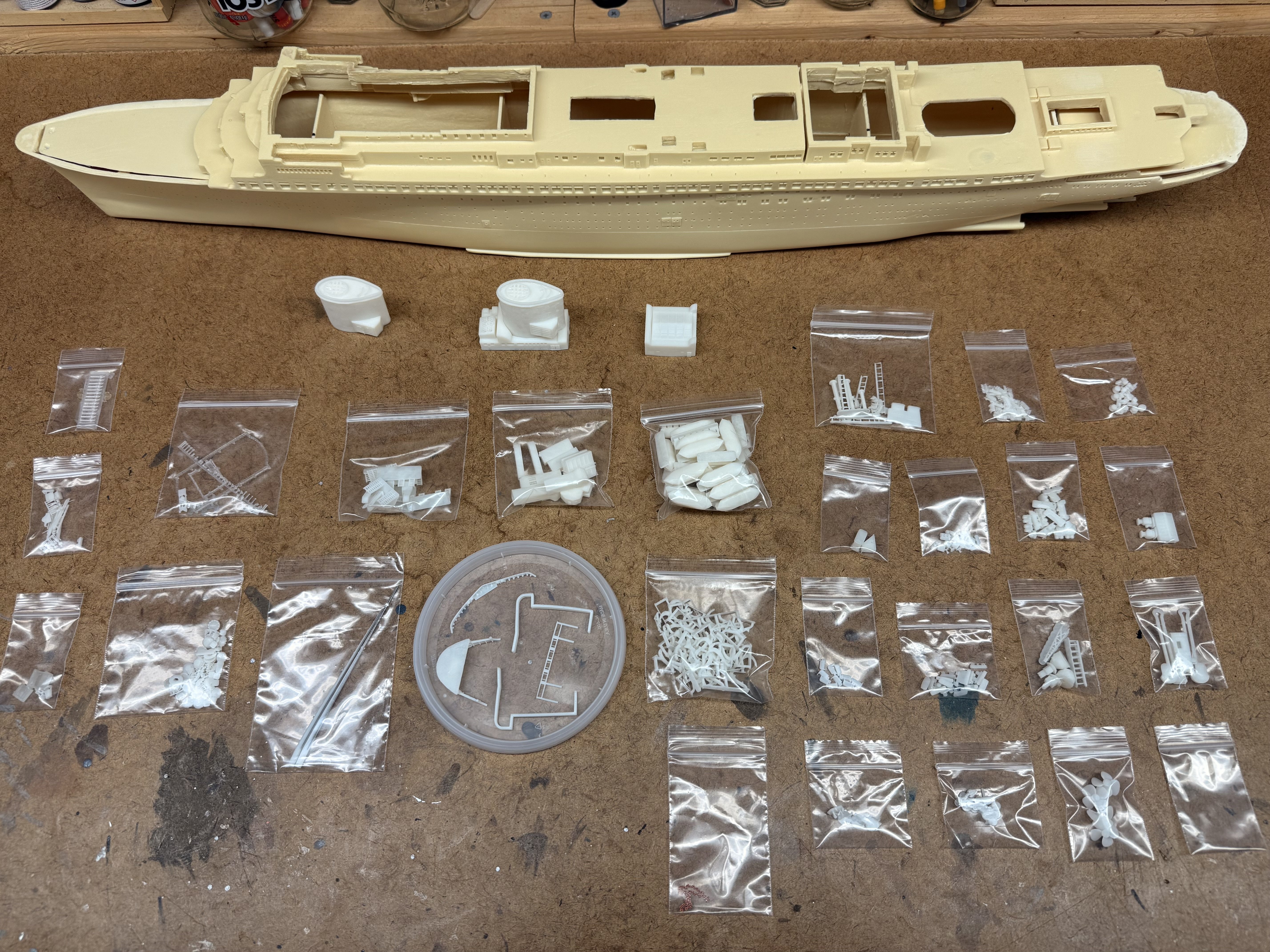

3D PRINTED PARTS

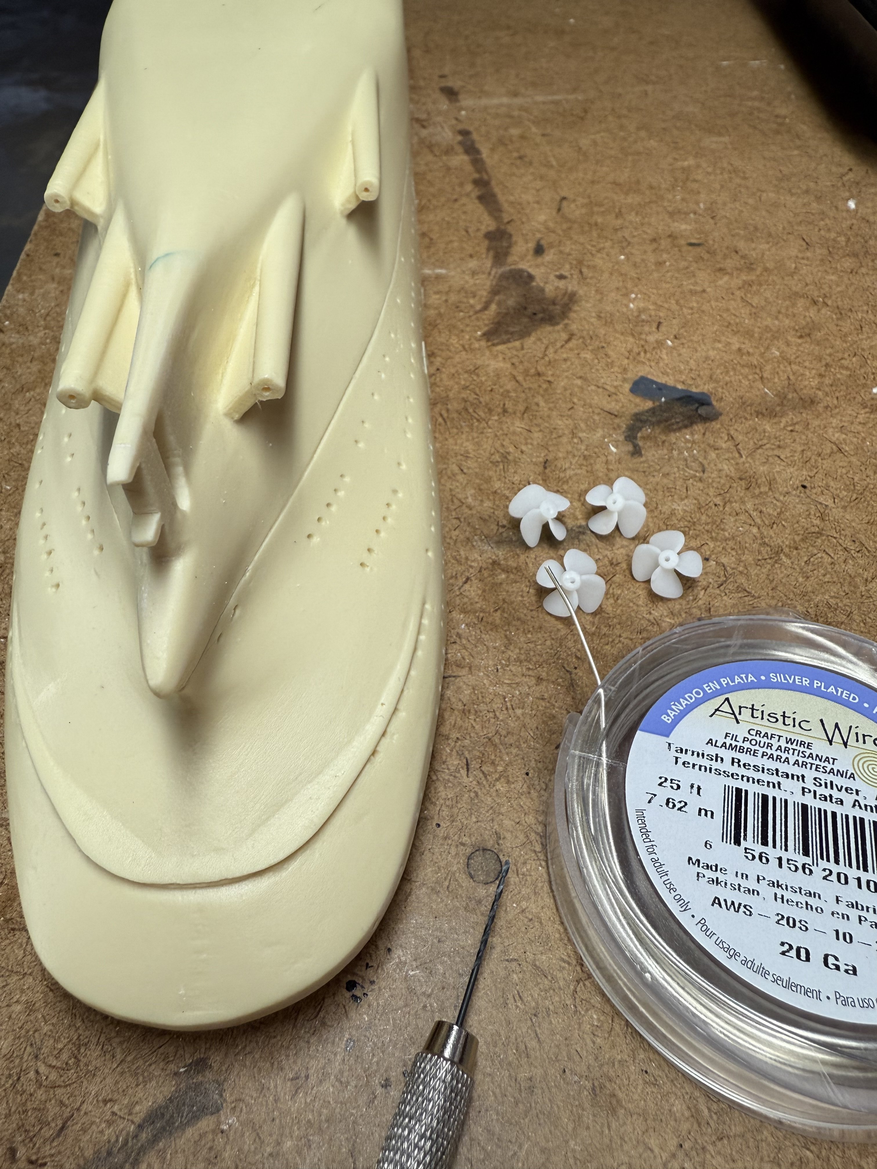

Before I forget, these are the 3D printed plastic parts.  These were all in baggies packed inside the hull.  They are finely detailed, and there are hundreds of them.  Detailing the decks will be a lot of fun.image.thumb.jpeg.a739510e17f891d6cf86cdd8def6e8da.jpeg

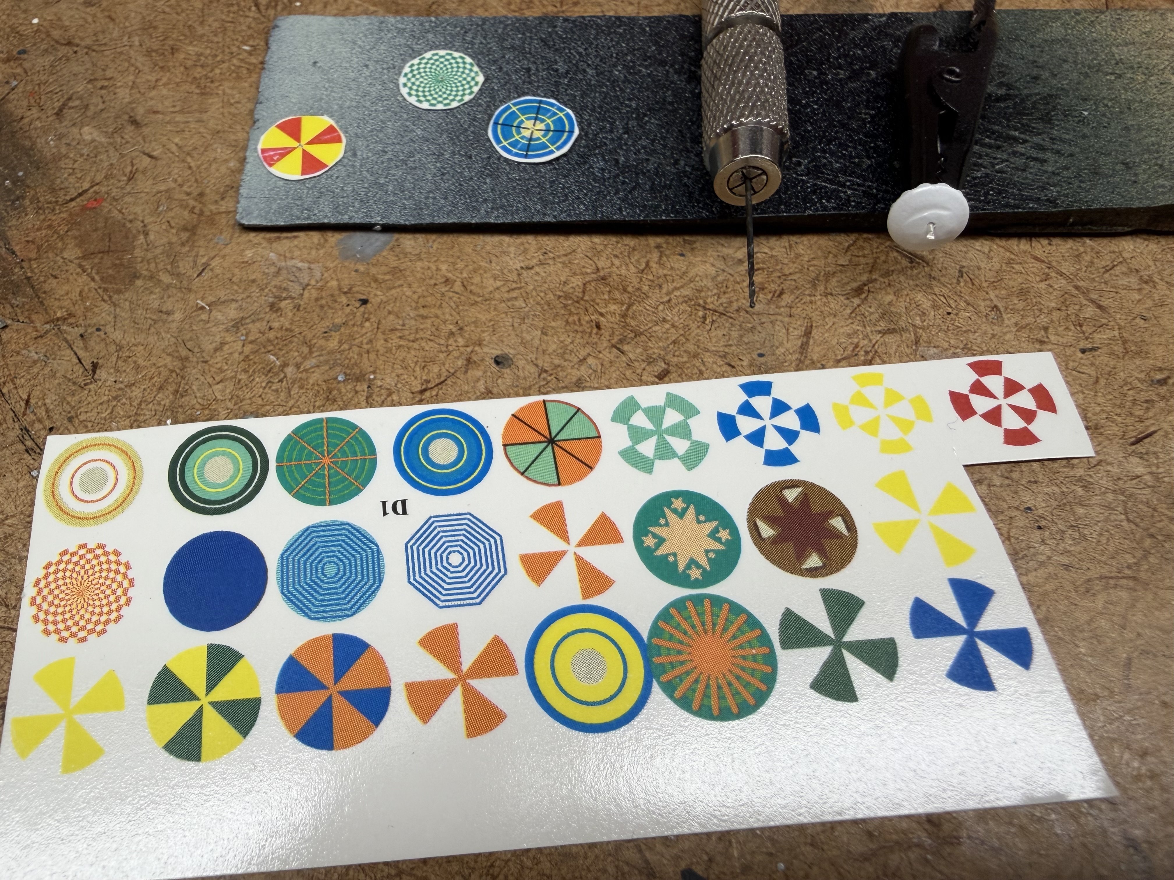

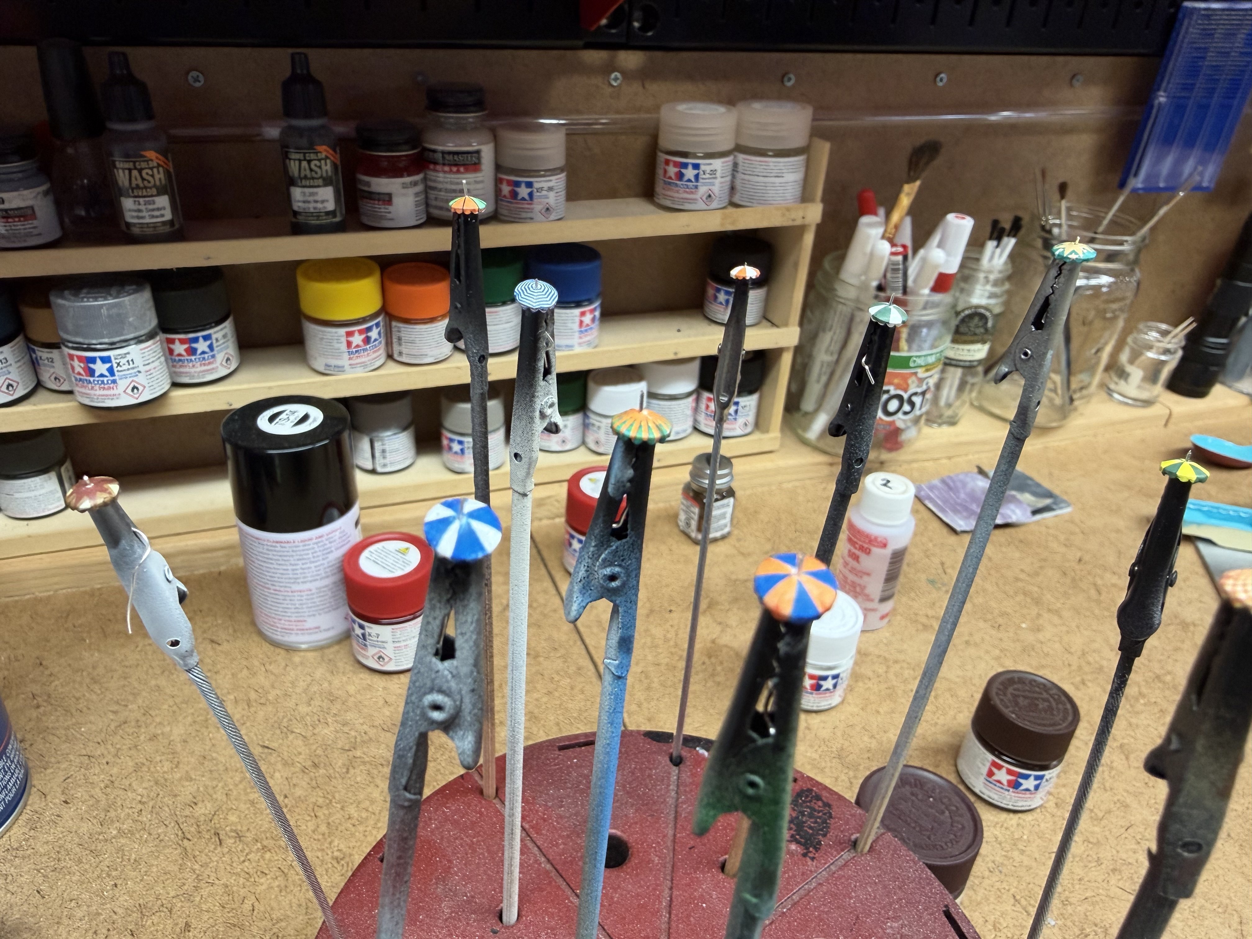

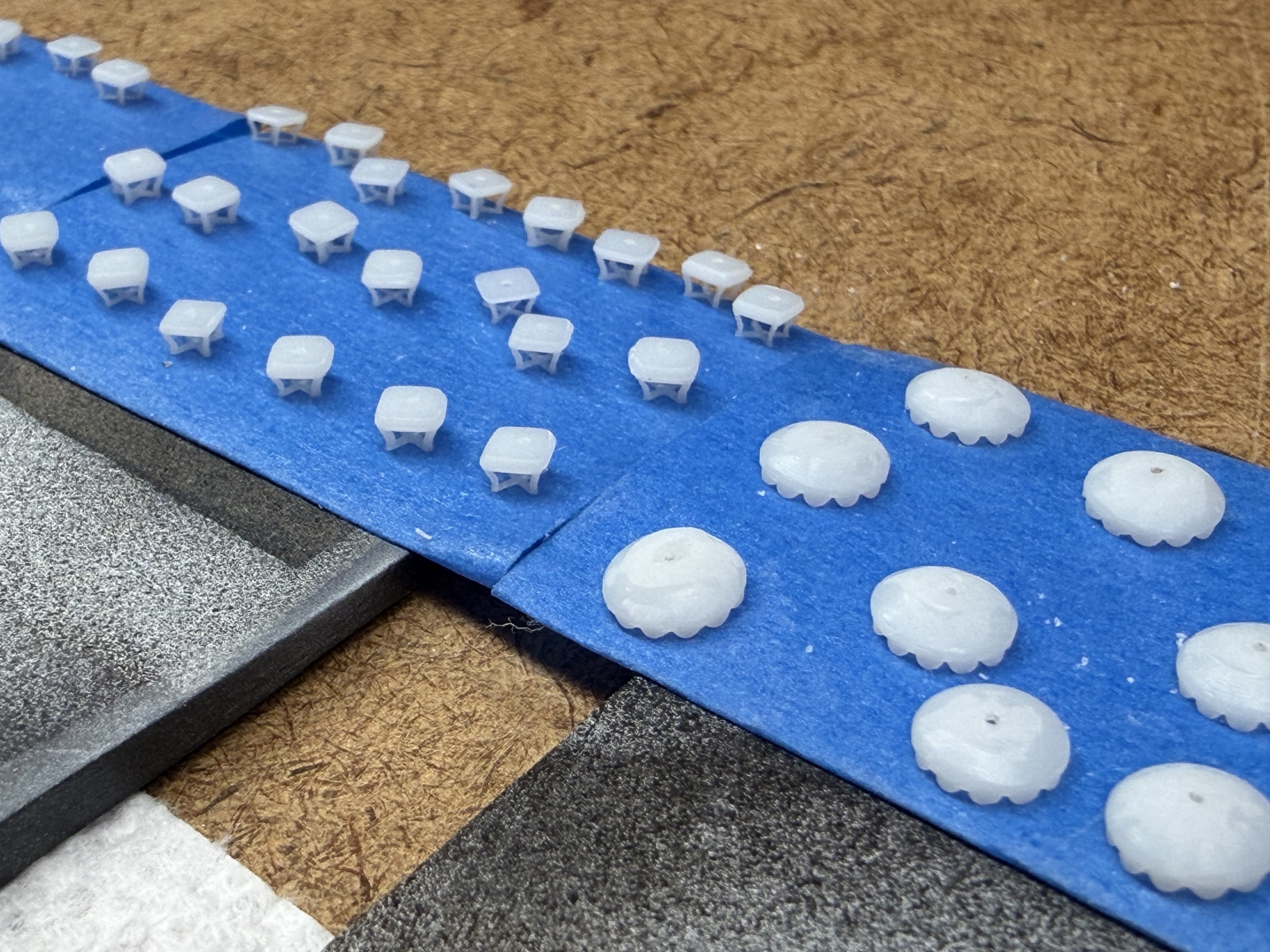

One of the fun parts of this kit is all of the colorful little umbrellas on the pool deck.  Each tiny little umbrella has a tiny little decal which must somehow be applied, centered, and molded into shape.  I settled on a technique where I score the decal and drill a hole in its center, poke wire through a corresponding hole in the plastic umbrella (which will ultimately connect the umbrella post), then finesse it with microsol until it conforms.  After they dry I brush on some Tamiya semigloss acrylic to seal them.  Quite labor intensive but I'm looking forward to the result.  There is a future post coming up on little teeny tiny deck tables that go with them...
