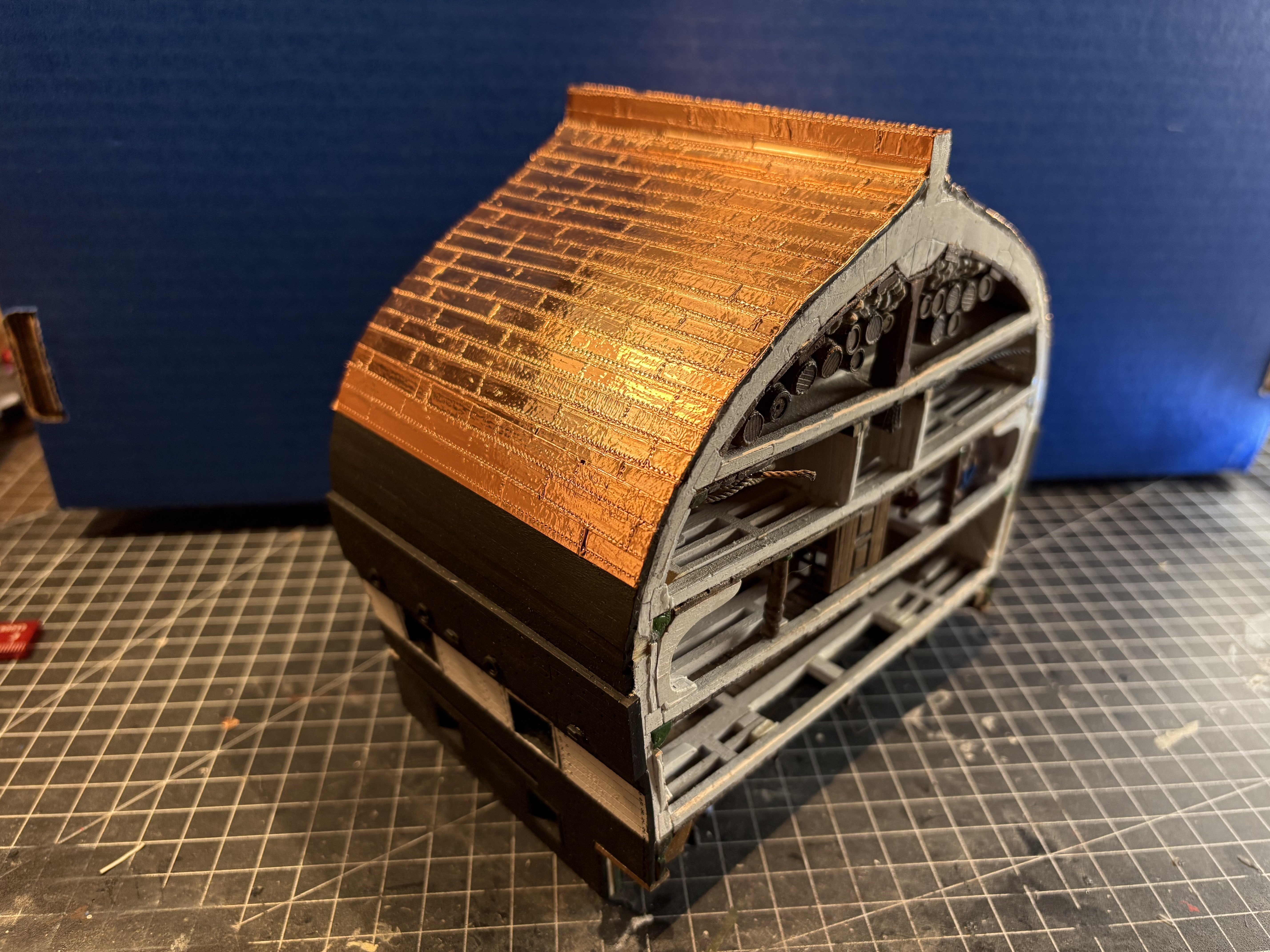

Next came the ballast in the keel. I struggled for a long time over whether to use iron ballast, as I didn't really like the look of the stones. But after finding no evidence that the Constitution did not use stones as ballast, I had no choice but to use them.
And then came the first exciting step for me as a greenhorn. Laying the deck planks between the hold and the lower deck.
I had several types of wood sent to me and then decided on smoked oak. This came closest to my ideas of color and structure, as I wanted to leave the wood natural.
I added a few more barrels (I also improved the quality a little here) and this part of the ship was finished.

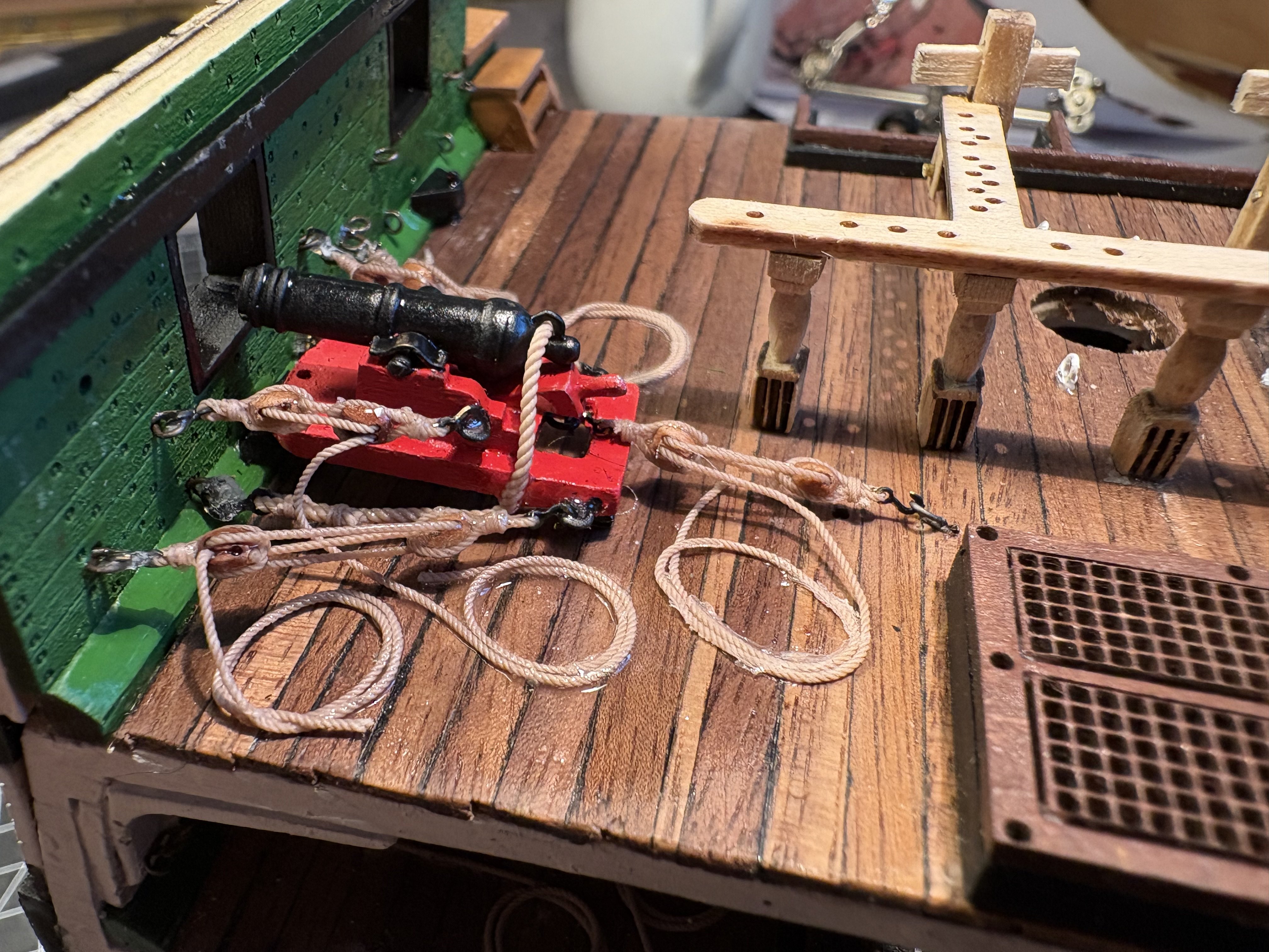

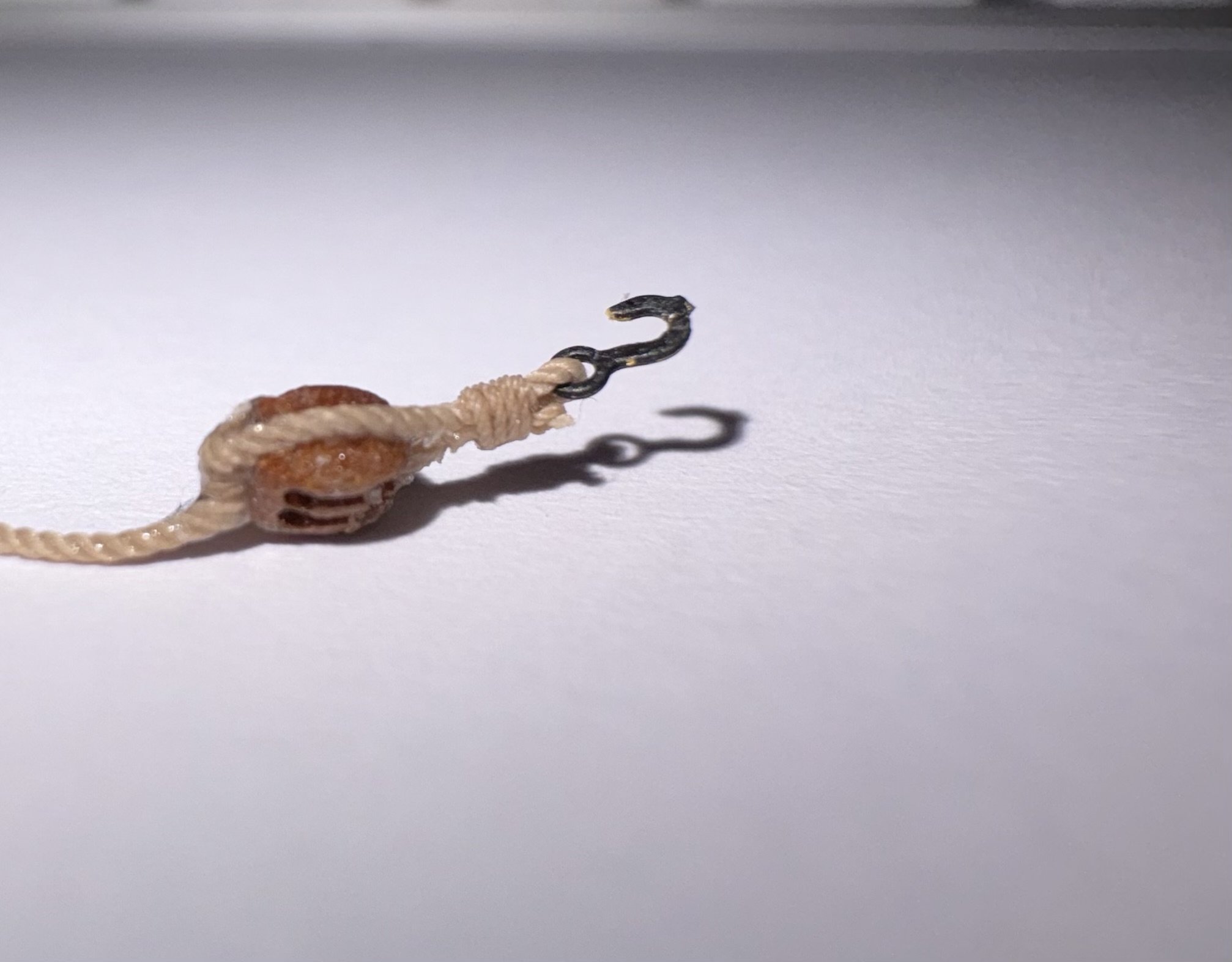

Now I finally wanted to do something with ropes and blocks and started building a long gun, even though that would have been the next step after installing the berth deck.
I wanted to try out to serve a block and all the new challenges at least once, so I quickly decided to rig a long gun.
I made a replica of part of the gun deck so that I could rig my cannon in peace and try everything out before finally attaching it to the deck of the Constitution.
image.thumb.jpeg.e7867185cadea400ca9771ab8f42701e.jpeg  image.thumb.jpeg.06d60d1a6f5da44d6043202e2fc2304c.jpeg
This is my first attempt at using ropes, and I ask the kind readers of my log to bear with me.
I promise I'll get better. And above all, faster. That one cannon cost me a day's work. I don't even want to imagine what that would mean for a ship like the “Nuestra Señora de la Santíssima Trinidad” with its 140 cannons. Probably half a year's work like a master watchmaker.
So, now we're up to date, and from now on, posting will be a little slower, I assume. I'll also show more intermediate steps.

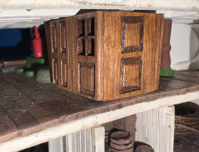

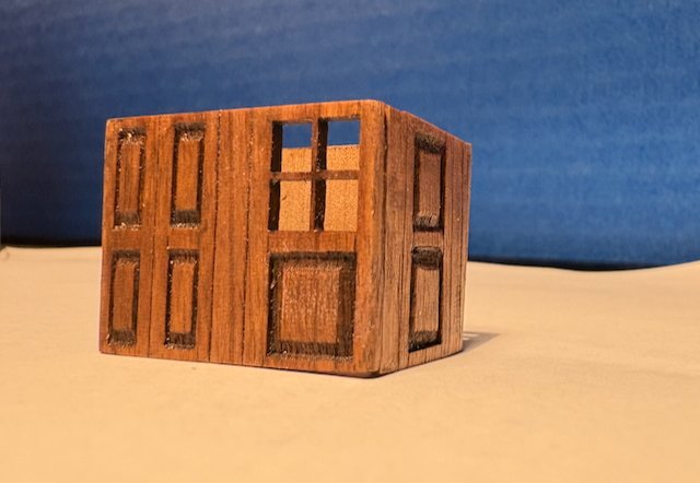

The only mystery to me is this cabin in wood colour on the berth deck. i built it because it appears in all photos, including those of the current USS Constitution in Boston harbour.
 Tomorrow, I will start with the gun deck. Many exciting things await me there. Especially the guns. I have already practiced and completed a sample gun.
I'm coming back to the wooden cabin on the bert deck. I took another look at my built-in construction and was dissatisfied with the quality of my work. It wasn't nicely done and was too small, as the water pump pipes also had to go through this cabin.
I decided to rebuild the cabin.

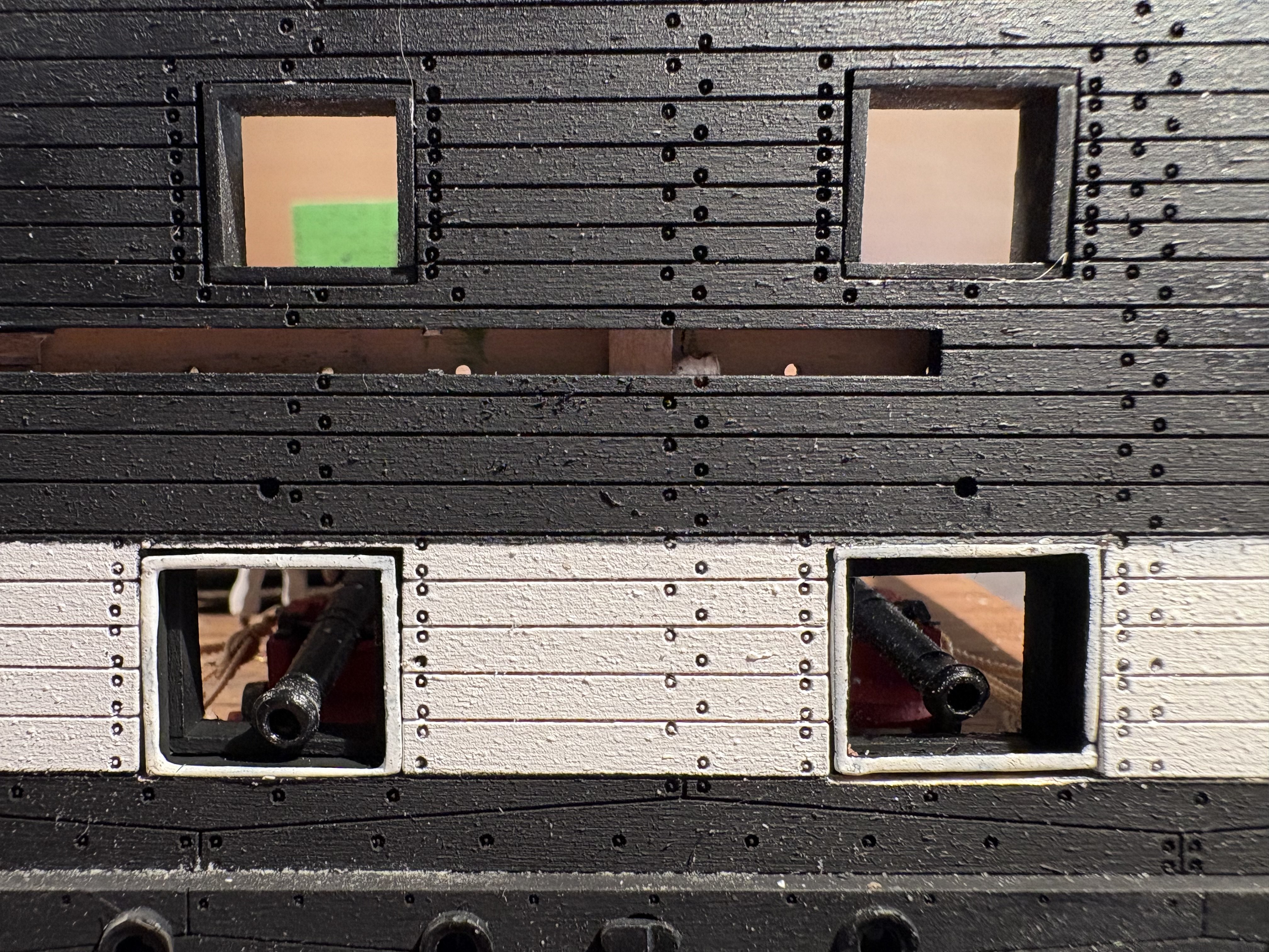

First, the support structure for the spar deck, consisting of standard knees and diagonal knees.

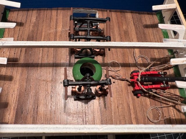

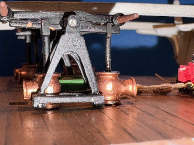

Then it was time to install the pump units.
Since they were made of soft Britannium, they were quite bent and poorly cast and needed careful reworking.
Then I installed my first gun, which I had already built in advance because I was so interested in working with the ropes and tackle blocks.
Incidentally, I really like the look and colour of my deck made of smoked oak. I recently read a page-long discussion in a model shipbuilding forum about the width and thickness of deck beams. It was about the contradiction between historical dimensions and their implementation in models, which sometimes deviates to give the model ship a more pleasing appearance.
All I can say is that my deck planks have the historically researched dimensions. And I don't like the over-the-top representation of deck fixings on many model ships, with nails and dowels that are not to scale. I decided to be more restrained and only hinted at the caulking.
I like it, and it's still up to the model builder to choose.

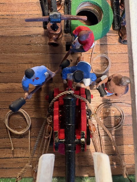

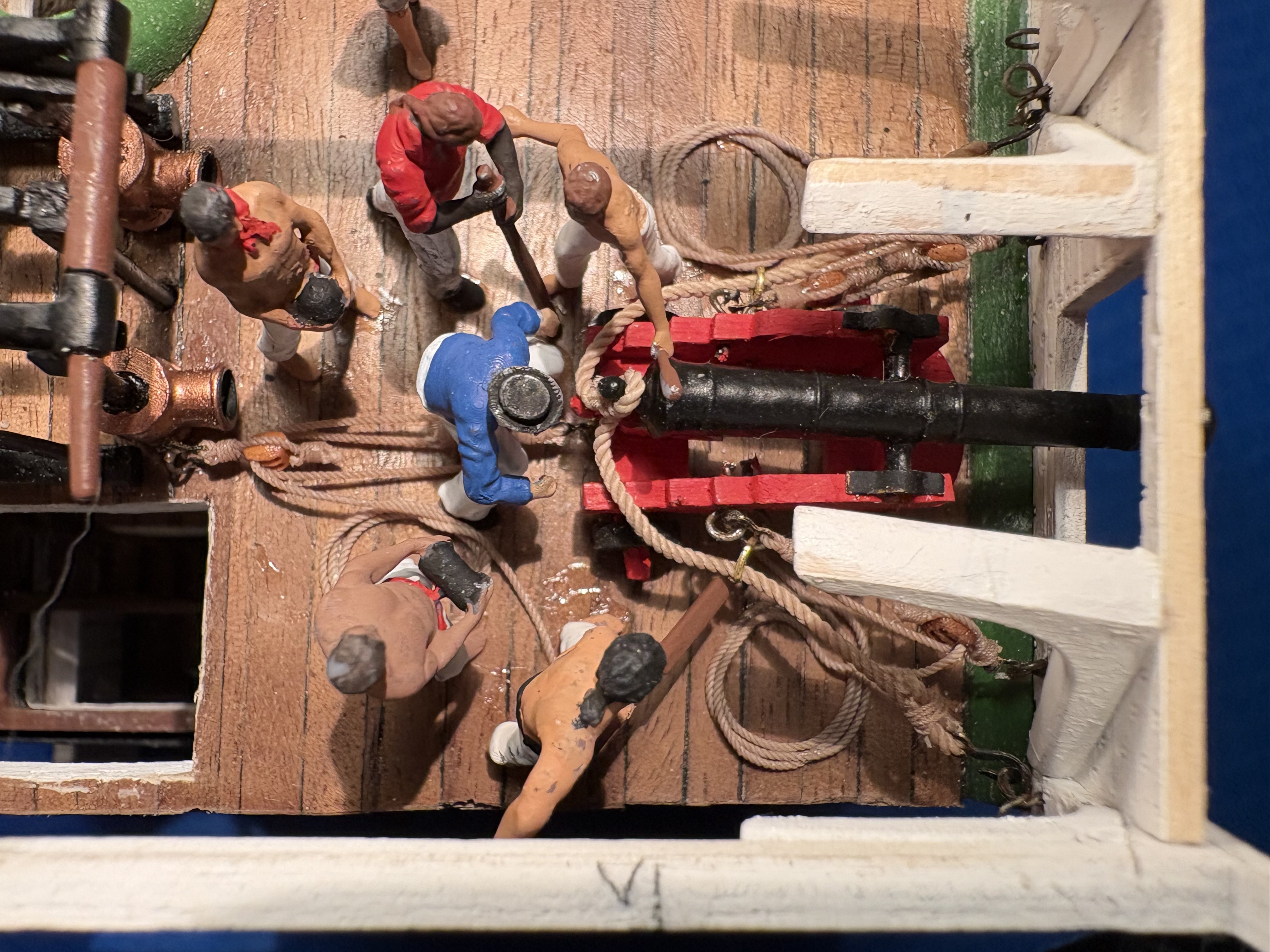

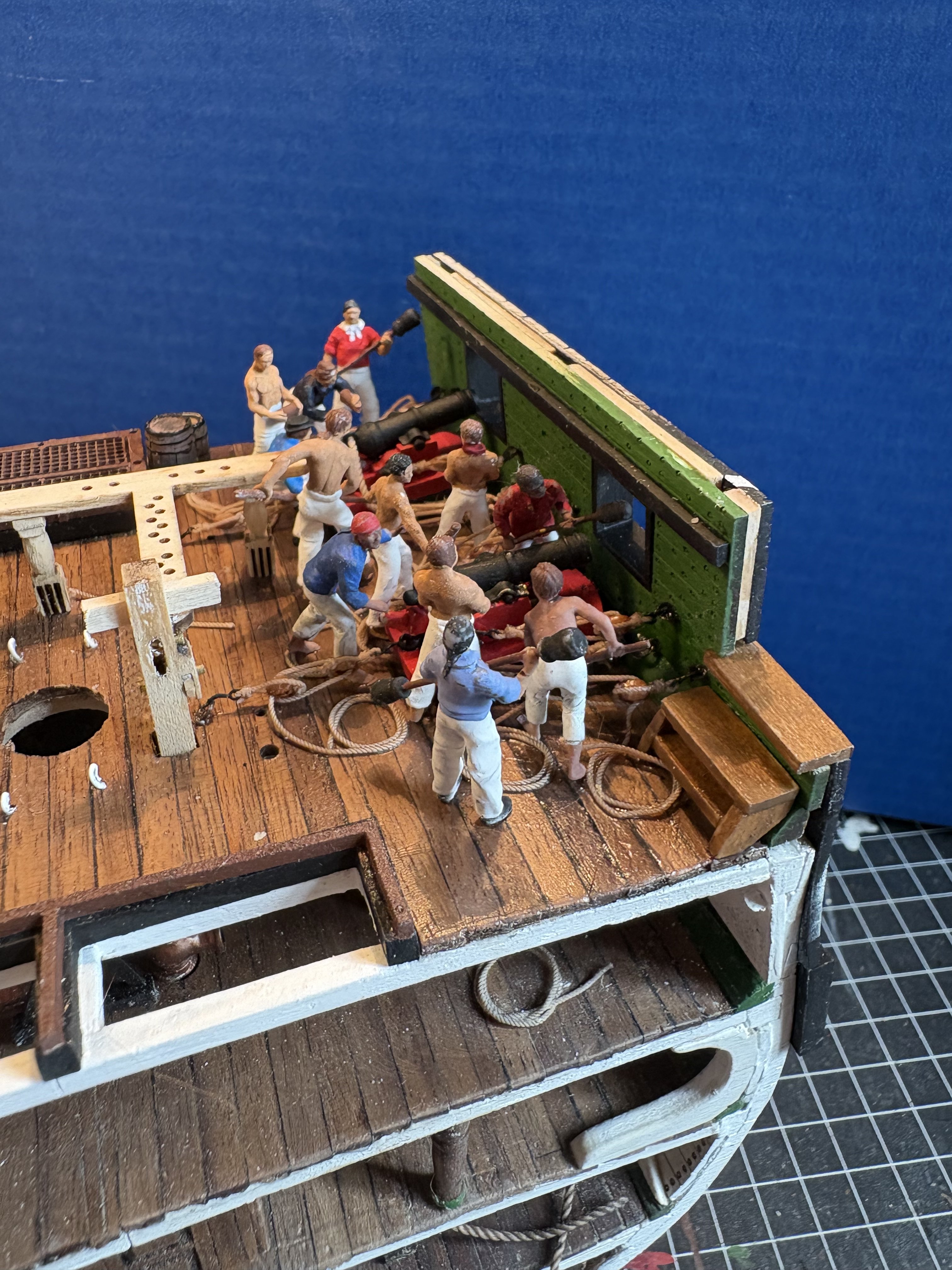

And now for a little surprise: Since I come from model building with a focus on dioramas, it was clear to me that I didn't just want to build all the historically documented fixtures, but also wanted to populate my cross section with the appropriate personnel.
I found some great resin figures for the HMS Victory, which I am now converting to the US Navy.
There are 61 figures in 1:75 scale (okay, my cross section is 1:76, but let's ignore this minor deviation).
The first four figures have already been brought to life.
I found some great colouring templates for the historical uniforms on the internet

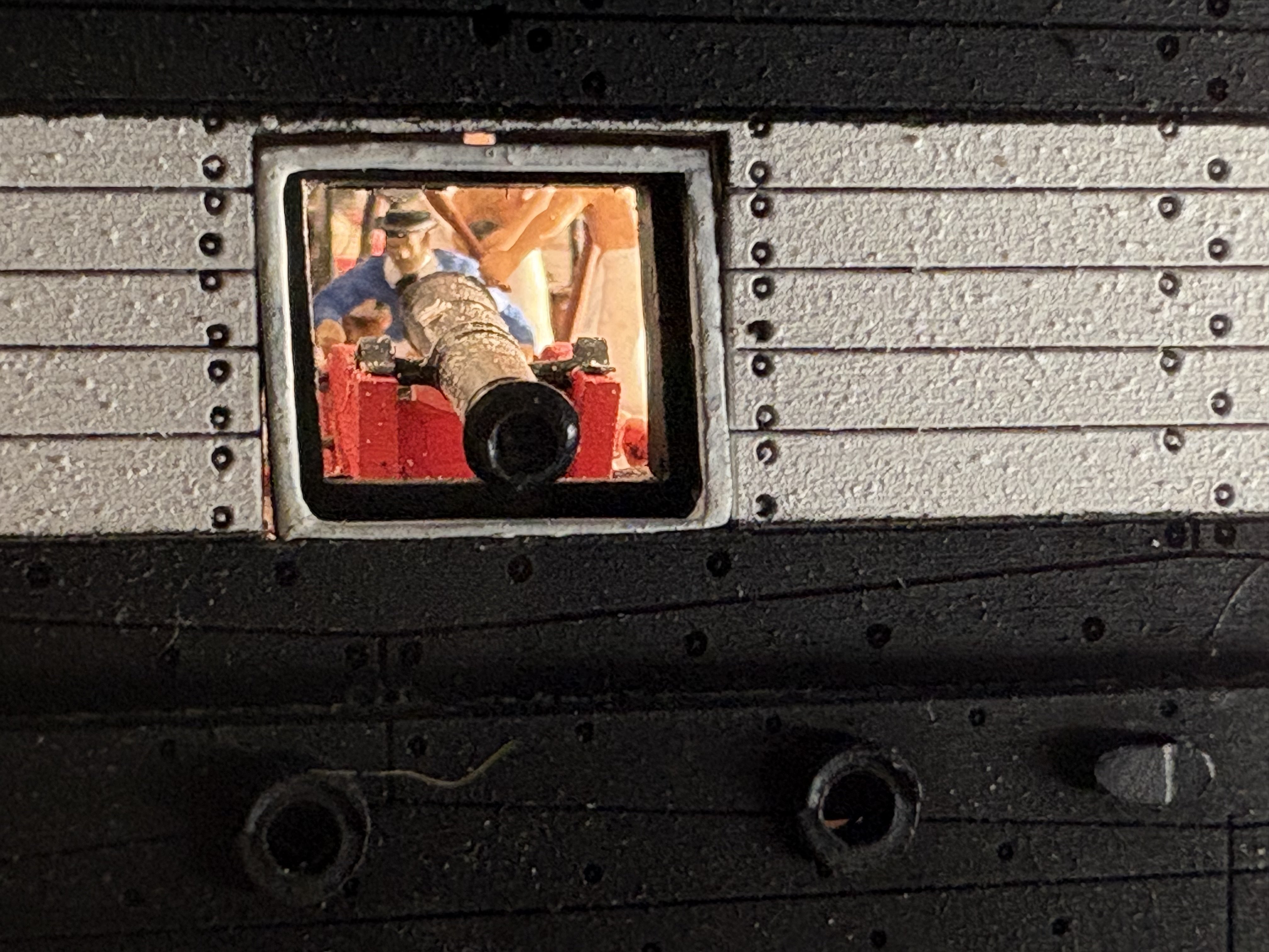

And this is what it looks like through the gun ports. Please don't forget that the scale is 1:76 and the figures are approx. 20 mm tall (or rather small).
Painting can only be done with a good pairs of magnifying glasses and a steady hand.

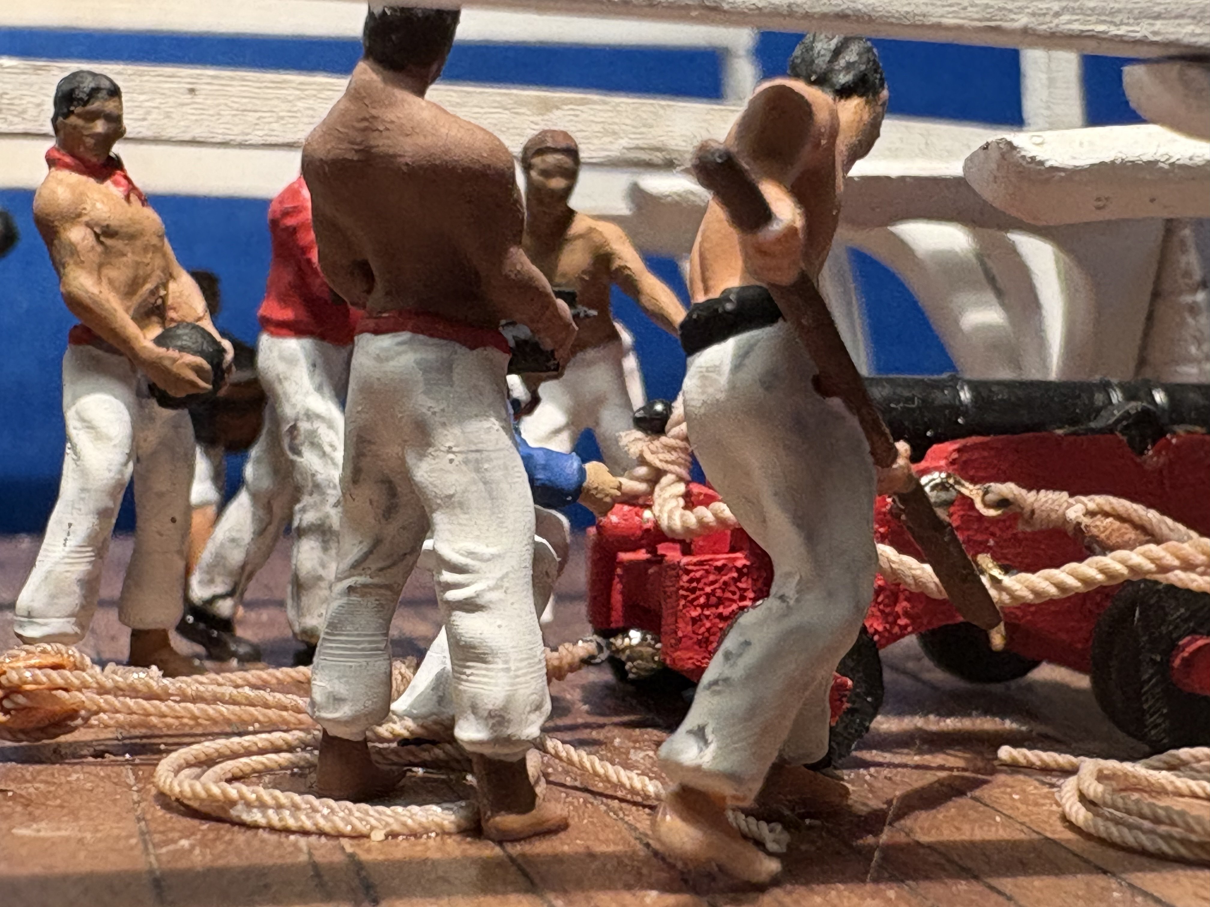

Before I move on to the next steps, here are a few more impressions of my personnel. I really like the figures, they are so perfect, and that in 1/76 scale. You can even see the muscles of the gun crew.
image.thumb.jpeg.fc57b98df4f20558669435bcd9d2c77e.jpegimage.thumb.jpeg.0d3f7d7c2b18ee5ea8fa0afb5bec2c8a.jpeg

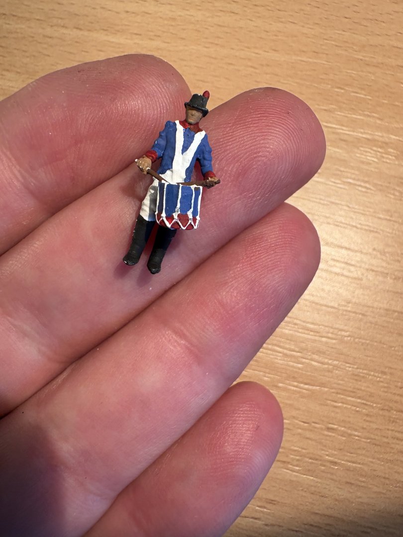

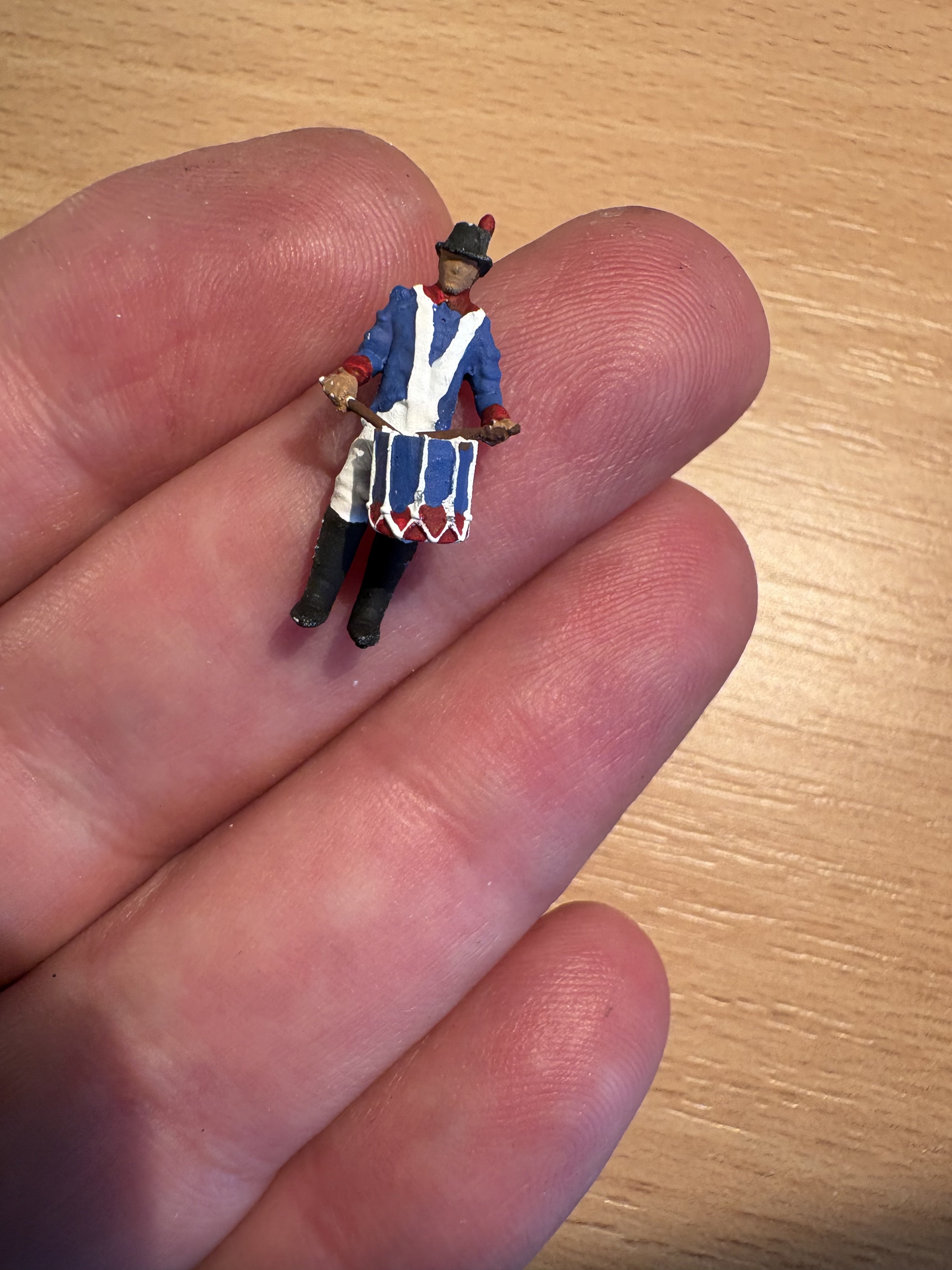

And another figure I like: the Navy Marines drummer. He will become part of the deck line-up on my USS Constitution.

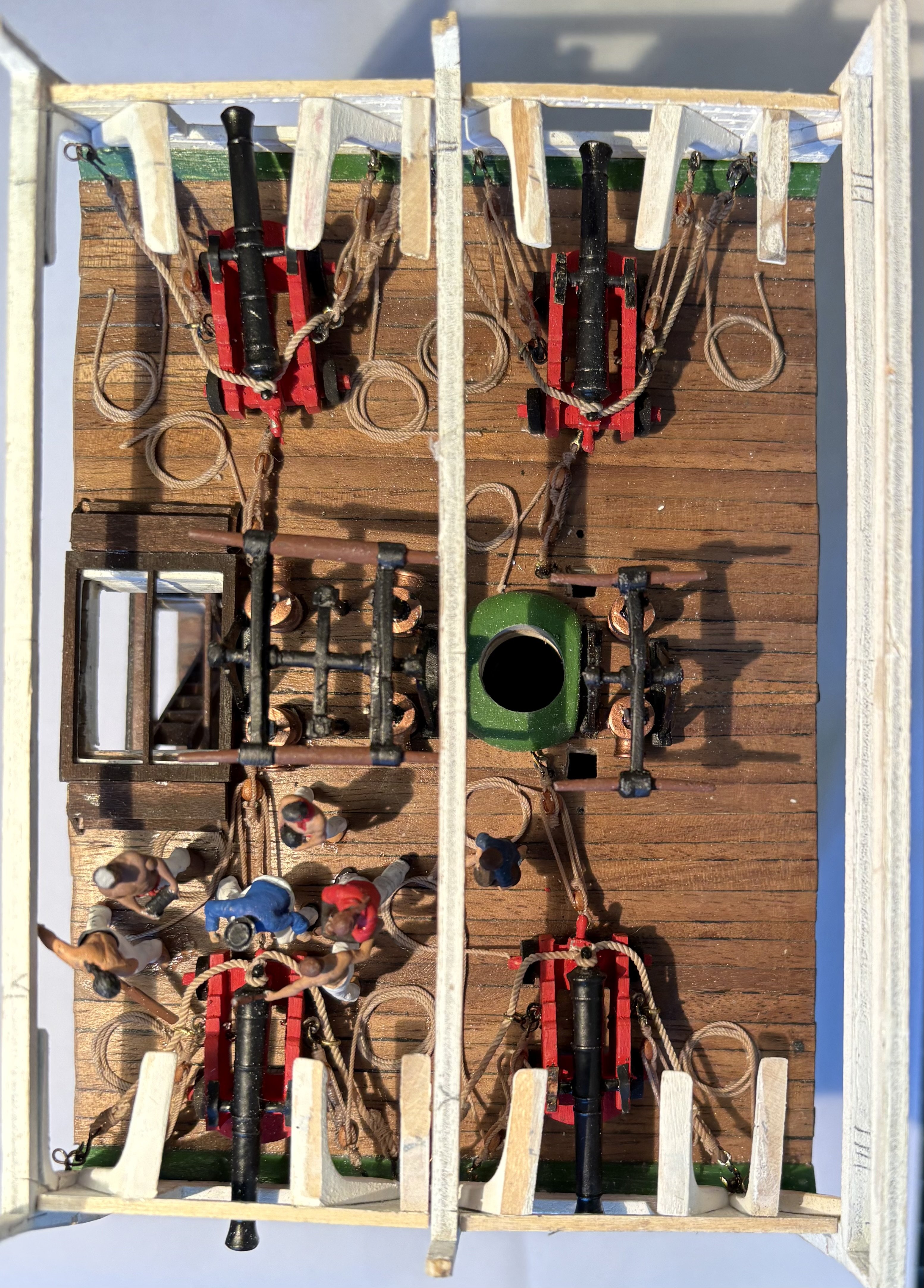

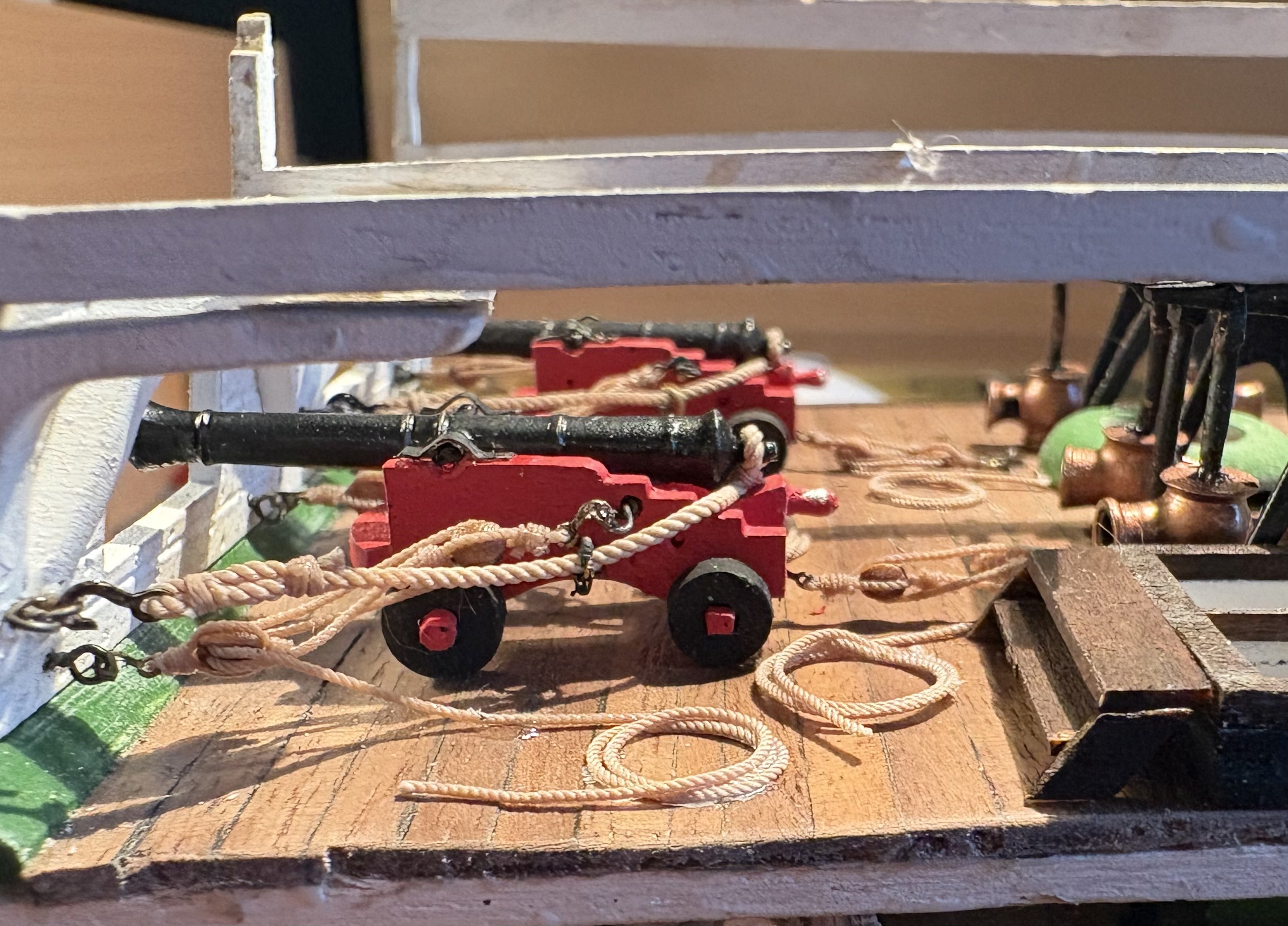

I am now in the process of finishing the gun deck. All guns are in place, all lines attached to the guns. I am still a little unhappy with the strength of the ropes. The breechline is okay, but the gun tackle is a little too thick for my liking. It is 0.5 mm, but I think 0.35 mm would be better.
I lack the historical knowledge to determine the correct size.
image.thumb.jpeg.4418969b59a7d6347f46706fd05fcfa3.jpeg   image.thumb.jpeg.73e666c377de21aadf39fef7c6783b7a.jpeg

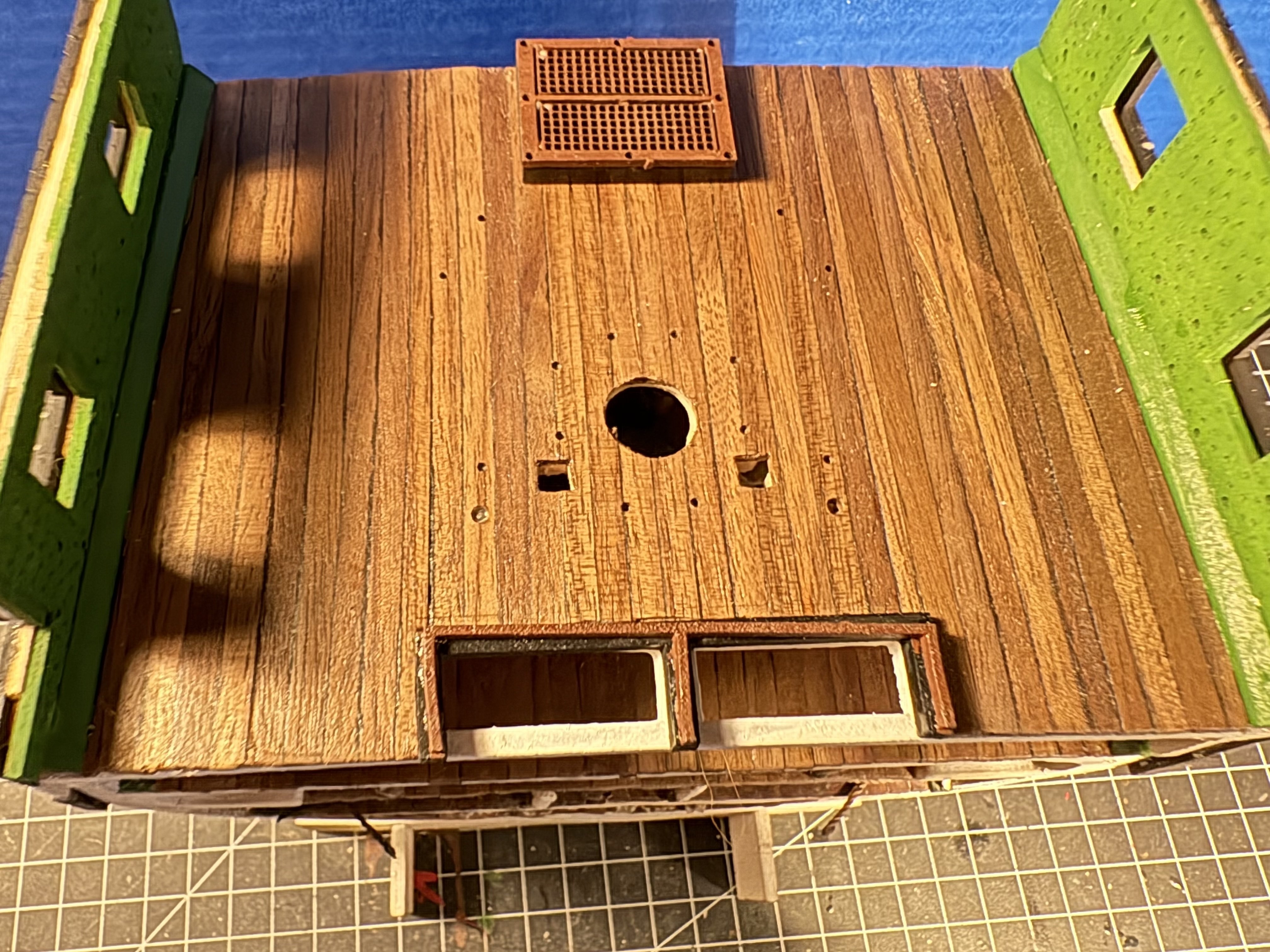

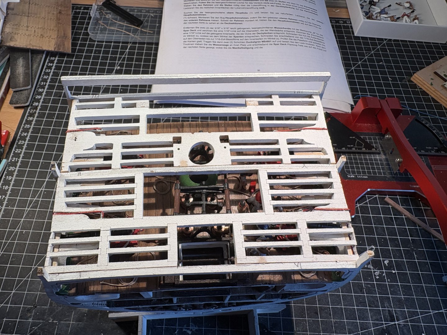

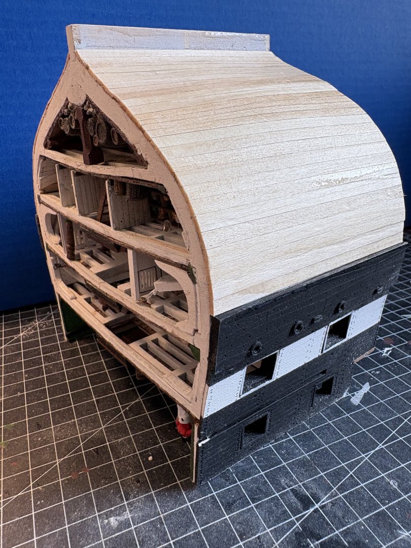

Put the lid on and all my carefully positioned employees have disappeared. It's a shame, really, but at least they still get a little daylight from the side.image.thumb.jpeg.72653f2ca99552c213aeaa3caef024eb.jpeg

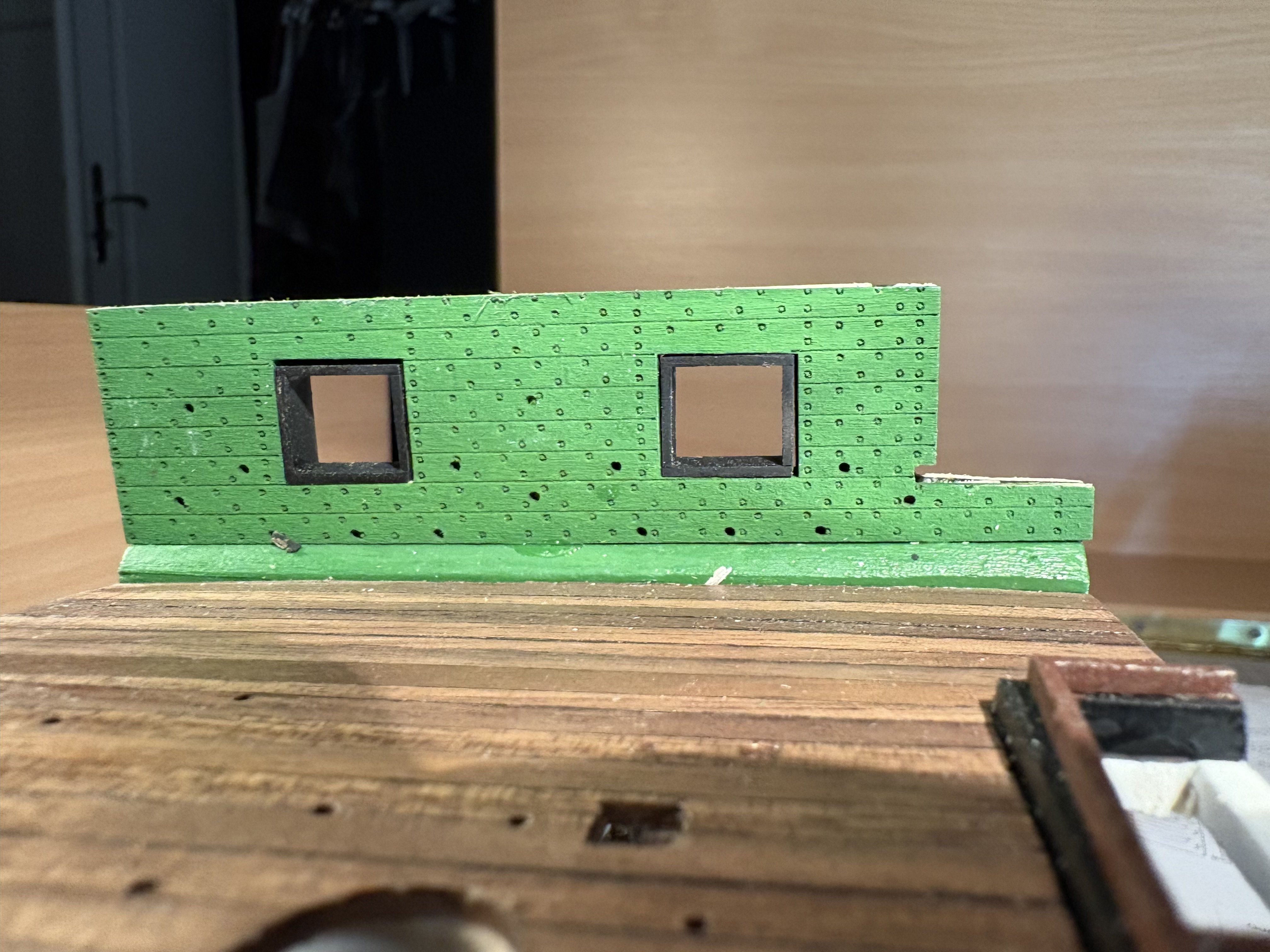

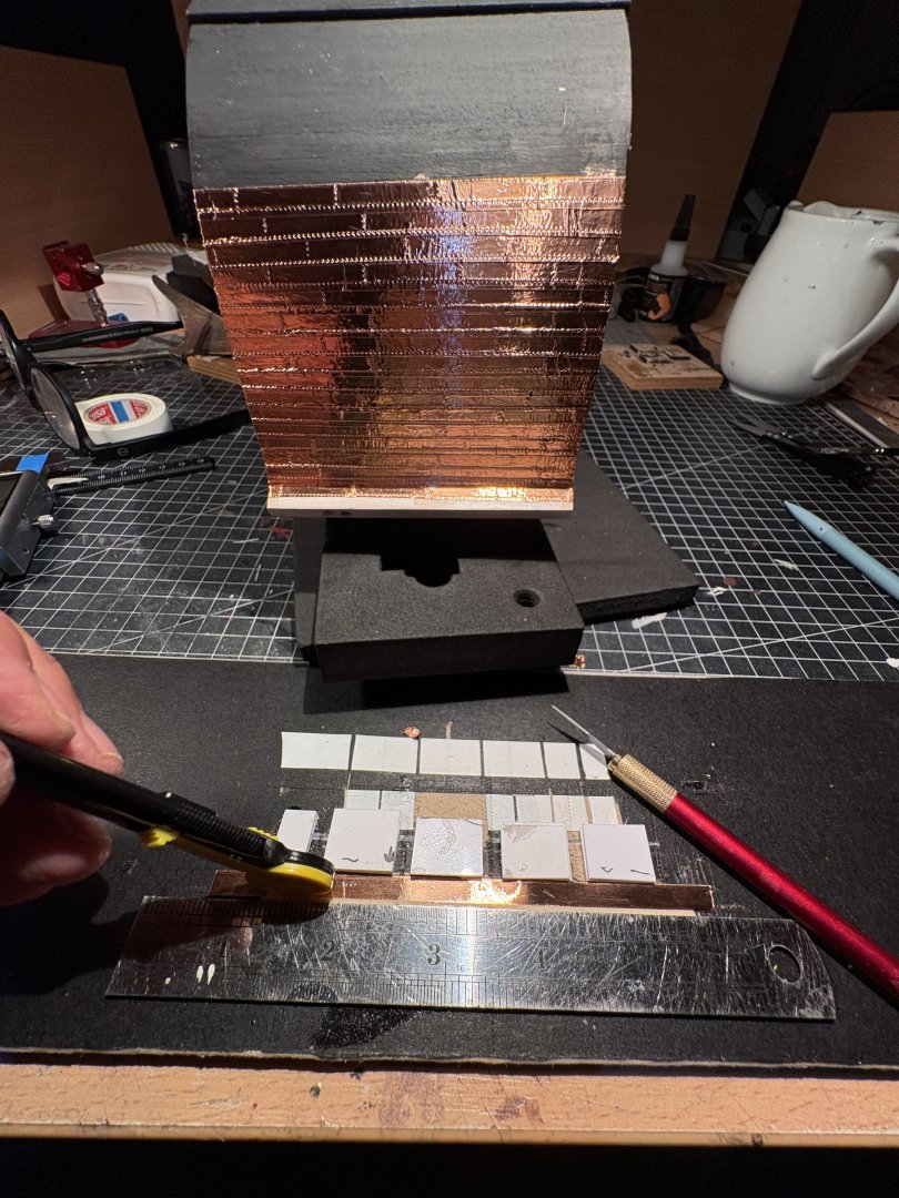

I first completed the installation of the hull of the spar deck and did not follow the instructions exactly. I find it easier to build this way. So first the sidewalls,
image.thumb.jpeg.1bdb917bcbd820e6c9757efba90bd4b2.jpeg   image.thumb.jpeg.52ec2c4e42e747405be34135c32531e6.jpeg
the gun port bracings and gunport frames,
the waterway and then the deck planking.

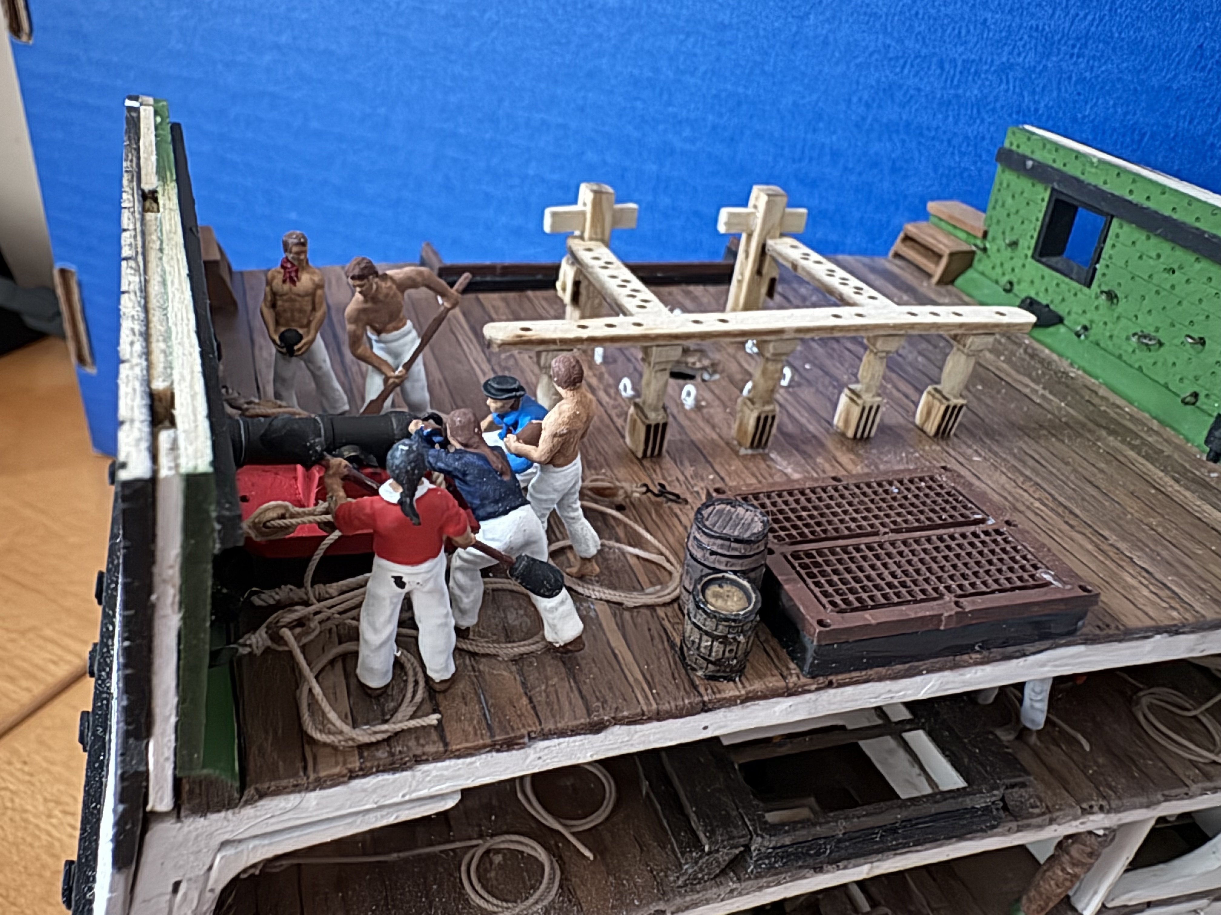

The Spar deck is finished and I have started to equip it with the necessary equipment.
Actually, I should have planked the hull first, but as everyone knows by now, I love my little 1:76 crew members and I couldn't resist installing two carronades and manning them.
First of all, carronadas  alone...
Then with the corresponding staff:
followed by the second carronade and its gunners...
And all this just to put off my first big challenge, planking the hull.

After deciding to get into shipbuilding, I started with the cross section of the USS Constitution to get a feel for wood, gain some initial experience and attach the first, albeit super humble, planks to the hull.
And as far as I can tell, it worked out quite well.
My fear was unfounded.
However, I have the most respect for copper plating, as I have no experience with it whatsoever and this copper foil seems very fragile. I hope it doesn't turn into a complete mess.
The copper wasn't so bad after all. But that only applies to my expectations. Perhaps the result isn't as good as I think it is. In any case, I'm satisfied.
image.thumb.jpeg.5e58e7a88c54af3f400cb47abda14116.jpeg   image.thumb.jpeg.293388e73d4b797db9d9141d73338bcf.jpeg
I built a device where I could cut the foil and attach the rivets.
And once again, I took the liberty of a model builder and only used the rivet rows very sporadically. In my opinion, and I'm really no expert here, the many rivets look too dominat on a scale of 1:76.

Another completely new thing for me. With the guns and carronades, I was able to work with blocks and ropes for the first time and am constantly improving.
I quite like the lad, but again, that's not an expert opinion, just my humble opinion.

Thank you for your kind and encouraging words. You've inspired me to post some photos of the almost finished project.
