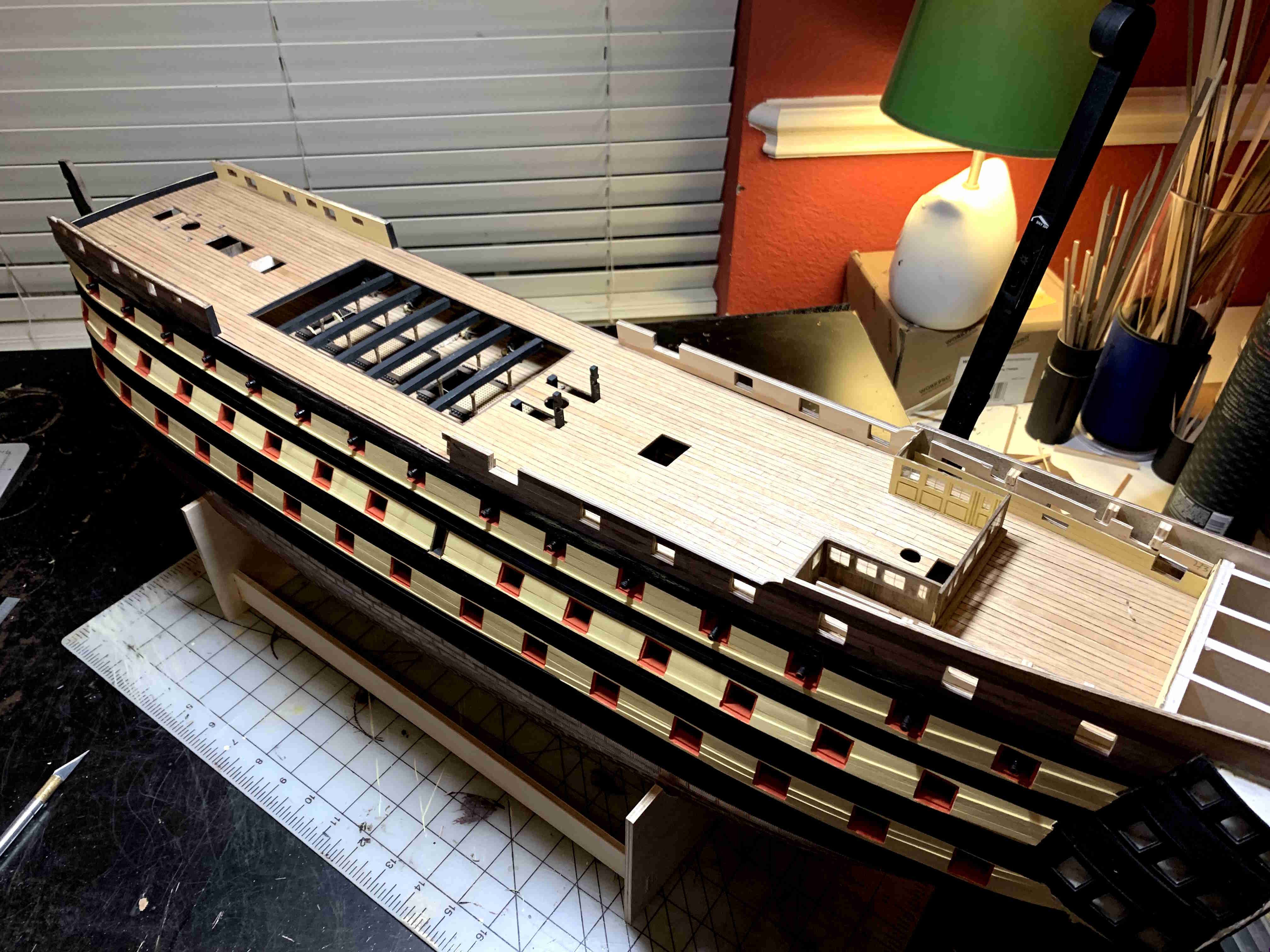

And just FYI,  here's a picture of where I am currently on the build. I didn't start a build log because there are so many great ones already.
