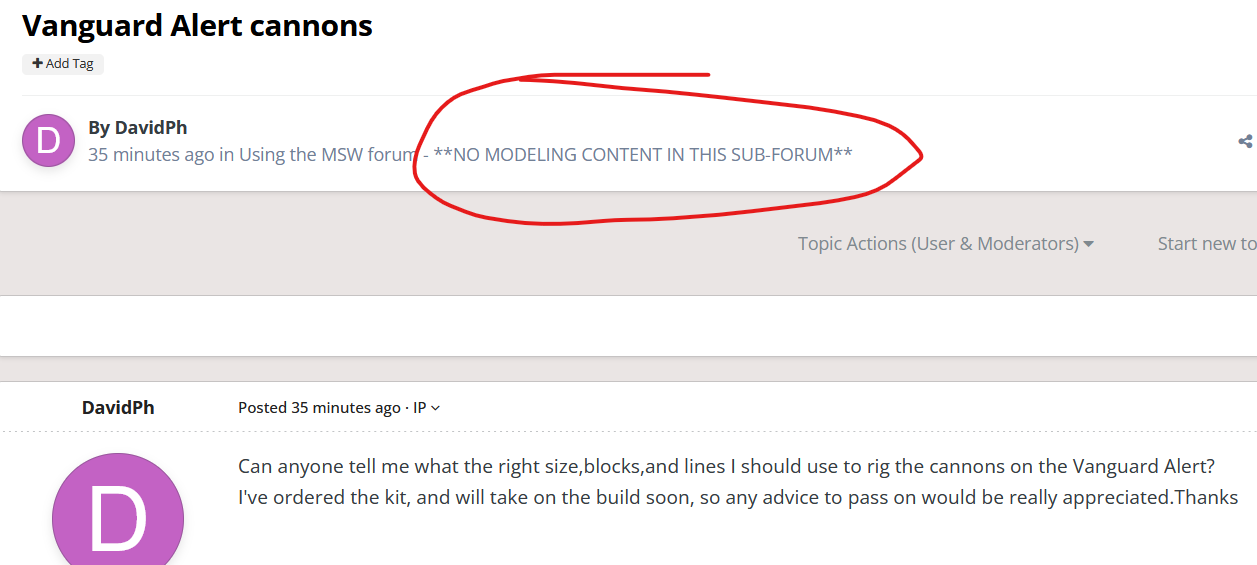

Can anyone tell me what the right size,blocks,and lines I should use to rig the cannons on the Vanguard Alert?
I've ordered the kit, and will take on the build soon, so any advice to pass on would be really appreciated.Thanks
