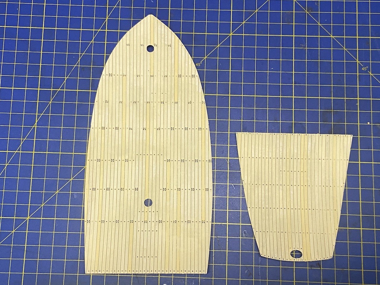

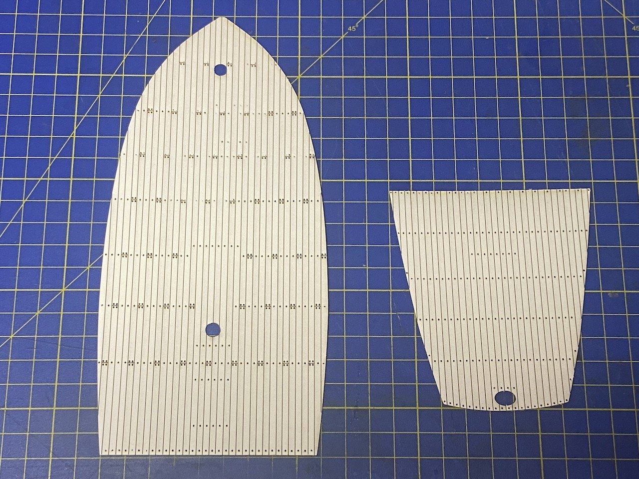

So, I started working on a new deck for the 1/72 scale Le Coureur model. This is basically just the same 1/96-scale model deck that I've enlarged. Laser cutting and engraving the deck from card, now that I've got settings for my laser that work better. Below are the plain, laser engraved decks.

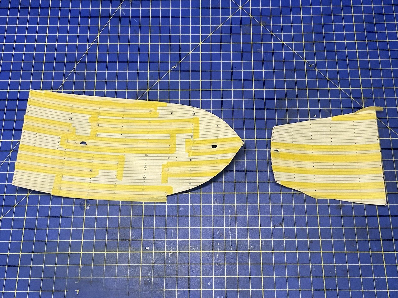

As per kit instructions for painting, I gave the decks a coat of a very light, cream-colored paint that's provided in the kit. I used a very thinned down mix and applied it to the card stock. It's a very light coating. The water curles the paper a bit, but it will flatten out when dry. After allowed a good 24 hours, I taped off a random selection of planks, and repainted these areas.
Again, a thorough drying before applying a paint mixture as given in the kit, but I think my application was thinned down maybe a little too much, but I think it will work as is. I may tape off some more random planks and repaint them before continuing. This should help offset some of the blotchiness that occurs when brush painting on absorbent material.
Still, the deck is a very light tan color and should work as is, though they look a bit pale in the photos. And, if I do too much more to it, I risk ruining it. I'll think on it a bit.
