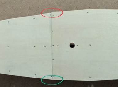

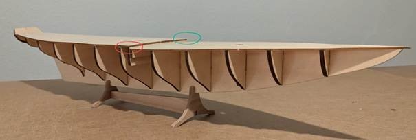

I only noticed one inaccuracy, which I was a little bummed that I had missed, but it is solvable when sanding the edges of the bulkheads to match the planks of the hull. There is a jump halfway down the deck.
When you look at this point in the topview, the contour is interrupted at one side.
I also noticed that the higher deck did not have a rounded/smooth contour shape, but it has two sharp edges. This is not a “fault” from me, but it was lasercutted that way. On this edge I have to add a walnut sheet, which will follow the contour. I suppose those have to follow a smooth rounded line, not the sharp edge?
Following the instructions I have to add those walnut sheets first and sand the bulkheads later, but maybe it is wise to round the contour of the deck before adding the walnut sheet? At the same time I can also correct my small inaccuracy.

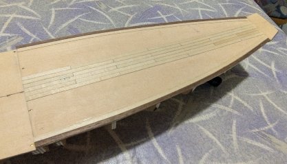

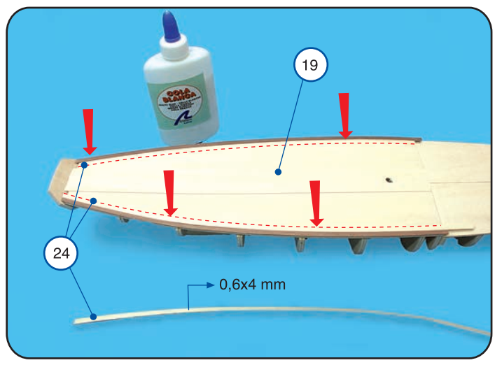

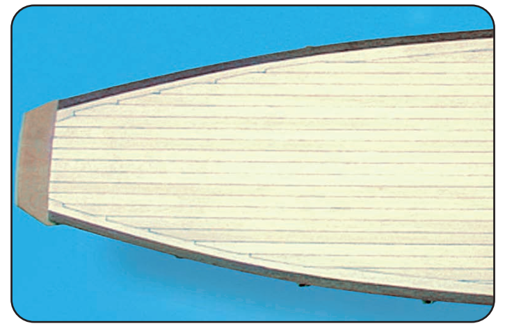

The planking of the deck will need some bending of planks and this will be the first new thing to learn for me, so I am still looking into it first and I am investigating how to do this.
The most outer plank is walnut:
And the second row is basswood:
the rest will be filled with straight planks:
Is this the right way to do the bended planks:
  • put the plank in (warm) water for a while. How long? A few minutes, an hour?
  • Bend the plank and place it with clamps in the right position onto the deck.
  • Let it dry in this bended position.
  • After drying, take away the clamps, put some glue on the bended plank and position it back with clamps to let the glue dry.
Will this work in this way?
Yes to all questions...durations of soaking is usually 15 min. or so in warm water...just experiment yourself
When you clamp the plank to the deck it's sometimes nessecary to use a little piece of scrapwood between the clamp and soaked plank.
Because of the wood is soft with all the water in it, you won't damage it with clamps. That said...walnut is pretty hard, but personally I would better be safe then sorry.
Edited by Ronald-V

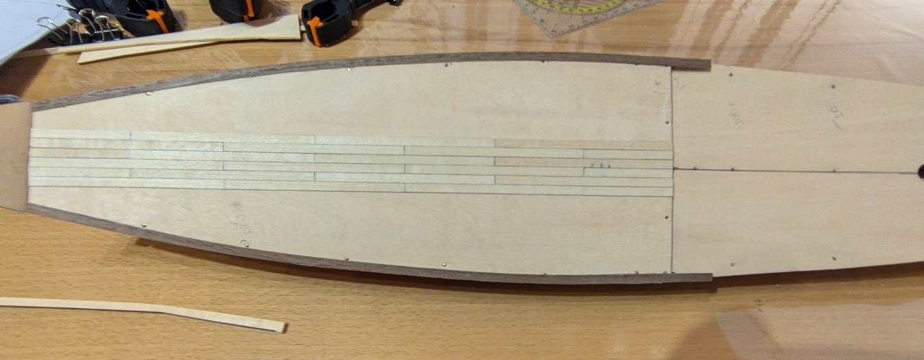

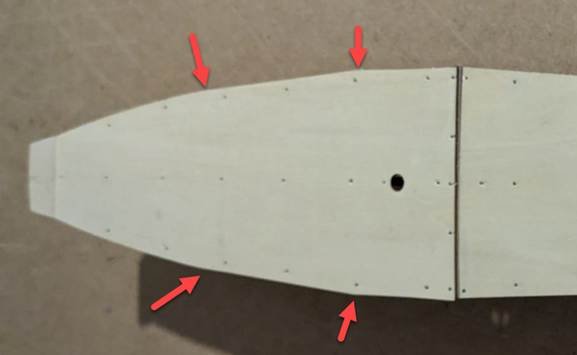

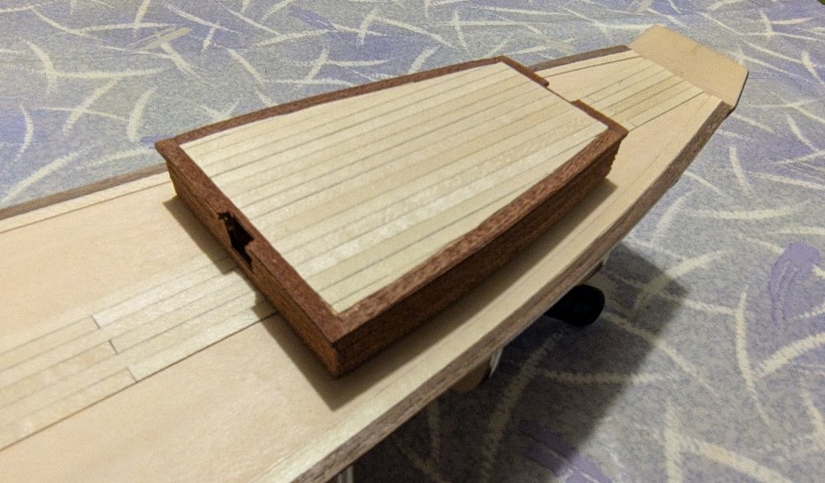

Planking the deck.... wondering how to start....
I am at the start of planking the decks, but I am wondering a few things, because of a small inacurrance in my work and a thing about the lasercut decks. Maybe I am thinking to much before actually start, but I would like to try to get the planking as symmetrical as possible.
Next image is from the build log from @Penfold
Bluenose II by Penfold - FINISHED - Artesania Latina - 1:75
When finmishing the planking, he noticed there was a small asymmetry in the pattern of the planks, because he sanded the contour of the deck after drawing the centerline, but before planking, as I did understand it well.:
I hope to avoid that, but as a newbe, I have a small asymmetry in the position of the higher deck at the red arrow, because I was a bit inacurrate when assembling the frame. The hogher deck protrudes a maximum of 1 mm from the lower deck on one side.

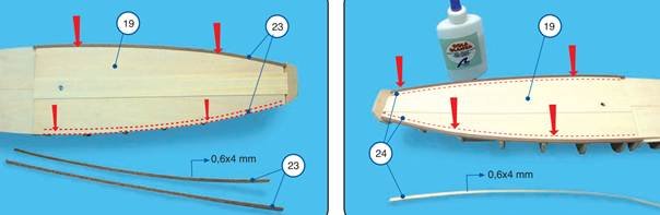

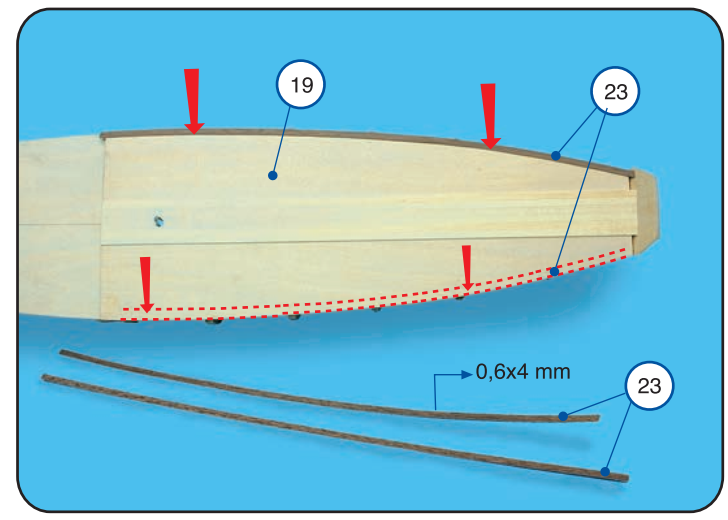

As per manual, next steps has to be made:
  • Add 6 planks in around the centerline
  • Add a walnut plank:
  • And a basswood plank along the contour:
  • Then fill in with the other basswood planks:
  • And after a few other steps, sand the right shape in the bulkheads:
But there are a few questions.
At the red arrows, the higher lasercut deck has two obvious sharp points. Along the two green lines, the countour is a straight line and only the blue edge is curved. The walnut plank and later on the bulwarks will have to follow a nice curve.
As told in the instructions, the curve will be sanded after placing the planks on the decks.
That means, when attaching the outher plank, you need to stay inside the contour and will see the sharp points of the deck and other parts of the deck protruding, which will be sanded away at a later time:
Another consequence of this is that the with of the walnut plank may vary because of the sanding.
The other way might be to sand only the contour of the deck (not the bulkheads at his moment) to get the nice curve and place the outer walnut plank against this sanded curve.
I can than sand and measure both sides as close as mirrored to get a nice symmetrical layout of the planks and draw the centerline after this.
To be honest, the deviation between left and right is only in this incircled area; the rest is symmetrical:
But I can imagine, because of the cutouts, a small asymmetrical area will be visible in asymmetrical cutouts/planking:
The other thing is, because I will need to correct the little inaccuracy at the step from the lower to the highter deck, the hole of the mast will also be a little offset to the centerline (about 0,5 mm or <1 mm). So the lines between the planks will also be not completely symmetrical to the hole of the mast, but maybe that will be less visible?
Can you guys tell me which way I can do this best? Or am I being too picky now and do I simply have to start planking?
I hope I made my questions clear, but someone told me: ask before gluing!
Edited by bnw
  I'd likely sand the sub deck to have an even curve first (no angles then),and focus on having pretty good symmetry around the bulwarks.  If the symmetry is a small amount off where a mast goes, it will be hard to notice there than if the symmetry is much off at the prow and stern areas.  I'm attaching a photo of a bluenose model showing that there is a lot of stuff going on at the bases of the masts.
  Sometimes, you just have to go ahead as best as you can, and deal with the occasional irregularities (or curve balls) modeling in wood might present you.
Tnx! That sounds logical!
