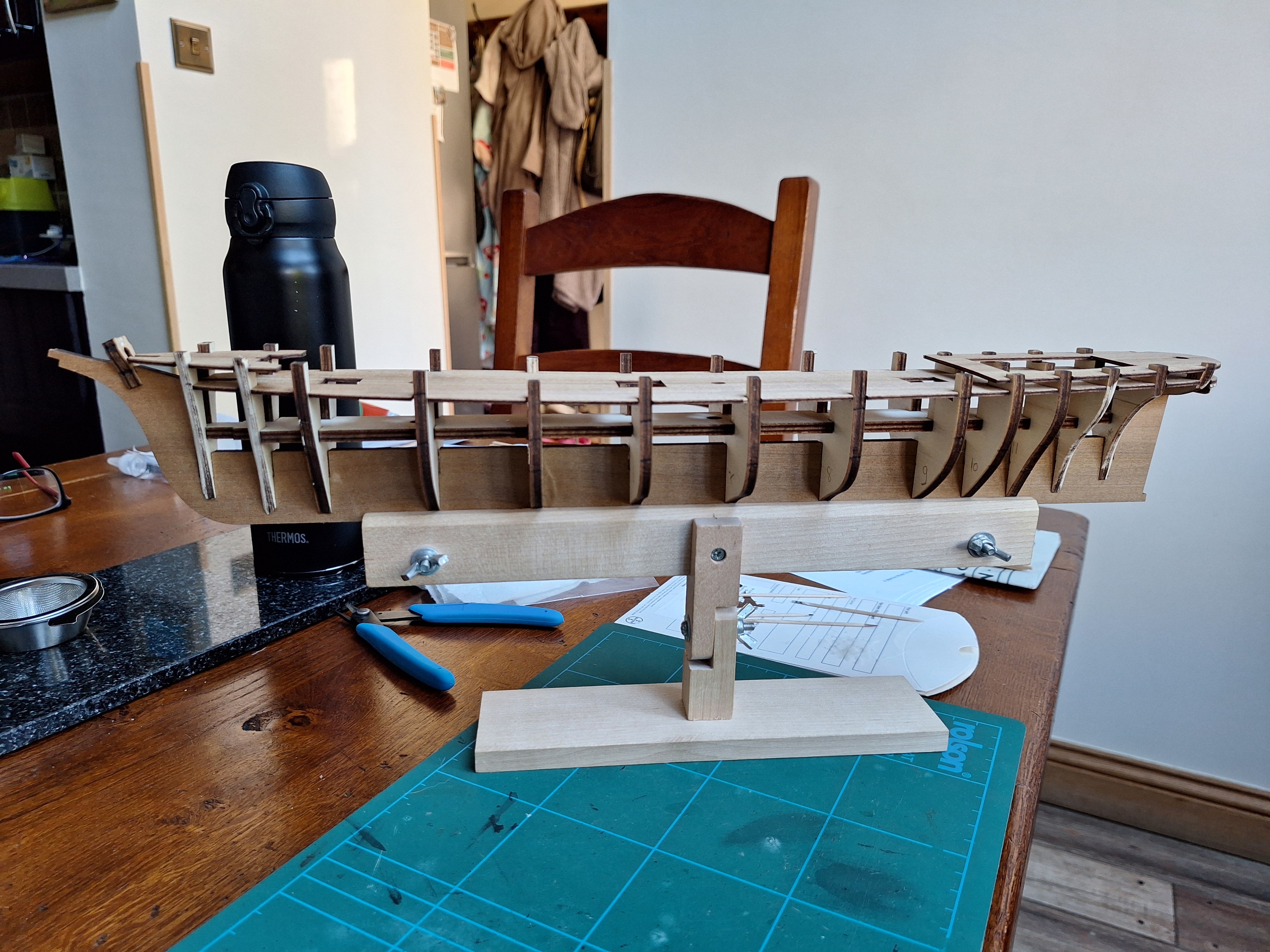

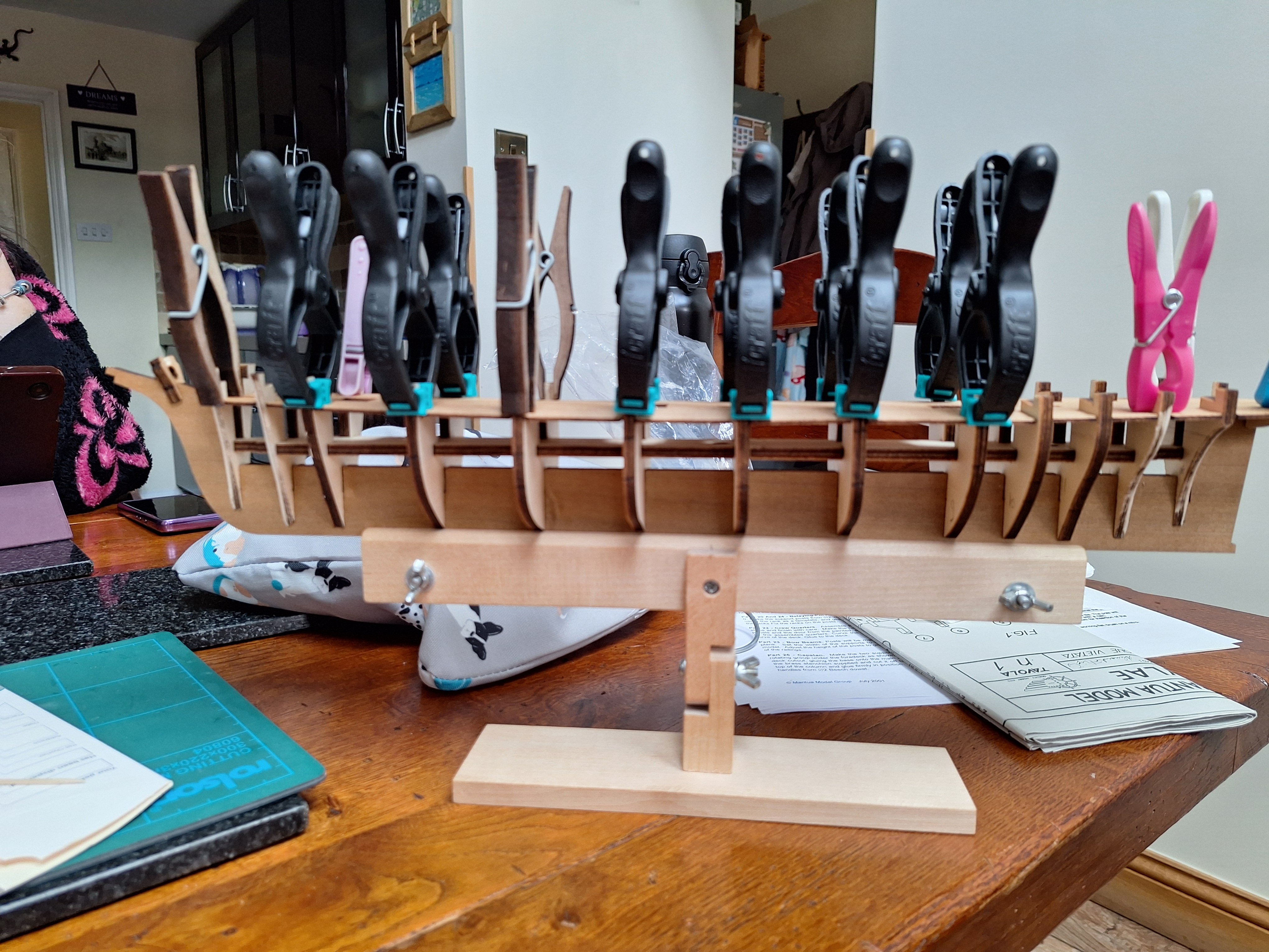

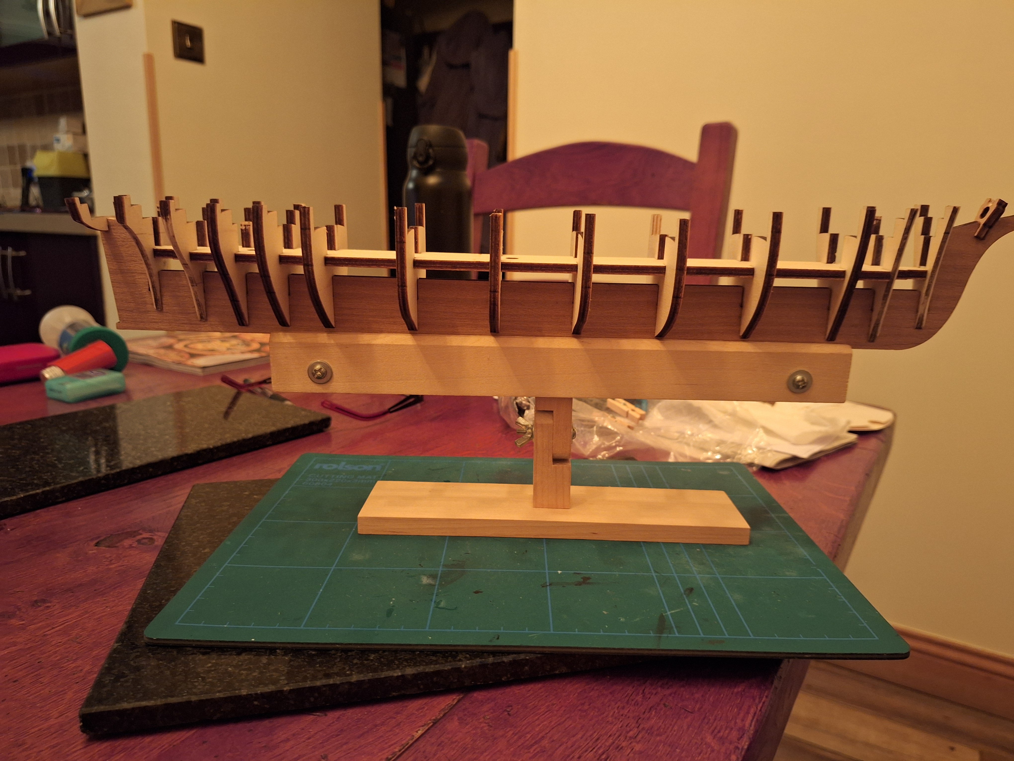

The basic framing and sub deck seemed to go in quite easily. Forward and aft frames were chamfered as suggested.

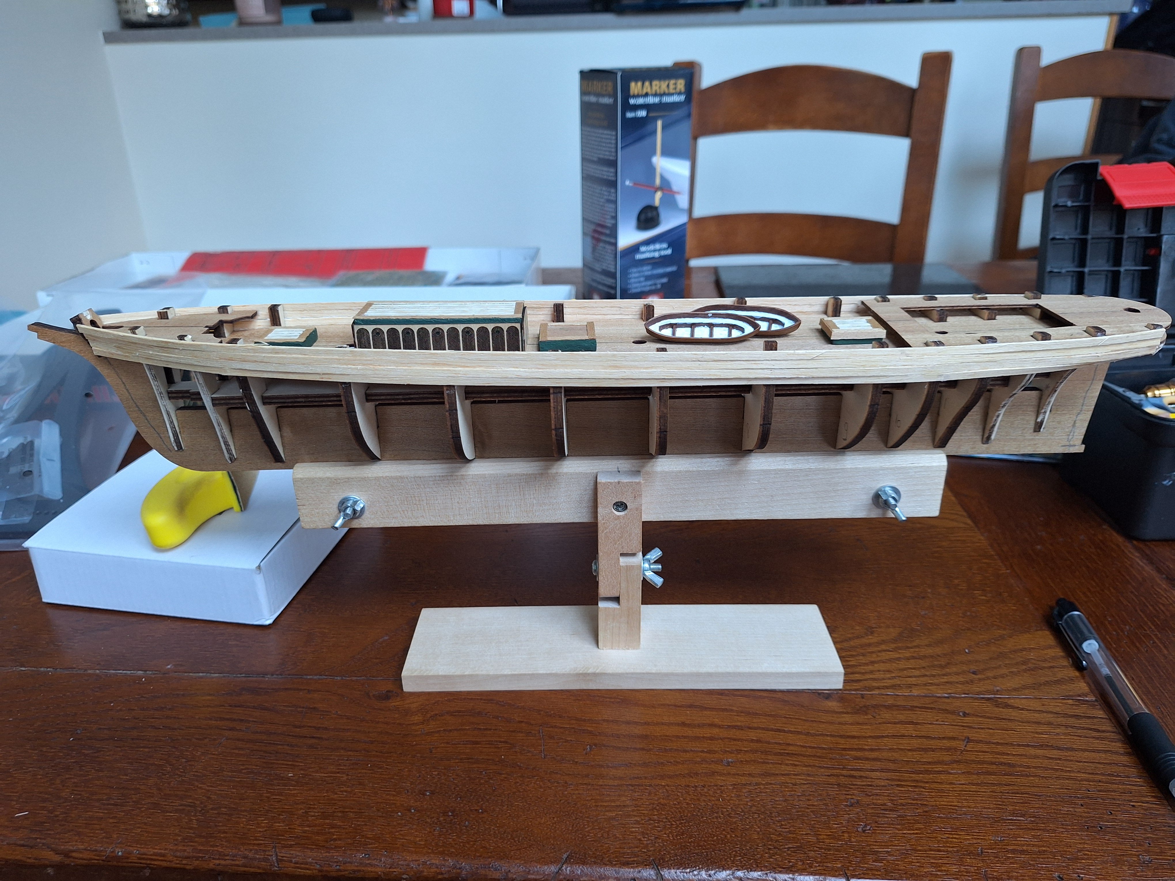

The main deck was then glued in place
and then the focsle and poop decks.

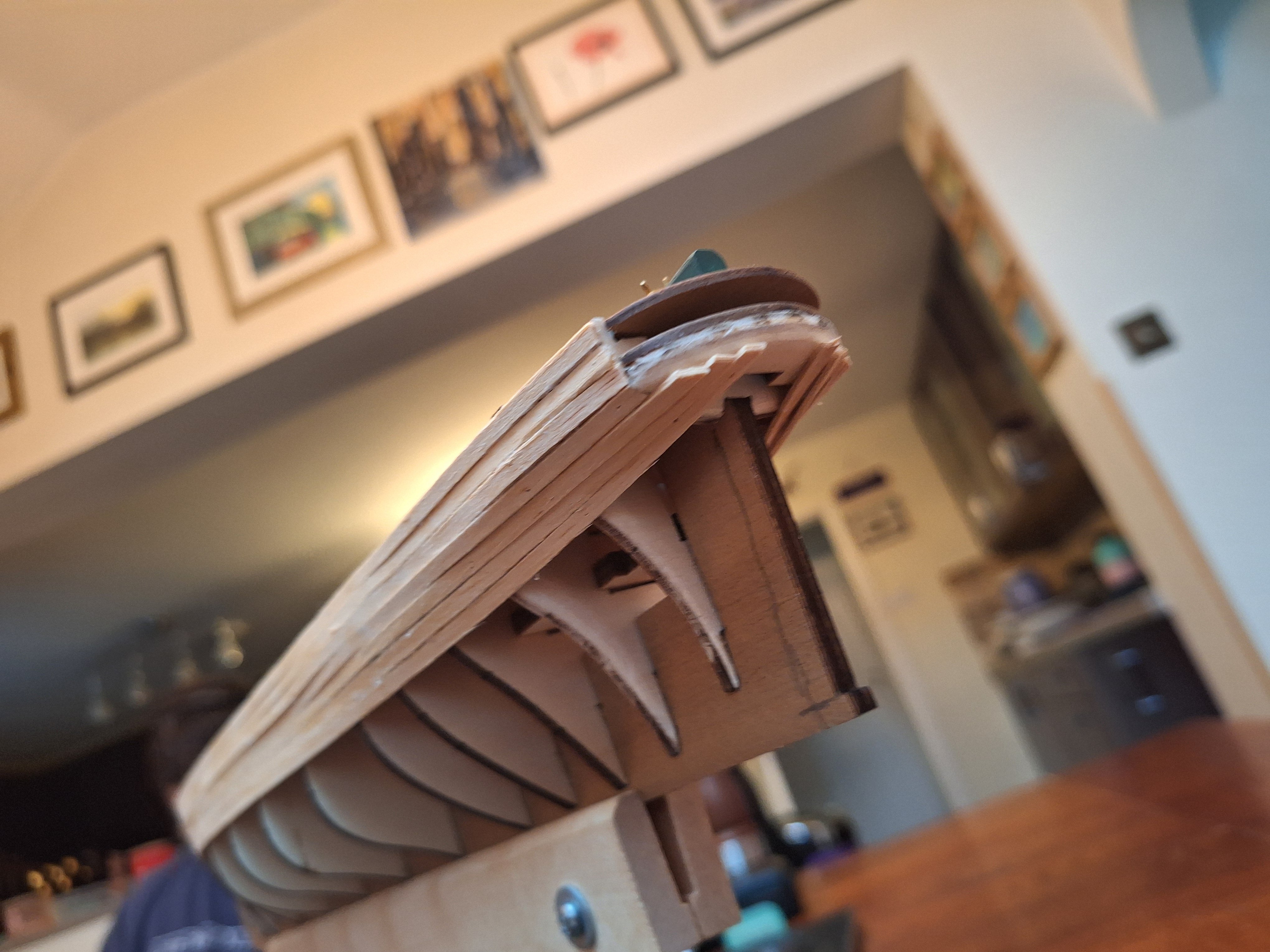

So far so fairly good. On to the planking.
This is a double plank model, which I have not tried before, but I enjoy a challenge!
The runs seem quite reasonable except up onto the stern without too much bending required as yet.

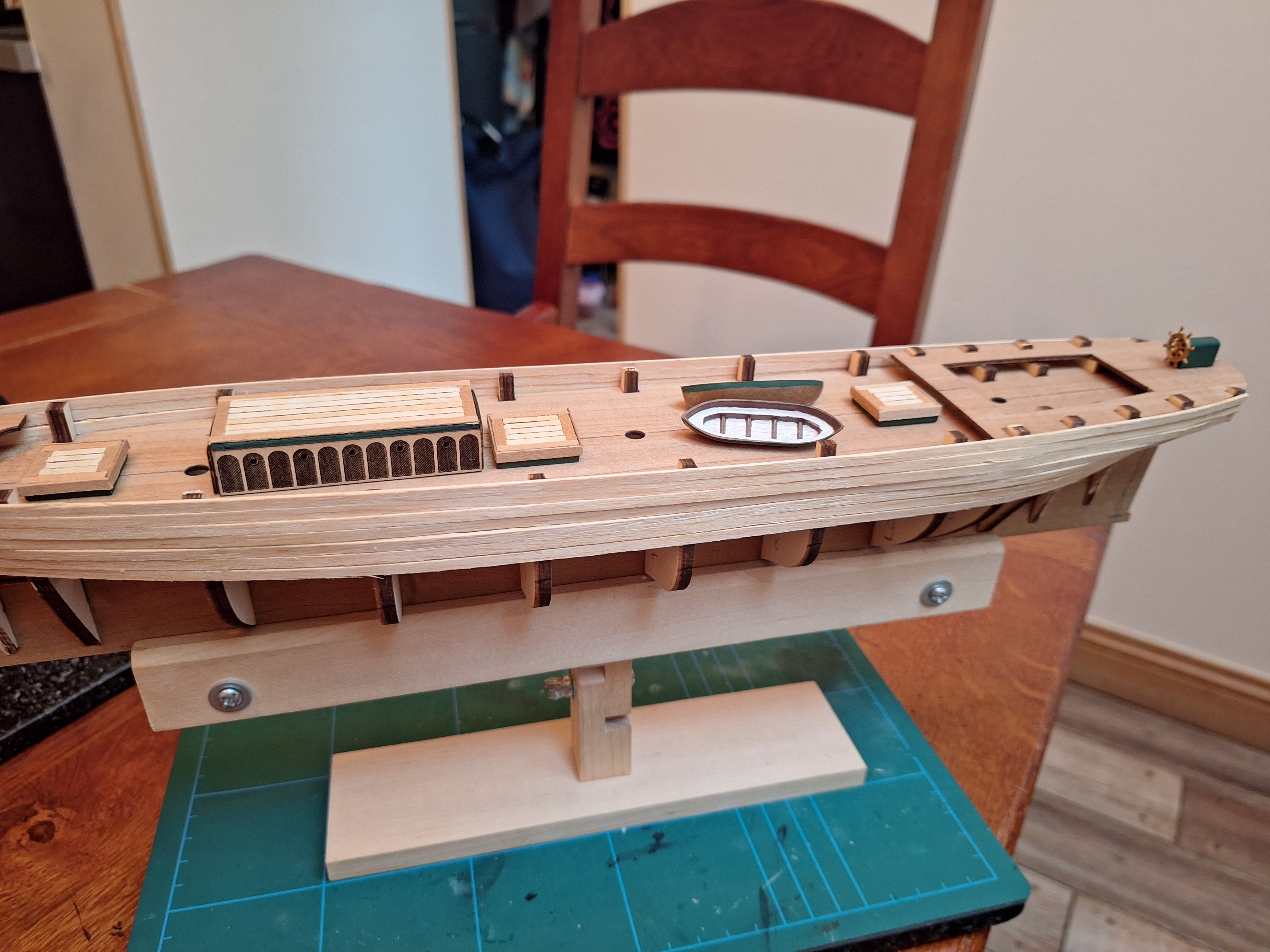

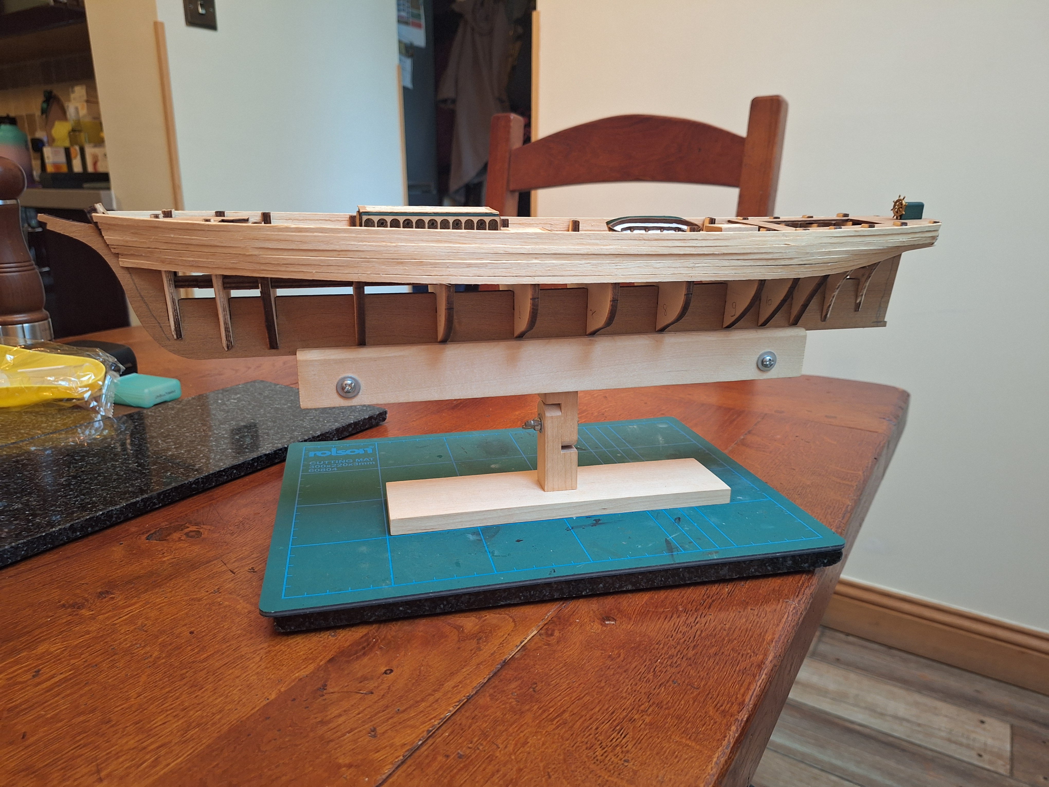

Progress to date is below, you will see that I have also started on some of the deck structures. The deck house that positions just aft of the Foremast is meant to have a convex roof, but I decided that this was more trouble than it was worth and sanded it flat. I think this looks quite acceptable and saved me a lot of stress!
The Lifeboats are as suggested by Popeye in his write up being Amati 50mm. I think they are a bit big for the model looking more like a longboat than a lifeboat, but they do look good. I will probably finish painting them and then decide if I will use them.

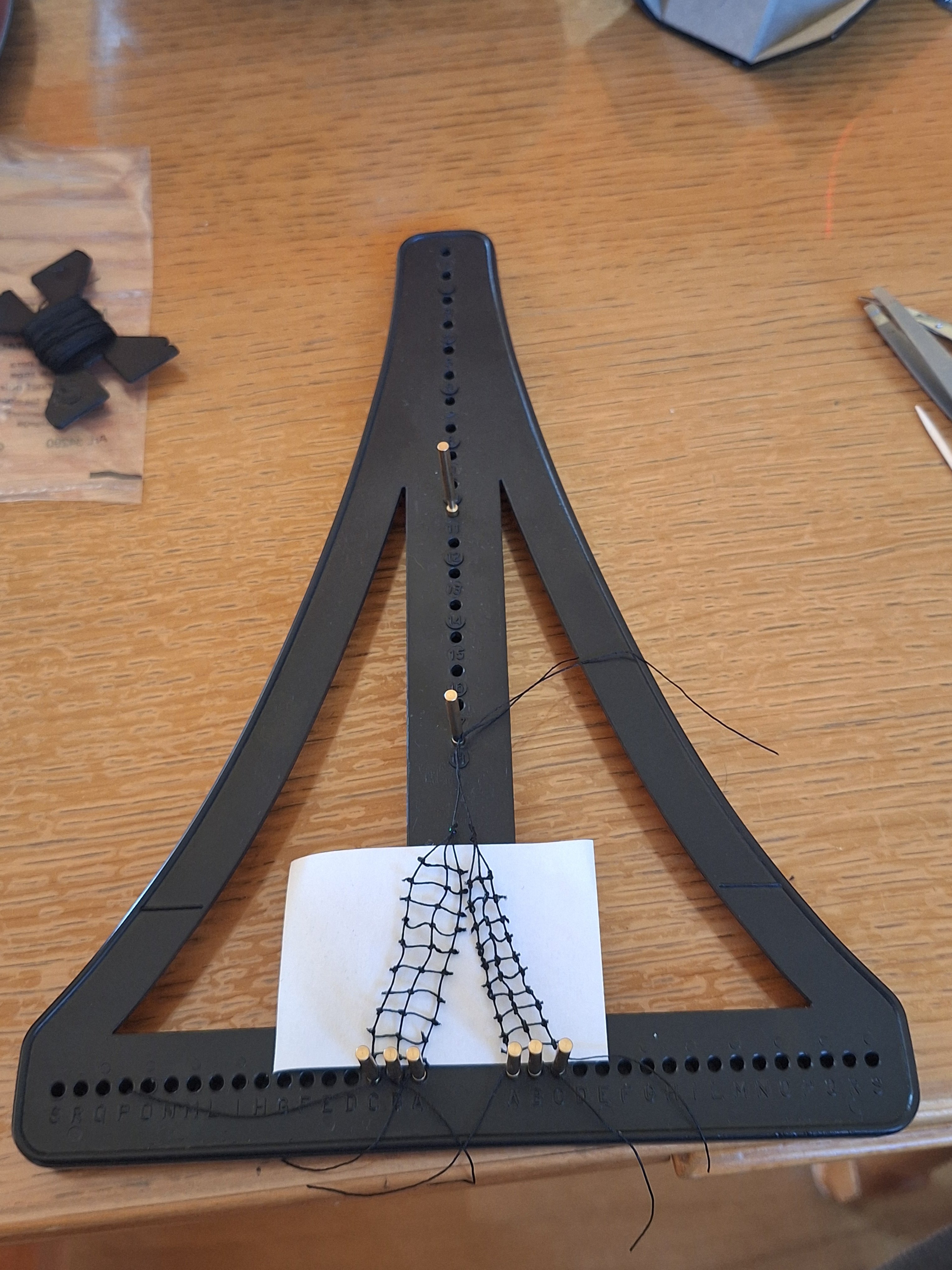

Nothing on the hull to report - I am on holiday, But... to feel like I was doing something whilst I am away I thought that I would start some of the rigging.
I decided to use an Amati Loom-a-line. I know that I could have achieved the same thing with a bit of plywood and a few nails, but as it was fairly cheap (about $10) I went for it anyway.
As you can see my first attempt on the left is somewhat wayward and will be discarded, although I am happy enough with try two for the mizzen.
And the frame - I think worth the money. The pins are a bit tight in some places and fall out of others, but now I am getting used to it it is helpful, and also very adaptable for exact requirements and scale.

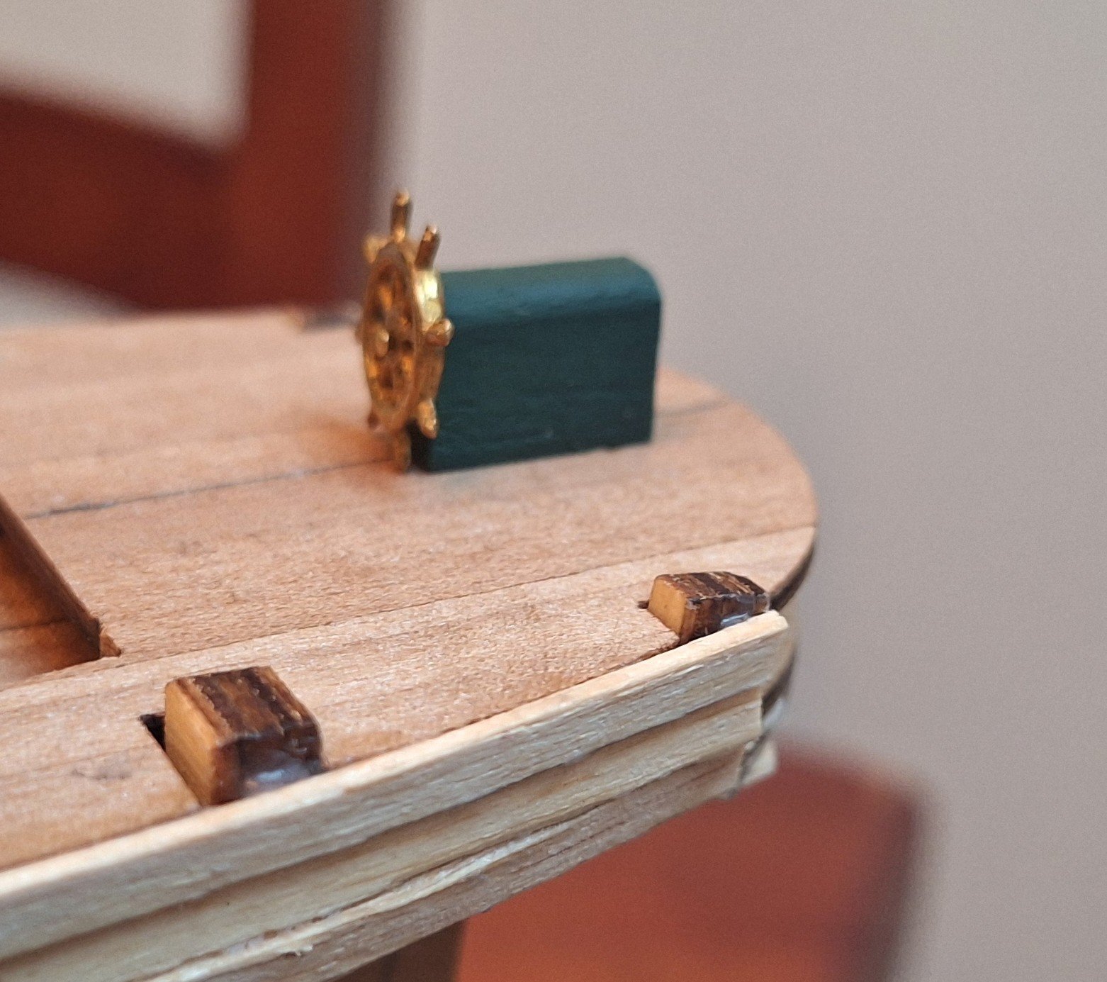

The only other thing is the wheel. The plans said to take the provided wood block, chamfer the top and then make some legs out of wire to give it the height for the wheel to clear. I didnt like this so I have built up the botton of the block instead.

Hi Adrian, Thermopylae is indeed a beautiful ship. I realize you haven't built many ship models, but I do encourage you to rig your shrouds in place on the model rather than using a shroud jig. The trouble with shroud jigs is that a given set of shrouds ends up tapering to a single thread at the top which cannot be attached to a mast head in any realistic manner. In reality, shrouds are rigged in pairs with the middle wrapped around the mast with the loop "seized" at the side of the mast. "Seizing" just means a second short line is tied around the two threads to lock them together. Also, each pair of shrouds is wrapped around the masthead just above the preceding pair, alternating between port and starboard shrouds, leading to a stack of ropes passing around it. The single line from a shroud-jigged set of shrouds cannot replicate this stack which in my opinion is a very noticeable part of ship rigging.
Just my opinion.......you can ignore me, I won't be offended. 😉  Ultimately it's your model and whatever makes you happy is great!
Anyway here's a pic of fore shrouds on an old model of mine during construction. You see the effect..............
Nem0, I have the bottom of your pictured kits. Maybe they are just different editions of the kit?
Ian, Many thanks for your input. I do take your point on historical accuracy. At this point I must temper this against my own capability! We shall see. I only finished a few shrouds on the jig, and their rigging is still so far in the distance that I may well attempt what you suggest when I get there.
If nothing else the jig has improved my miniature clove hitches!
