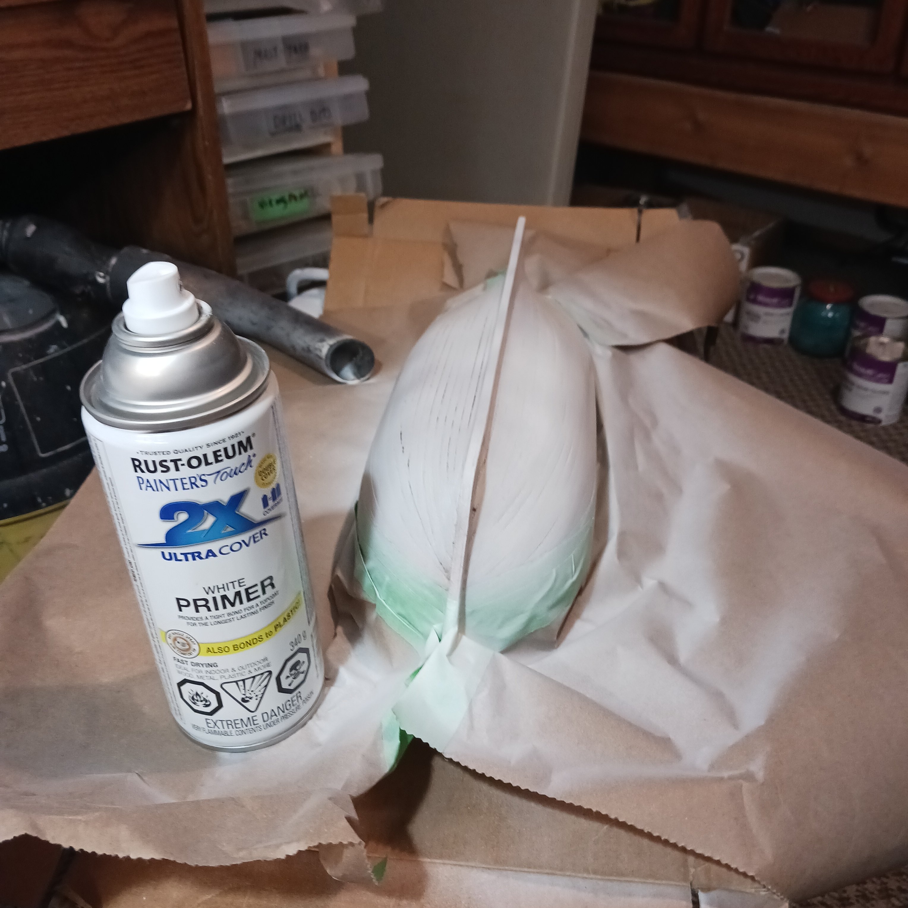

Most importantly - I need advice on the white hull paint. I see in the instructions that Jim used a Rustoleum matte white primer. Apologies for my ignorance, but is it only primer or is there a true white that goes over the primer as a top coat?
Thank you!
Yes it only primer,  you should put a coat or two of paint over it. I used a primer then two spray coats of 2x white. When all the Duchess was finished I sprayed a clear coat of flat  2x.
This is the primer, when dry spay two coats white, optional clear coat.
 Hope it helps
