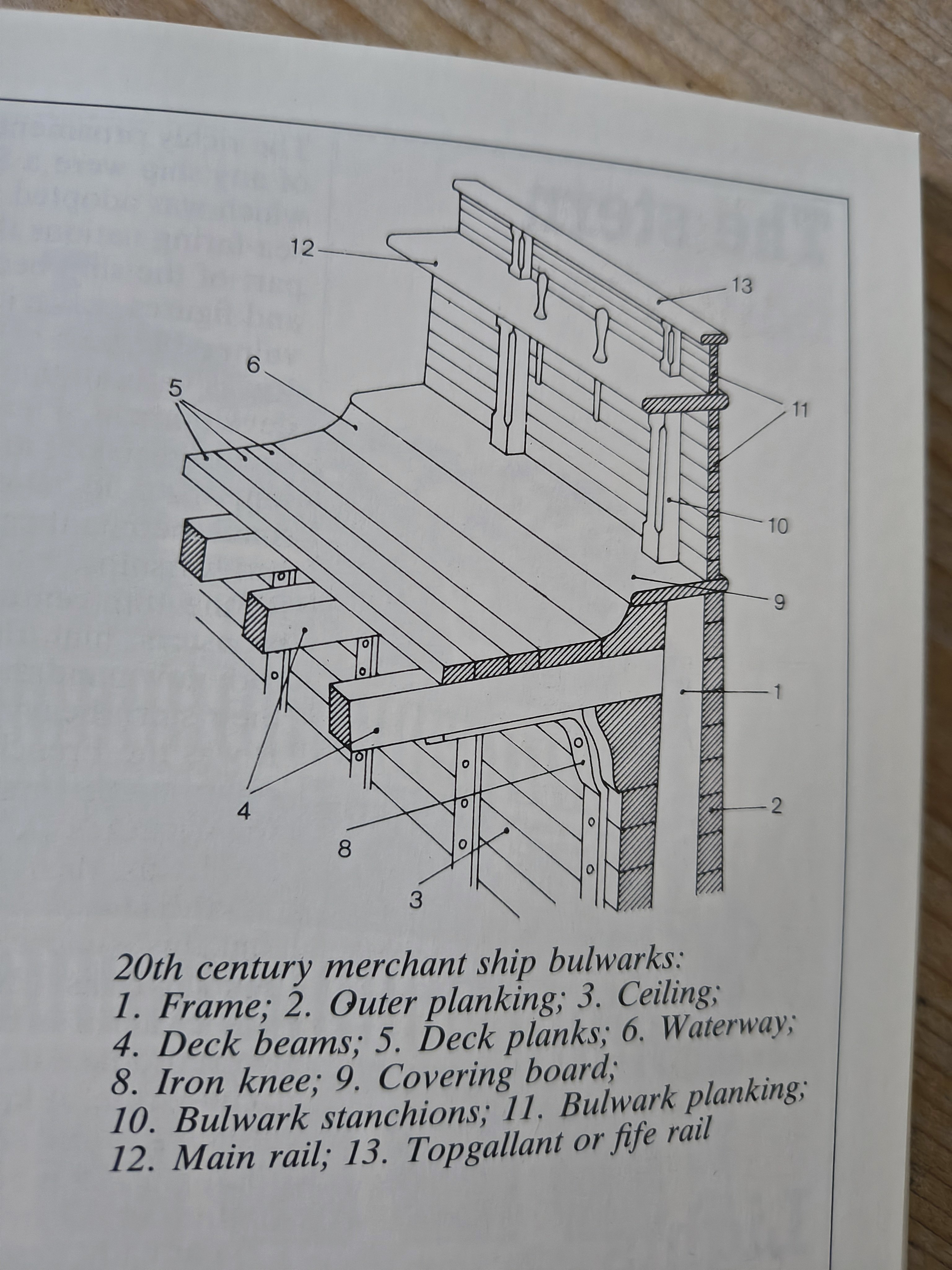

If you look at the pictures from the HMS Victory, they seem to be unpainted. If I understand correctly, they're part of the deck, a sort of L-shaped plank that starts on the deck and ends in the bulwarks. That's why I consider them a deck component and leave them bare (varnished, of course). This isn't based on facts, but on my own observations, haha. 😄

I have included an illustration from Mondfeld's "historic ship models" where you can see how the waterway as I see it is part of the deck.
Obviously this isn't a picture of the ship you're working on (not even of the time period), but personally I don't think there would be much difference?
Edited by Ronald-V
There are many different ways in which the waterways and covering boards were composed/constructed, depending on the period and the size of the ship. Sometimes, waterways and covering board were one piece of timber and in other cases there were two (as in the above drawing) or even three pieces. I have seen drawings/paintings of warship decks, where the waterways/covering boards were painted. In the case of the above drawing, it would be likely, that the covering board is painted, but the waterways are not - would be also easier to realise in a model.
