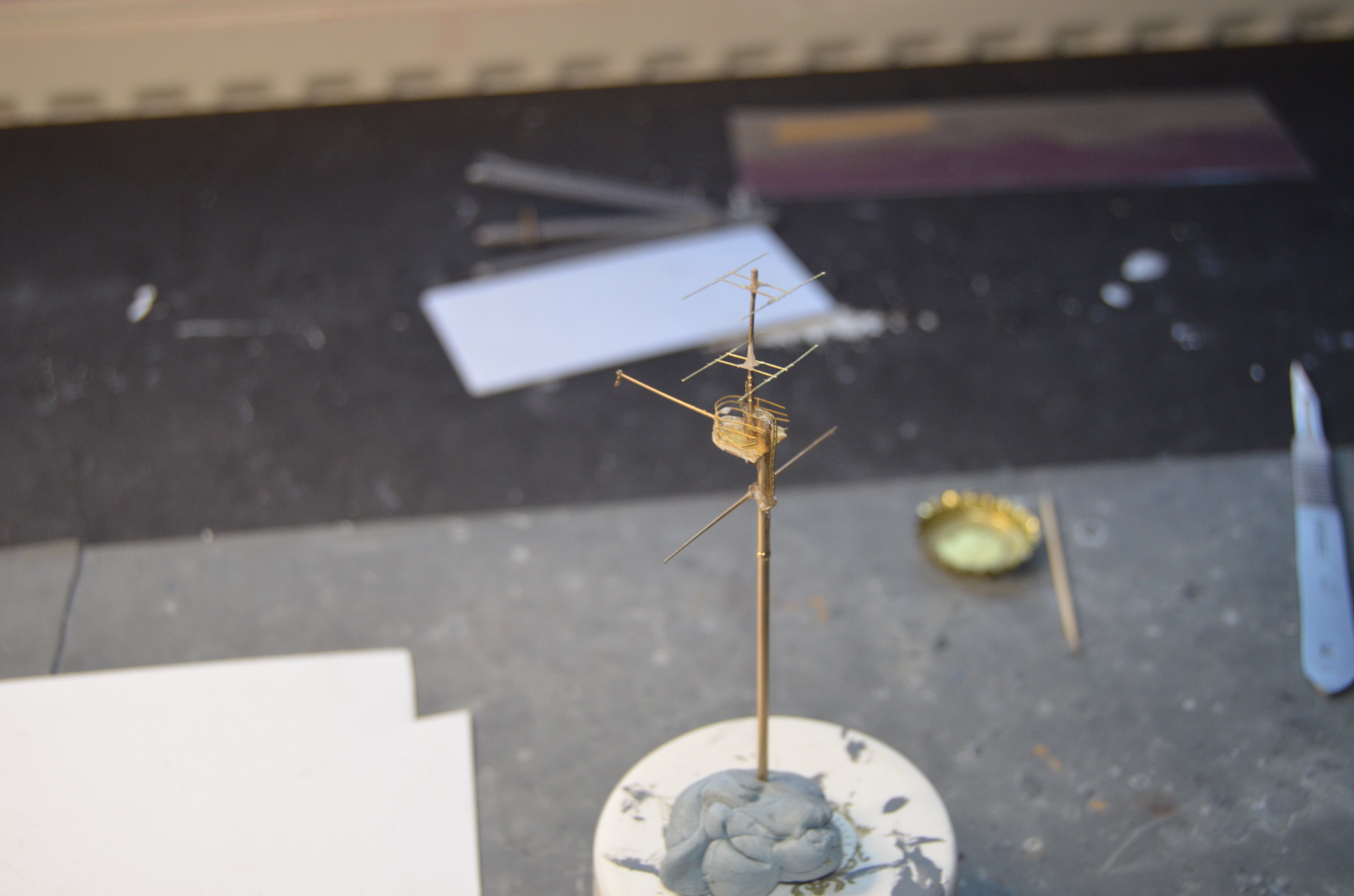

The top part of the main mast. This is made with the MK1 kit and replaces all of the Trumpeter parts. It is OK but I put the yard on the wrong side and am not going to take it apart to fix it. The hand rails are alright but the ends broke. As with these things it does look impressive when seen normally. Now onto the bottom part which will also have a lot of replacement and extra parts.
After much thinking about the yard I decided to change it. I did not like the way it bent down. Or that the cord was way out of scale and drew your attention to the rigging. So I have used the rolled brass yard from the MK1 kit. The only downside was how fragile it was. Even this would bend down with to much tension. So I added the line to give it more strength at each end of the yard. this has stopped it pulling down. There was very little surface for it to bond to either. So I left the centre part of the plastic mast in place to act as a brace and that has worked out fine. I also swapped the 0.4mm cord foe 0.2mm. It should be 5 double lines but that was way to finnicky to do. But it does look far better and more like how it looks on the ship. I have also added a few more stays to the funnels. Just the main mast to do and a few bits that will added to the hull and it will be finished.
