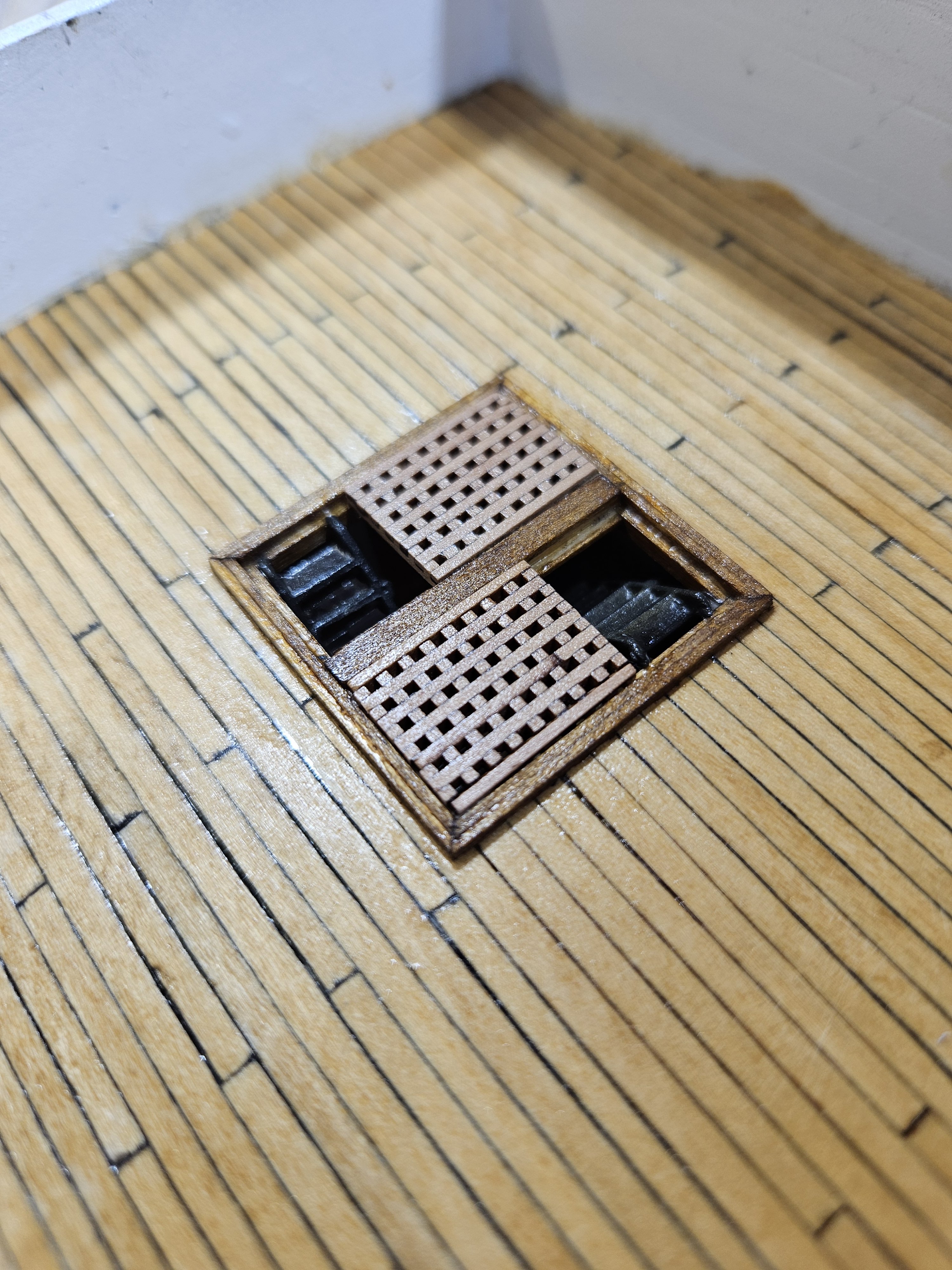

  8. Berth Deck decking stained and varnished. Started on the hatch coamings. Unlike the hatch coamings on the Orlop deck, I decided to form them inside the opening. It is going well, but in retrospect, I probably should have stained them prior to installation. LIve and learn.... Cheers, Brian

  17. All major beams for the Berthing Deck are fitted. I initially planned on keeping them in place as I installed the Orlop Deck bulkheads but quickly realized that would be too challenging. So I place a small mark on each side to mark the location of the beam, numbered each beam, 1 being the most forward beam and removed them all, including the centerline stringer (which was temporary anyway). Prior to removing all beams. After removal, I painted them for final installation. But before moving forward with re-installing the beams, I laid base board along the interior of the Orlop Deck bulkheads to glue the bulkheads to. This is the Aft portion of the Orlop Deck: And this is the forward portion of the Orlop Deck with the first beam reinstalled and the first bulkhead fitted. Prior to final installation of the bulkheads, they will be painted and doors installed. My plan is to work from the most forward part aft until the last bulkhead of the forward section is complete, then shift to the most aft bulkhead and work forward until that section is complete. Then I will determine if I want figurines or not (not having much success in that) and lay the cable in coils on the cable deck and place a spare anchor against the starboard hull.
