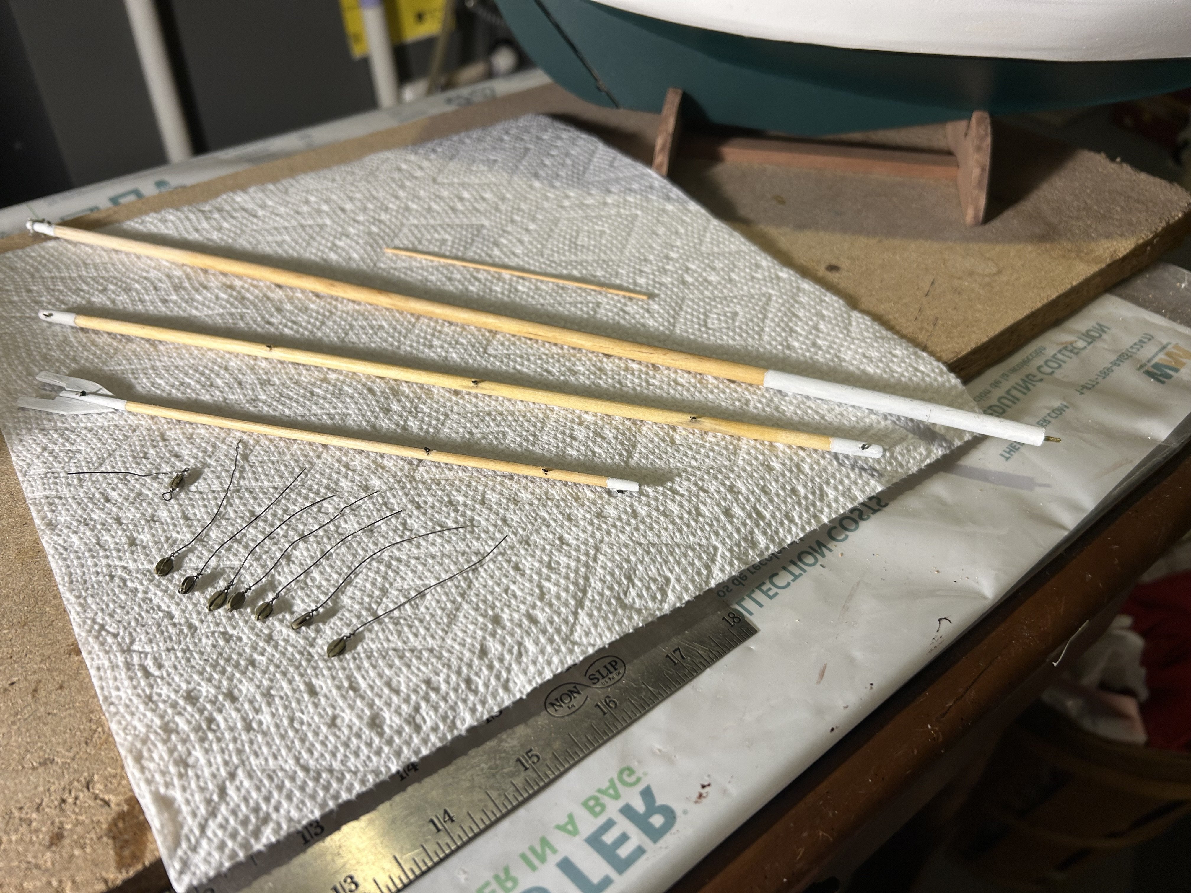

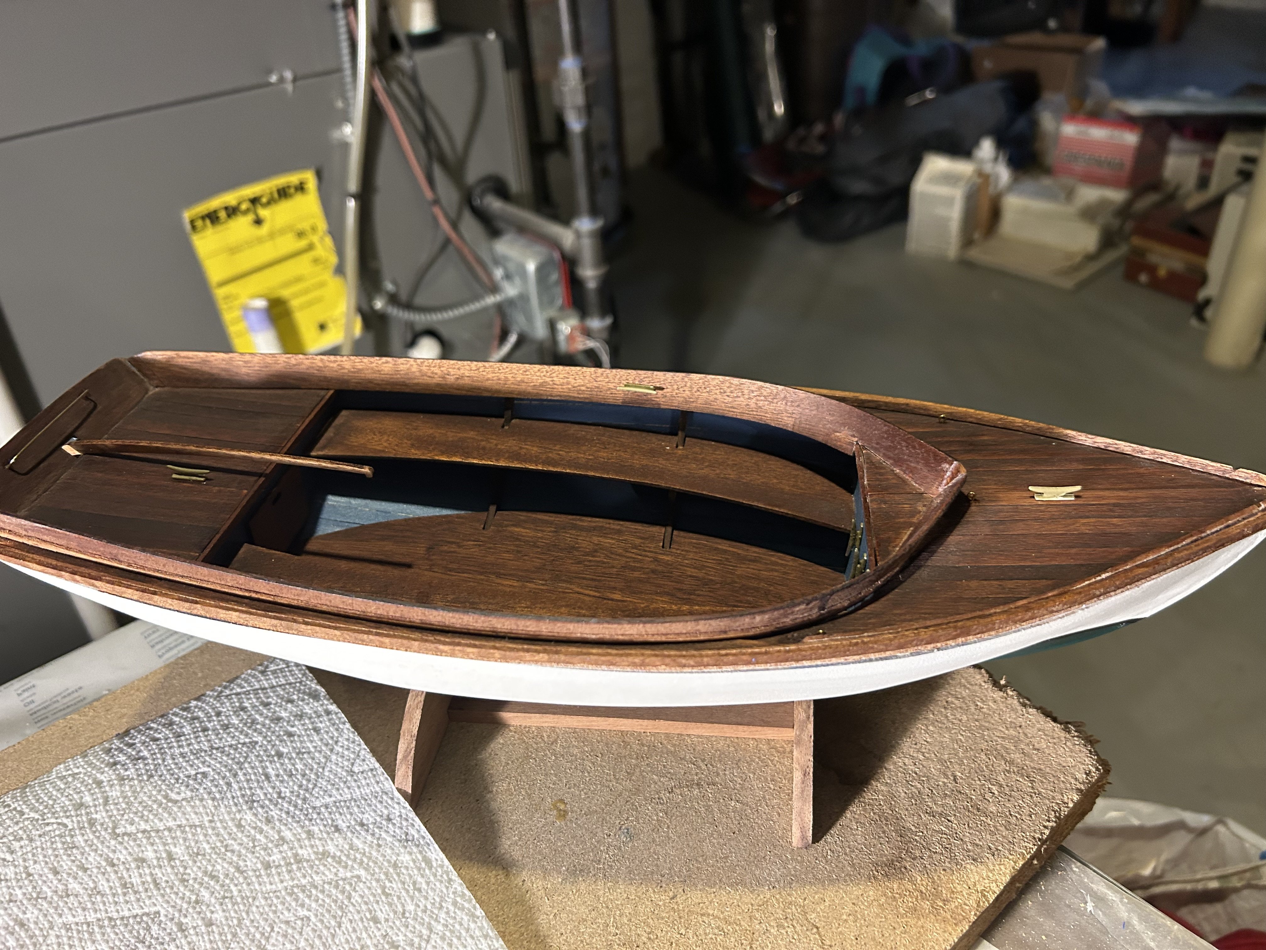

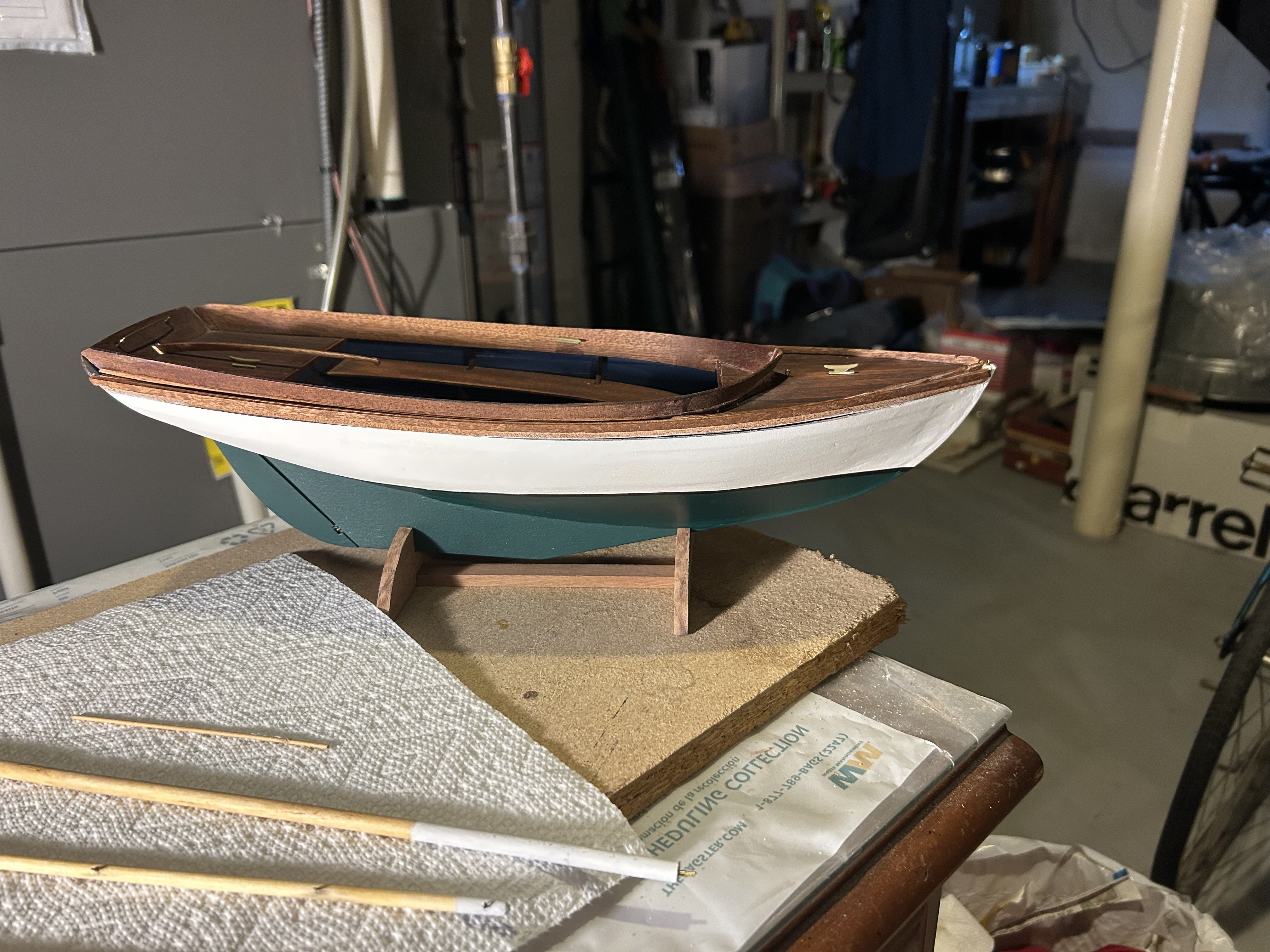

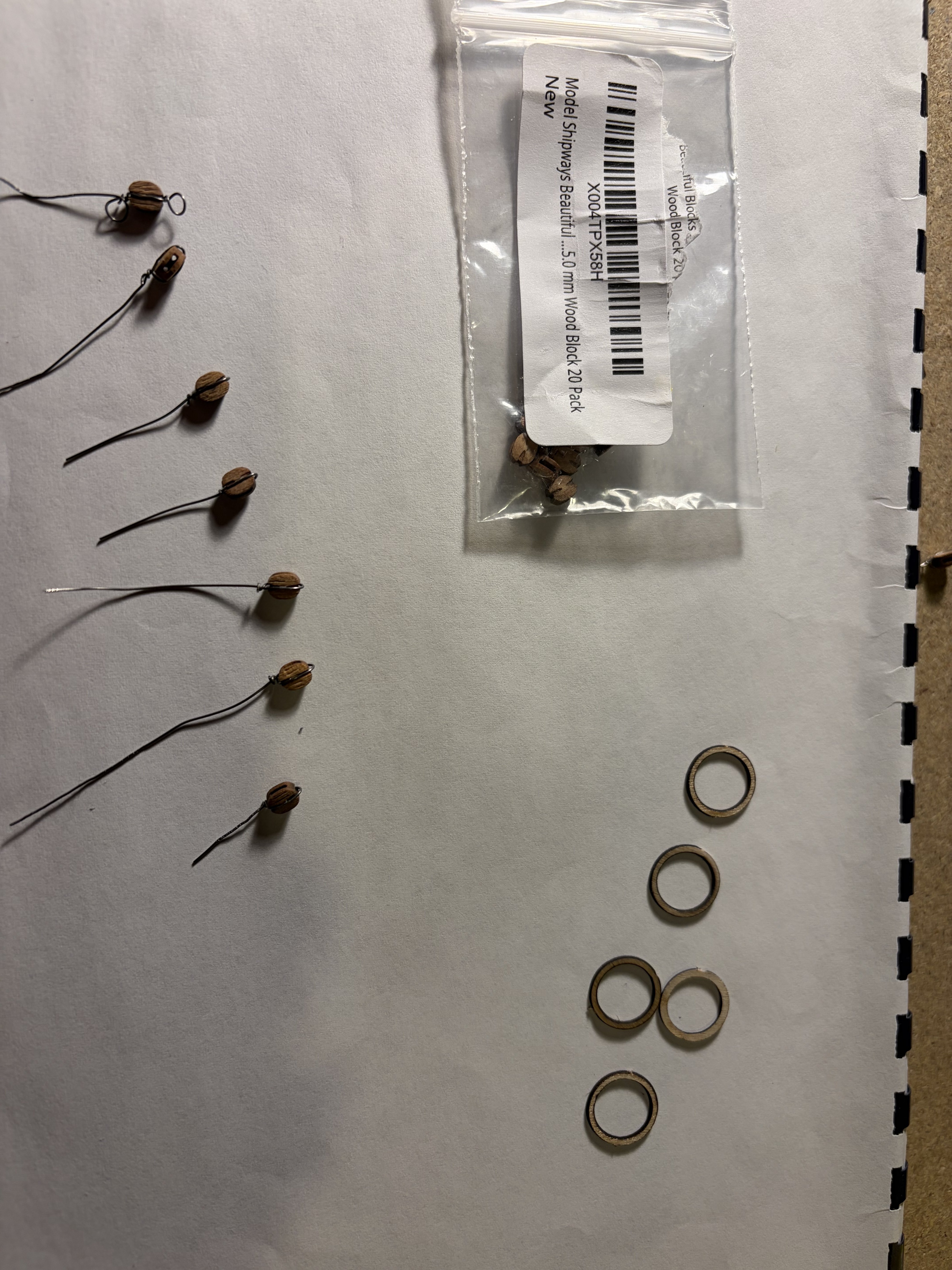

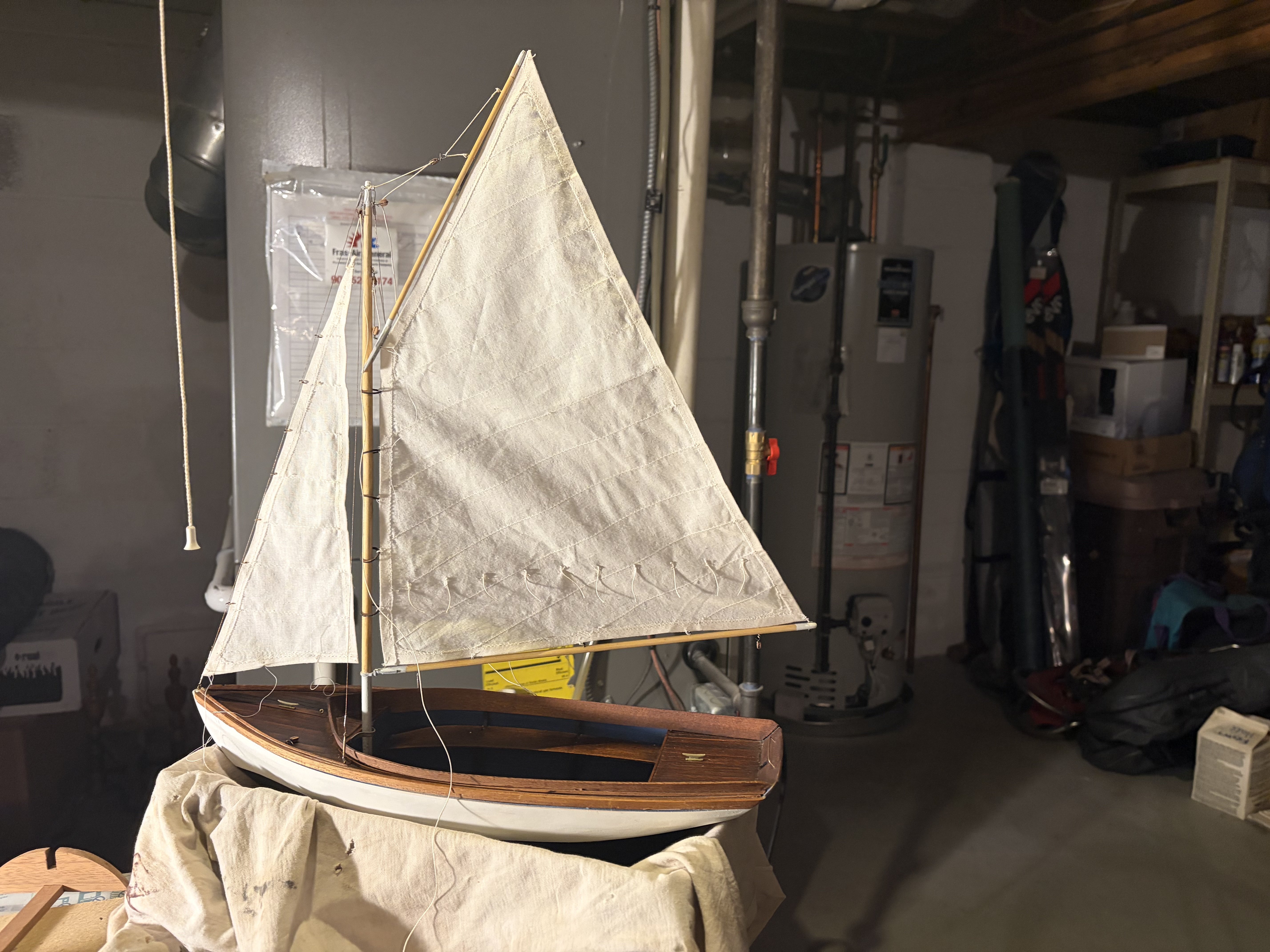

11/14/2025 update( back to it- golf season in the Northeast is over) Construction notes: 1. Entire hull was painted with Rustoleum 2x Painters Touch Flat white 2. Exposed interior planking was spray painted Rustoleum 2x Painters Touch Wildflower Blue satin( I would choose a different color in retrospect ) 3. I used delicate surface Frog Tape to mask the water line. Hunter Green Americas Finest ( Rustoleum) below the water line. I sprayed the frog tape with matte clear b4 painting with green to prevent color bleed 4. SIGSCS642 1/8” Super Stripe black for the water line 5. I attempted (unsuccessfully) to make wooden mast hoops as outlined in the instructions. I purchased 13/32” hoops ( part no. F-1504) from Blue Jacket 6. Model Shipways makes a wood single sheeve 5mm block MSBB1050- similar in size to the cast components provided with the kit. 7. I am fortunate to have some viable Flo Quil model paint. I used this to paint the ends of the mast, boom and gaff. 8. Much appreciated shout out to Sue A. who I met at the Blue Jacket rigging class a few years ago. We’ve stayed in touch since, and she provides great advice and ideas as I progress. She stitched the mainsail and jib- great job- and we opted not to install the bolt rope. 9. I had painted the interior mahogany transom blue, and realized that didn’t look right. I used citric acid to effectively strip the paint.
Planking is complete. Difficult to bend basswood planks in 3 dimensions- I’m soaking the planks with boiling water and ammonia. There are several small gaps between planks. I painted several toothpicks the same color as the cockpit interior and glued them to the exterior hull to smooth the plank transitions
