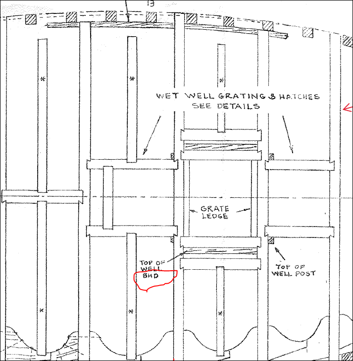

  1. If that middle letter is an H, then you are probably correct. Thank you sir!
