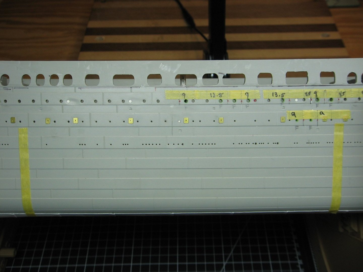

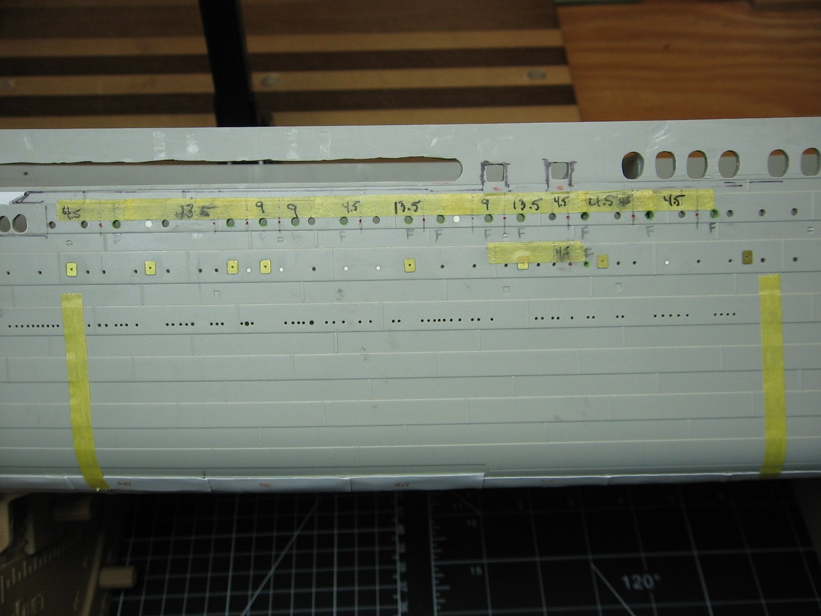

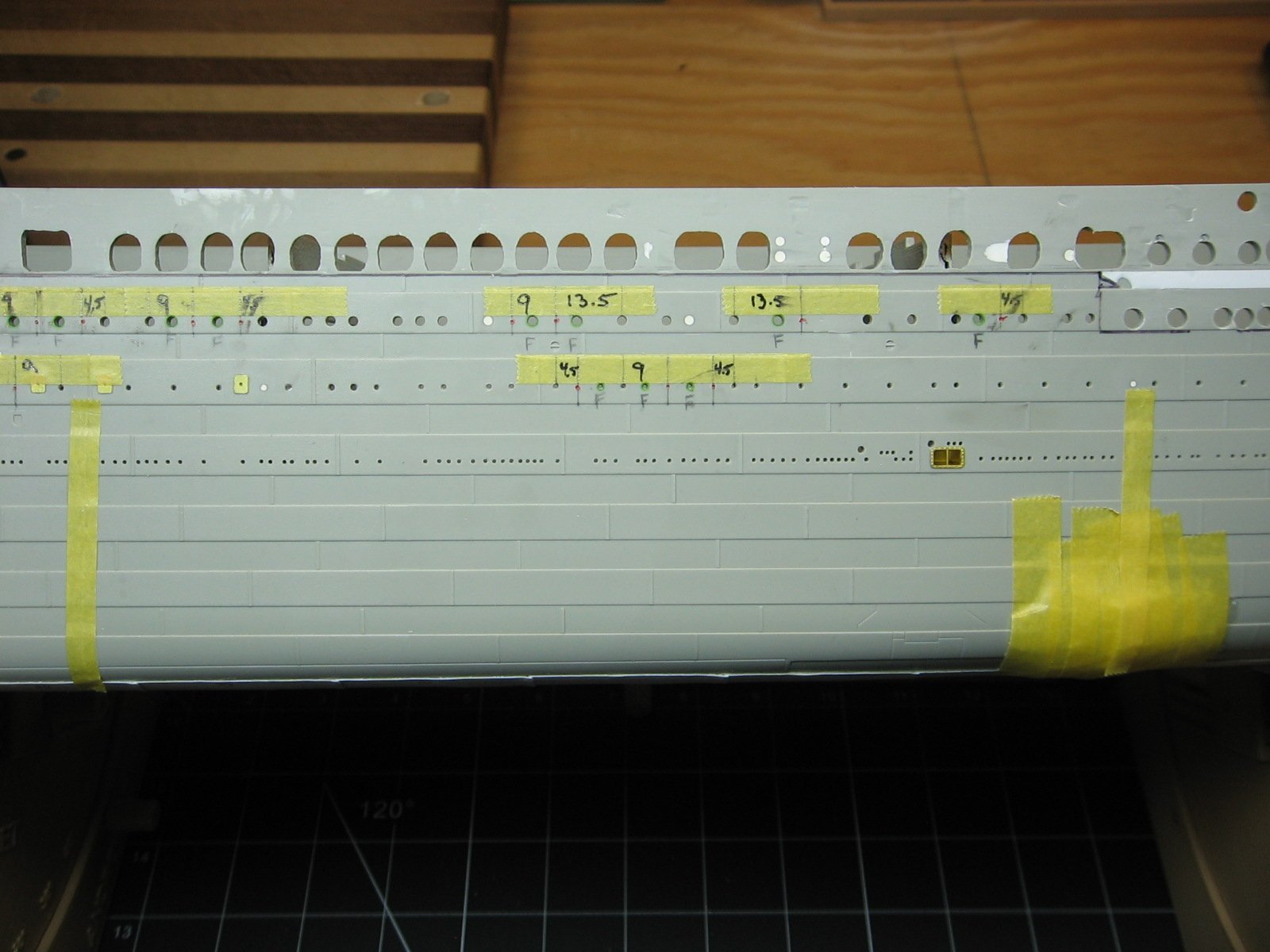

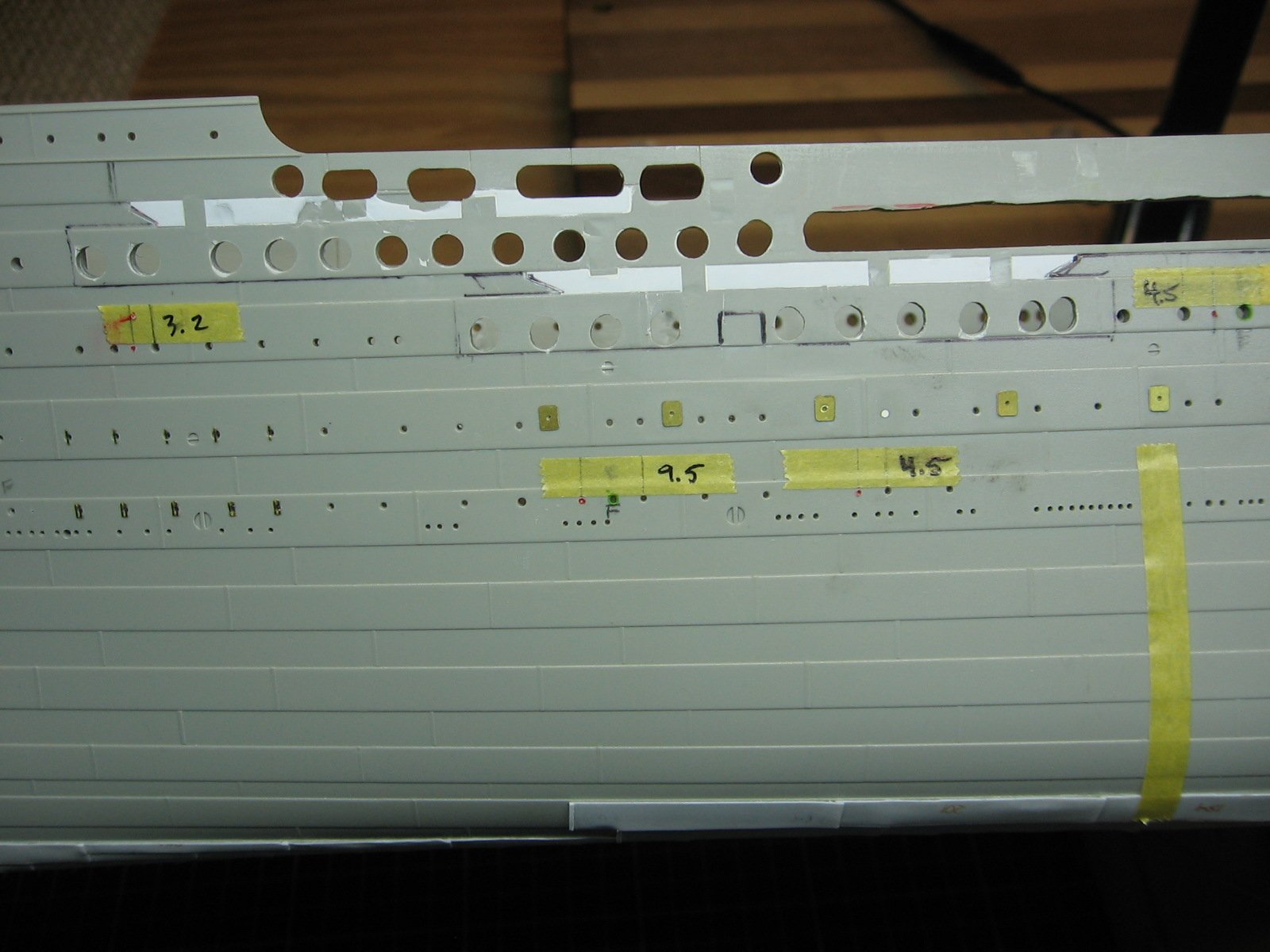

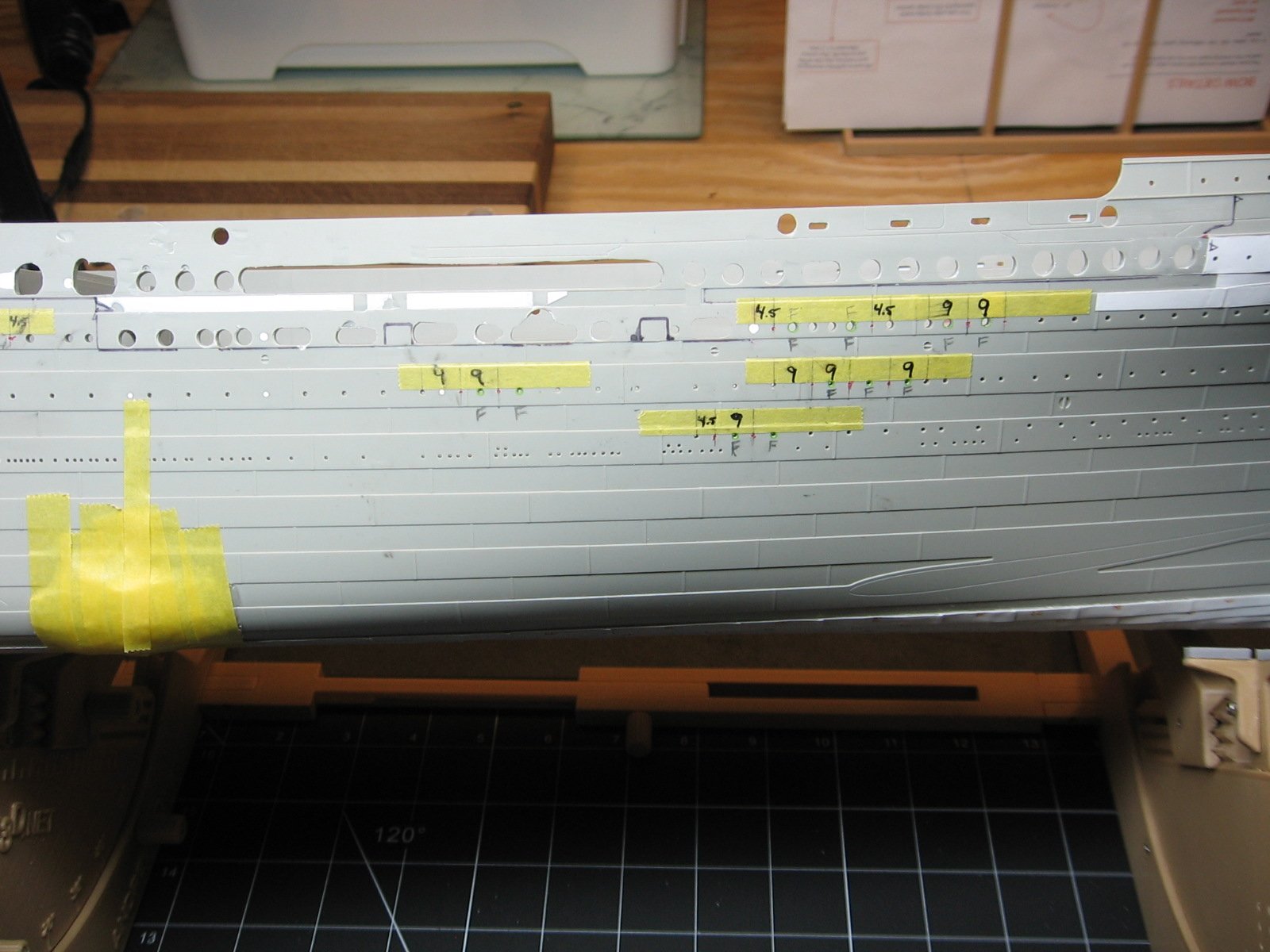

Thanks for this question, Evan. After much deliberation I have decided not to remove the well deck bulwarks. More on that decision later in this post. Update: After ~6 mark ups and ~7 dry fits (I lost count), and many hours of drilling and filing in between, the Port side of the hull is finally prepped for the Mini Brass PE. The Starboard side prep should go much faster, given that I now know what I'm doing as well as not having to prep parts N1 and P1, as I'm going with the pending AM support frame. The mark ups currently showing in the following pictures are for relocating the incorrect portholes on the Port side. Contrary to what I side about those earlier in this build log, I've decided to do them. They will be next, before proceeding with the Starboard side prep. Some words on my experience with this AM kit (Mini Brass Hull Profiles) so far: I can't explain why this porthole, near the aft well deck, is partially covered. This porthole is, unfortunately, not one of the portholes on the "remove" (fill) list. It did exist in this location. I have since filled this porthole. Not sure what else to do, short of trimming the PE here and adding a styrene strip to replace the plate seam doubling plate, which would be lost by doing so. Any opinions on this aspect would be greatly appreciated. Further to this, and a potential cause: The instructions for this AM kit provide guidance on the placement of the PE in a vertical plane. "The PE should be lined up with the bottom of the outer strake of D-deck (marked with a red line in the graphic below). Dry fit the pieces to to get a clear idea where each piece needs to go." This guidance is very much appreciated. Having said that, the fitting of the PE on the vertical plane becomes somewhat obvious during the first dry fit. What is far less obvious is the placement of the PE on the longitudinal plane. However, there is zero mention provided regarding where to place the first piece with regard to longitudinal placement. No datum. No benchmark. Guidance in the instructions on that would go a long way. With the first dry fit, I started forward and lined up the forward well deck wash ports of the PE's Section A with the wash ports on the Trumpeter hull because, well, they lined up. This was my benchmark. Many of the portholes of the first section lined up as well, with this benchmark. In doing this, I discovered some of this coping strip (within the red circle) required trimming. Part of this coping strip, aft, required trimming as well. Unfortunately, I had not noticed the partially covered porthole until much later, after I had already done significant surgery to the hull. Shifting everything 1mm forward was not an option, in my mind. That would cause more surgery required, not to mention who knows what all else. Again, I'm considering trimming the PE to expose the porthole fully. The Well Deck Bulwarks: As mentioned at the beginning of this post, I have decided to not cut these away. Having seen Evan's work on his Titanic in this regard, I was very much interested in removing these bulwarks as well. The only difference for me would be replacing the curvature of the bulwark forward (forward well deck) and bulwark curvature aft (aft well deck) with styrene, as the PE would take care of the rest. I figured I could follow and replicate Evan's lead on this and was 90% committed to take the plunge. Only one more question remained. Would the KA and/or Pontos PE I have, representing the inboard side of these bulwarks, line up with the Mini Brass PE? KA PE, forward well deck, Port. KA PE, aft well deck, Port. Unfortunately, they do not line up. Pontos does not line up either. Rats. As far as I know, there is no other AM PE available for the inboard side of these bulwarks. These are the only two options. Having said that, I want to use the KA PE in these places and I figure the thickness of the Trumpeter hull will provide enough separation from the Mini Brass PE to render the misalignment a non-issue. Hence, my decision to leave the bulwarks intact. Much thanks to Evan, regardless, for putting the thought in my head. Not much else to say at this point. As mentioned, will do the porthole relocations next and then on to prepping the starboard side for the Mini Brass PE. Thanks for looking. Cheers, Mark

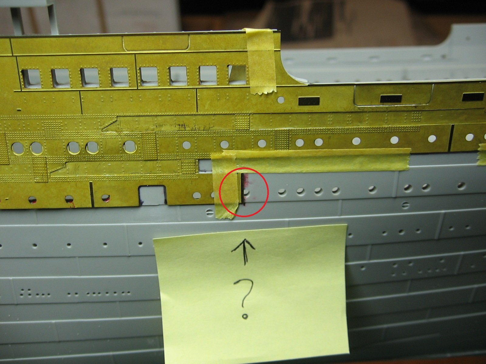

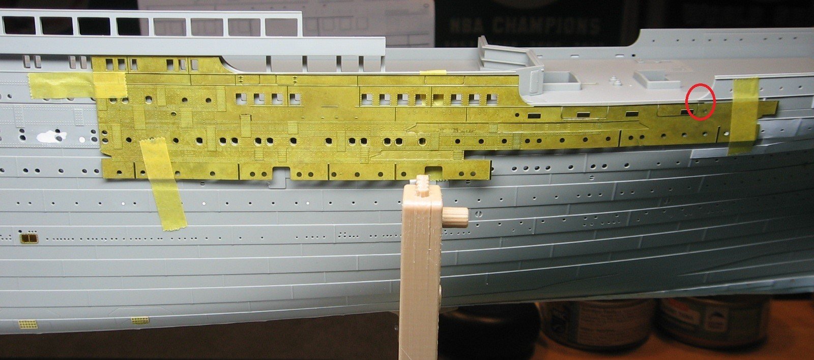

Changed my mind on getting to the propeller shaft wings and bilge keels next. Will get to those later. I need to address something else so I can get back to content sleeps at night. I did a dry fit of the Mini Brass Hull Profiles PE kit, port side. Ugh. As one can see by the photos, alignment is perfect in some parts (circled in green), but grossly not in other spots (circled in red). In hindsight I suppose more research on others experiences with this aftermarket kit would have been prudent. Apparently, turns out the kit hull has even more inaccuracies and, in this regard, the Mini Brass PE is correct. Who knew? If I had known that, I likely would NOT have purchased the kit. One of the reasons I was sold on it was that I expected no major surgery required. There is no mention of major surgery in the instructions, which I perused online prior to taking the leap. Having said all that, and given the amount of time and money already invested in this PE, I think I can make it work. Unfortunately, I have already drilled out the portholes. Less surgery would be required if they were still intact. First step is to remove the raised detail for a flush surface. Then more dry fitting for a better understanding of where I need to cut. Thanks for looking. Cheers, Mark

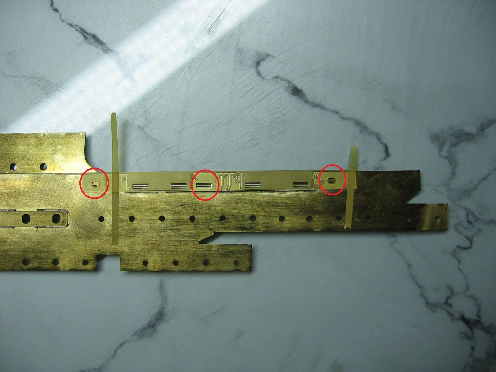

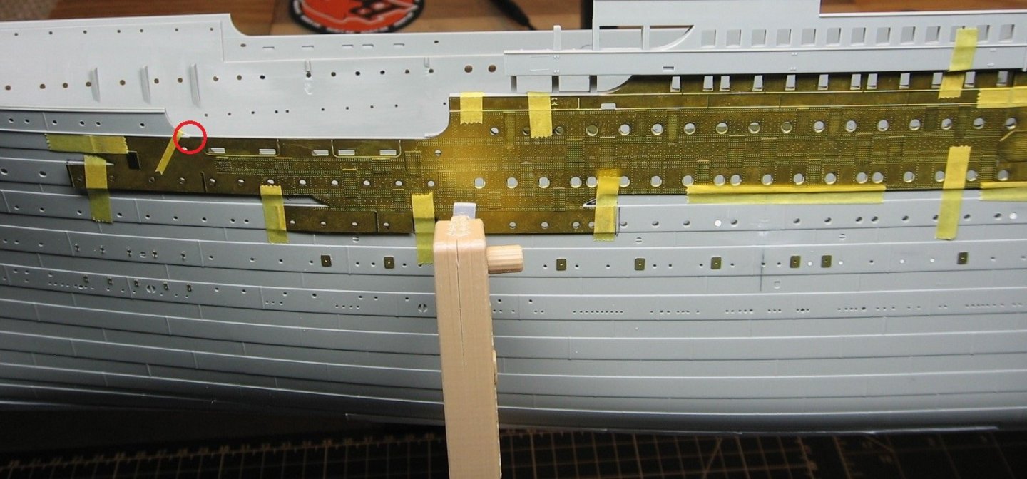

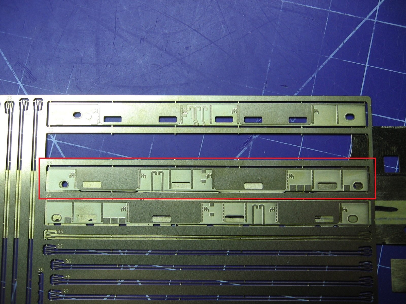

Doubling plates (all 180 of them) attached. Used CA glue for these. Parts A - D now complete. I found Part CU-2 backplate to be the most difficult. Particularly on the Stbd side (circled in red). It popped off under stress from handling. Re-attached with epoxy. Unfortunately I re-attached it without paying attention to alignment. Thus, it is slightly off by about 1-2mm longitudinally. Shouldn't be a big deal and hardly noticeable. Up next, as per instructions, with this PE kit is to prepare the hull. However, before engaging in that surgery, I want to do somewhat of a dry fit first. As well, there are other hull features still to be attached. For attaching the bilge keels and propeller/shaft wings I expect I'm going to want to flip the hull upside down. I'm quite certain that would not be a good idea with this PE in place. Further, kit parts N1 & N2 and P1 & P2 (for A, B, and C decks) come into play with this PE. Having said that, it's time to install the internal frame aftermarket kit. Original plan was to install the frame kit after painting the hull, as it would be much easier to install the porthole "glass" without the frames in place. But that plan was before I decided on this PE kit, and plans change. Glueing one frame at a time. I did not have a bar clamp large enough for this, so went out and bought one. At $18.99 CDN each (on sale, down from $29.99) it made more sense to get just one, instead of four. In the meantime, prior to starting on the internal framing, I was pondering the lowest row of molded indentations on the hull, which represent through hull fittings. Common advice regarding these is to DON'T DRILL THESE OUT(!). But wait.....I'm not lighting my model, and therefore, there would be no light leakage through these if they were drilled. I decided the overall look will be better with them drilled. Left undrilled, some of them will end up painted over with antifouling red. Done. Second frame glued in this morning. Two more to go. Should have that completed within a couple of days. After that will be the bilge keels and propeller/shaft wings. Thanks for looking. Cheers, Mark
Parts CU1 and CU2. For the Port side, I treated these parts same as the previous back plates. Worked them from the back side. Measured for fit and applied epoxy. Then flipped the sheet over for fine tune positioning. As soon as I flipped the sheet over both pieces fell off. I wasn't able to apply enough glue for the parts to remain attached during the flip. Bit of a gong show, from that point, but I managed to position the parts while working them from the topside and using CA glue in conjunction with capillary action. Different approach for the Starboard side, which was way easier. Worked them from the topside from the get go and simply positioned the pieces dry and then taped them in place, followed by applying CA glue at each ends, allowing capillary action to do it's thing. Then, once secure, flipped the sheet over and applied more CA from the backside. On to the Doubling Plates... Thanks for looking. Cheers, Mark
Back Plates of Sheets 1 and 2 done. I've been working on another project, which delayed me for a while, but that's completed now. As well, I found I had to provide weight to the PE to flatten the bends resulting from the shipping damage. Not sure if this would have been required regardless, but me thinks not. At any rate, because of this, I chose to do each of the larger back plates one at a time. I wanted to minimize the possibility of the back plates slipping as much as possible. Thus, this slowed the process down. I chose a BIG HEAVY book for the weight. Further, I switched to a slower curing epoxy. Working out well. On to Sheet #3, and more Back Plates. Four back plates for each side (Port and Starboard) on this sheet. I'm hoping to get all eight done in two applications. We'll see. Thanks for looking. Cheers, Mark
