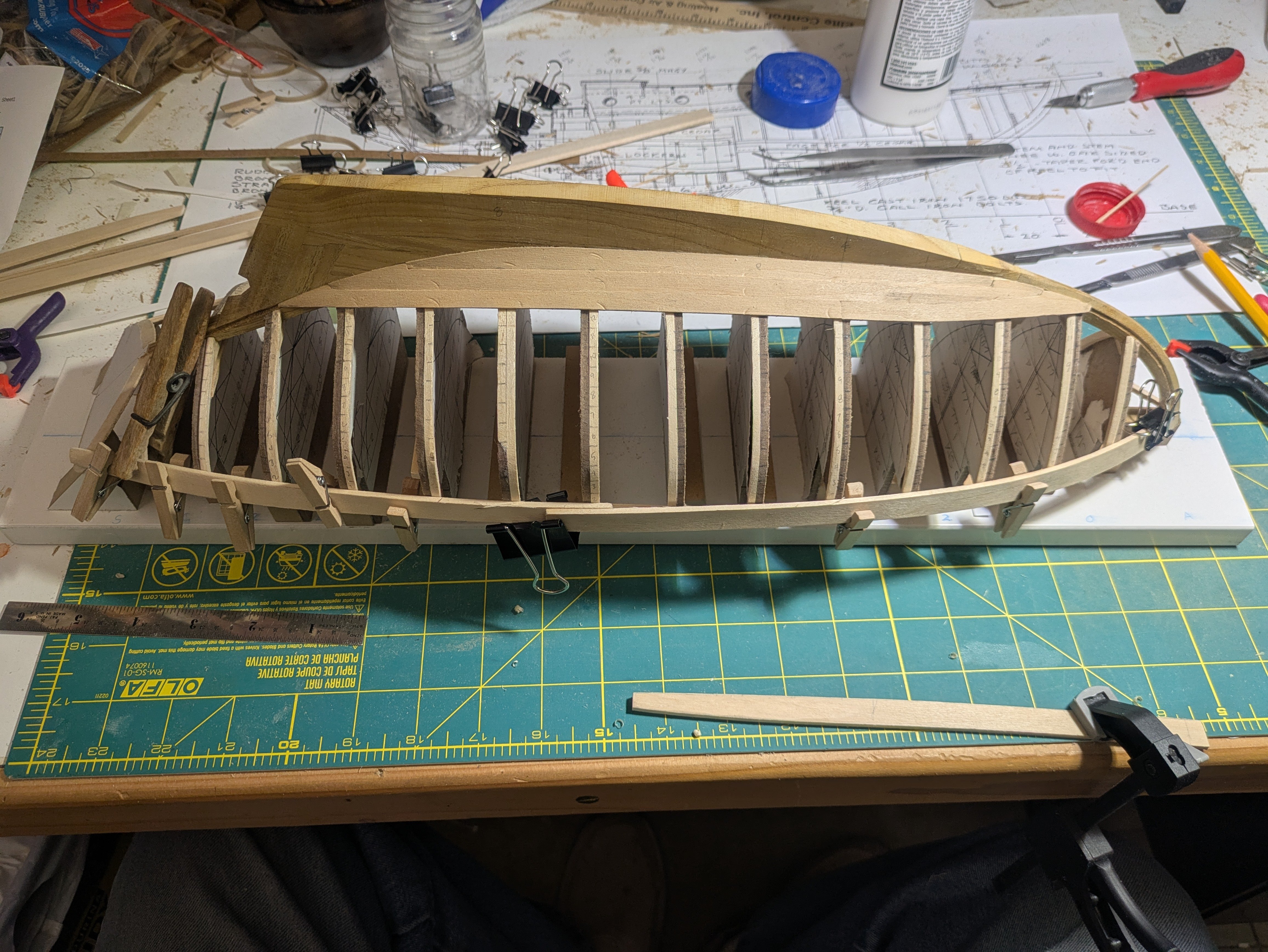

Jim, I think it will start to look like a boat soon. Keith, Yes but with only 15 planks per side I will need a few more boats and different shapes before I get good at it. I got two more from the garboard on and I am working on the sheer strake. I'm using 1/8" (3.2mm) stock for the sheer strake because there is a lot of curve at the stern for a nice width plank. The last two molds have a lot of curve at the top so I used a small gouge to cup the end of the planks and sanded the out side down to 3/32" (2.4mm) so the sheer will be a little thicker then the rest of the planking. I have been "steaming" or boiling the planks using a microwave. Then I dry them with a MonoKote heat sealing tool.

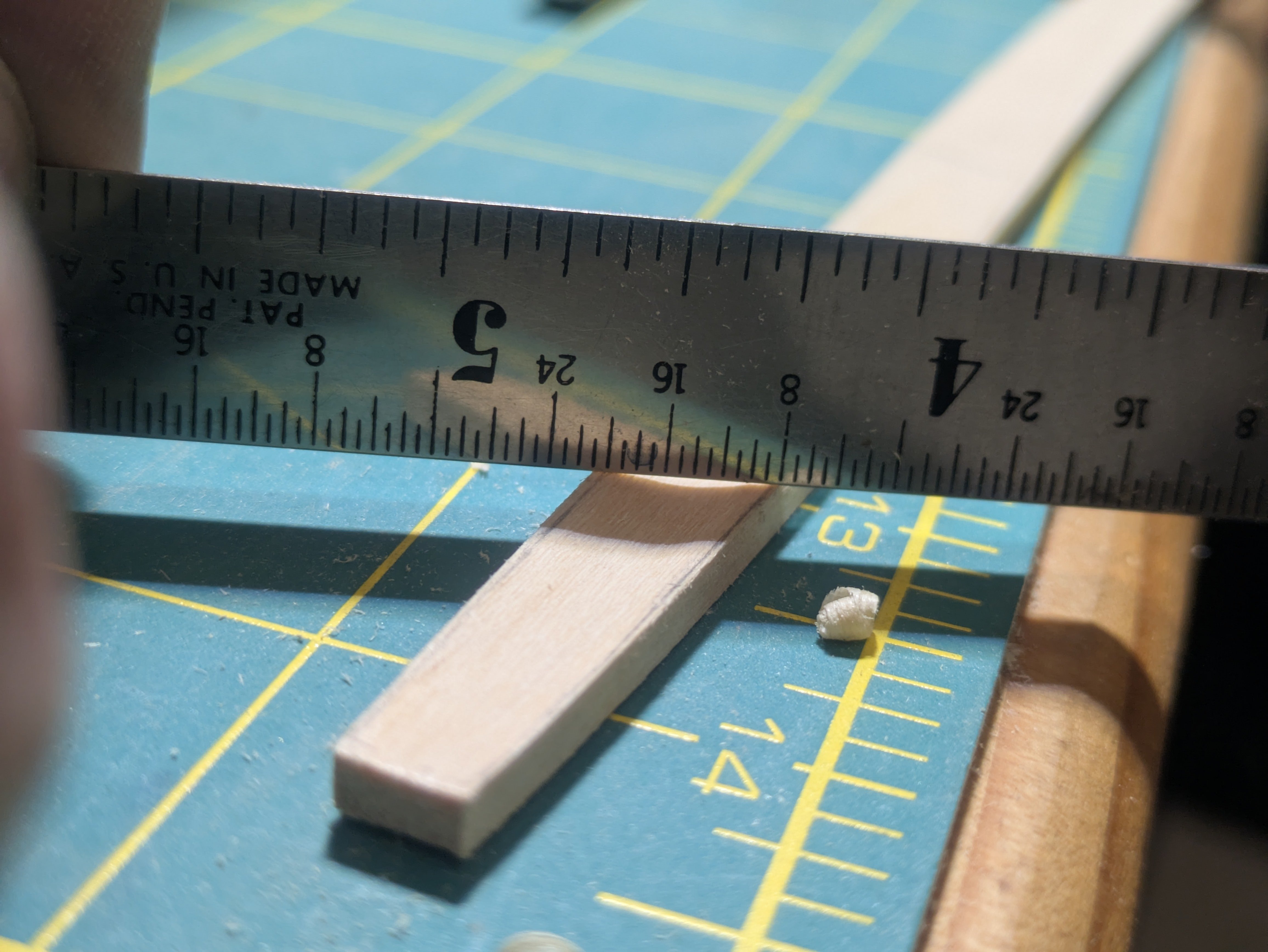

Slow start on the planking. I made a pattern for the garboard plank and to my surprise both sides are the same! Tomorrow put some twist and bend where needed and glue them down. The widest point on the garboard turned out to be 5-1/2 inch a far cry from the nearly 12 inch we used In the full size boat.

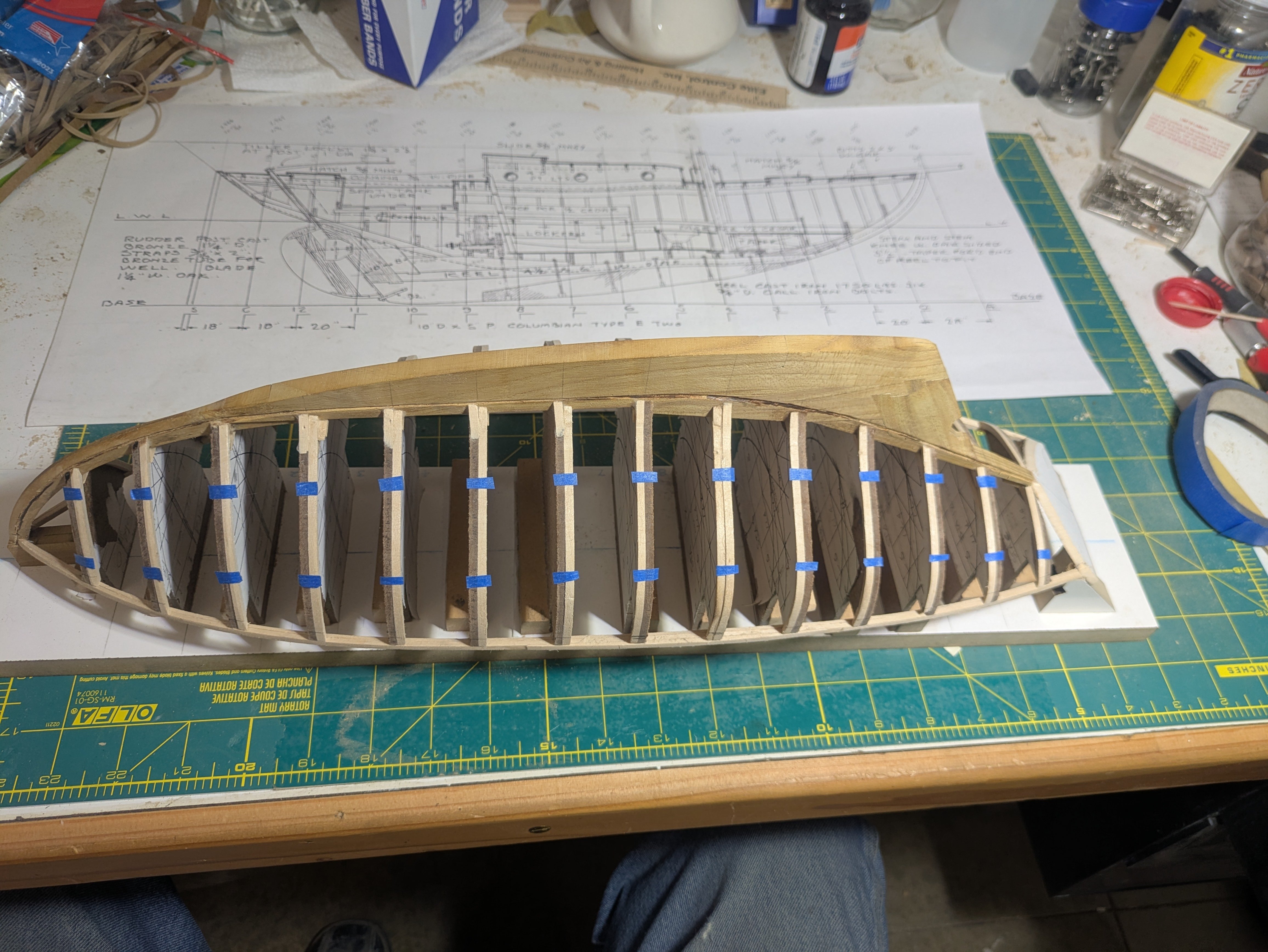

I got the plank layout finished. I started with laying a 1/2" wide batten to see how planks would lay naturally. But that would cause the planks to sweep up and end on the sheer so they will all have a curve to the keel at the bow and slightly at the stern. I know this is not unusual but I was surprised that much of the mid stations don't need any curves. When I start cutting the planks this will be seen.

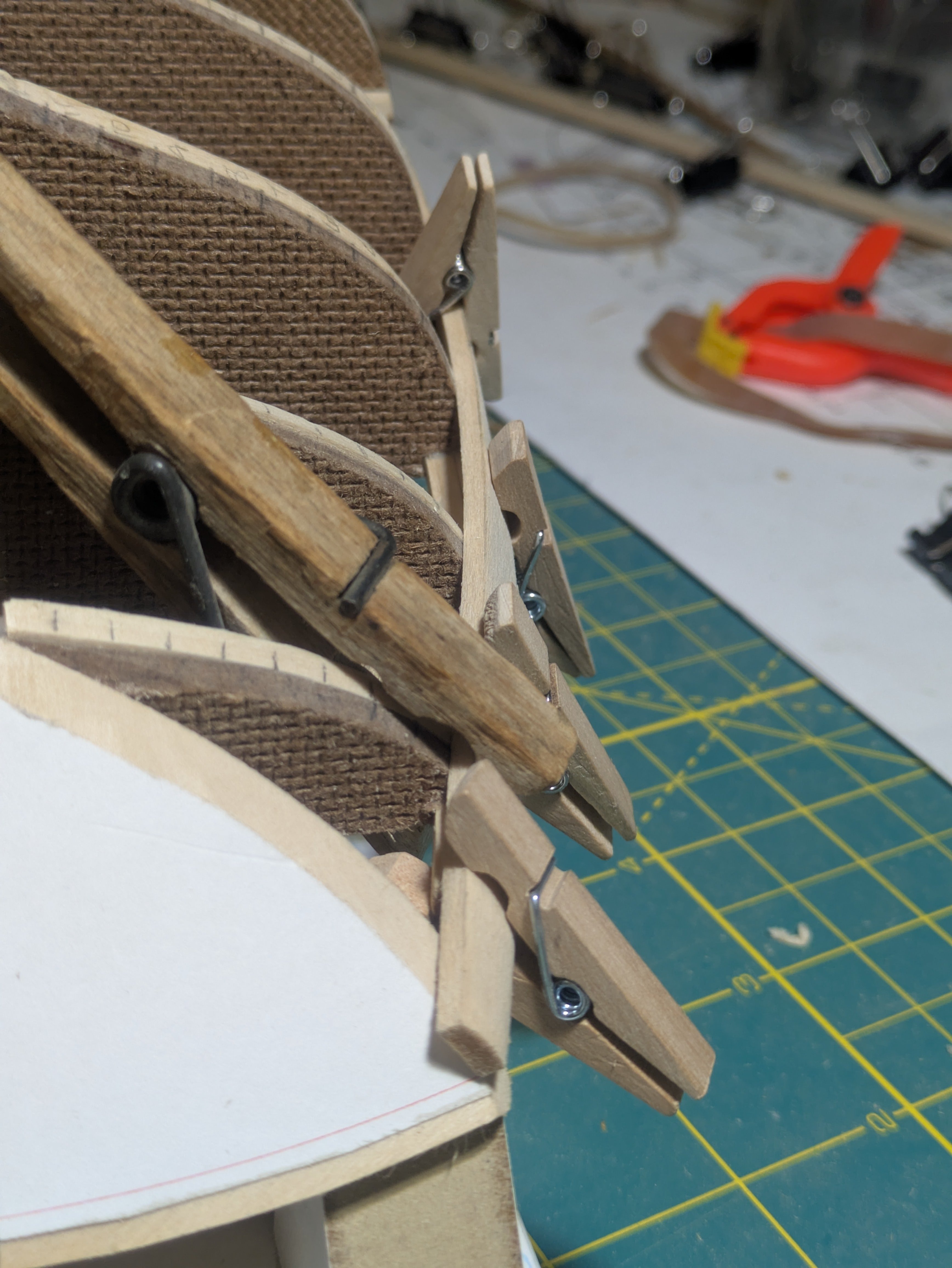

I tried to get the molds to stand vertical but carefully making them but I had to resort to shimming with a piece of paper under the back half of the mountings. I cut some basswood strips and and soaked them in a glass of water that I boiled in a microwave. I am forming the boxwood on the edge of the molds for added support for the planking.

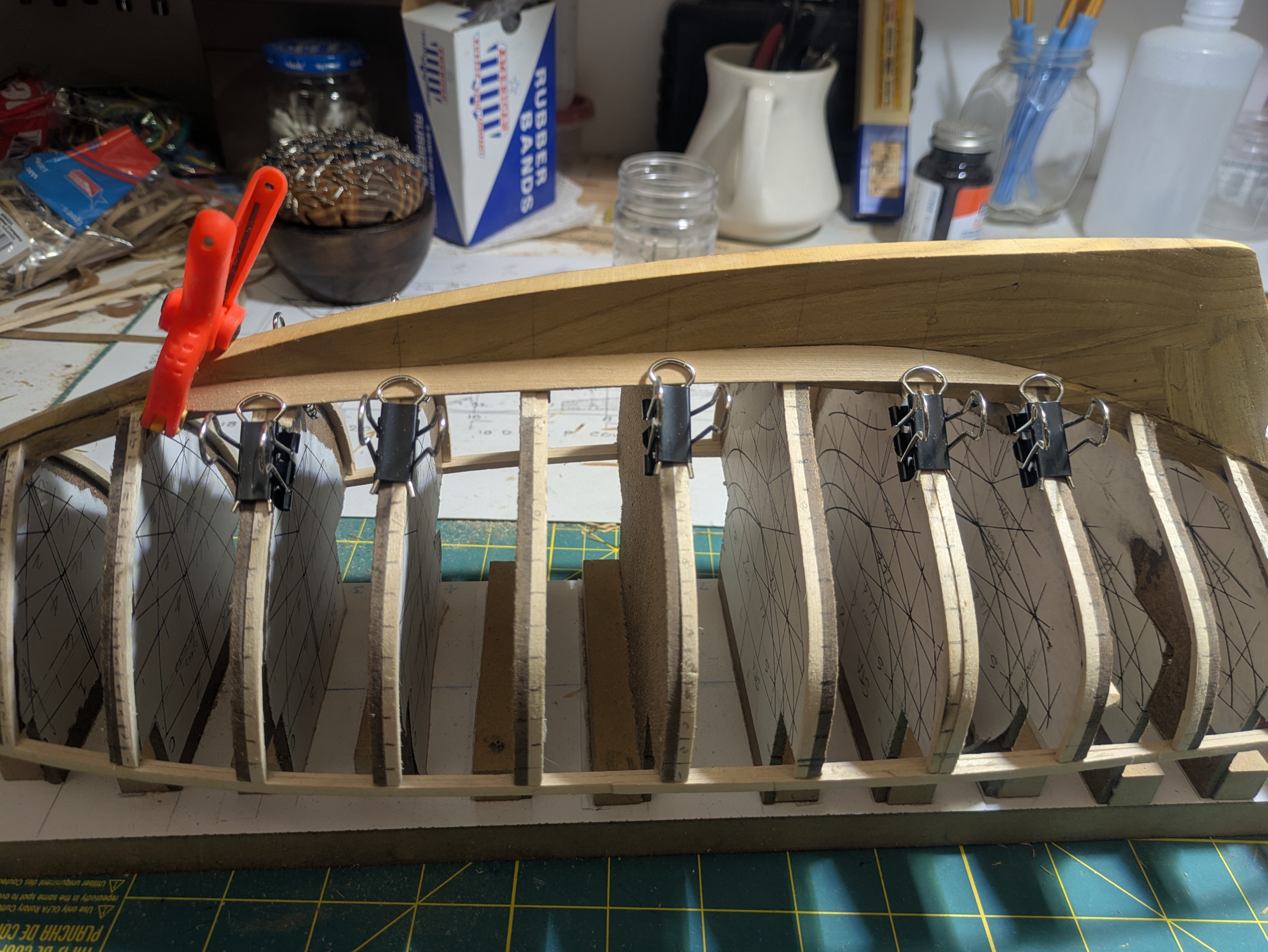

Well a lot of things to figure out. And I already regret using hardboard for the molds. That's what inexperience and a supply of hardboard gets you. I fastened the molds from the bottom of the building board so I can remove them individually. I'm thinking of adding frames to the edge of the molds to add to the gluing area.
