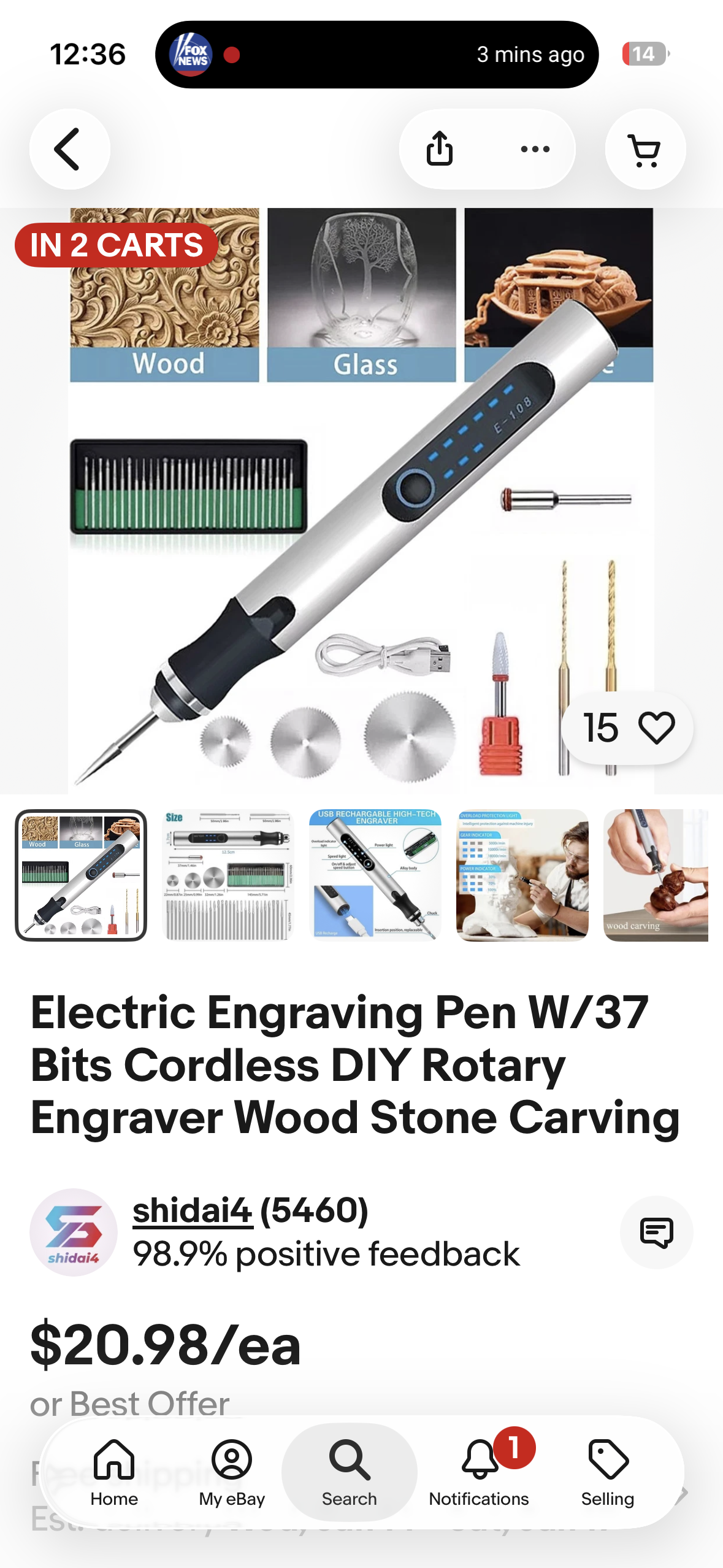

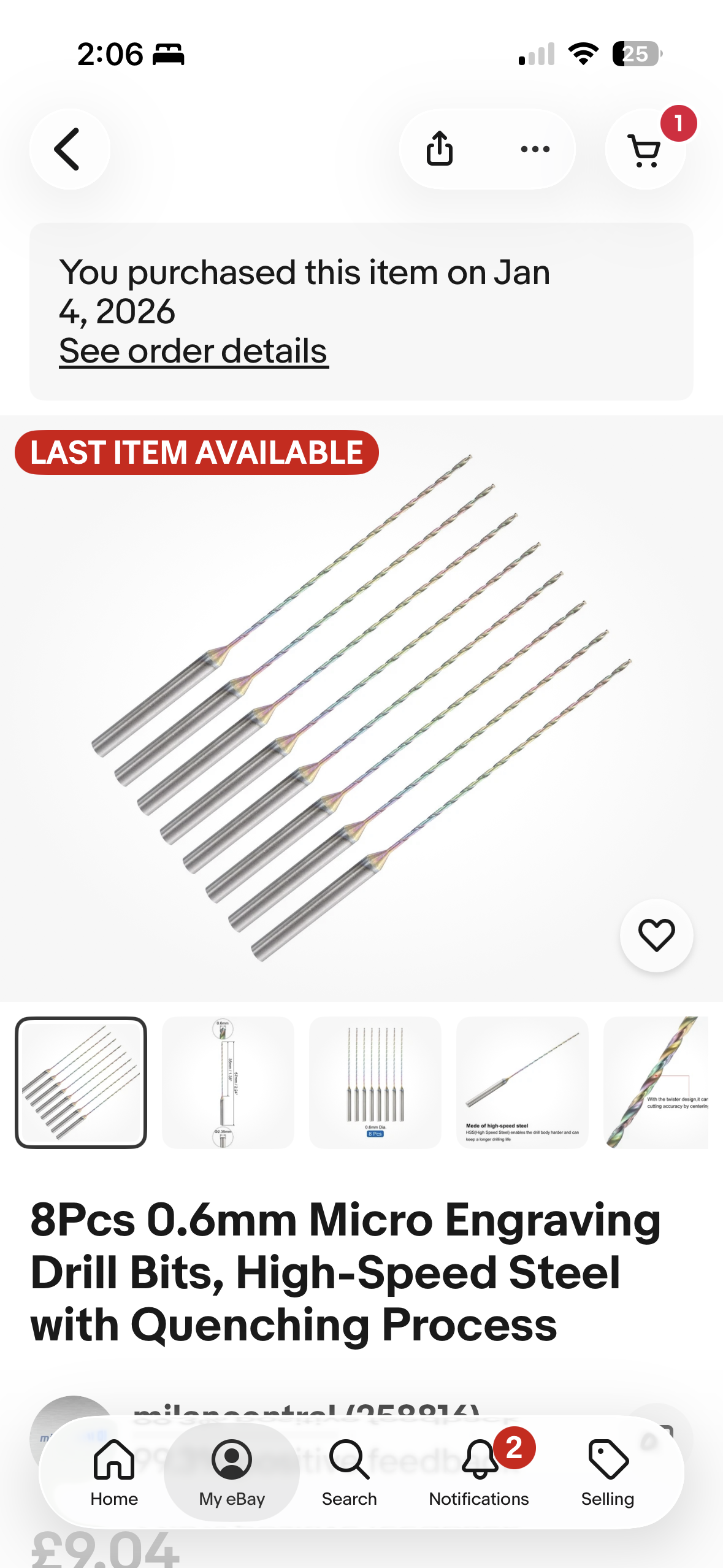

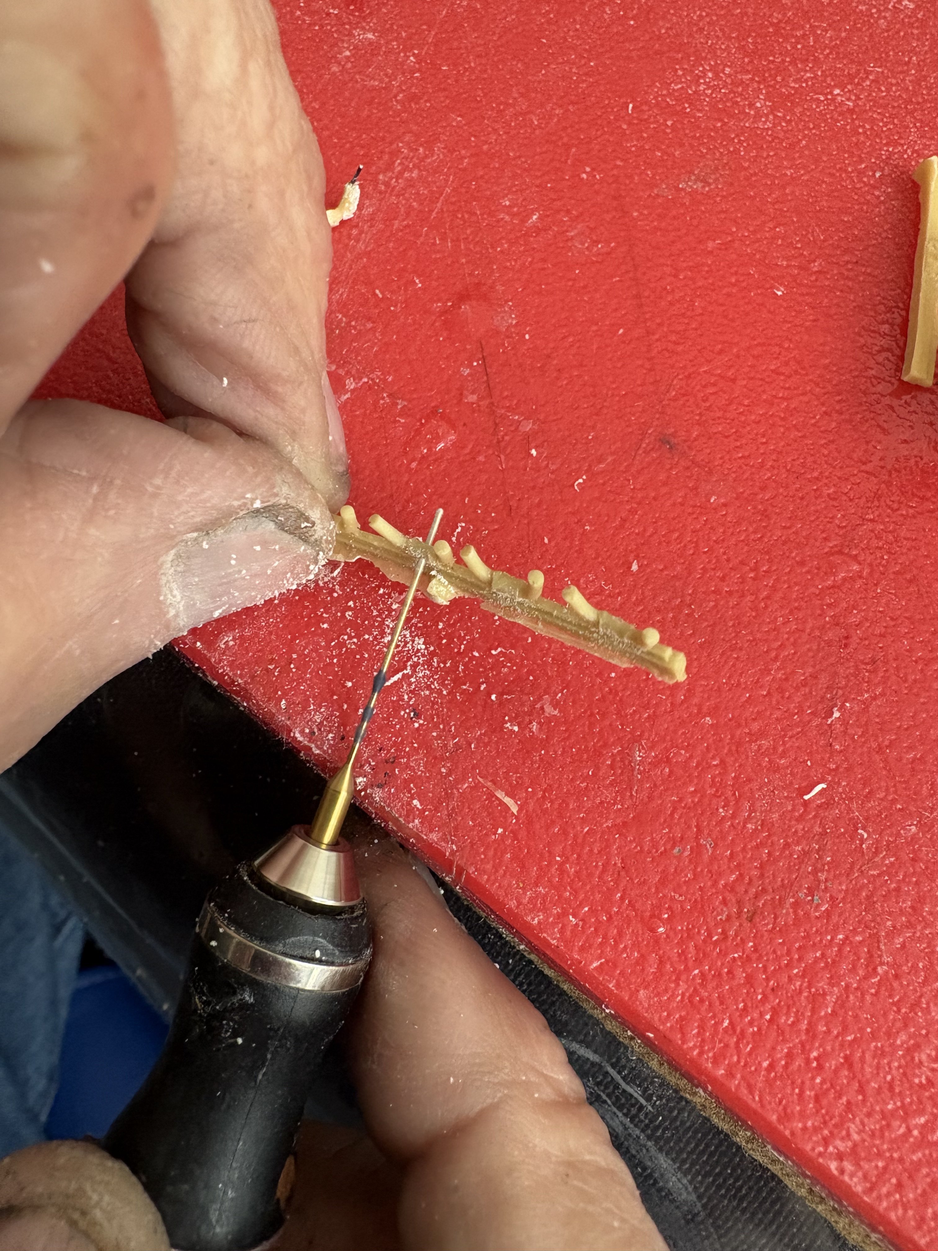

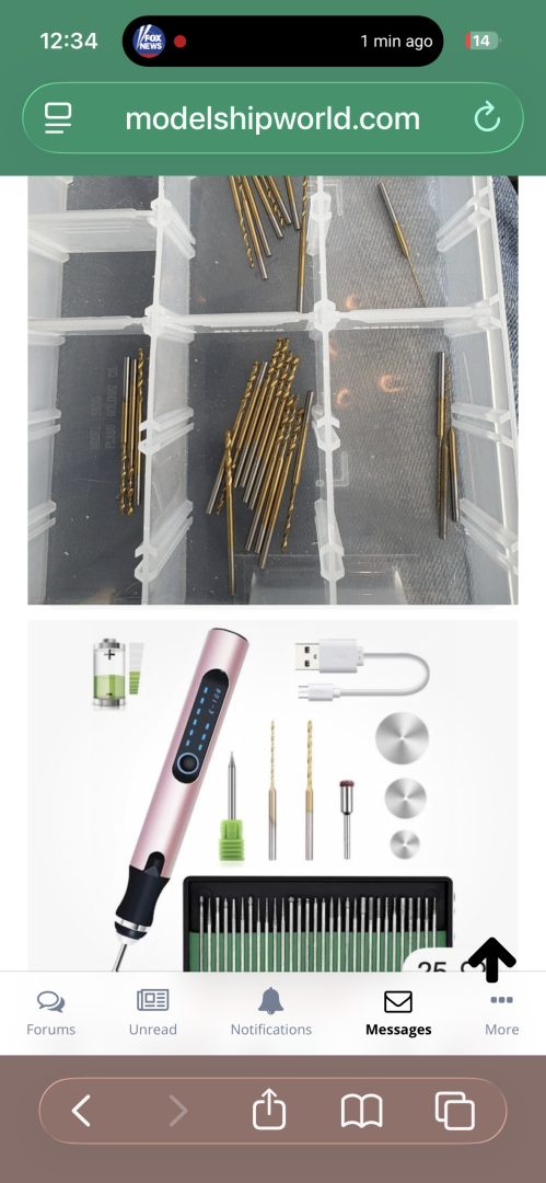

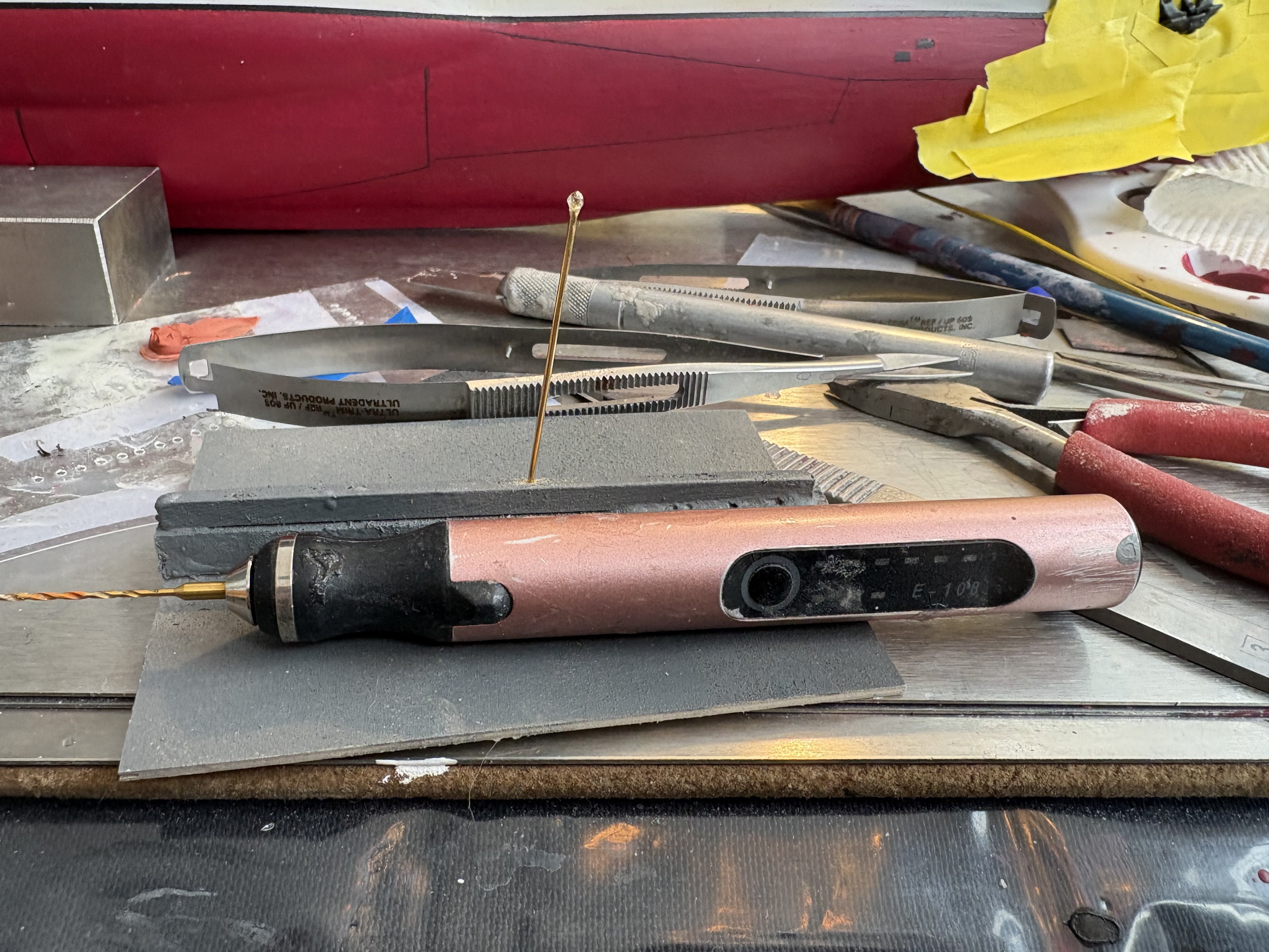

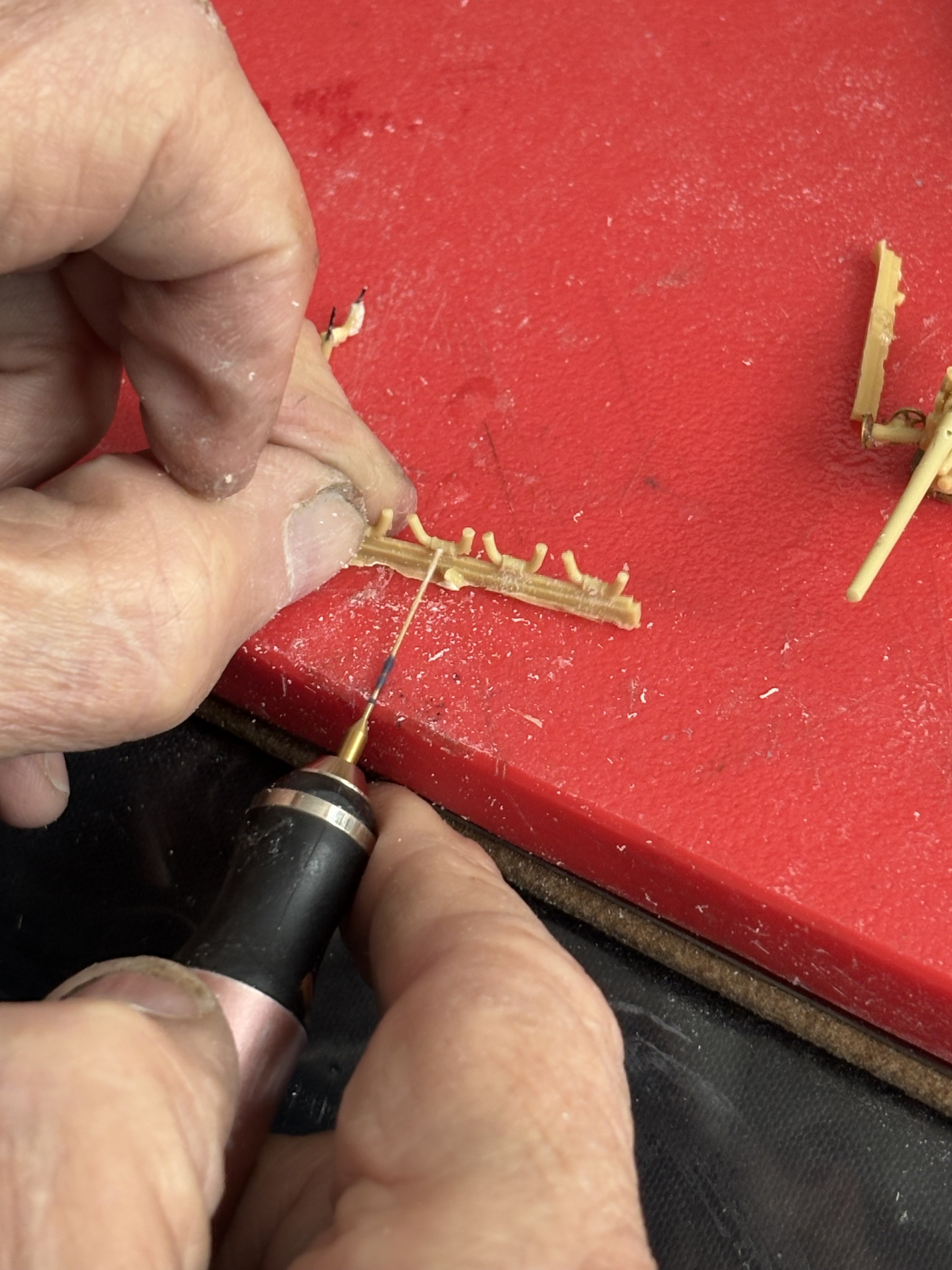

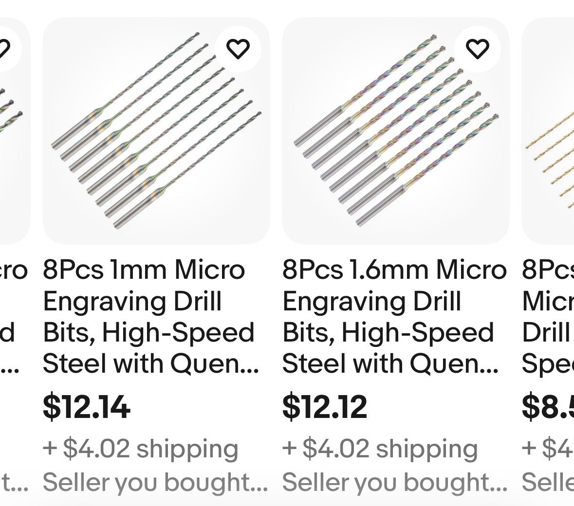

Ellie Another suggestion if you are going to continue with this hobby buy a micro handheld drill. I have had mine for 4+ years and use it every day atleast 8times or more. You can drill precise micro holes., grind and enlarge holes clean around cemented parts and any use can think of. It comes with about 18 diamond burs for engraving, drills a mandrel with 3 saw blades and a power cord for charging. You hold it like a pen and multiple size drills from.06 mm on up. They are readily availably on eBay cheap Just make sure they have a 2.35 mm shank because the chuck is friction fit. Now that I sang this micro drills praises sit down. It all can be yours on eBay for around $21. Admiral Rick

You will love it. Best hobby tool I own. When I said I use it multiple times every day how true for so many different things besides drilling. 4 years and it never failed means works as well as the day I got it. If you look on eBay or Amazon order some more drill bits that you think you will need, especially the smallest diameter ones. Make sure they have a 2.35mm shank. Being a Dentist I have done a lot of drilling in my life and enjoy this drill more than my high speed handpiece. When you get it and use it let me know what you think. Best Rick
