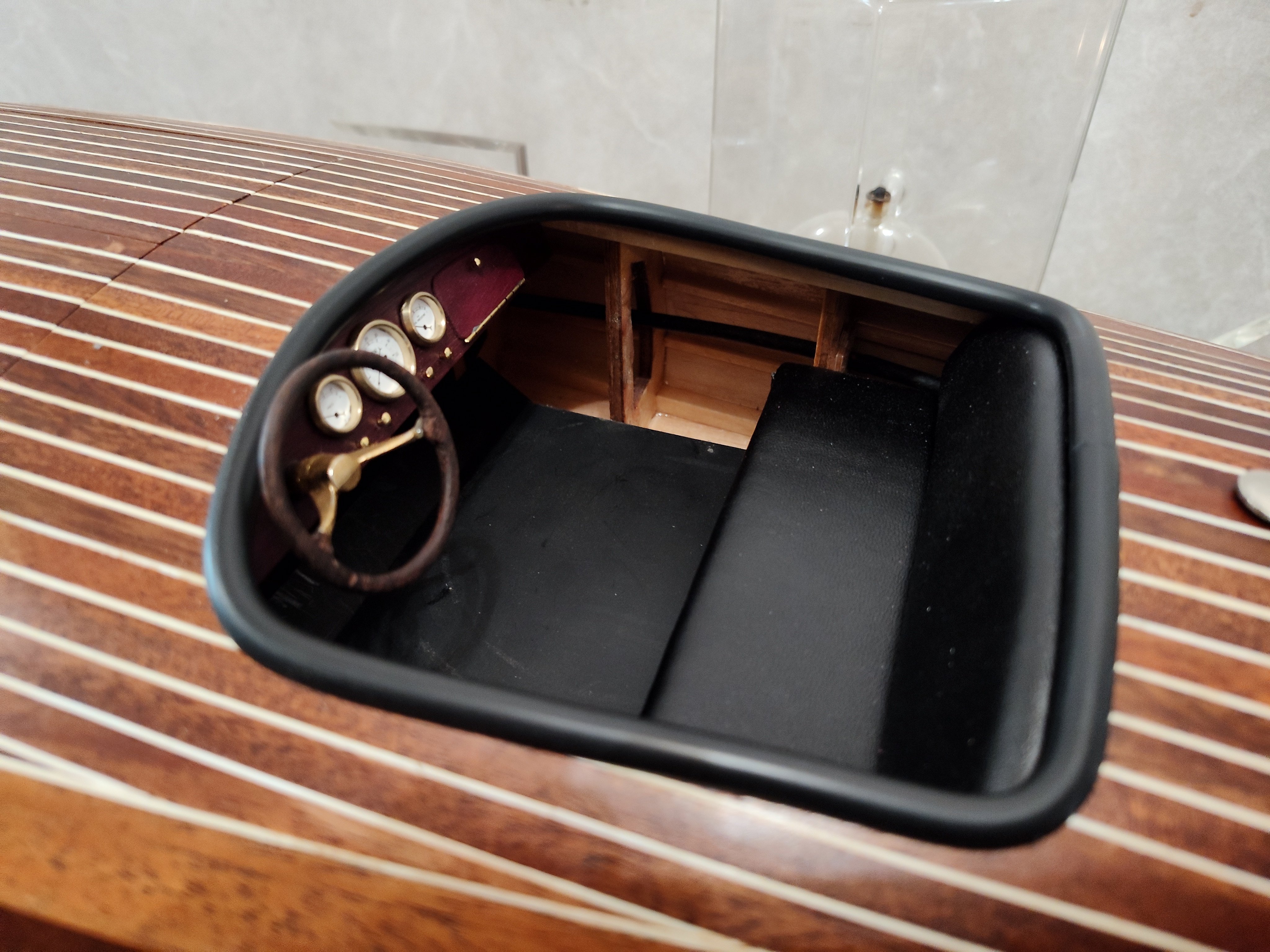

  1. Well, here is the finished model. I may add more pictures when I build a new stand for it. It's kinda weird being finished. I keep thinking of what I have to do next. I hope you all like it.

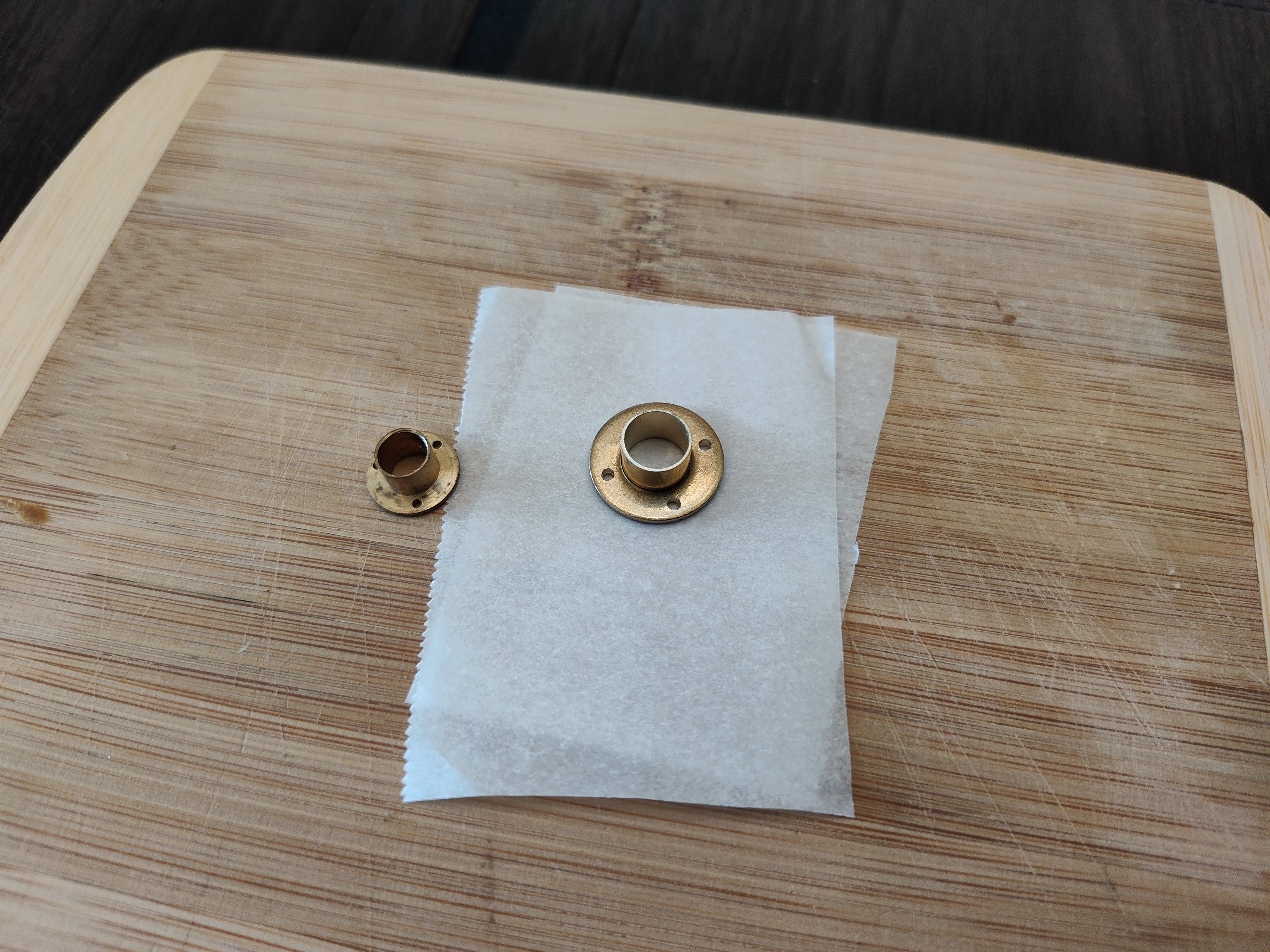

  2. Deck hardware and exhaust going in. Once again, the exhaust included with the kit was just too small so I fabricated a better one using a brass washer and a bit of brass tubing. The intake ports needed very little fitting so those went on quickly. The boat is just about finished so this is probably my last post before the big reveal and glam shots. Stay tuned...

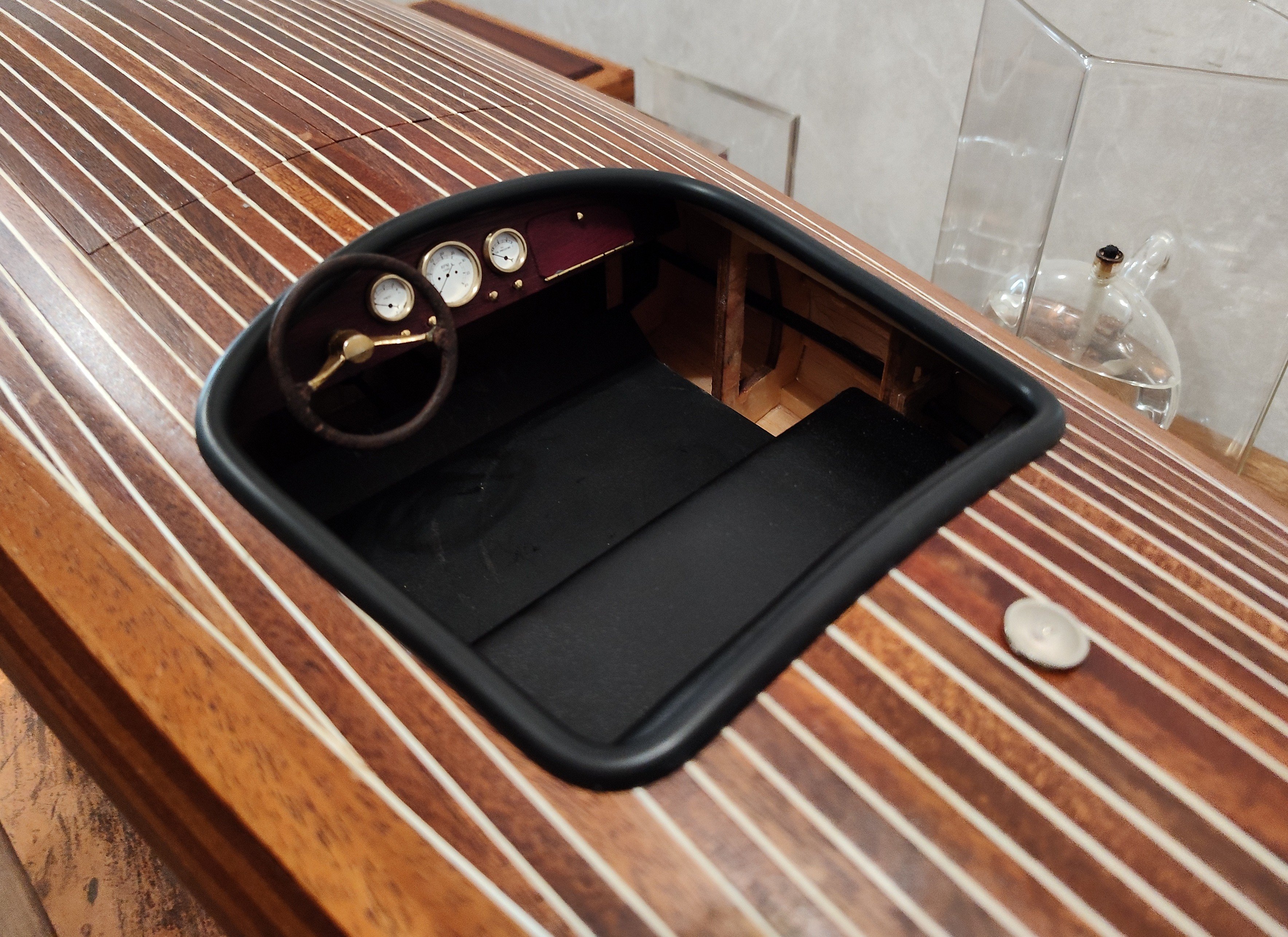

  3. The cockpit is pretty much done. I still want to re-do the seat back. I would like it to have verticle pleats. I need to figure out he best way to do that.
  4. I remembered I had some Rub n Buff gold leaf so I tried it out on the steering wheel yoke. It's not perfect but it isn't triggering me anymore.

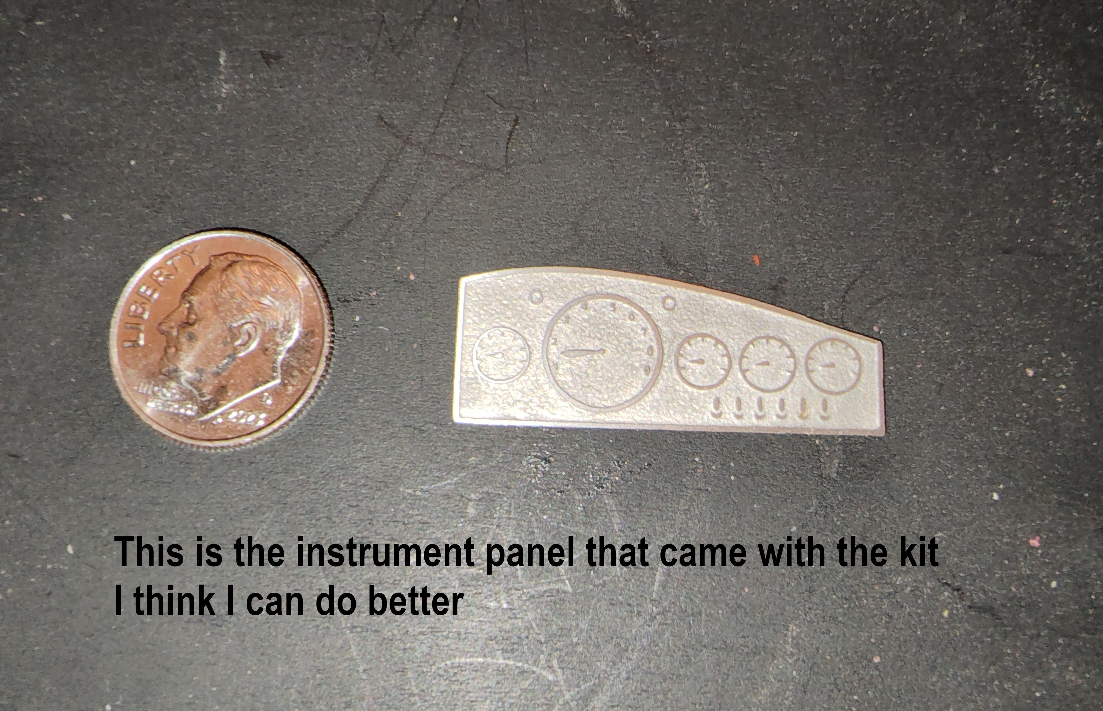

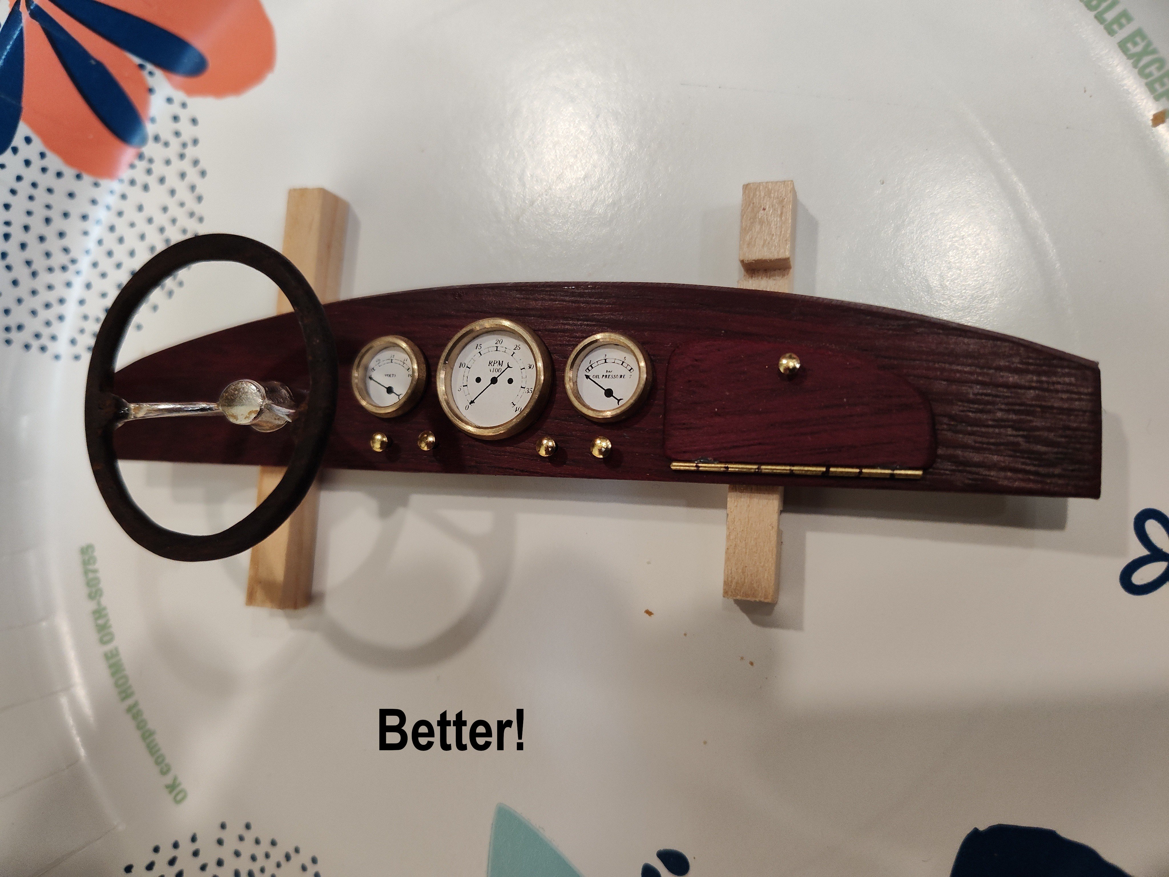

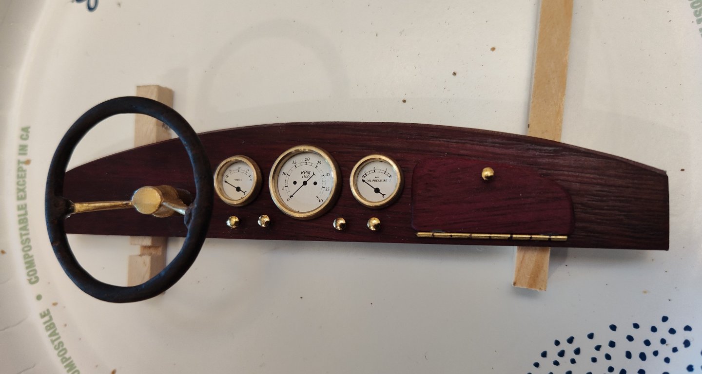

  5. Moving on to the Dashboard I decided to go with my own dashboard design. The included photo-etched instrument panel was just too small and unusable. The only thing I kept from the kit was the steering wheel yoke, and even it bothers me since it is chrome and not brass. Oh well.
  6. A word about scale This kit has an identity crisis. It doesn't know what scale it is. The web page for the model says it is 1/16 but the box says 1/6. I know for a fact that the boat the kit is based on is small, so I am going with 1/6th scale. A lot of the hardware in the kit is unusable since it is not to scale. The instrument panel is a joke. The cockpit coaming, exhaust, and rear cleat are also too small to use. I will be replacing all of these parts with something more suitable. The hero of this kit is the mahogany planking. That's where most of the money you spend on the kit goes. I want the hardware to match the quality of the boat itself. Cockpit coaming I used a larger coaming than what came in the kit. I used super glue gel since it would have been too difficult getting epoxy in that little groove in the coaming. I was wondering if I wanted to do partial coaming or do the whole thing. I went with the whole thing. I'm happy with how it turned out.

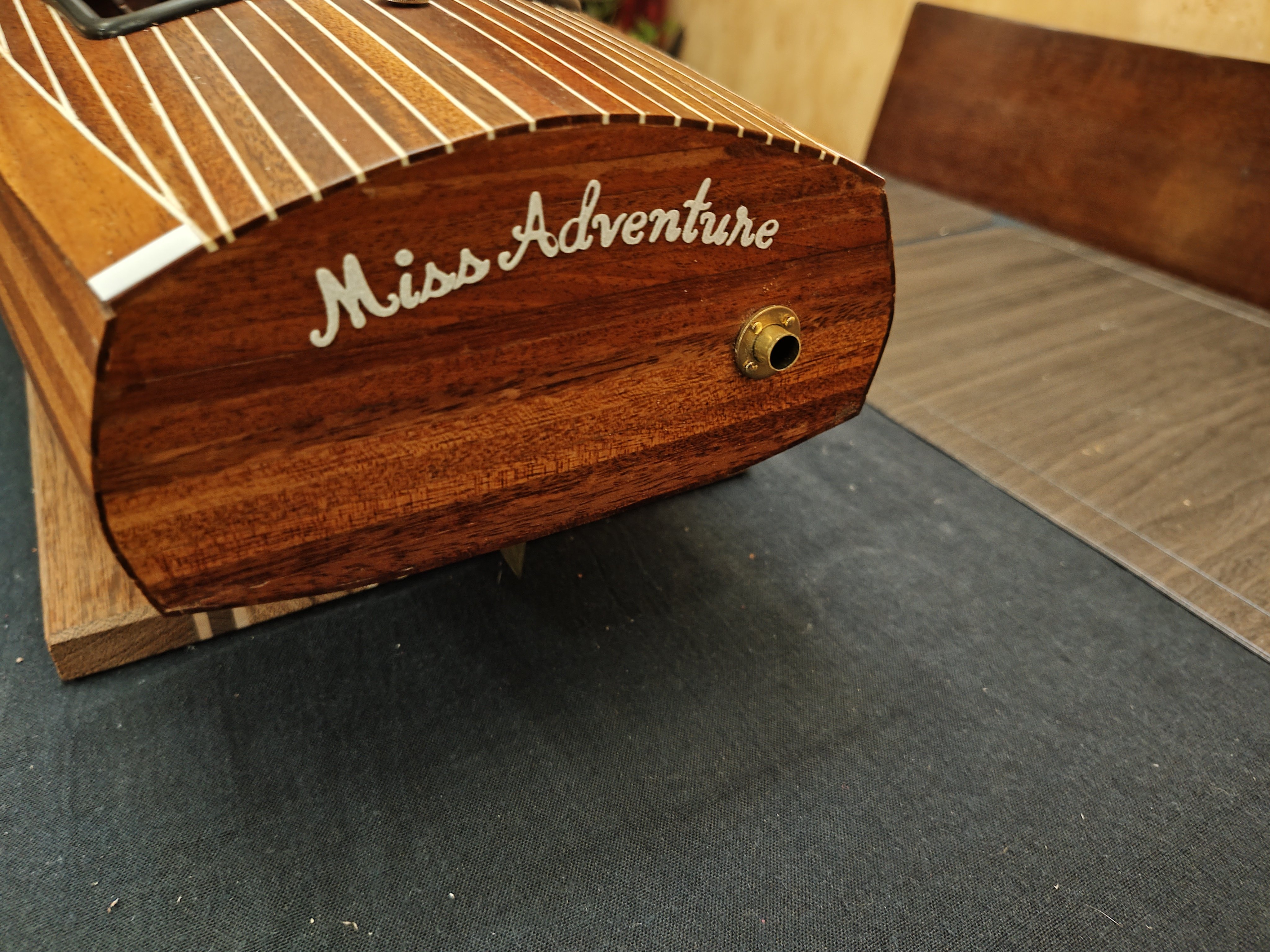

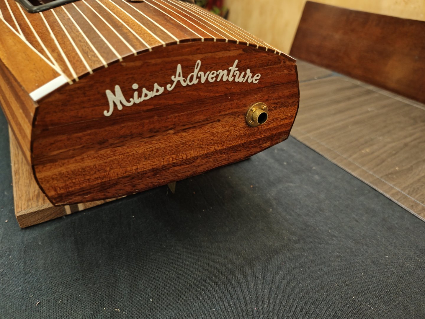

  8. I finally got the last coat of Urethane on the hull. I found some vinyl lettering on sale at Hobby Lobby and was thinking maybe... It actually turned out better than I thought.

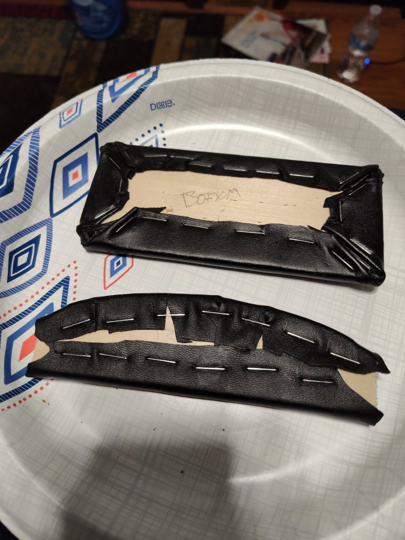

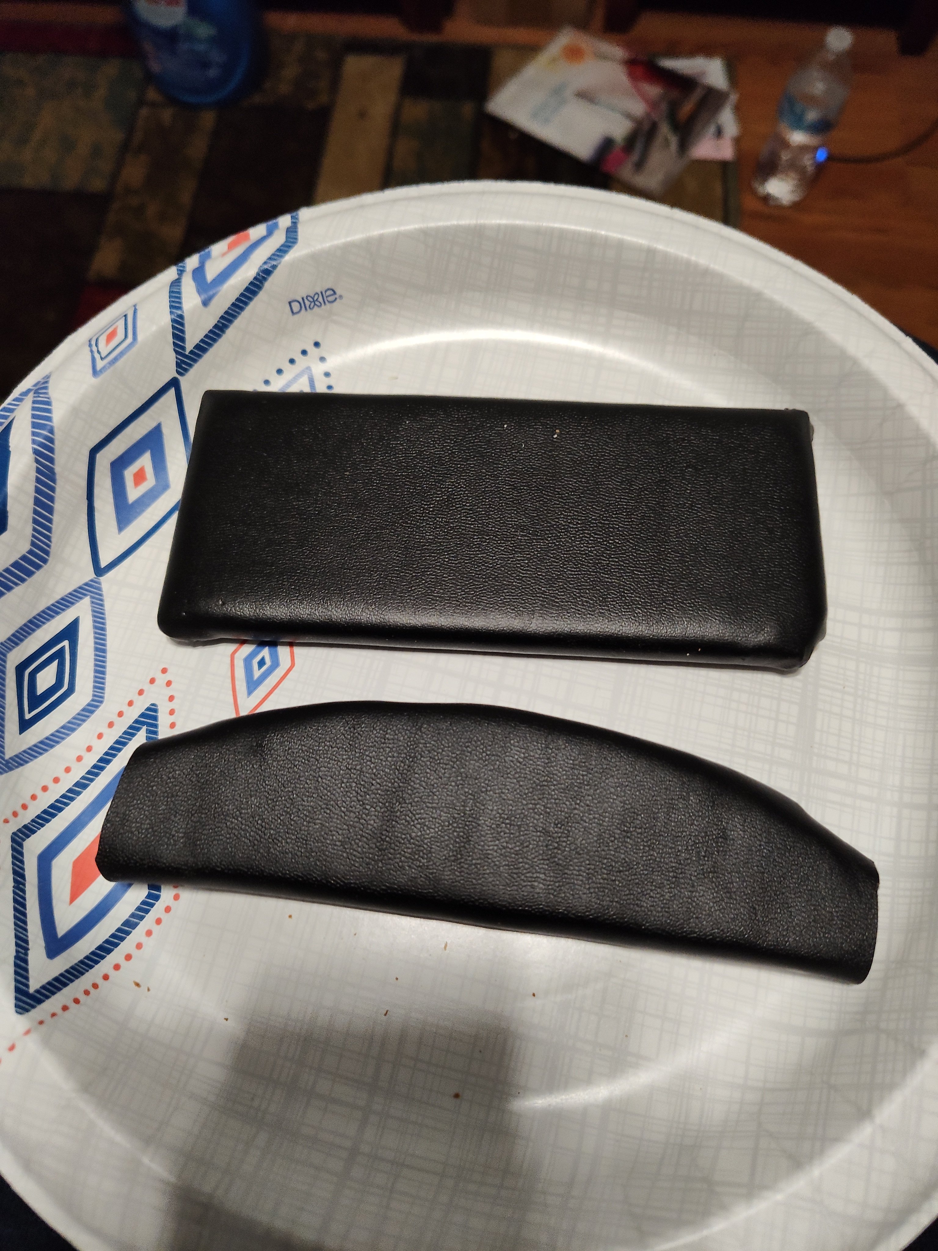

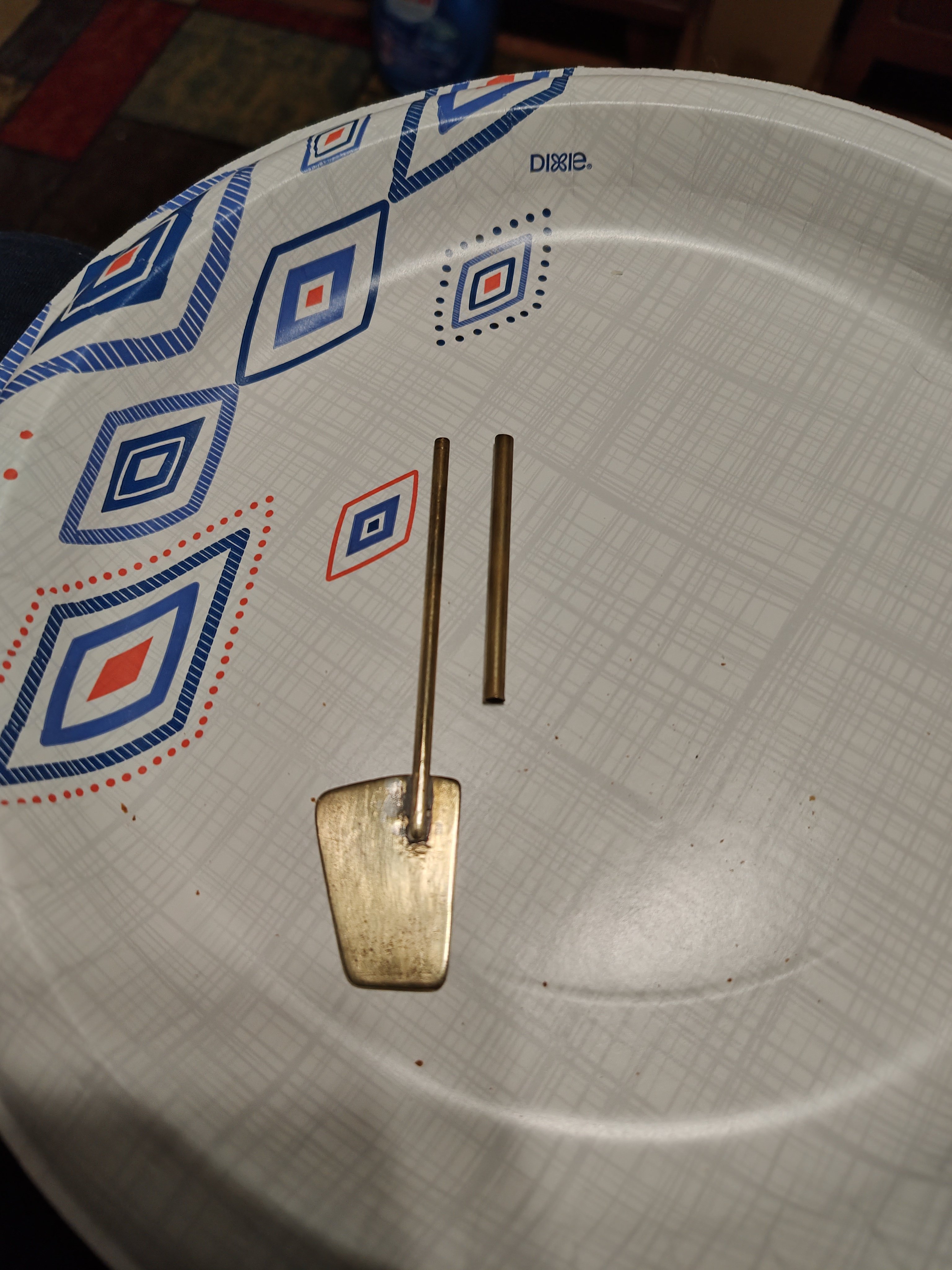

  9. I started to get to work on some other stuff.. I didn't like how the kit used thick plywood for the rudder so I got some scrap brass, cut it to shape, then braised it to the rod. I still need to clean it up more. I used pleather scraps and thin shipping foam to upholster the seats. I used a regular stapler to secure the edges. It's not great but I can redo it later. For expediency sake, this is fine.

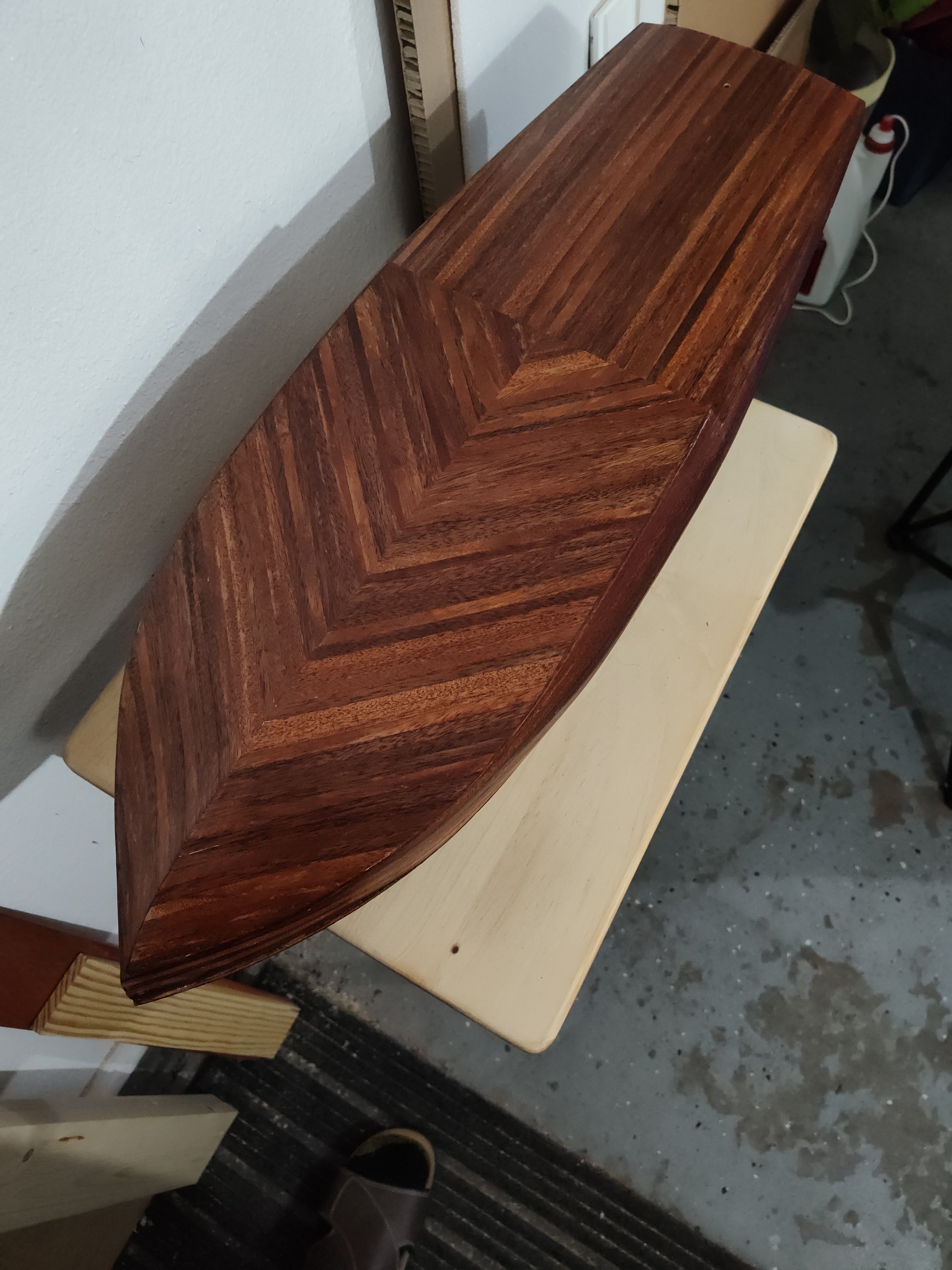

  11. 5-10-2025 Now we are getting more up-to-date. I decided on using Minwax Helmsman Spar Urethane in a satin finish. It has good moisture resistance and durability. I prefer satin finish since gloss is pretty unforgiving of any imperfections. I plan on two coats of brush on and a final coat of spray. Here is the deck after the first coat of Urethane. I hate that the margin planks were not long enough the reach the back of the boat. I had to add a piece of mahogany planking to finish it out and it looks kinda janky. I may put some kind of fitting or hardware there to mask it.
  12. And so it sat for three more years while life got in the way. I gave me a lot of time to think about how I want to finish the wood.
