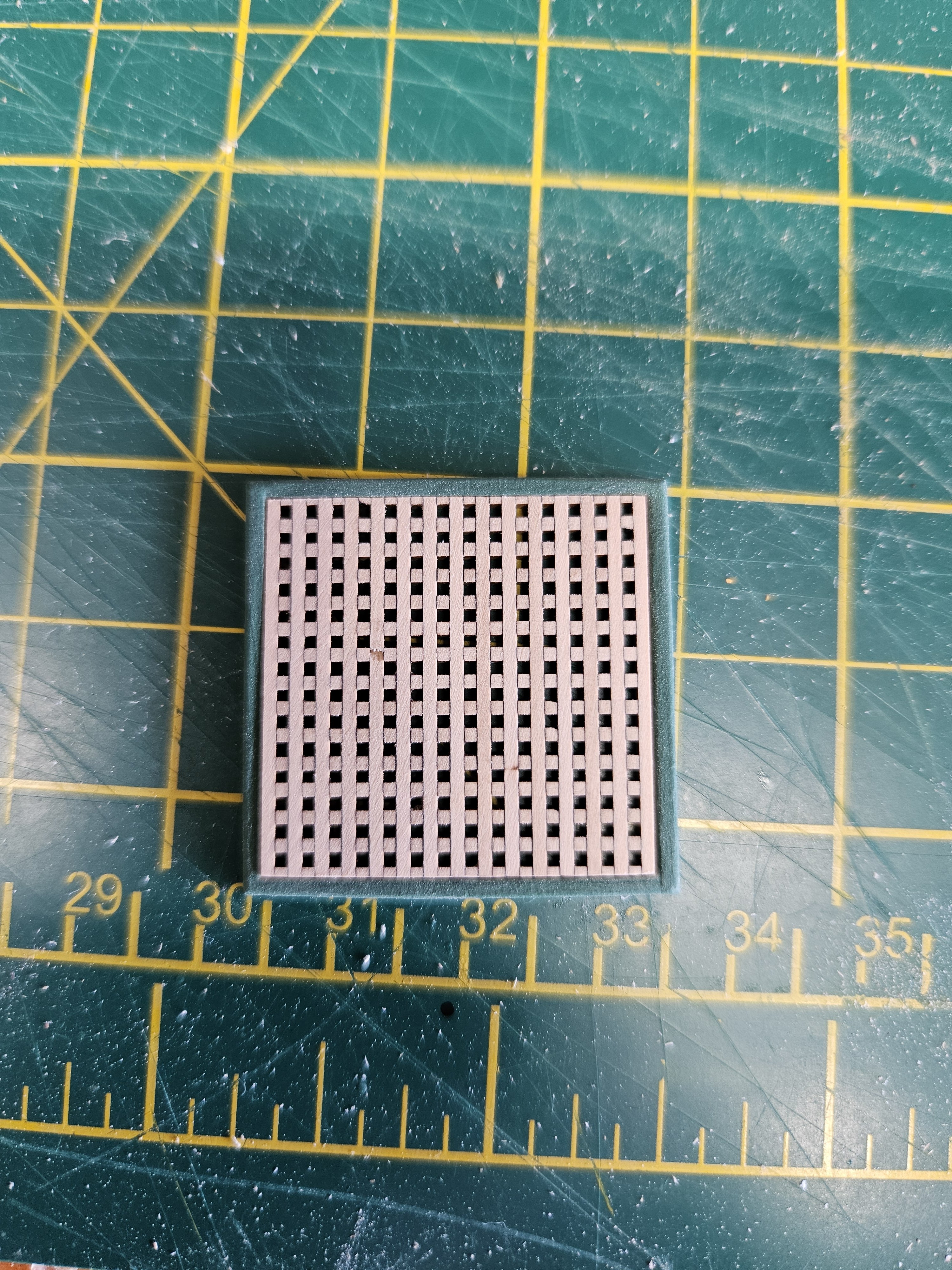

@Avi I found .03 thick gratings (1:72 scale) from drydockmodelsandparts.com.  That, on a 1:96 scale, comes to 3 inches, which is pretty dang close to accurate, and the "holes" are square.  They are made from boxwood so they can be sanded, stained and varnished to your liking.
Regards, Brian
Oh, now that is an interesting idea. I did a search on their page for "gratings", got this. I assume one of the first few?
Yes, the 1:72 gratings.  This is how mine came out.
