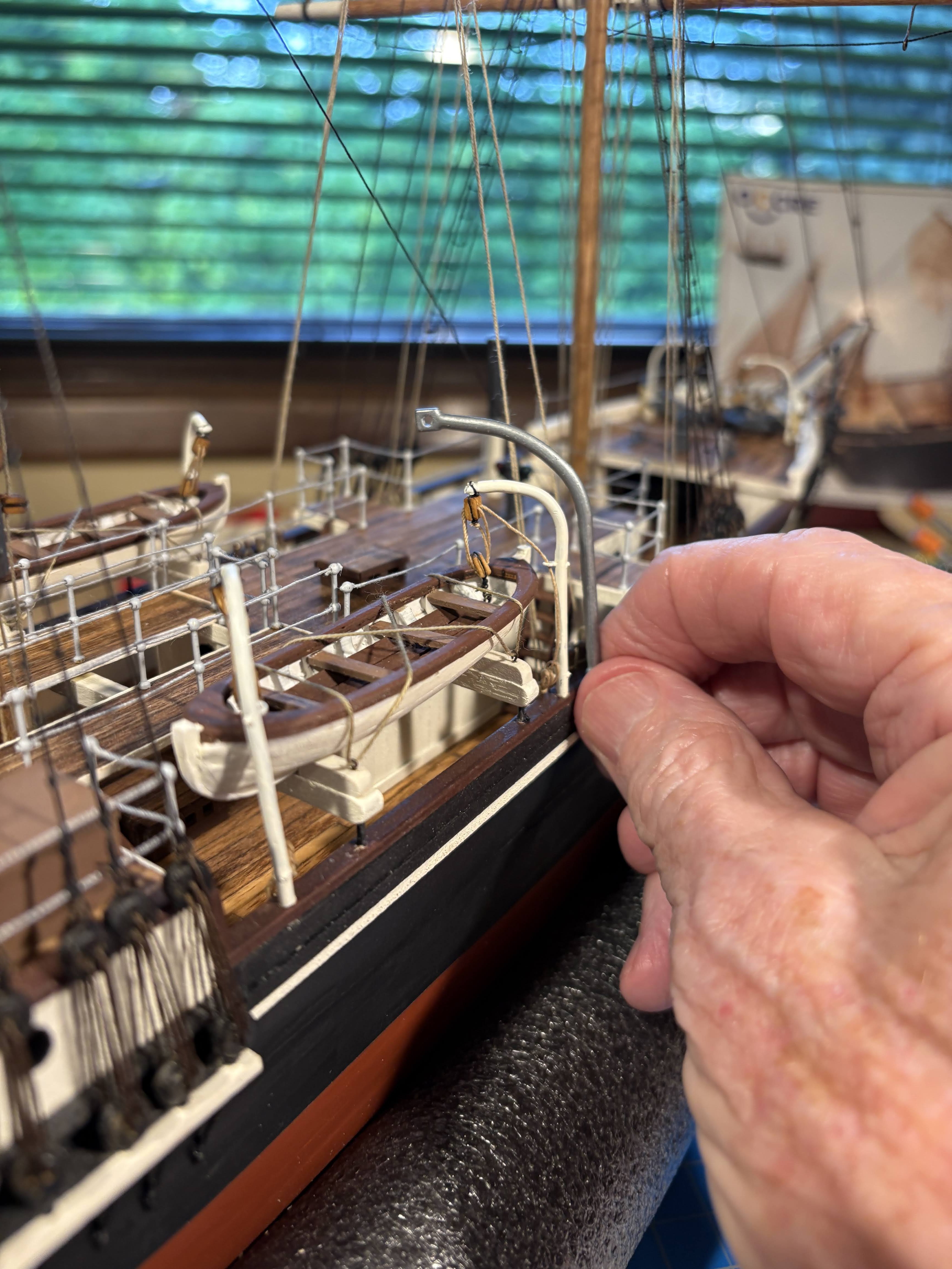

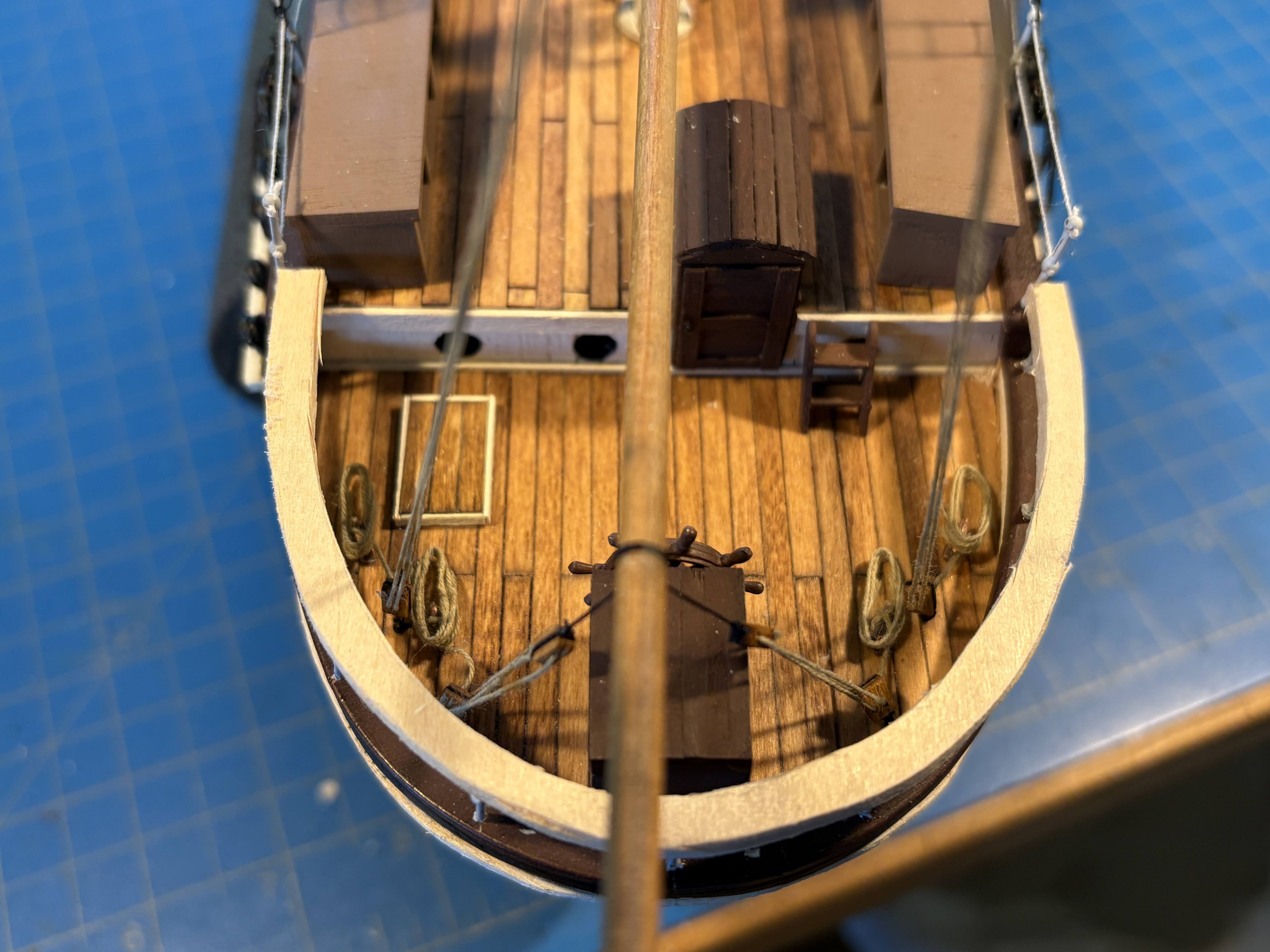

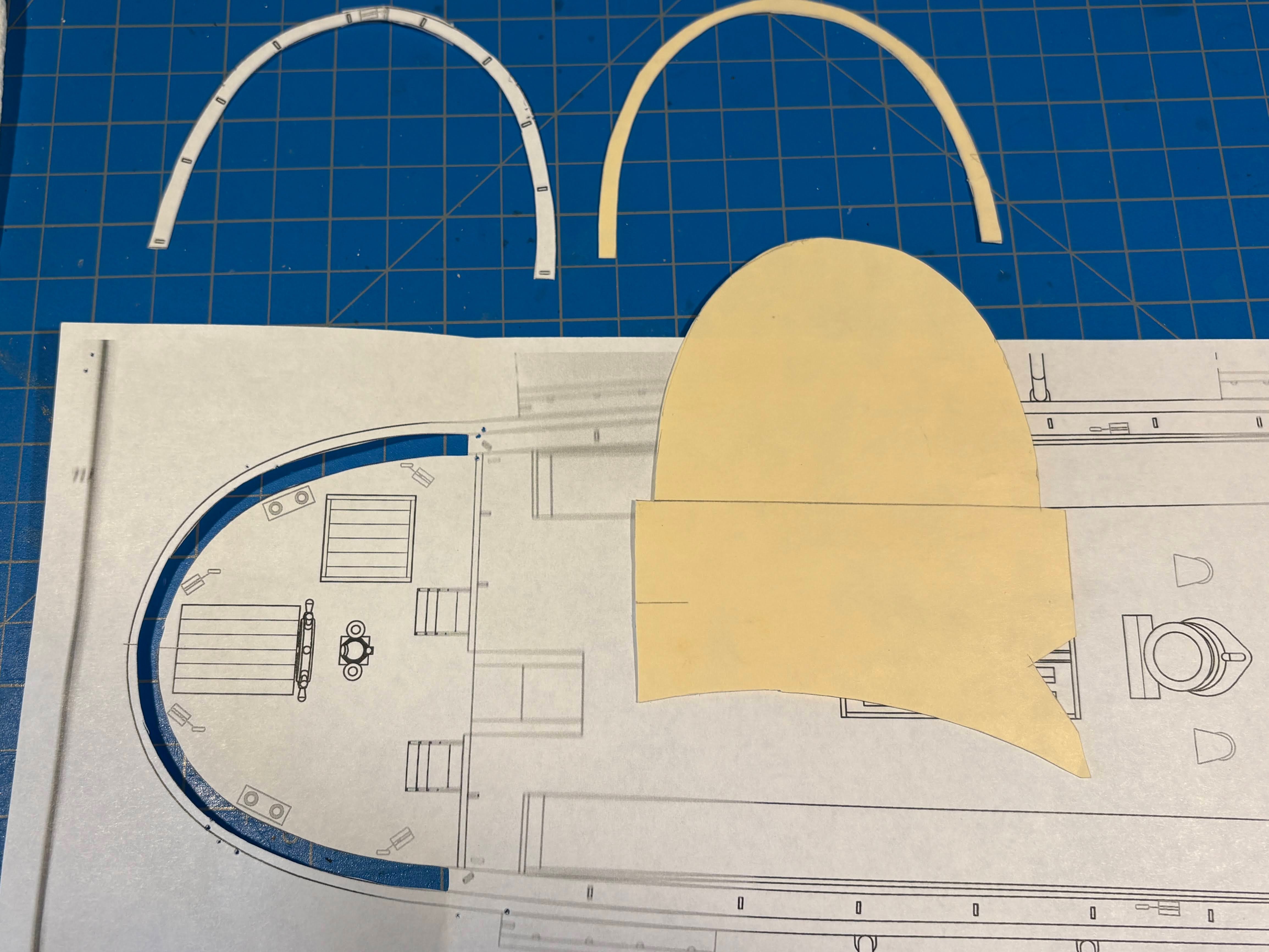

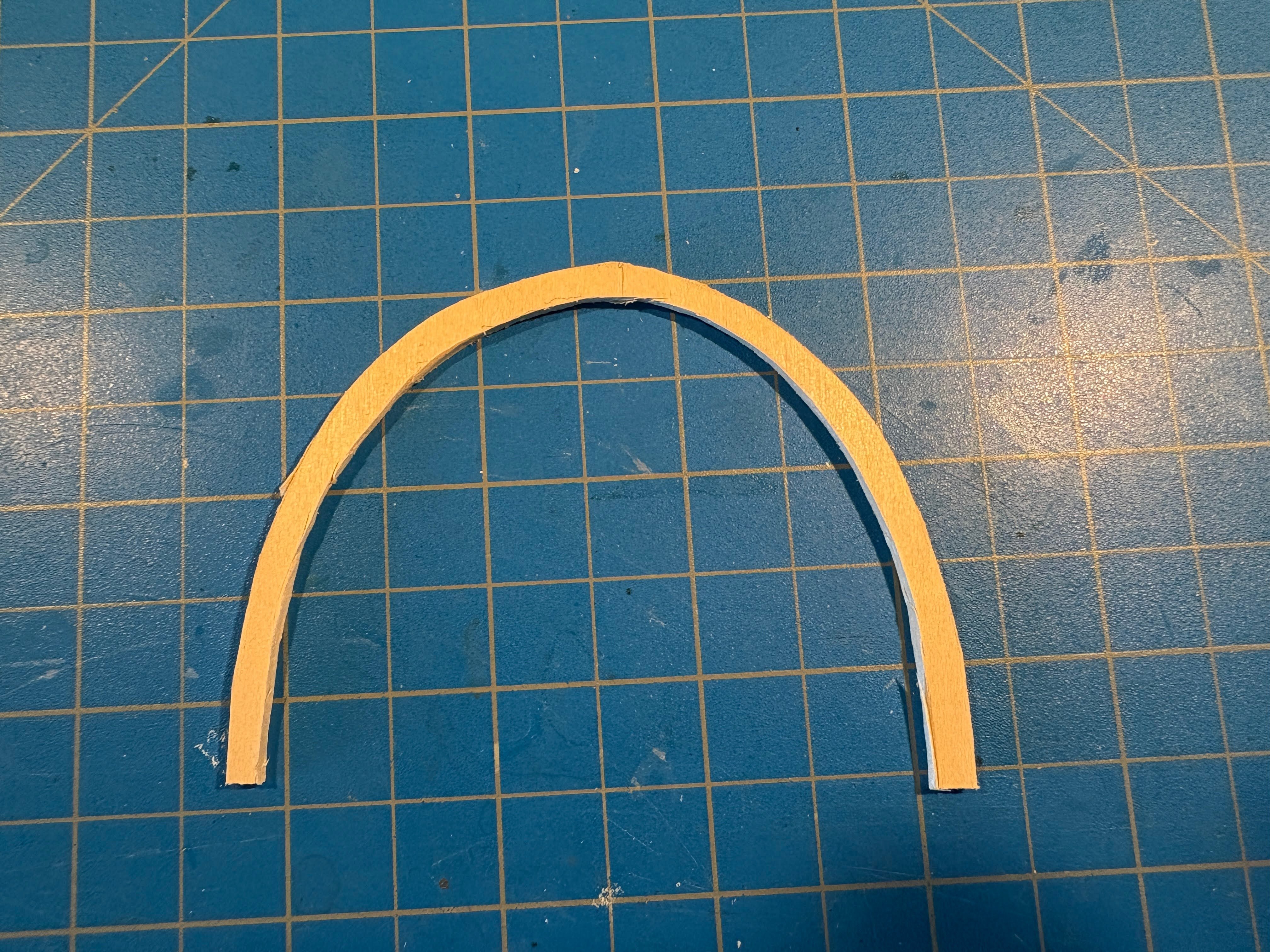

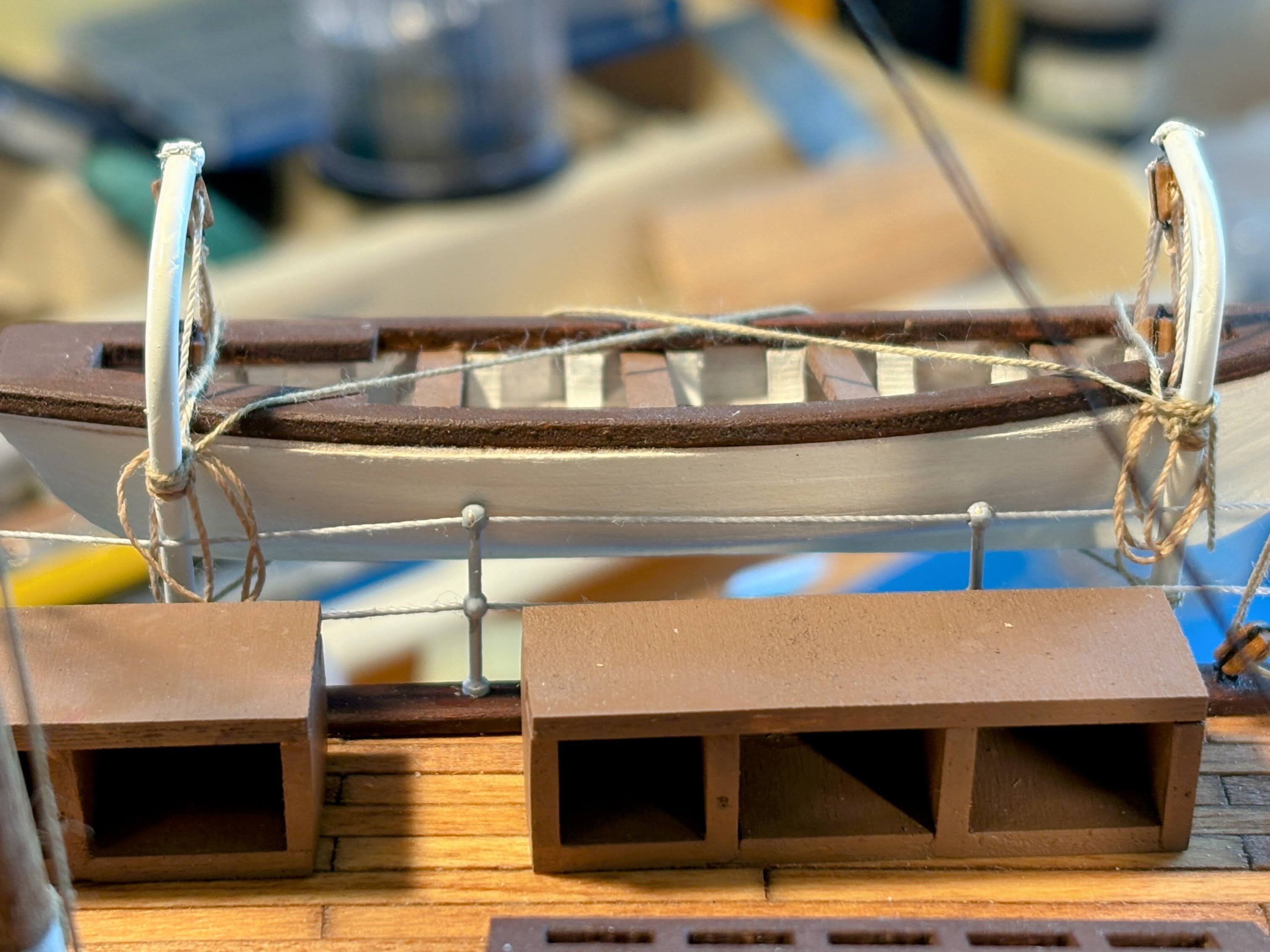

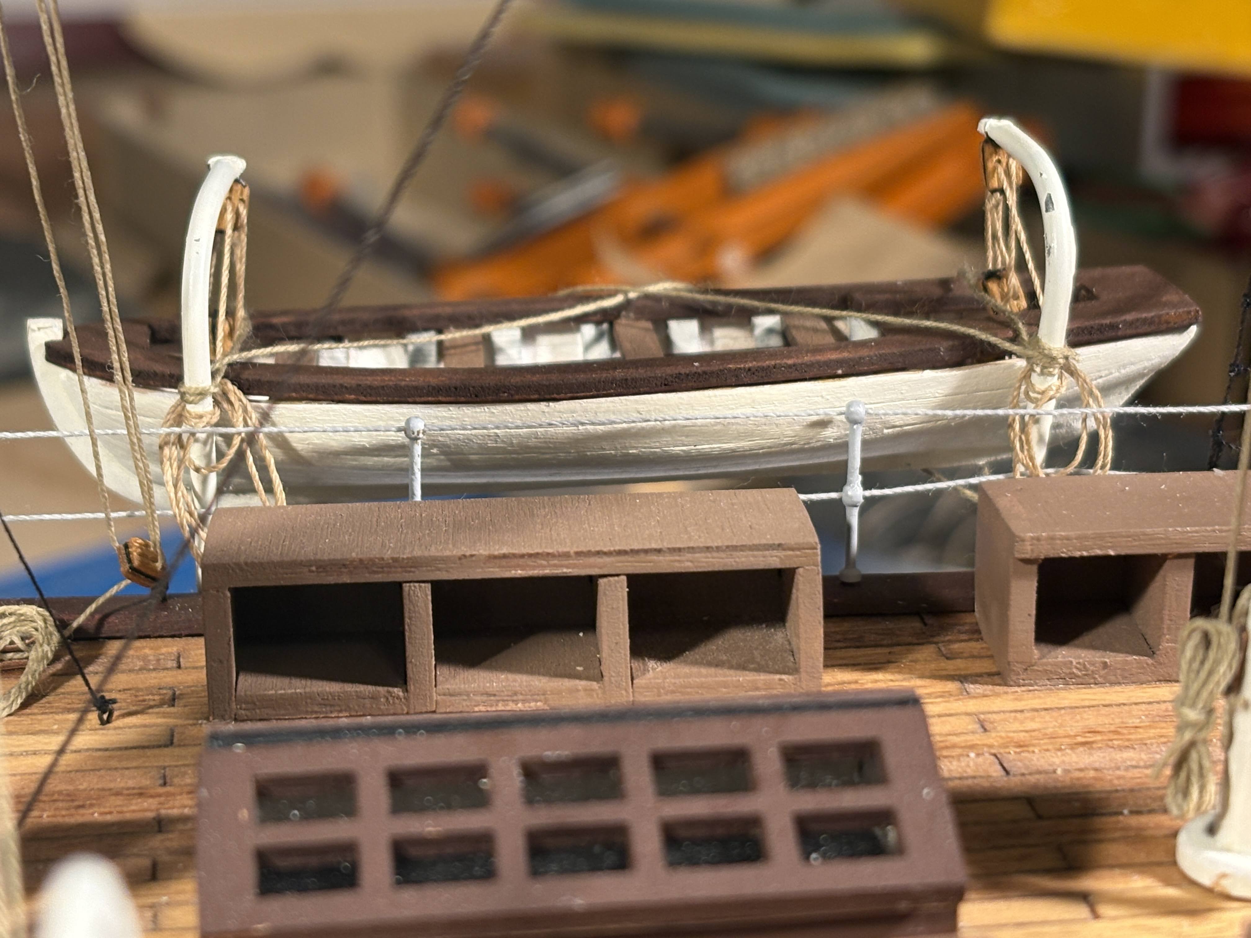

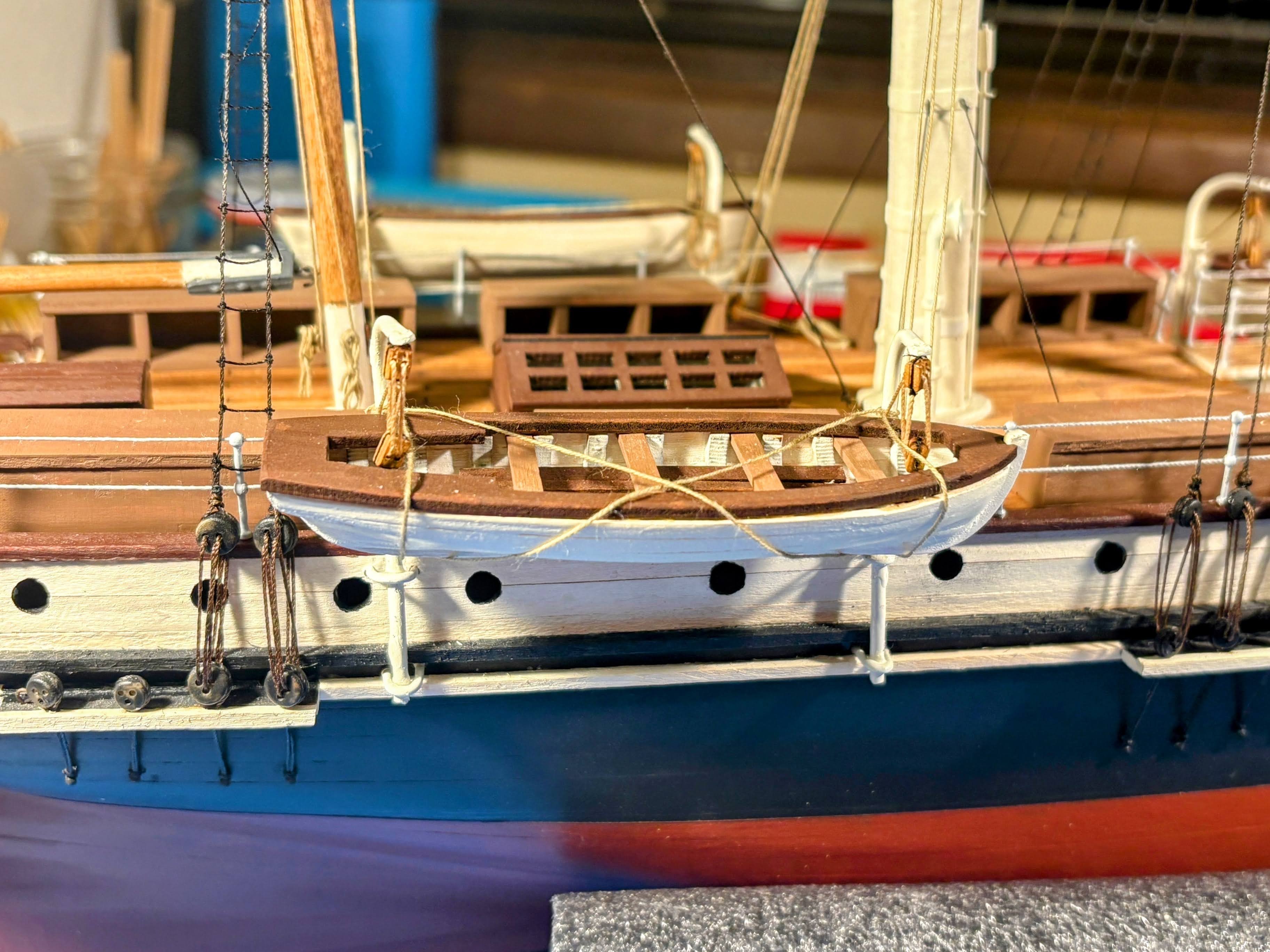

I ordered some 2mm diameter aluminum wire to make the davits (more on this in my next post, about the davits).  The bulwarks are made from 2mm thick plywood; an obvious problem.  I decided that the best solution to that problem was to glue a couple of 2mm (or perhaps 1/16”?) thick strips on the inside of each bulwark, just below the rail cap.  Much easier said than done in the narrow space available, especially for the forward strips. Fortunately the beam holding the aft end of the boats was only dry fit, and I was able to remove it, making a little more room available. After trying too many unsuccessful methods to talk about, what worked was applying a small piece of double sided scotch tape to a finger to which I stuck a strip, applying a bit of glue to the exposed side of the strip, and pressing it blindly into place.  For some reason I had a dentist’s mirror (plastic: probably a toy) where I store tools I never use, and I used that to view and make necessary adjustments. All of this so there would be enough wood available in which to drill holes for the davits.

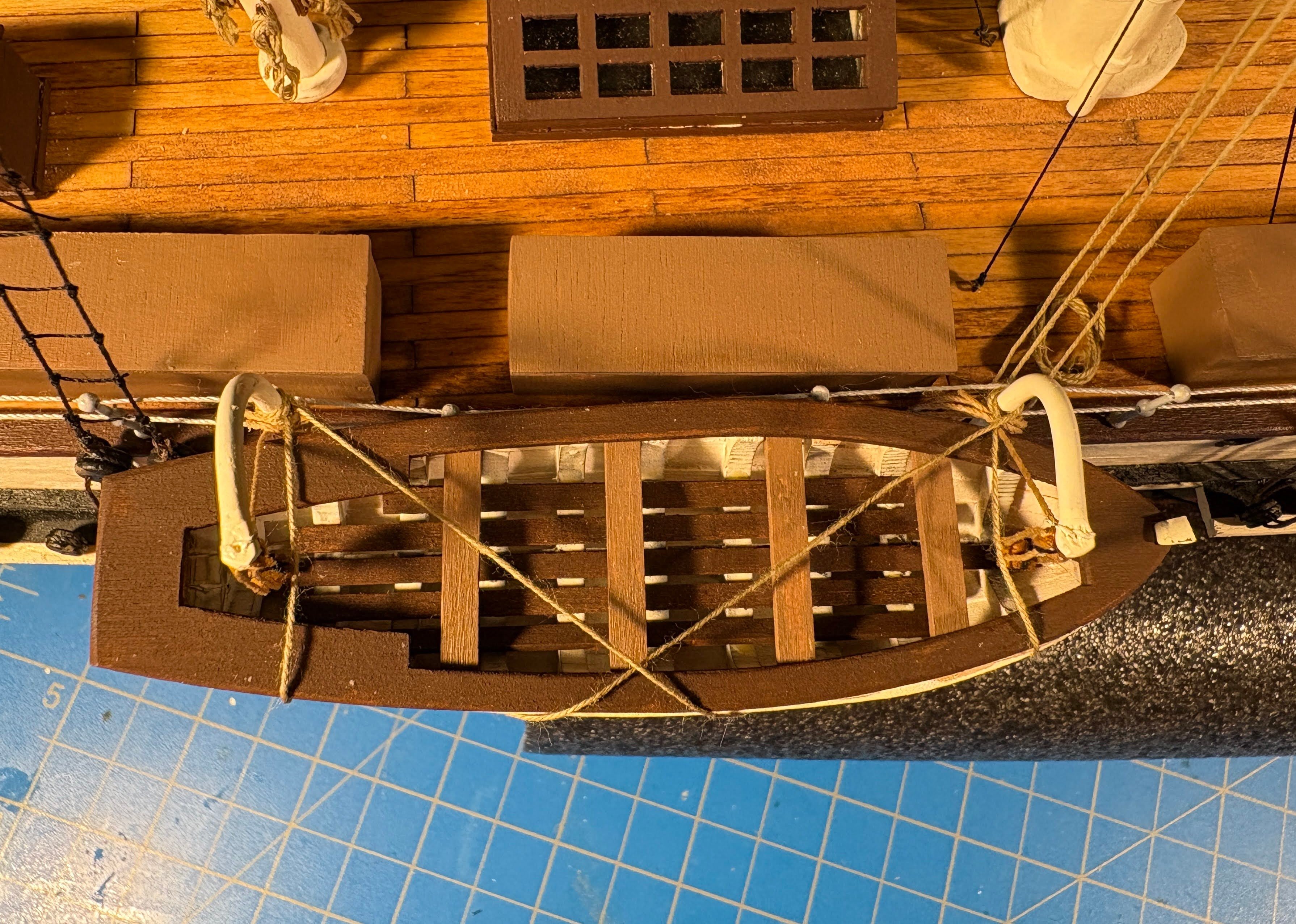

Before I could install the davits, I needed to glue the boats in place, and before that I needed to rig the lines which lash the boats in place, and before that I needed to glue the planks which run between the deck house and the deck behind it, and before I did any of that, I needed to glue the aforementioned beam in place. And of course I needed to fabricate the davits, but that will be the subject of my next post. My fingers are too big and clumsy to rig the boat lashings with the boats in place, so I did the rigging very loosely, leading the threads through the previously installed eyebolts in the appropriate order, then sliding the boats though the loose loops of thread and into place after carefully placing a dab of glue where each boat’s keel will rest atop the beams.  After the glue dried, I tightened the thread and somehow tied off the end of each thread with a half hitch. Both ends of the thread were knotted to the same eyebolt, on the inside rather than the outboard side of the boat, so as to hide the unsightly knots.

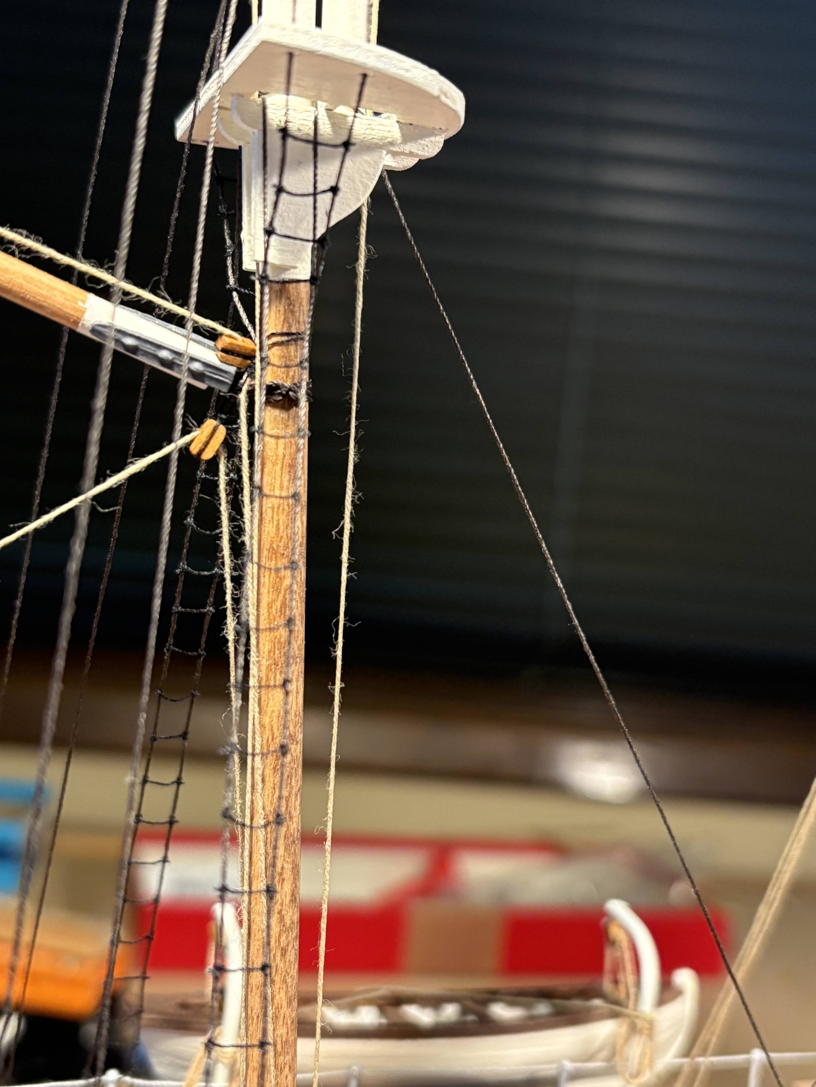

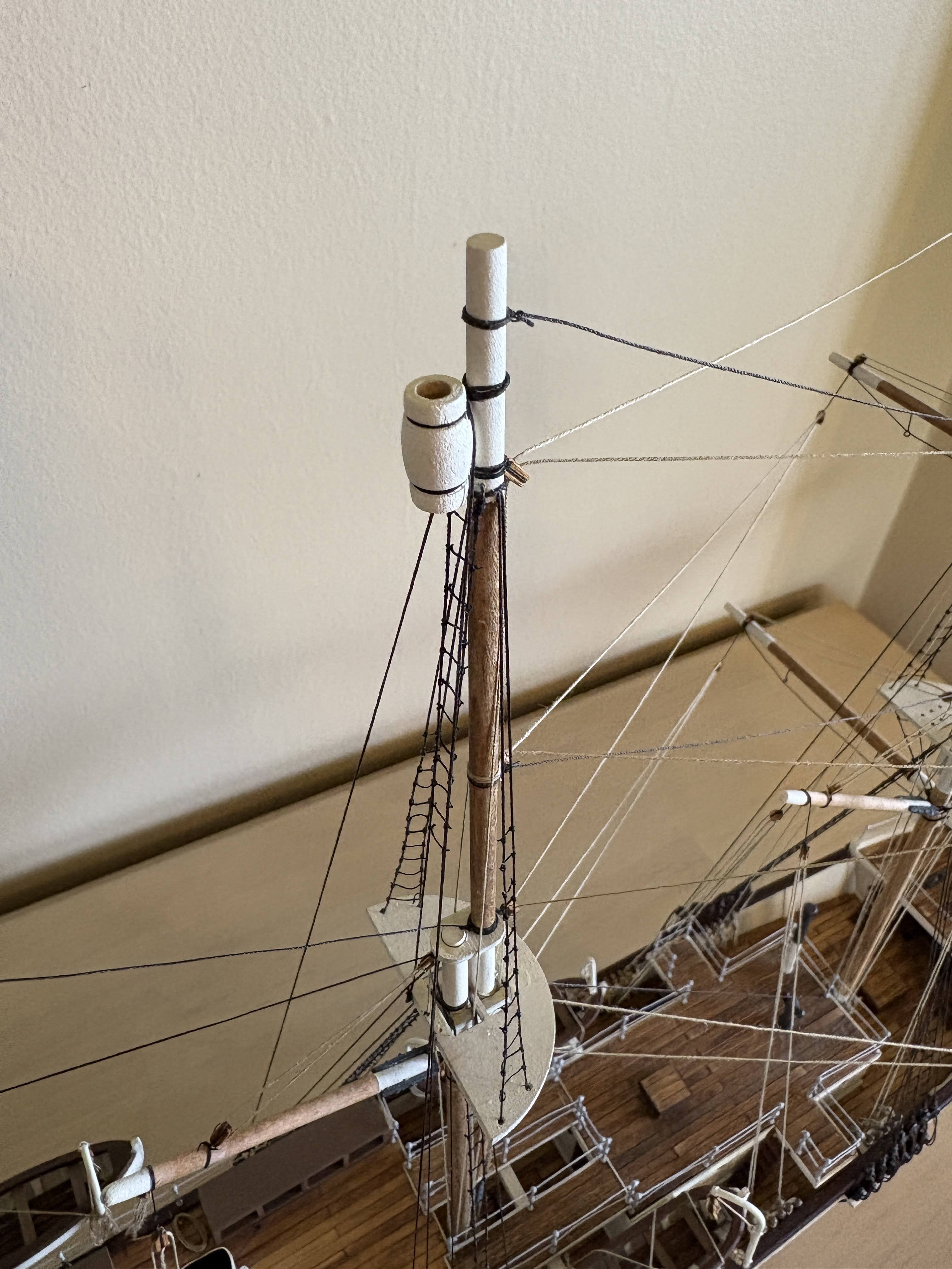

I also found some time to rig a few ratlines.

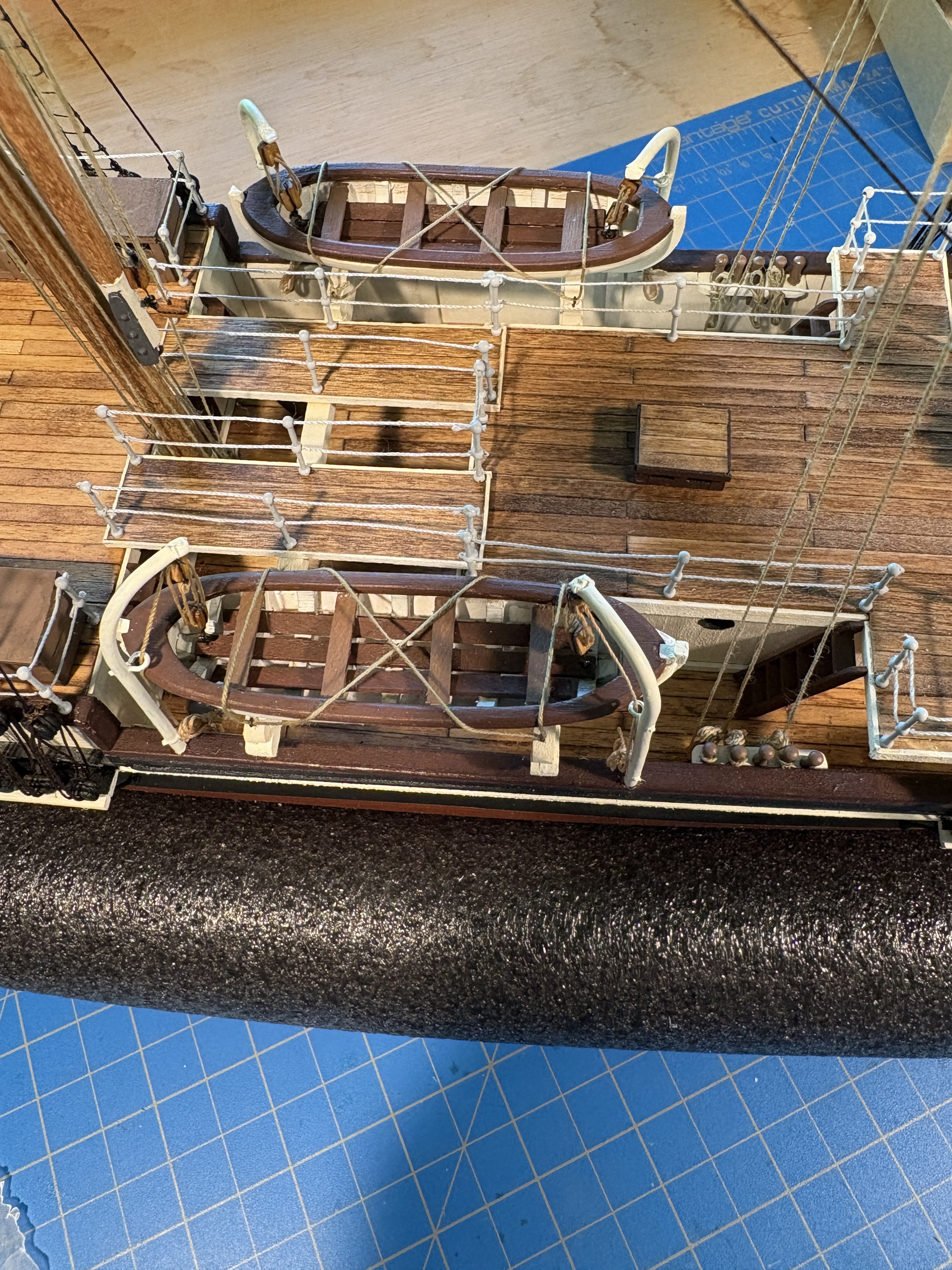

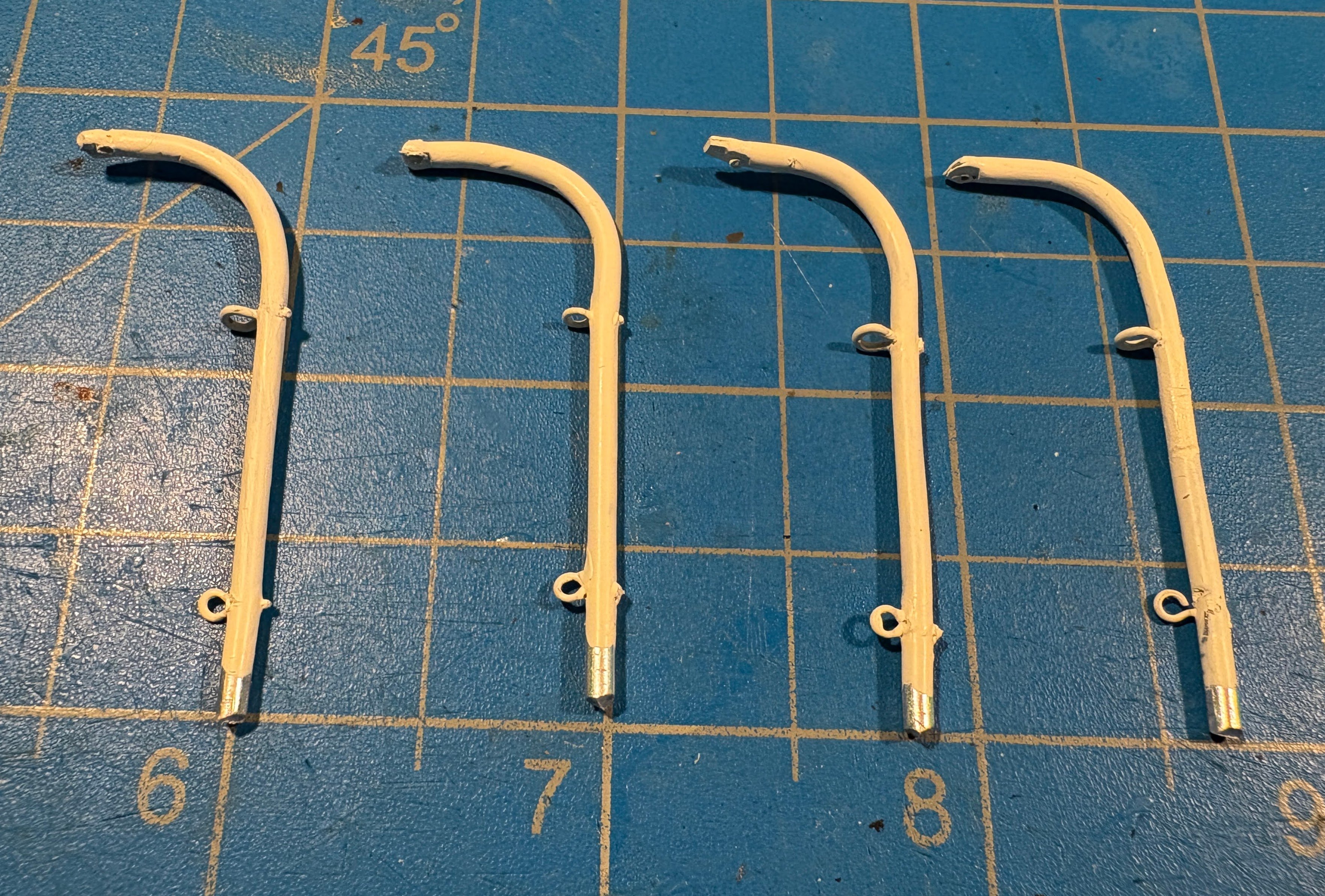

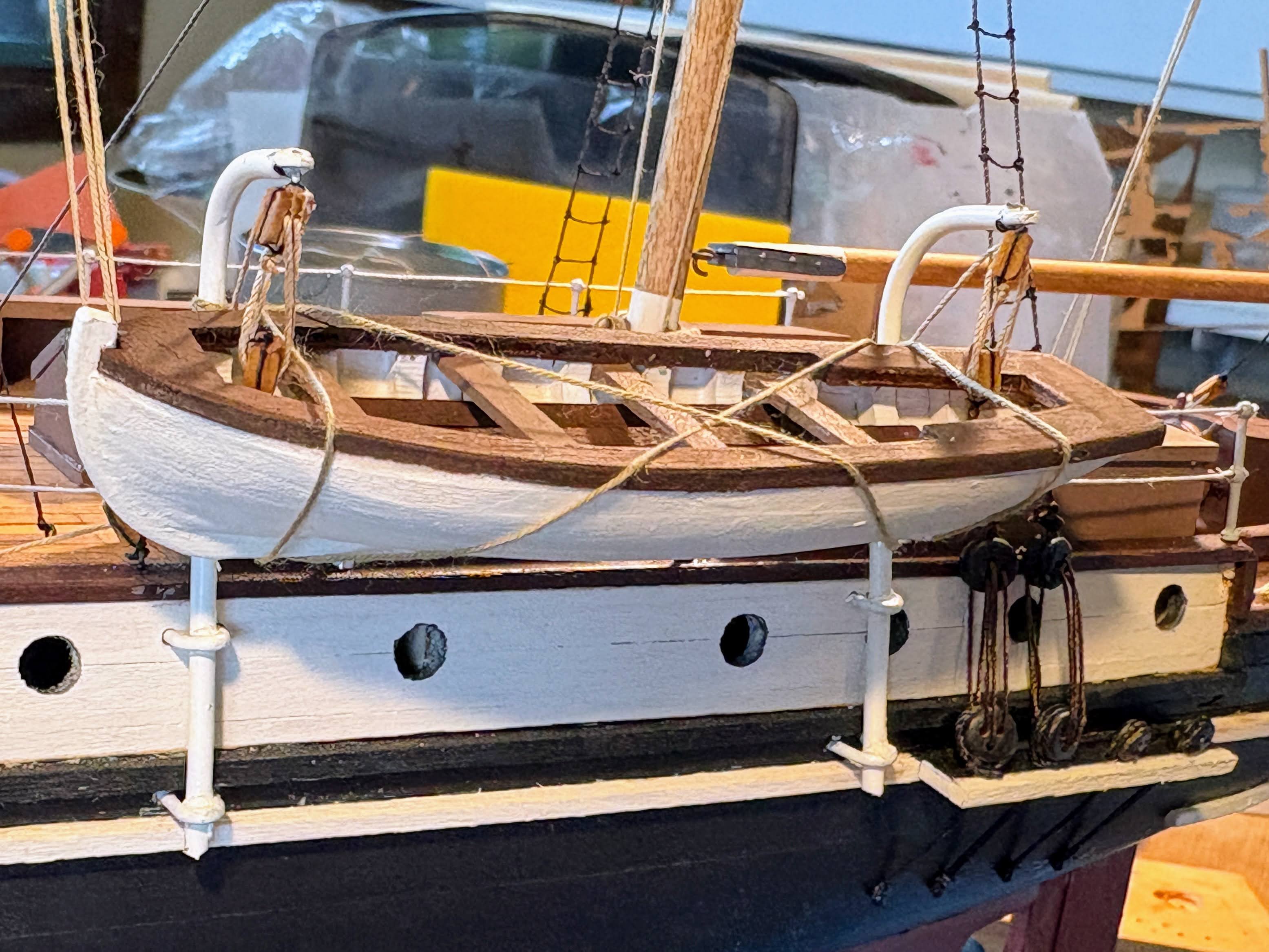

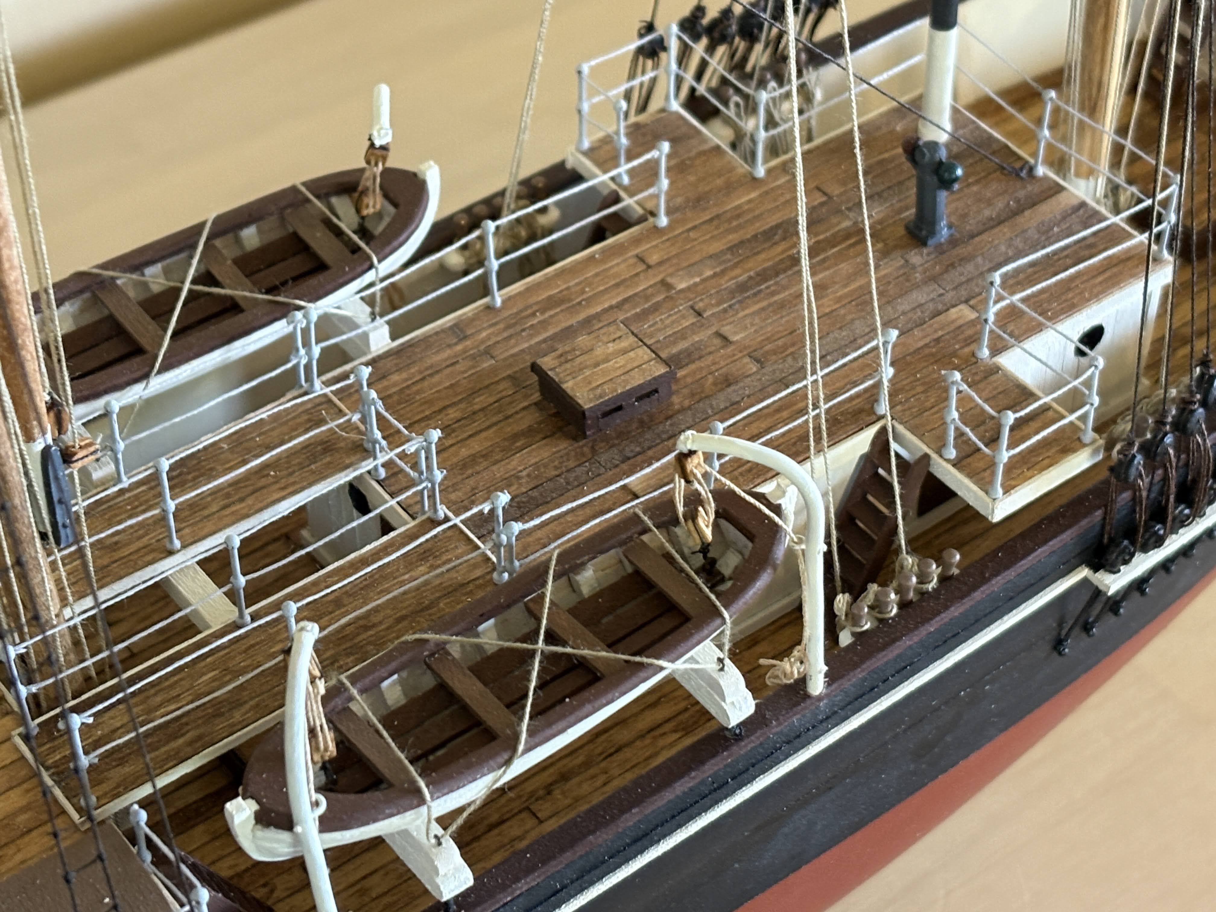

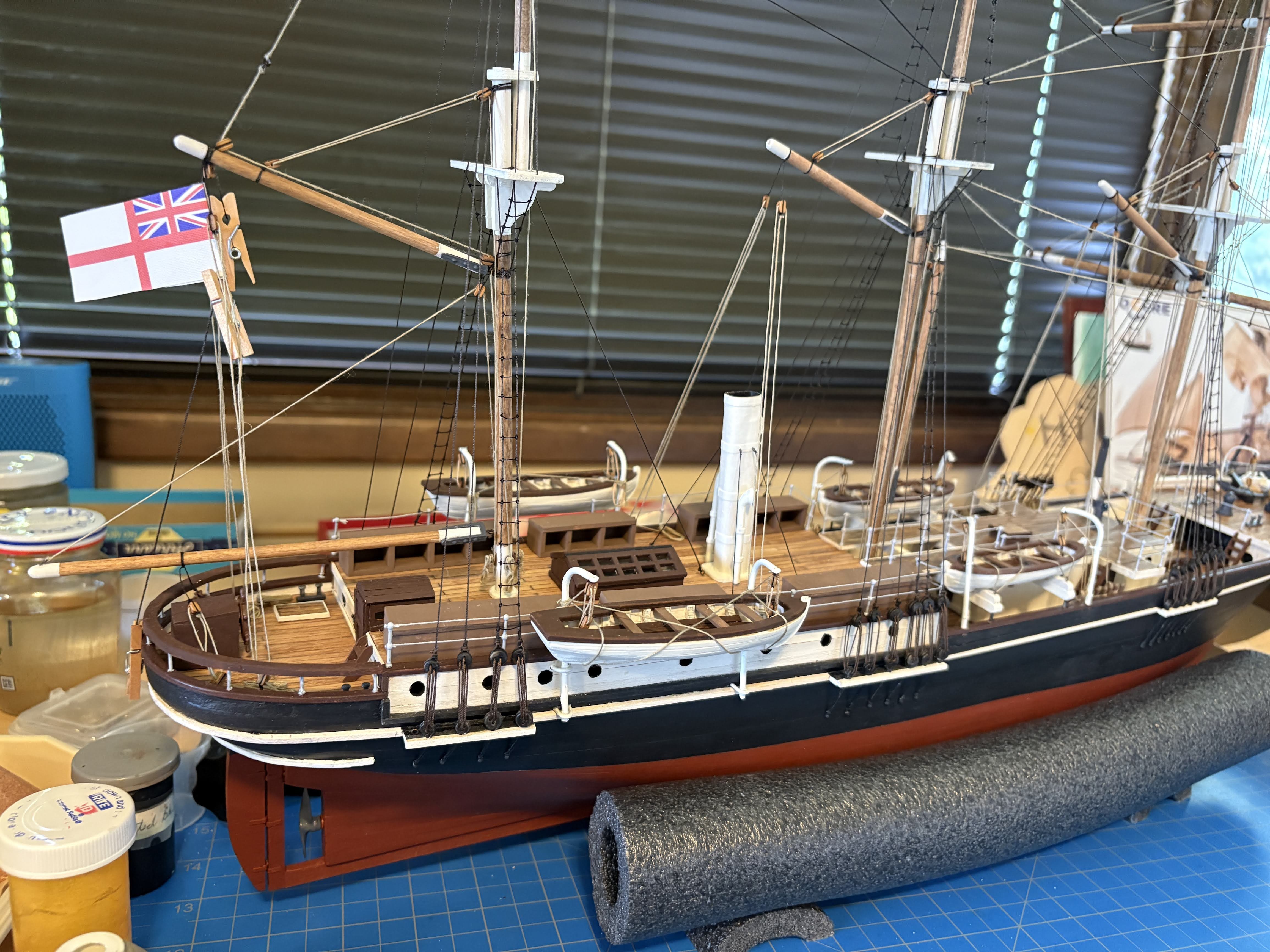

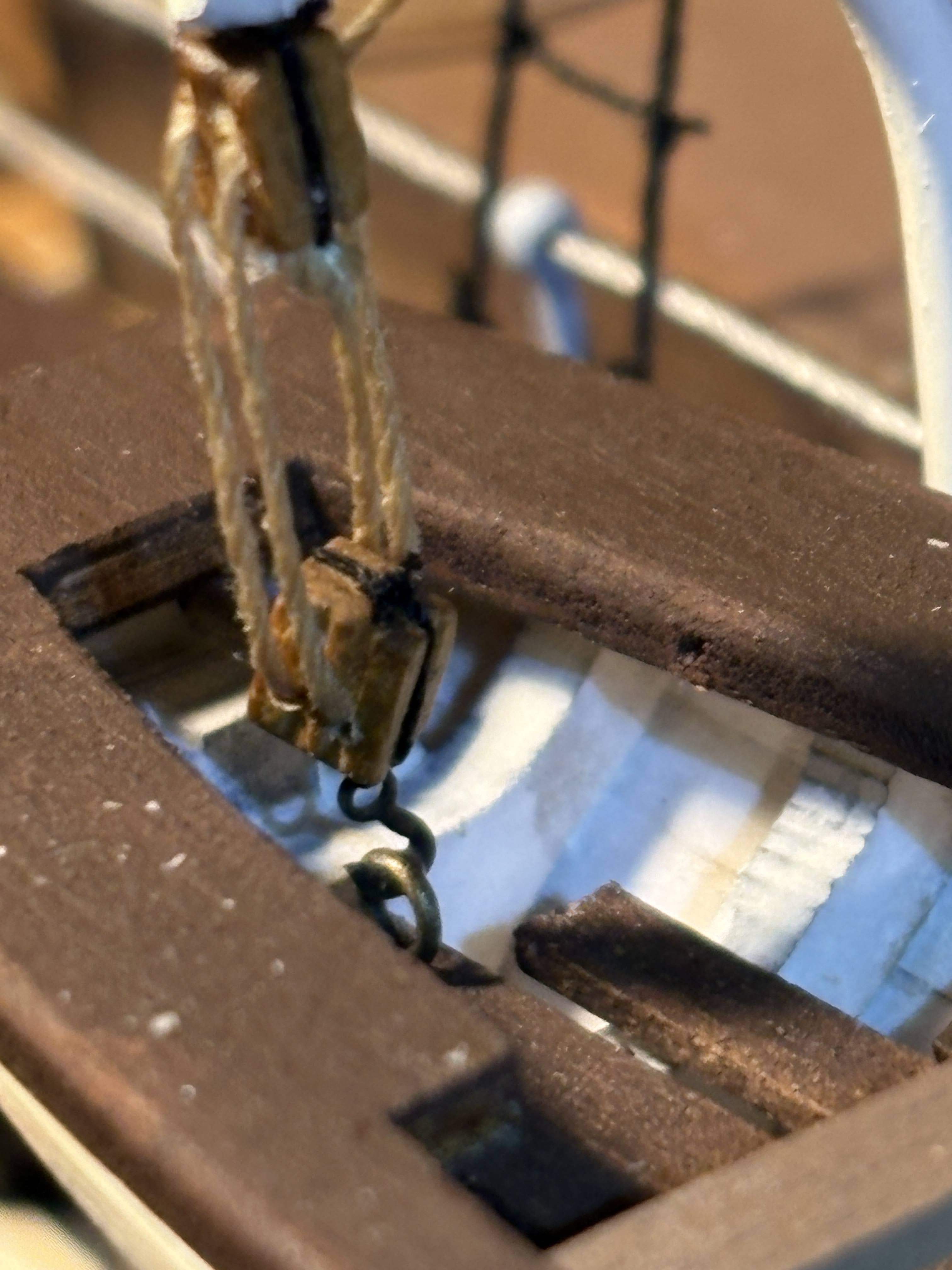

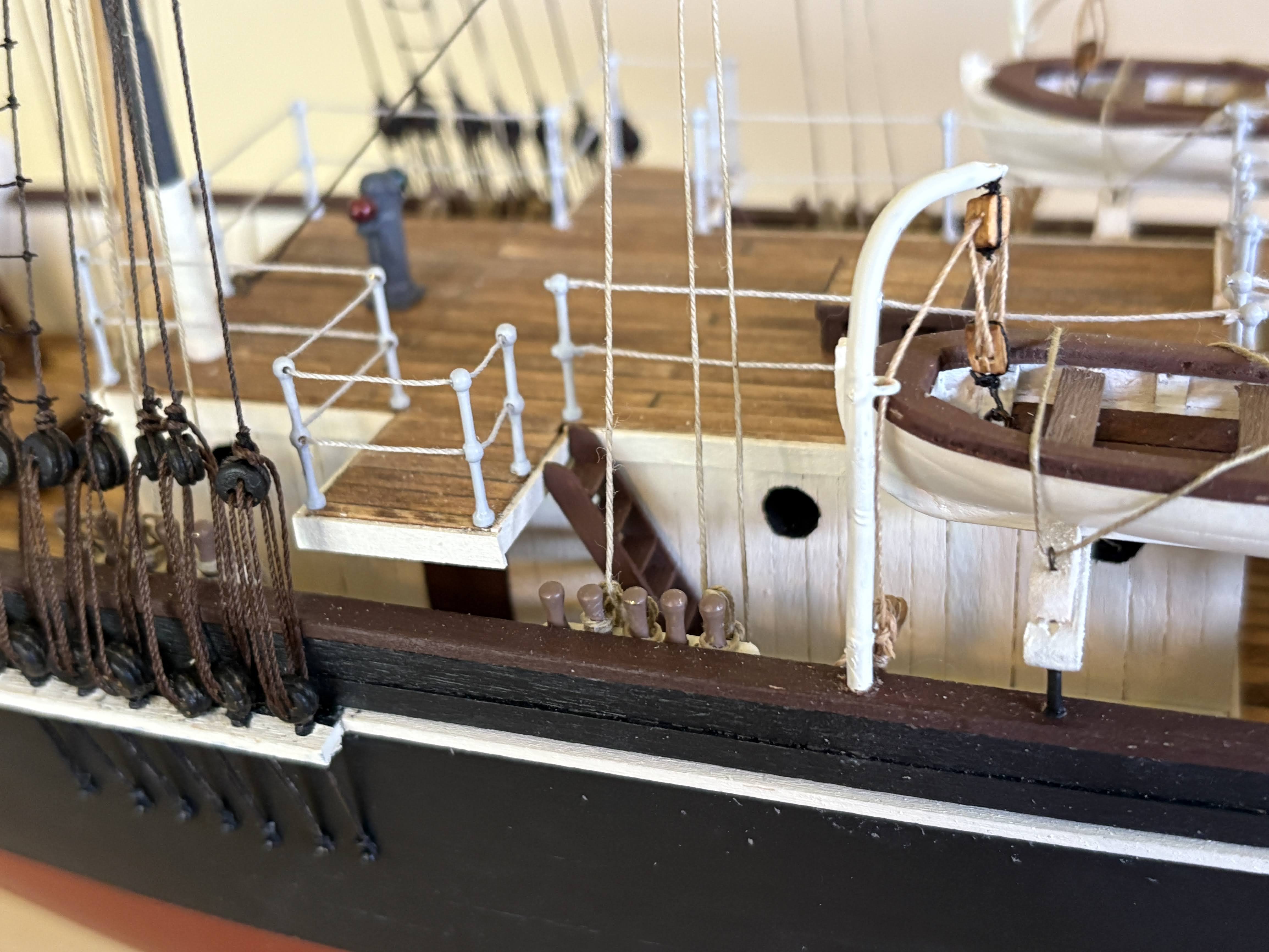

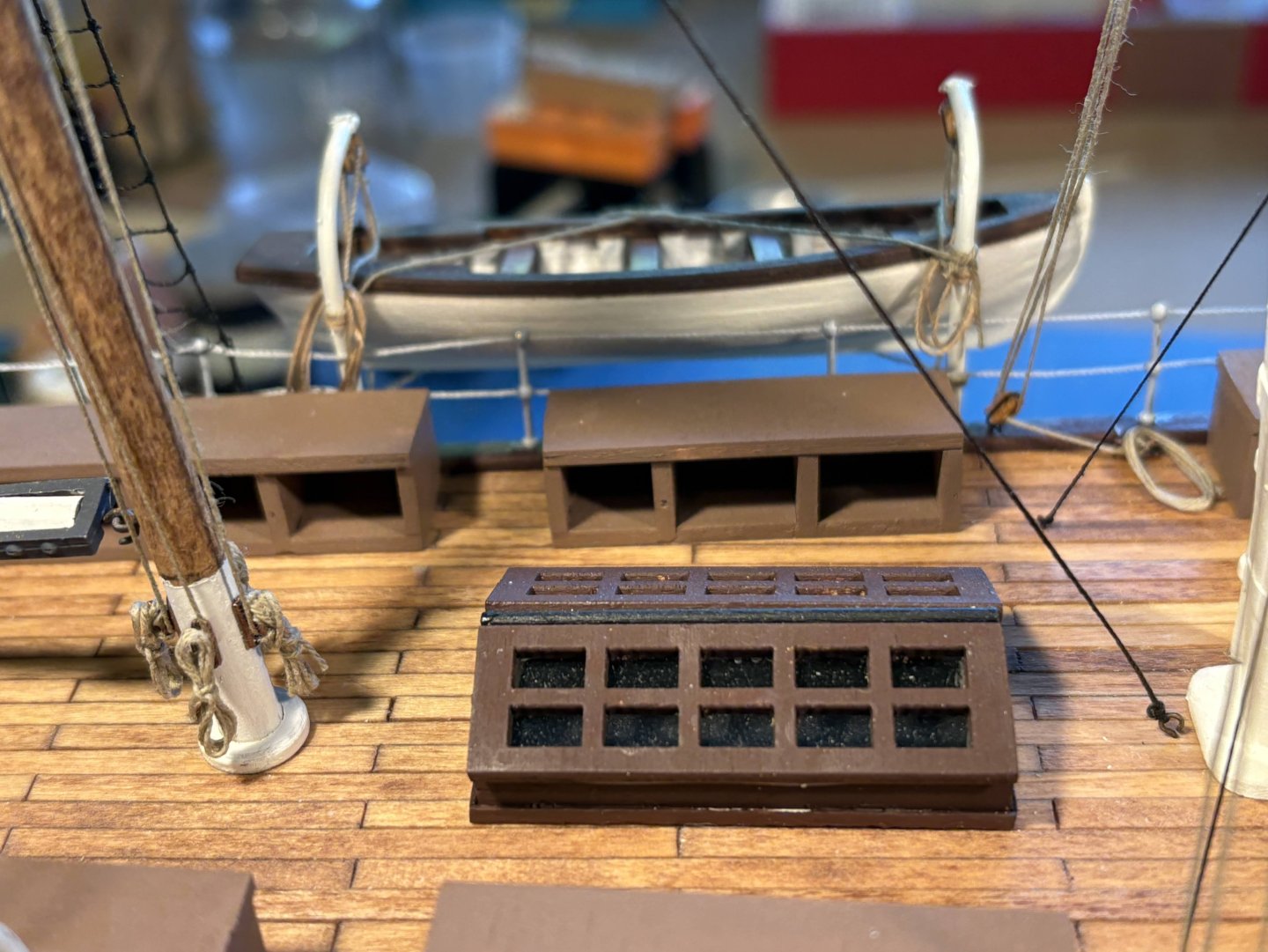

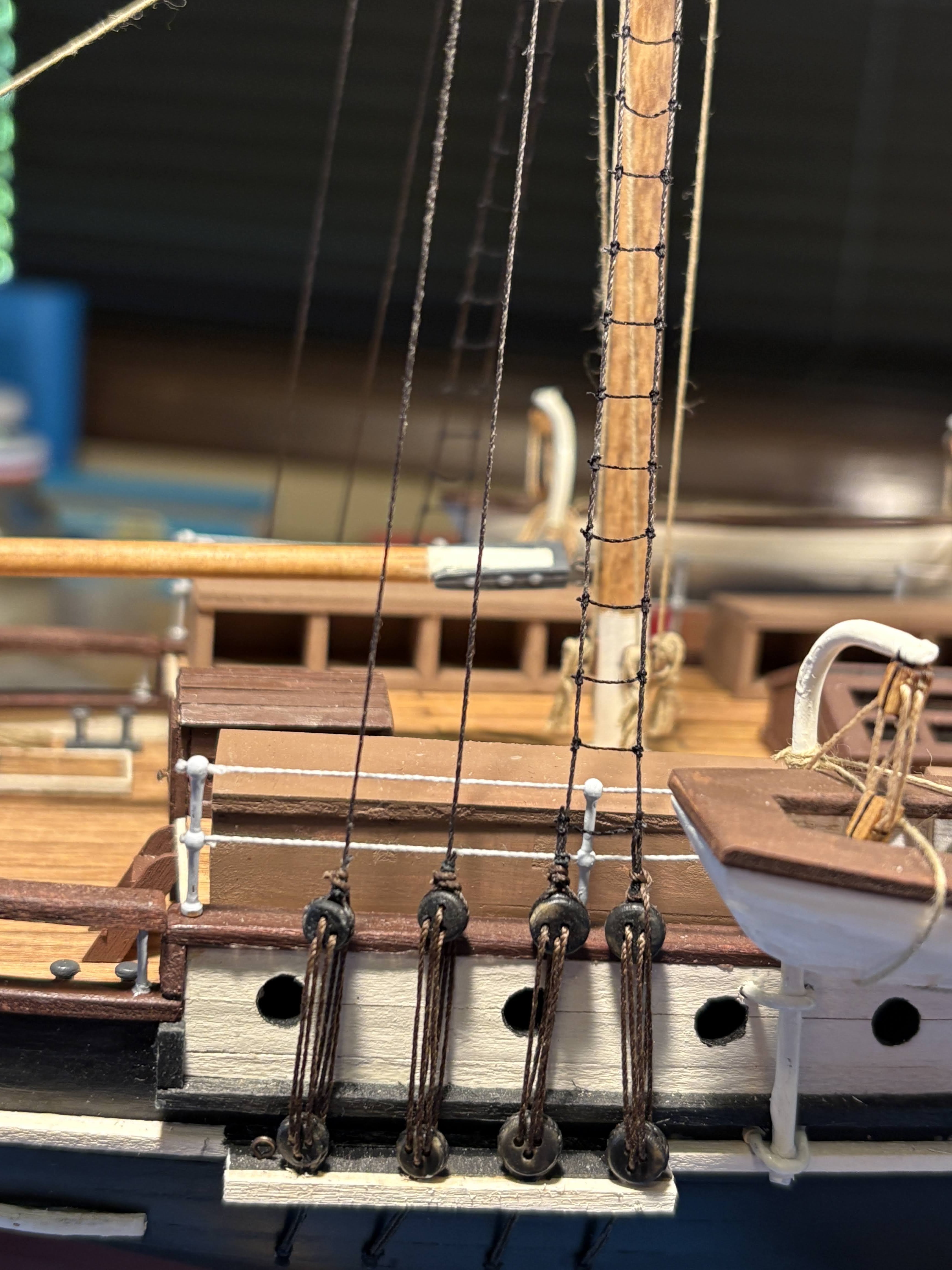

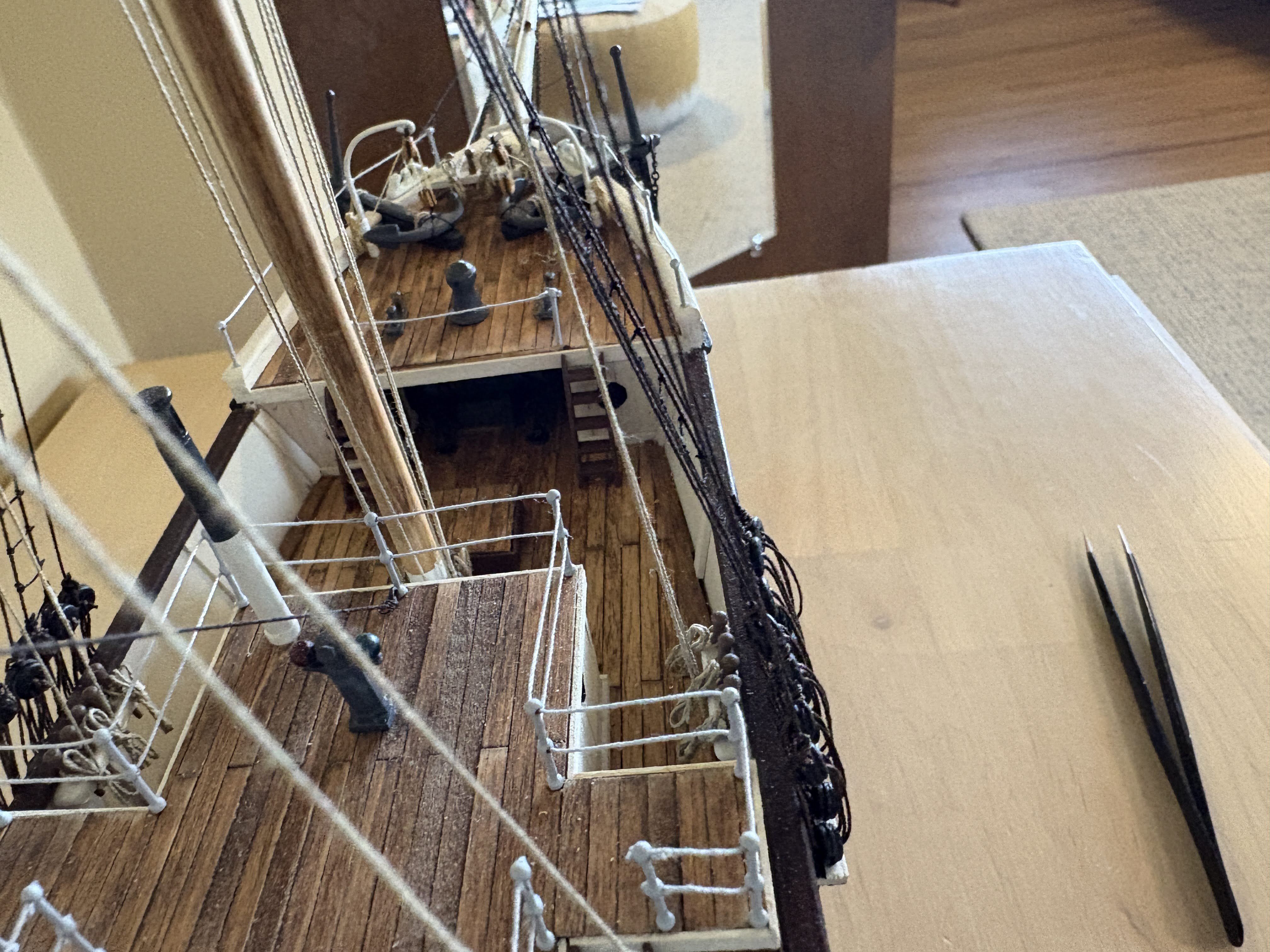

A year ago March I made anchor davits from some 1mm aluminum wire that I had lying around.  It was very easy to bend and otherwise work with, and I had no idea where it came from.  Some Google sleuthing revealed that it’s often used in crafts, which led to the realization that this wire was probably something our daughter played with probably more than 25 years ago.

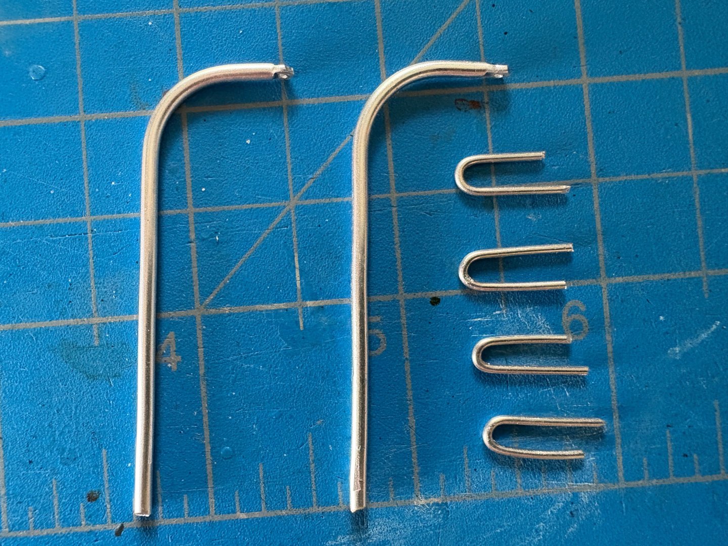

That wire was too thin to work for these davits, but I found some 2mm wire online that worked just fine.  At least for these two boats, the davits supplied by OcCre not only don’t work facing inboard, but IMHO they are too large for this scale.

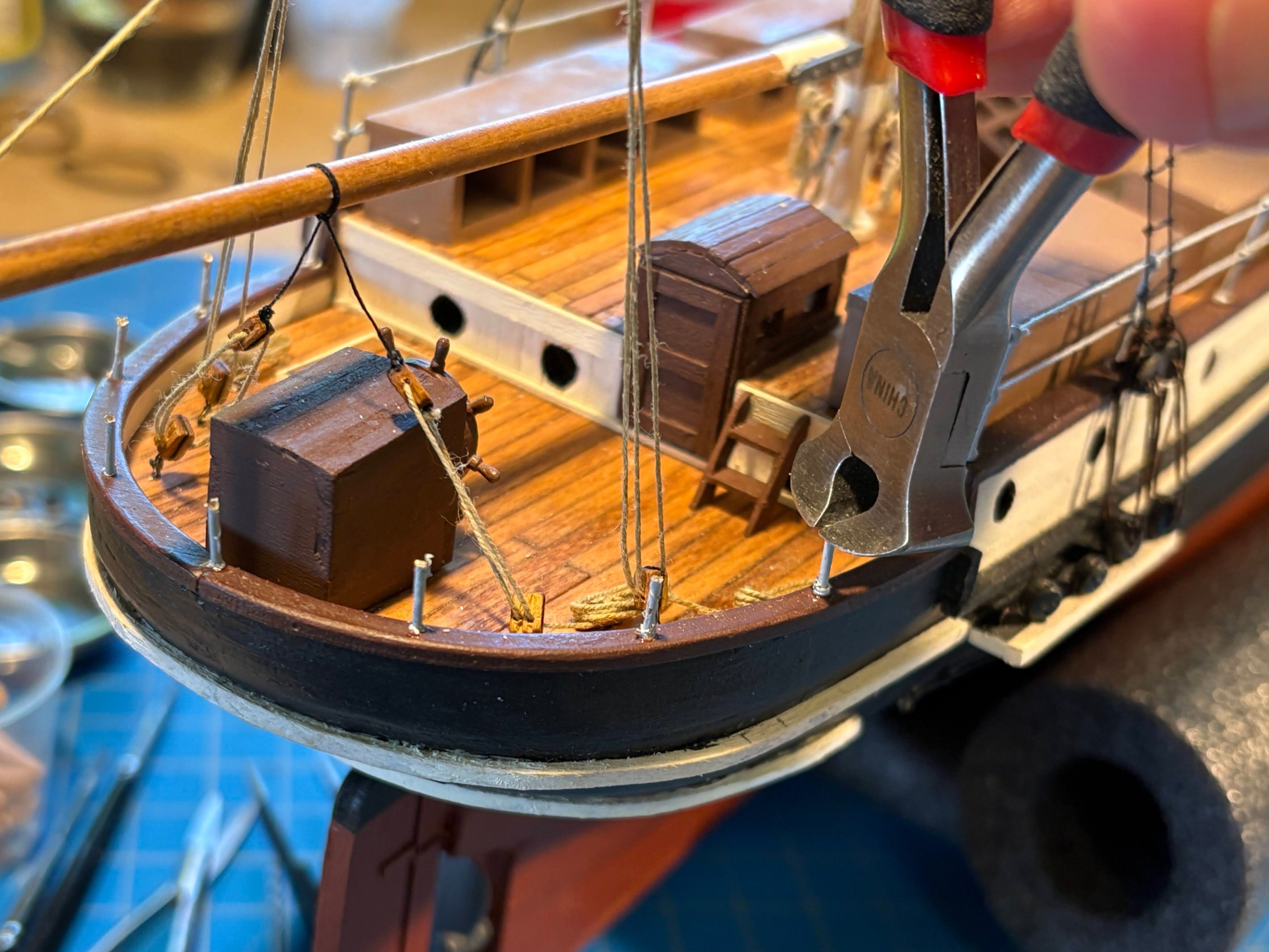

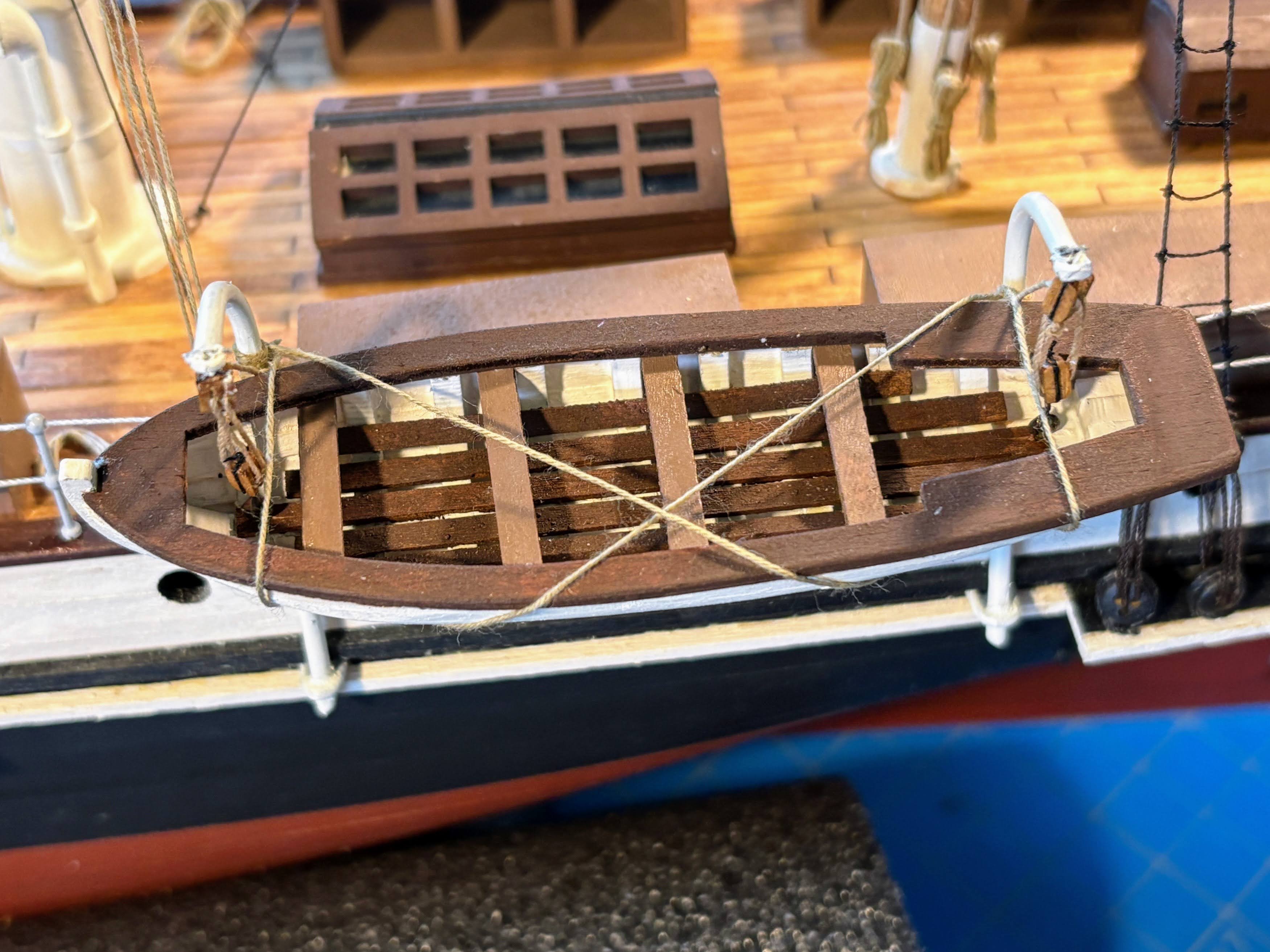

Bending this wire to the desired shape was quite easy.  I found a highlighting pen that made a perfect jig. I then used some blunt nosed pliers to flatten the upper end of each wire and put a hole in each one to attach the tackle to.  The latter proved to be far more difficult than I expected; in part because my mini drill bit set is not very good quality, and in part because flattening the ends probably made the aluminum harder and denser.  The problem I had was creating enough of an indentation so that the drill bit didn’t dance all over the place before finally digging into the aluminum. What finally worked was driving a tiny nail through the metal, and enlarging the hole with an appropriately sized bit.

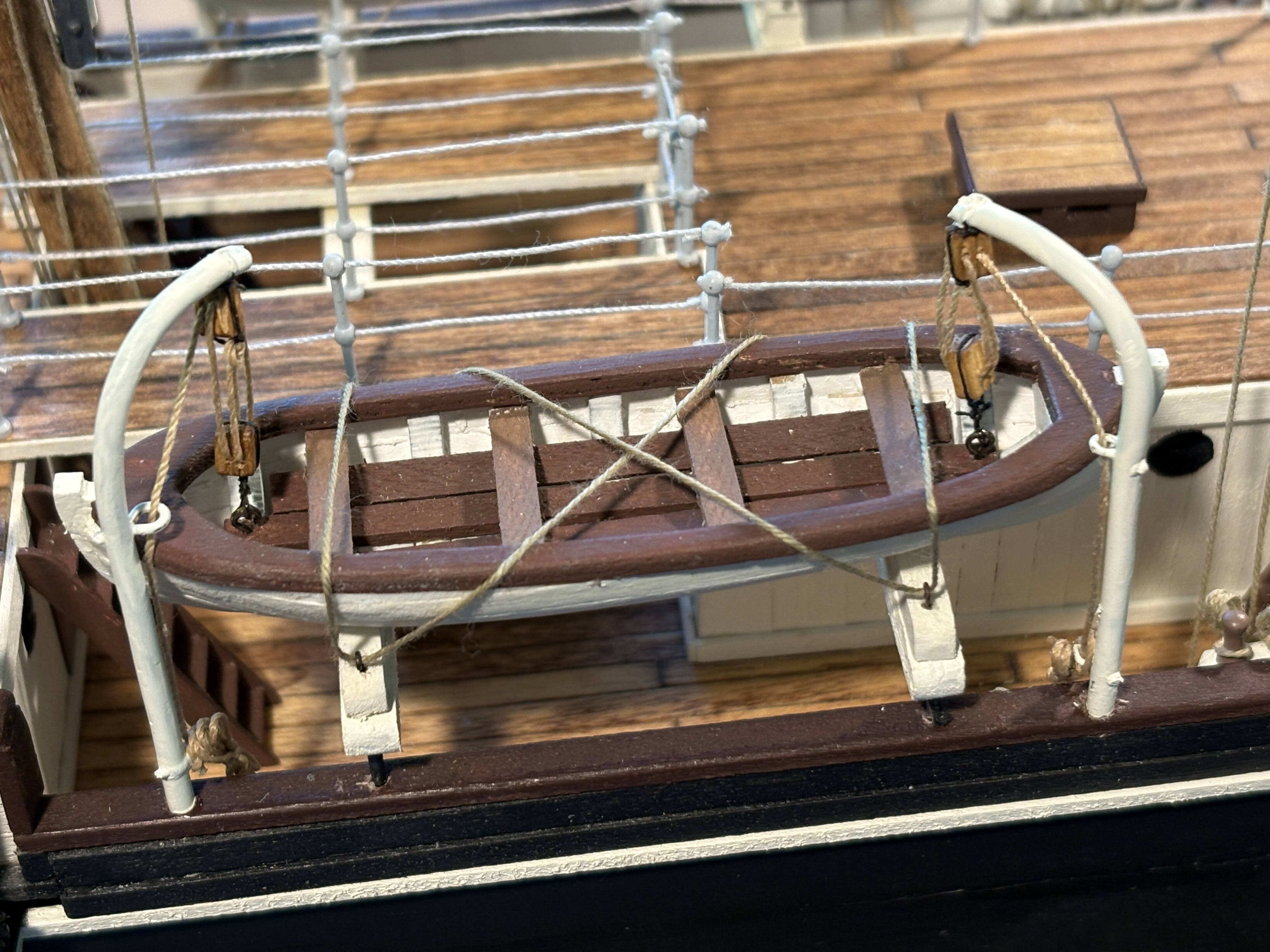

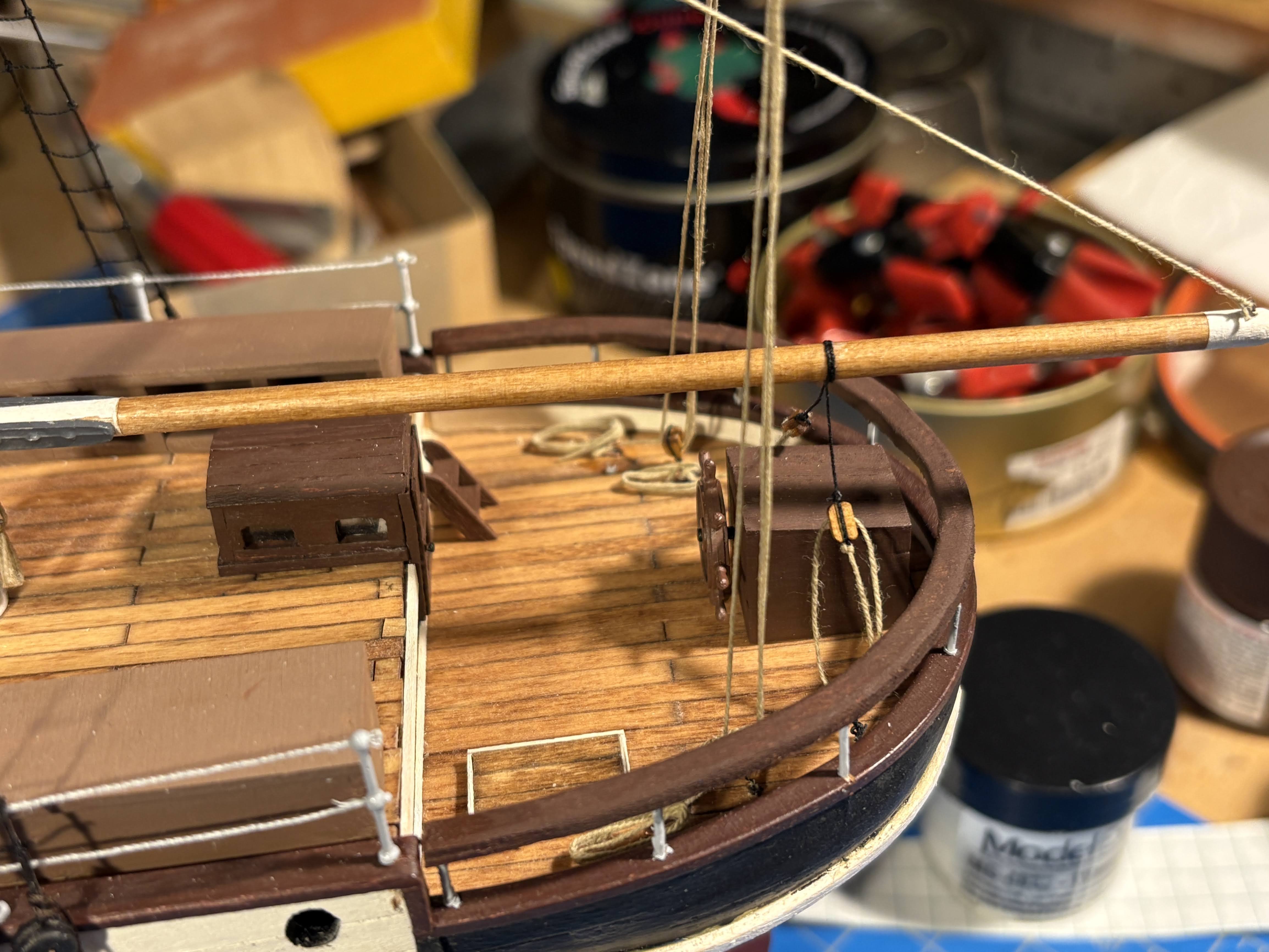

Then I realized that the tackle couldn’t travel in a straight line to a cleat positioned where any crew member could reach it; it would drape against the side of the boat, which just didn’t look right.  So I drilled holes for small eyebolts for the line to pass through. I don’t have, and probably couldn’t reliably handle, blocks small enough to fit the bill.  Next challenge was making cleats for securing the end of the tackle, very much like the wire cleats I attached near the bottom of each mast. The masts of course are significantly larger in diameter than these davits, and they provided a much better gluing target than these davits.  After an hour or two of unsuccessful efforts, I gave up and decided another eyebolt would have to serve as a faux cleat. Next step was to give the assembled davits a bath in denatured alcohol to get any finger grease off of them (I kind of guessed that was a good idea), then painted them with the same Model Shipways “Warm White” paint that I used on everything else that is white on the ship.
Rigging the tackles was pretty straight forward.  As with the anchor tackles, I used photo-etched hooks (left over from my prior build) to attach the tackles to the eyebolts previously installed in each boat. Those hooks are all but invisible in the photos below. Tying off the running end of each tackle was pretty straightforward as well.  Far more challenging was hanging a rope coil on each eyebolt rather than on a cleat; it took quite a bit of effort for something that is almost not visible. A dab of white paint on the top of each davit hides the thread used to tie the upper blocks to the davits.
