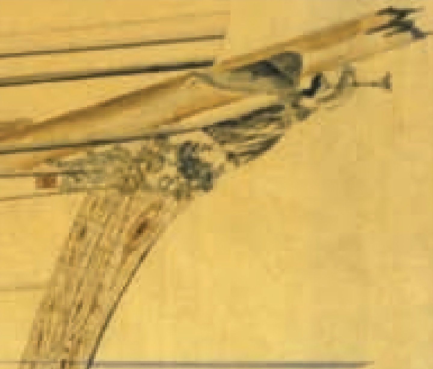

@sob @rwiederrich and I have both been doing a very deep dive into Donald McKay's remarkable California clippers for 16 years now. While the vast majority of that time has been concentrating on his last magnificent medium clipper Glory of the Seas, it naturally led to examination of his other earlier clippers as well. Our research has led us to some startling conclusions. I personally have been astounded to discover how effectively Donald McKay disguised his nautical bow construction which Rob and I now refer to as the unique McKay bow. Beginning with Stag Hound his inaugural clipper, Duncan McLean a sailor himself and apparently good friend of McKay's describes this vessel as: "Not only is she the largest of her class afloat, but her model may be said to be the original of a new idea in naval architecture." There are 3 components described in the Stag Hound bow: (1) stem, (2) cutwater and (3) hood ends. " The whole rake of her stem on deck is 6 feet, and of her sternpost 2 feet." "An idea of its sharpness may be formed from the fact that, at the load displacement line (as the cutwater is tapered to an angle), a flat surface applied to the bow from its extreme, would show no angle at the hood ends. "A carved and gilded stag hound, represented panting in the chase, and carved work around the hawse-holes and on the ends of her cat-heads, comprise her ornamental work about the bow." Using published Stag Hound lines, I overlaid (2) cutwater and (3) navel hood over the (1) stem adding the stag hound panting in the chase as described. Carved work, just as on Glory of the Seas would embellish both cutwater and navel hoods identically. There's a precise scale included off the port bow of the sketch. One observation I've made is that Duncan McLean is long on construction details and short on describing ornamental work. When he describes Flying Cloud for the first time, McLean actually uses the nautical term "navel hoods." In fact, he makes his most in-depth observations of any McKay bow in his evaluation of the strength and ruggedness of this California clipper fleet bow. "She has neither head nor trail boards, but forming the extreme, where the line of the planksheer and the carved work on the navel hoods terminate, she has the full figure of an angel on the wing, with a trumpet raised to her mouth. The figure is finely designed and exceedingly well executed, and is a beautiful finish to the bow. It is the work of Mr. Gleason, who made the figure-head of the Shooting Star." "Her hood ends are bolted alternately from either side, through each other and the stem, so that the loss of her cutwater would not affect her safety or cause a leak." Utilizing the same published lines for Flying Cloud I reconstructed her complete bow as she's been described ever since the Boston Daily Atlas article was published over a century ago on April 25th, 1851. Admittedly it's tough to see since it's so dark but the very first color woodcut illustration of her being launched includes a wedge-shaped design just above and behind a white winged trumpet bearing angel which the artist used vertical lines to delineate. Just like Glory of the Seas the top line of this shape just happens to align directly with the planksheer molding. A couple years ago I discovered this fascinating oil in an Australian Maritime Museum titled "Flying Cloud off Whitbey, North Yorkshire 1871" by John Scott. Twenty years after her launch, she still has her trumpet bearing winged angel mounted in front of her gilded carved navel hood over a carved cutwater. Typical of older wooden clippers, her once lofty rig has been reduced and her once deep topsails have been replaced with Howe's rig upper and lower topsails on all masts. Another beautiful contemporary piece I found is: "Ship 'Flying Cloud' Alex Wagner, Cmdr, of New York going into Hong Kong." This is an earlier work depicting her when she still had her original taller rig. Detail scene shows a white winged angel bearing a trumpet with painted, carved navel hood and cutwater. Note how in all works, her angel figurehead isn't attached to the bowsprit but mounts below the navel hoods and in front of her cutwater. Artistically portraying these complex shapes is quite a challenge since the prows of these huge clippers were very sharp and their rigs were like skyscrapers. Incidentally, I've personally seen a portion of a substantial iron bar that once mounted the Grecian goddess Athene to her supporting navel hoods on Glory of the Seas when her new Cape Cod owners invited me to see her. I hope this is sufficient evidence to prove conclusively that our understanding of clipper Flying Cloud must be revised to incorporate these unique bow construction components.

@sob Scott, since cutwaters and navel hoods were never included by McKay in his lines, his widow would have had nothing to trace. Similarly, no monkey rails, splash rails or figureheads have been found on any clipper ship lines either. Rob, Vladimir, myself and occasionally Druxey have been able to keep our communications civil by agreeing that our mutual goals have been to maintain focus on trying to remain as faithful as possible to Donald McKay's historically accurate vessels. However you envision cutwaters and hood ends (or navel hoods) I strongly believe you must at least concur that as her lines are currently portrayed they only show a bare stem, these other two important elements are currently lacking. Perhaps it's personal artistic bias but the two bow revisions I've illustrated appear to show a more refined impressive and complete clipper prow which gracefully incorporates all elements as described.
of course I want 'remain as faithful as possible to Donald McKay's historically accurate vessels"
your bow revisions do show " a more refined impressive and complete clipper prow" I just do not agree that there is reason
to think that McKay's idea would have sprung forth on his first few ships quire a refined
but, in the end, there is no actual data to show that either of us us correct in our views - so I'm going to leave it there
but do keep up the very good work shown in this blog
Scott

Rob, continuing in my research into Donald McKay's apparent intent to disguise his bow structure components, here's one of the most bizarre sketches made by him. This is the famous flyer, the Australian Black-Ball Emigrant clipper Lightning constructed as one of four for the James Baines Line. The open section of her bow is original as drawn by McKay himself. The only logical explanation for this intentional omission is that he was concealing something. Ironically, the only source I've seen this peculiar sketch is in an 1961 American Heritage Junior Library Book for kids. It's surprisingly informative. Next is a contemporary preliminary sketch done for a lithograph of her which appears after it. The original sketch definitely shows an outline of a  construct whose top aligns with her sheerline molding and which comes to a point above her winged figurehead. The litho has this area embellished in gold and looks like the device has been extended further than the sketch. This component is what we have identified as her navel hood. This same litho was also used as a cover for "The Lightning Gallop" musical score. Her bow shows distinct outlines of what we now refer to as her navel hood and cutwater with her original winged female lightning bearing figurehead. Coincidentally, it's the same section McKay left blank in his own drawing.... Another work by brilliant British artist Samuel Walters depicts "Clipper Lightning off the Coast." Since the piece suffers from an over exuberant cleaning, it's washed out and her prow section is blurry. Still, details reveal another navel hood, cutwater and winged figurehead. Anyone familiar with this particular artist's work knows he's meticulously accurate in his depictions. I find that overall, this prow depicted in both pieces looks remarkably similar to photos we've seen on the bow from Glory of the Seas. Clippers were very popular subjects at this this time. Especially the gigantic American vessels which dwarfed their British counterparts. To power these huge ships they had substantially tall rigs with impressive spread of sail. Cameras weren't yet widely available so newapaper publishers had highly skilled artists do careful illustrations of these magnificent vessels. Anyone who's ever attempted to draw the complex curves of a clipper's bow knows what a challenge it is. Still, it looks like for all their flaws these artists have done a credible job in reproducing these glorious ships.ClipperLightning-Contemporary-Sketch.jpg.63b13946571fb5f1f85f5359ac939fc1.jpg

Rob, no surprise that I agree with you. In fact, in his letter accompanying his Stag Hound builder's model, Cornelius McKay confirmed that his dad jealously guarded his scientific secrets. Actually, we have modern counterparts in the America's Cup yacht race competitions. As confirmation of the extremity that Donald McKay we to just look at his ship's line illustration of his Australian Black Ball line extreme clipper Lightning.The very front of her bow is left completely blank!
@rwiederrich @sob here's a comparison between Donald McKay's structural sketch of 1853 twin clipper packets Star of Empire & Chariot of Fame (courtesy of Peabody-Essex Museum, Salem, MA). There's an 1853 painting of Chariot of Fame referred to as a clipper ship. The winged angel figurehead is larger and the prow is less pronounced in the sketch, with a clear gap between the figurehead and bowsprit. Compare that to the painting of the ship herself. Now the figurehead is more true to scale, there is a structure which mounts her and it abuts directly to the bowsprit. This arrangement provides more of a solid base to the bowsprit. In addition, the cutwater, navel hood bow is noticeably more pronounced as the figurehead is also further out. It's a challenge to see details as the image gets more blurry when I enlarge it. Still, Rob and I recognize the similarity between this vessel and the same arrangement on Glory of the Seas launched sixteen years later. From a basic engineering viewpoint, the idea of extending a portion of the hull to serve not just as a support for massive bowsprit-jibboom spars but also to provide a secure mounting point for full sized nearly 8' tall figureheads while doing double duty as shelter for the same is pure brilliance to me. A basic bare stem simply cannot achieve the same results. All of McKay's ships were described as having cutwaters but none of our contemporary models even show that. To Rob and I we feel like that's doing a disservice to the genius of Donald McKay.
