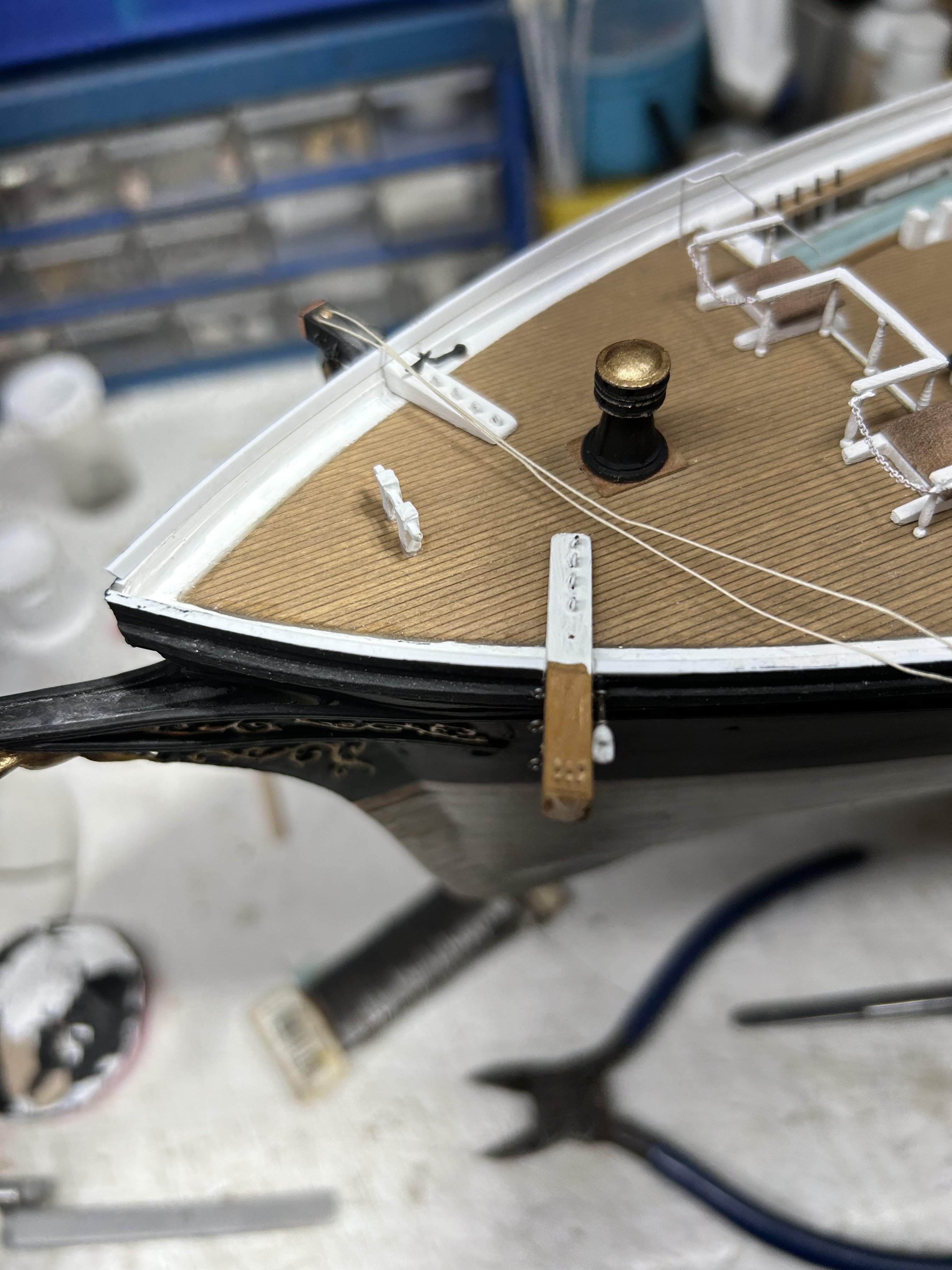

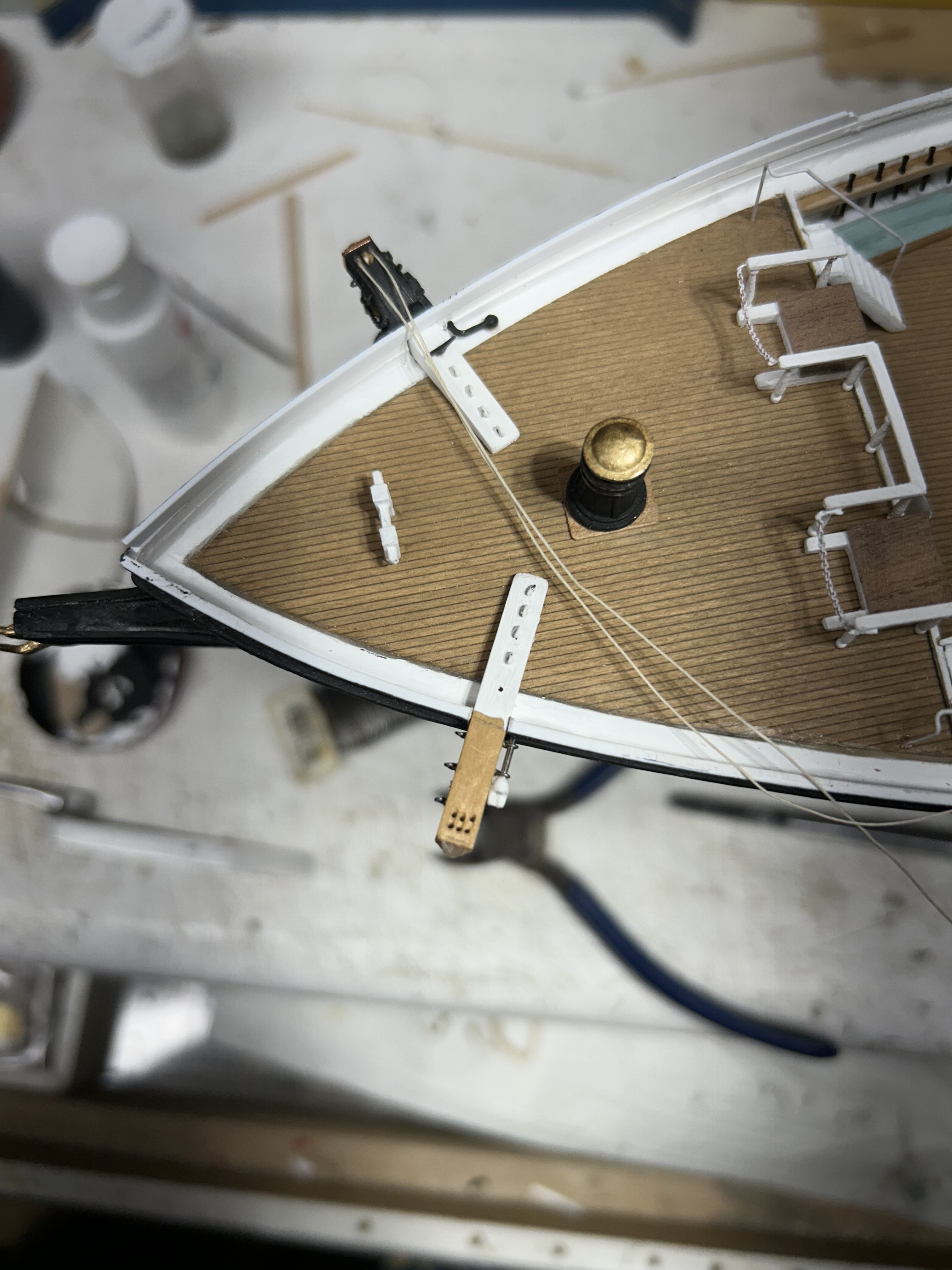

Nice job on the cathead Rob!!
Rick
Thank Rick.   It needed to look warn as naturally expected.
Rob

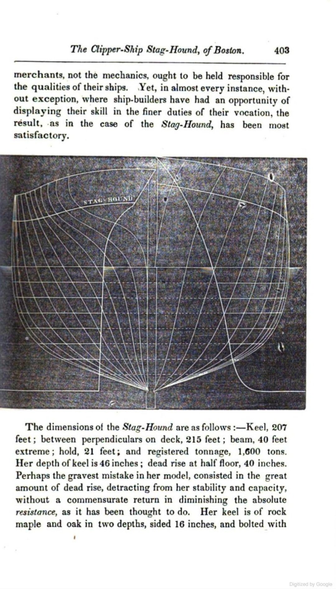

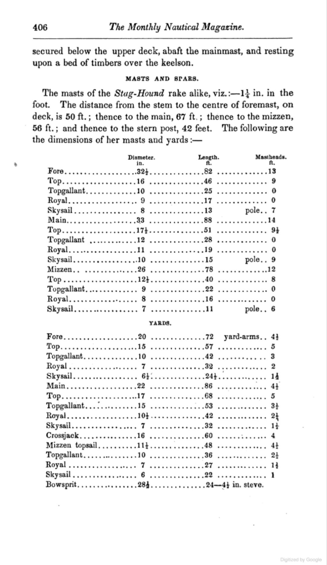

April 1855, Monthly Nautical Magazine Quarterly Review Stag-Hound article. This article, written 5 years after her launch confirms Hall's notes regarding the 1 & 1/4" per foot rake of her masts. It still has the incorrect 4 & 1/2" per foot bowsprit steeve. Fortunately, Cornelius McKay's letter and drawing shows a less dramatic 4.2" steeve per foot. Valuable documents such as these aid in confirming accuracy.
29 minutes ago, ClipperFan said:
@Snug Harbor Johnny that's some amazing statistics for sure. Thanks for doing those calculations.
I agree…… great job Johnny.
Rob

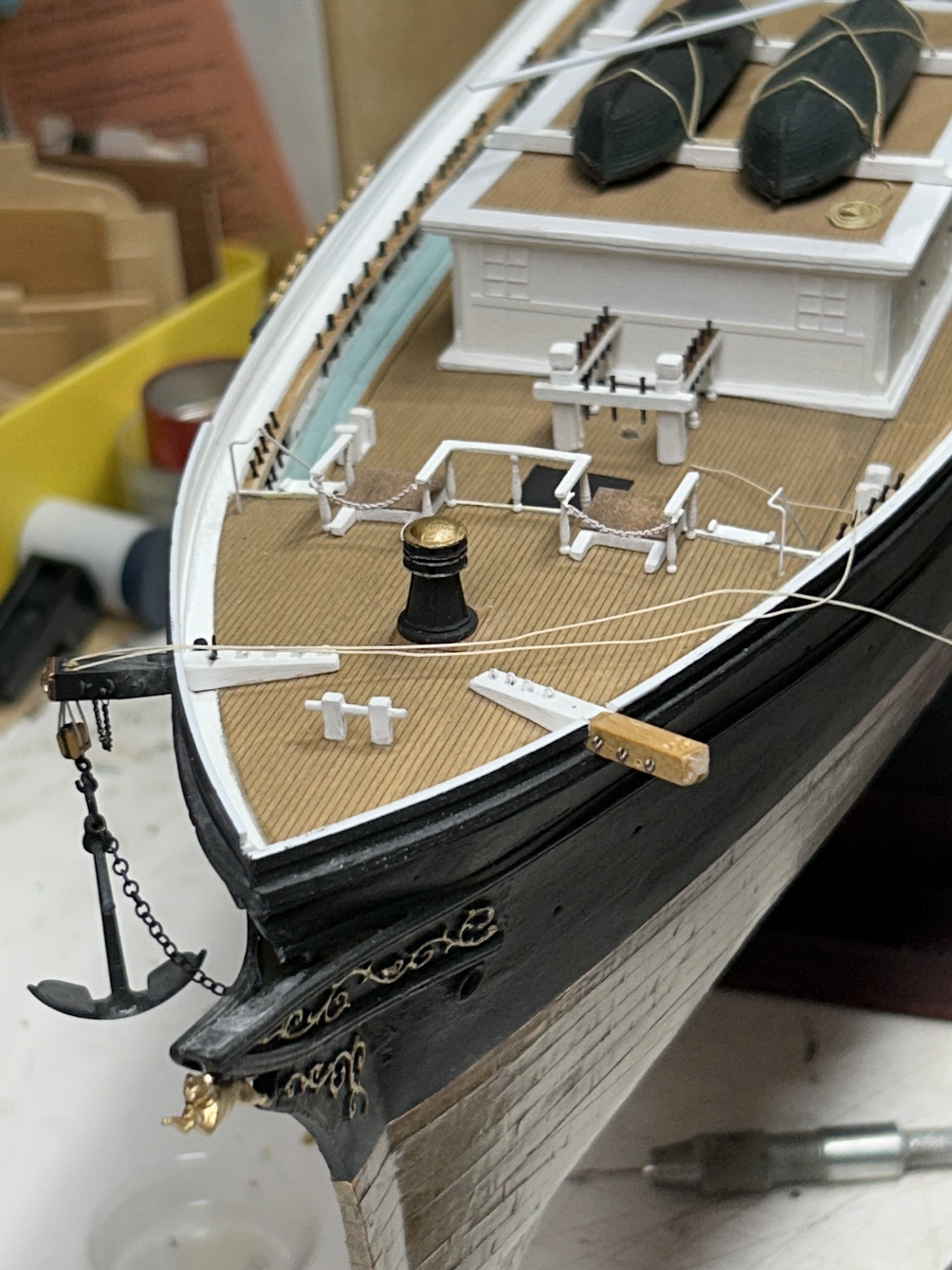

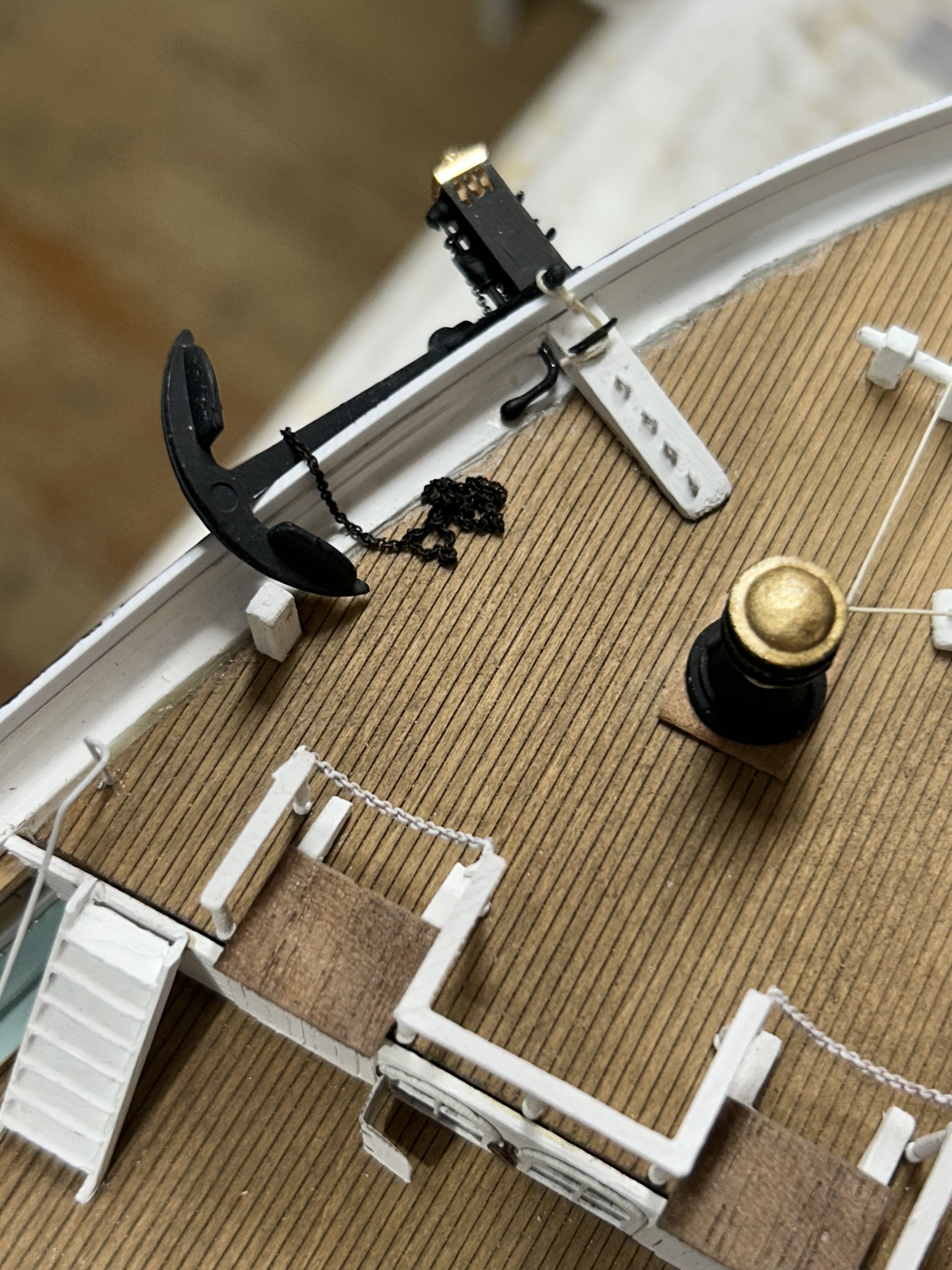

Worked on the anchor for the cathead. I decided against the wood stock, based upon Buttersworth’s painting, plus the fact McKay had an open checkbook to buy the best and most up to date hardware for Staghound.
Rob
Rob
Rob, your powers of observation still impresses me. I checked and both of Buttersworth’s pieces feature the more modern all iron anchors.

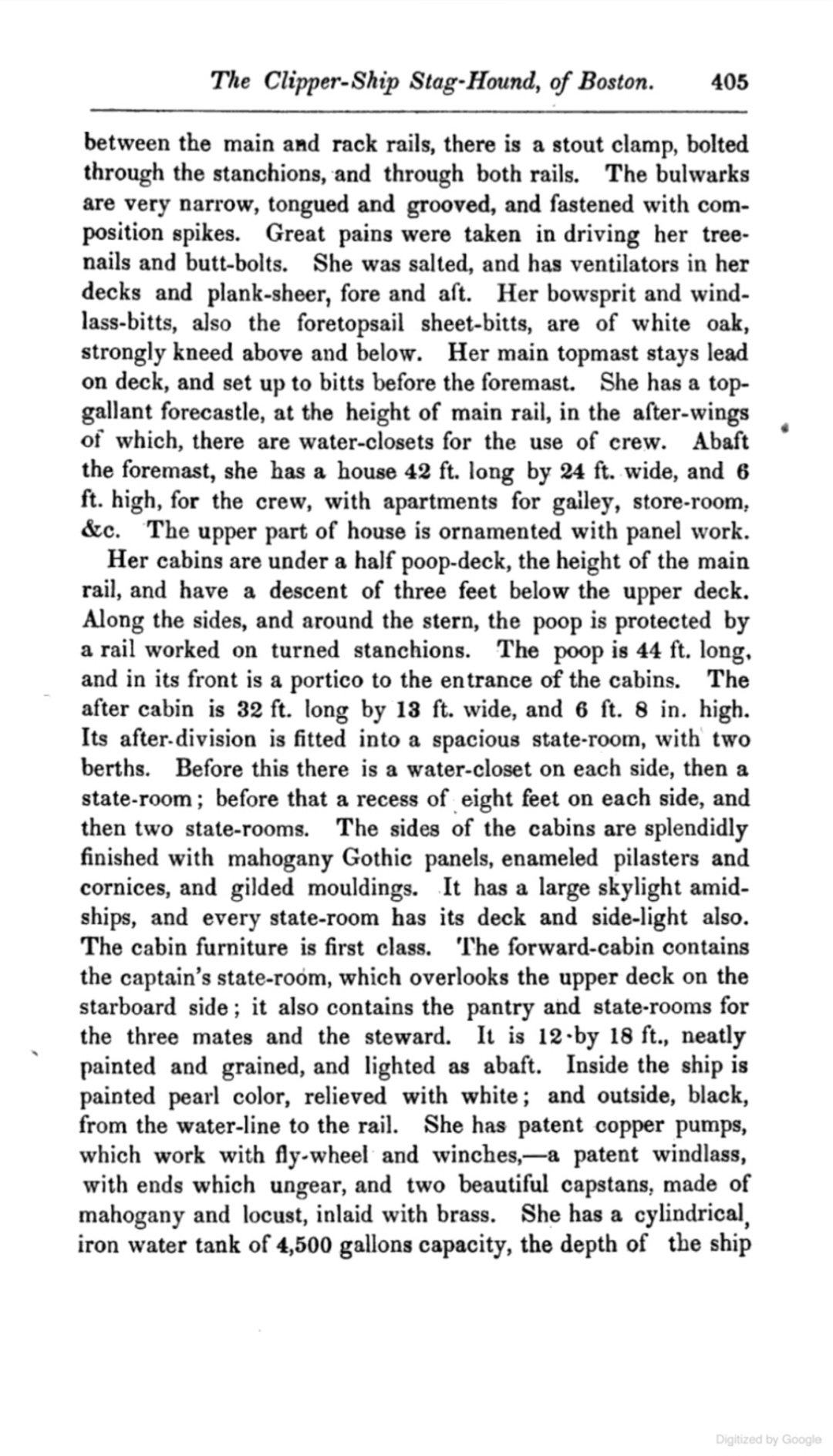

Rob, here's Duncan McLean's description of the ventilated bits. He describes them as all being made of choice white oak. My educated guess would be that some form of iron might have been pounded into wooden bitts to provide ventilation. Foretopsail sheet bitts are also ventilated. This reminds me of the composite mizzen mast which was hollow inside to provide ventilation and prevent rot. I'm going to see if I can find some patented examples of ventilated bitts from 1850.
It looks like this is another case of Duncan McLean c combining descriptions for brevity. You may already know this but I had to learn it for myself. Ventilators were not inside bitts, they were nearby them. I found 2 patents. Emerson's which was specifically described as being on Flying Cloud and since it was patented in 1848 it's safe to accept they were installed on Stag Hound too. The later Ventilator appears to be bulkhead mounted. The Warren Robinson patented description also includes detailed float valves to prevent water ingestion and draining from wave action, which also confirms these were the ones installed along planksheers.
Rich , it says the foretopsail sheet bitts are all white oak.  NOT the ventilated bitts.  These are all metal bitts with unscrewable centers with caps. NOT the large wooden bitts, found at the foot of the masts, and by the bulwarks for mooring.  Two different kinds of bitts.

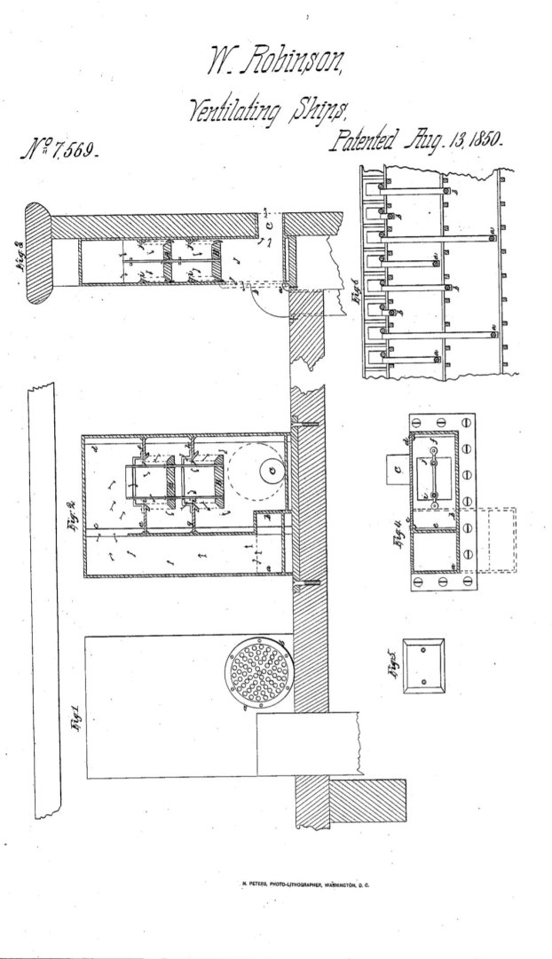

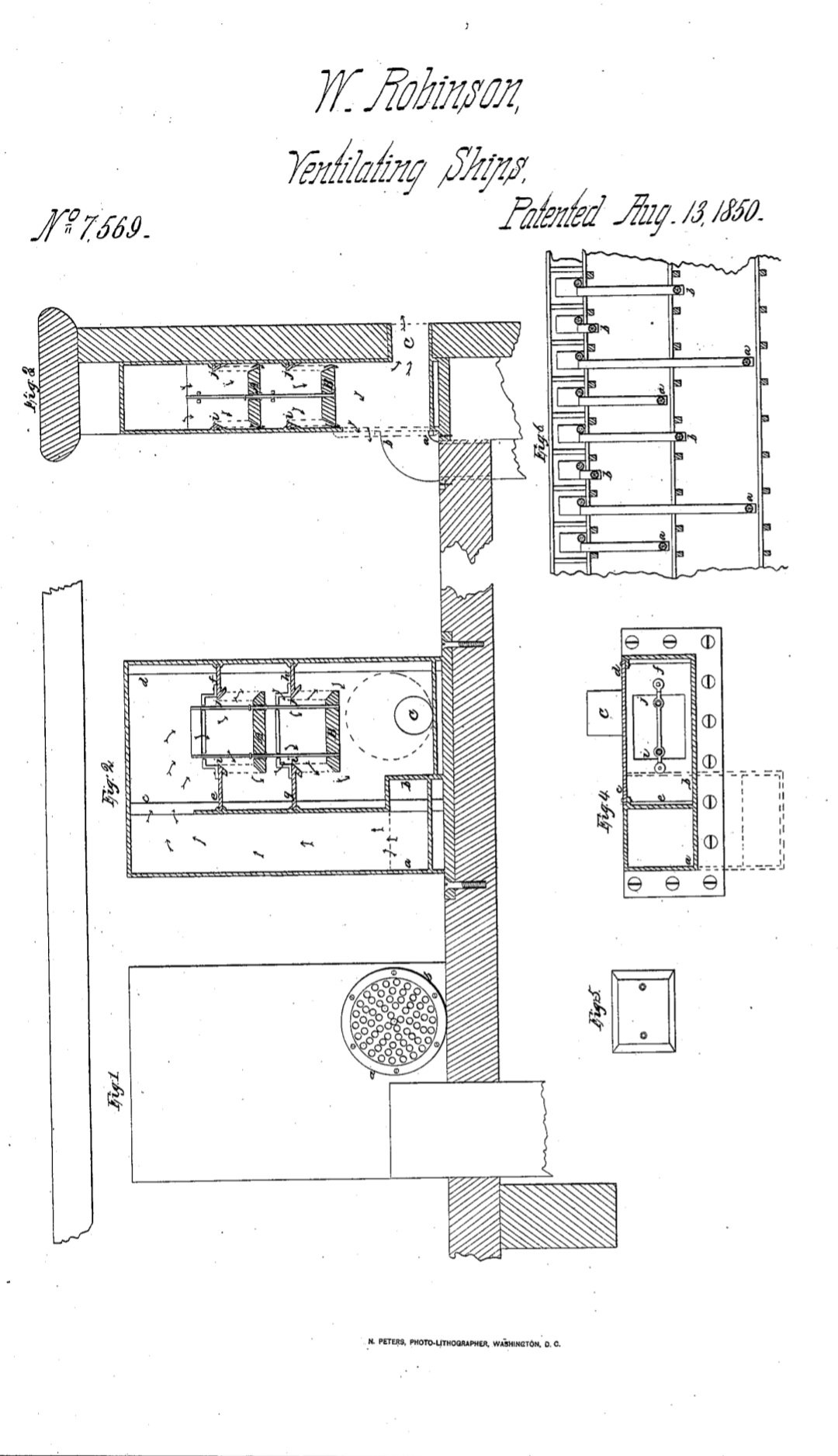

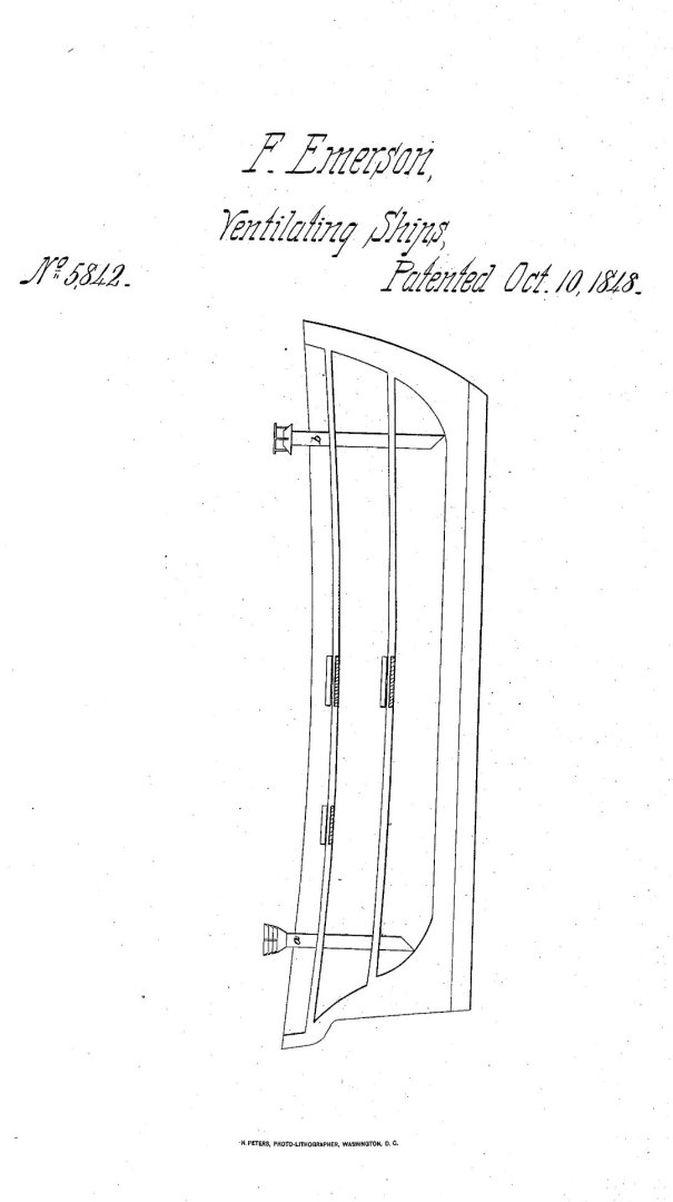

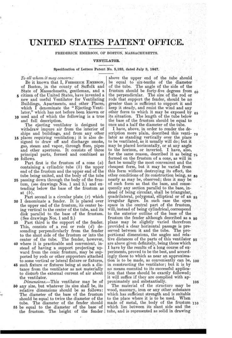

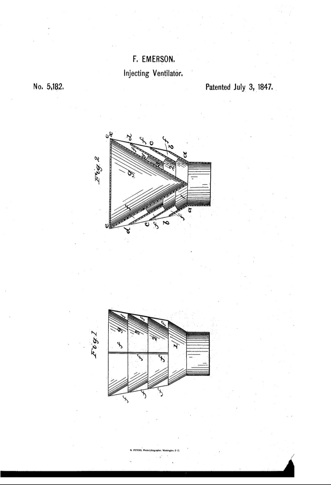

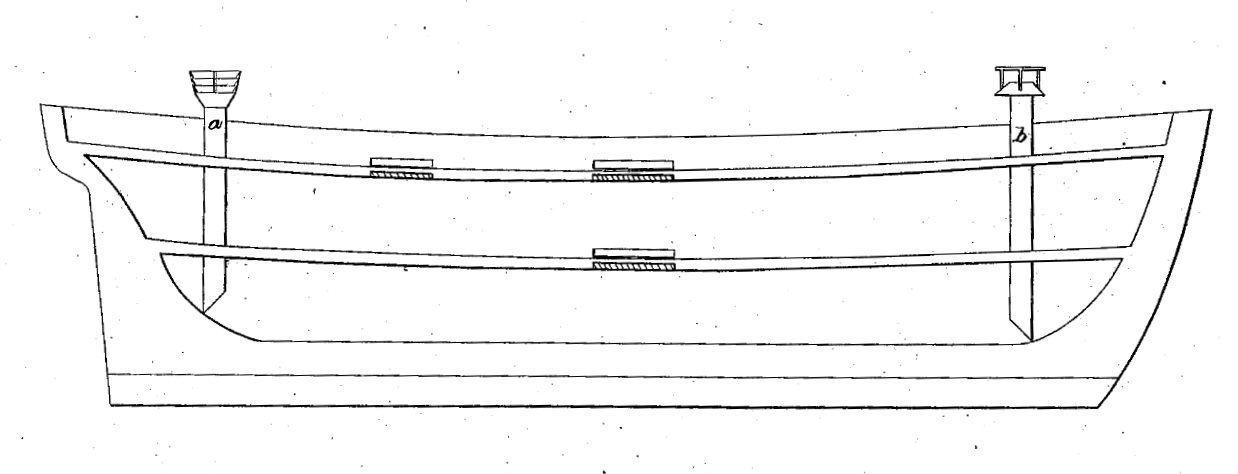

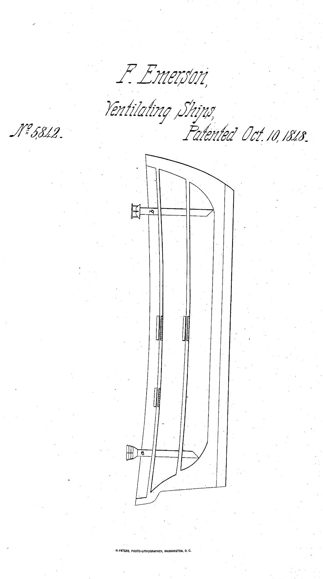

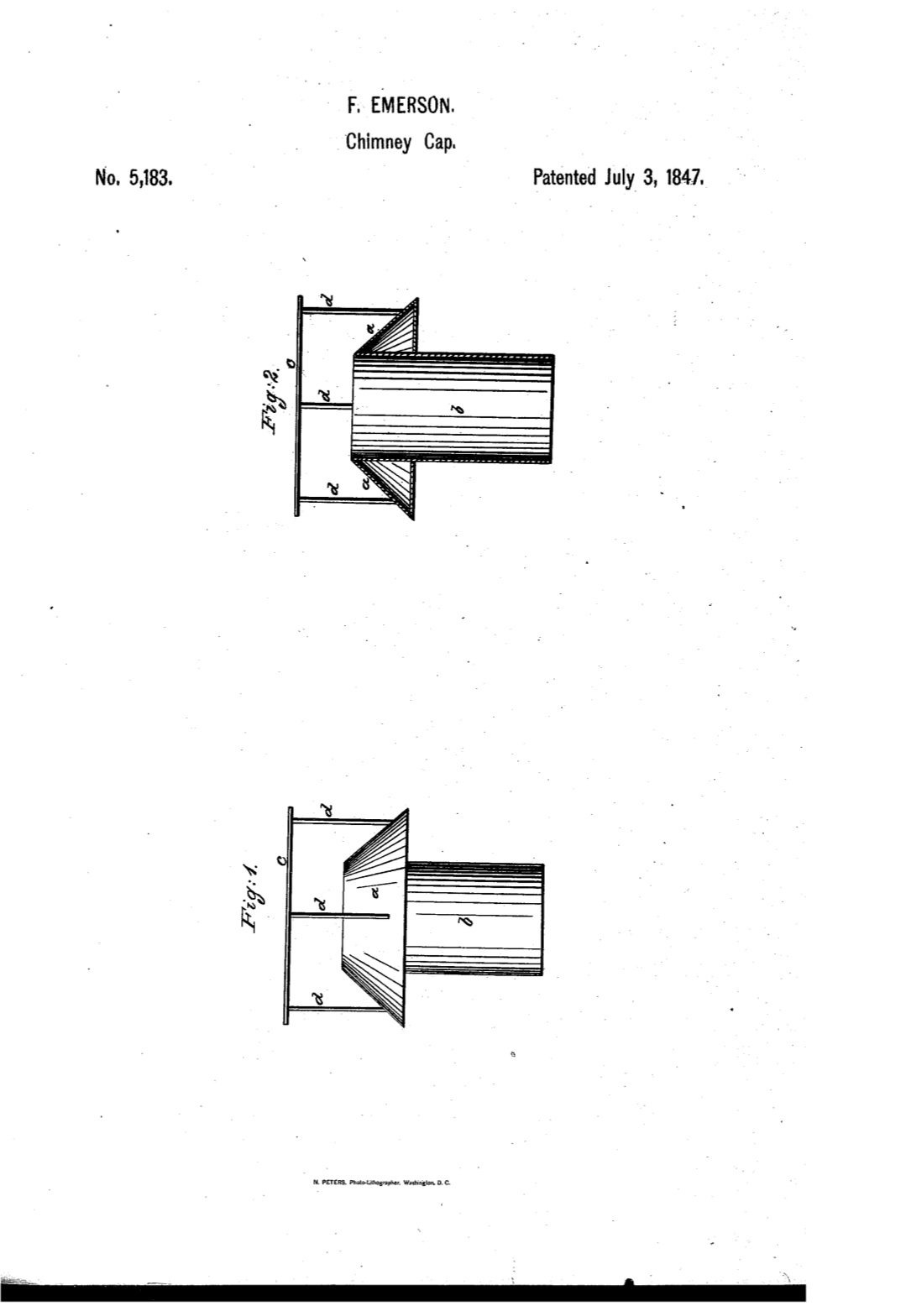

Rob, researching ventilators going back to 1847, I found no ventilated bitts. Emerson describes his pair of ventilators as one which brings fresh air down into the hold or lower decks with a corresponding one that extracts fouled air out. He recommends one be placed at the fore of the ship and the other at the aft of the ship. For larger ships, even a second pair could be used. In this case, the order would be reversed. One injector and one extractor near each other. Stag Hound having been the largest merchant ship in the world at her launch, it makes sense that she would have had additional Emerson's ventilators. Before going with metal bitts, I encourage you to double check with Mike. Whenever I tried to find any type of wooden or metallic ventilated bitts it went to a dead end. This is why I suspect Duncan McLean inadvertently mixed in wooden bitts with cylindrical metallic ventilators installed nearby. Here's Emerson's 1847 patented ventilators.

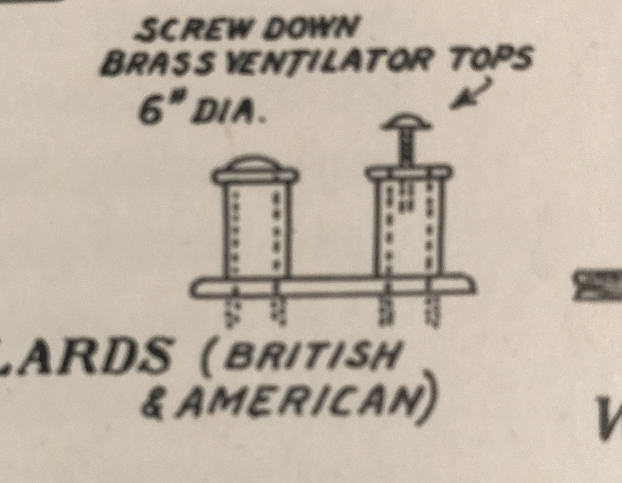

Rich , I’m suggesting this type of ventilated bitt.
Rob

Rob, your model, your build. I hate to be a royal "PITA" but try as I might, I cannot find any reference to such ventilated top bollards illustrated here. Everything I have read, including searching contemporary patents, refer only to seperate ventilators. Nothing embedded in bitts of any kind.

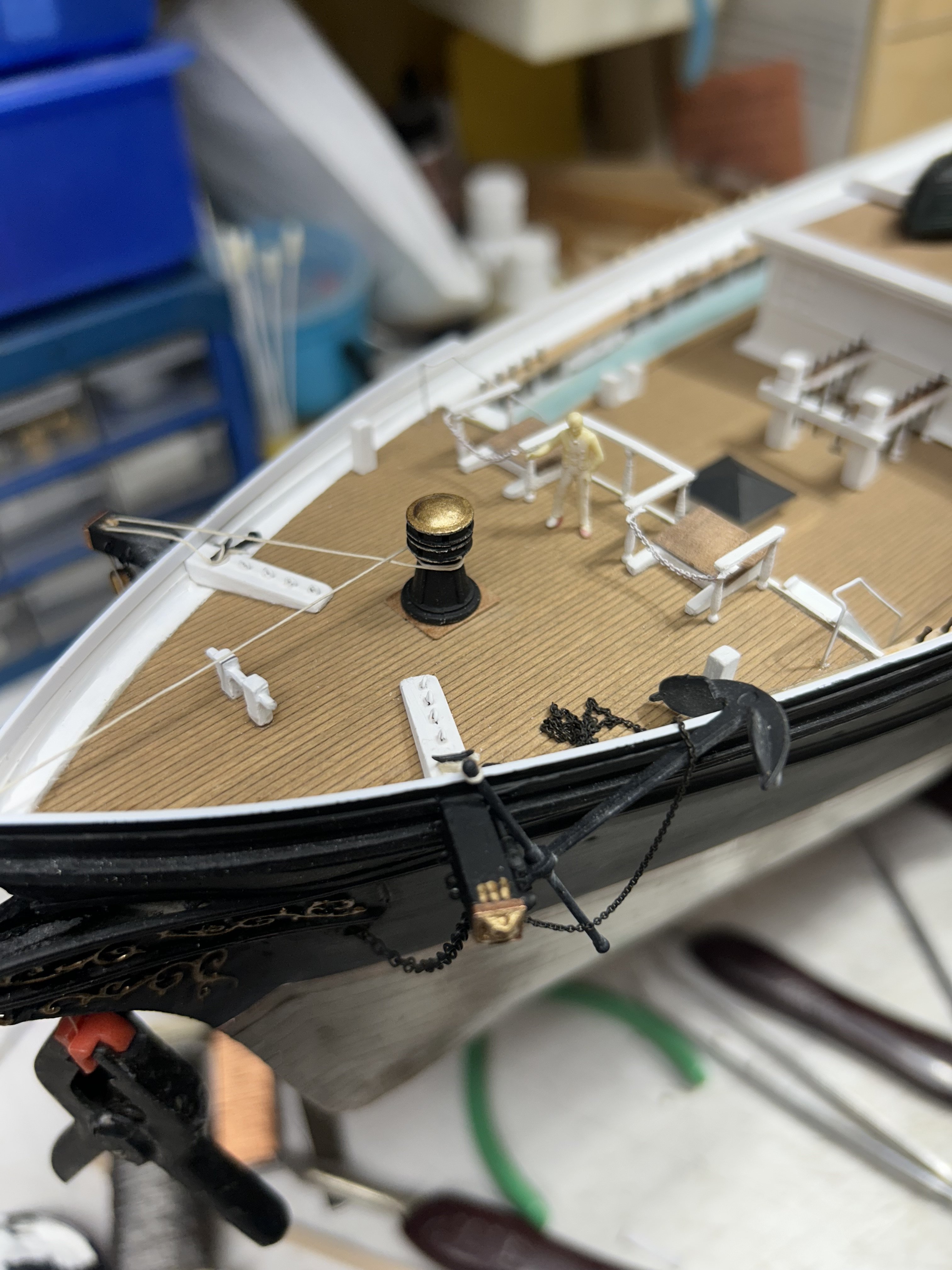

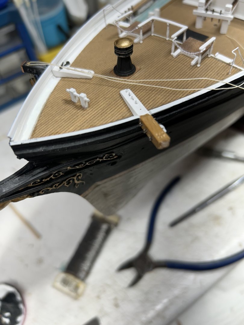

I worked on the port cathead a bit today.
Rob

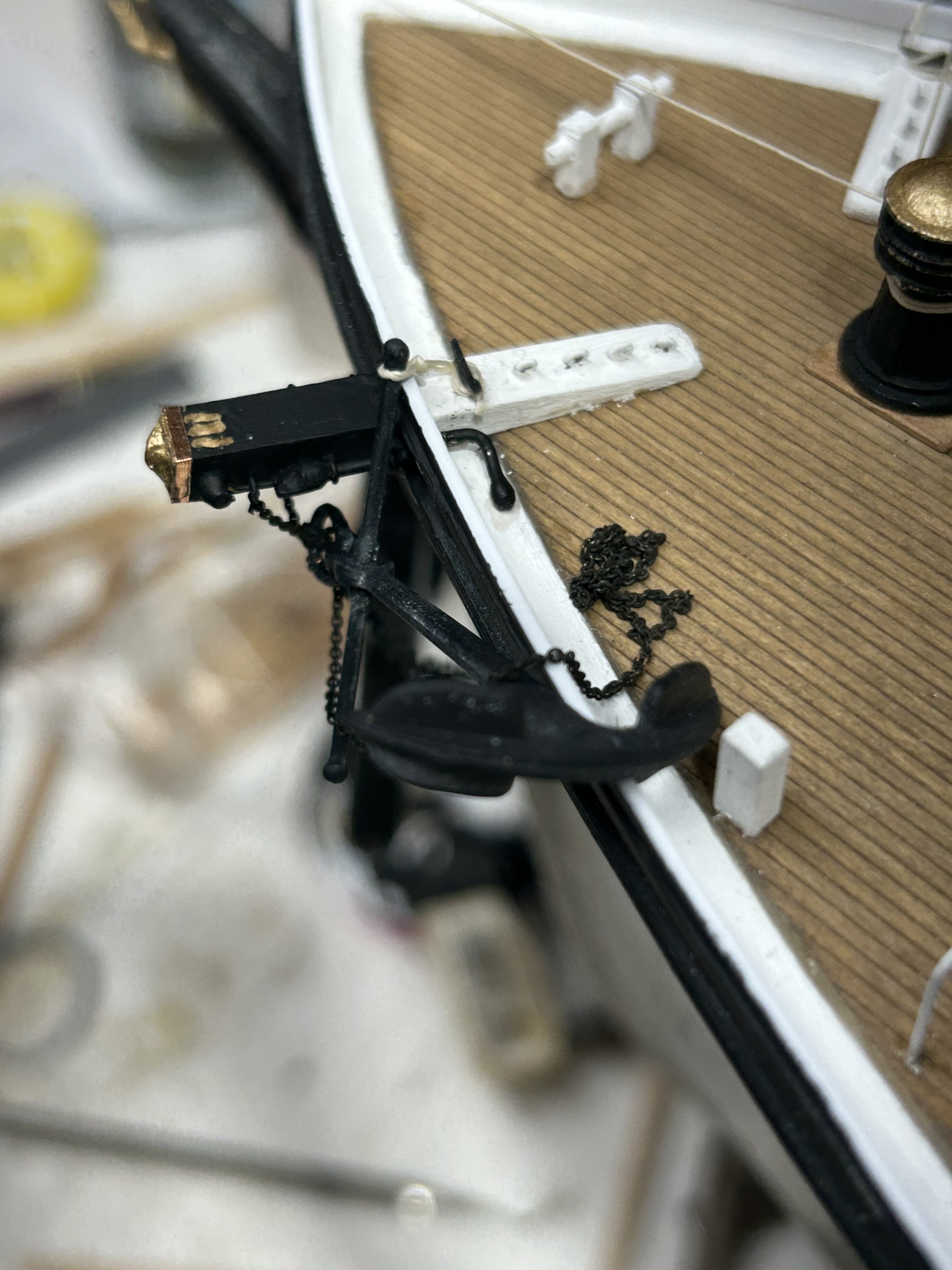

More images.
Rob

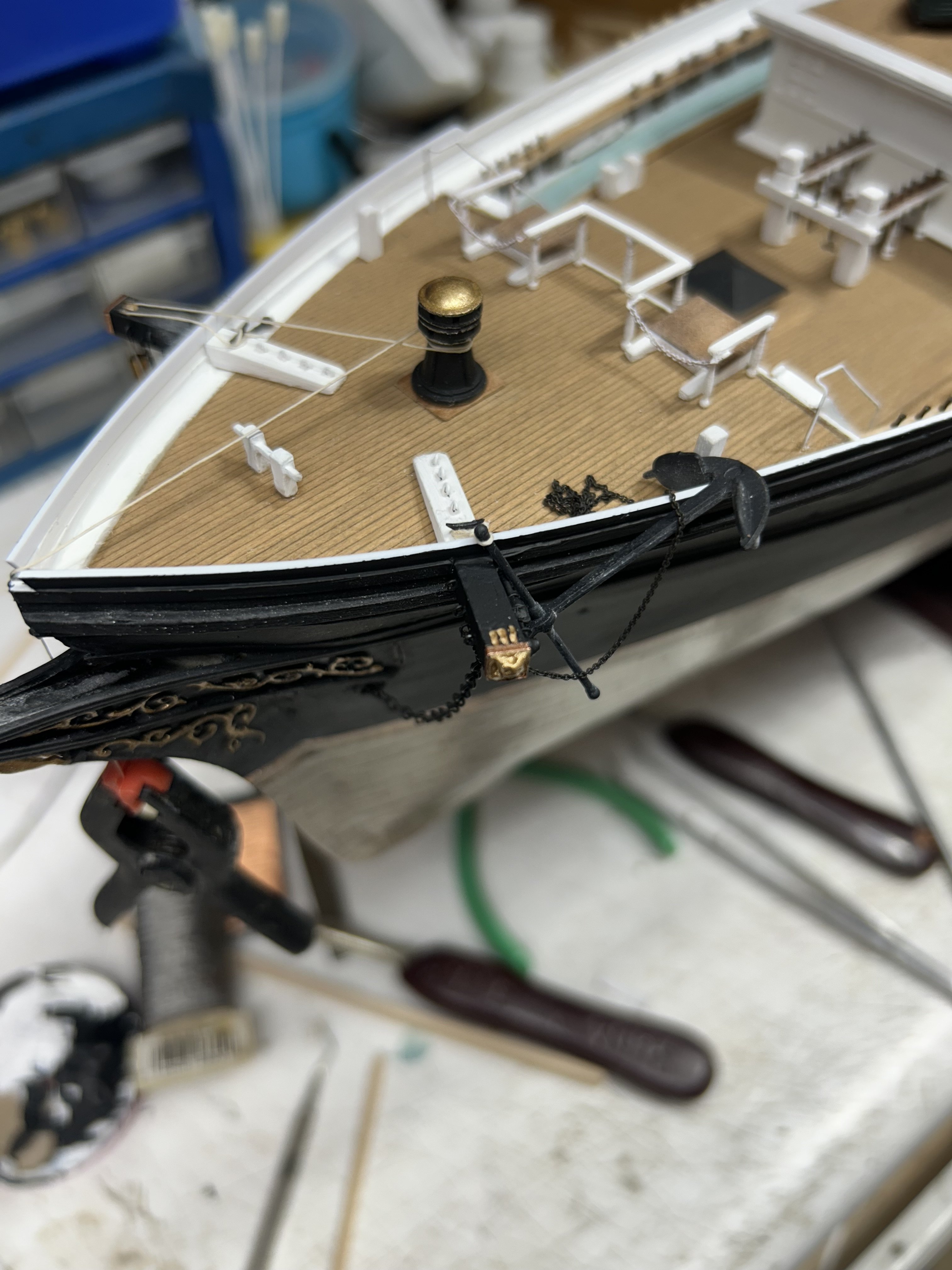

The port anchor will be supported on the splash rail , I think. It’s not finished.
Rob

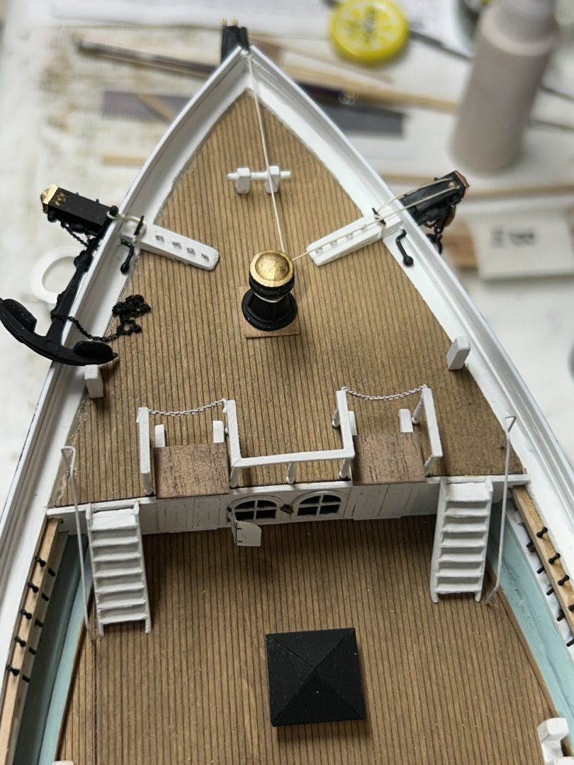

Finishing up with the anchors. Just a couple more things to do.
Rob
