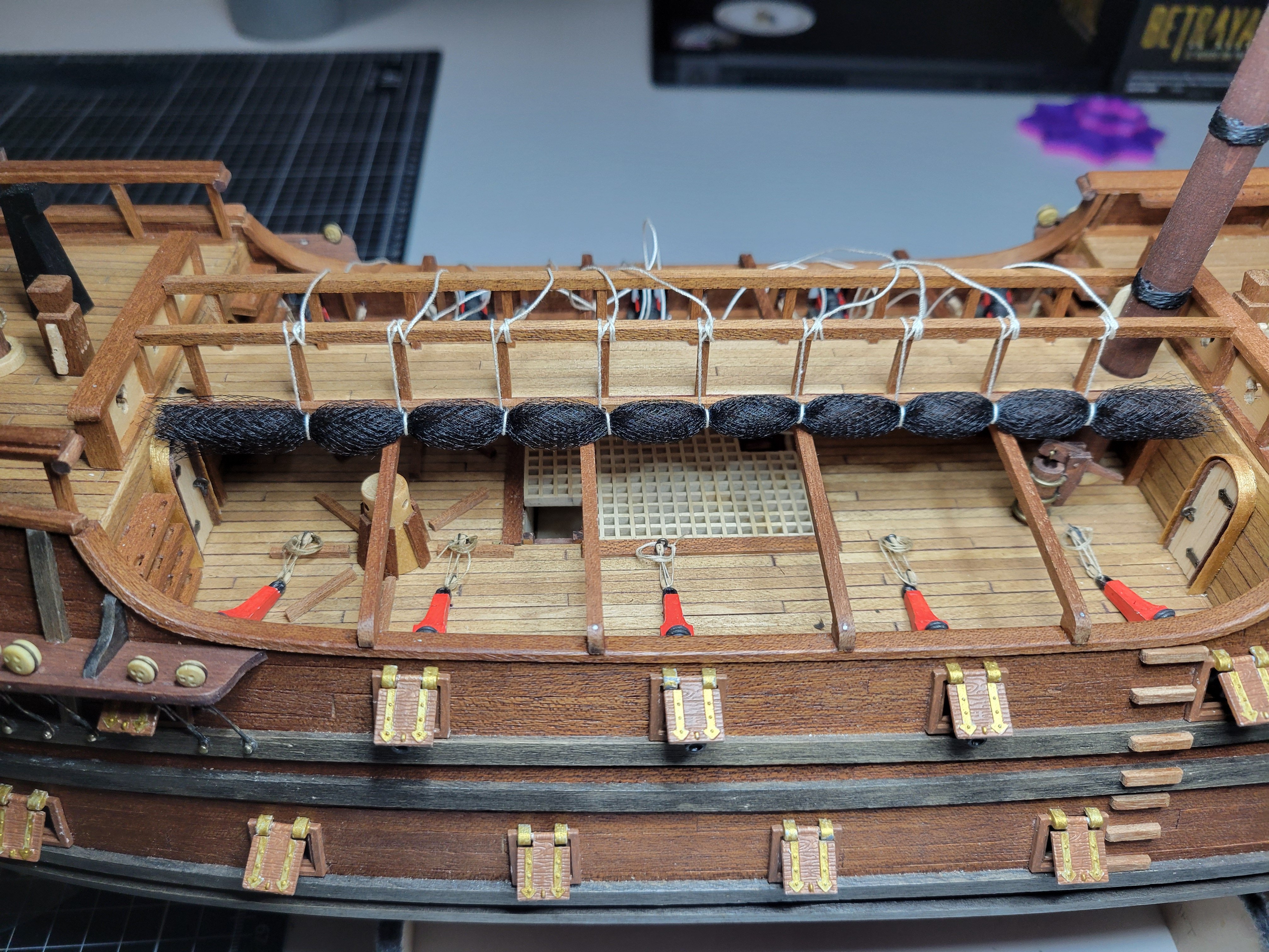

 Ot much available on these nettings/grattings over the gun deck so I'm just going with what makes sense from my own time handling the lines in the navy (granted a modern destroyer is a bit different than a 17th century spanish galleon!).  I figured there would be people "rolling/gathering" the netting from the gun deck and a second team on the walkway above hauling in on the lines.  Once in place they would probably just lash those lines right to the rail with a good ole clove hitch and then coiled on/near the rail.
The mesh netting from Occre was not properly sized (not long enough) and a bit rigid so I replaced with tule fabric which has a smaller grid which fits the scale better and just looks more natural.
Port side set and coiled

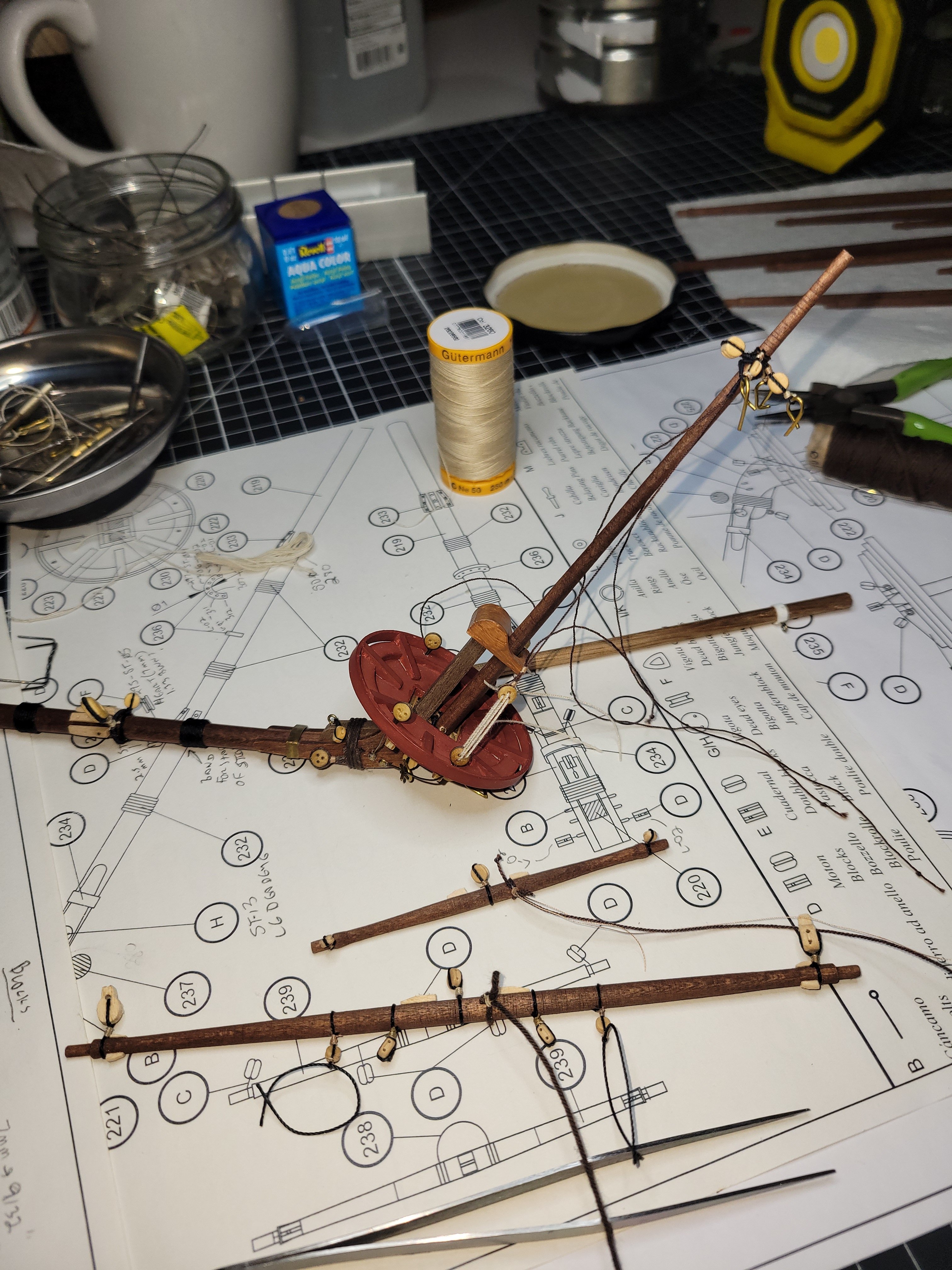

Continuing progress.  Sprit sail yard ready to bend sail.  Spirit top mast rigging and yard in progress.  Rigging the shrouds.  Probably going to set the bowsprit next with the gammoning and bobsays when the shrouds and ratlines are done.
