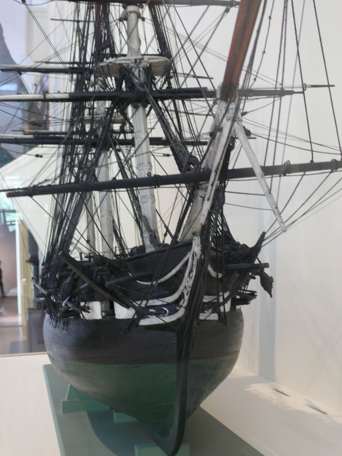

I thought it might be a good idea to give you a heads up concerning the pitfalls I encountered when doing the bowheads in case you are not aware of them already.   The plans given on page 48 of the instruction book represent the restoration which was done in 1978 and is the current configuration.  The scale is not given, but I was able to figure out that it is 1/96, and so can be used as is for the model.   This configuration conflicts with the elevation plan in two ways: the cathead emerges from the hull at the forecastle deck level in the plan and in photo 24 on page 50, but does so just below the caprail on the real ship.  Consequently the photo shows a "squashed" version of the bowhead structure compared to the real thing.  The deck plan also shows the position of the catheads forward of their present position.  I did not catch this until after I finished the build and saw that I had a foreshortened version of the structure.  Here is a build photo of a superb model by Herb Ebson showing the simpler version of the bowheads shown in the Campbell plans:
This is the configuration of the bows that the Revell model uses.  The Model Shipways Constitution uses the current appearance.  Perhaps one of the many builders of that kit might be willing to share the measurement from the stem to the cathead if you decide to use the plans given on page 48.  By the way, the Ebson model uses real trennels, not simulated ones, and there are working brass sheaves in all the blocks.
In case you do not already have them, here are some photos of the real ship you might find useful:
Note the complex curves and variable beveling of the outboard edges of the bowhead timbers.   Whenever I see a model of the Constitution, the first thing I look at is the bowhead.  That is the most difficult part of the build in my opinion., and the Constitution bow is the most complex and challenging of any ship I have yet seen.  The most successful rendering of this that I have seen is a build from the MS kit by Jerod Matwiy:
One more thing.  The cast metal trailboard provided in the kit is different from the current version, so some creative fettlin' will be needed to integrate it into the current configuration.
Kurt, where may I see more pictures of Herb Ebson's and Jerod Matwiy's models?

Hi Kurt,
Thanks for the heads up and all the very useful info and photos. I have already been a bit perplexed by the position of the catheads. The "simplified" version definitely looks like it would be easier to do, and I am trying to be true to her appearance in 1812, but esthetically, I feel compelled to stay with the current configuration. The way the second rail fairs into the cathead, although complex (and intimidating) looks so much more elegant. I'm curious if this version was actually a quick fix after the damage suffered in the collision with USS President that didn't get changed until a later restoration?
Jon, you are the man with the photos. Do you have any that show a pretty good view of the bowhwead on the Hull model?
Frank
Here are a few more
Jon

Thanks guys, as usual, both of you have been a huge help. Jon, once again impressed with your library of photos. Of course, all of this has given me a lot to ponder. Although I really like the look of the current bowhead rails, I did start this project with the intention of building her as she was in 1812 against Guerriere. I have to assume that the men who made the Hull model knew what their ship looked like. With that in mind, i think I will proceed with this simplified version. Of note to me, the bowhead timbers are all black without the white trim they have now. The second rail (Lower rail) is completely absent. The upper half of the bulwarks is open all the way back to the first carronades. The boomkins protruding from the bowhead is non-existent today. i assume these were replaced by some of the hardware attached to the sides of the catheads now? Lastly, the top of the false rail is black, and not white as it is now. I'm sure there are a few other details, but those are the ones that stand out most to me
Frank
In a book of photos published in 1991 which I bought when I visited Constitution,  foretack boomkins are in place.  They look identical to those on the Hull model.  I am guessing that since the courses were not set when they last sailed her, and likely will not be set if they sail her again, the boomkins will  no longer be needed, hence their present absence.
