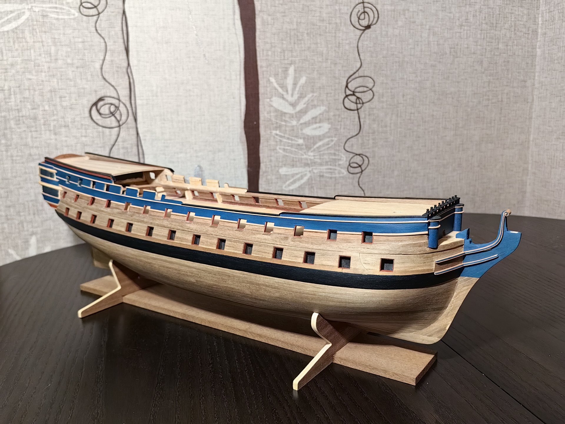

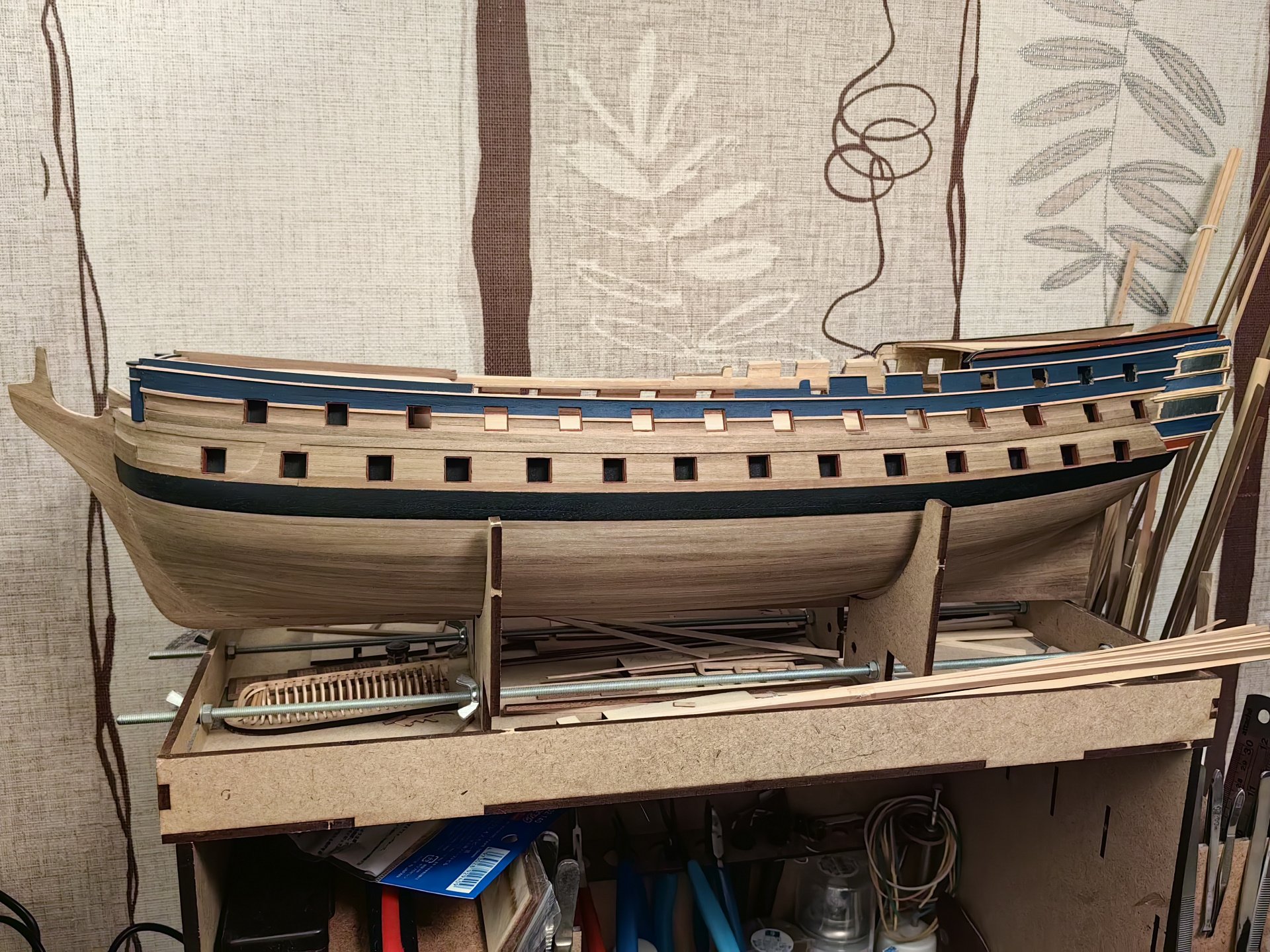

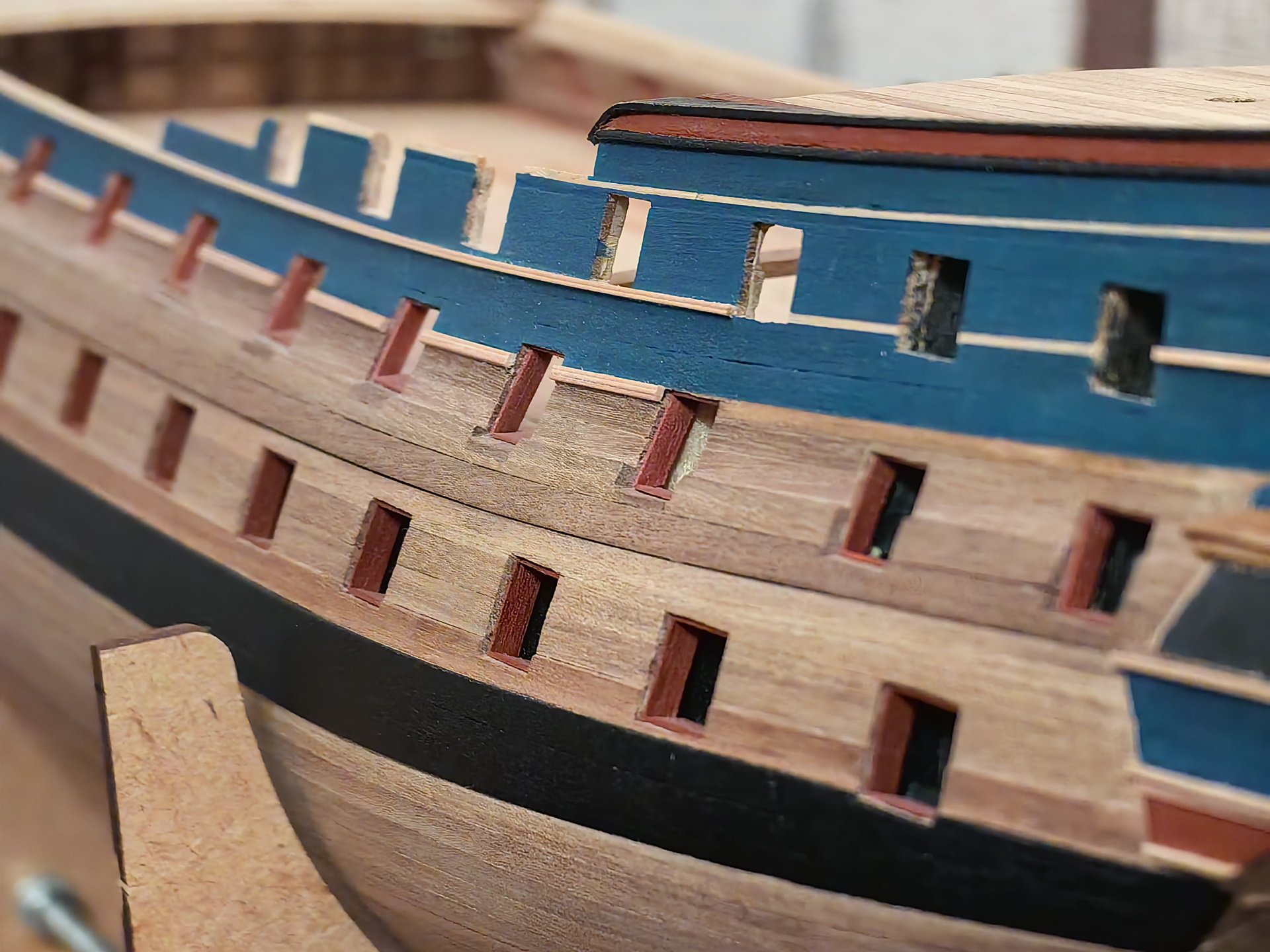

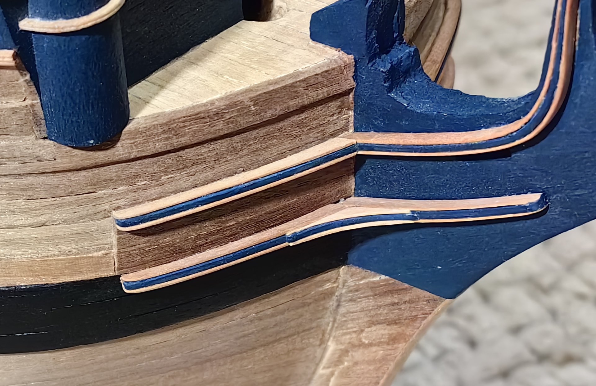

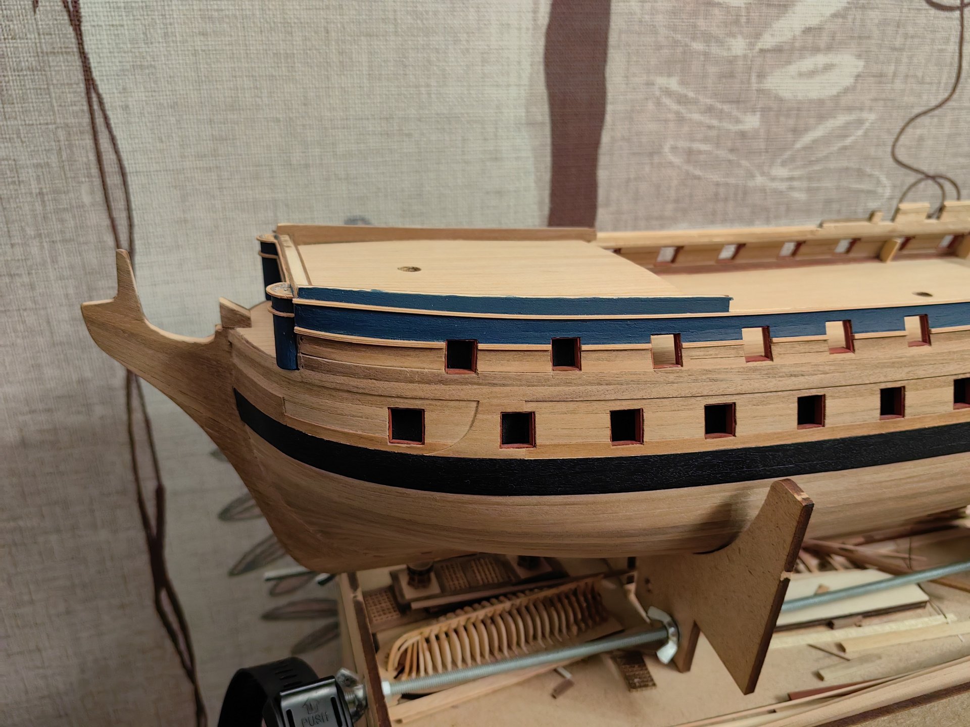

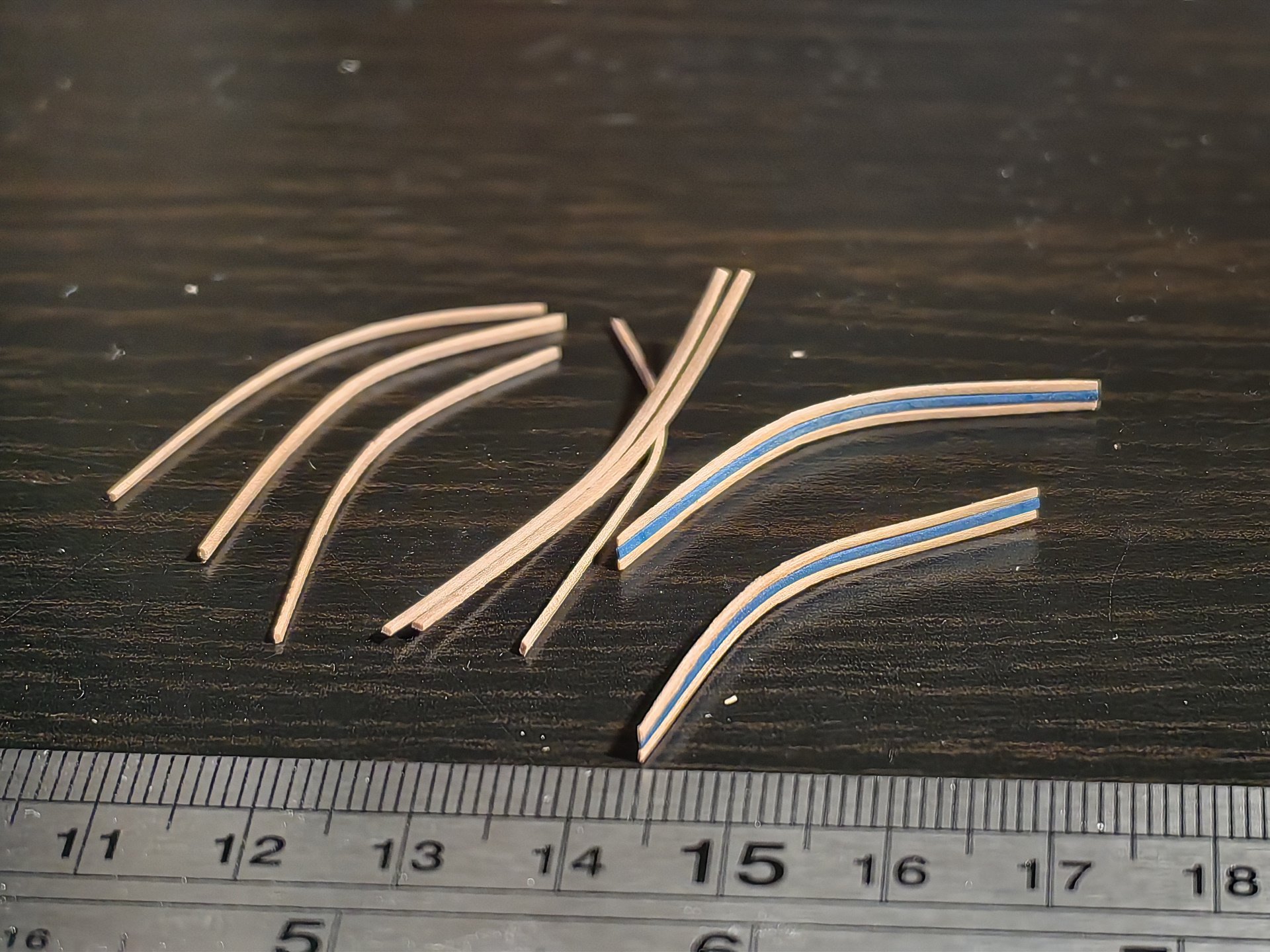

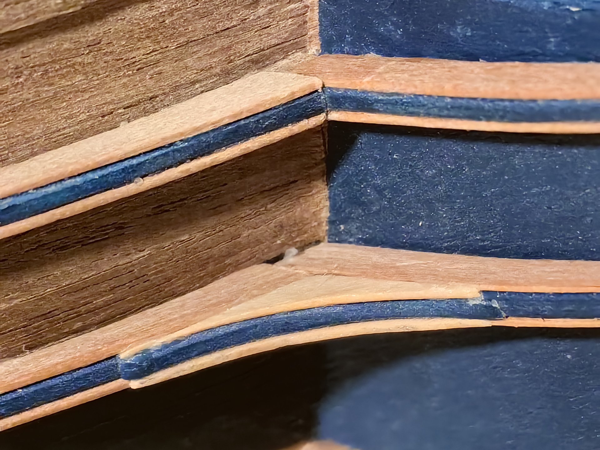

After holding the already painted body in my hands, it is not very pleasant to see it with peeled-off sides. I'm in a hurry to return the model to its former appearance, correcting mistakes along the way. Painted again, using masking tape as a separator. Since PVA glue does not adhere well to acrylic paint, I left unpainted strips for the rails to be glued.

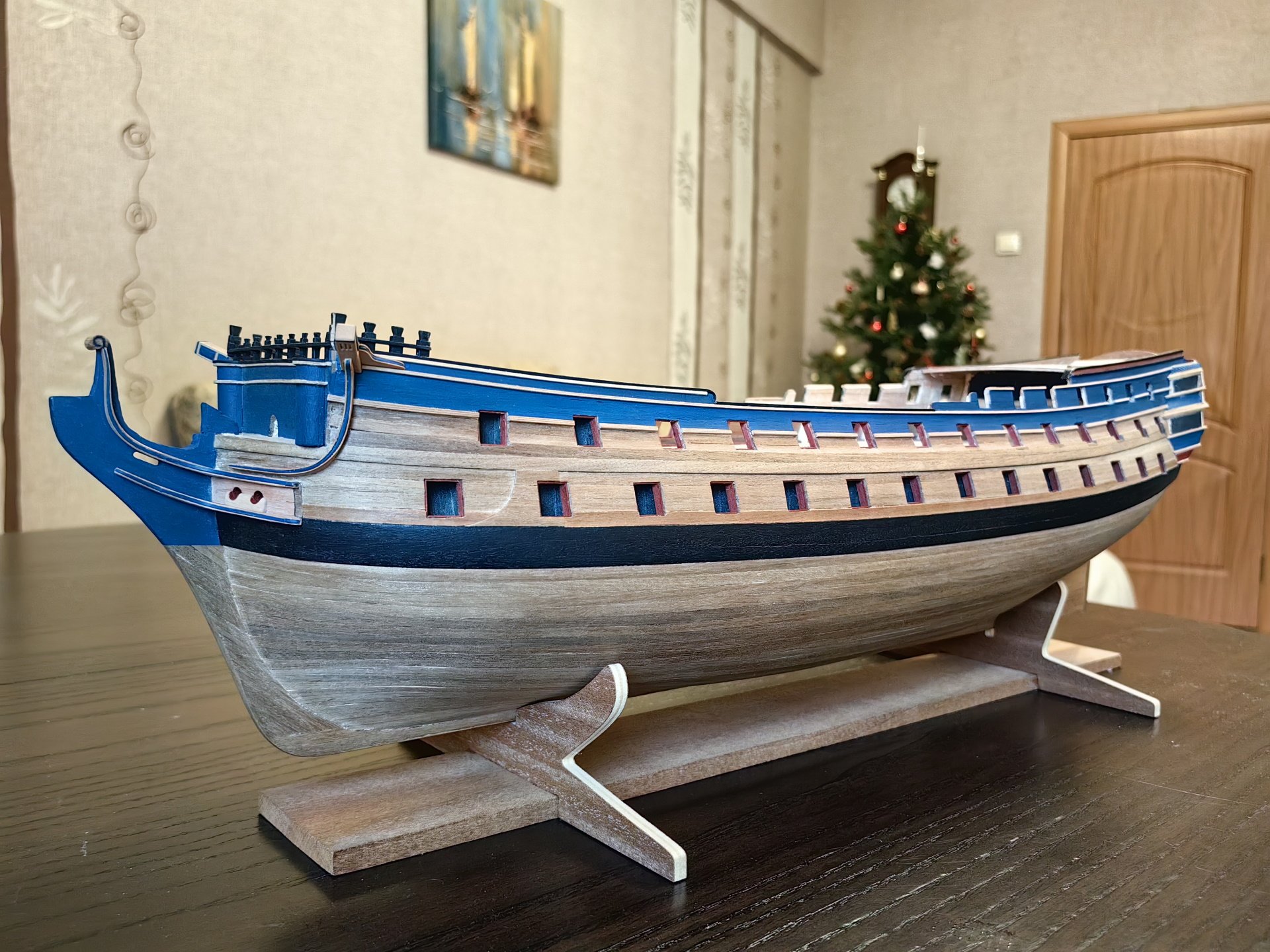

Hello everyone!

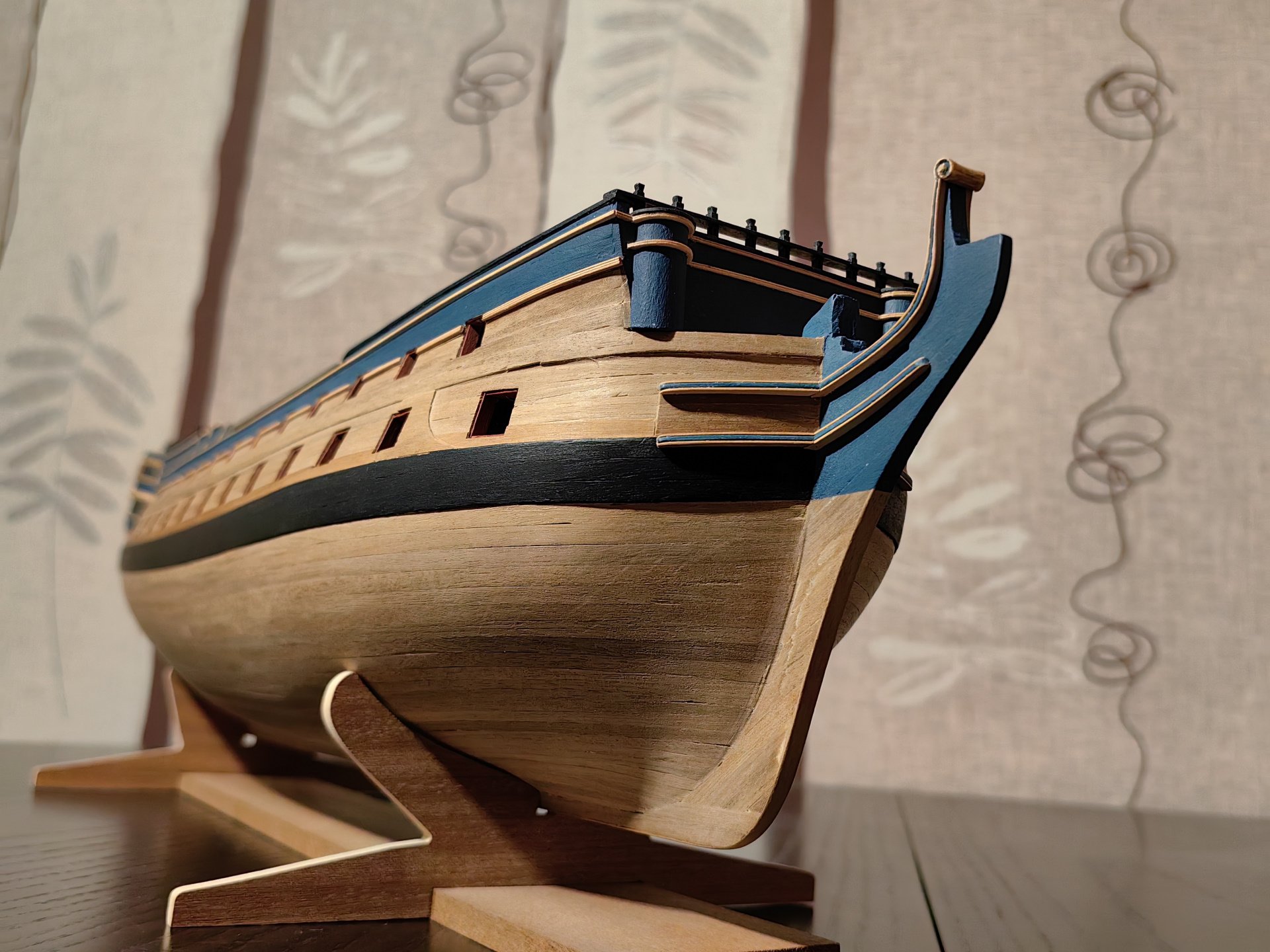

Finally, the model has taken the same appearance as it did before the upgrade! New rails have been installed. They are made of a pear-shaped slat  with a 1x1 mm cross-section, which has been pre-shaped. When I looked at numerous photos of museum models, I noticed that in many cases, the  waist  rail was wider than the others, so I decided to do the same. I didn't have a 1x1.5 mm rail, so I glued another 0.5 mm rail to the existing one, rounding its edge first. Since the  waist  rail runs along the main deck, interrupted by the gun ports, I glued it in short sections.

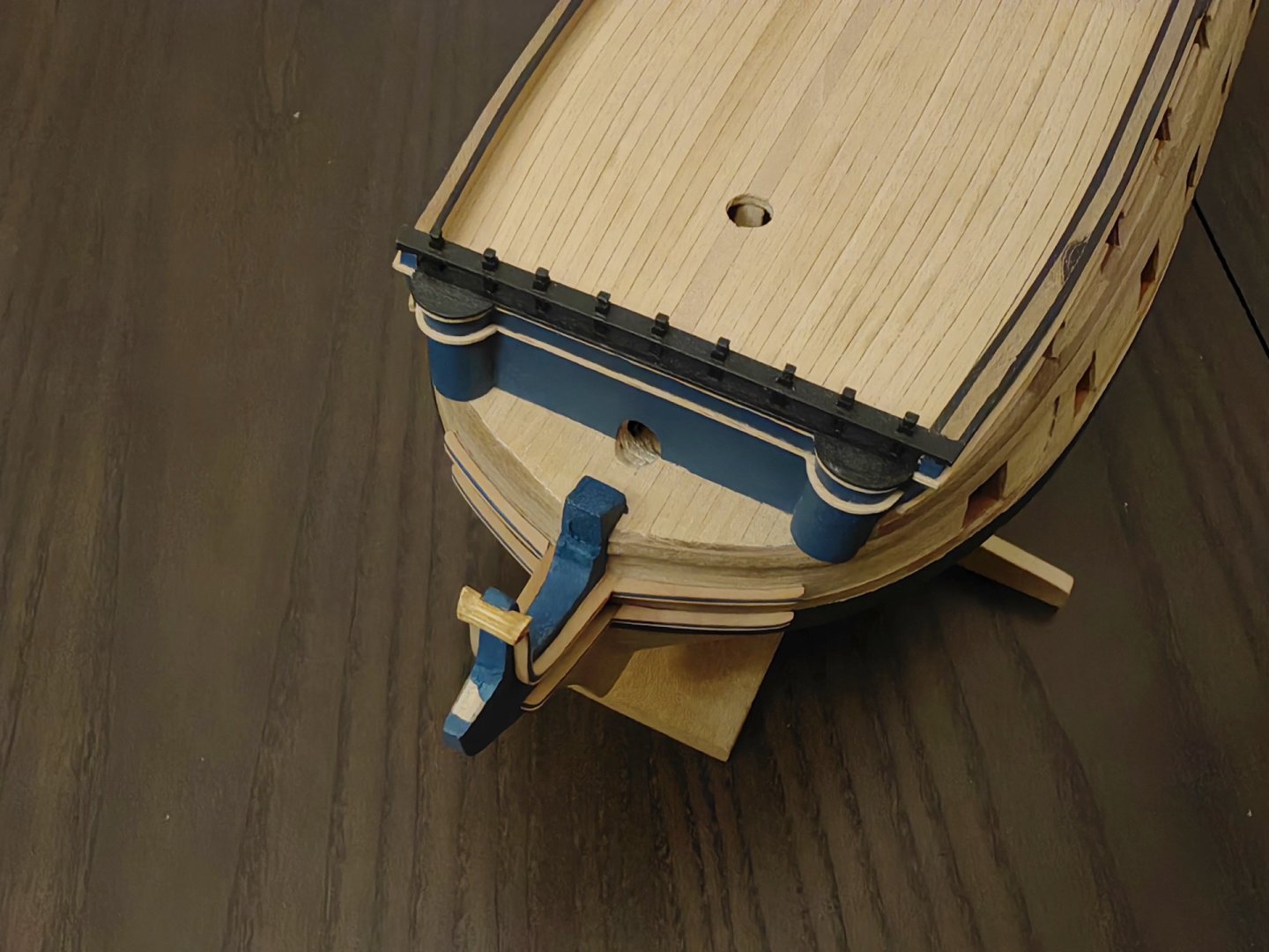

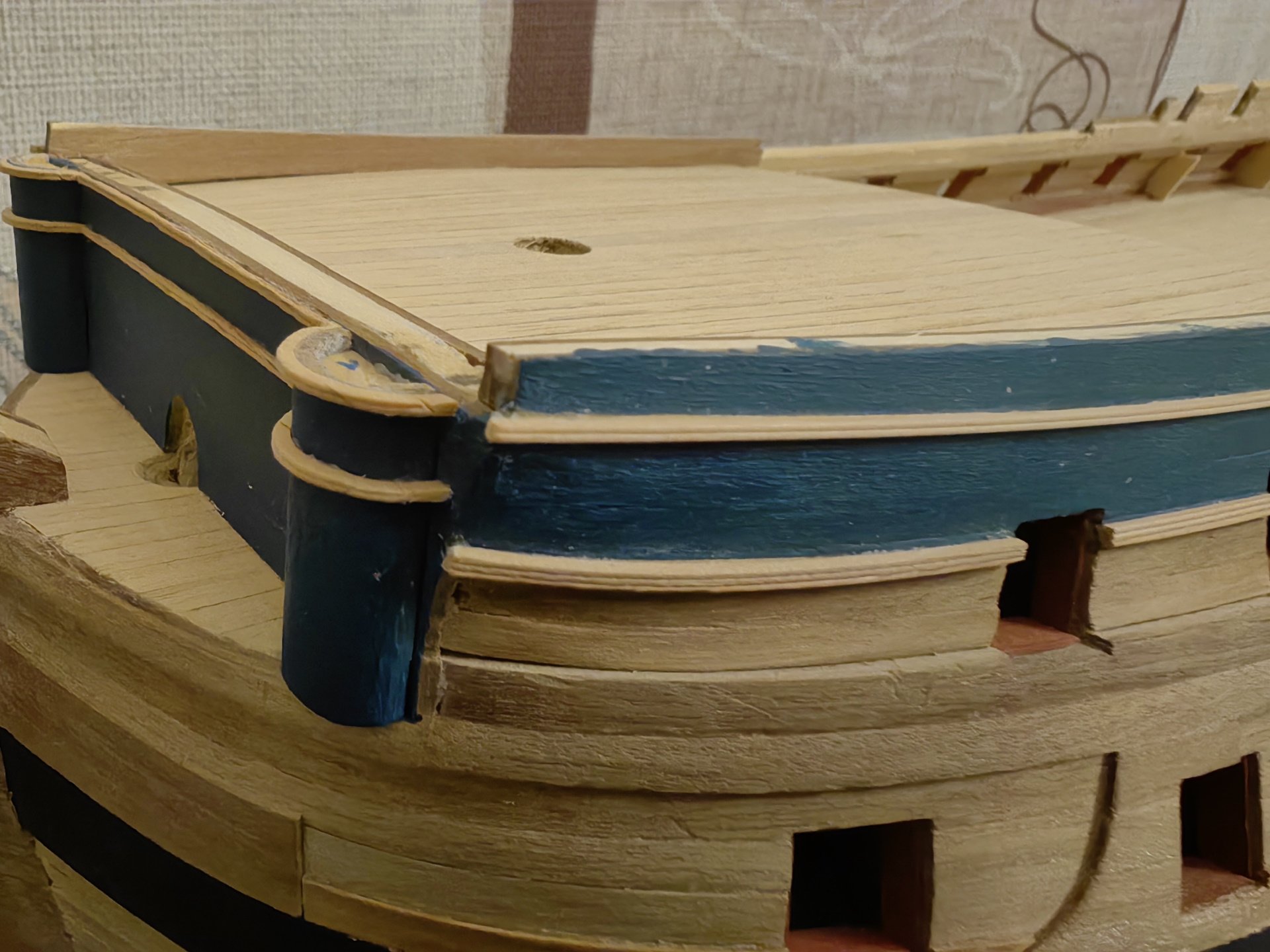

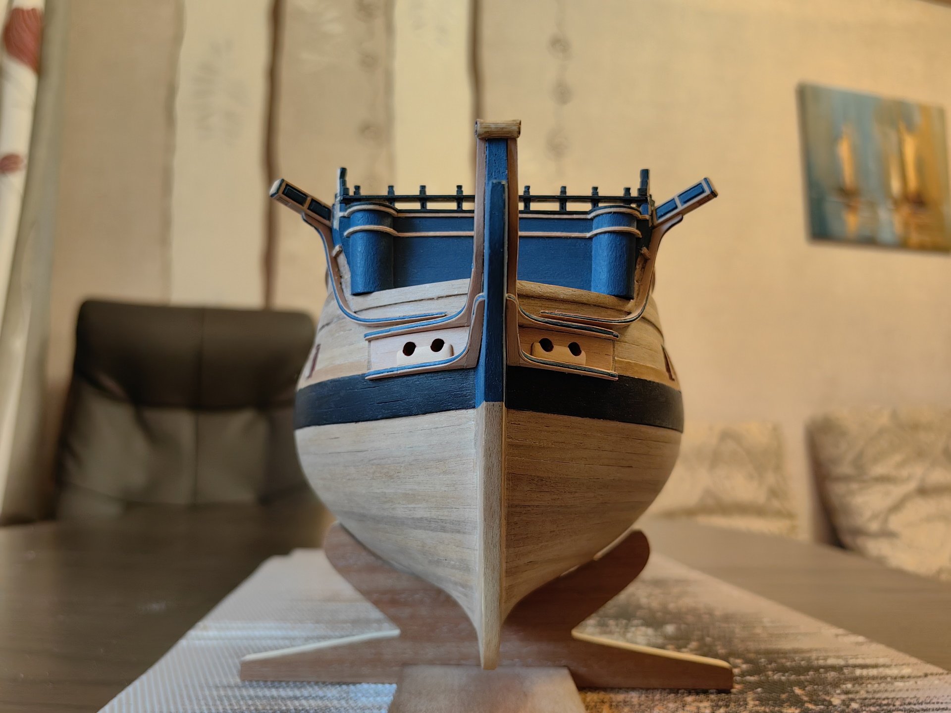

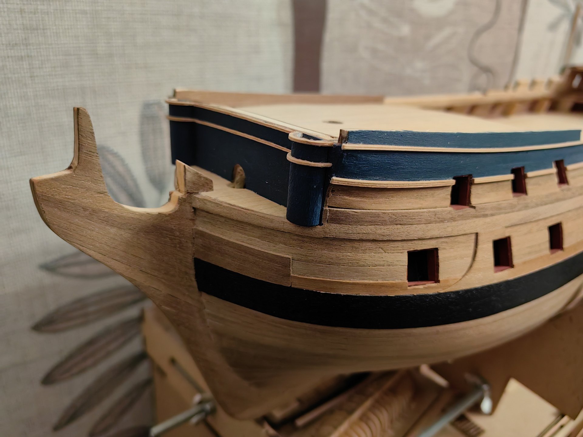

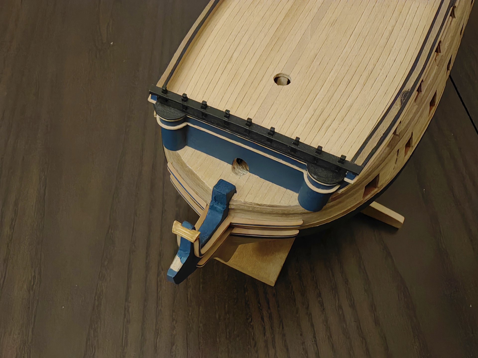

I've replaced all the rails that were part of the second layer of the model's sheathing, installed the planksheer on the beakhead, and the roof of the roundhouses.
I'm currently working on the rails and top timbers of the foredeck and beakhead.
Edited by Frecap

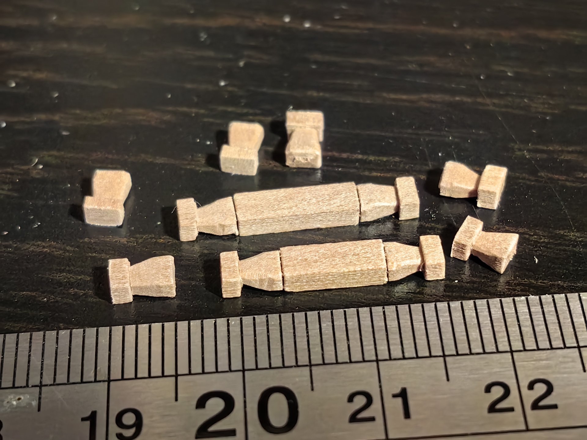

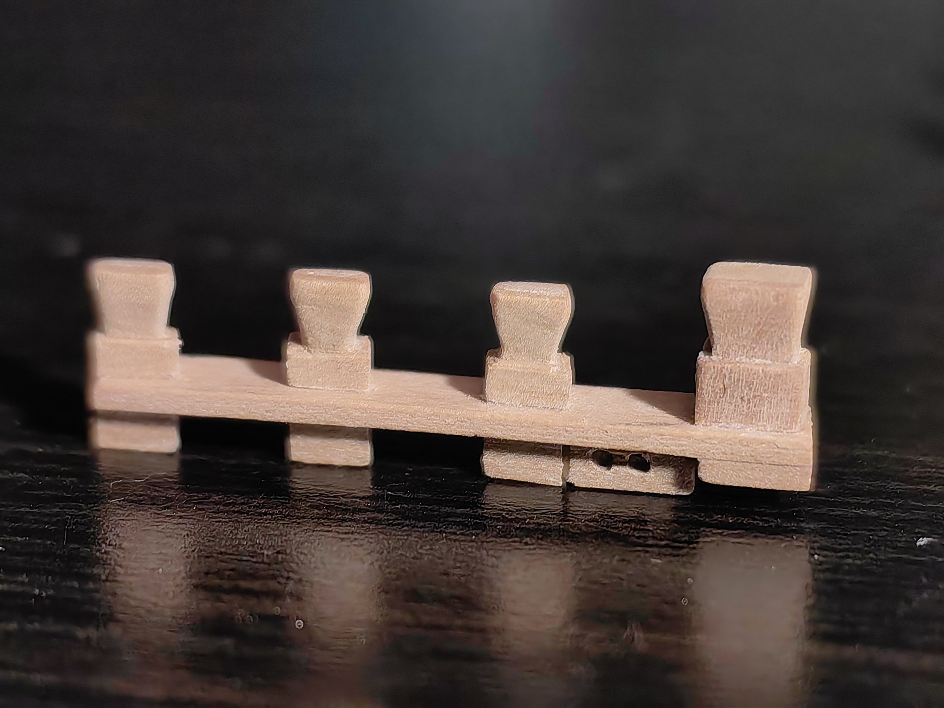

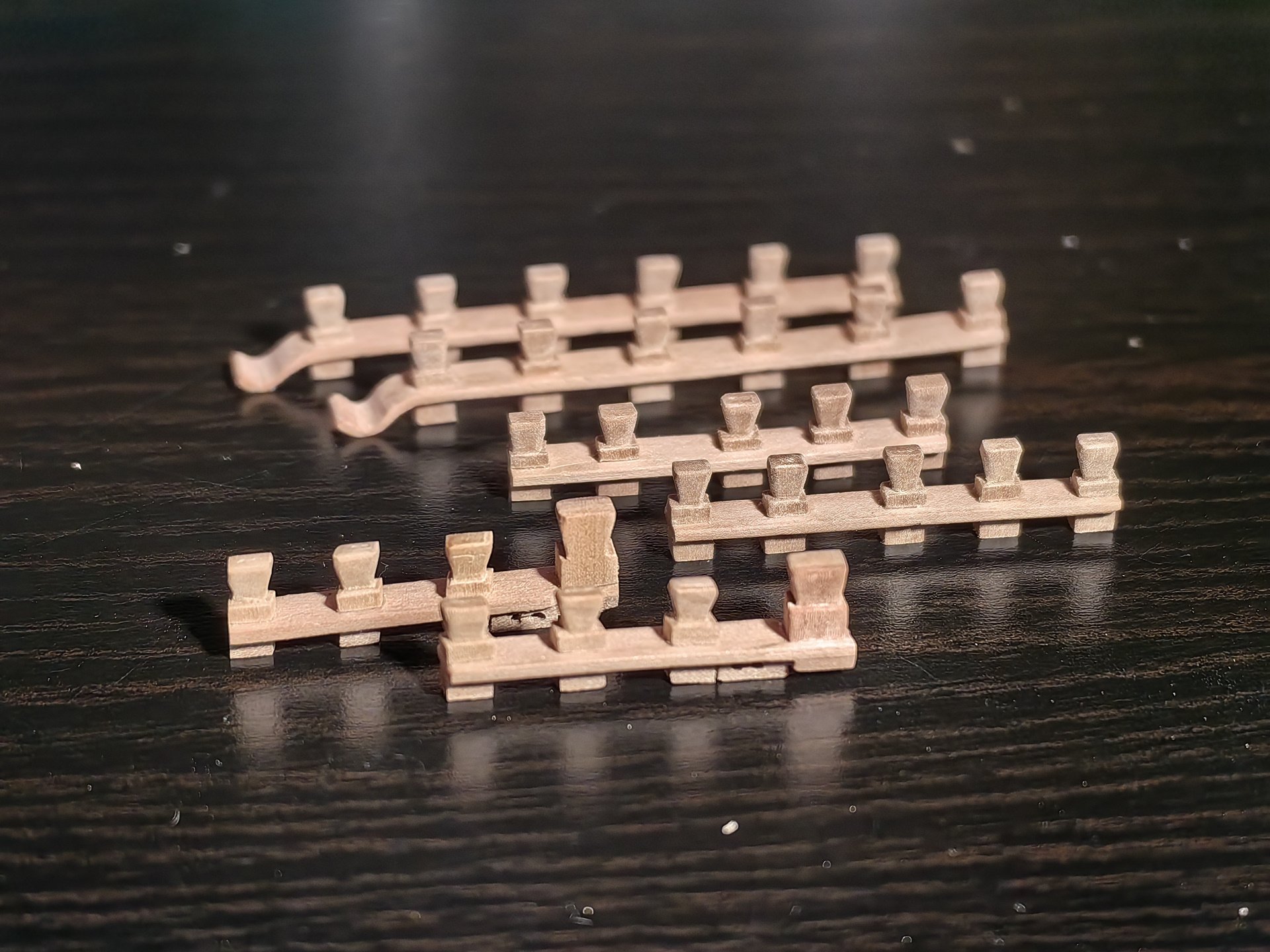

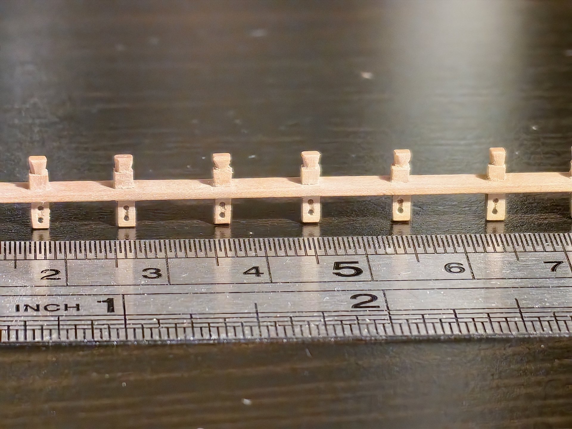

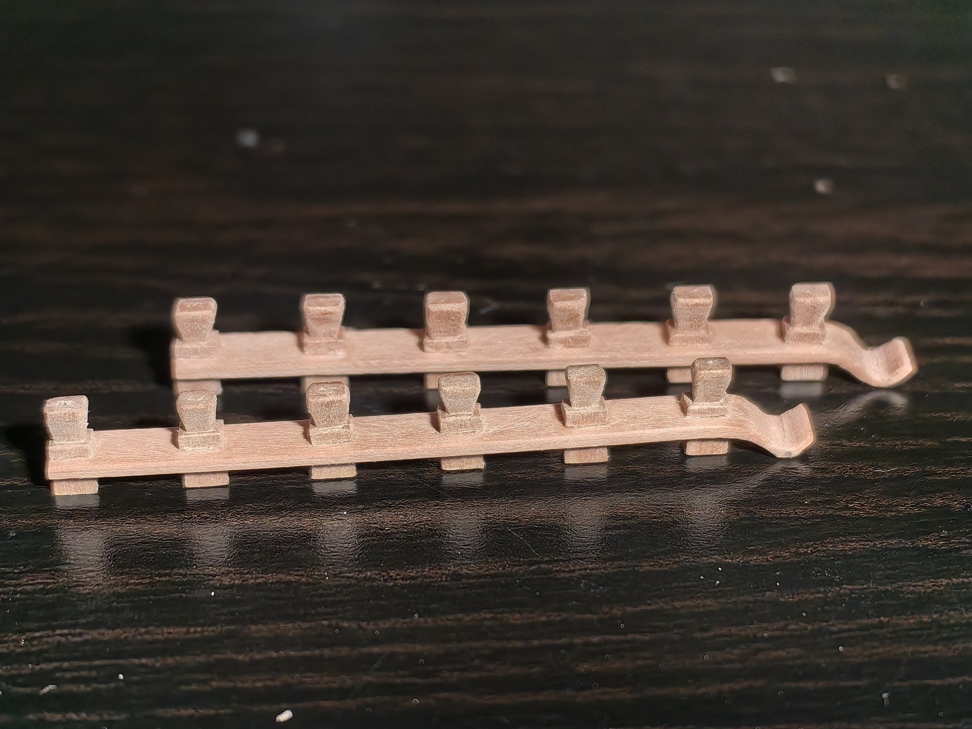

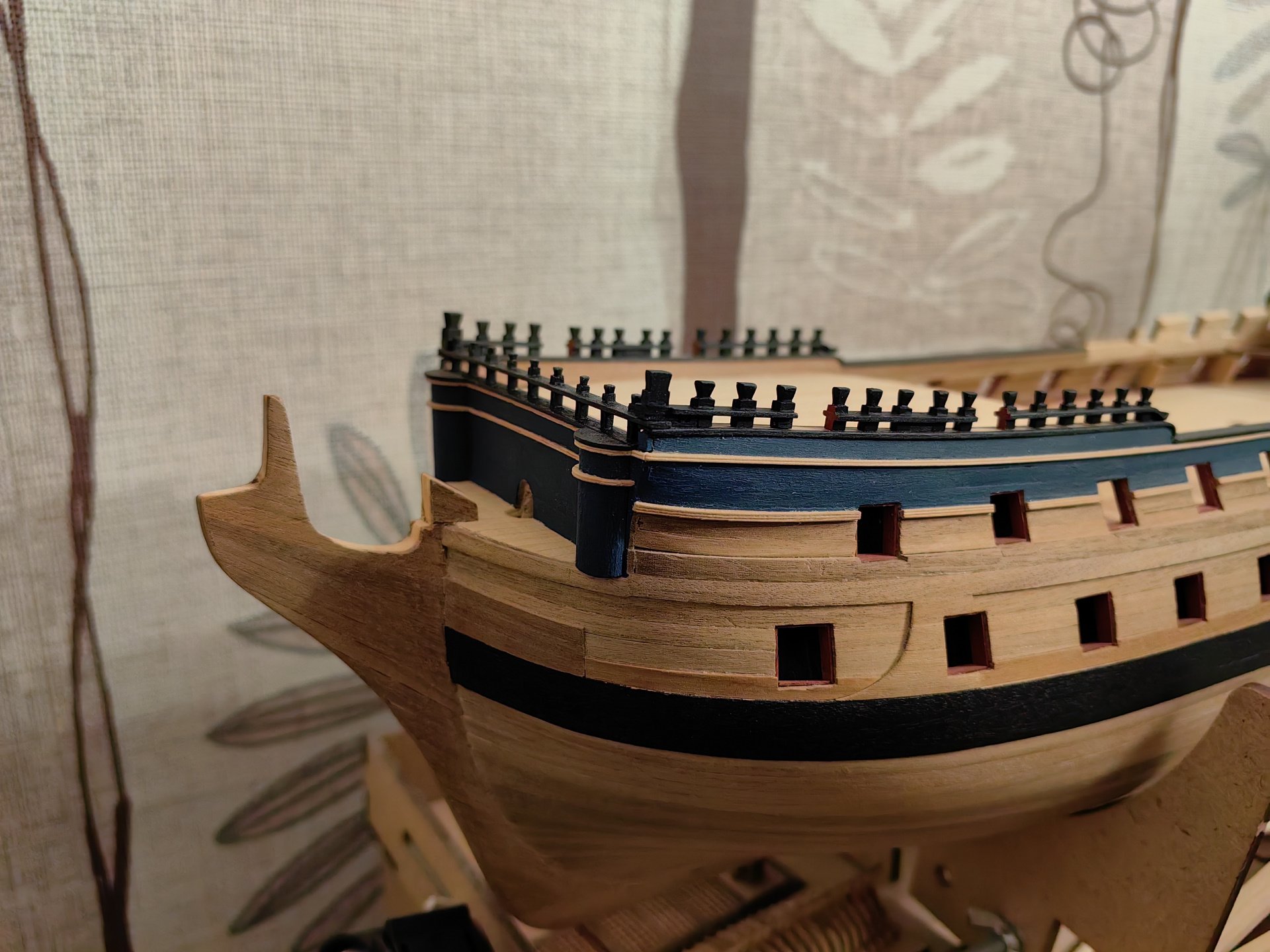

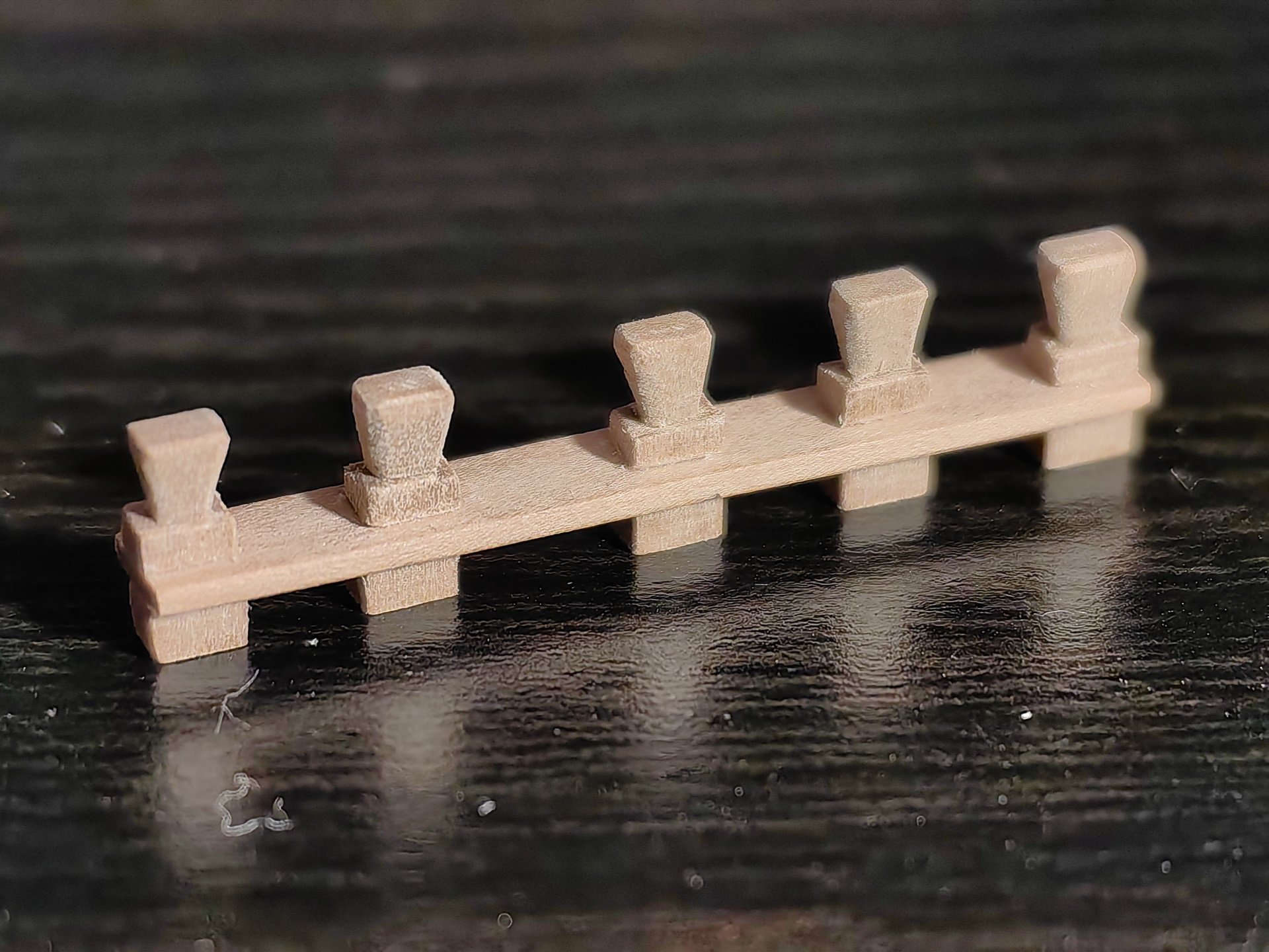

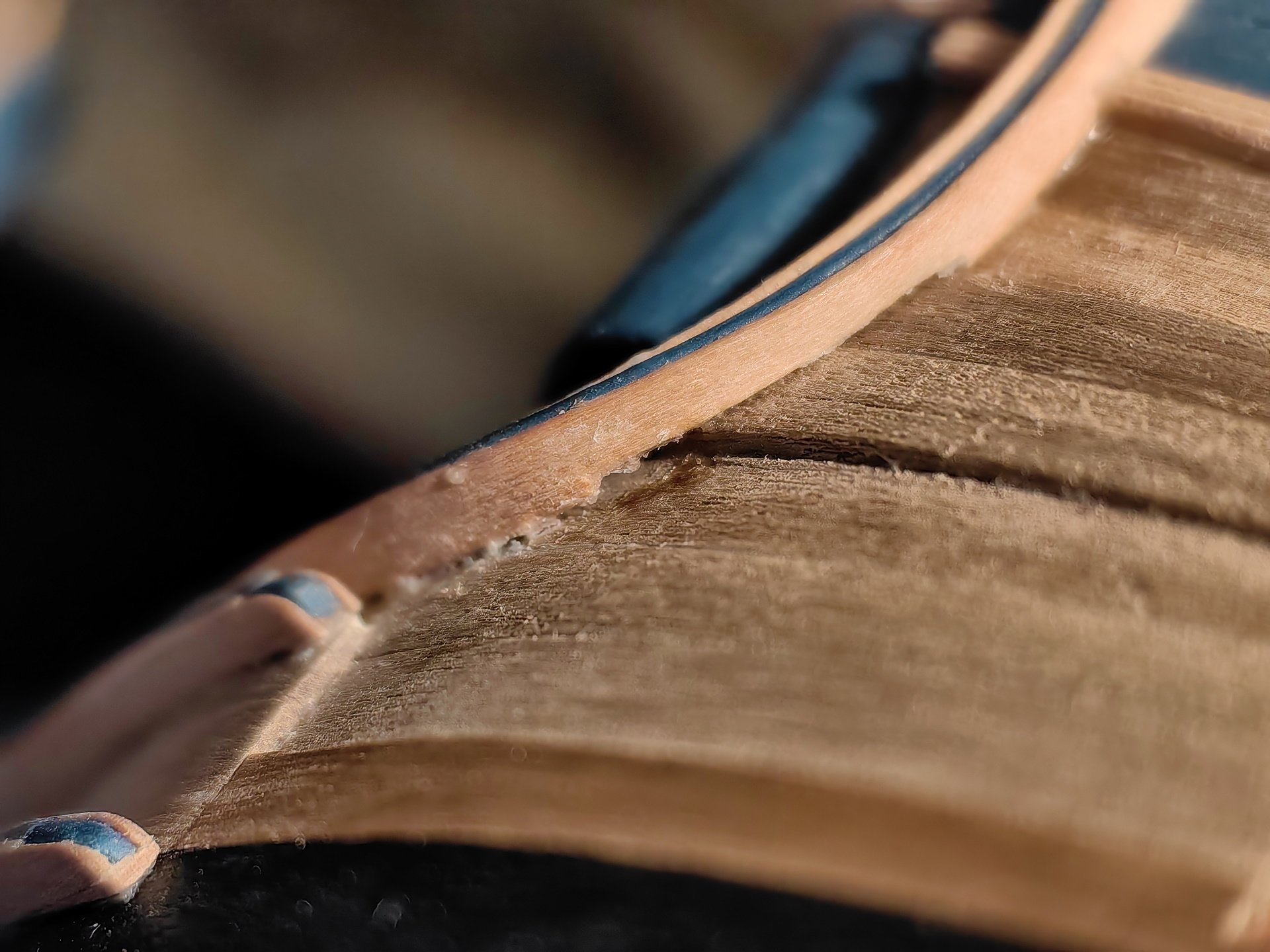

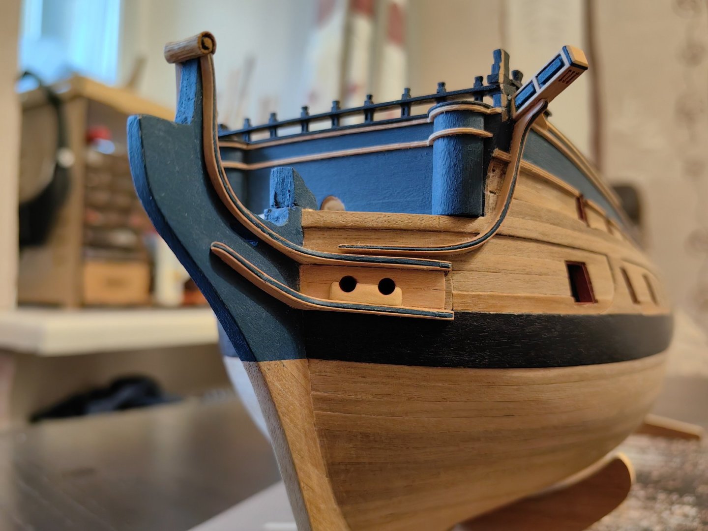

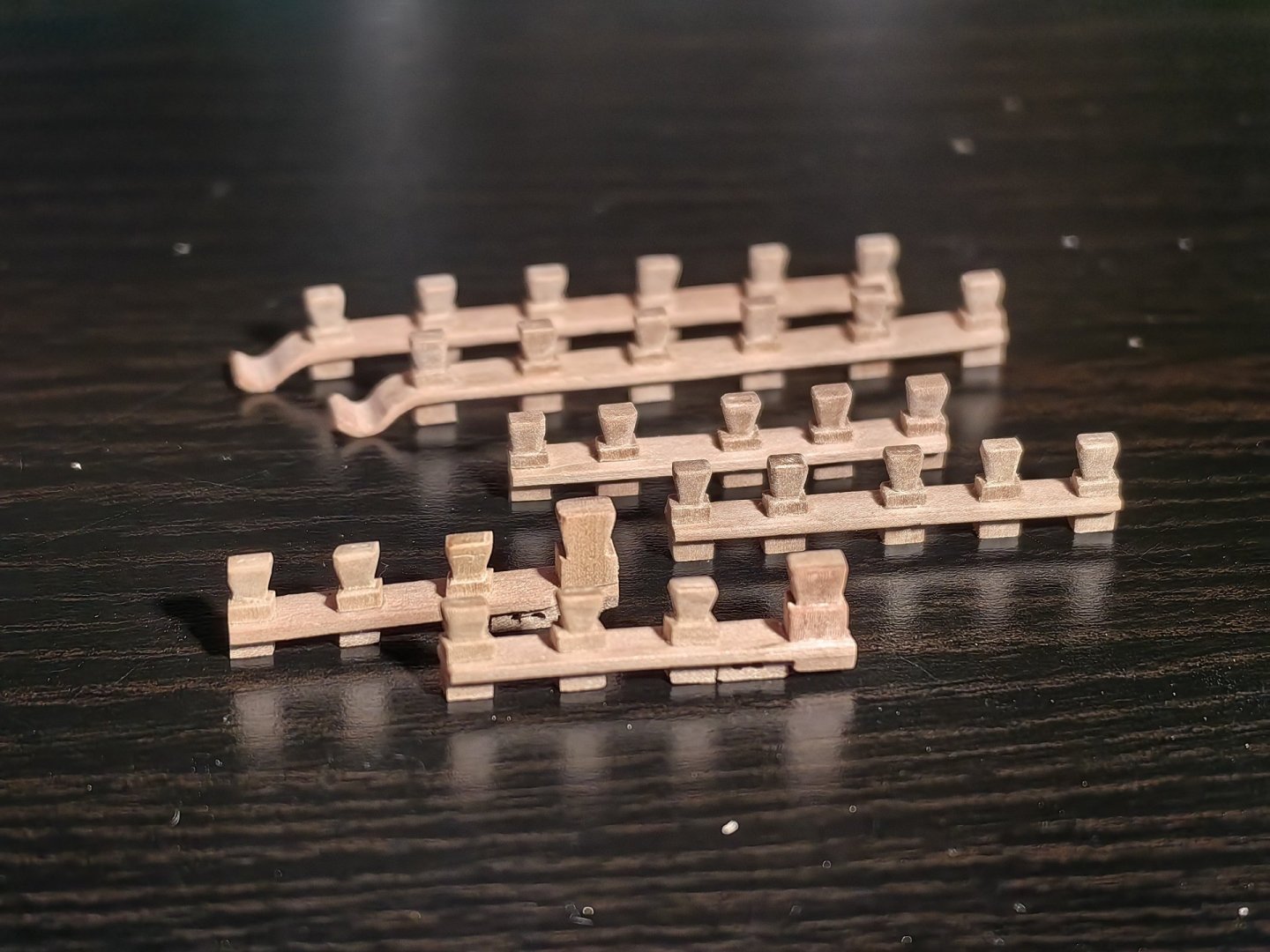

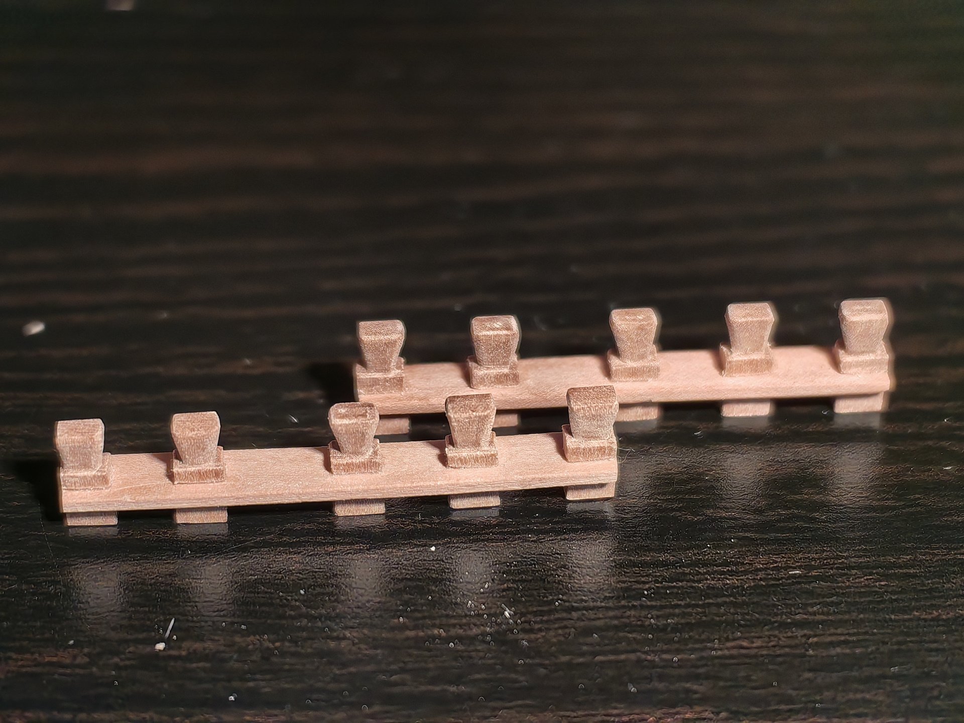

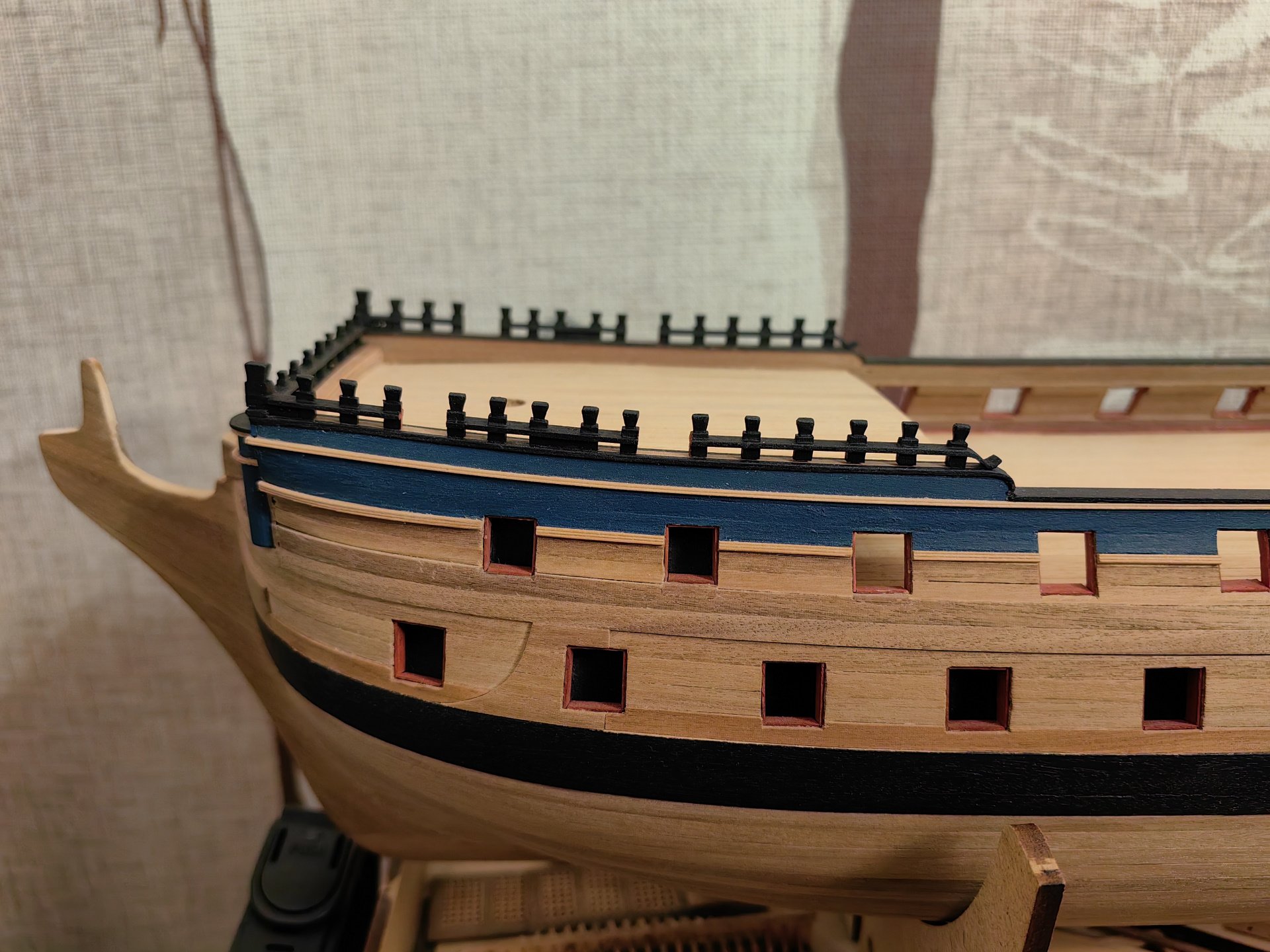

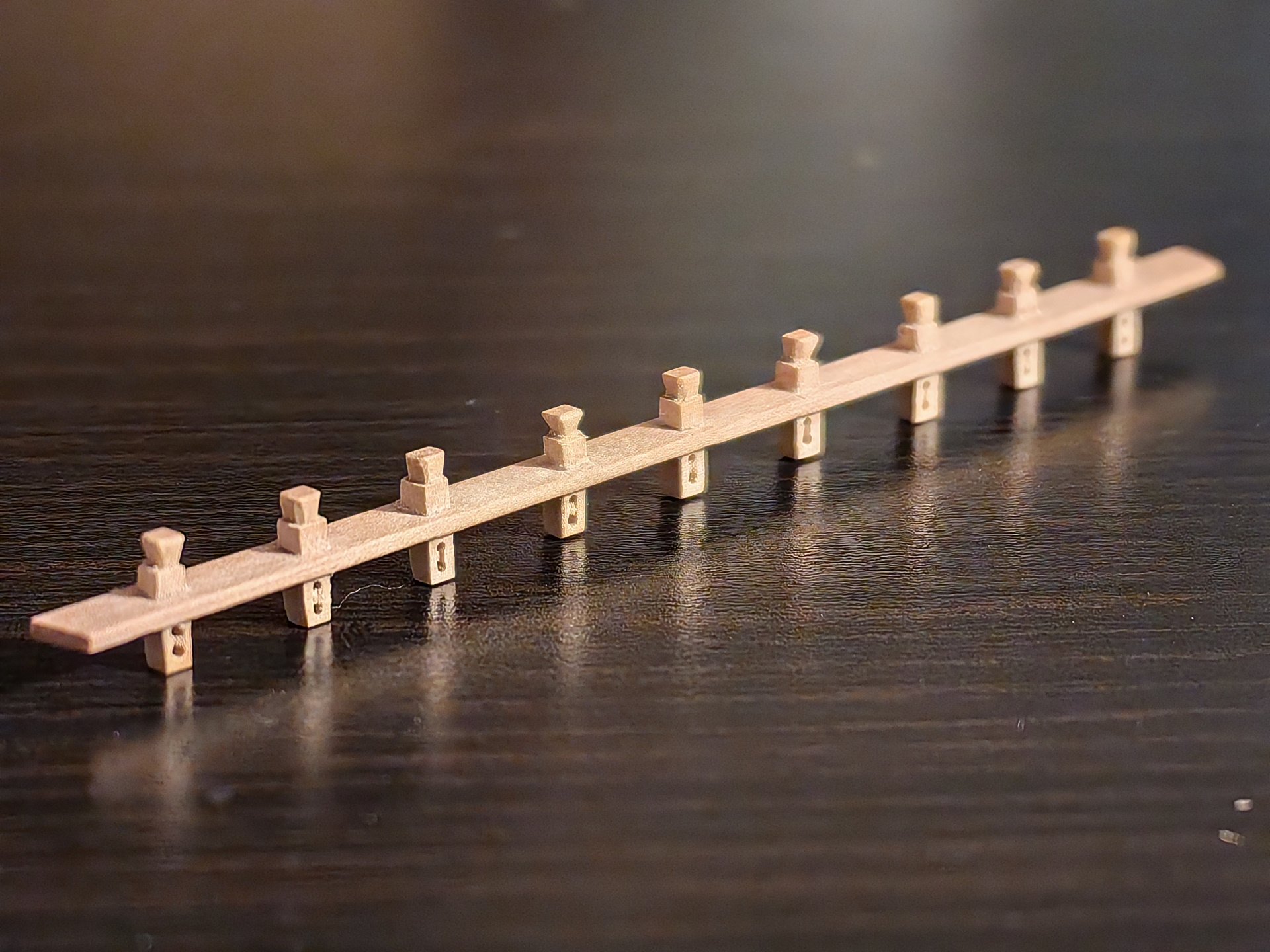

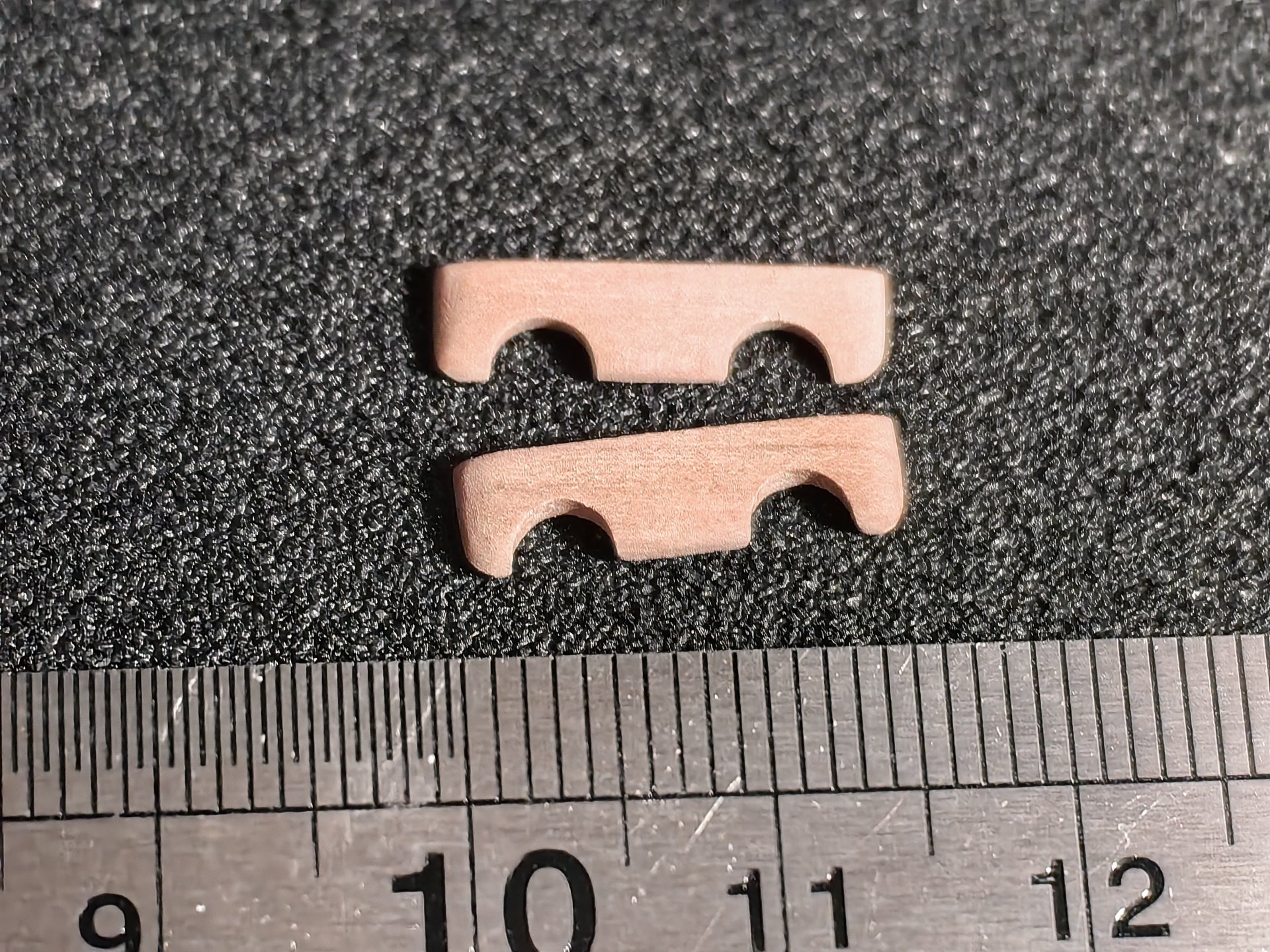

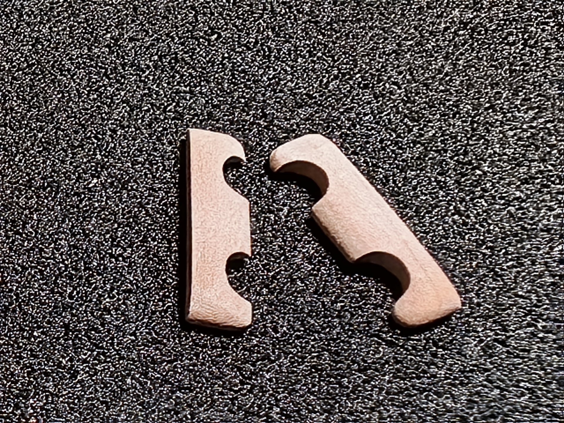

Here are some photos from the process of making the fordeck's railing. I appreciated the benefits of the pear wood and purchased several different sizes of planks and use them whenever possible. The top timbers of the fordeck's bulwarks form the gun ports, and as a result, the fife rail consists of three parts. Since the bulwarks converge strongly towards the bow, the group of bow top timbers has a parallelogram cross-section. This is also shown in Corel's drawings. I didn't bother with the rest and made them rectangular. Many small details have to be made by hand. Of course, it is difficult to achieve their full identity. But all the photos are taken with magnification, in reality the difference is not so noticeable. Especially all this will be painted black.

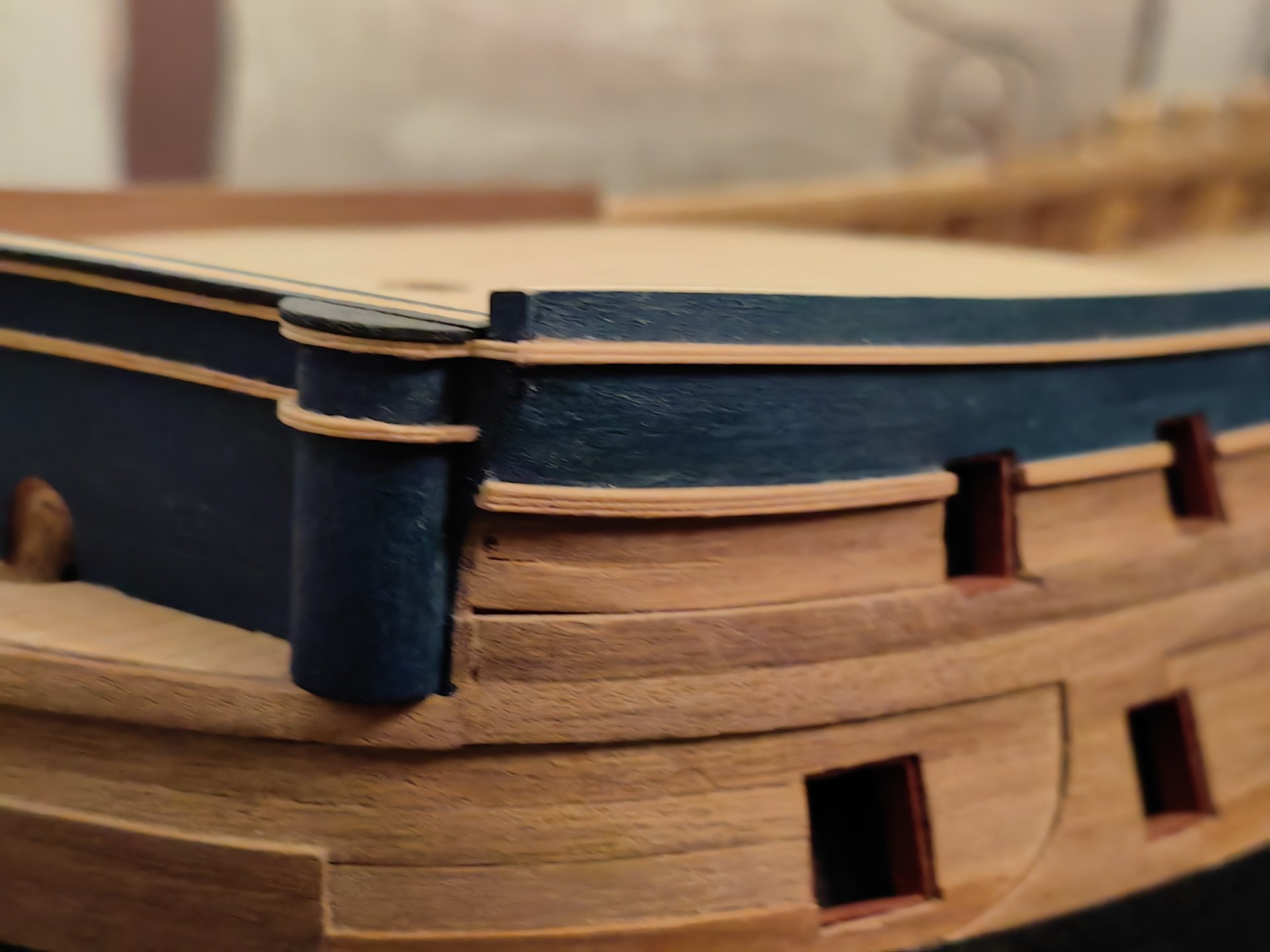

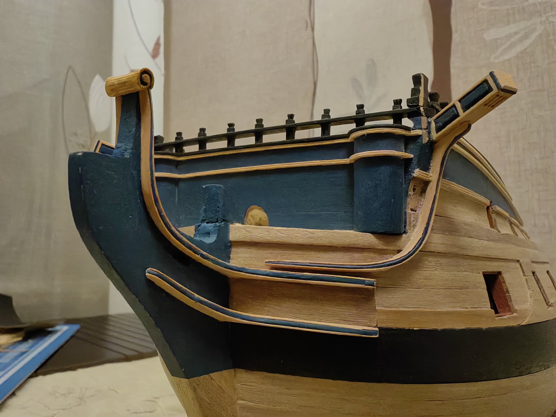

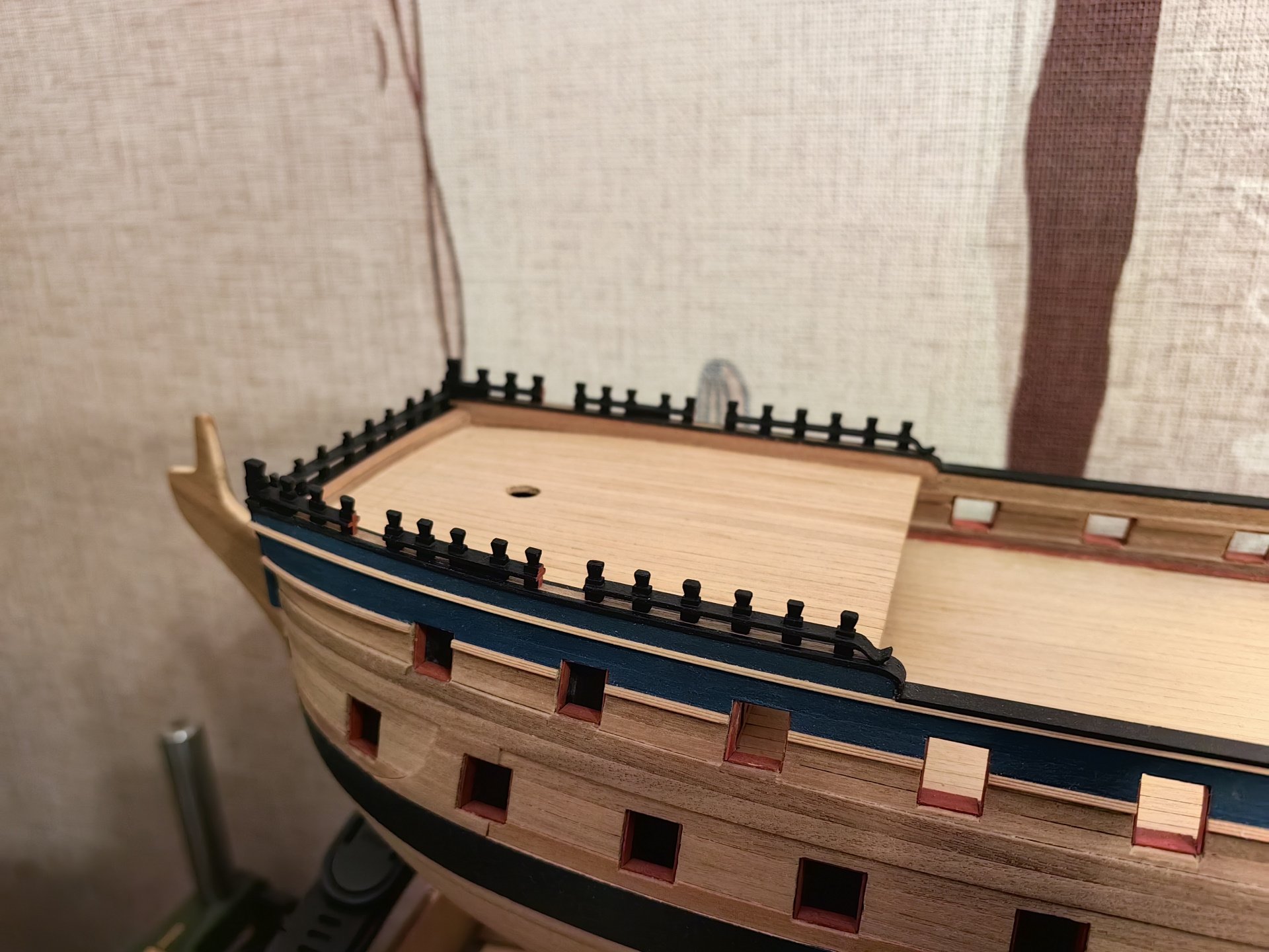

I mounted the gunwale on the bulwarks of the fordeck. I painted it, as well as the rails and toptimbers. I left an unpainted strip on the gunwale for better adhesion when gluing. But I won't glue the toptimbers yet, as there is still a lot of work to do with the case and I don't want to accidentally break the fragile structures. But I couldn't resist and took some photos).
8 hours ago, Captain Amateur said:
That looks great. Wondering what brown did you paint the railing?
Thank you!) The monitor screen may not have very accurate color reproduction. This is not brown, it is black.

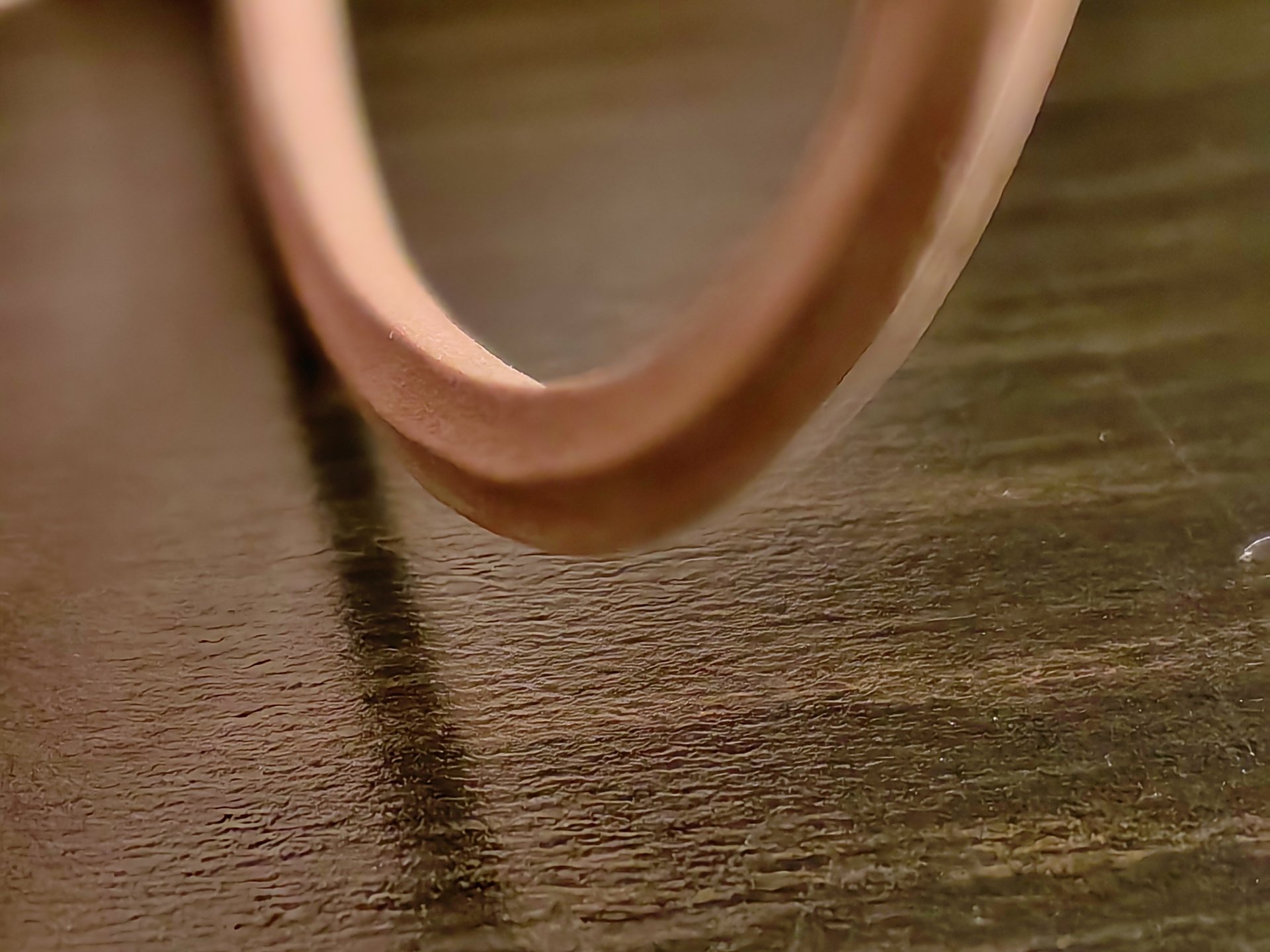

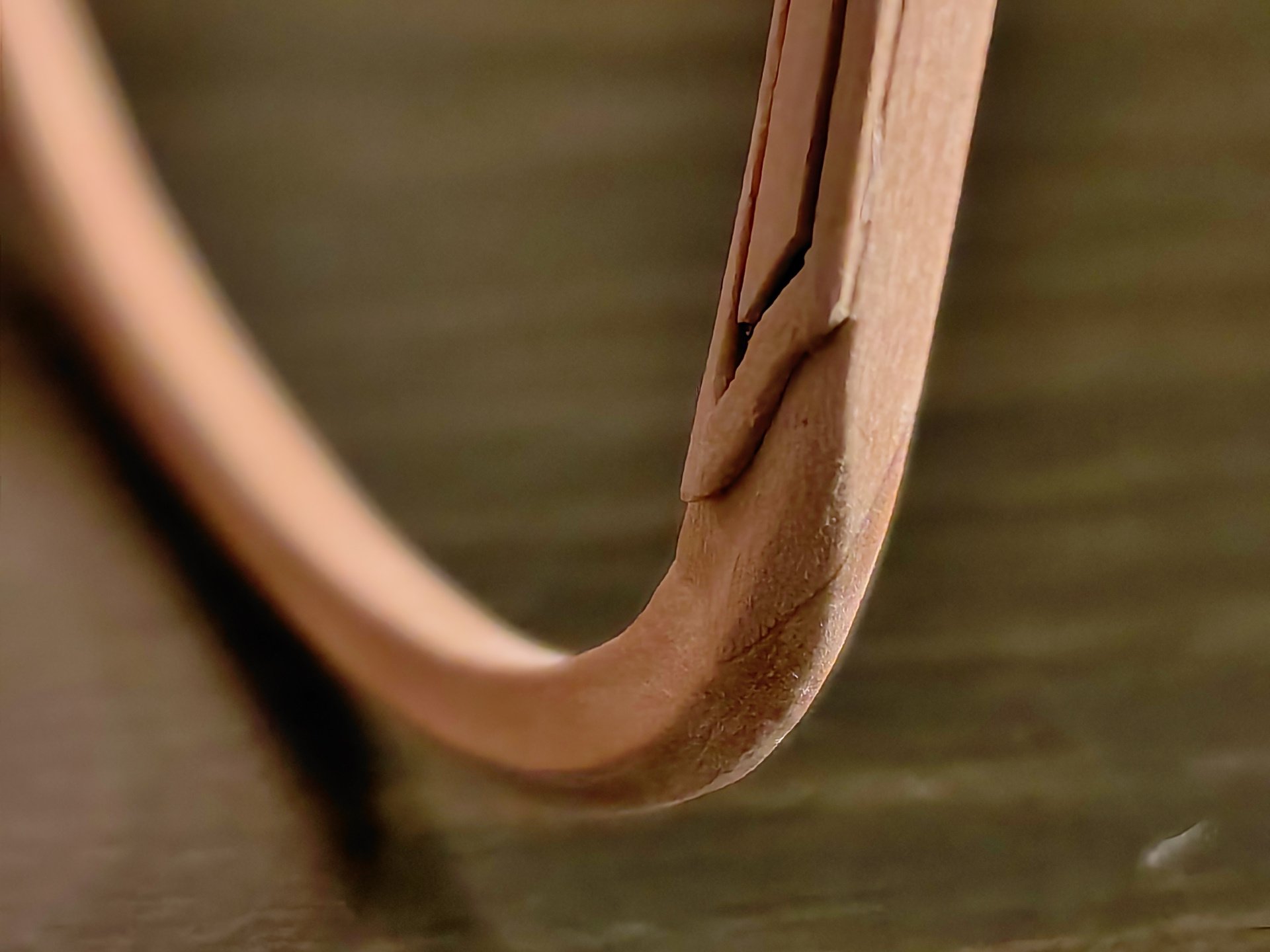

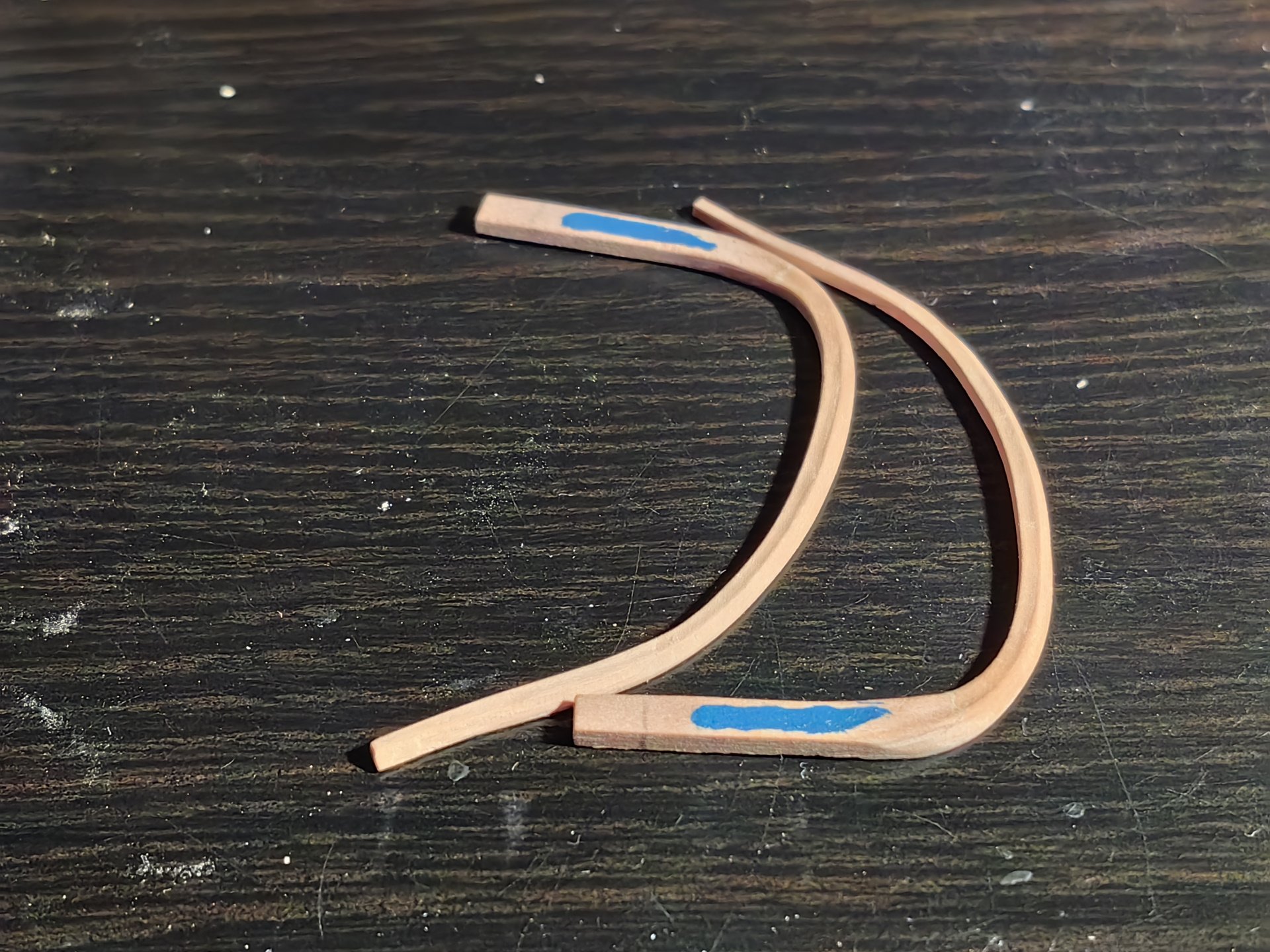

Hi Frecap,

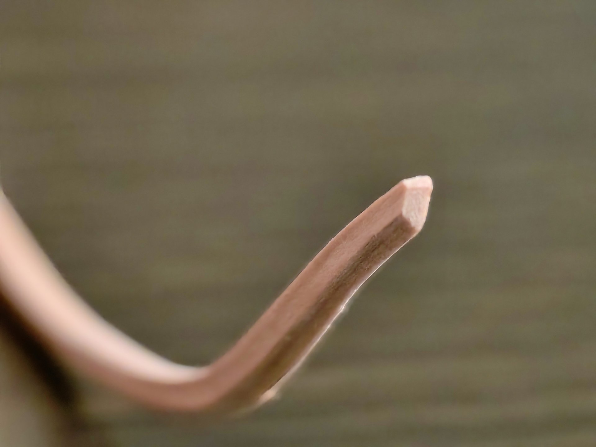

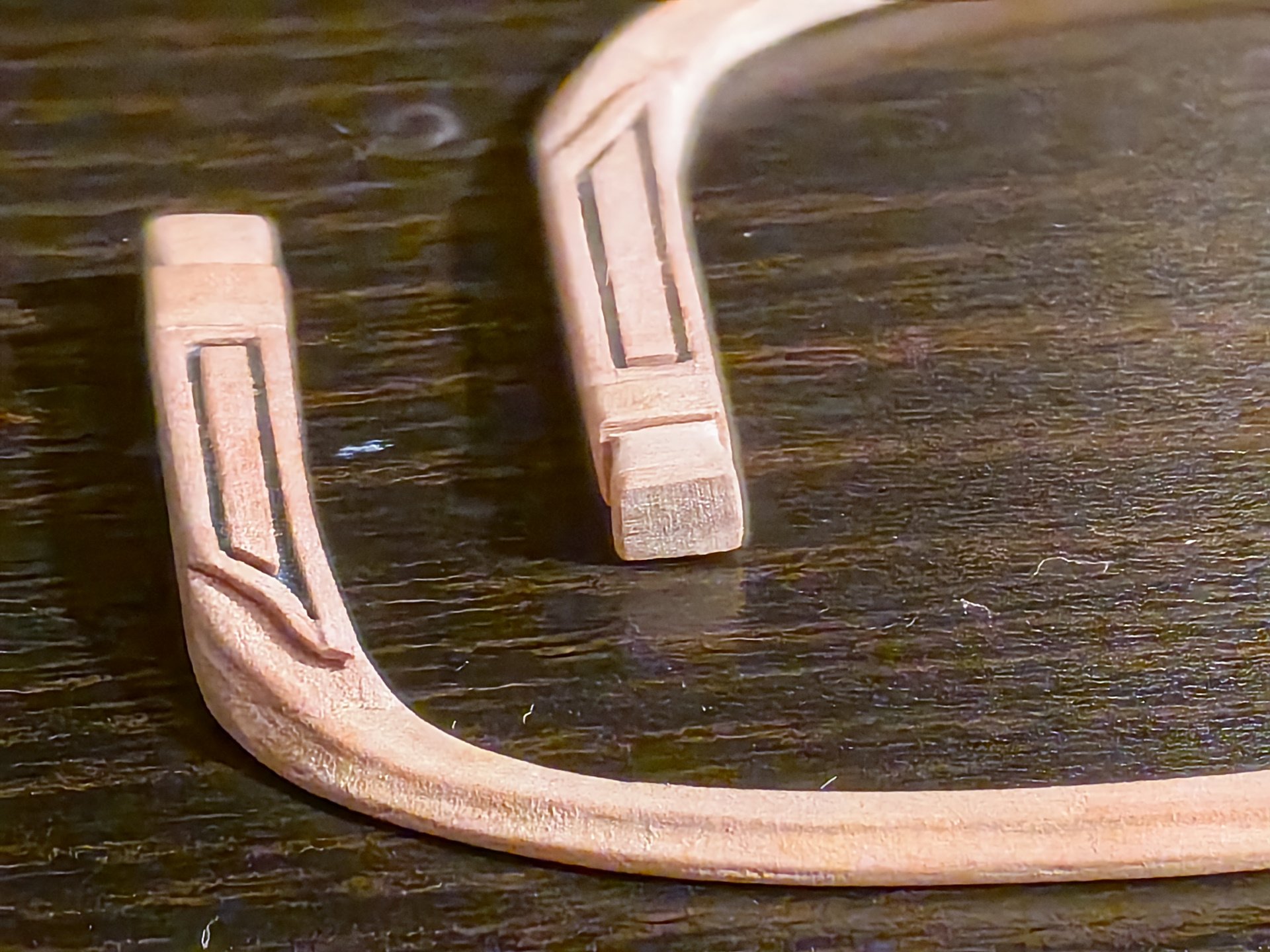

Your guwales look fantastic!! I am curious on what technique you used to get the end of the gunwales to curve up. I am going to be building mine in the near future and was hoping you could provide me some insight on how you achieved this. I am assuming that you used two pieces of wood glued together and shaped the final result. I am very impressed with your work and your Bellona is really coming out nice. The paint scheme you have chosen is beautiful.
Hi, Nearshore!

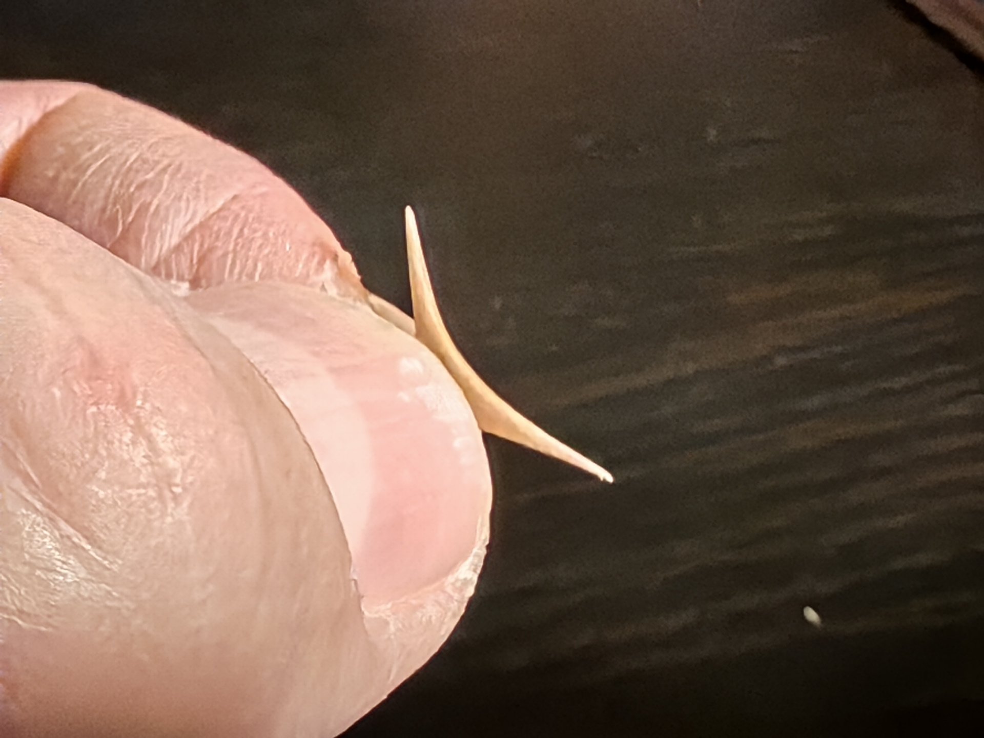

Thank you for the rating, it's very nice!) I bent the rail by steaming it in hot water and then ironing the tip with an iron, gradually bending the rail. If the radius is slightly larger, it bends normally. However, in this case, the radius is only a few millimeters, and it caused problems. I think it's important to take your time and repeat the steaming and ironing process several times, as there's a chance of the rail breaking. The first bend turned out to be good, but on the second, where the rack rises up, it broke. And on both sides. And I glued the broken parts with PVA glue, for strength, I glued several small pieces of thin rack into the concave part and then, when the glue was dry, I processed it with a round file. So, in fact, you are right, this part is composite, in two parts. Probably, you  can not  suffer and make it composite at once. In the future, I will probably do it.

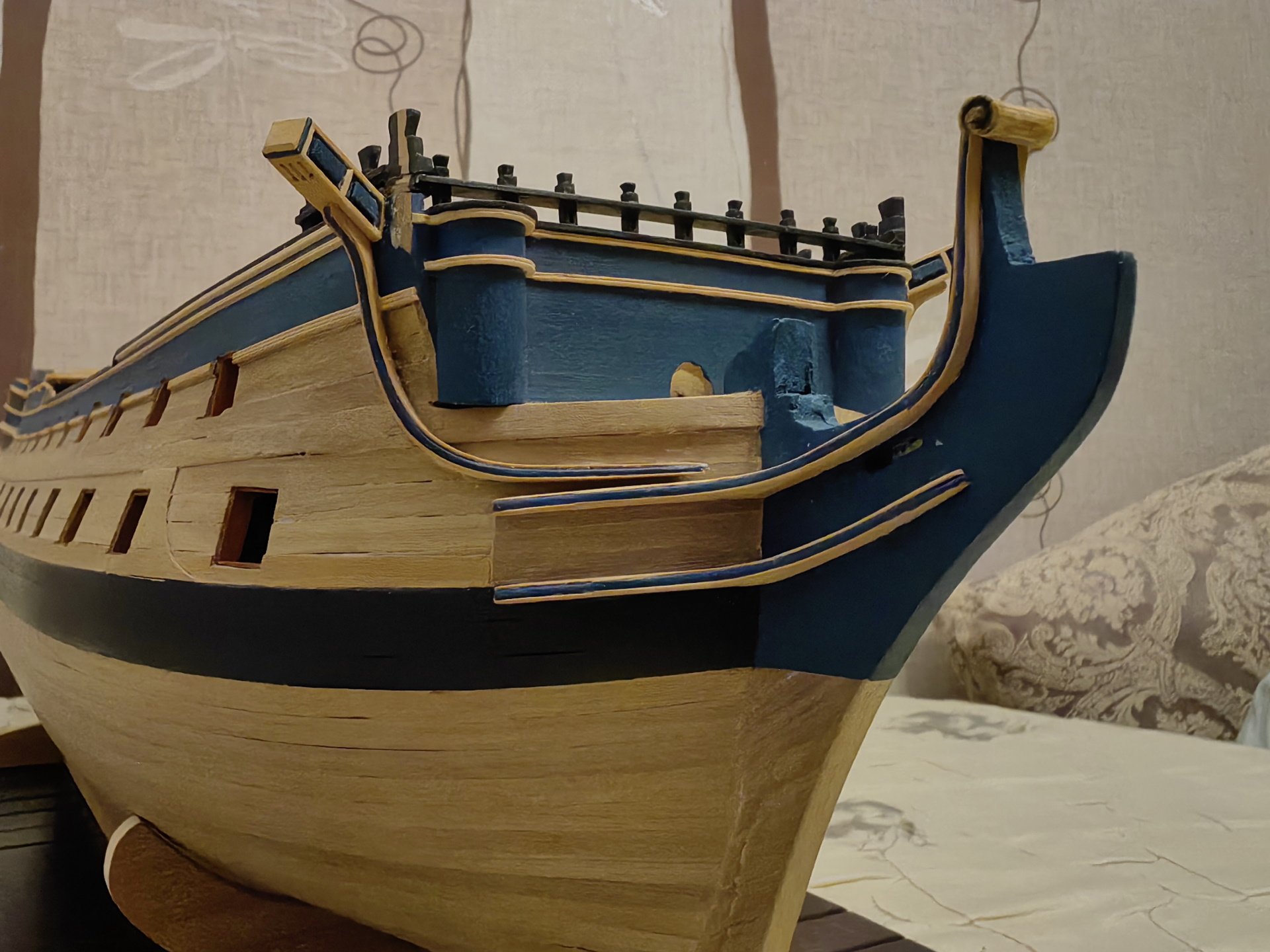

Hi!

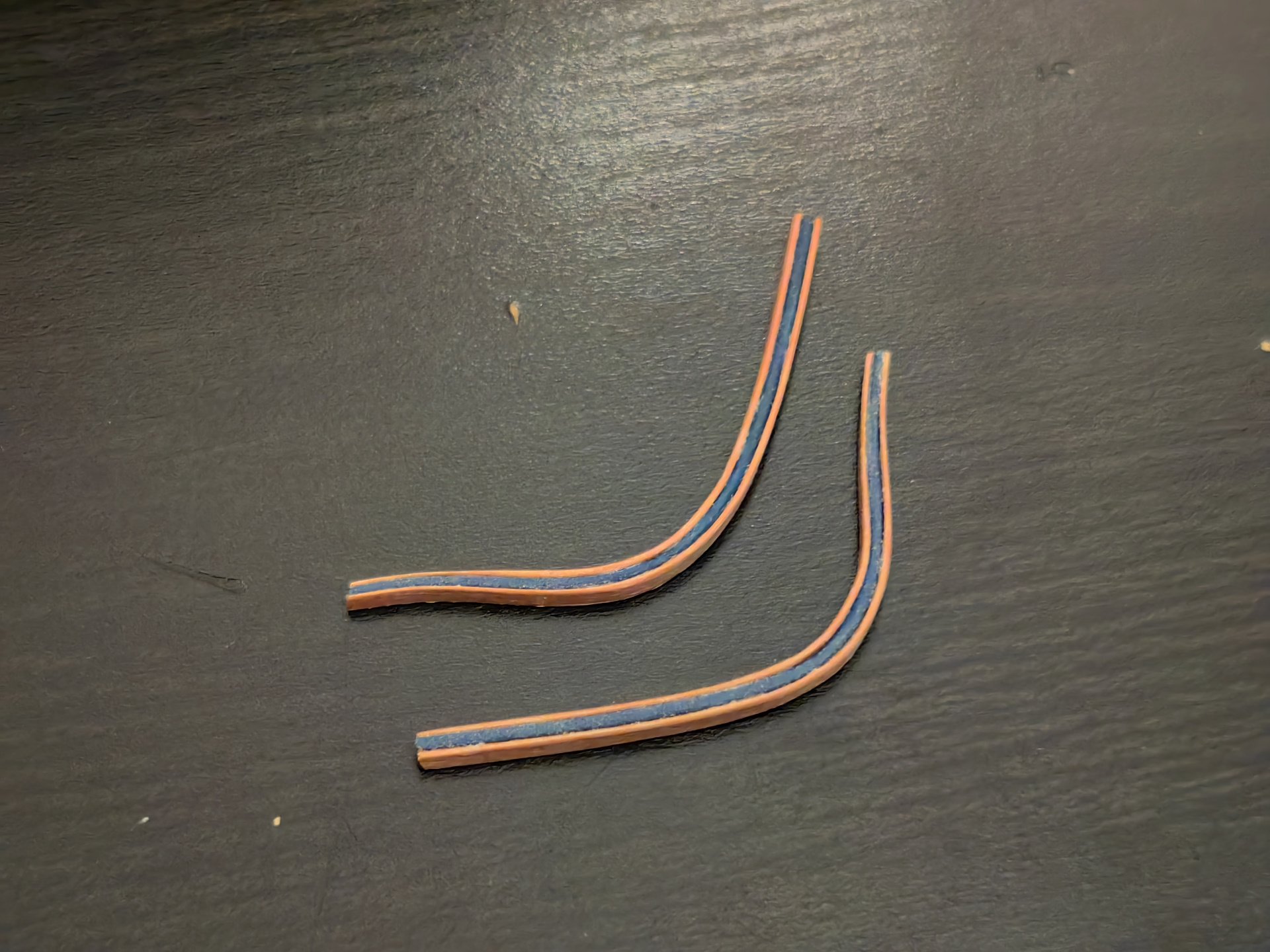

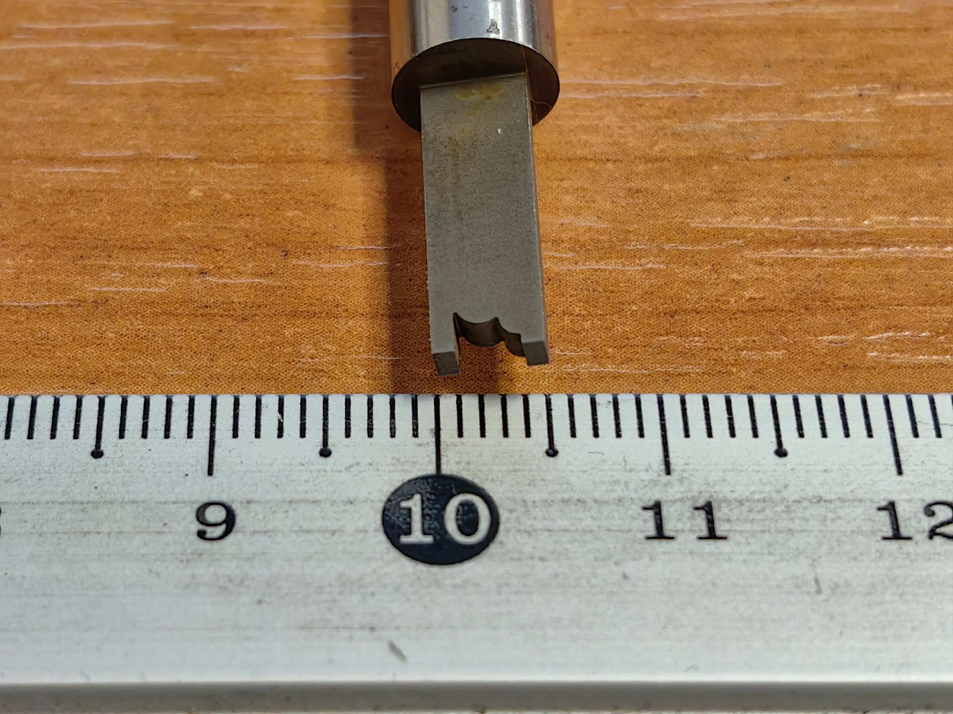

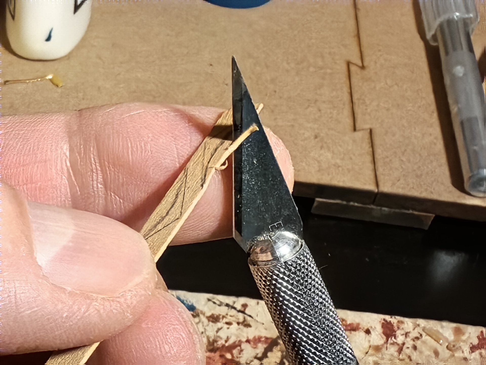

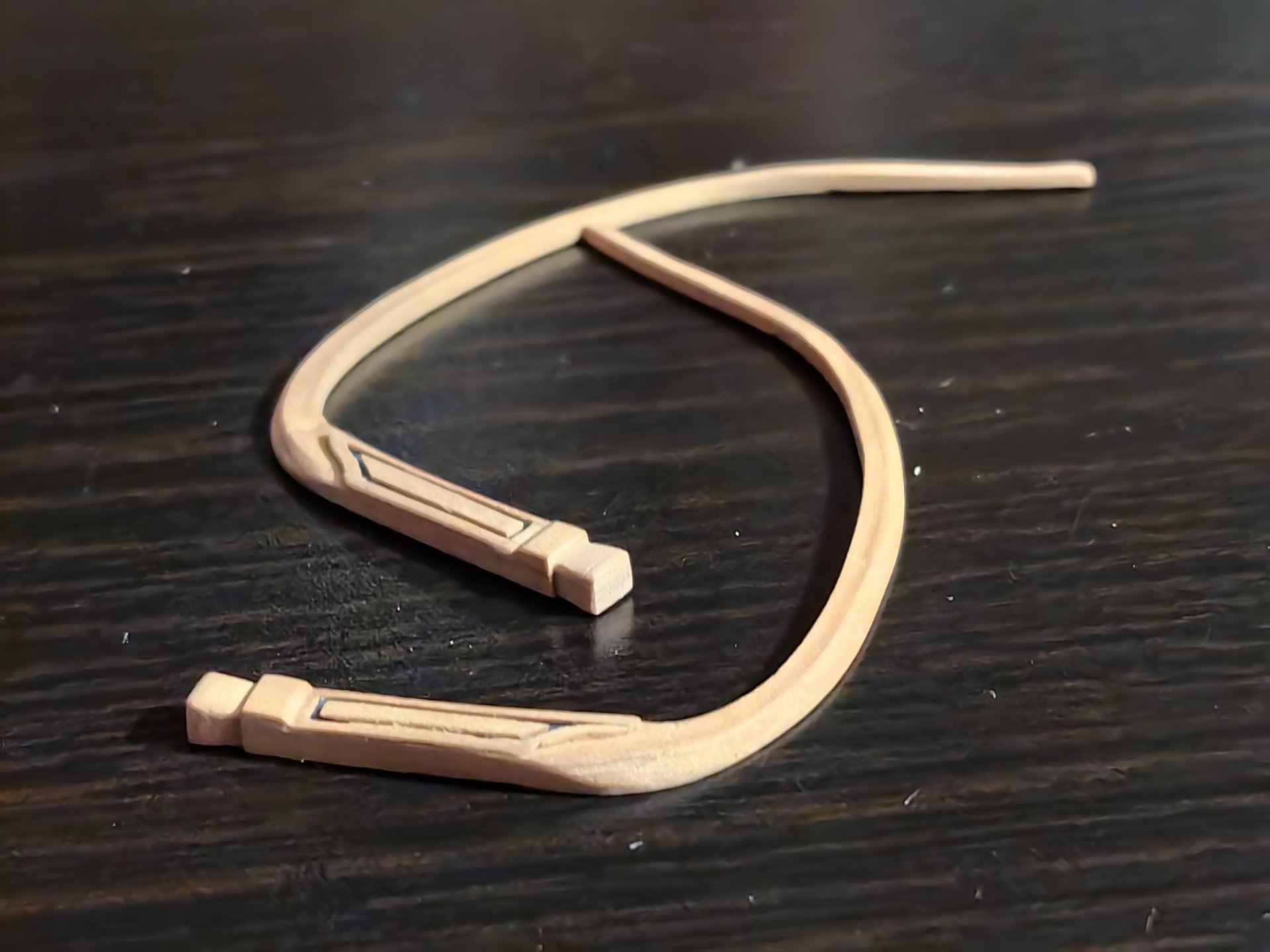

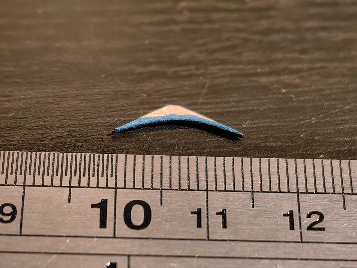

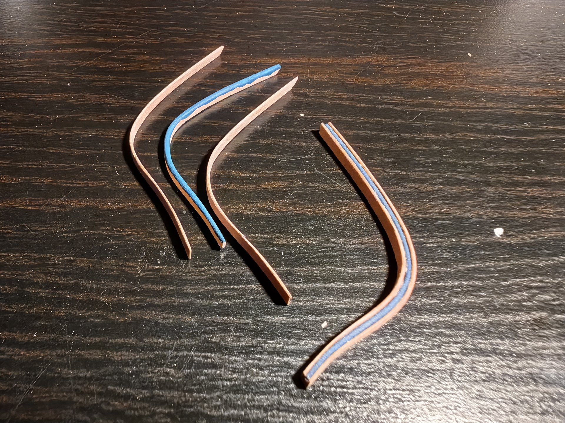

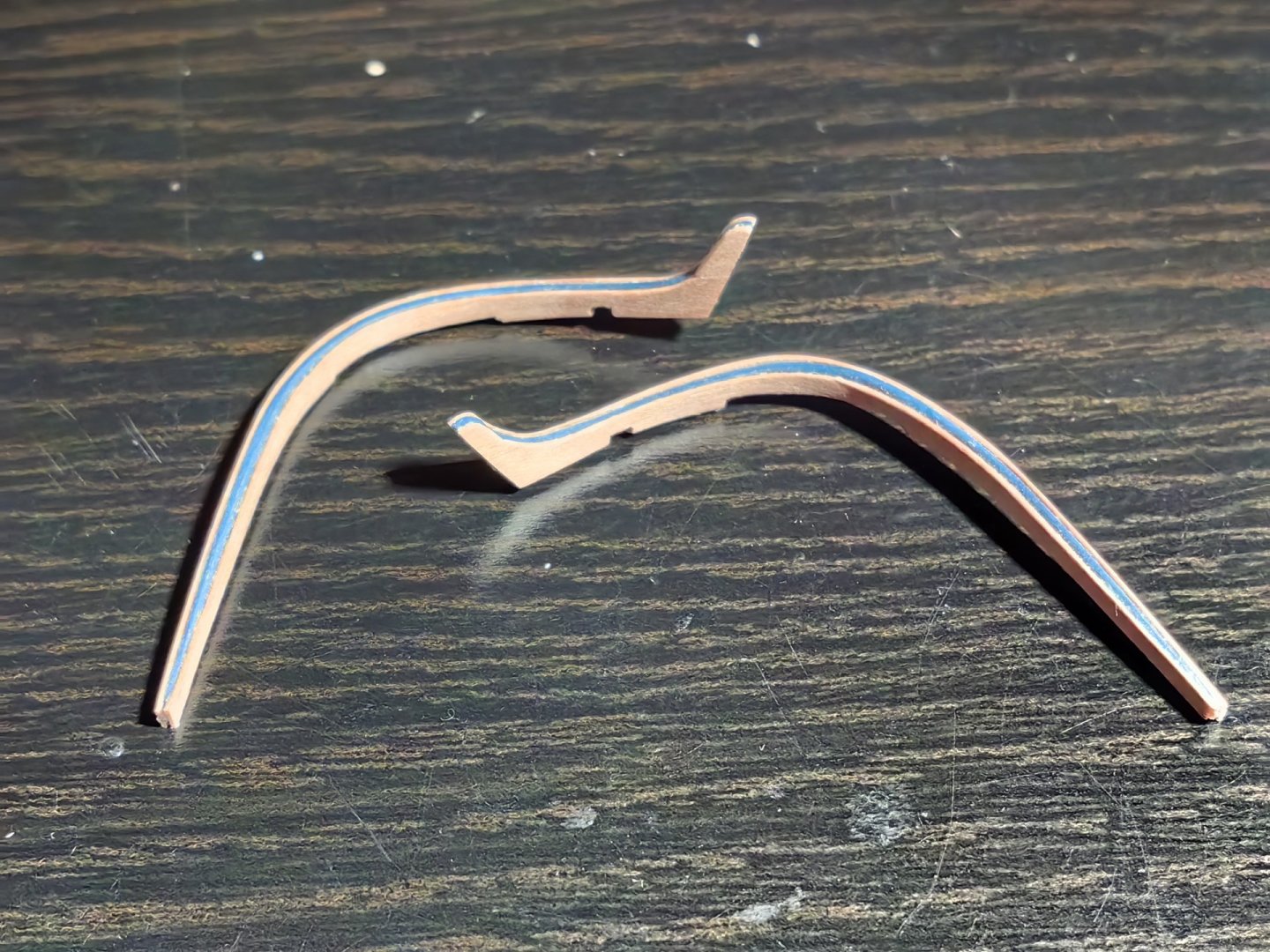

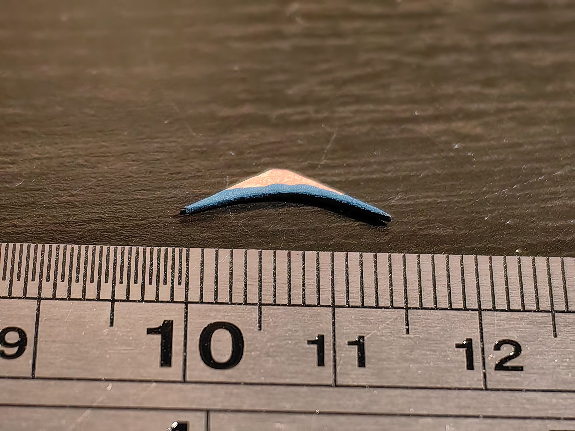

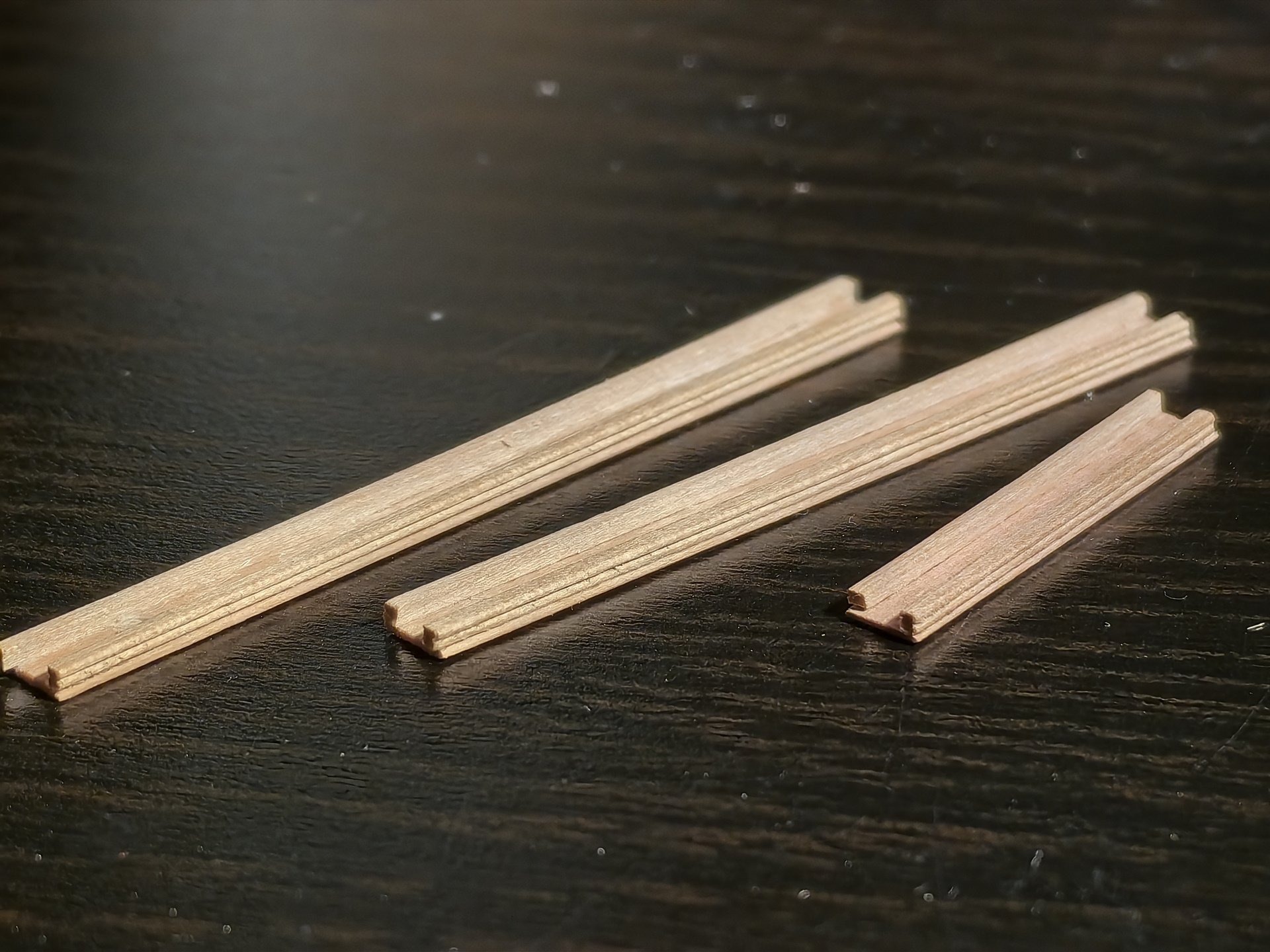

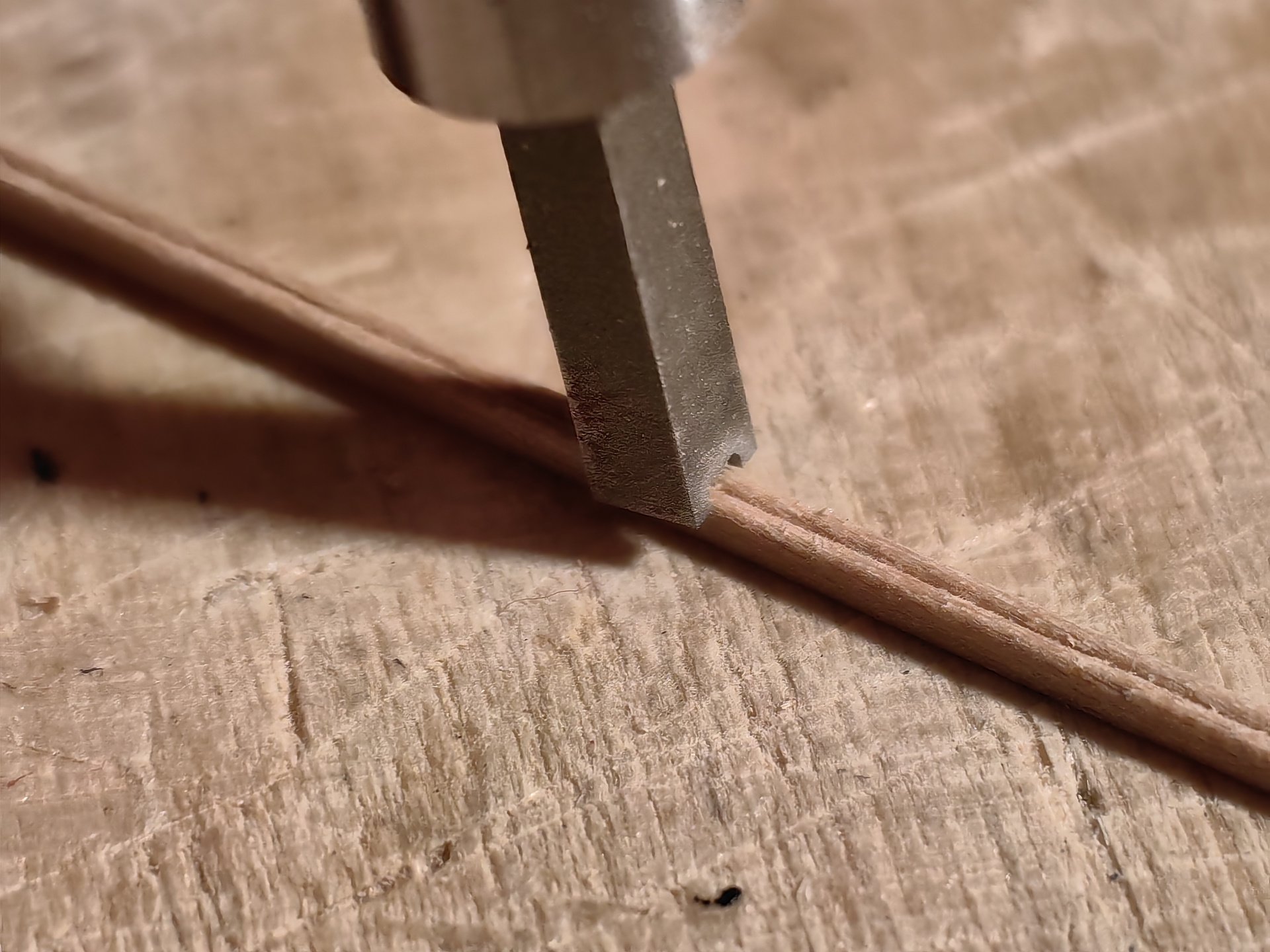

I'm continuing with the head. I need to make a lot of thin, openwork parts. I started with the chееks. The Corel set doesn't have any laser-cut, ready-made parts, but  the chееks need to have a distinct profile and the inside of the profile needs to be painted. While I can still give the rake a profile using a special tool, I won't be able to paint such a small part accurately. Therefore, I'm making the chееks out of three parts.
1113.thumb.jpg.eec47cf4d776acf8f7fa9c4ed8e19631.jpgThe central part is made of a 1 mm rail, and the side parts are made of a 0.5 mm rail. All the rails are made of pearwood. By the way, it is easier to bend thinner rails. Then I gave the front edges of all the rails a semi-circular profile, painted the front part of the central rail, and glued on the side rails. The long upper cheek should taper towards the end, so I sharpened all three rails. However, when I saw the result, I felt that the taper was not sufficient, so I tore off the glued parts, sharpened the rails again, and then reglued them.

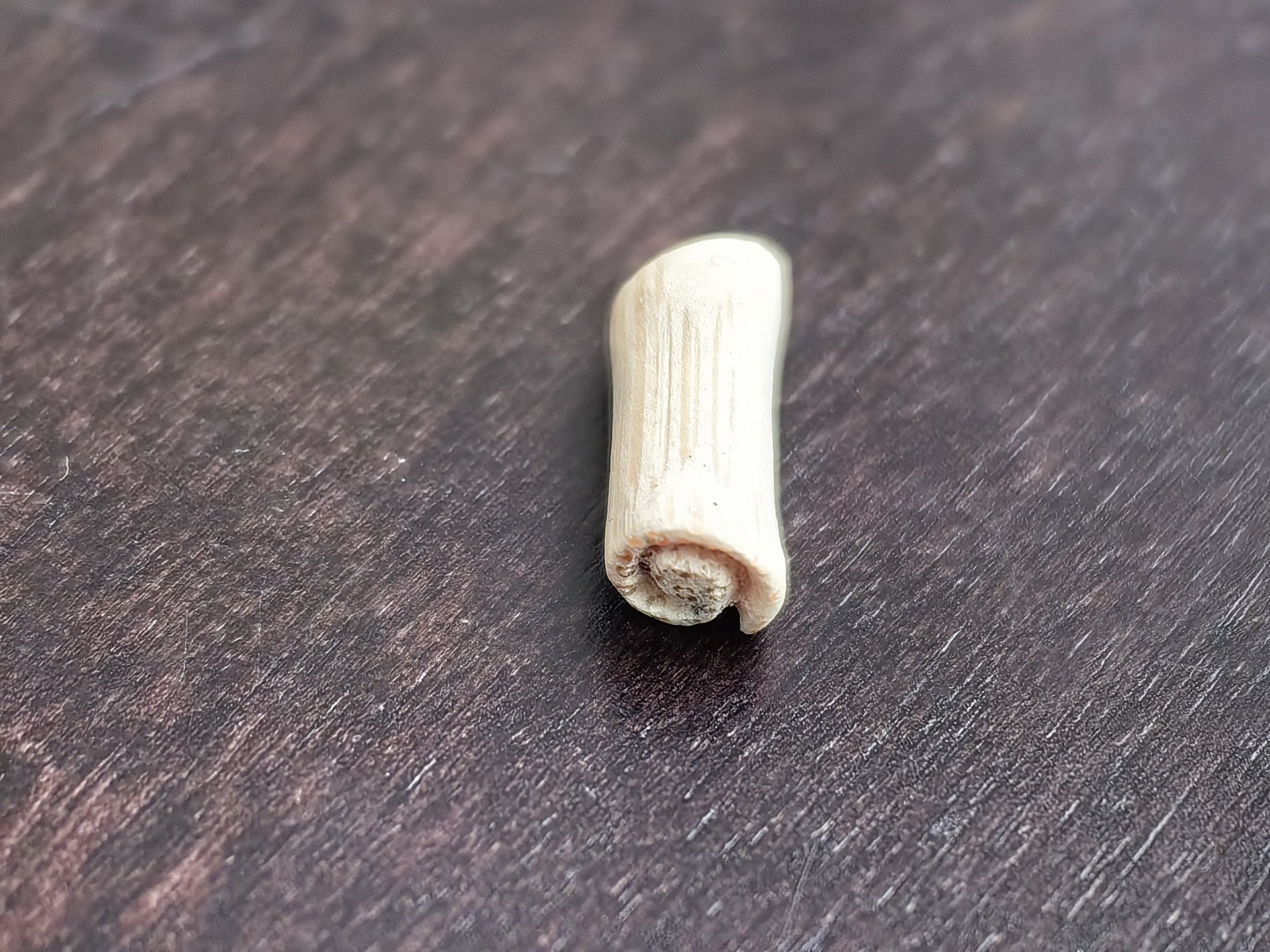

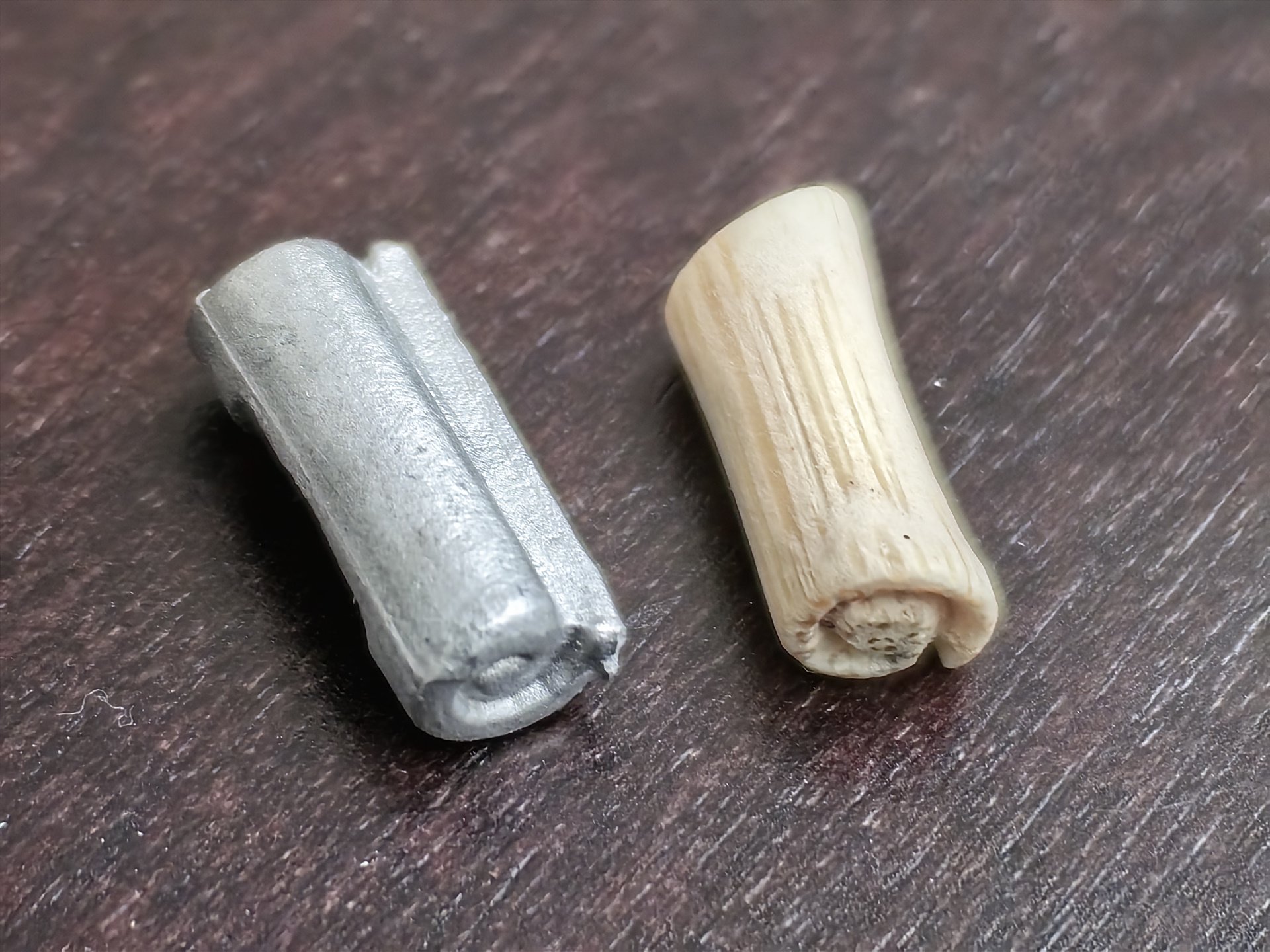

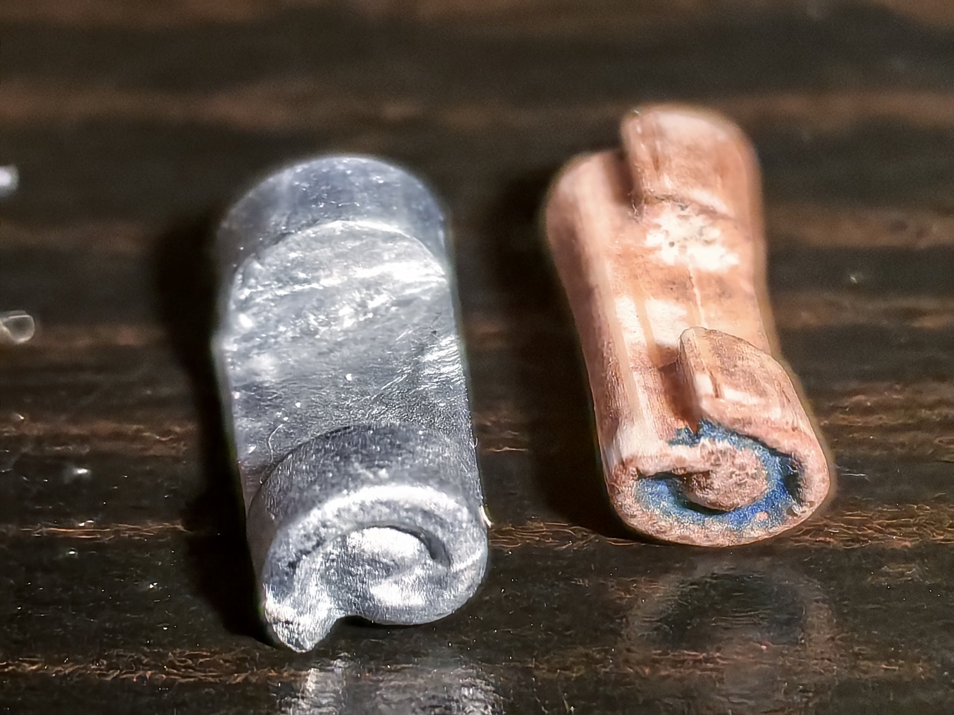

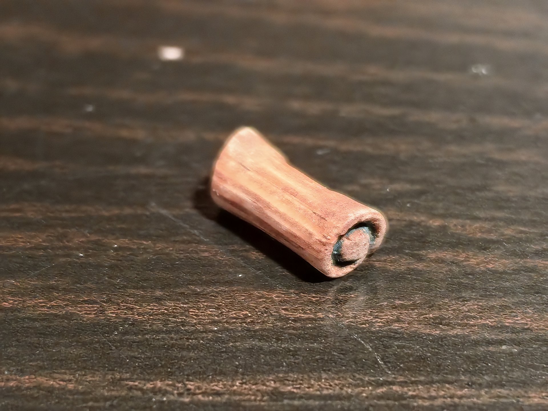

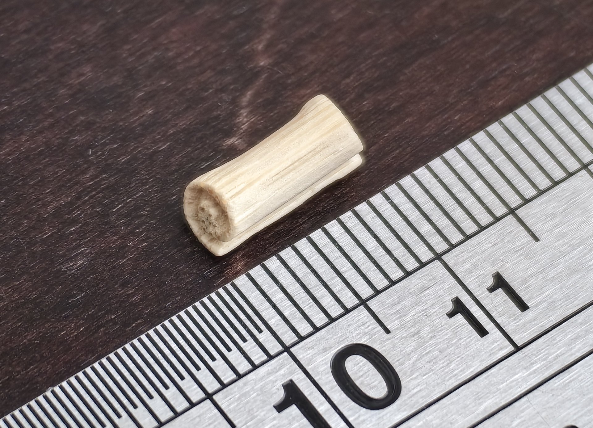

The upper cheeks converge at the top and rest against the volute of the herbroket.  Corel's  volute is made in the form of a cast tin part, which I absolutely do not like, as well as most of the metal decor parts. I decided to make it myself. I did not have a pear rail of the appropriate cross-section, so I used a sushi stick. It is made of bamboo, which is quite hard and perfectly processed with a linography cutter. However, it is lighter than pear and speckled. But a little mordant has more or less evened out the colors, and since the piece is very small, I hope that the specks on the model won't be too noticeable.
Hi!

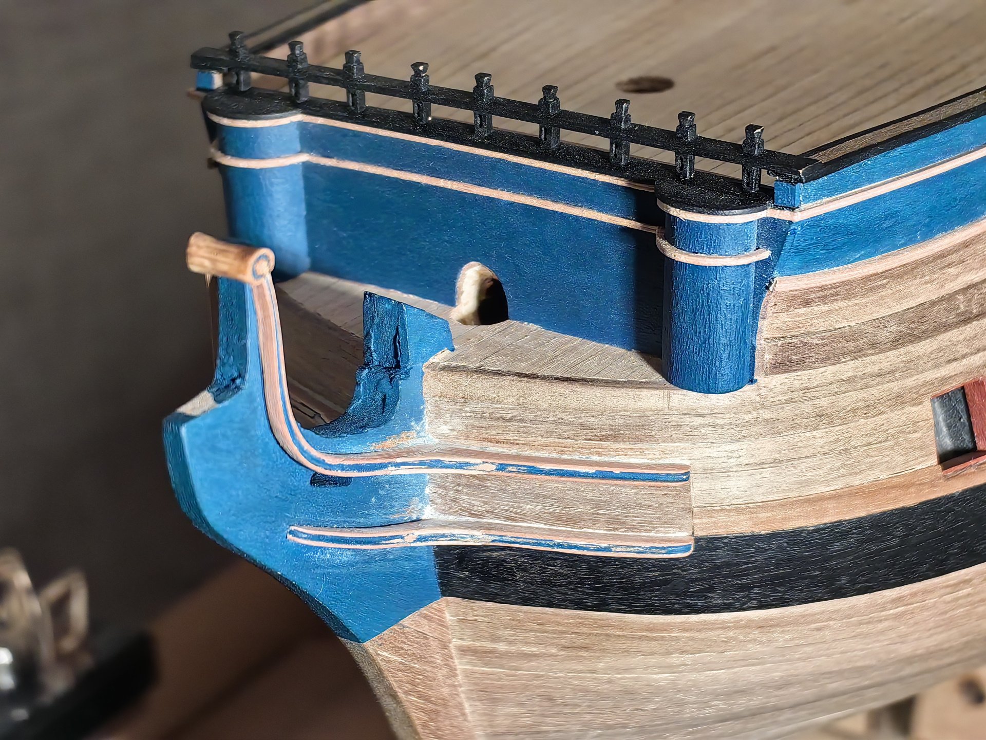

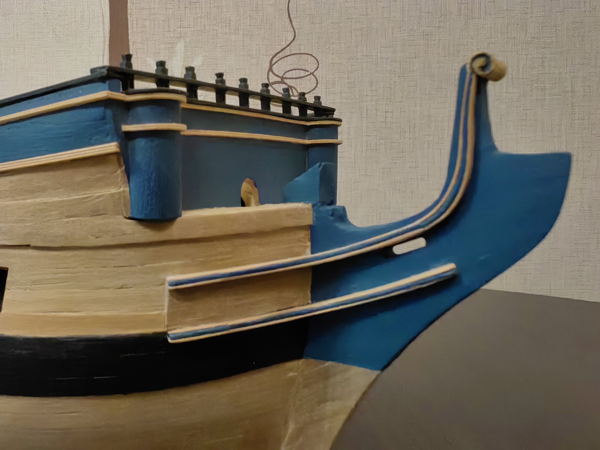

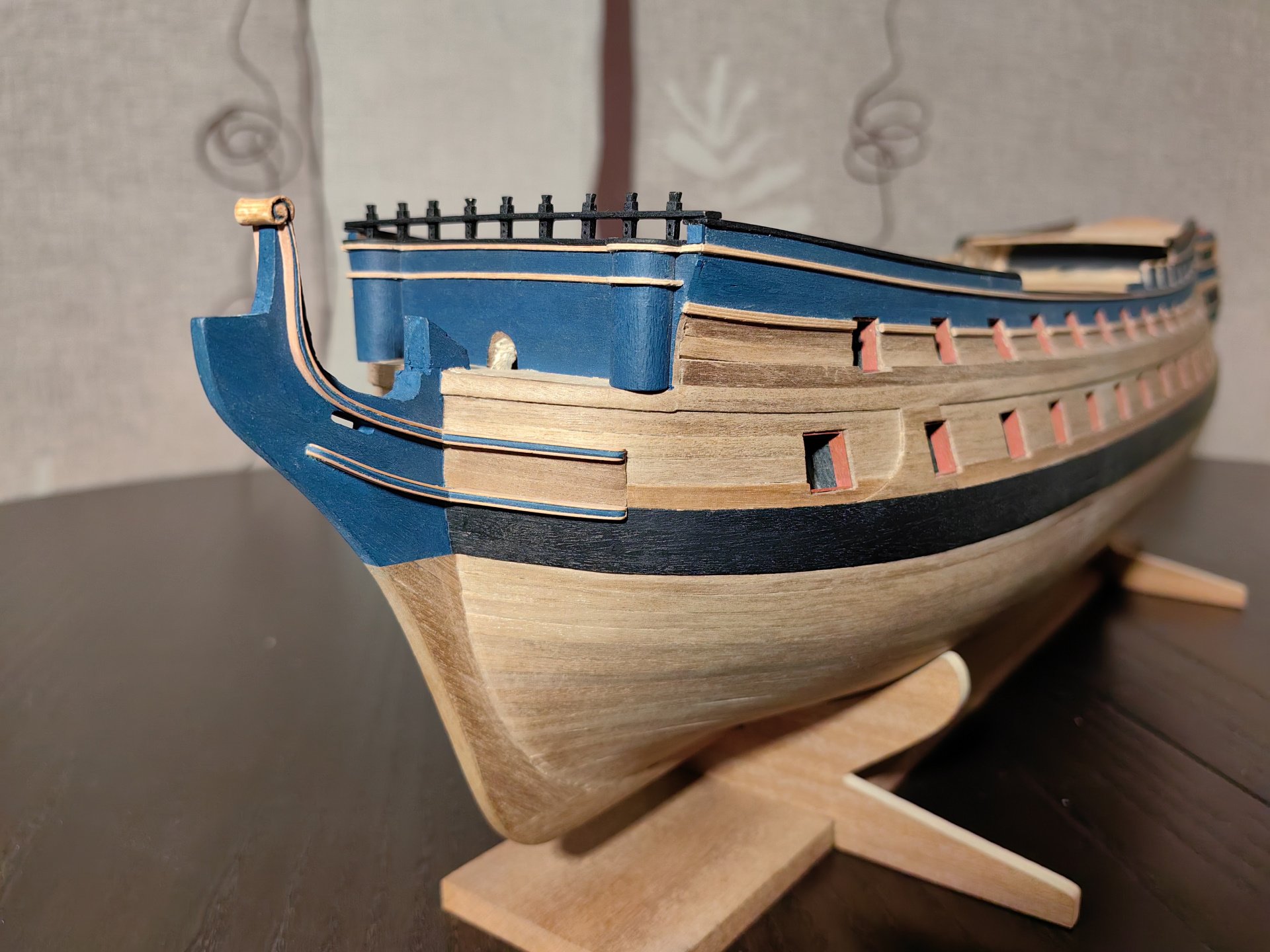

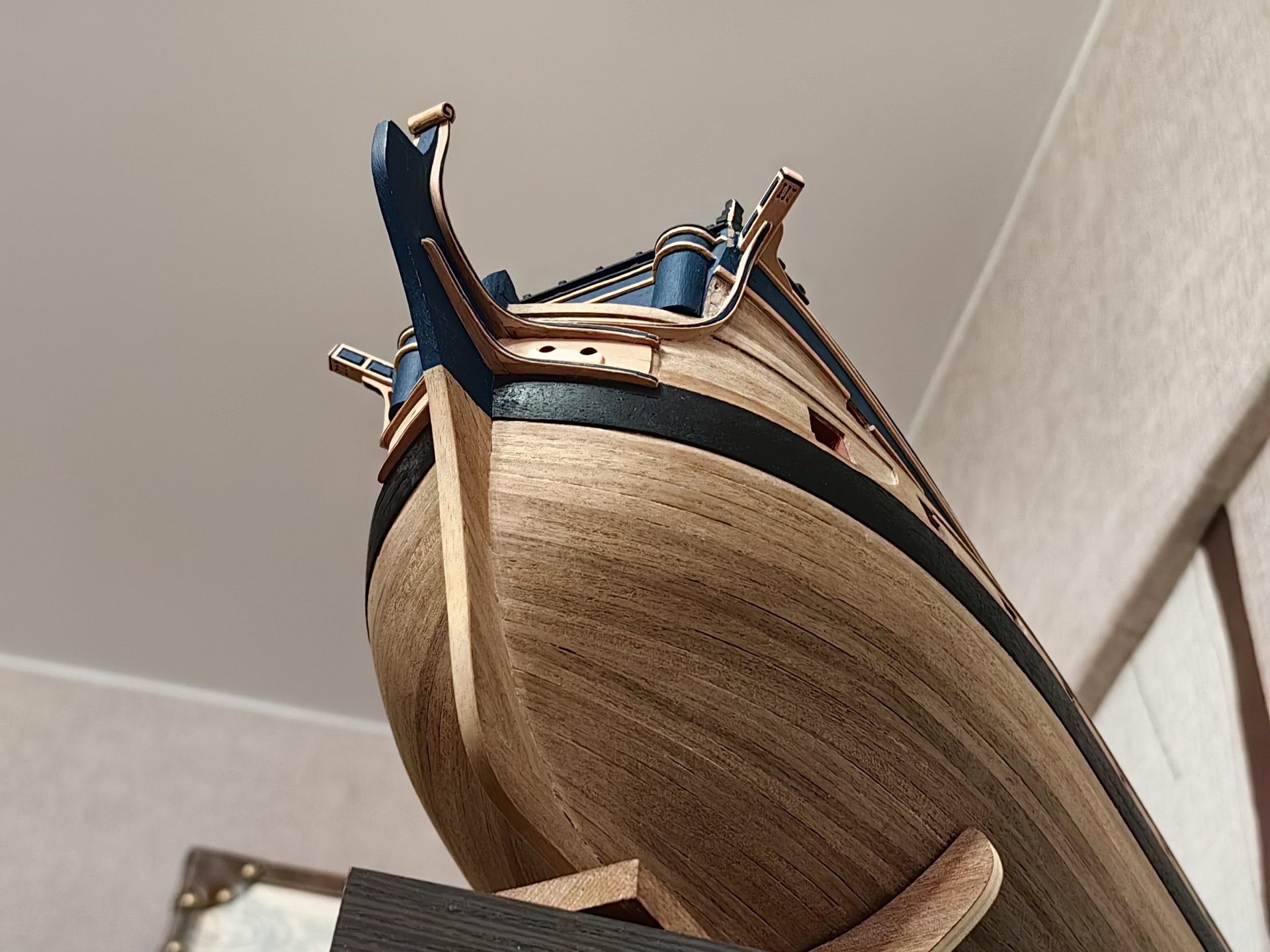

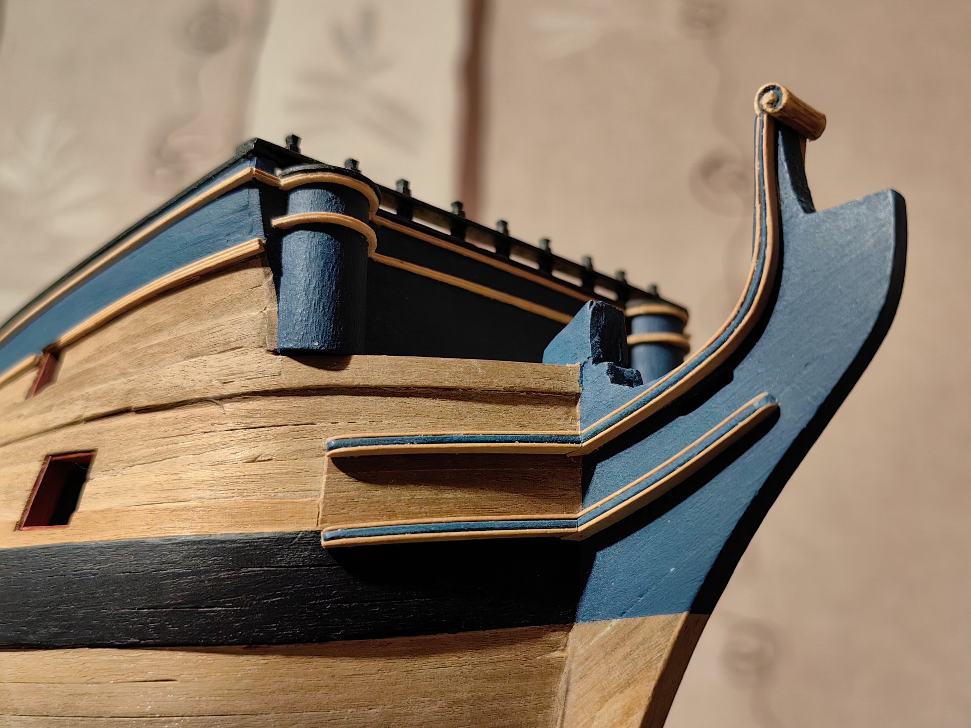

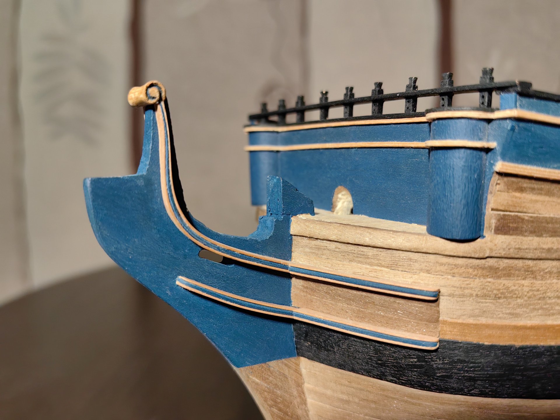

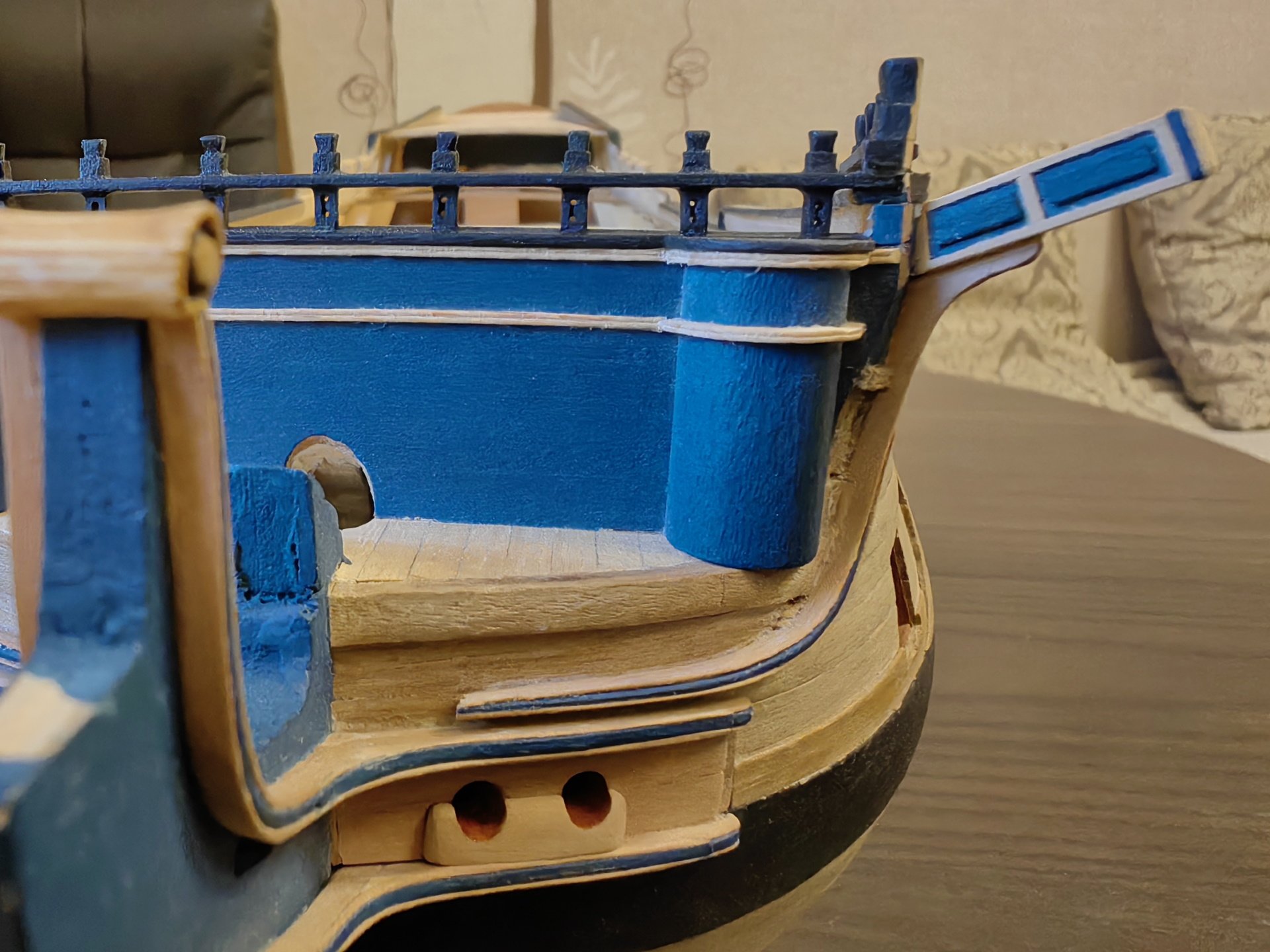

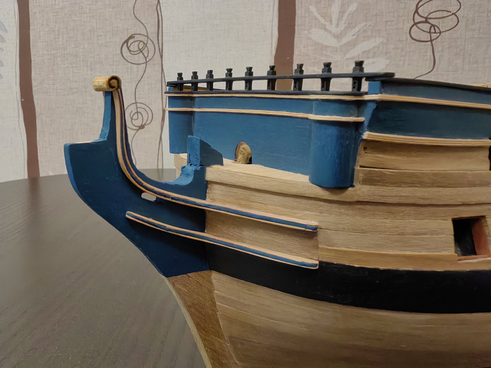

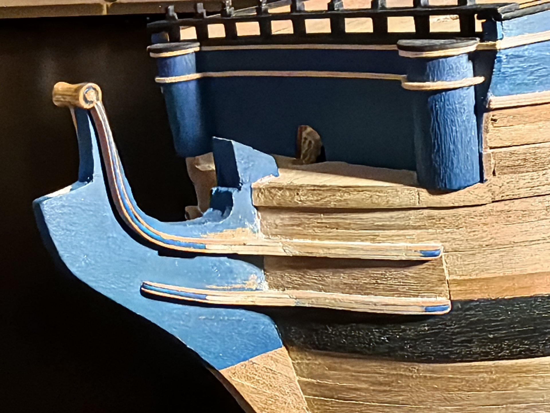

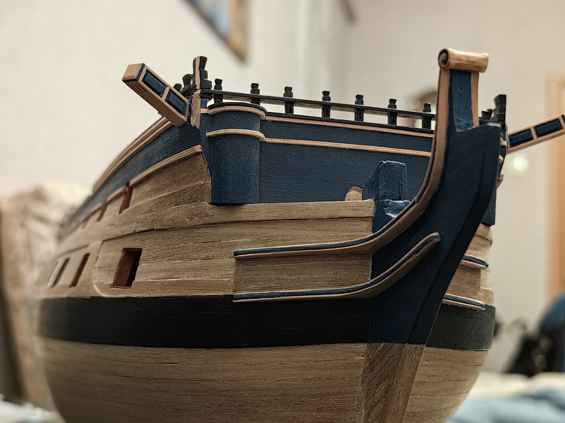

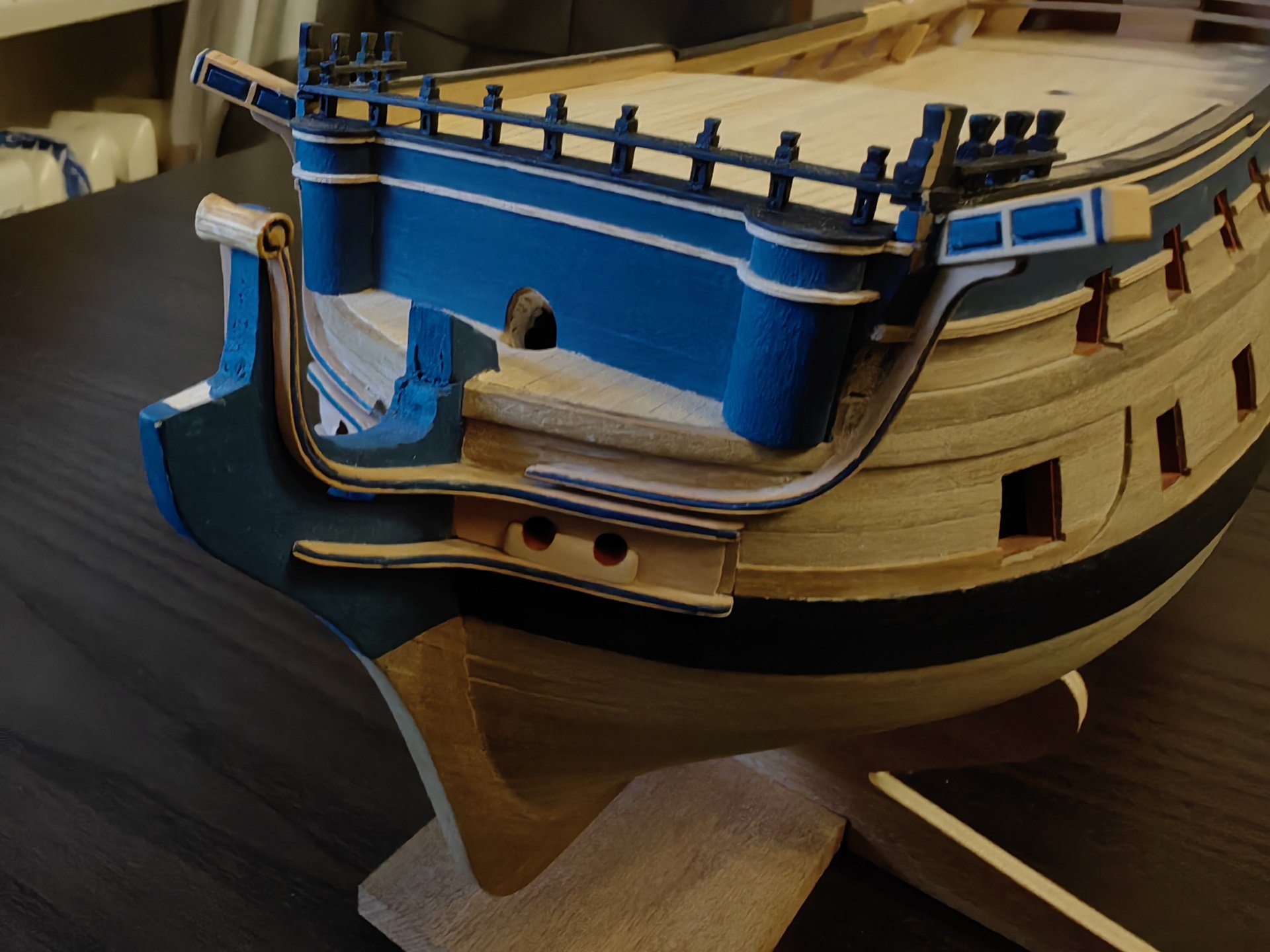

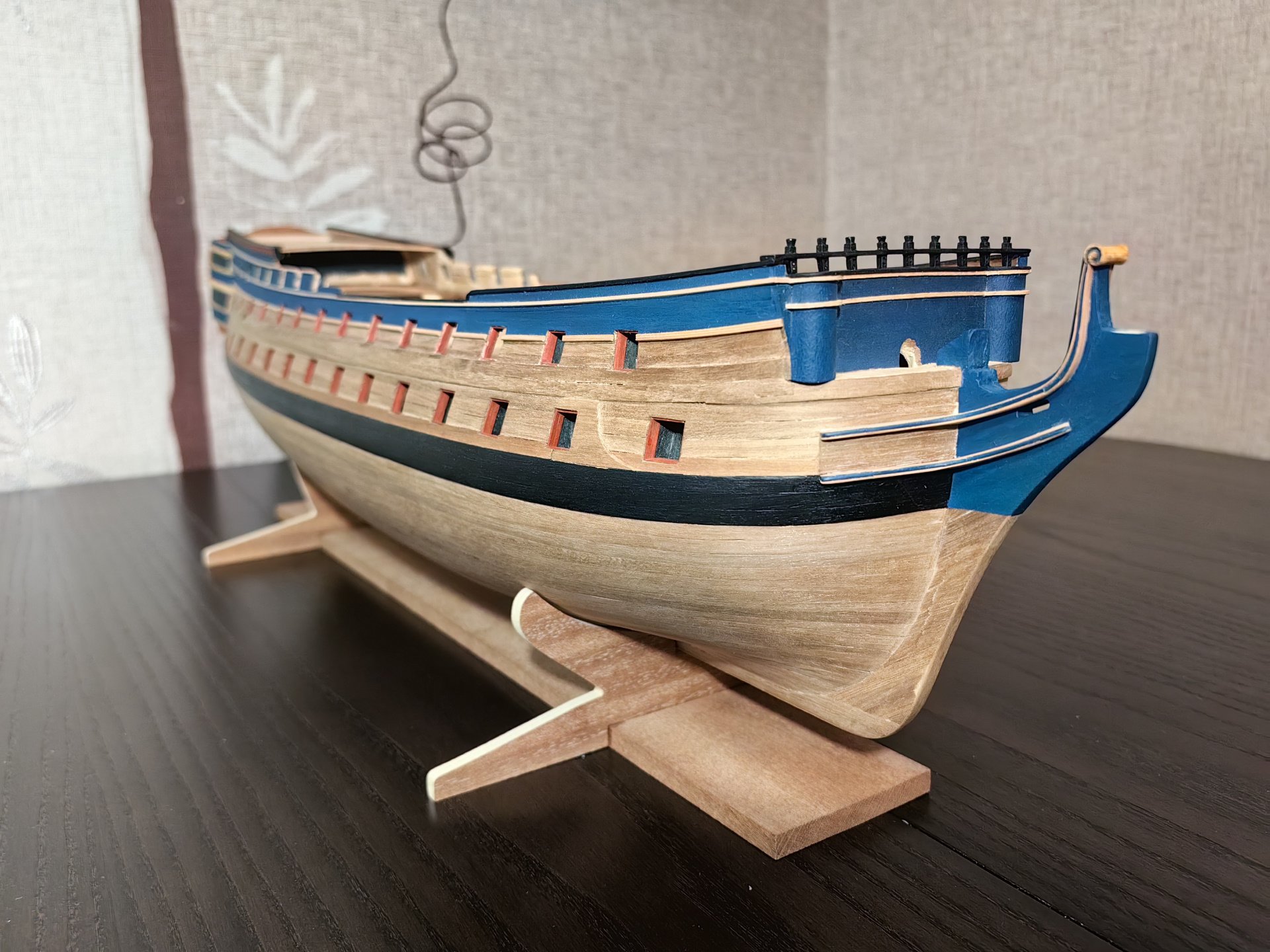

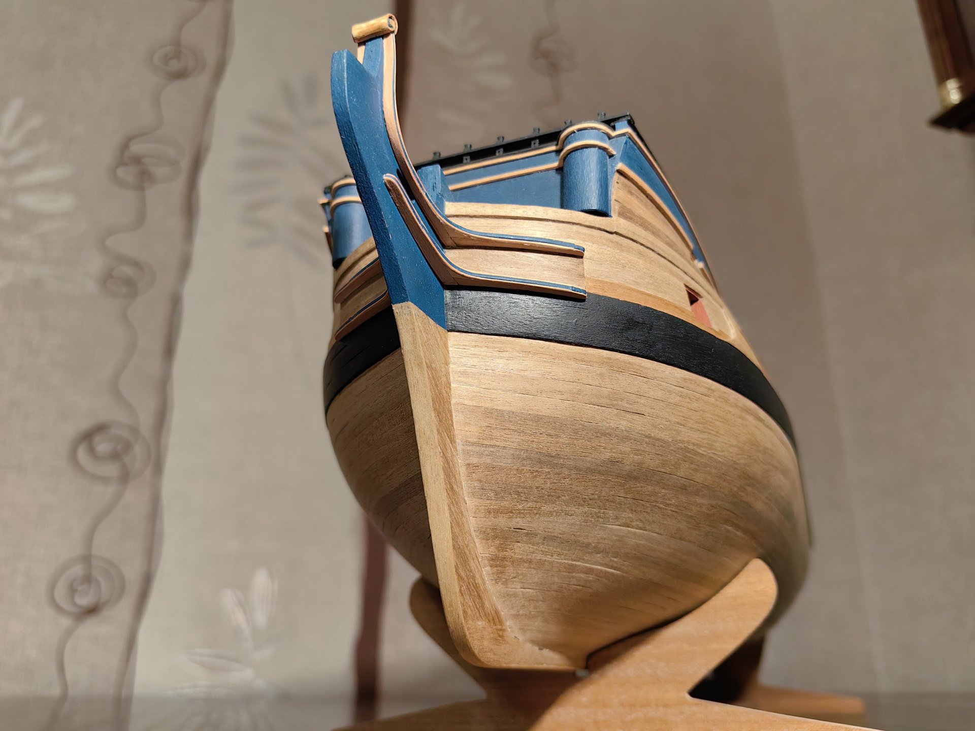

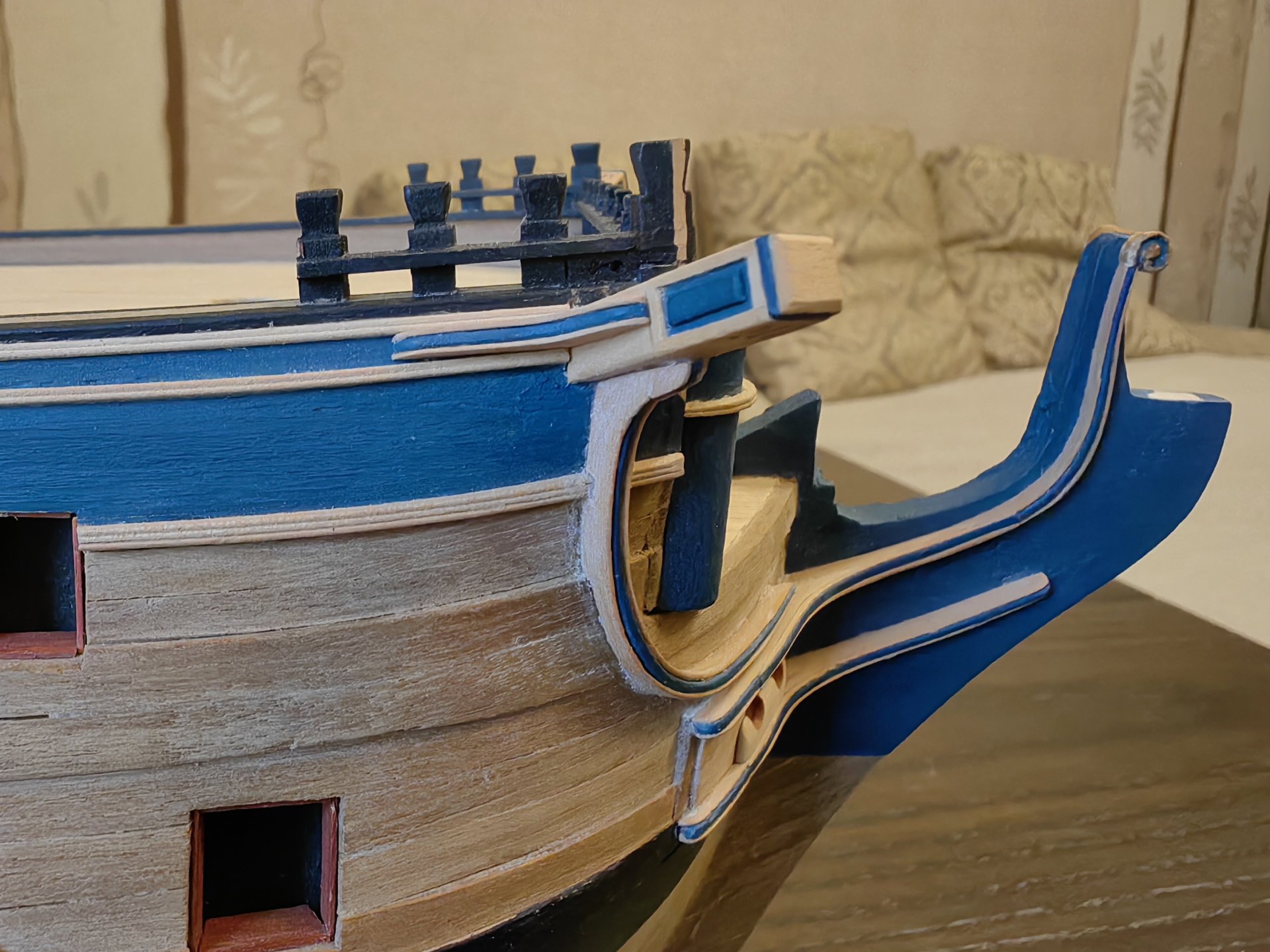

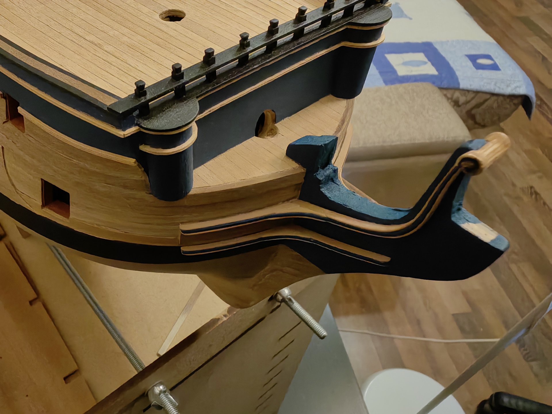

The assembly of cheeks from several parts did not take much time. Unexpectedly, a lot of it was spent on fitting and mounting them on the hull. And this is the result.
Probably not perfect, but, as I think, no worse than everything else. Here, of course, there will be something to finish. Since on the prototypes, cheeks have a smooth transition from the hull to the head knee, and I just have them docked, I want to make something like knees with an internal radius. There are also some gaps that need to be seal. In general, this process is endless. But the result is satisfying)

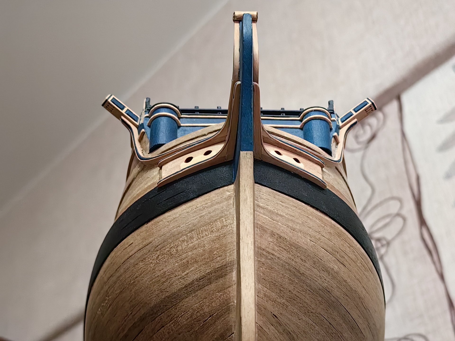

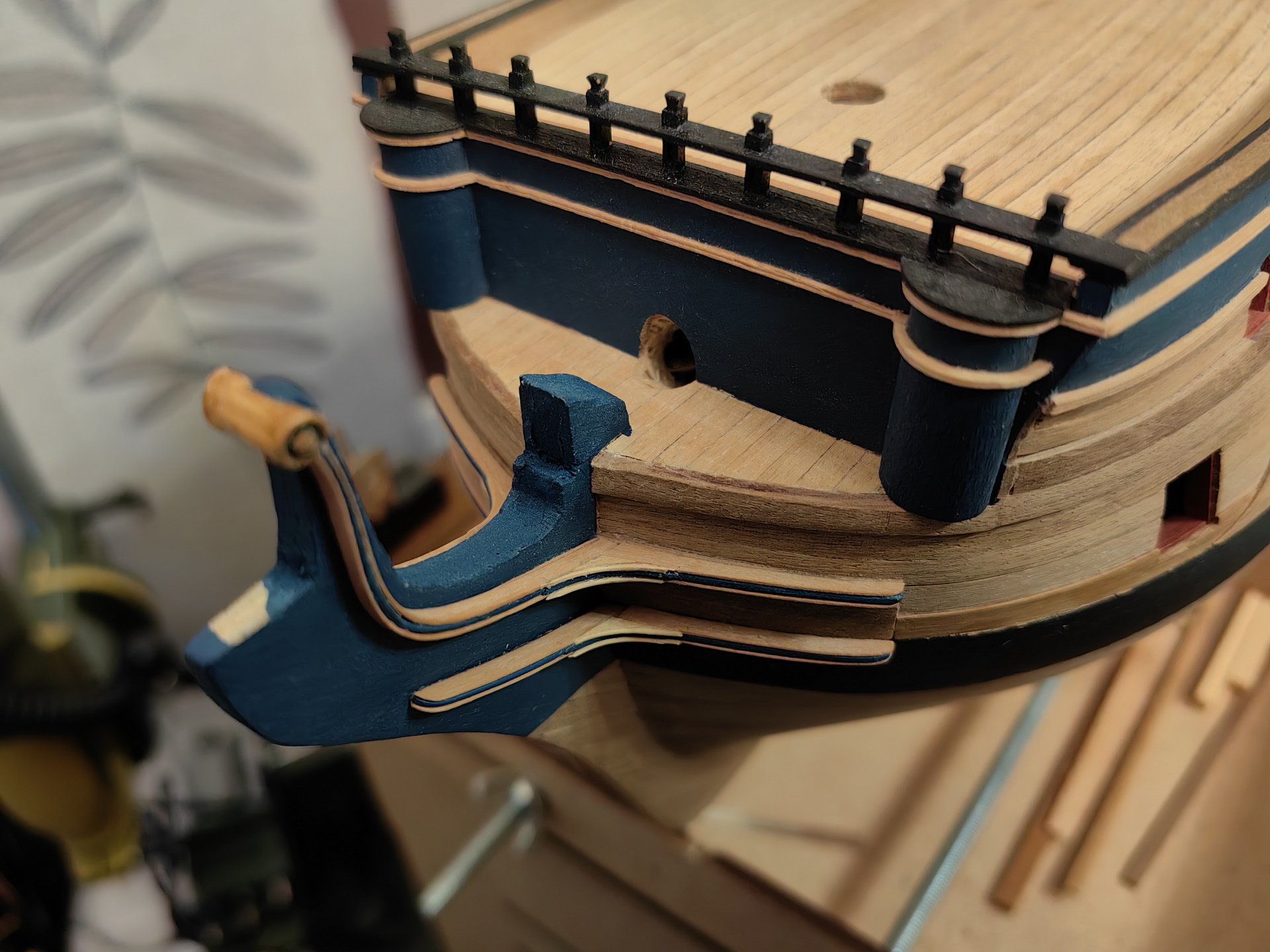

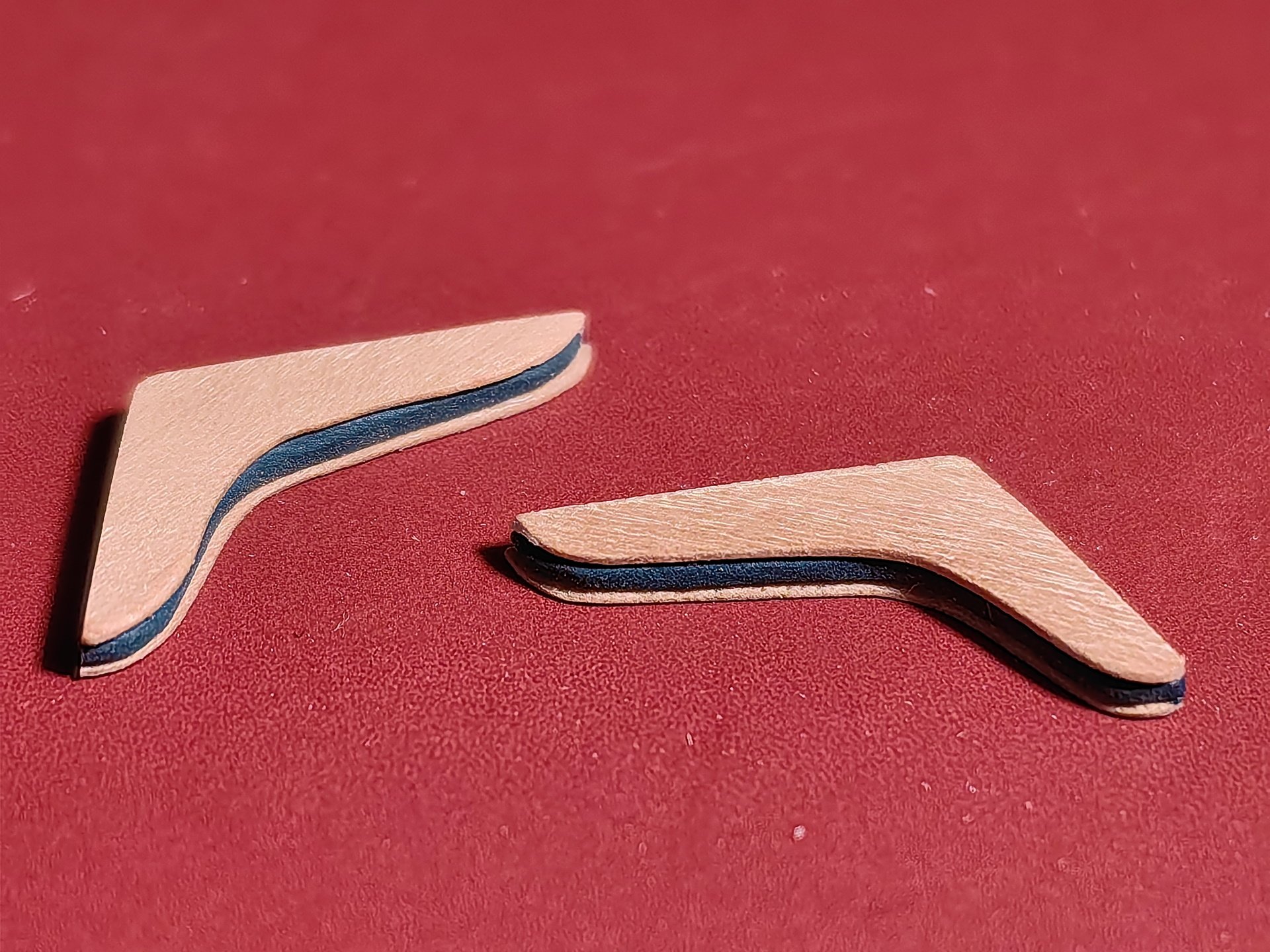

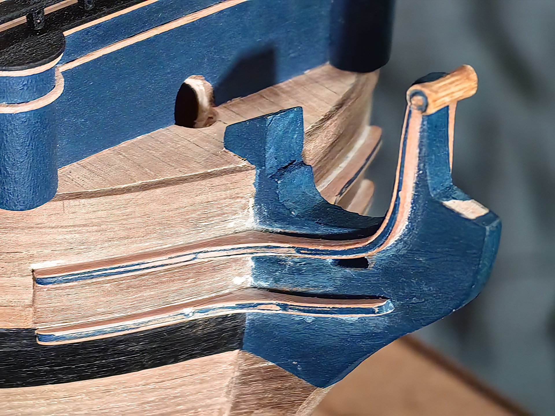

Hello everyone!

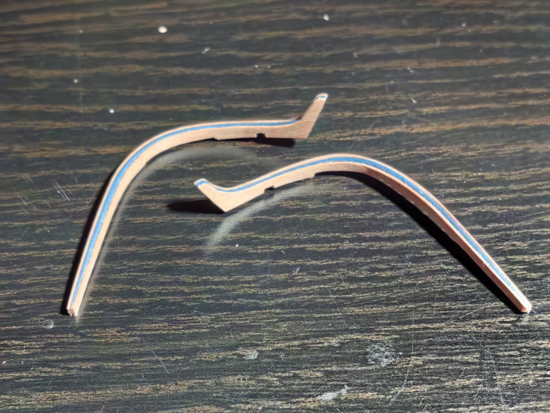

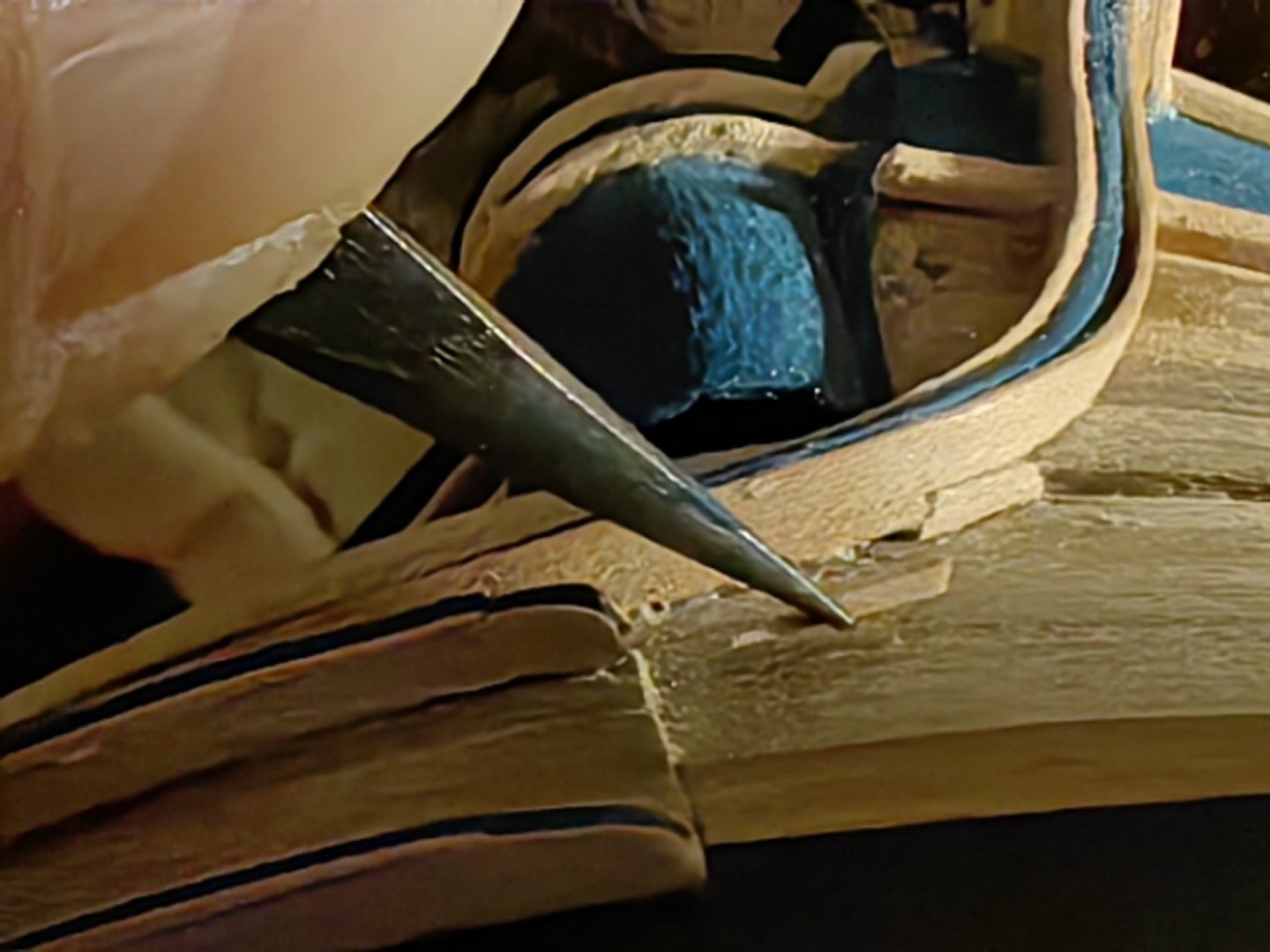

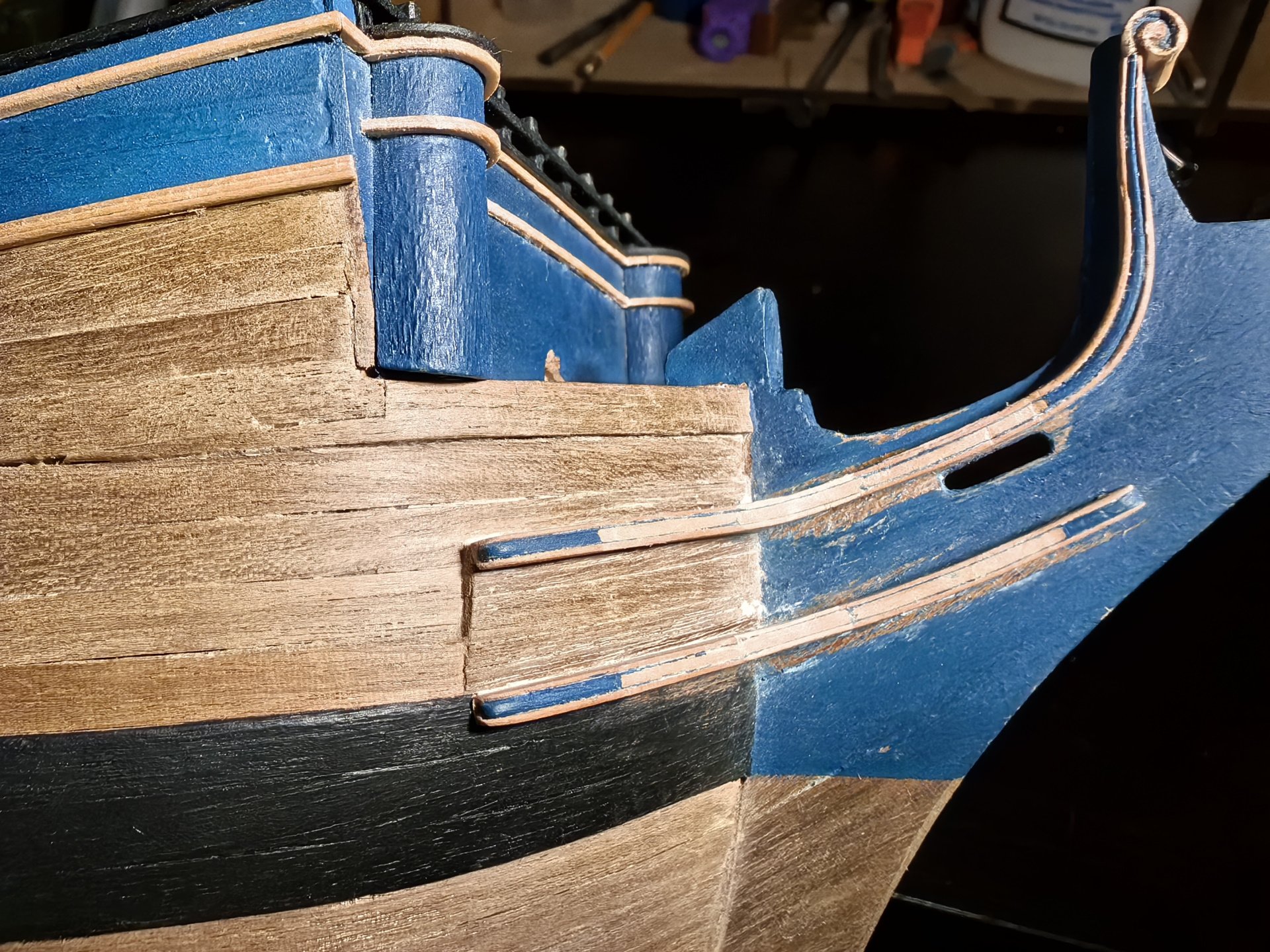

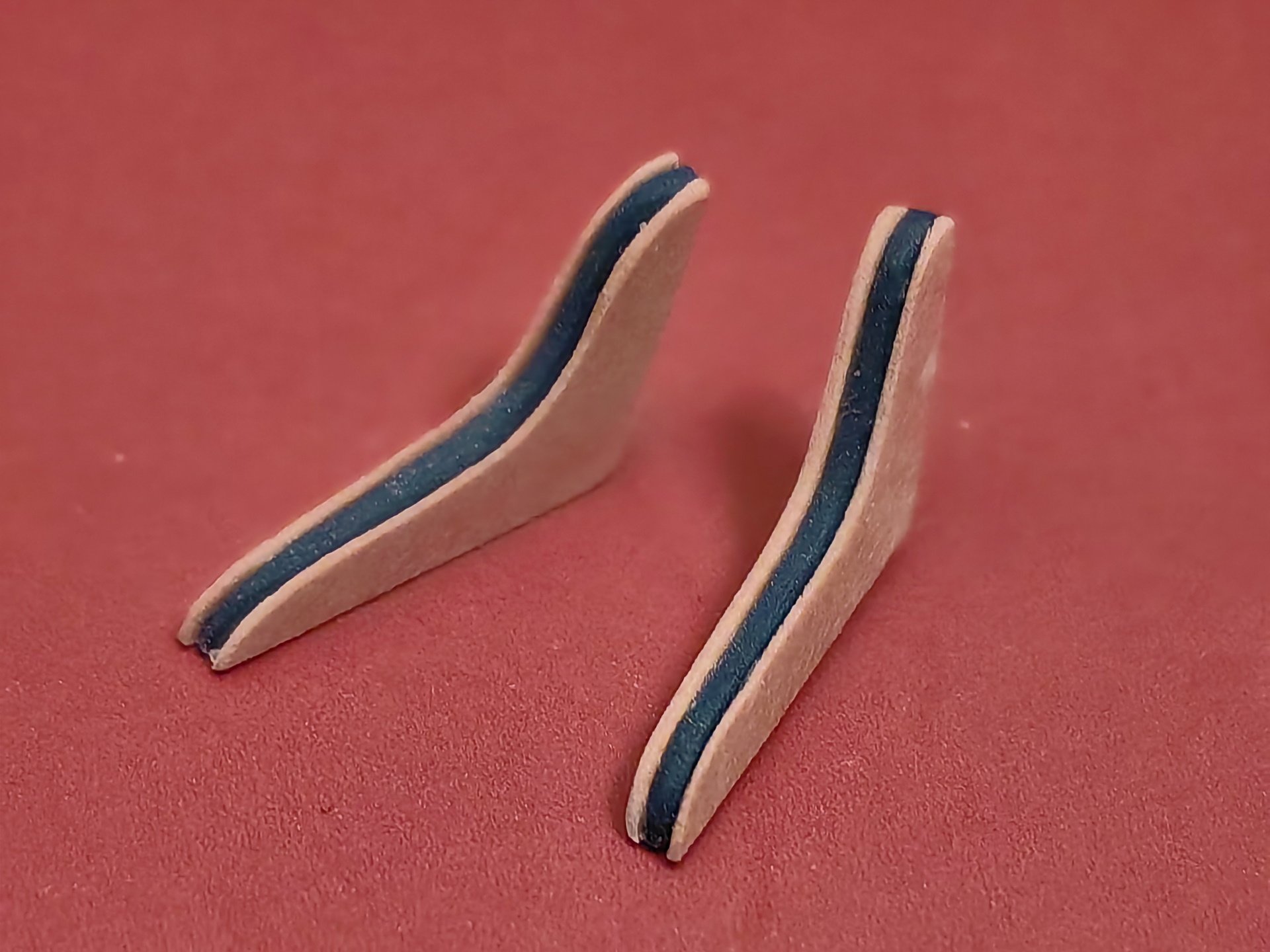

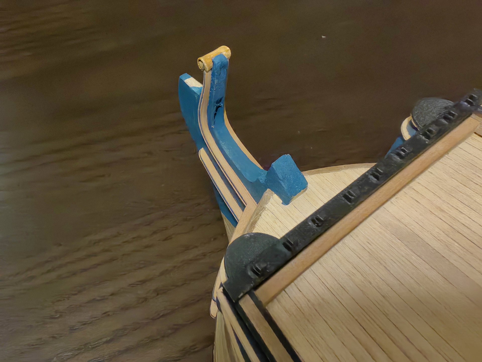

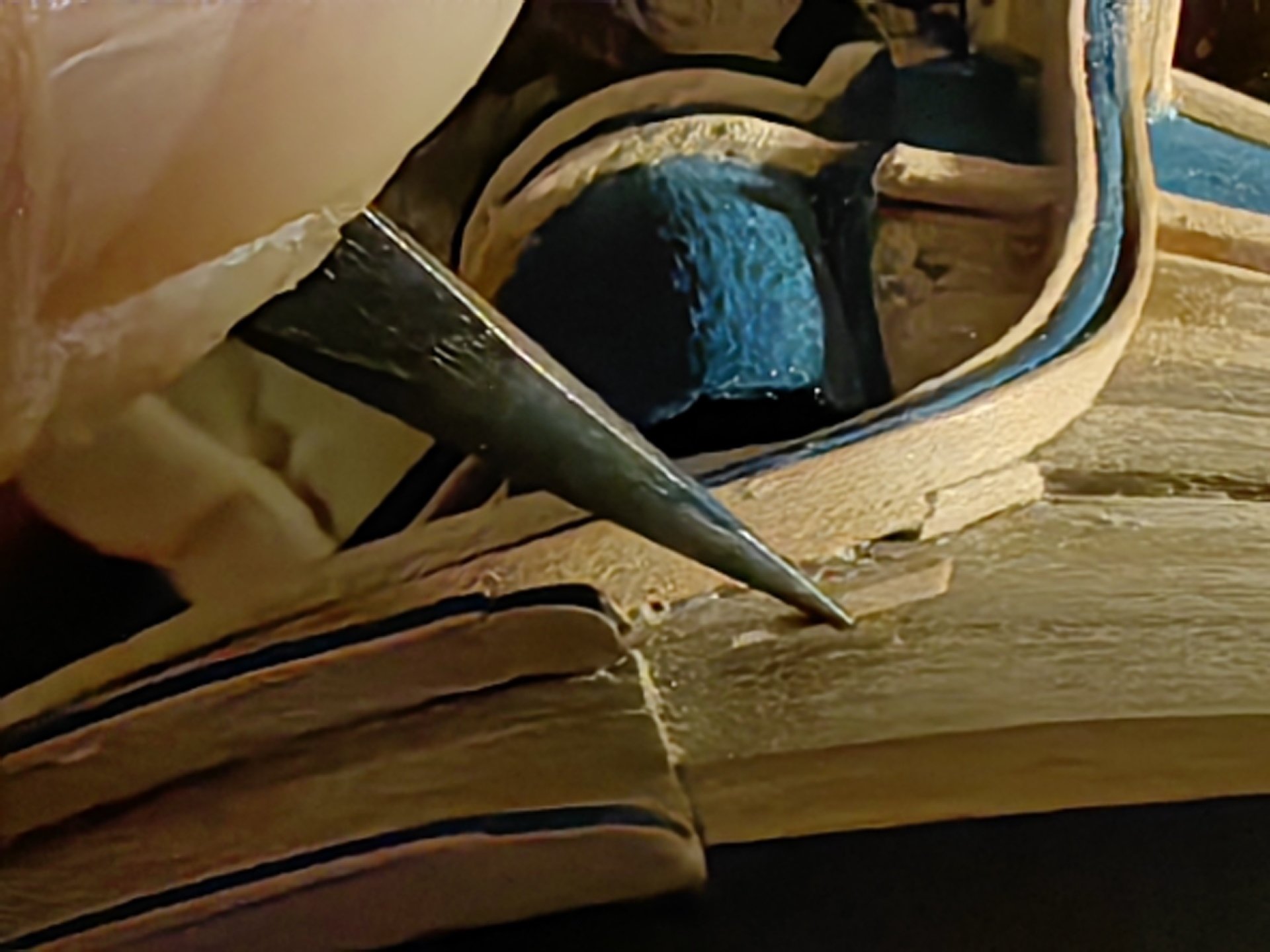

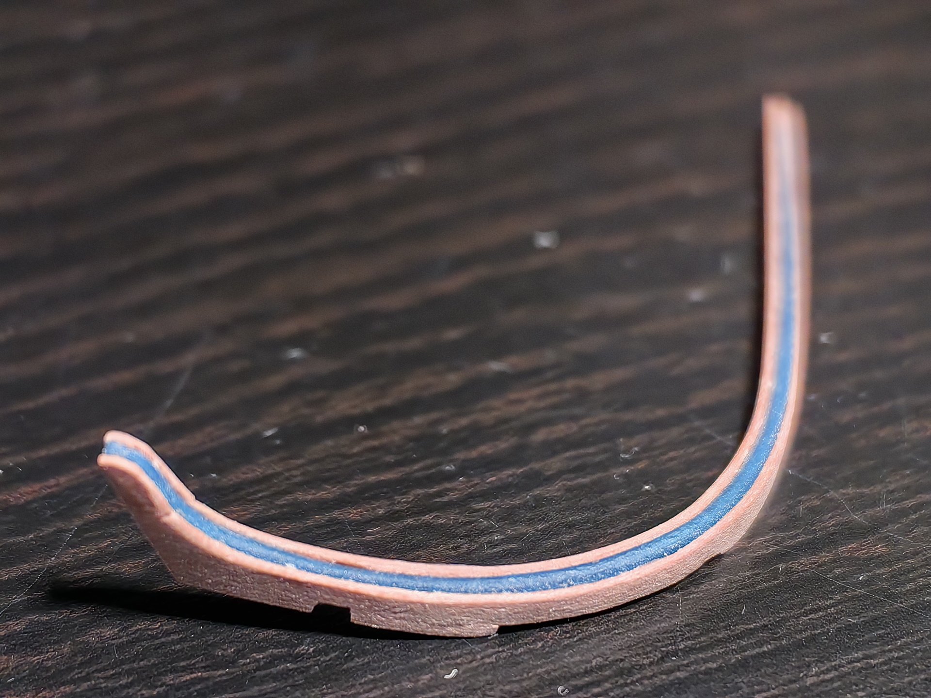

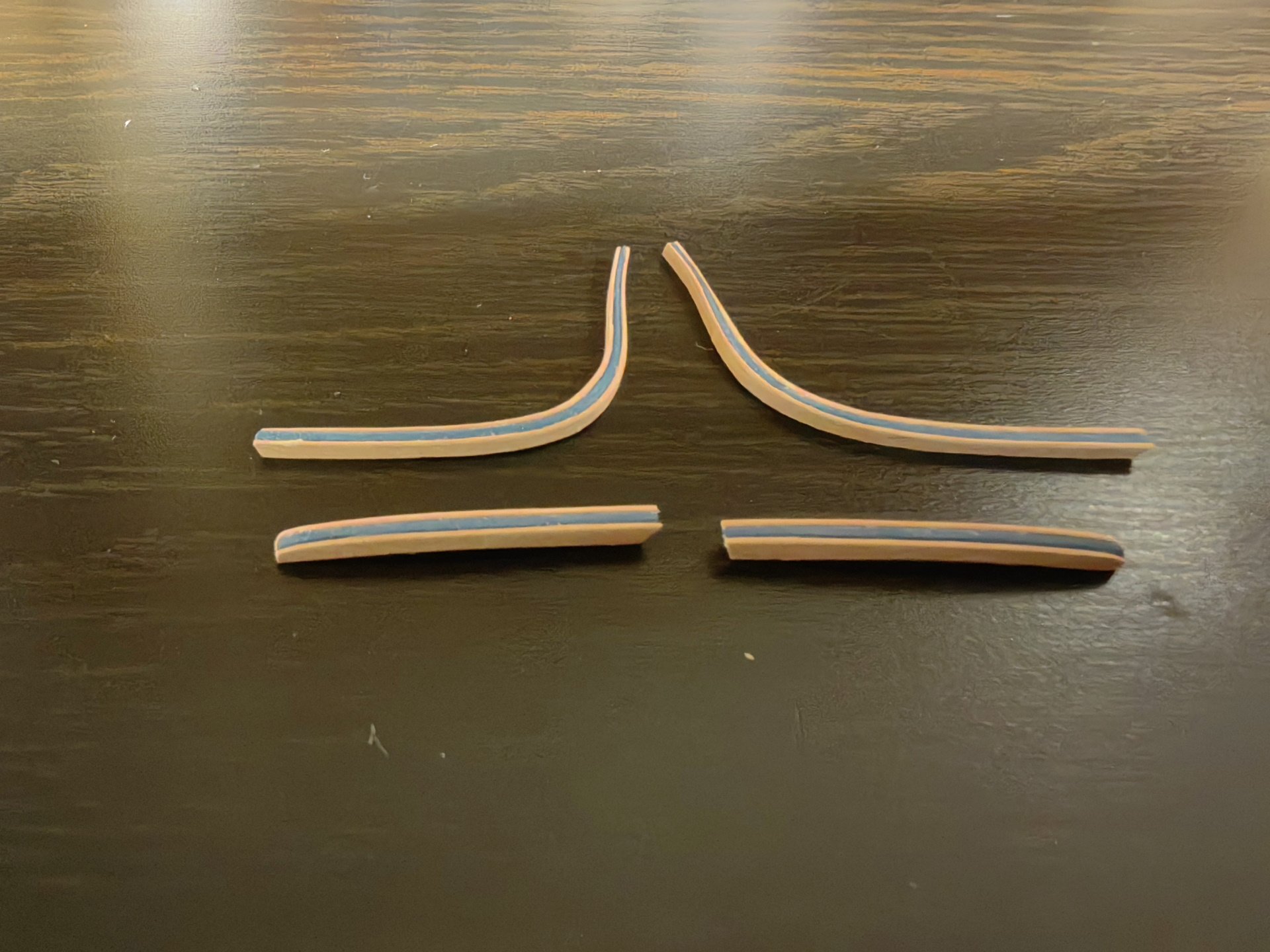

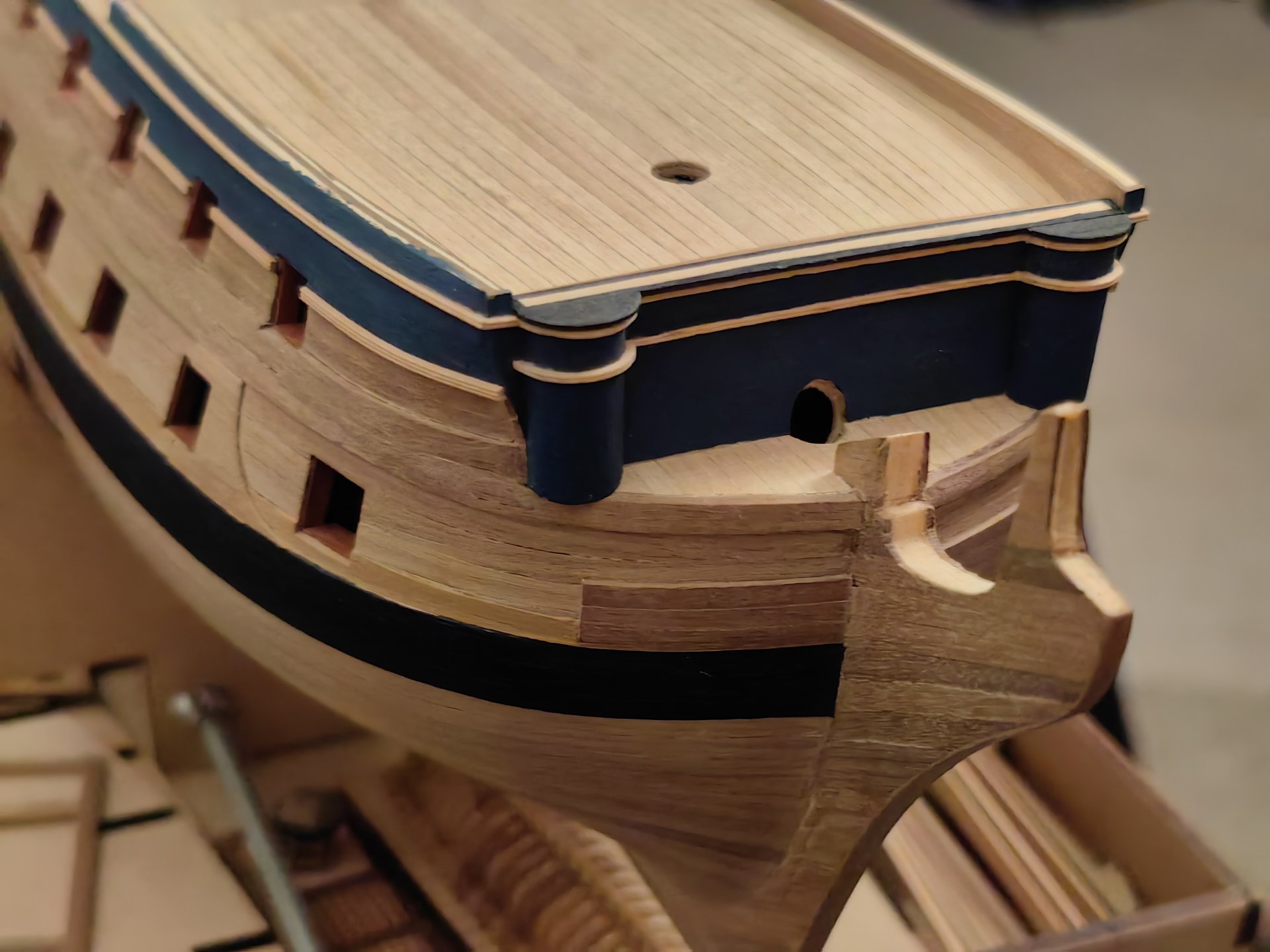

I've been working on the bеakhead for the past three weeks, but it's not as easy as it seems! Since the cheeks  are essentially the knees, I decided to make a thickening at their junction in the form of a separate part. And since the cheeks are glued together each of the three parts, then the details had to be made in the same way. And here I faced difficulties. The outer slats are only half a millimeter thick, and even with the most careful processing, they easily break. In addition, I tried to make the joint as invisible as possible and for this it was necessary to sharpen the tips almost to zero. In general, I broke an uncountable number of them.  Although the joints were still visible, I decided to stop there.
But after that, I decided to fill in the gaps where the cheeks were attached to the body with acrylic wood-colored putty, which I had purchased specifically for this purpose. However, I made a mistake. I was not careful enough when applying the putty, and it ended up covering the entire nose of the model. When the putty dried, it turned out to be almost white, and it got trapped between the three parts of the cheeks, making it impossible to remove. I managed to remove the putty from the smooth surfaces, but I couldn't remove it from the cheeks without removing the paint from the middle rail. After that, I couldn't paint it without getting the adjacent areas dirty. I didn't want to redo the cheeks, so I decided to make a compromise. I cut off the damaged part, made a 0.5 mm thick edge from three pieces of wood, and glued it to the cheeks. It wasn't as beautiful as it was before the putty, but it was still passable. Then I had to touch up the head knee and chainwales  This is the result.

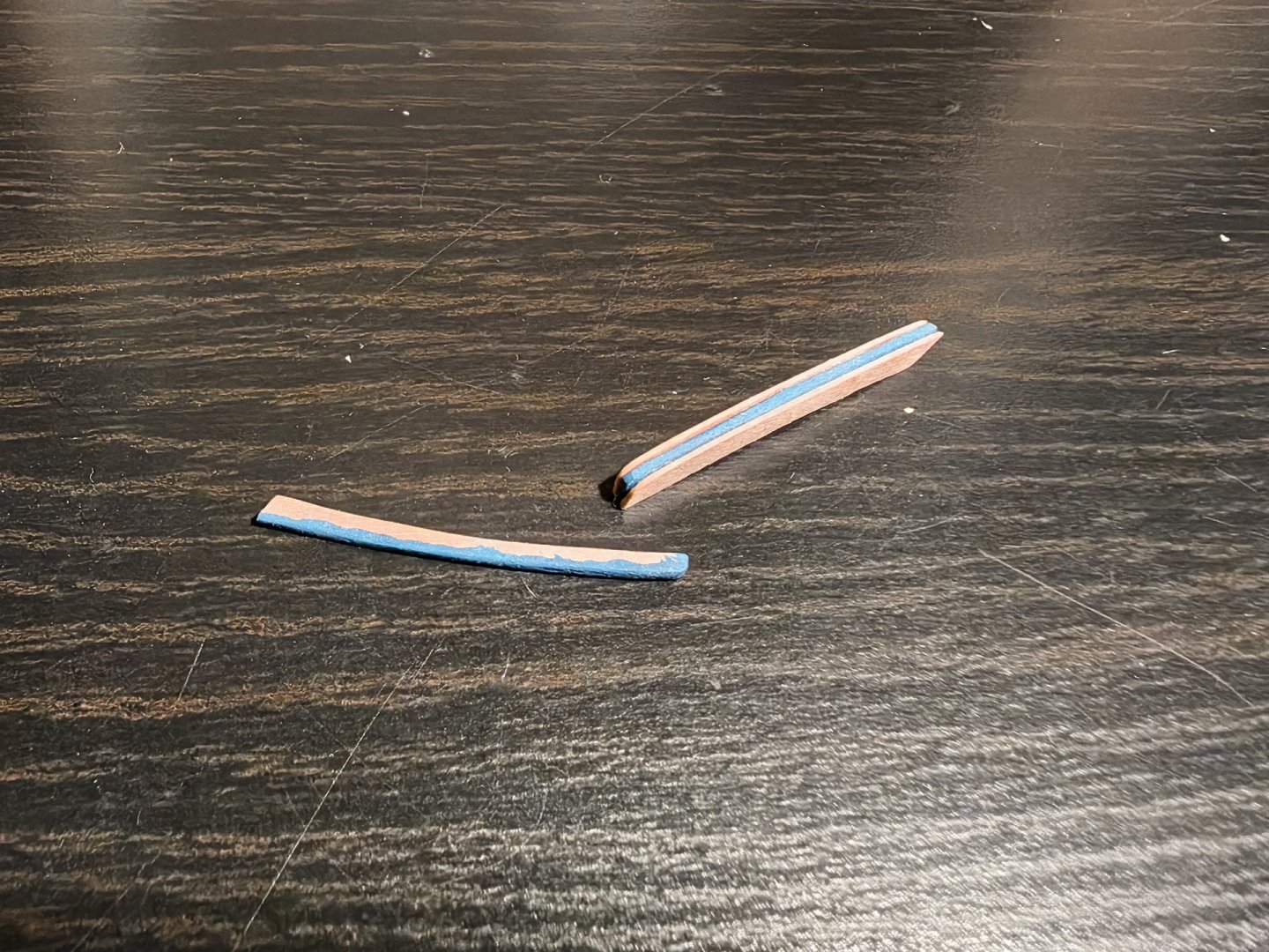

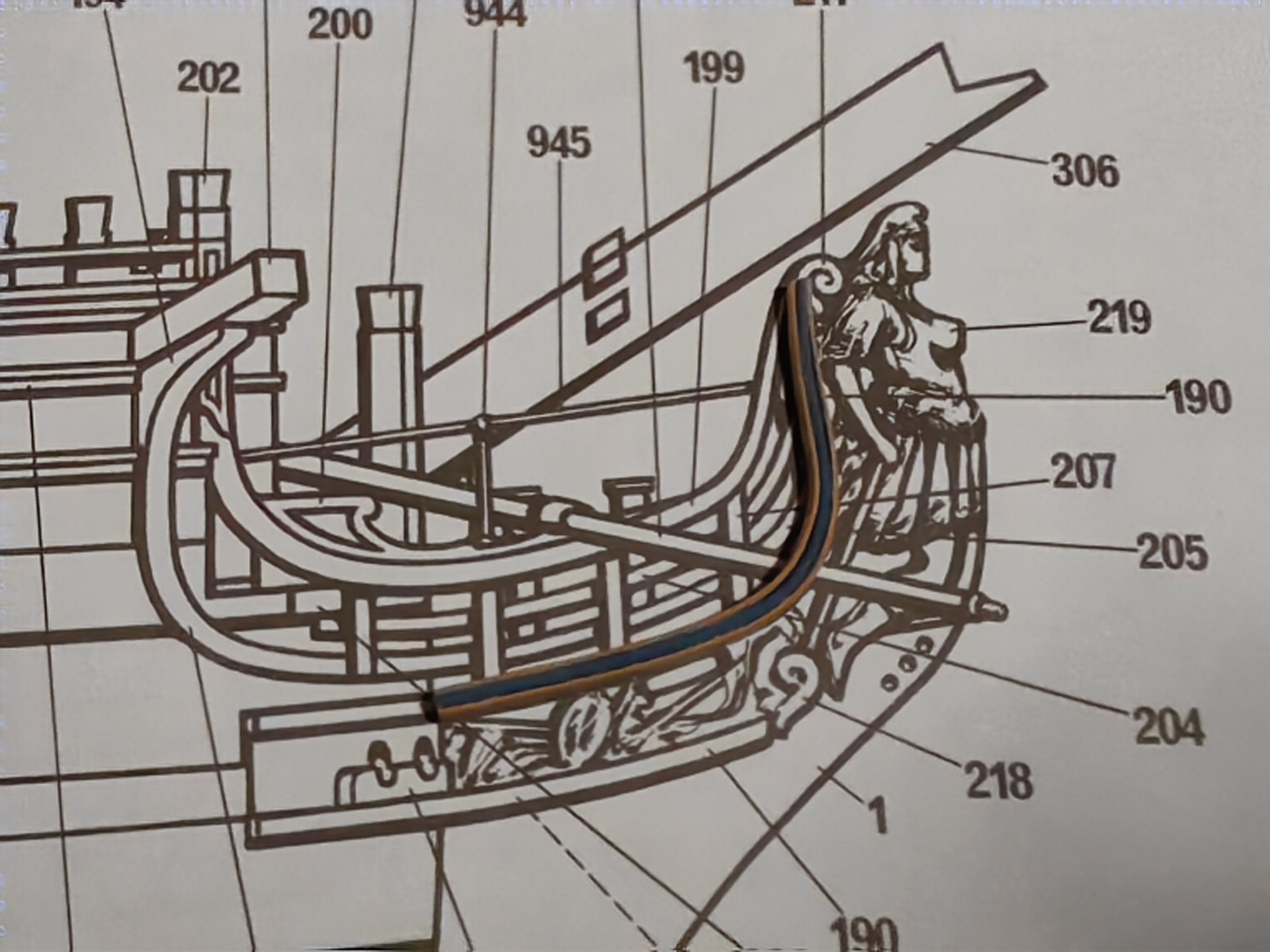

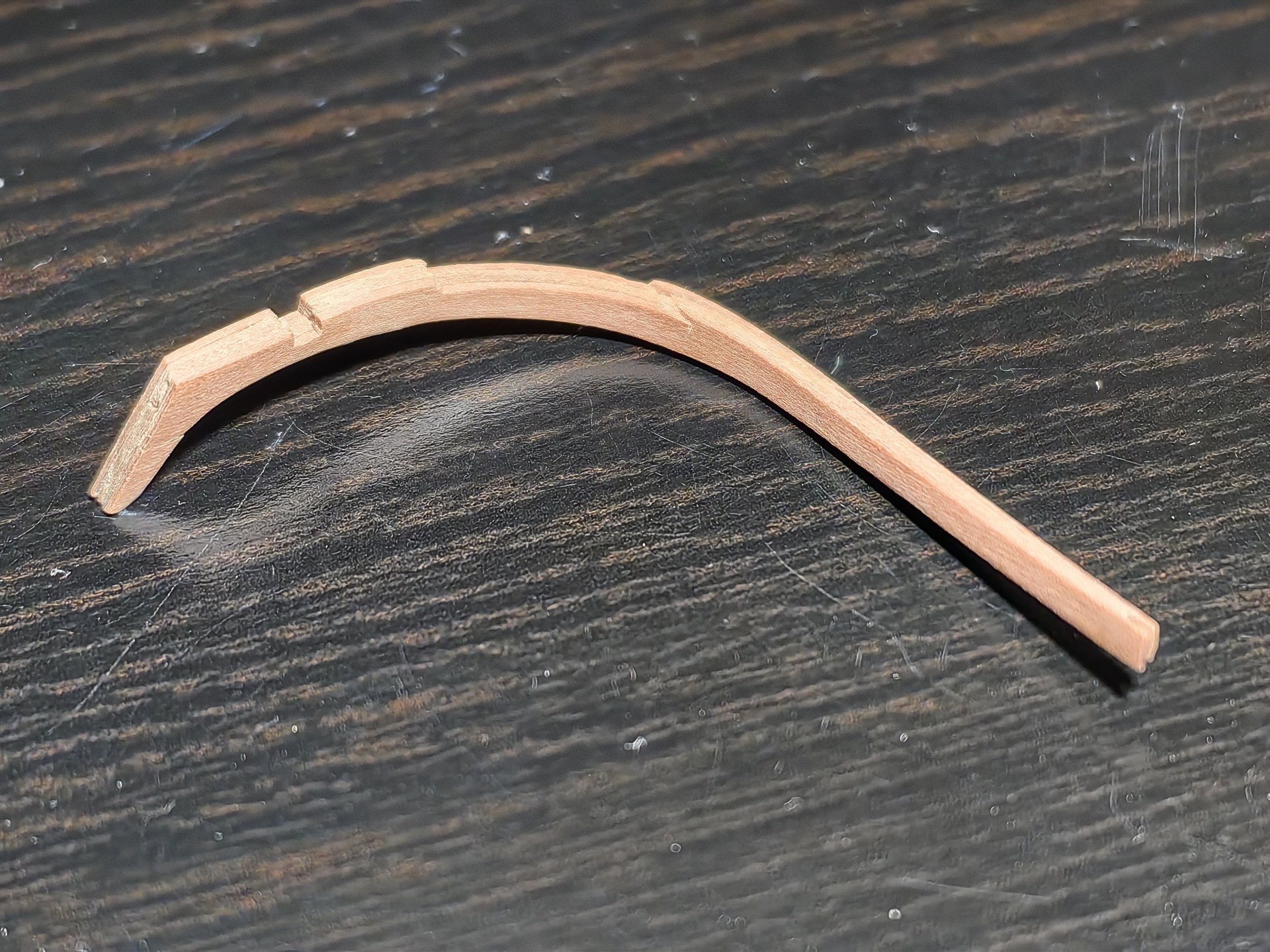

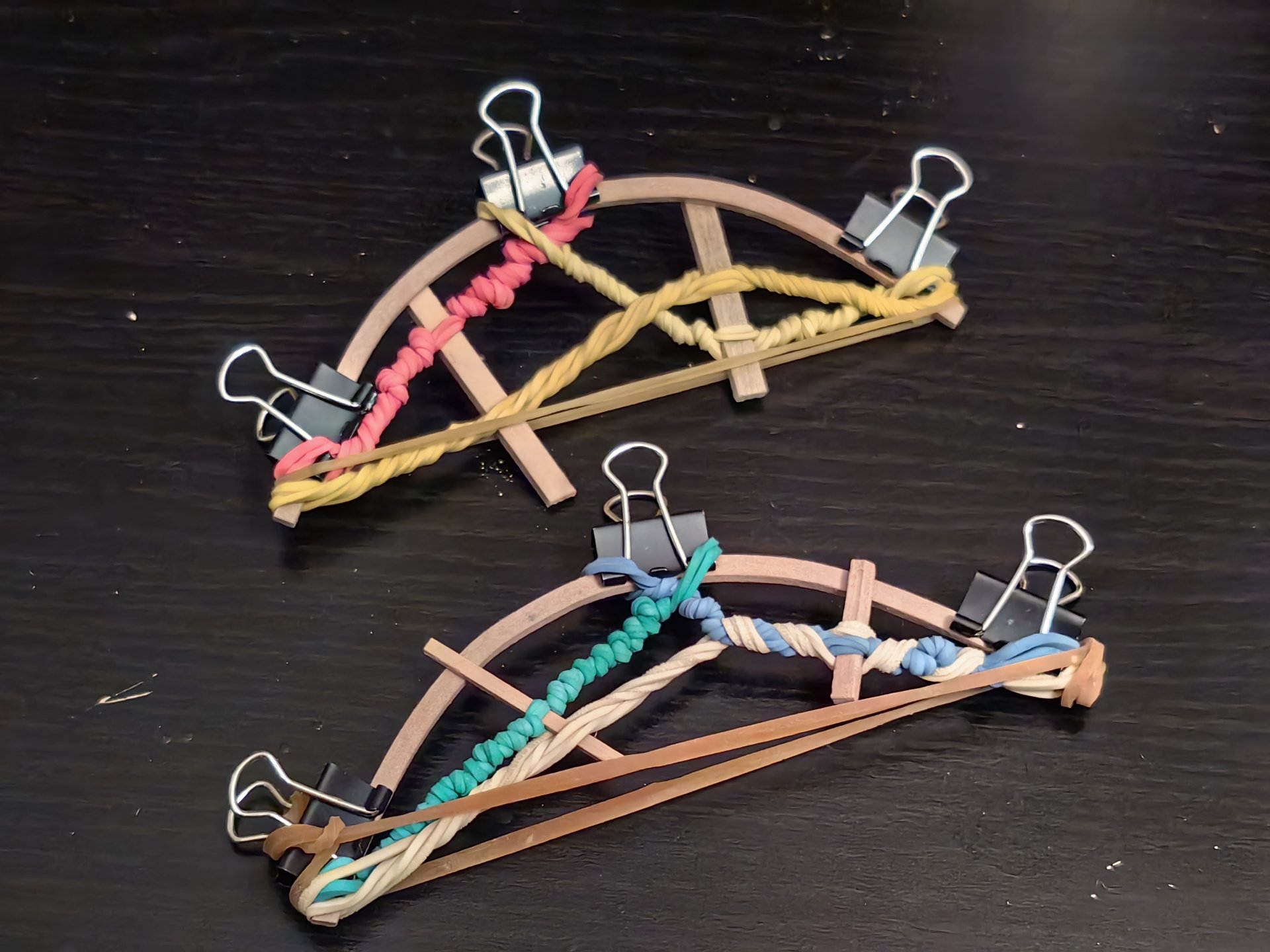

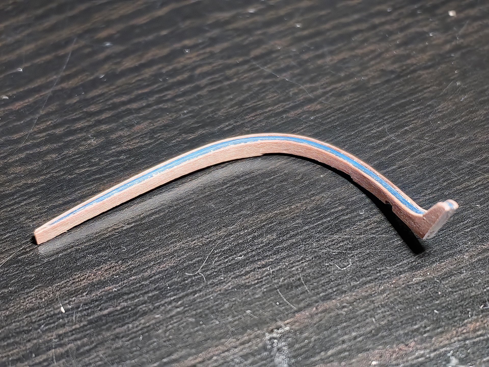

The next step was to make the main rail. At first, I tried to bend a 2x4 mm rail according to the profile on the drawing. I steamed it in boiling water, bent it with an iron, and then soaked it again in boiling water, holding it with rubber bands to prevent it from straightening. However, it didn't work out. The curve was too sharp, and the rail broke. In the end, I cut the central part of the main rail from a 20 mm wide rail and glued the ends. On prototypes and museum models, these rails have a beautiful carved profile. To give the rails a similar profile, I made a tool similar to the one used to profile the rails along the sides. However, the main rail gradually narrows from 4 to 2 mm, while the tool's profile width is 3 mm. Additionally, since the part was cut from a wide rail, the tool sometimes cuts across the layers, resulting in poor initial quality of the profile. A round file and sandpaper solved this issue. This is what I ended up with.
The top timbers on the main rail should fit snugly against the top timbers on the bulkhead of the beakhead, which is painted black. It might be a good idea to paint it black as well, but on the Charles Middleton’s  model, represented in the museum it's painted by wood color and looks good. I decided not to paint it yet and see how it looks when assembled. If there are any issues, I can always color it up later. I'm not entirely sure about the best order to assemble the beakhead. I think that I will first make all its parts and then assemble the whole structure. In the meantime, as a reference point, I decided to use the cathead, which I made from a beech 4x4 mm rail, pasted with a 0.5 mm rail from a pear tree and installed them on the body.

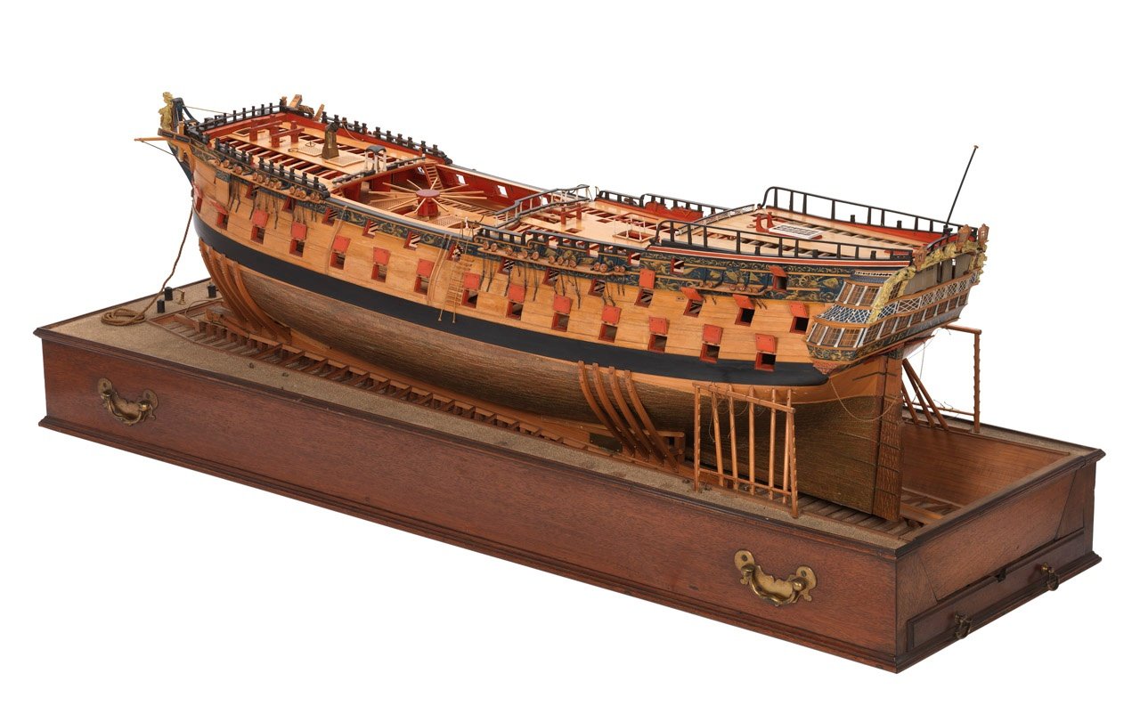

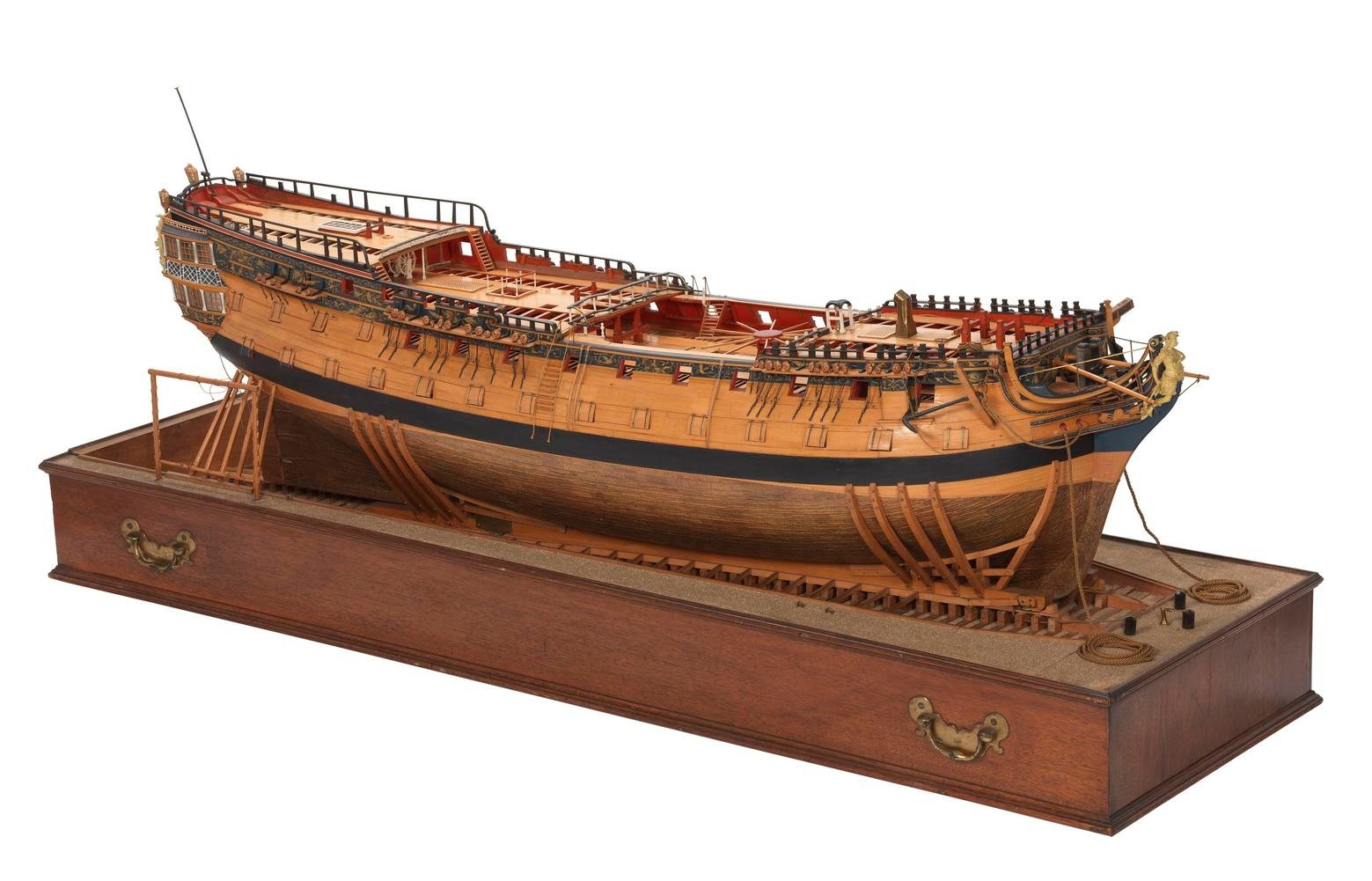

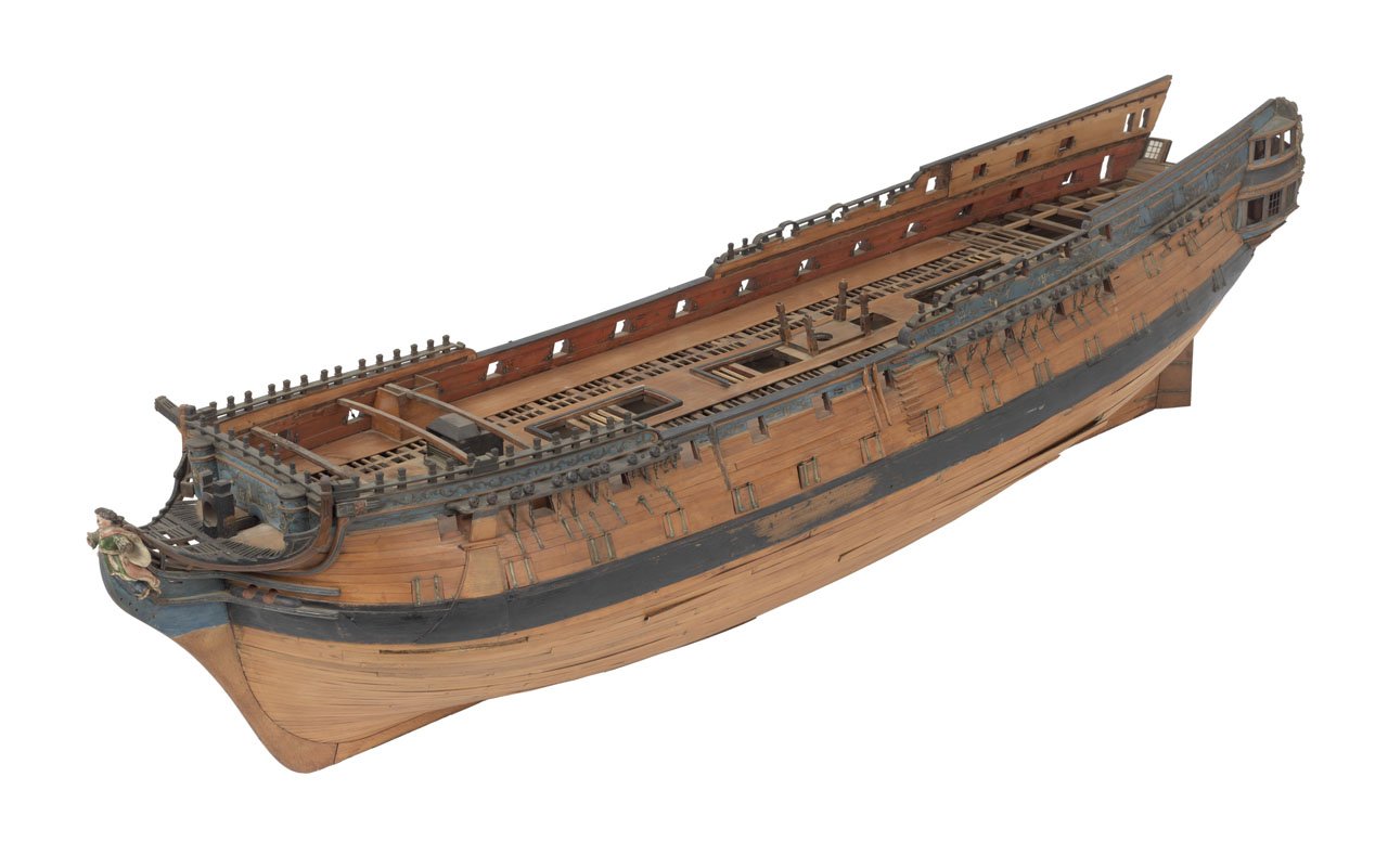

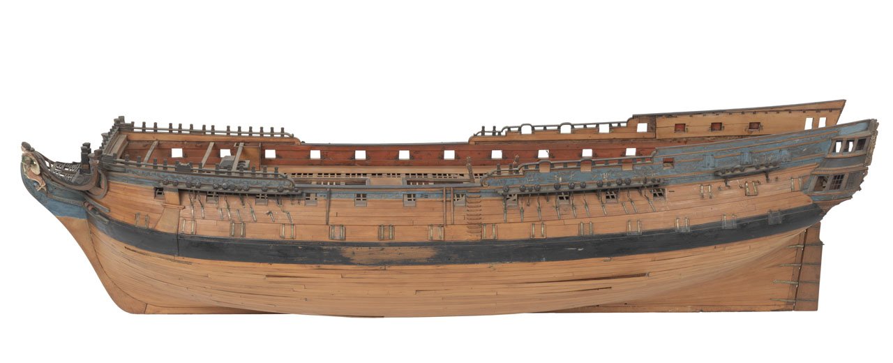

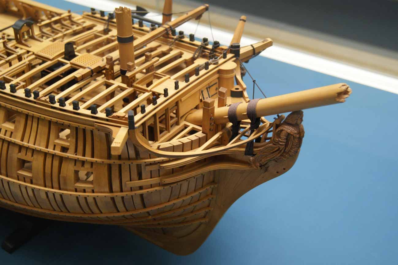

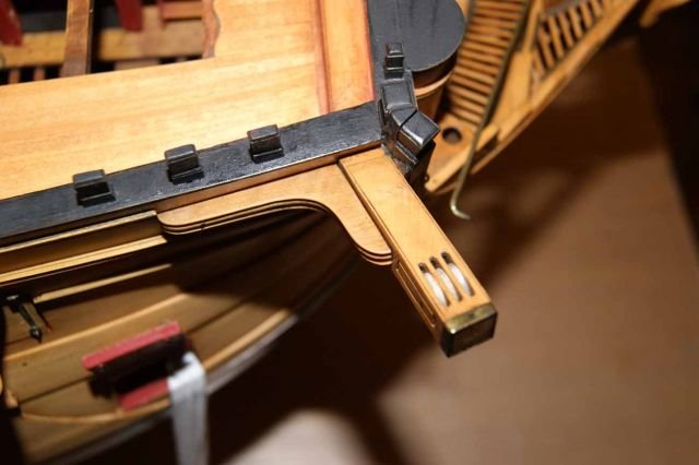

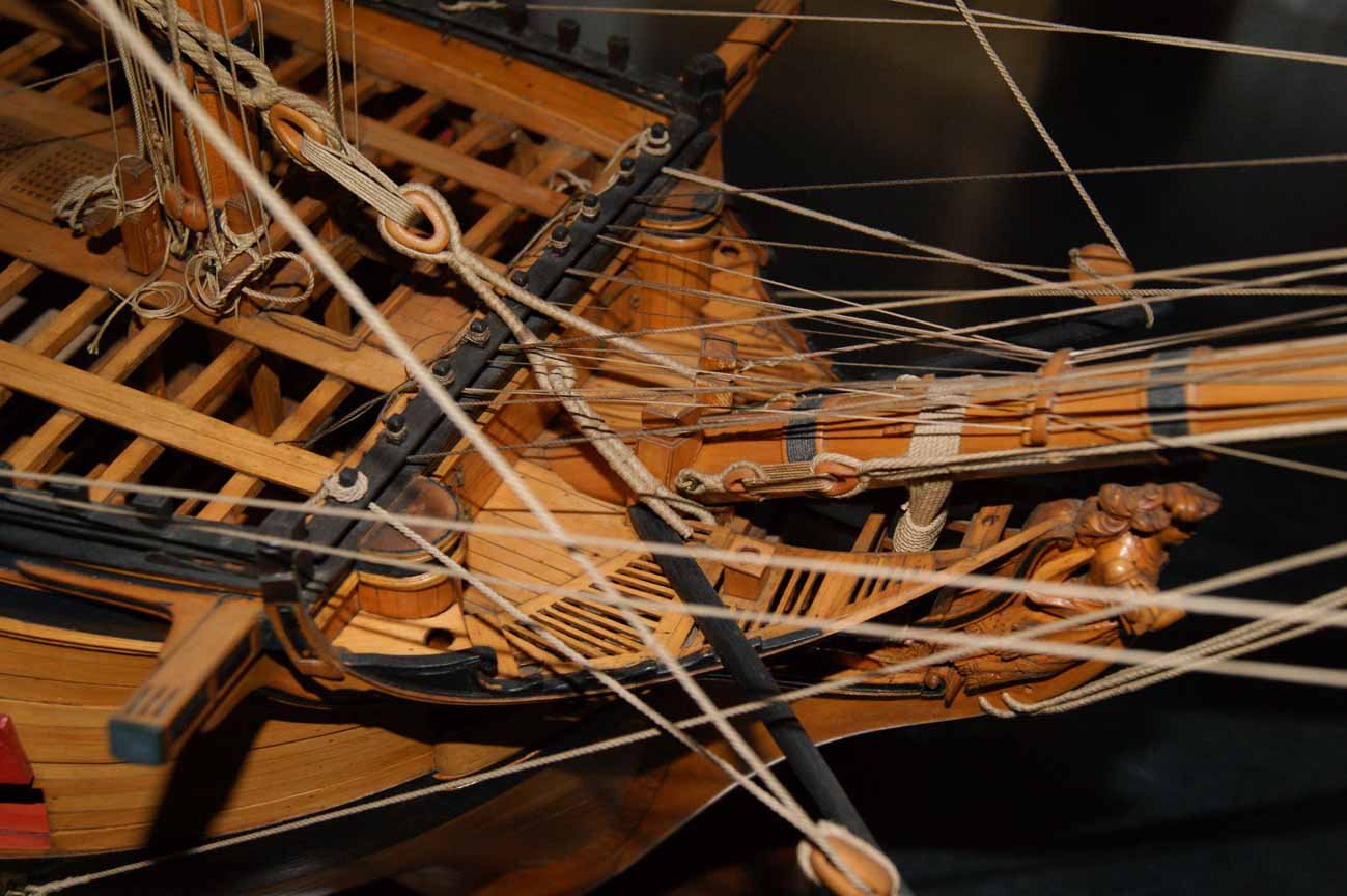

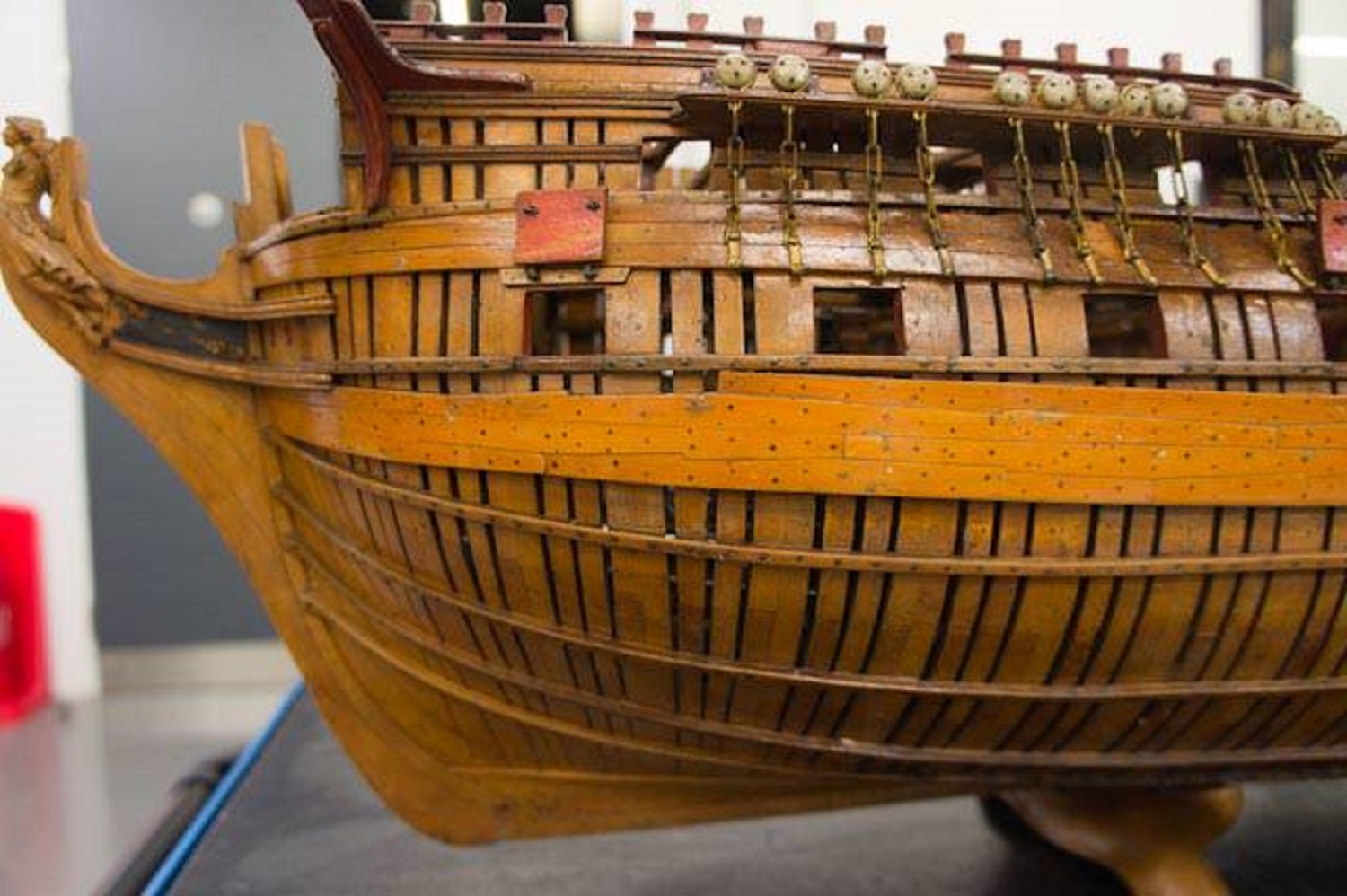

... Looking at the photos of the museum models, I noticed that Thomas Slade's model has catheads supported not only by the saportus, but also by a knitsa pointing towards the stern.
However, this detail is not present on Charles Middleton's model, in Lavery's anatomy, and certainly not on Corel's drawings. Since I am building a Bellona model, I believe it is necessary to include this element. Unfortunately, I have already installed the catheads  on the model. It's not difficult to make a knees, but I don't want to remove the catheads, so I'll have to carefully cut off the back of the decoration to attach the knees to a flat surface.
Before you butcher your nice decoration near the catheads, keep in mind that the Anatomy of the ship does not mention the presence of that knee pointing towards the stern, as you indicated. I think this element only belongs Slade's model and is not representative of the ships of that time.
In my opinion, you should not add it as it makes the sleek lines of the Bellona less pleasant and is not required from a carpentry perspective.
Yves
Hello, Yves, thank you for your comment. I haven't decided yet whether I'll make this knees or not... It looks good as it is. However, I would like to disagree with you about the necessity of this knees. The krambol was used to lift a multi-ton anchor and secure it to the side of the ship, bringing it to the stern. It is evident that the krambol had to withstand tremendous loads in two directions, which were compensated by these knees. The models from the Greenwich Museum demonstrate the presence of these knees:
Edgar, Egmont, Thunderer, Warrior

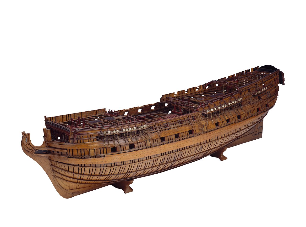

And the Slade model, unlike the later Middleton model and even more so the modern Lavery anatomy, is the exact prototype on which the ship was built. And the "Installation Party" of the series consisted of not one, but three ships. Bellona, Dragon, Superb. The Dragon model, which also shows this knee, has been preserved in Greenwich.

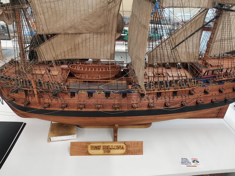

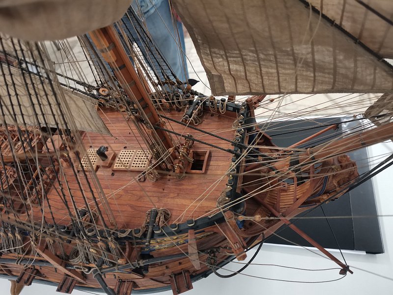

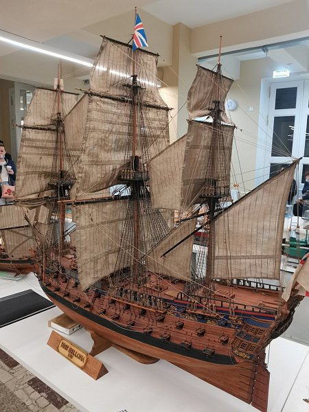

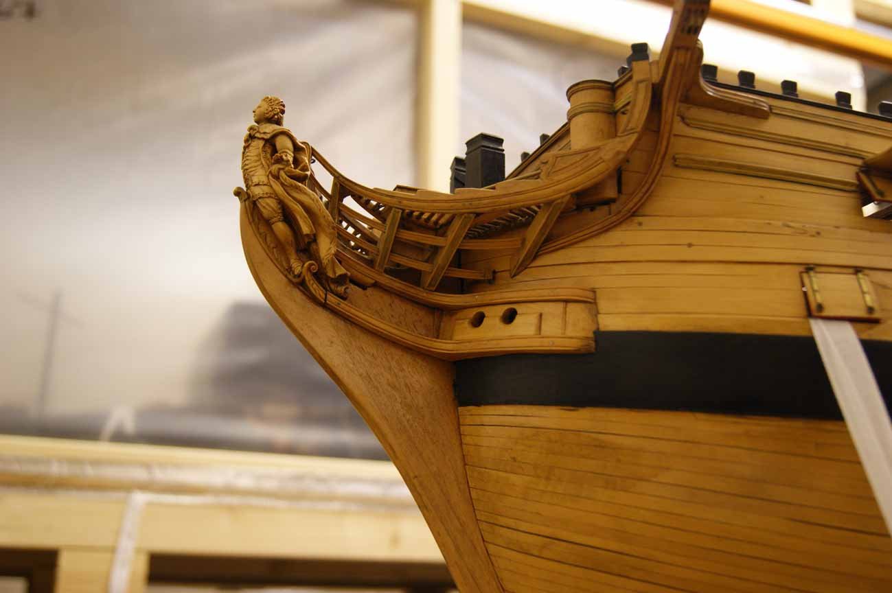

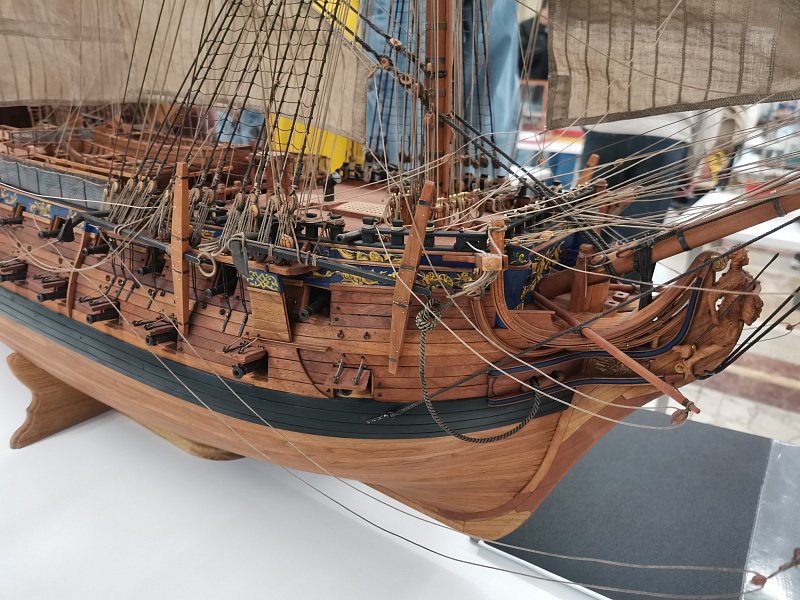

Below is a picture of the CAF Model kit of the Bellona, I built a couple of years ago:
This kit (1/48) is based on the Anatomy of the Ship and the fabulous 1/36 model located in England at the Maritime Gallery. You may want to consider it when you are done with your COREL model, if you still need an extra dose of Bellona 🙂

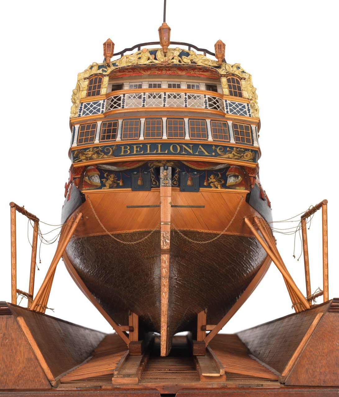

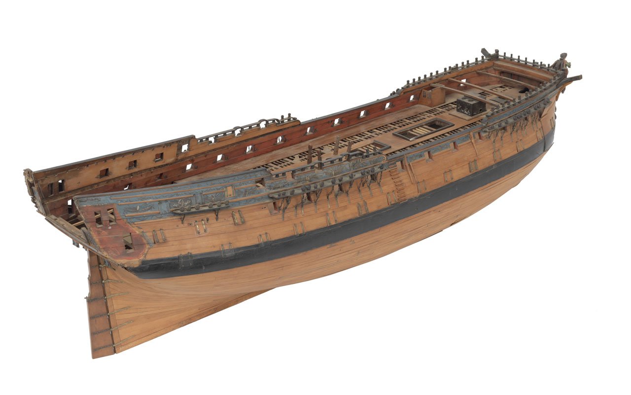

Yves, do you mean the model from the National Maritime Museum in Greenwich?
Specifically, this model shows a third-rank battleship of the "Dublin" class, not the "Bellona" class. There is a difference. It's all about the history of the model. This particular model was commissioned by the Surveyor of the Navy, John Williams, as a gift to King George III during a scheduled audience. Williams was pushing for government funding to cover His Majesty's Navy ships with copper sheathing. The plan was to cover the entire fleet with copper, which would have been extremely expensive and required a significant increase in metal production. The protracted fighting in the American War forced the blockade to be conducted in an extremely unfavorable long stay in the waters of the Caribbean, where, after the loss of colonial naval bases, the English fleet suffered losses from the shellfish teredo ("shipworm"). The ship "Bellona", by that time already an old man, was the king's favorite - it was with the launching of "Bellona" that the reign of the long-lived king began, and George treated the ship like a godson. The model was intended to impress the king, and it also served as a demonstration of John Williams's technology, including methods of sheathing, insulating layers, and more. Since there was no time, a model of the first seventy-four guns ship was obviously taken, covered with copper for demonstration, and decorated to look like a Bellona. The ship itself was sailing near India at that time, and apparently there were no drawings for comparison (and they are) at hand. It's funny, but the Greenwich collection contains not only the original drawings of the Bellona, the first ship of the largest series of 74-gun ships, but also a model of the work of the Navy Surveyor Thomas Slade. So the photos show a certain 74-guns ship of the "Dublin" class, with a working stand that simulates the ship's launch (the copper coating was done by tilting the ship, and it was pointless to bring the ship into a dry dock and put it on a launching sled - this is clearly an unsuitable model for explaining the technology, let alone the idea of mass copper coating of the entire Navy!).
The audience and demonstration were a success, and the king signed the relevant decrees. For the first time in the world, in less than two years, the entire British Royal Navy was copper-clad at the government's expense, as part of a government program. The first ships to receive copper cladding using Williams's technology were... of course, the Bellona and the Victory.
The Middleton model is a great example to follow in many ways. In my work, I try to do many things the way they are done there. The CAF Model kit is most likely based on this model. However, even within this kit, each modeler can do many things in their own way. For example:
