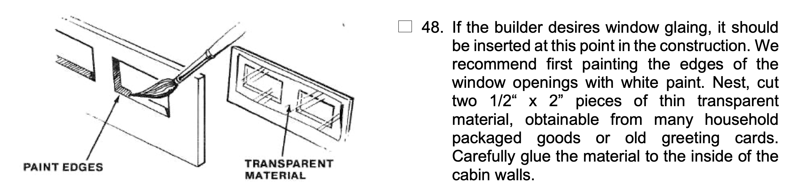

My Scow Schooner has fairly large openings for windows. The instructions note that a "thin transparent materials" can be used - "from many household packing goods or old greeting cards."
Recommendations for what looks good, is reasonably easy to use, and easy to find to simulate window panes / window glazing?
