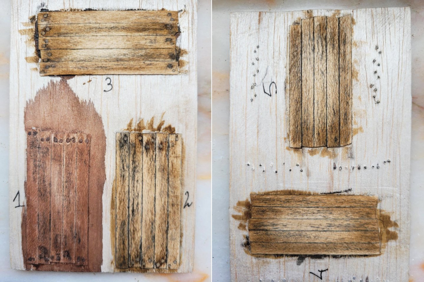

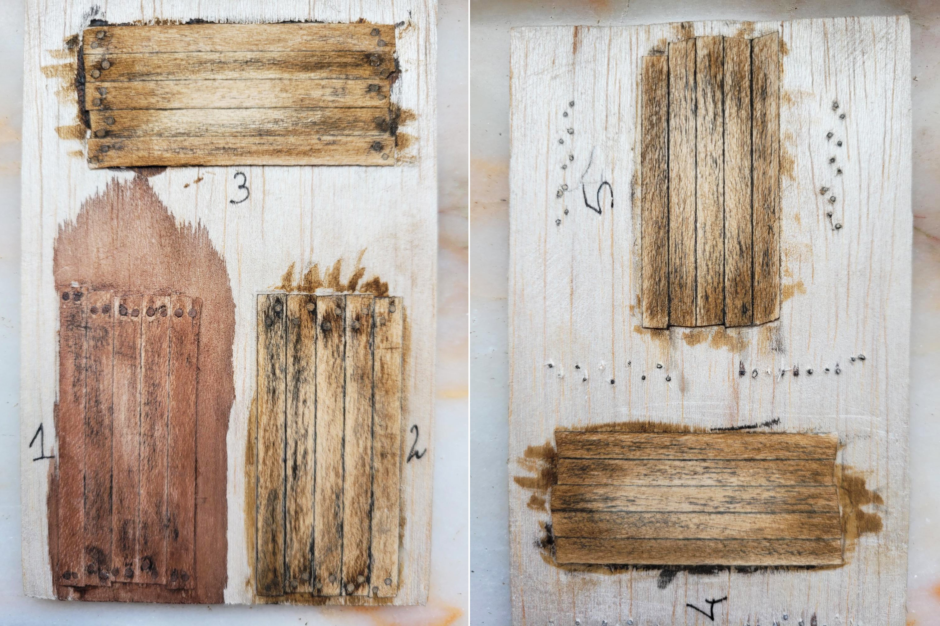

Here I present you with the result of five weathering techniques. Or, to be more specific, variations of 2 or 3 techniques.
Techniques:
1) Plank sides penciled, dashes of black paint and sanding, wash of walnut in a 1:2 ratio.
2) Plank sides painted black, wash of judean bitumen (1:4) and sanding, wash of indian ink with alcohol and sanding (4 drops per 4 ml, unintended mess up).
3) Planks glued with bitumen colored glue, dashes of black paint and sanding, wash of judean bitumen (1:4) and sanding, wash of indian ink with alcohol and sanding (again with the wrong proportion). Second wash of 1:4 bitumen.
4) Plank sides painted black, dashes of black paint and sanding, wash of judean bitumen (1:3) and sanding
5) Plank sides painted black, dashes of black paint and sanding, wash of judean bitumen (1:3) and sanding, wash of indian ink with alcohol and sanding (1 drop per 4 ml).
Note: all were more sanded, particularly in the middle, as all weathered parts will have different amounts of sanding according to use.
My opinion:
1) Hate it. Period.
2 and 3) I very much like the plank sides painted black in 2, more effective as caulking simulation than pencil or colored glue. On the other hand, the second bitumen wash (in comparison with 4 and 5) made it a bit too yellowish. Also, the mistake in indian ink proportions messed up the result.
4) Increasing bitumen wash proportion to 1:3 and applying only once gives a less yellowish look than 3, which look better to my eye, but maybe a bit orange. I also like the result of black paint dashing and sanding as simulating humidity.
5) Now with the proper proportion of indian ink wash, I think it gives a nice result in highlighting caulking and humidity, and also in toning down the orange in 4. Maybe a bit too dark, I may dilute the indian ink even more.
So, now I'm inclined to go for either 4 or 5. Would love to hear your opinions!
