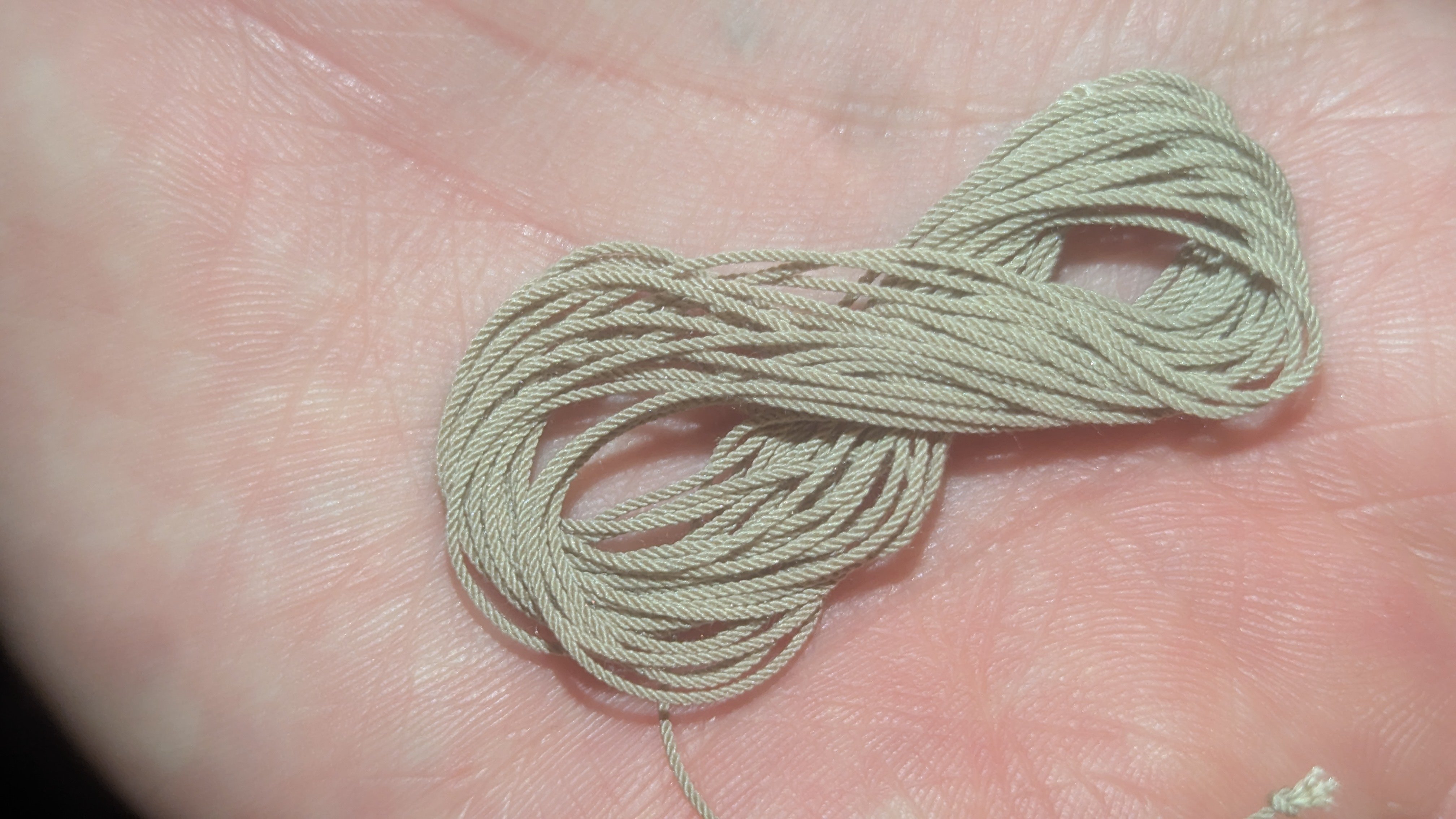

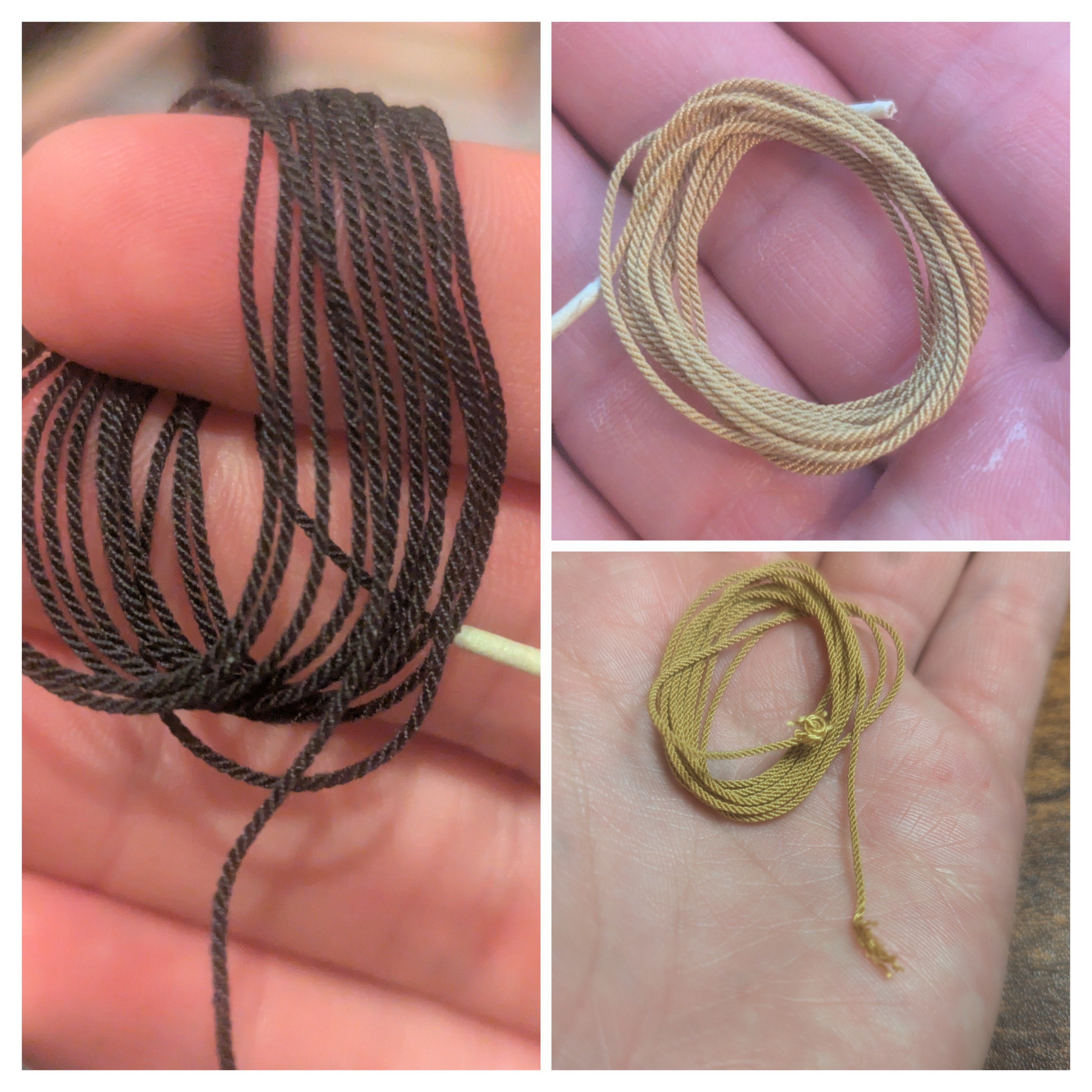

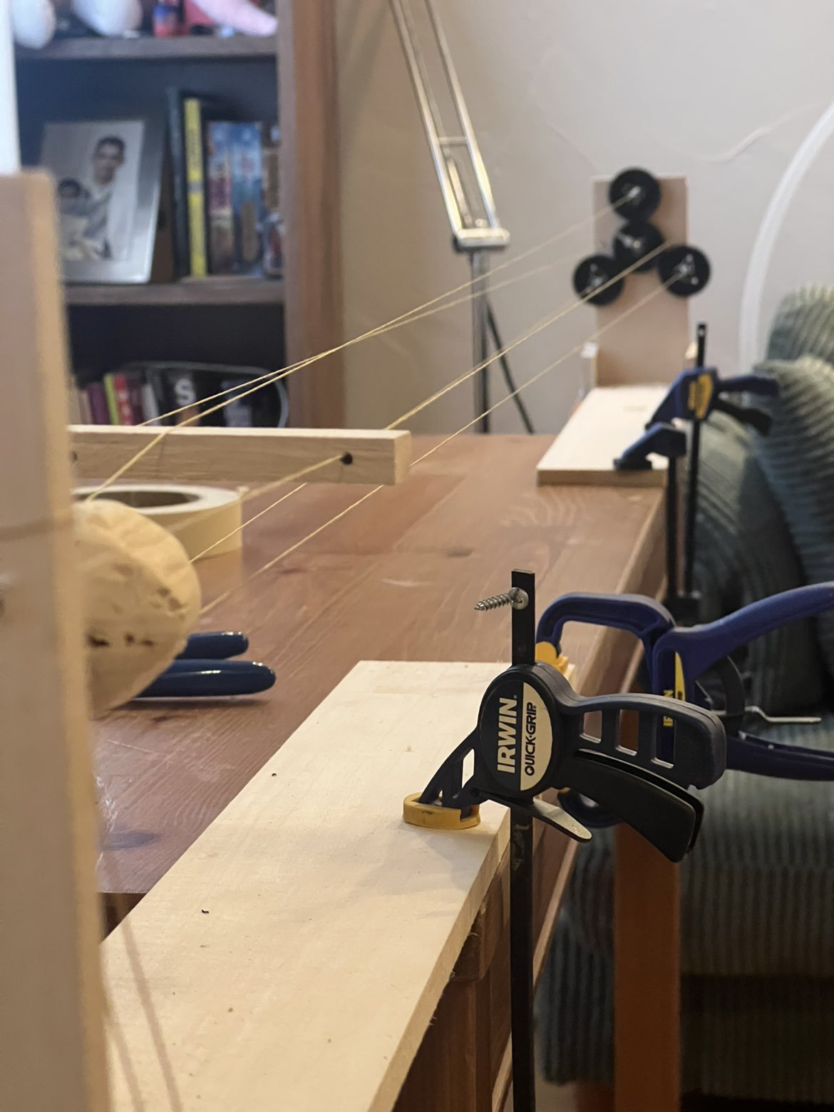

Firstly, I made a ropewalk! And will attempt to use only made-by-me rope for the entire build, I'm excited to start using it, but it'll be a while. Here's some rope I've made so far:
Everything will be right hand lay from now on I promise.
If you want to see a breakdown of the ropewalk itself, I made a post about it here:

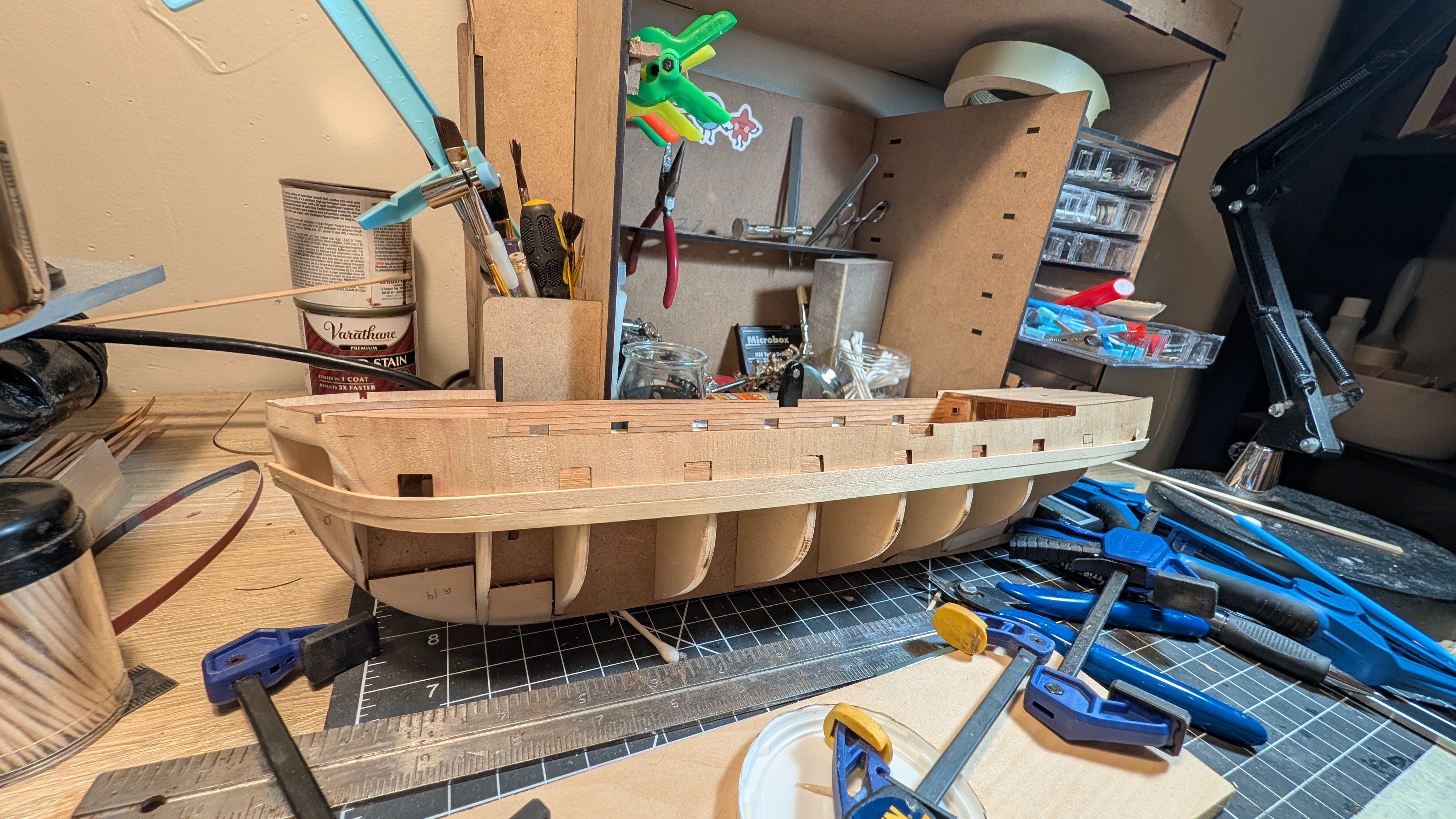

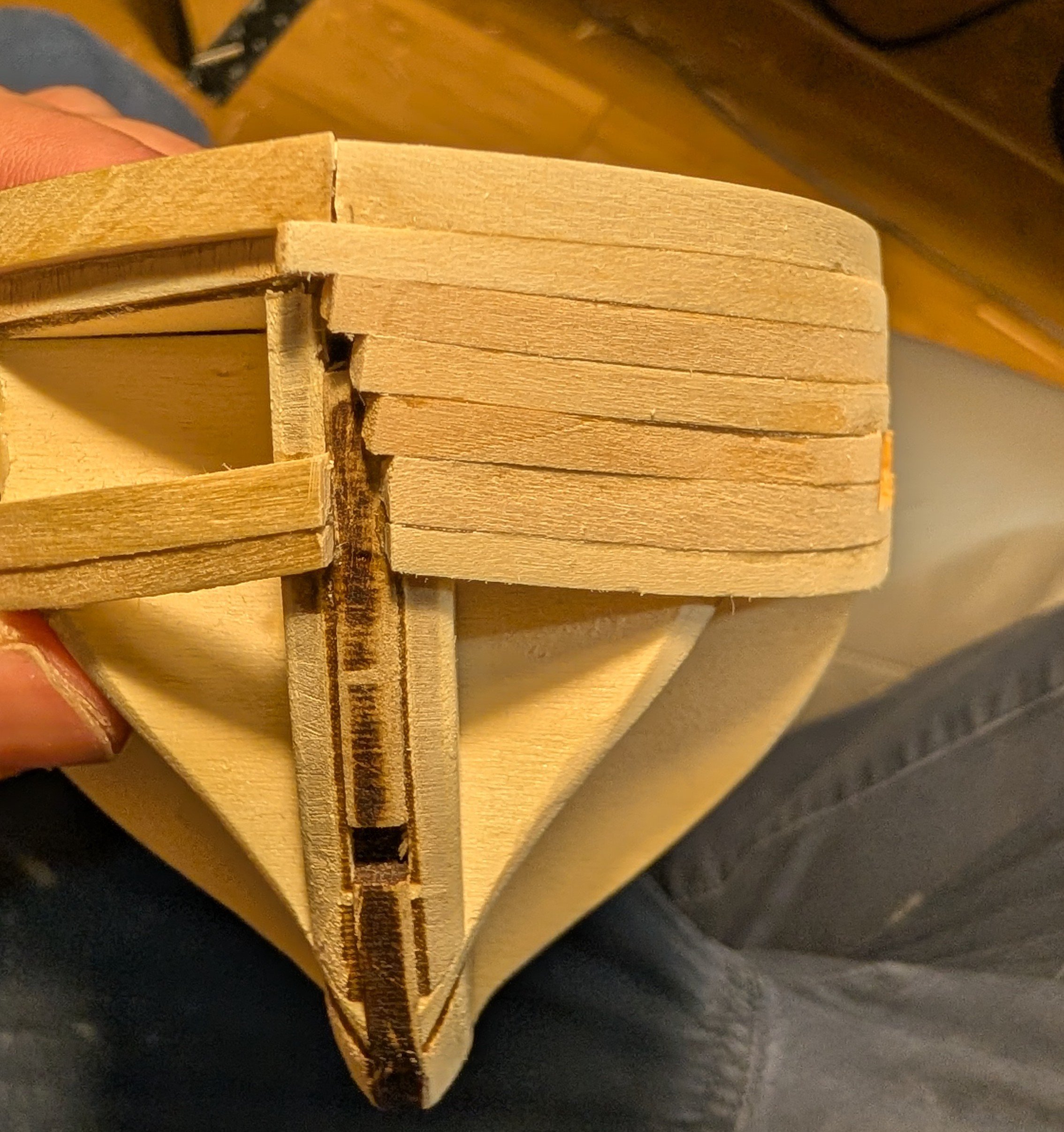

I was excited to apply all the lessons I learned from the Albatros, especially the lesson on how-to-not-break-your-bulwark, but the "damage" that Fed Ex referred to was exactly 1 snapped bulwark.
No big deal I hope, but it does feel like I'm developing a relationship with bulwarks akin to @Knocklouder with bowsprit.
Glue is drying as I type this, and I have high hopes.

  Your ropewalk is setup with a 'top' (juggernaut) that runs itself up to the geared end as the rope is made - similar to a full-size rope walk, but constrained by the side line guides.  A large version I used to use at craft demos had a swivel on the far end to relieve excess counter-twist, while other versions use a crank.  Whatever way, the product comes out about the same.
  After using Chuck's Rope Rocket (judging the amount of twist by 'feel' and distance each end moves on the two-step process), the scale rope length is 'whipped' by hand to normalize any twist imbalance (that removes any kinks), then I'll step on one end and pull out the rope in sections to stretch it out ... this 'sets' the rope pretty good.  I use poly thread for permanency, so it is heat treated on a cookie sheet  for 5 minutes in a 320 degree F oven.
  Cotton doesn't need this if stretched with moistened fingers.  Old models rigged in just plain cotton thread can have deterioration, but laid scale rope of cotton should last longer ... but many (like me) are betting on poly for the long run.  Linen rigging - like the old fly fishing line used by old timers - holds up very well, just as fine linen sails have done.

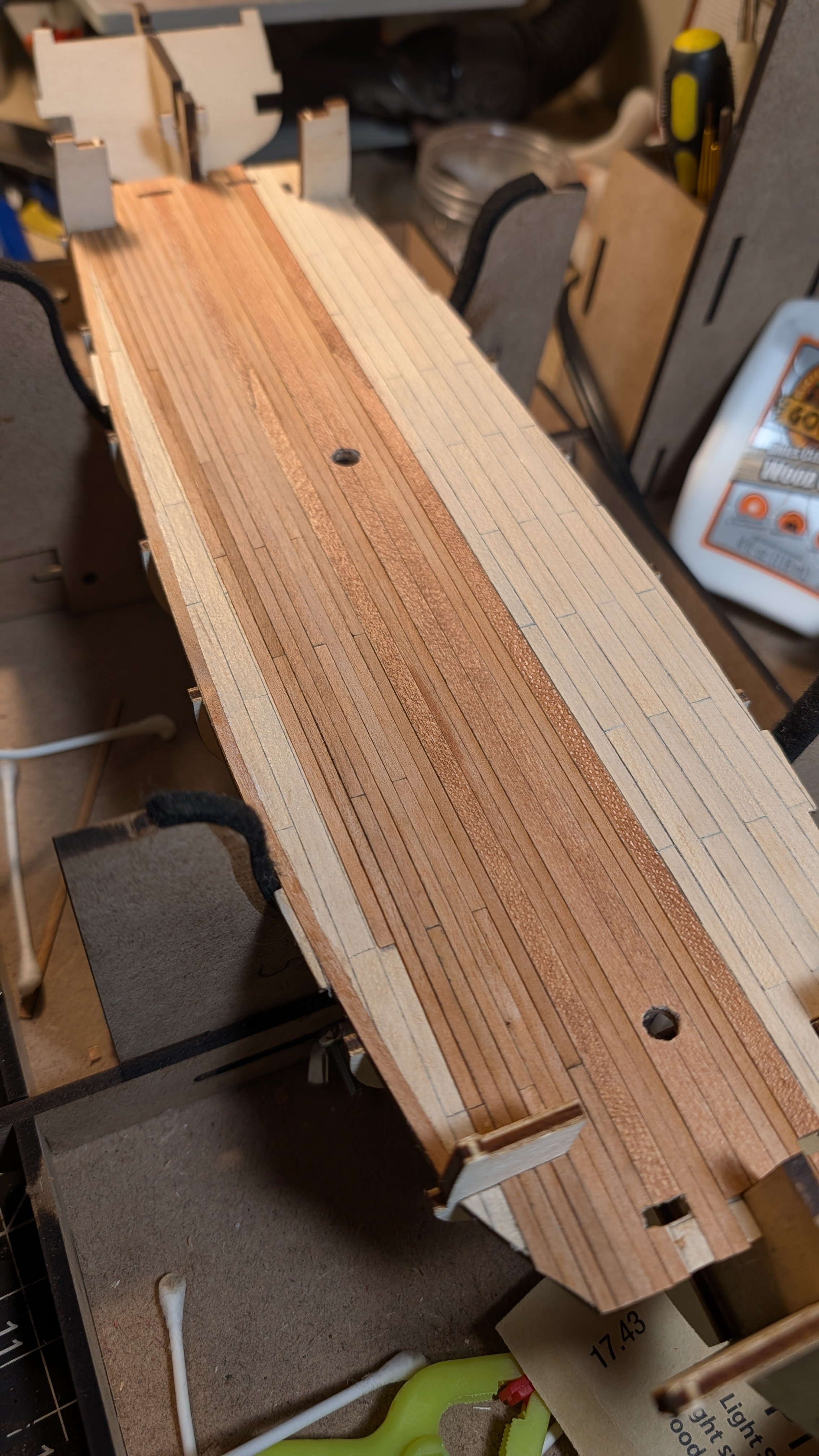

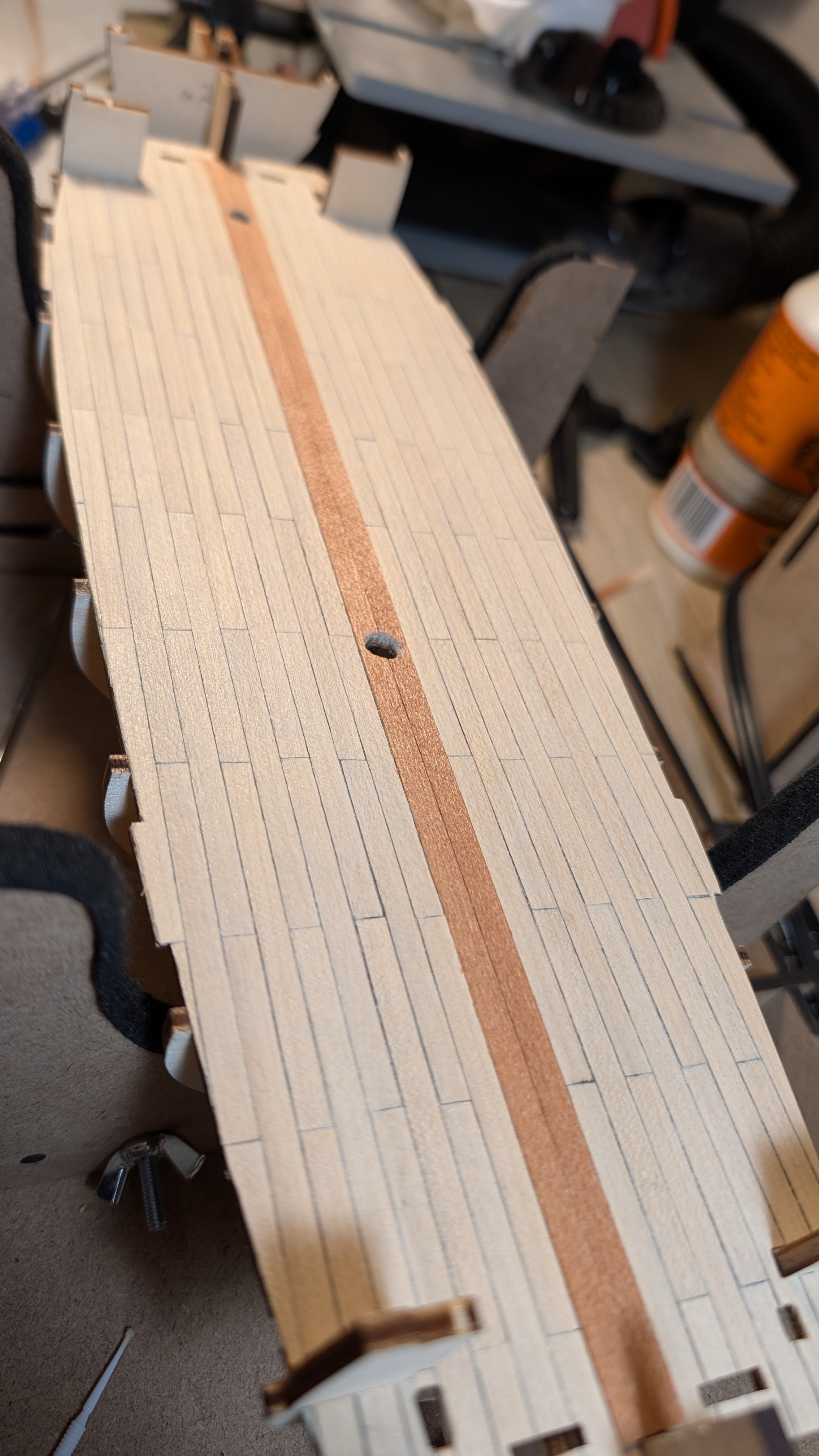

Hello all!

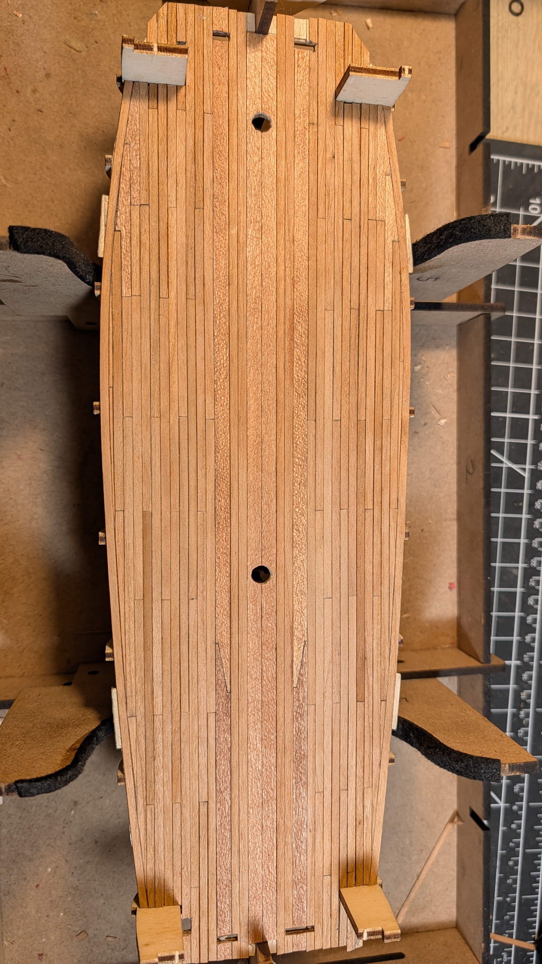

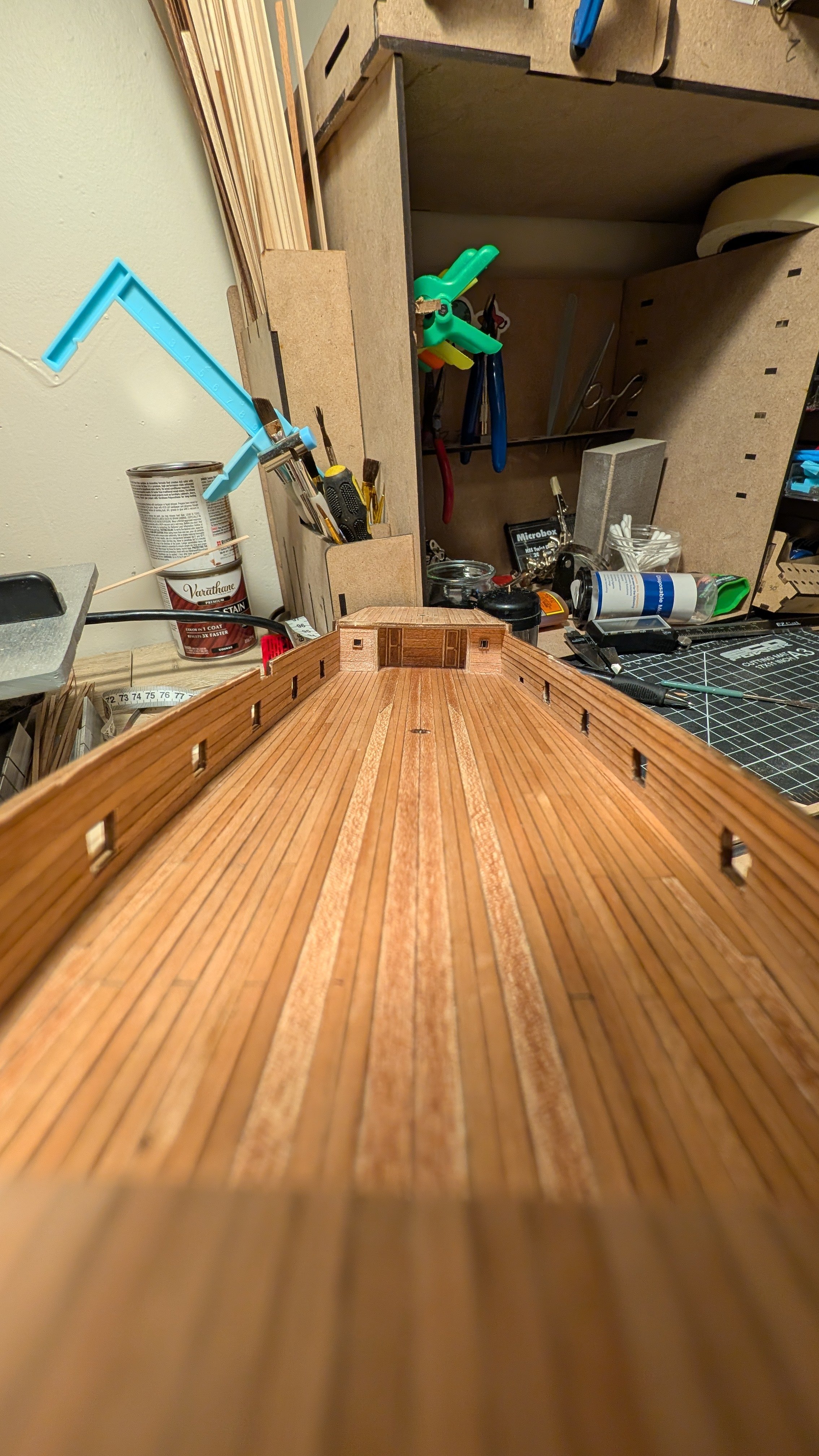

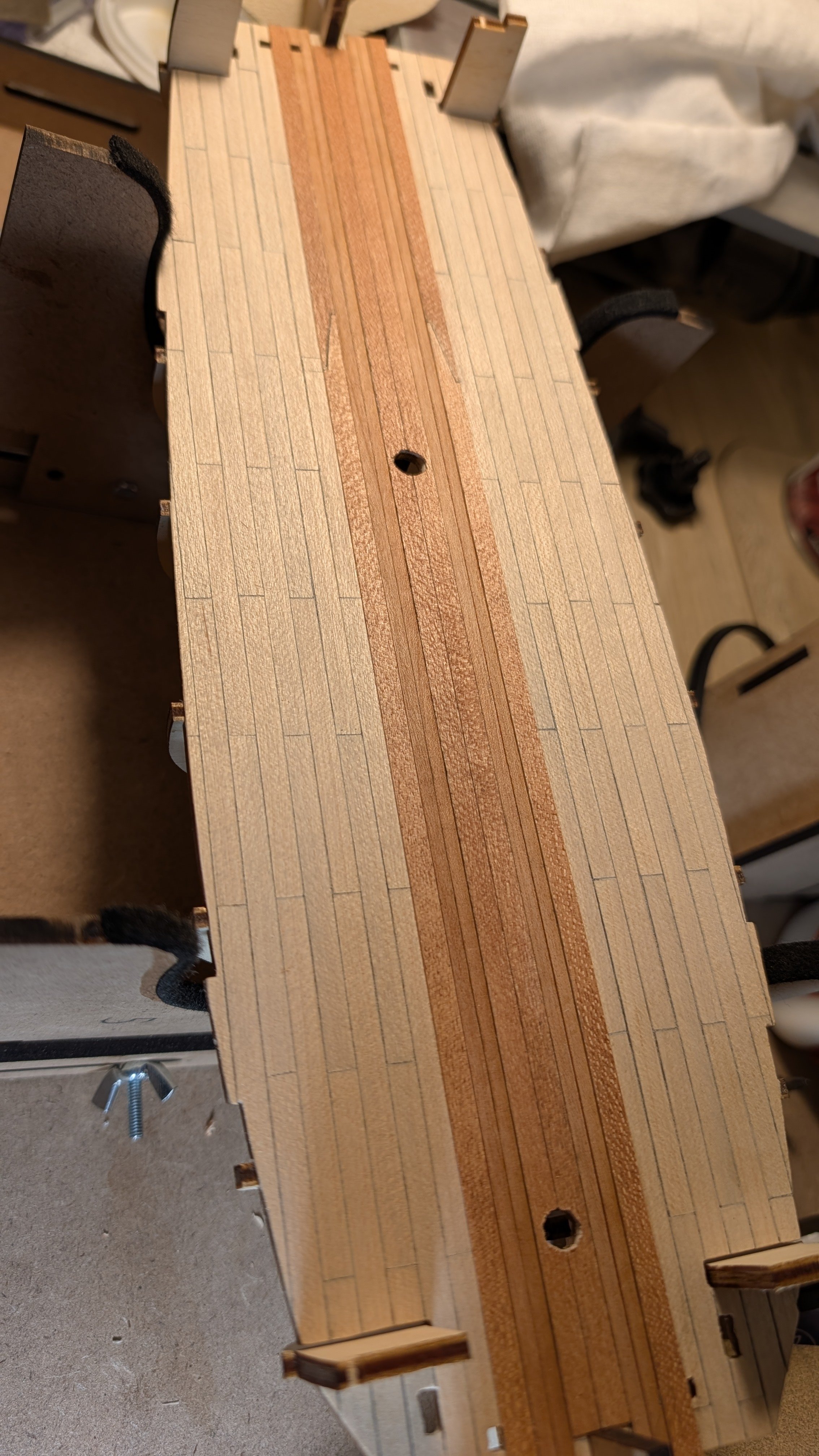

I am back from my visit to Chicago, I have been really missing my model while away. I did get the chance to visit the Chicago Maritime Museum and admire the models there though.
I returned to find the cherry planks I ordered before leaving had been delivered and I have been able to begin work on redoing the deck planks.
King Plank:
Now these two pieces actually aren't the new wood, the new planks are just too thin to capture the king plank so I stained the kit planks and used those, I think the color matches well enough!
Binding Strakes:
Now in the Anatomy of a Ship for the Beagle, there are two binding Strakes, however I decided to just do one, otherwise most of deck would be these thick pieces, and I really wanted the small planks to shine. I'm happy with this choice, I doubt someone will examine the ship and be disappointed by a missing plank, right? Right.

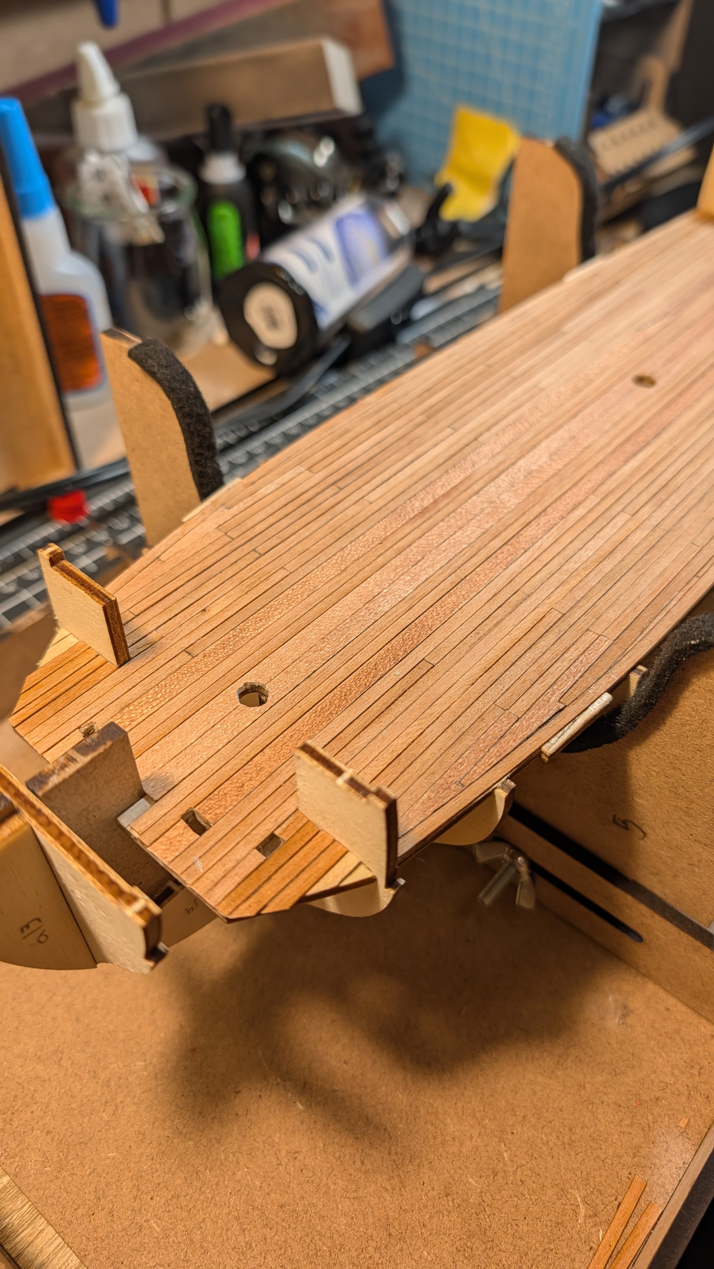

And finally the smaller 3mm planks can shine for the rest!!
Current State of the Deck:
PXL_20260107_105931087.thumb.jpg.1e9537a1ee2929d330591ca66a2e1a7c.jpgPXL_20260107_105951476.thumb.jpg.40bc9717c0aea8b01f0e2ef8e8a13572.jpg
The cherry wood is a bit inconsistent with color but I actually quite like that, makes it more apparent that these are individual 100mm planks. I also threw on a margin plank(?) and may try my hand at joggling here as I approach the bulwarks, there will be enough joggling on the forecastle deck regardless.
I'd like to thank @RobTBay and his build log for the Beagle. There was some fantastic deck work there that inspired me to redo mine.
Anyway that's all for now! I'm so happy to be back at the workbench, and I'm already itching to start planking the hull, still a ways to go before then though.

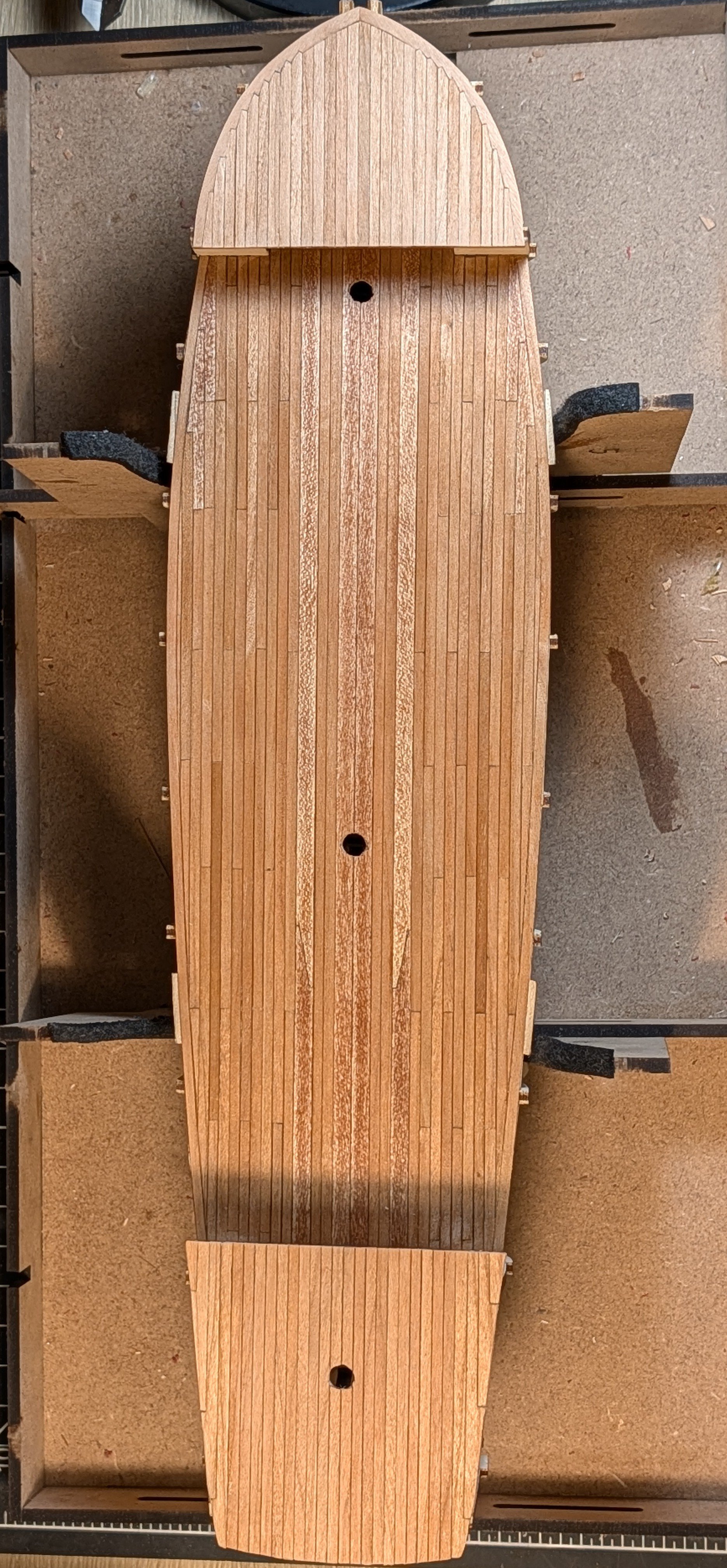

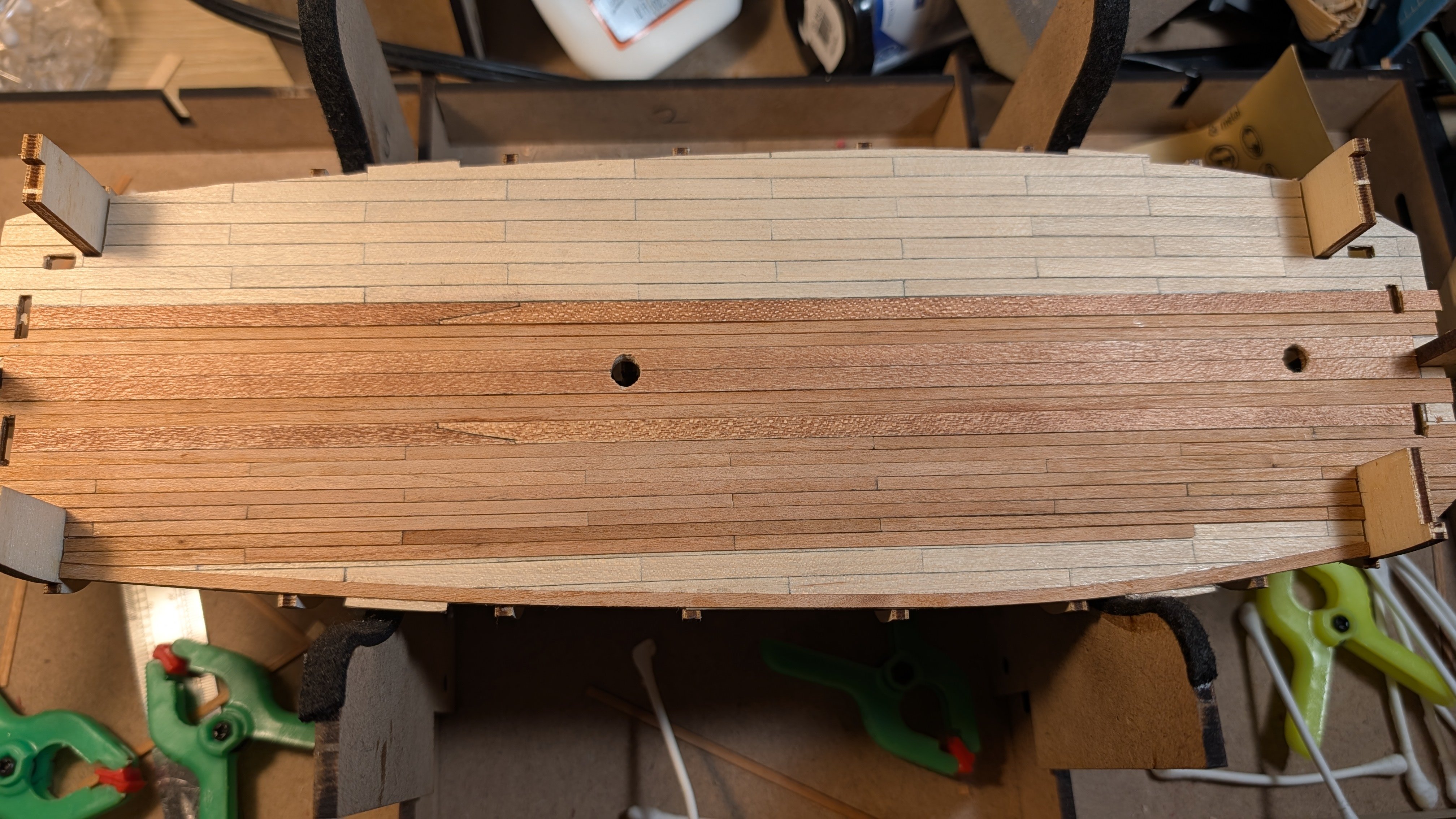

Fair wind all,
The deck is planked! Huzzah!
Now that it's done I am happy I decided to redo the deck, I feel a lot better about this result.

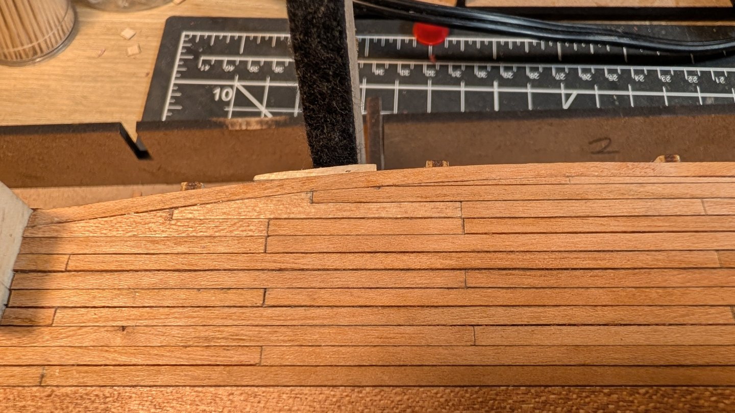

Also here is my first attempt at "hooking" planks:
Again I used kit planks stained to look like cherry for these hooks, as I don't order any cherry wood thicker than 3mm. Hindsight 20/20.
This is making me want to buy a table saw and start tearing my own planks... One day...
I wish I had hooked both fore and aft planks, but I still like the results, and the sharp planks will mostly be covered by stowed cannons later anyway. Onward to page two of the instructions

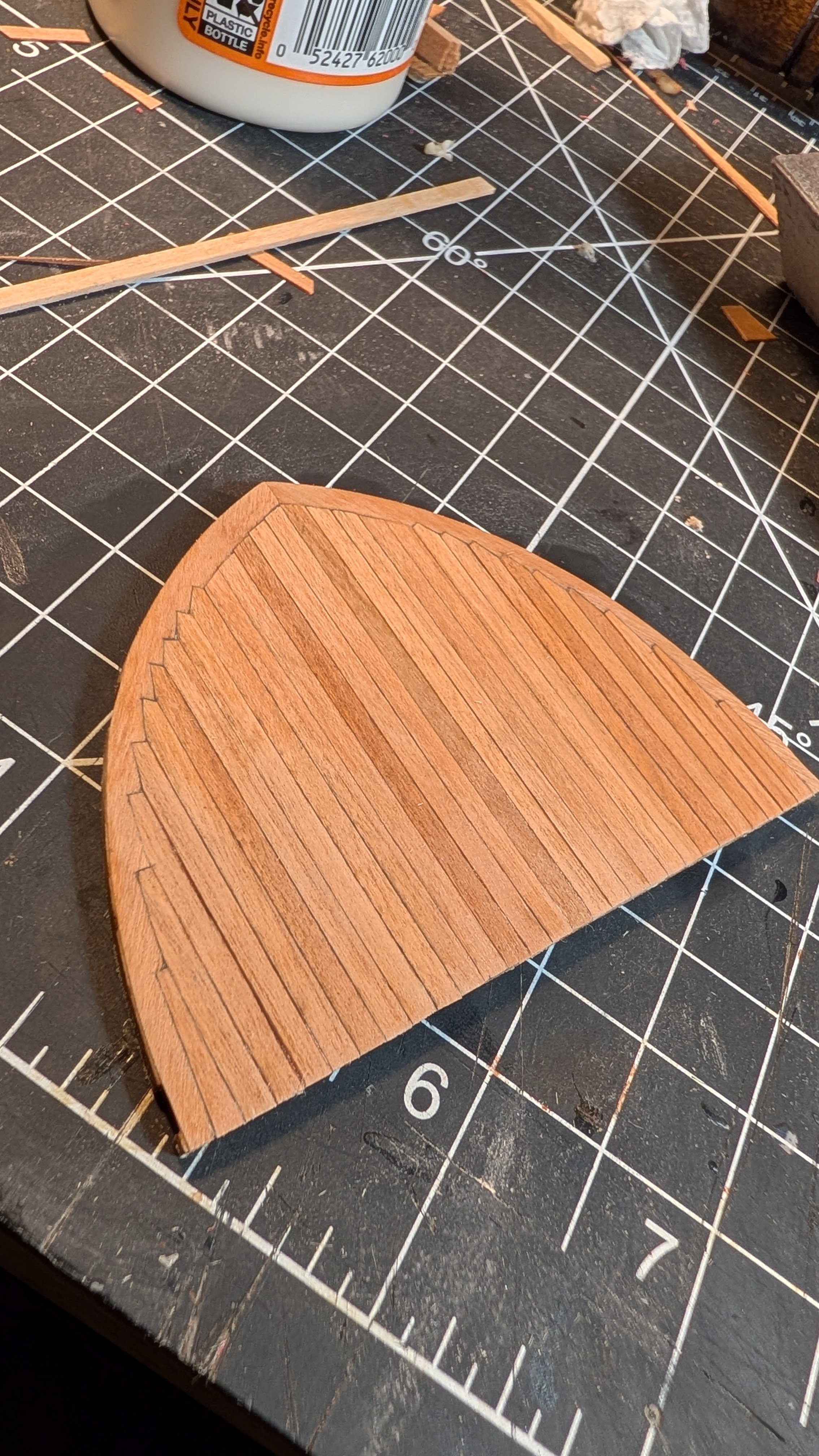

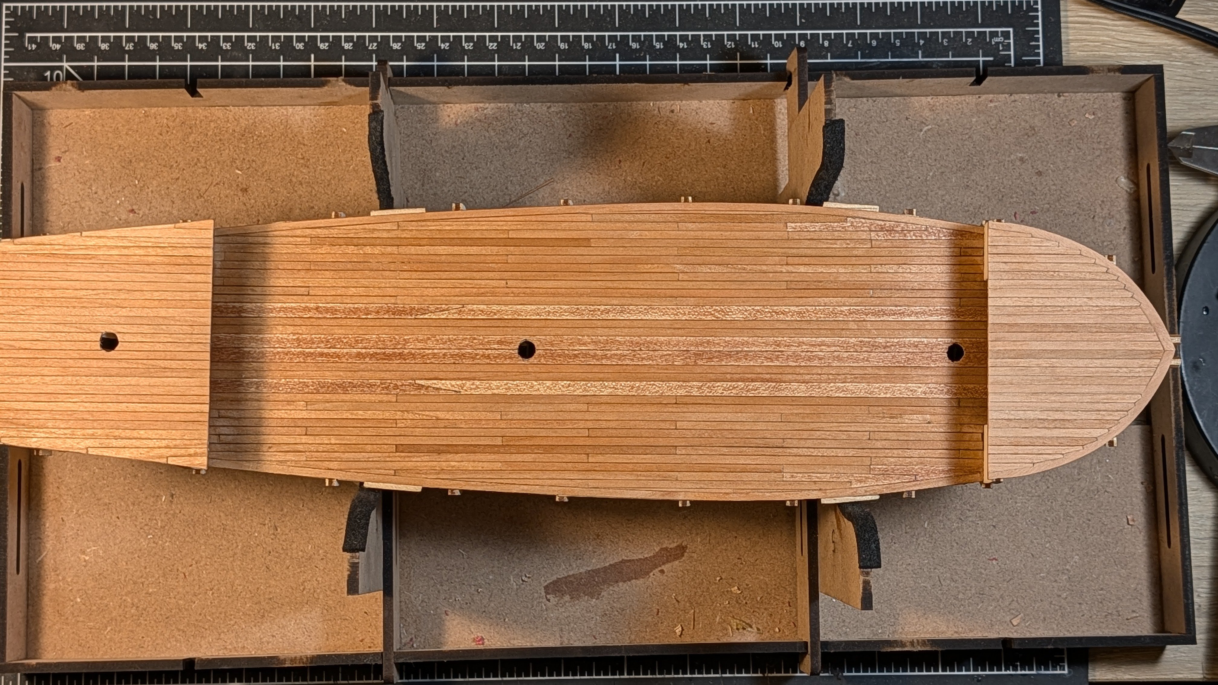

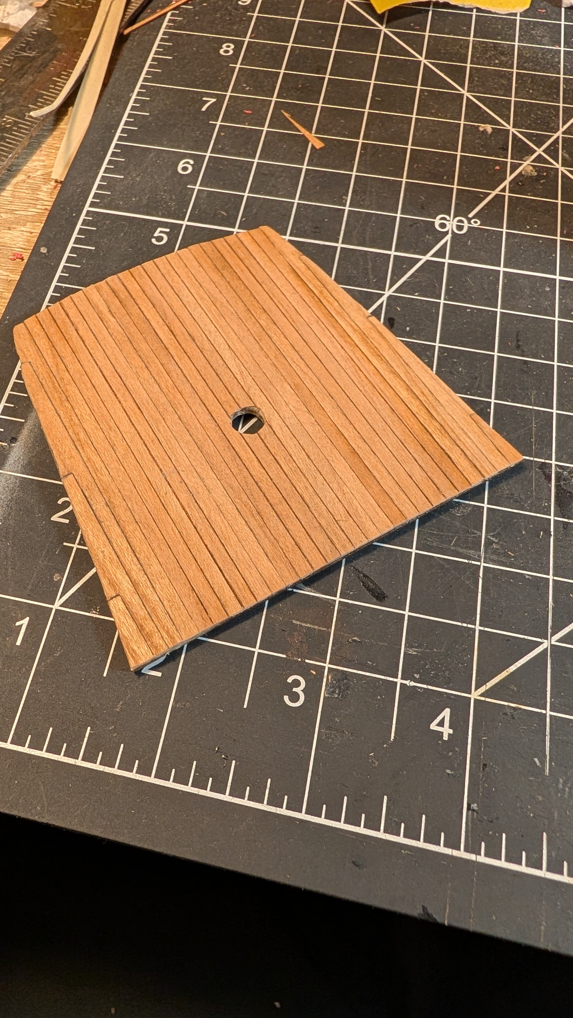

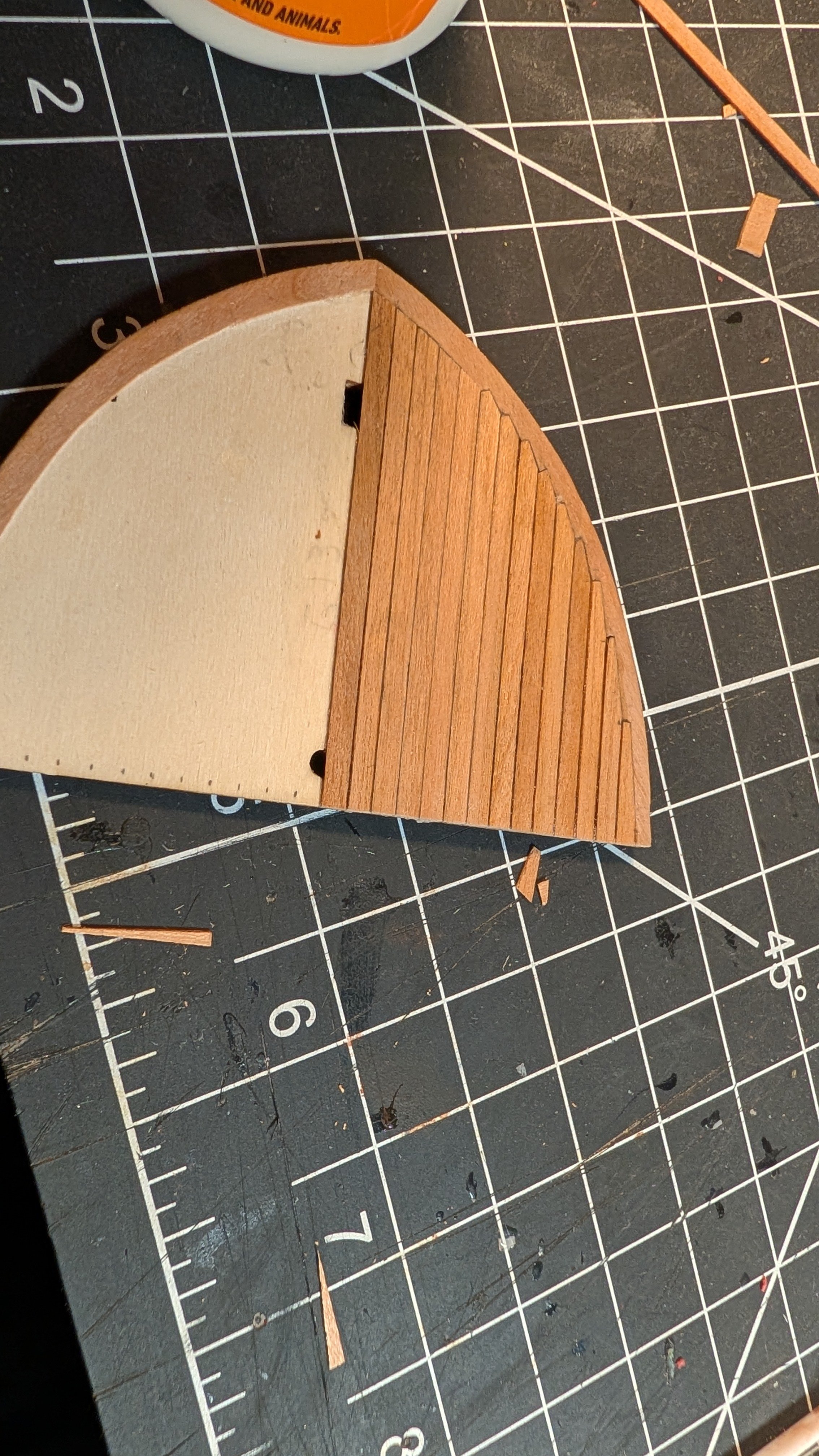

I applied some wipe-on poly to the main deck, and while it dried I decided to have a go at planking the forecastle and poop deck!

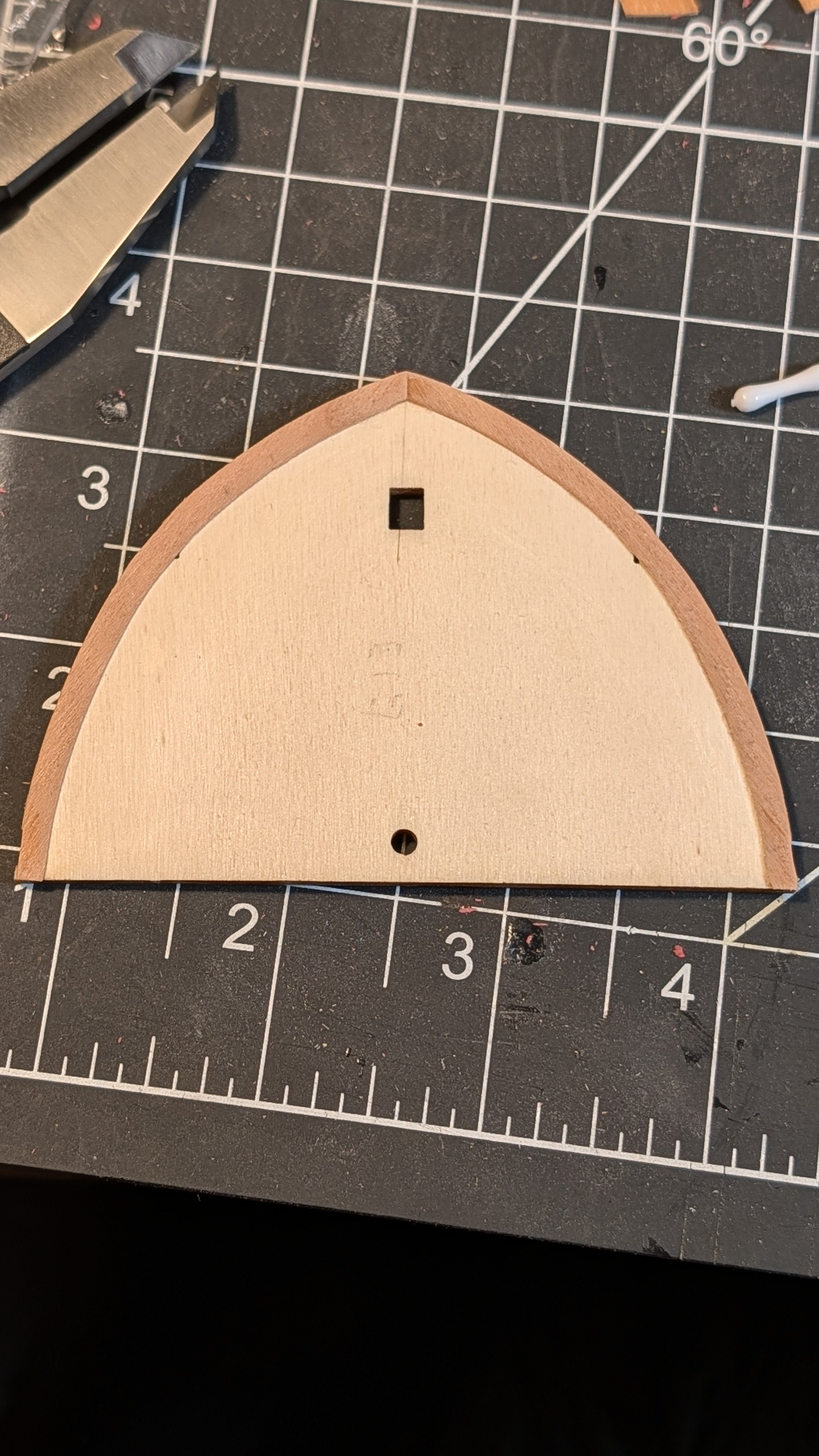

Forecastle

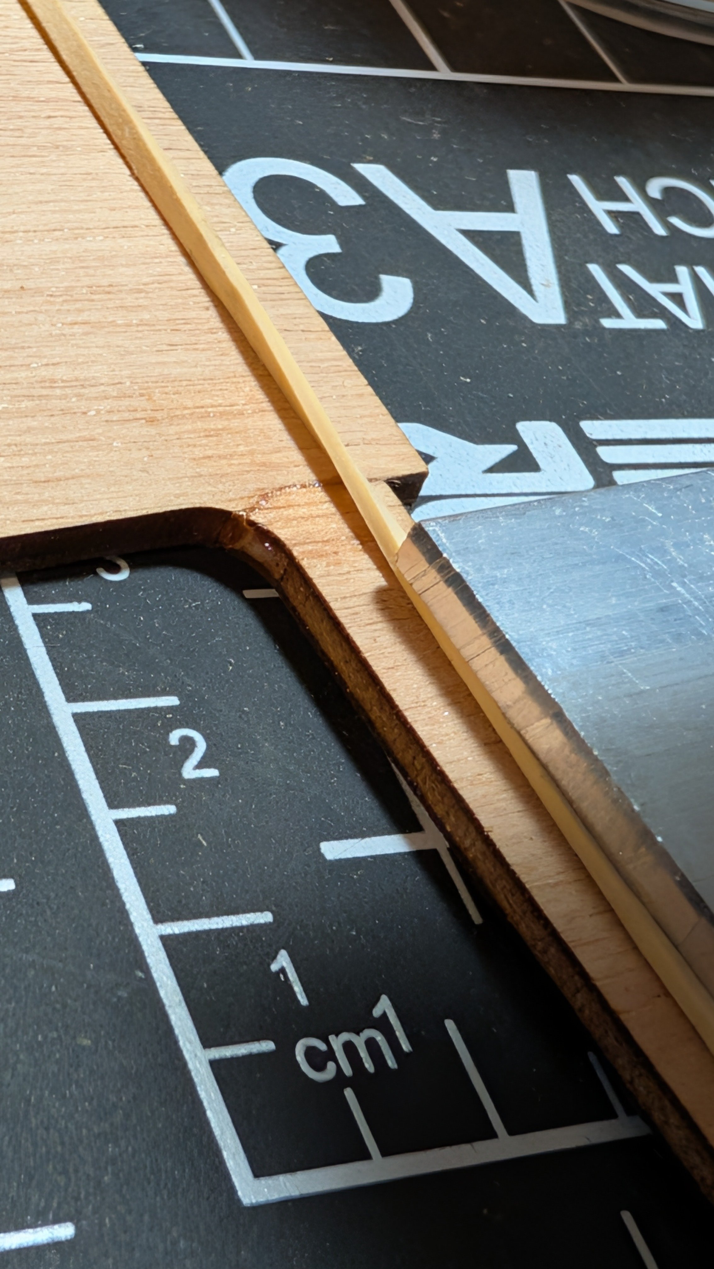

Boy oh boy I was really struggling to try and bend some planks laterally to make up the margin plank. I finally had enough and ran to my local woodshop and picked up some cherry veneer sheets in order to cut the margin planks.
This was attempt #3 I believe, these are some tough cuts to make smooth with just an exacto knife, I yearn for a mini router, or a drill press (@tmj does wonders with a drill press).
Anyway TIME TO JOGGLE
This was incredibly satisfying to do, challenging and tastefully repetitive.

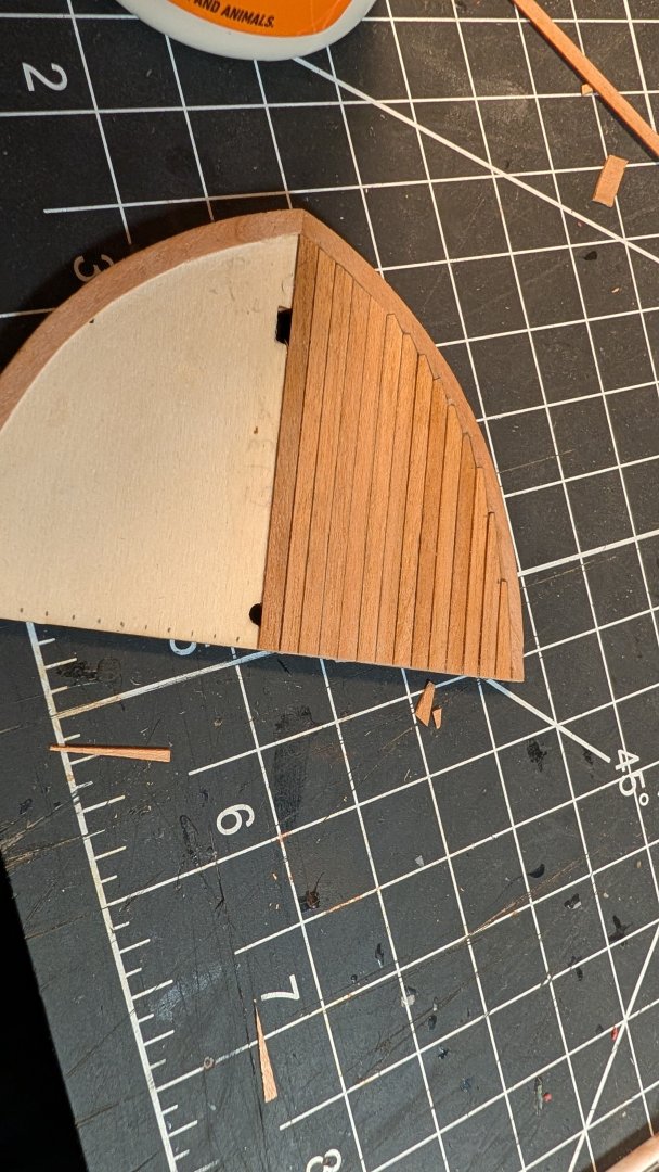

Poop deck
According to the AOAS book, joggling for the foredeck, hooked planks for the poop deck! No margin plank on this one.
I was just a tiny bit off center, and it meant the hook planks lack a bit of symmetry, but they make up for it in heart.
And I couldn't help but dry fit all the decks just to get a peek at the future:
PXL_20260110_111419829.thumb.jpg.32b427eaea25051e0d40b0603af97b79.jpgPXL_20260110_111408491.thumb.jpg.d4a1753730530a104bba3530fbbd19d2.jpg
I'm so glad I redid the deck, the cherry looks fantastic and the extra detailing feels worth it. Next, cabins and bulwarks (wish me luck).

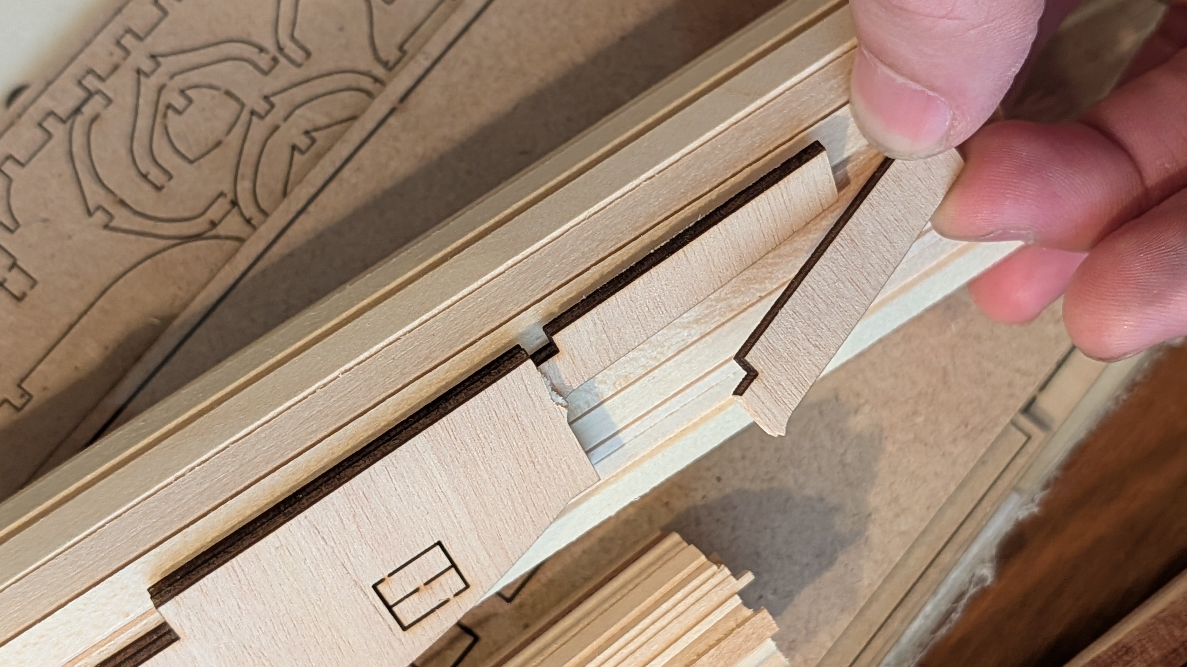

Bulwarks:
I pre-bent the bulwarks quite well this time to avoid my mishap with the Albatros, they were much easier to glue on, still a bit finicky but not stressful.
PXL_20260114_055812816.thumb.jpg.aa8b0bd94bbefc6dcdddc6bb61de4b4c.jpgPXL_20260114_055801905.thumb.jpg.69864fc27362ae2d88a2f982bd90d4d5.jpg
Keen eyes may note one of the cannons holes is not cut out. I did this on purpose because the layout of this aft-most cannon hole is different in the AOS book, and it will be easier to replicate with that frame still attached.
Here's how it looks in the book:
Look at me thinking ahead.
Anyway that's where I am currently. Planking of the inner bulwarks is in progress, I'm using the thinner 3mm cherry planks to match the book.

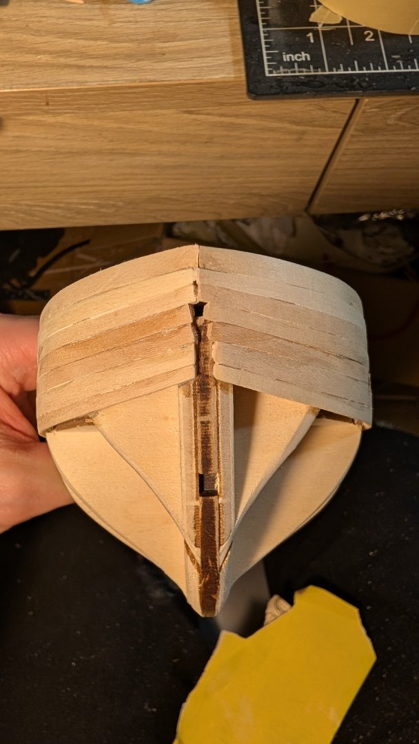

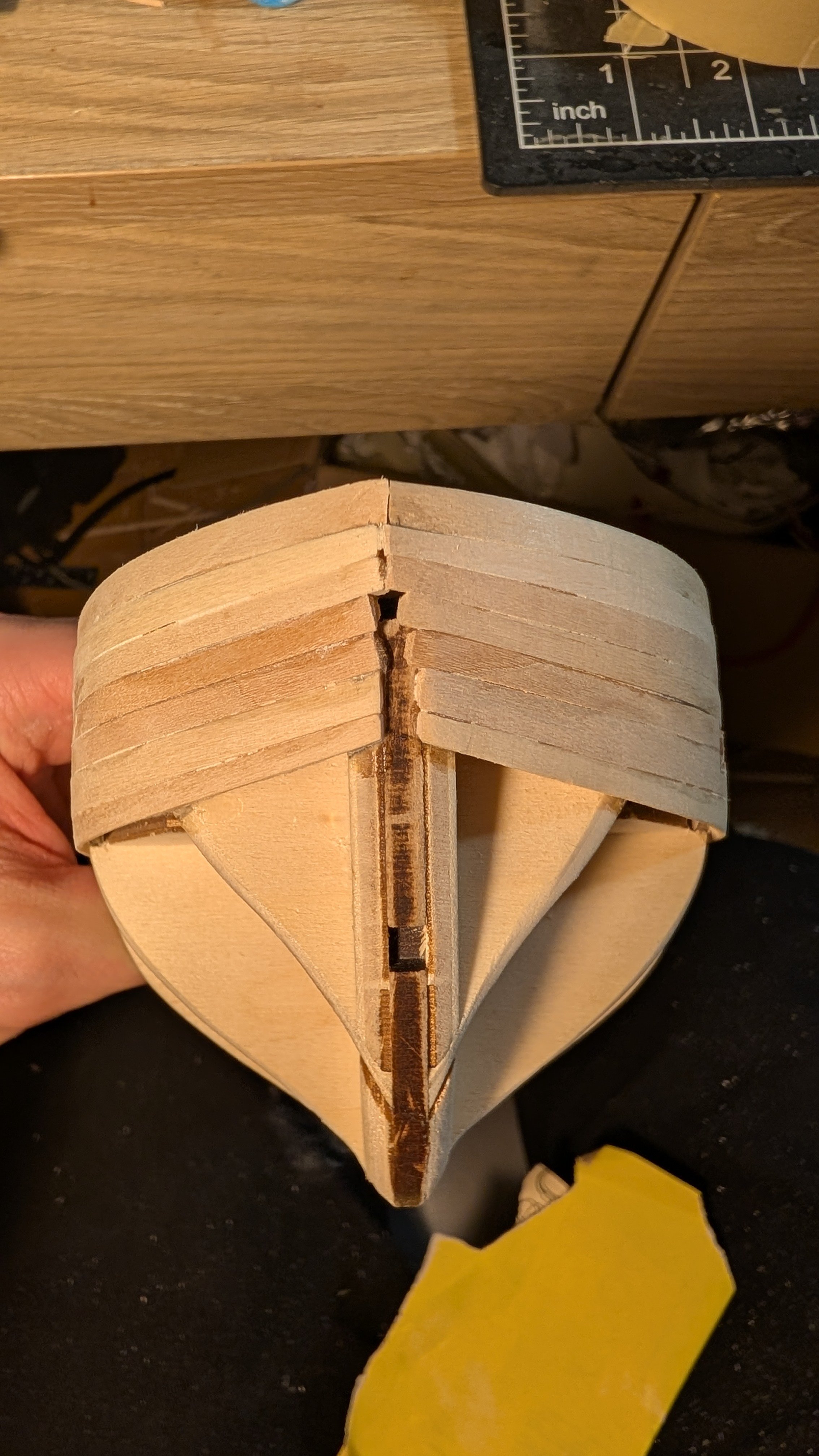

I decided to plank the outer bulwarks first, and then go garboard plank up once they are done. I am attempting bow to stern planking, with no sharp ends like the kit instructions.
PXL_20260118_090127348.thumb.jpg.00a2e8d280975b746c8e70fe46455ec5.jpgPXL_20260118_090152598.thumb.jpg.9d3aebb0218b9ea592581fca9538357c.jpg
If I had used 4 full sized planks above the first one I placed, there would have been a 1mm gap at the top, so I ended up thinning 5 planks instead. Challenging, but the result looks great. I will finish the starboard side, then on to the hull!

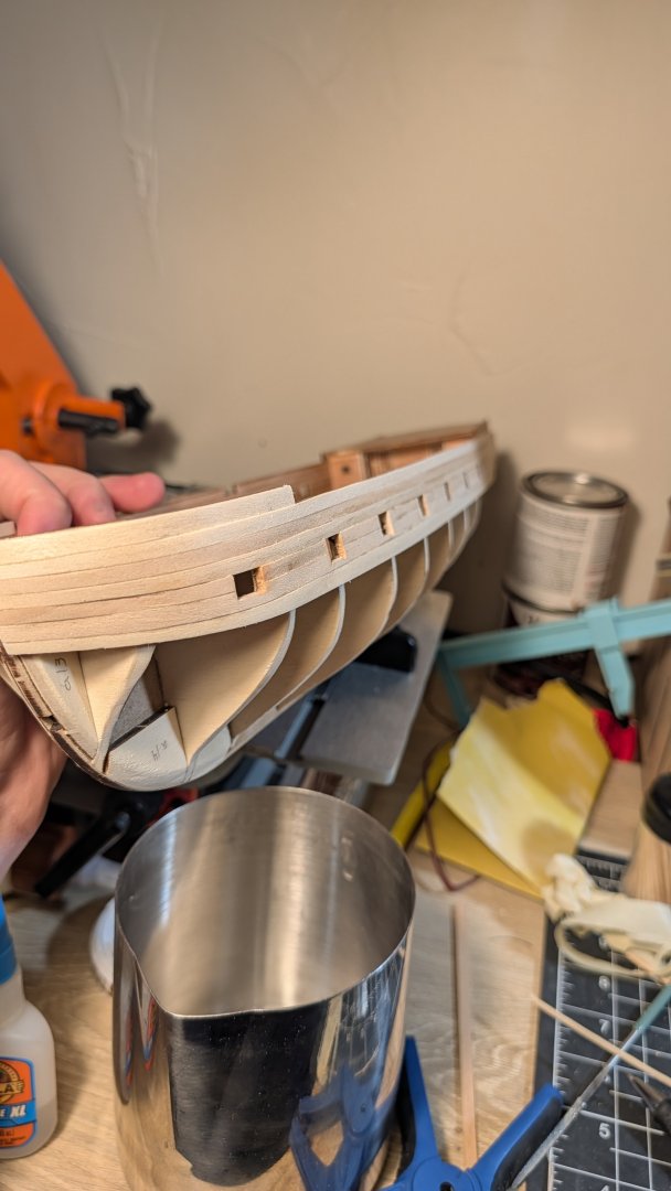

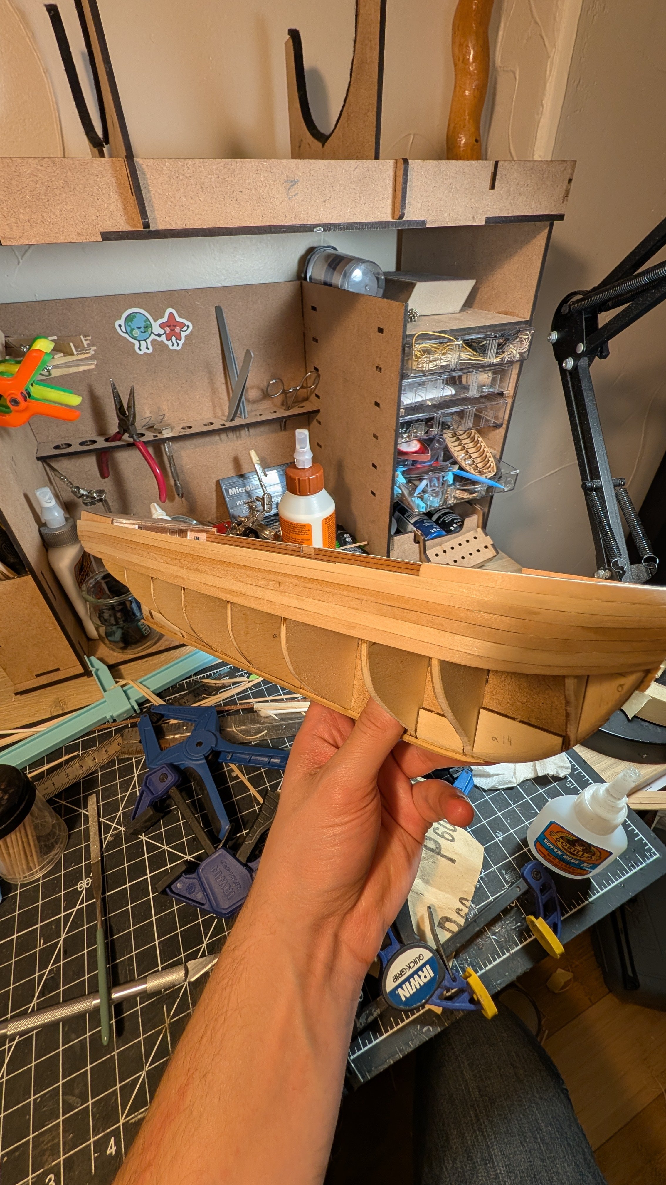

Ahoy all,
It feels like its been ages since the last post but I just checked and it was actually only a week ago. Time is moving very weird lately, and I feel all out of wack.
I haven't gotten much done, but have been thoroughly planning out the hull planking and reviewing tutorials. I think I'm getting the hang of it? We'll see.

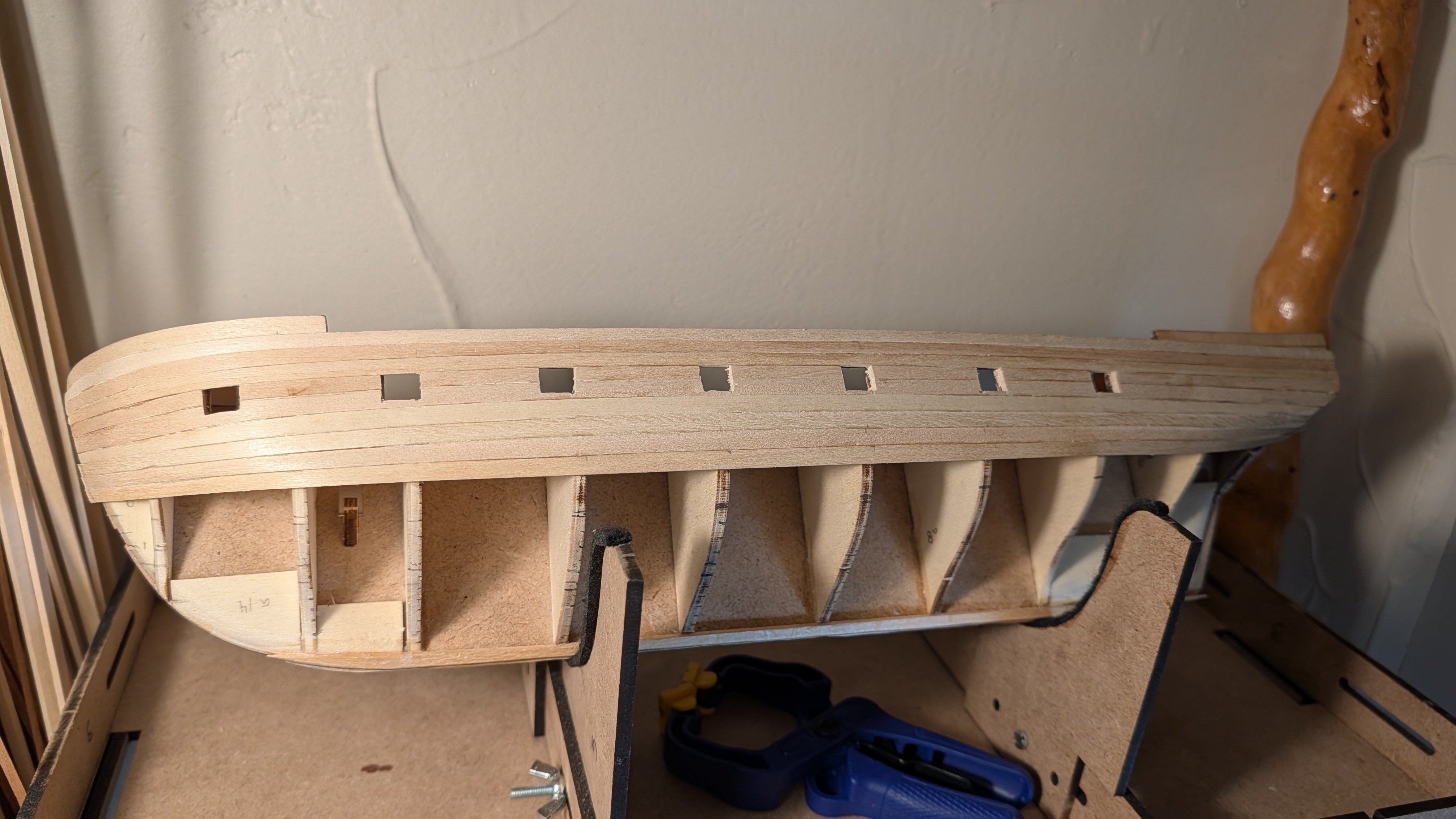

Bulwarks
I have (mostly) finished the outer bulwarks.
Gun ports on the starboard side still need to be cut.
PXL_20260120_032140453.thumb.jpg.c034638a9f6cd8e6916d4c79c6a7efe4.jpgPXL_20260124_100524225.thumb.jpg.1533ee076634832bb6fcfdbed0a02743.jpg

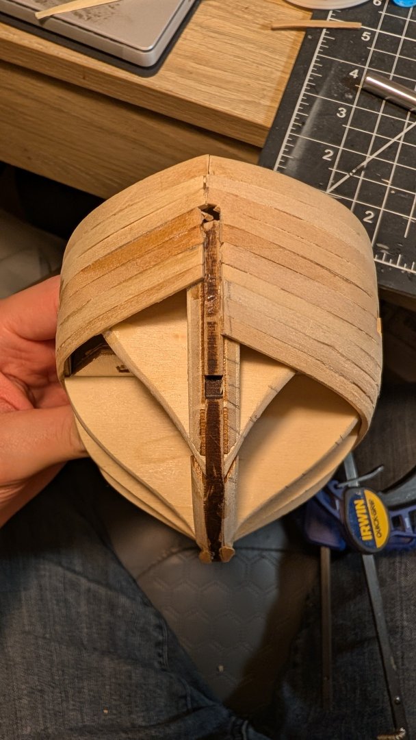

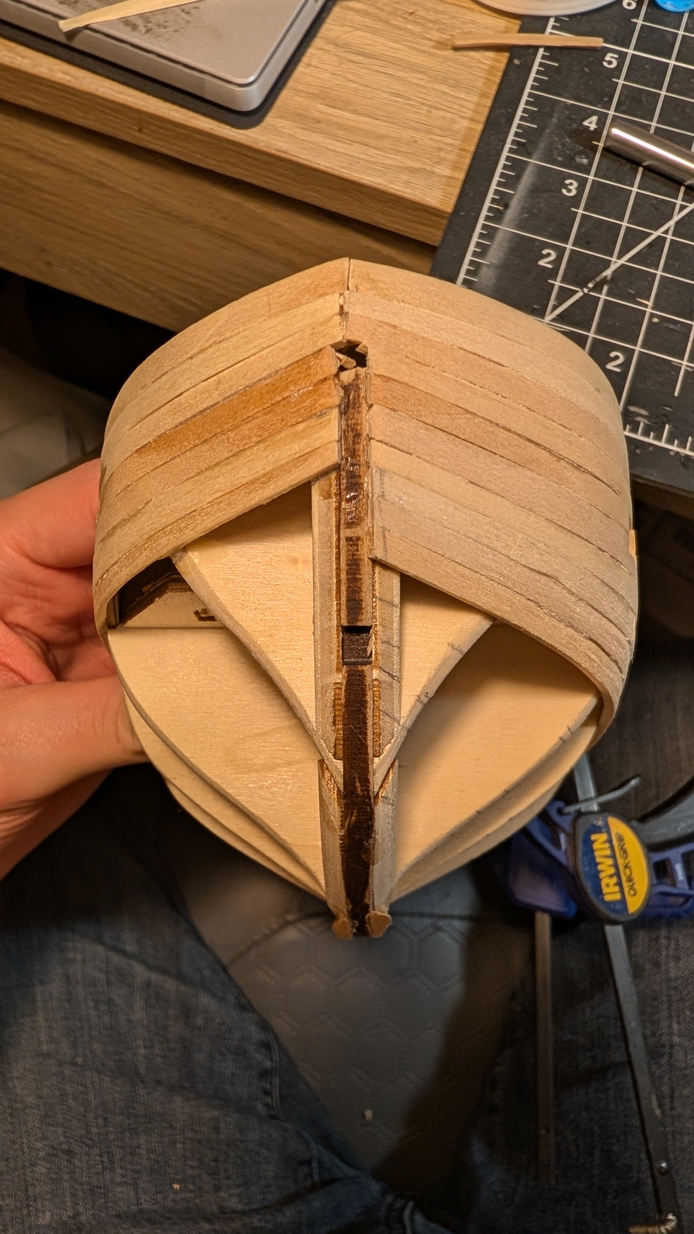

Hull Planking:
PXL_20260124_095938306.thumb.jpg.4cff5a75d41f072ae903d16a3624a621.jpgPXL_20260124_095811339.thumb.jpg.a1121986c112e0c1a251c753d3baea6d.jpg
I tick-marked the hull to the best of my abilities, and have finally begun planking the hull! 3 careful planks on the port side and the garboard strakes are all I have so far. Not much but it's a good start:)
Installing the garboard strake is quite challenging, I do hope it is easier on the next boat whatever that may be.
