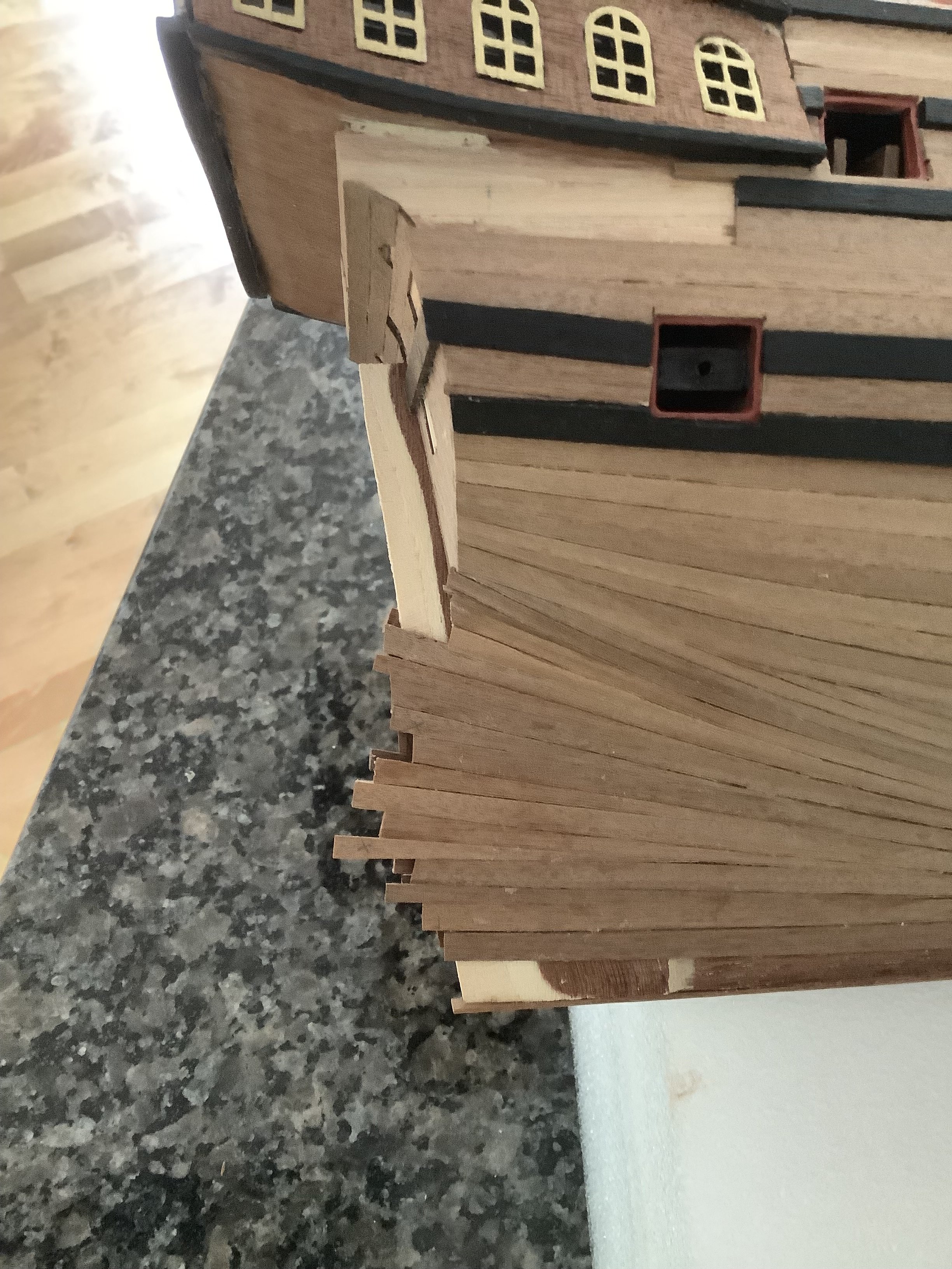

On my Mamoli Friesland build, I should have left the sternpost bare for vertical planking but realized late of my error.
Question is pull it off to the sternpost line or leave as is as I was going to paint the waterline and below all white (which will cover the error)?

Julian this is one of those questions that only you can answer  🤔.  If it hidden then if we don't tell anyone  no one know lol. If it is going to haunt you  replace the offending peices lol. I would just paint, but that's just me
 Good luck on your choice.  :cheers:

Maybe you can cut off both the stern post and the planking with one clean cut, then cheat by adding a slightly wider stern post for the lower planks to butt up against?

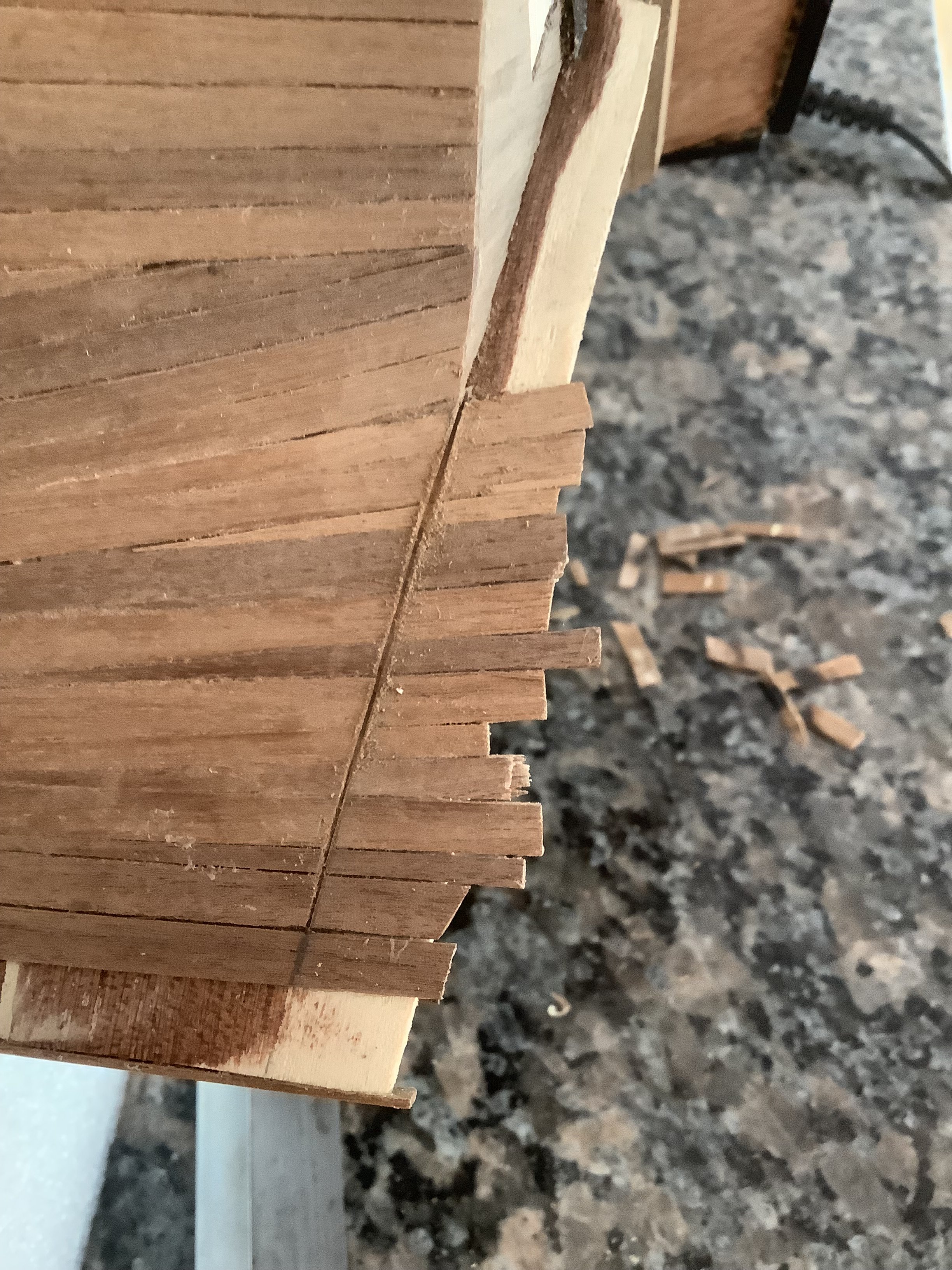

Thanks TMJ for your advice… yes I used PVA glue on the planks and I will take your advice of heating the planks after scoring a line where the stern post should be, and then trying to lift off the ends.

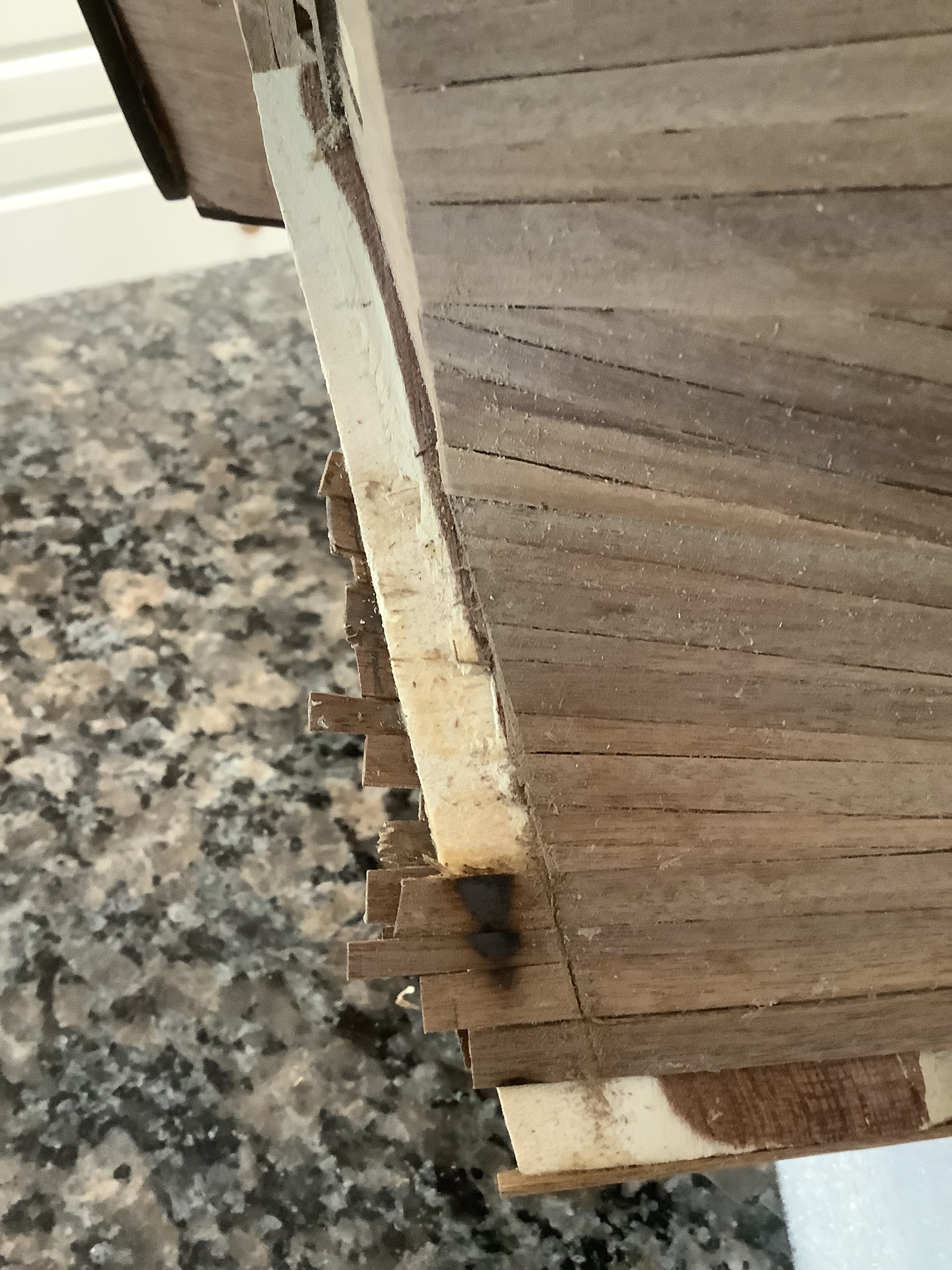

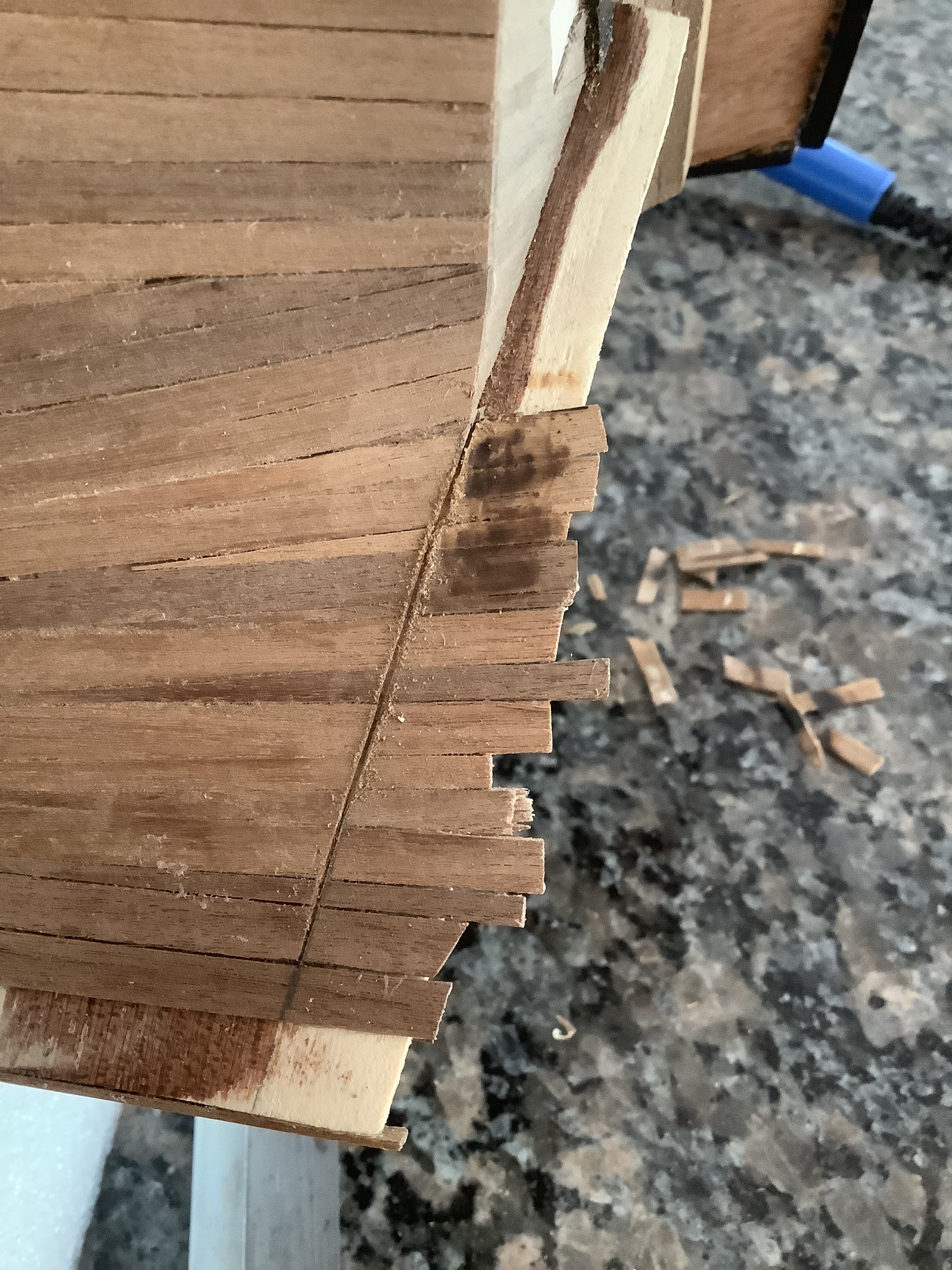

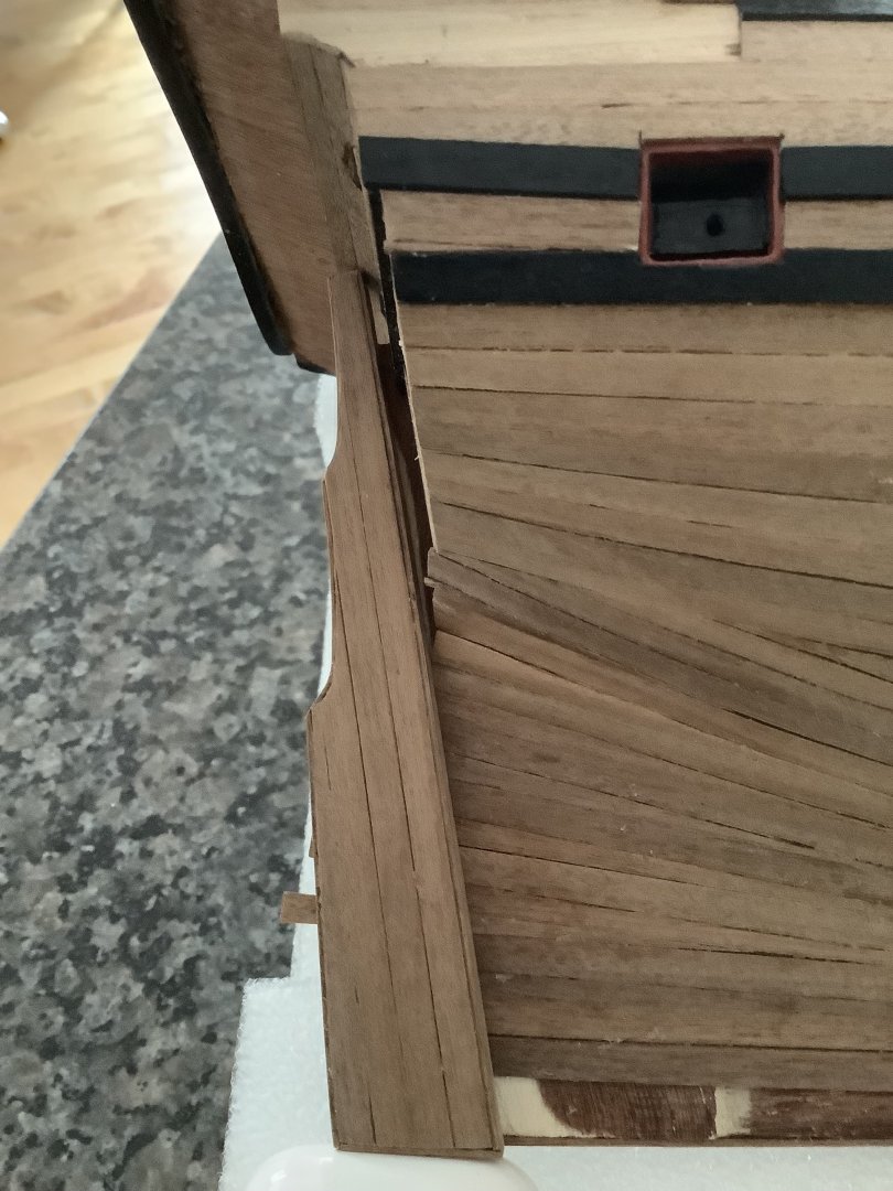

Much easier that I thought... marked the forward edge of the sternpost line, scored a line with a blade, heated up the plank portion in order to release from the glue, and the plank end lifted up effortlessly.
