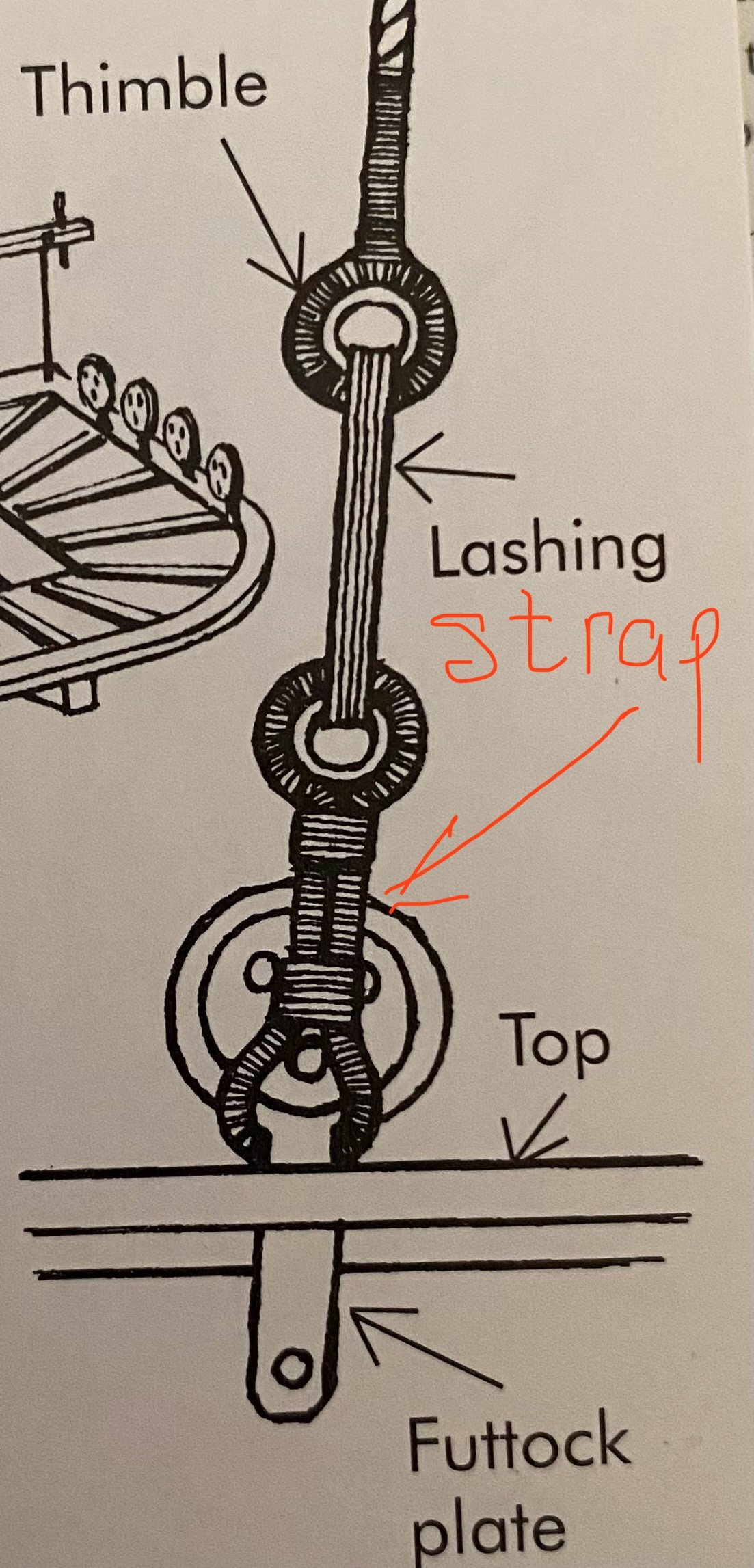

Hi, I am looking for help building a Strap for topgallant shrouds. My project is 1:90 scale HMS Victory. I am struggling with how to make a continuous rope loop which is served with thin line. Small scale presenting additional problems. Help!

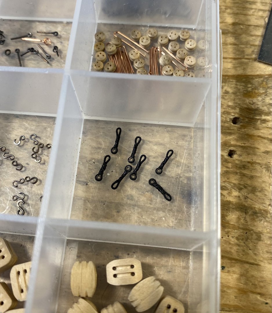

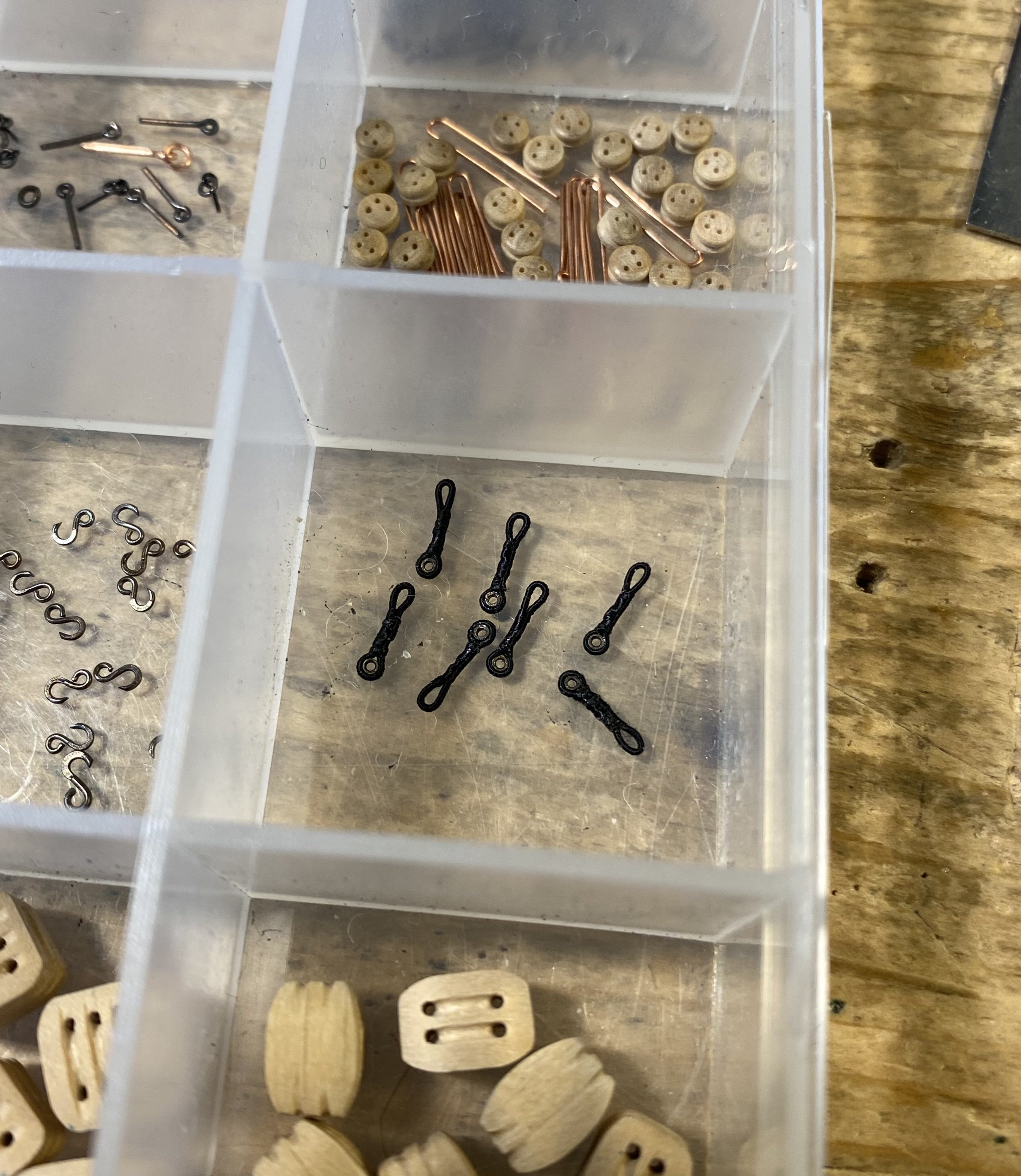

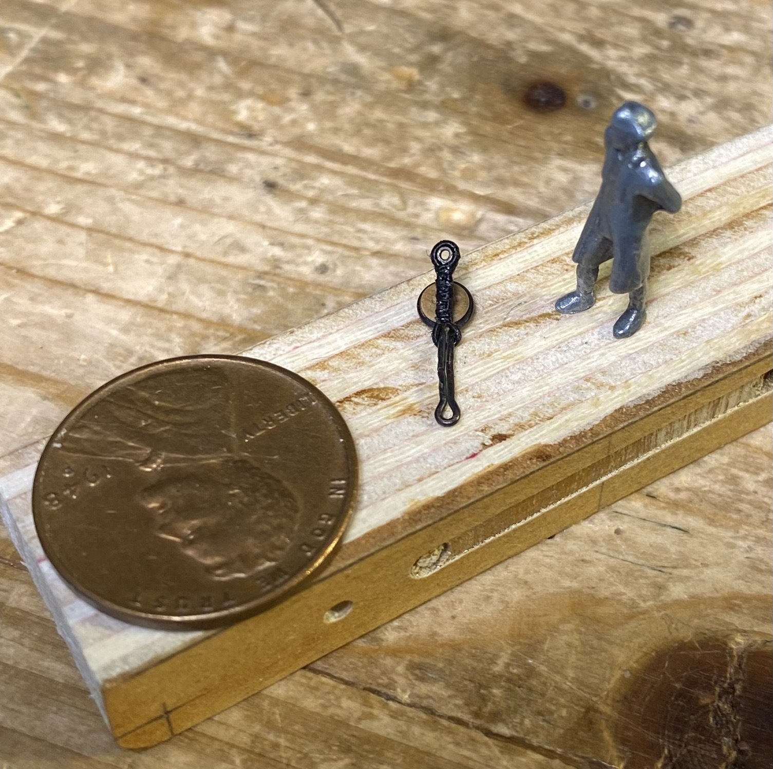

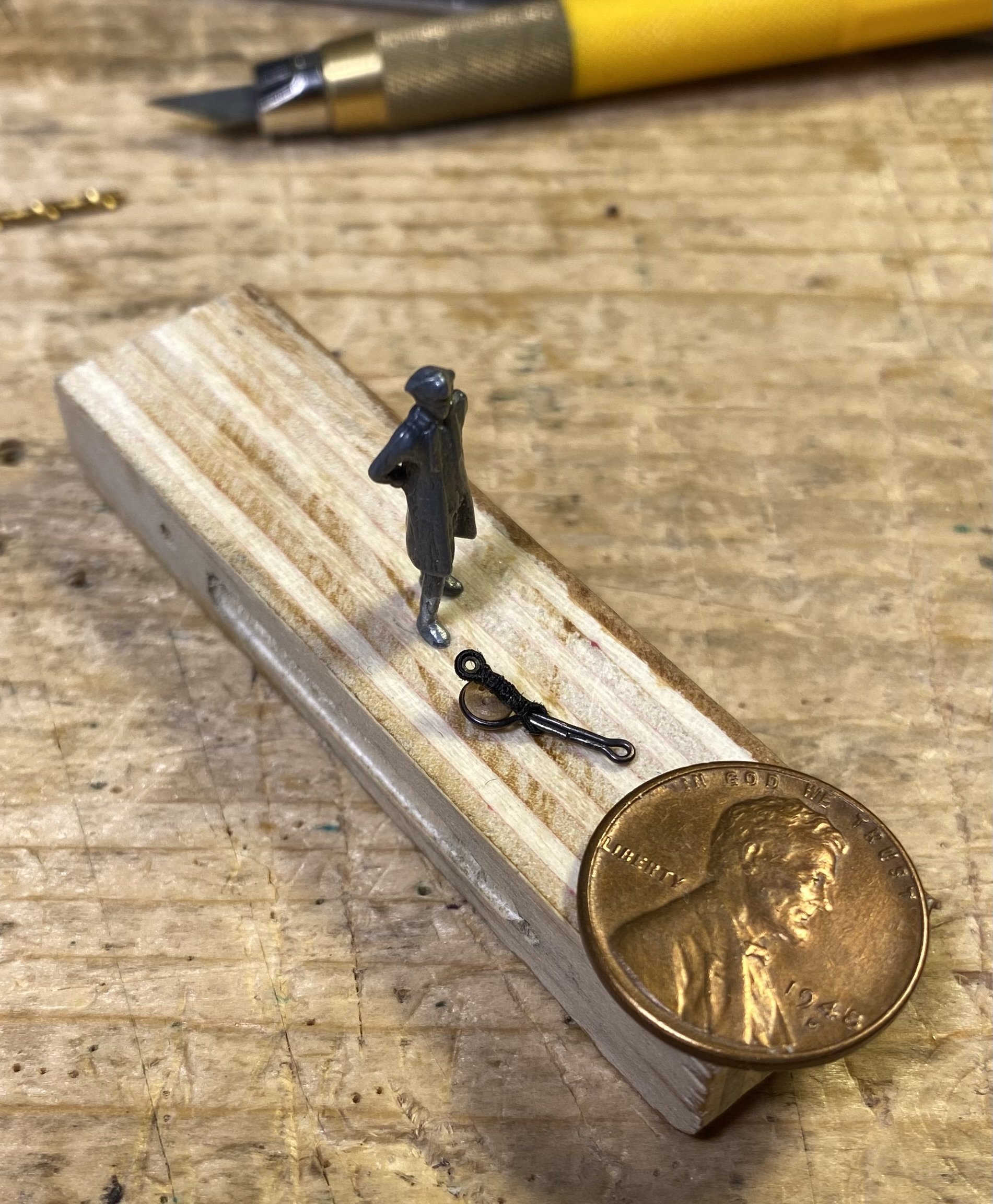

I spent half day making just one strap. I never cursed as much. I threw away three samples which came out to be too ugly. I hate the last one as well but it still maybe is acceptable. Here are the results.
