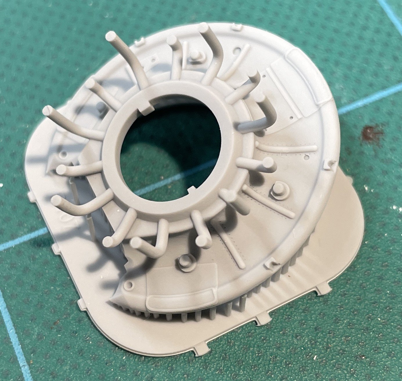

The biggest modification to use the printed engine is to cut off the firewall from the kit parts and get the 3d printed firewall to fit in its place.

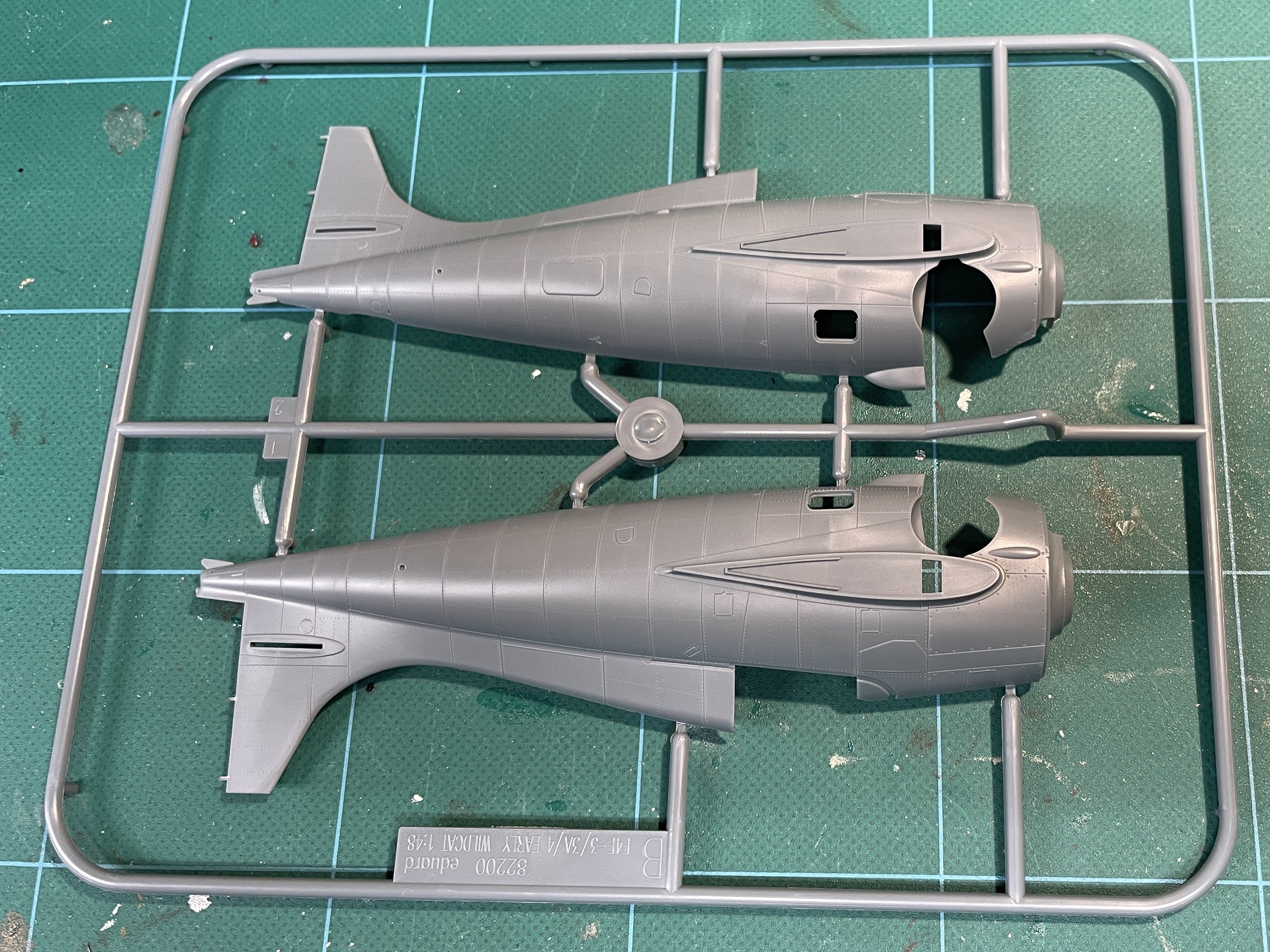

I’ve included pictures of the new firewall and the unmodified fuselage.

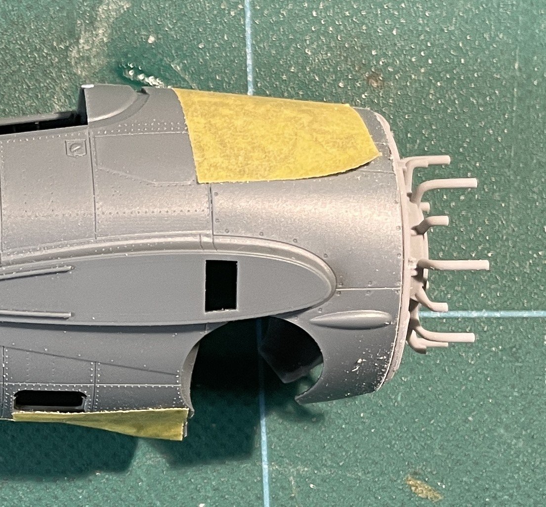

I cut off part of the old firewall with a razor saw, used a sanding drum on a rotary tool to remove much of the rest of it, then used sandpaper glued to a board to remove the rest really slowly, being careful to sand parallel to the panel line that I was aiming for.  It came out OK, so I think I am OK for two models.
